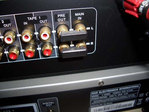

    Hi Guys,
    Not sure if this is the right forum but I'm sure it will be moved if it is not! I have a NAD C 320BEE Amplifier and I would like to connect a sub woofer to it. However, the amp does not have a dedicated subwoofer connection. Is there any other way to connect a sub to an amp like this other that at speaker lever. It has pre out/main in terminals. Can these be used? Thanks in advance for the help guys :W
    Sam.
  • Kevin D
    • 4601
    Yes it can. If you sub has low-level inputs and outputs like your amp, then just run a set of cable out to the sub and back into the amp, removing the jumpers.
    If you sub only has low-level inputs, then go get some nice RCA y-cables. Two males to one female. Connect the two males in place of the jumper, this will keep the connection the jumpers made. Then you have two female plugs ready to run a cable to your sub.
