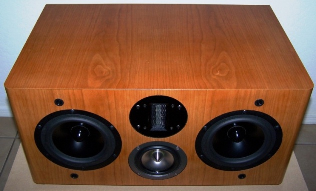

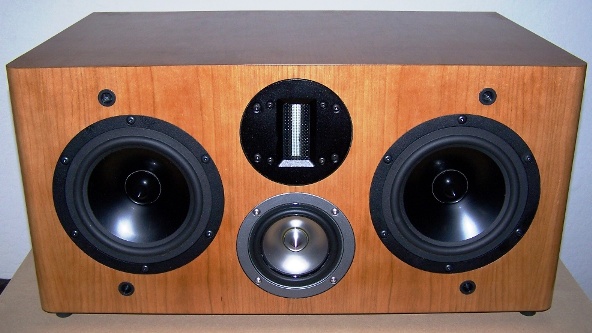

    Chuck (Impala454) made a suggestion to build a thread based on peoples' finishes. So, one could look at pics and make some educated judgment on possible finishes. Lets post some pics, and try to keep the discussion down as none of us want to hunt through 6 pages of chit chat for that one awesome pic
    Here's mine:

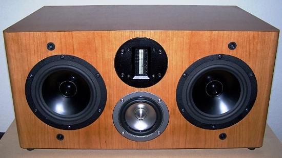

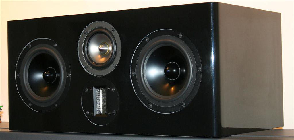

    Statement Center Channel:
    Flat Cut Cherry Paperback veneer
    Ironed on using Heat-Lok
    No Stain
    3 coats of High Gloss poly brushed on
    2 coats of Satin Poly sprayed on

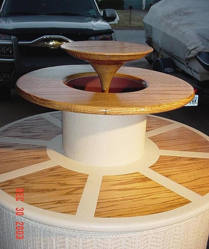

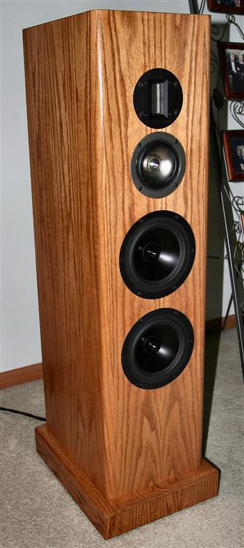

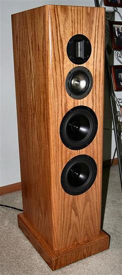

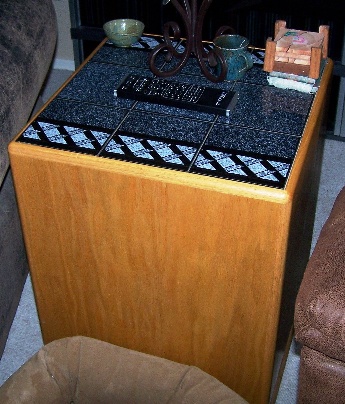

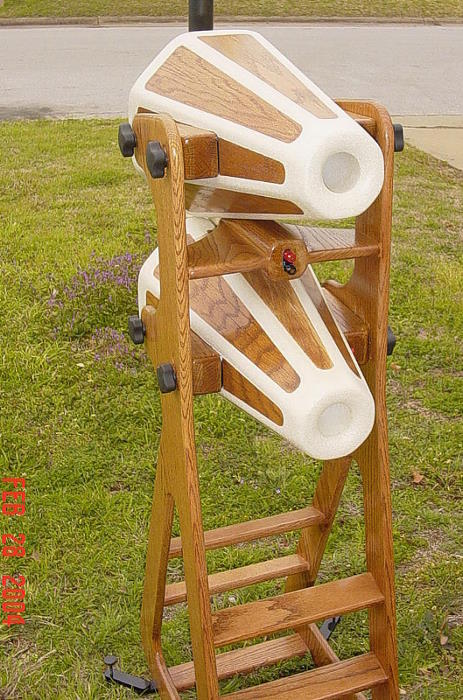

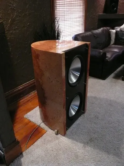

    15" Sub
    Flat Cut Oak Veneered Plywood w/ solid quarter rounds
    No Stain
    10 coats of High Gloss poly brushed on
    6 coats of Satin Poly brushed on
    Inset Tiled Top
    Click image for larger version  Name:	15in Sub.JPG Views:	13230 Size:	80.4 KB ID:	869332

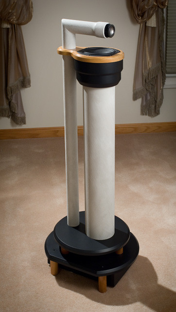

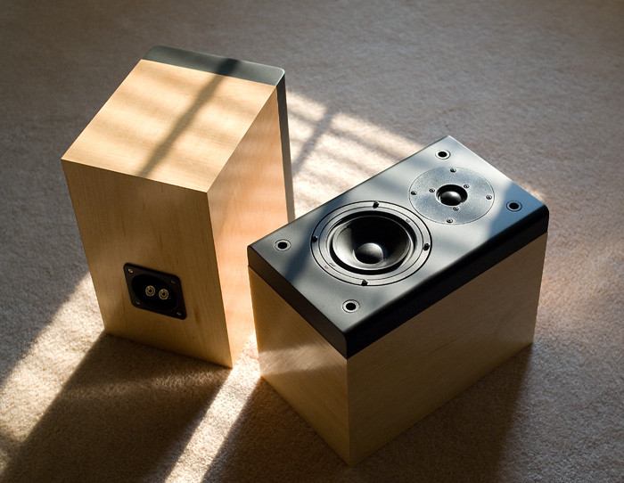

    Cabinet:
    paper-backed maple veneer, ironed-on using Titebond woodglue with these steps:
    veneering, loudspeakers, DIY, iron-on veneer, williamrschneider
    General Finishes oil-based pre-stain conditioner
    General Finishes "Honey" stain
    Minwax semi-gloss Polyurethane brushed-on, 5 coats
    Baffle:
    Zinsser Bull's Eye Seal Coat sanding sealer on MDF, 2 applications with sanding
    Rustoleum sandable auto primer rattle-can (more sanding until very smooth) & repeat
    Krylon Semi-flat black (rattle-can)
    Last edited by theSven; 24 June 2023, 21:27 Saturday. Reason: Update image location

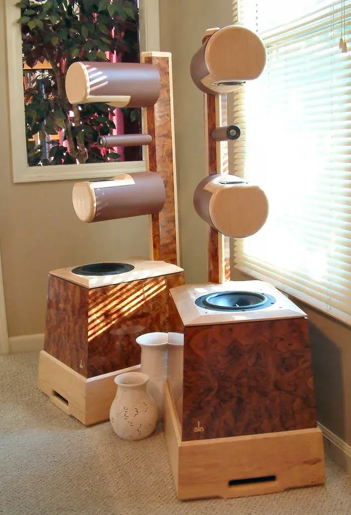

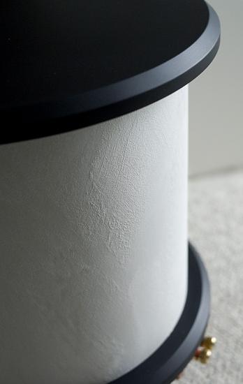

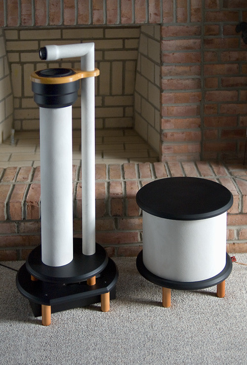

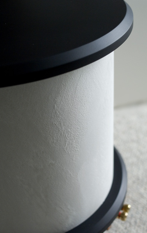

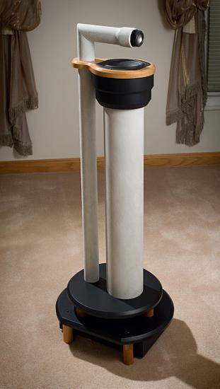

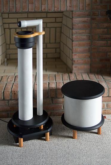

      PVC Pipes:
      Roughed-up with sandpaper
      Zinsser B-I-N shellac-based primer, brushed on
      Valspar "Ancient Stone" (Lowe's) interior flat latex, brushed on
      Valspar Lime Wash, brushed on in crosshatch pattern
      Valspar Latex Clear Glaze for extra protection, brushed on
      Black components:
      Zinsser Bull's Eye Seal Coat sanding sealer, 2 coats brushed on, sanded smooth
      Rustoleum sandable auto primer rattle can (several coats, sanded until very smooth
      Krylon Semi-Flat Black rattle can, 2 coats
      Poplar wood components:
      Minwax Polyurethane, 3-coats wiped-on
      Minwax "Gunstock" stain over poly
      Minwax Polyurethane, 3 more coats, wiped on
      (It's an odd way to do it, and the stain over the poly behaves strangely, but it gives the color I wanted without emphasizing the grain)
      Last edited by theSven; 24 June 2023, 21:24 Saturday. Reason: Update image location

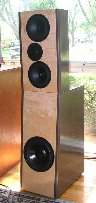

          Click image for larger version  Name:	AetherFinishedTall.jpg Views:	337 Size:	64.6 KB ID:	851749
          Sides (MDF):
          Rust-Oleum brown primer (2 coats, brushed)
          Rust-Oleum Hammered Brown paint (2 coats, brushed)
          Baffle (maple plywood):
          Zinsser Sealcoat (2 coats, cloth-wiped)
          Zinsser Shellac (4 coats, cloth-wiped (I think))
          Paste Wax (1 coat, rubbed on, then buffed off)

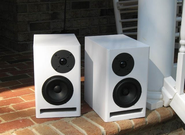

          If you want a flat white or flat black semi gloss with basically no priming or sanding, I highly recommend this:
          Broken: http://undefinition.googlepages.com/...olevels,87.jpg
          Rust-oleum Appliance Epoxy. Comes in black, white, and almond. Make sure your surface is filled and sanded very smooth beforehand, and just start hitting it; no primer needed. You recoat once every 30 minutes or so (gotta do it in time, or you'll have to wait a week to recoat), for 6-8 coats. That's it. You let it dry for a few days. If you want to clearcoat, you can, but it's probably not necessary. At this point, it already looks like real furniture (or a kitchen appliance, depending on how you think about it. This stuff is HARD; you can put your cup of coffee on it and not worry.
          Last edited by theSven; 24 June 2023, 21:19 Saturday. Reason: Update image location

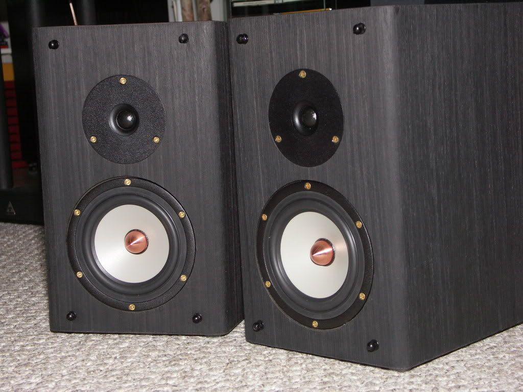

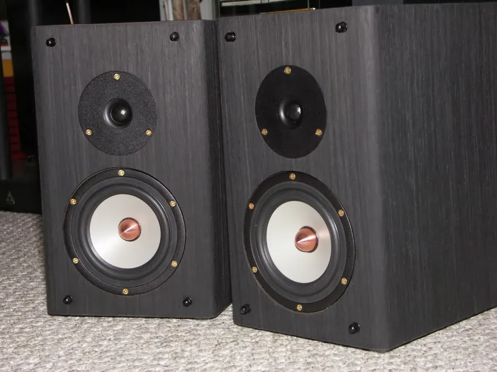

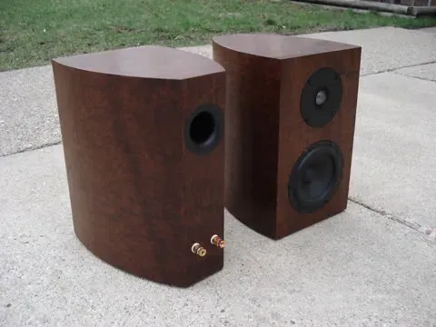

            My first finish, a simple 2 pass Ebony stain, and 1 pass Tung Oil, it disappears completely at night (with grills on).
            Last edited by theSven; 24 June 2023, 20:01 Saturday. Reason: Update image location

              The ebony stain is pretty sweet with the white cone, copper phase plug, and brass hardware. Well done!

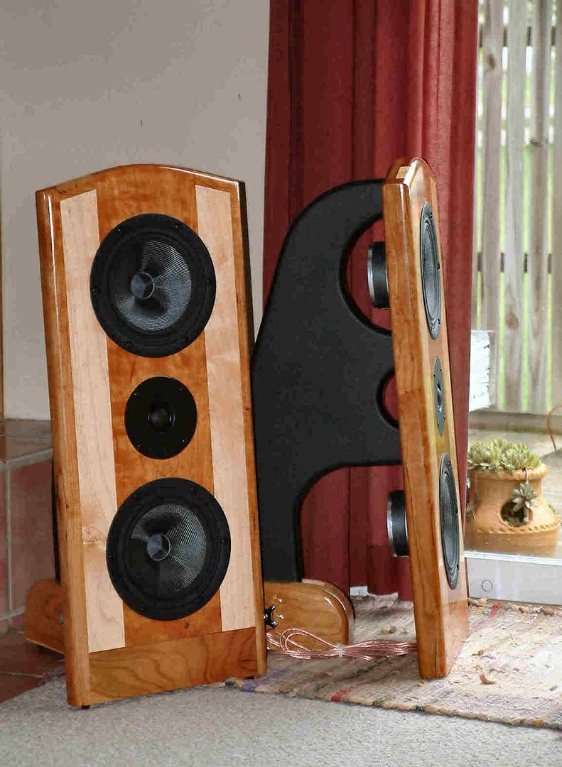

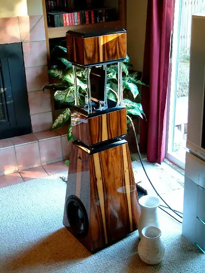

                • 1456

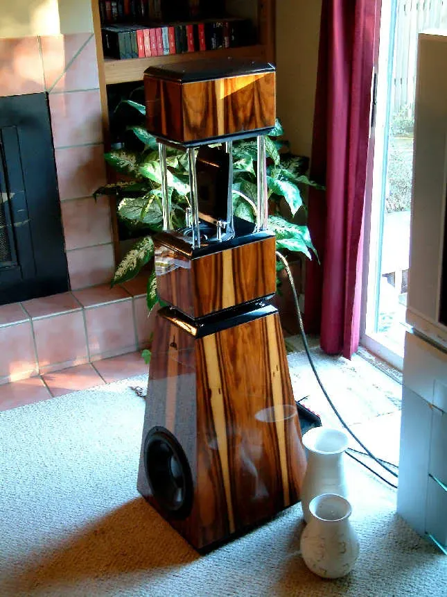

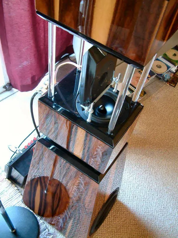

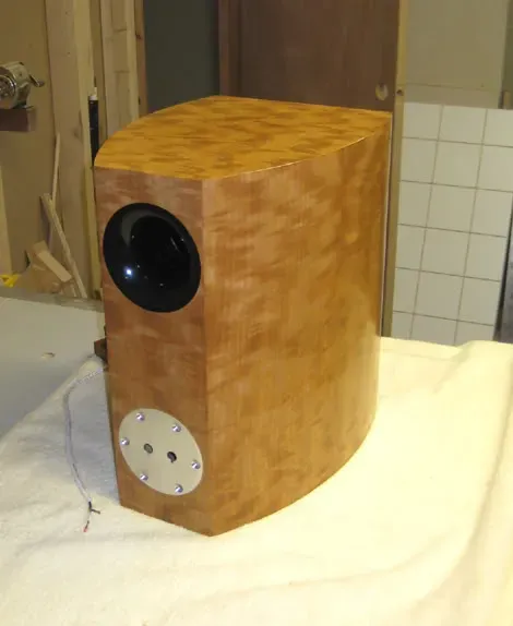

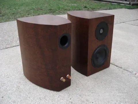

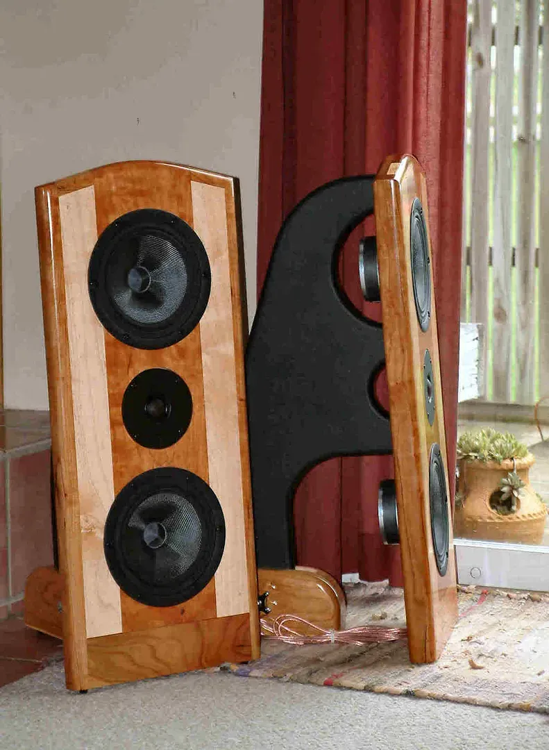

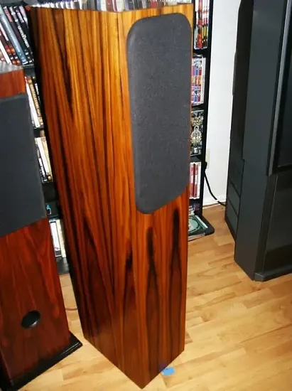

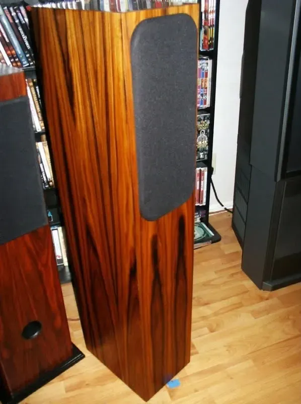

                This is probably my best effort, the HOSS project: HOSS
                Santos Rosewood 2ply veneer
                many coats of Dewaxed shellac followed by
                Many coats of Old Masters poly, brushed on and let dry flat one side at a time. Lots of sanding and smoothing. The gloss black is rattle cans of Rustoleum gloss black over primer over dewaxed shellac on mdf.
                Click image for larger version  Name:	DSCF0131-small.webp Views:	2 Size:	82.3 KB ID:	942636
                Click image for larger version  Name:	DSCF0026.webp Views:	2 Size:	82.1 KB ID:	942637

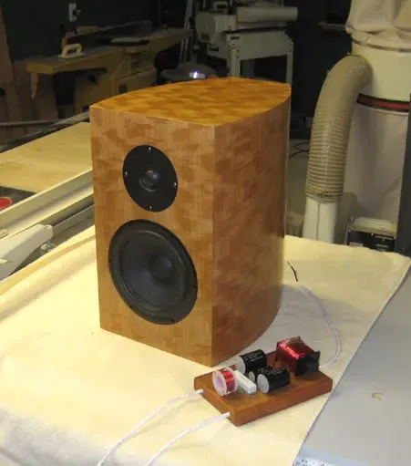

                Here is one of my NaO Mini's (just the MTM section):
                Solid cherry and Maple over an mdf backer
                Boiled linseed oil, 1:1 with naptha (IIRC)
                Followed by many coats of gloss wipe on poly mixed 1:1 with naptha
                Click image for larger version  Name:	NaOMini6-25-06a.webp Views:	2 Size:	85.7 KB ID:	942638

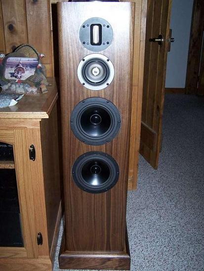

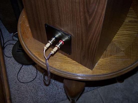

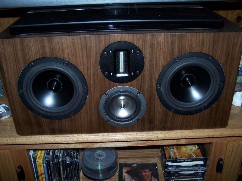

                  Well, I'll toss the Statements in here since they were my last projects.
                  The cabinets were sealed a skim coat of bondo and then with MDF primer (I hated it) and then sanded with many follow up coats of high build automotive primer.Once I got them to the point that "I thought" I had all the imperfections taken care of, I shot 10 coats of Target Finishes gloss black lacquer with a HVLP spray set up.
                  I then let them sit for a week. Next came sanding with 1000, 1500 and finally 2000 grit paper. I buffed them with 3M products from the autoparts store just like they do in the body shop. Lots and lots of work. Plus the materials were extremely expensive.
                  The Mini's in the attached picture were veneeered with paper backed 10 mil red oak veneeer, stained with golden oak, filled with Crystalac pore filler and then top coated with Crystalac clear gloss super Premun finish sprayed with my HVLP setup.
                  The Statements center had the same treatment as the Statements.
Name:	Mini Statements 003 (Large reduced).jpg
Name:	Statements center cropped 001 (Large).jpg
                  Last edited by theSven; 24 June 2023, 20:03 Saturday. Reason: Update image location

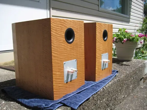

                  • Rolex
                    • 386

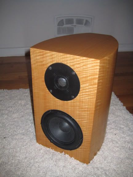

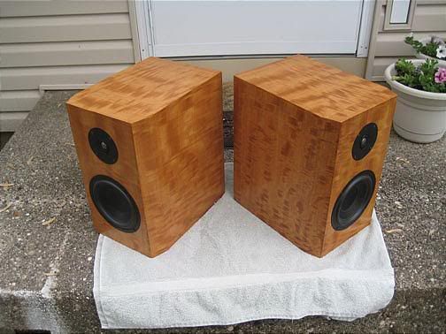

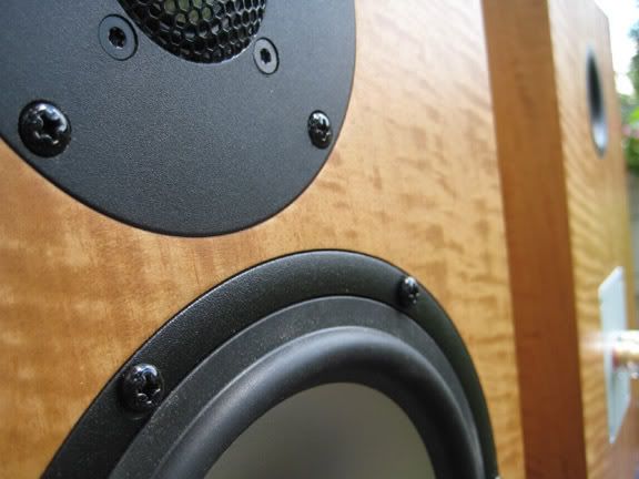

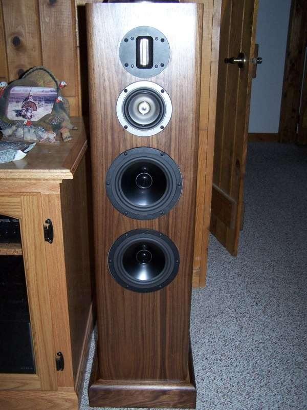

                    I have been using a precatalyzed lacquer over most of my projects, but have recently tried a polyurethane, tung oil, and turpentine mixture that have produced some great results. Not paint for me, I'm a woodworking, so I love using different veneer. The tower is cherry, the stand mounts are curly maple, imbuya, fiddleback anigre, and mottle anigre. THe imbuya pair uses watco danish oil with wax over top.
ID:	942639 Click image for larger version

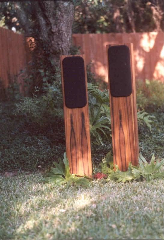

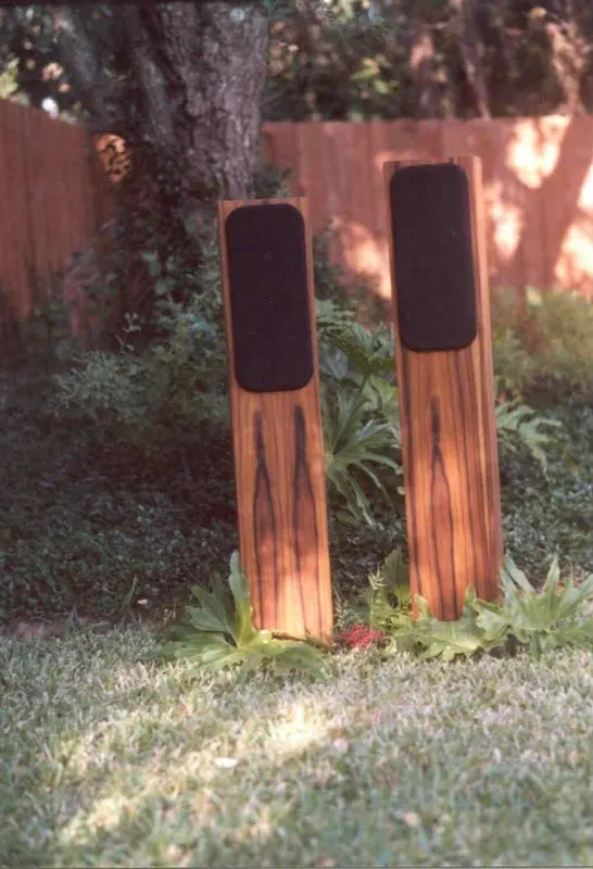

                      I veneer - favorite so far is rosewood. My favorite finish is very labor intensive, but IMO, brings out wood grain beauty like no other finish: hand-rubbed Danish oil finish. Before and after finishing:
                      Last edited by theSven; 24 June 2023, 20:06 Saturday. Reason: Update image location

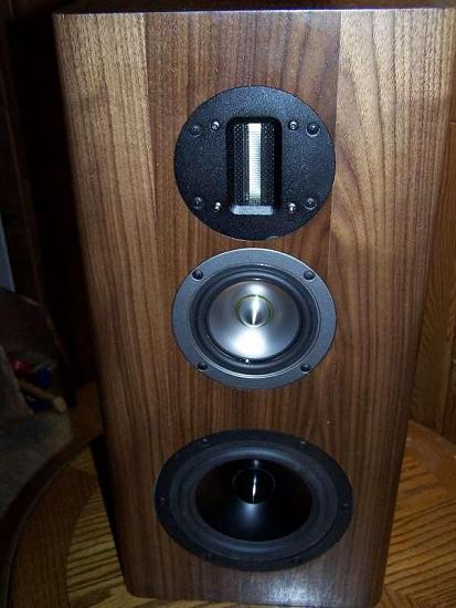

                      • Amphiprion
                        • 886
                        Too embarrassed to highlight the bowties, eh Hank?

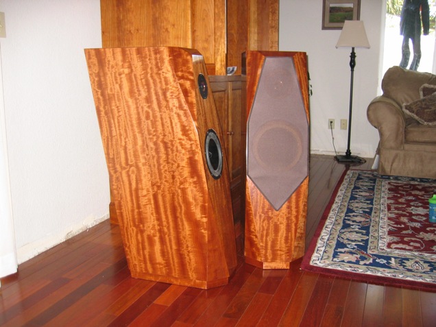

                        • kvardas
                          • 125

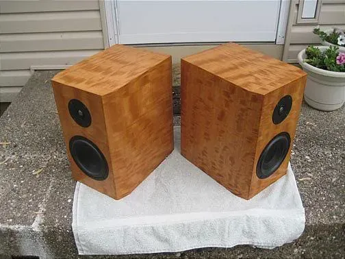

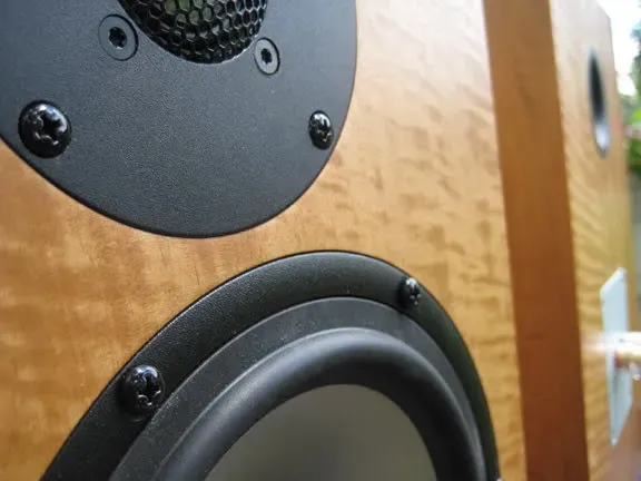

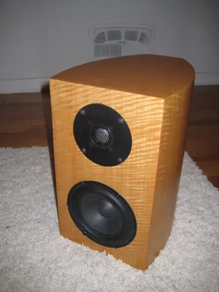

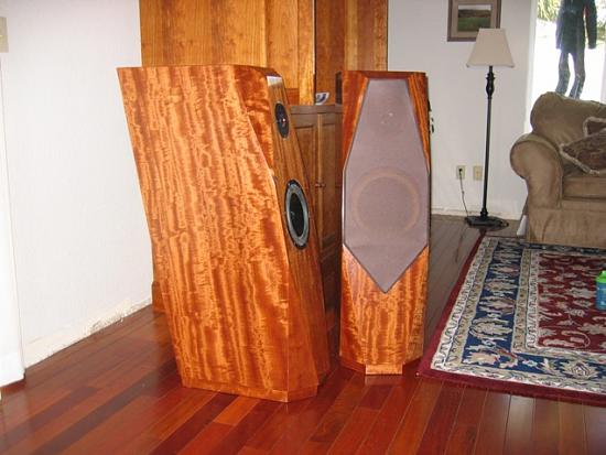

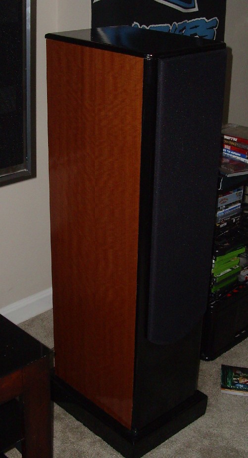

                          Mottled Makore Veneer
                          Five coats of Semi-gloass General finishes followed by two coats of tung oil/boiled linseed/beeswax home-made paste wax buffed with 0000 steel wool.

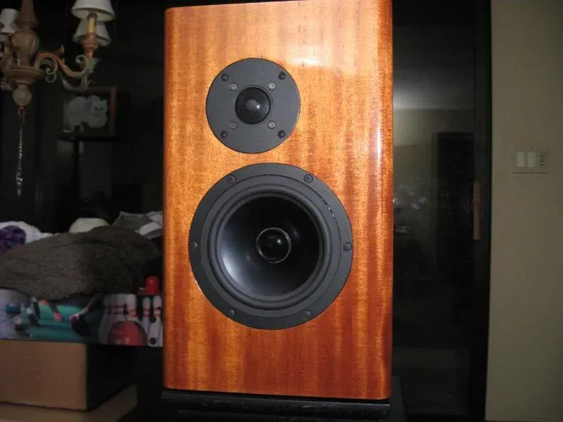

                            • JonP
                              • 692

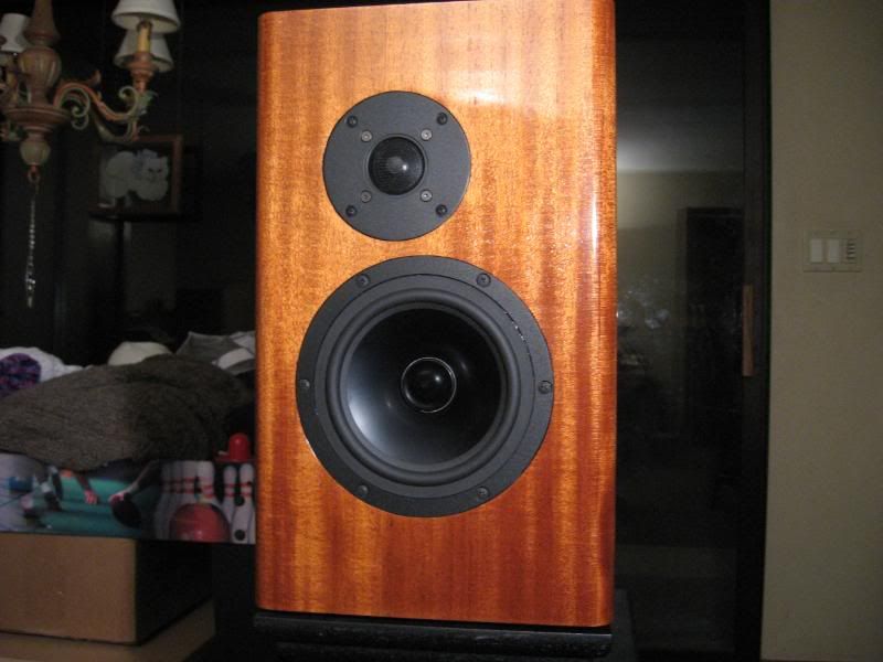

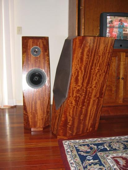

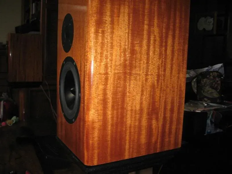

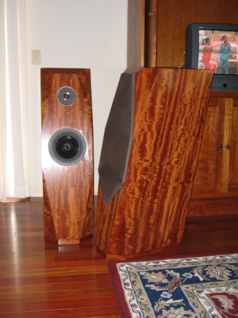

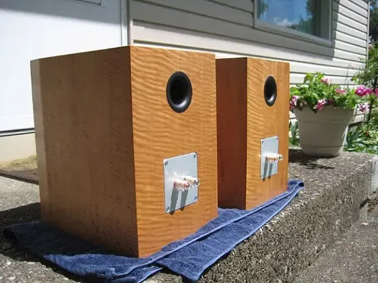

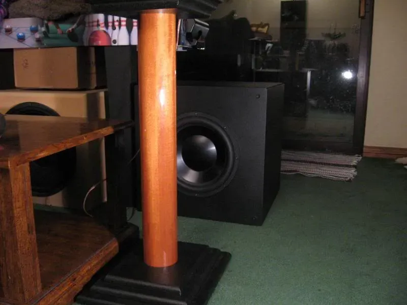

                              I should have better pics of these, but here's the Modula MT's I built a while back...
                              African Mahogany veneer, nothin' but Shellac. Made for a deep and glowing finish, but is somewhat easy to ding.
                              Zinnser's Seal Coat shellac, thinned to 1lb cut for a few coats. Somewhere in between Blond and Amber, it darkened the Mahogany nicely after a few coats, so I kept going.
                              More and more (and more and more) coats of uncut Seal Coat for final finish.
                              Used a scraper to help level high spots while building thickness, worked pretty good! Scrapers Rule!!
                              Wet sanded with a block, between later coats with (equiv of) 320 Micro Mesh cloth. (highly recommended!)
                              Then sanding up the Micro Mesh grades, thru 12000. (equiv of 2-3000 grit)

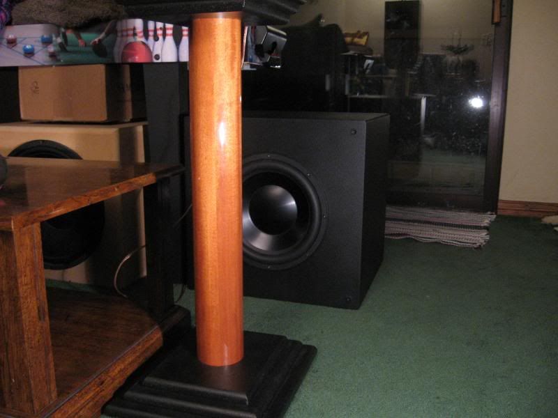

                              Pic of veneered 3" PVC stand
                                  Mark, the before/after towers were my A/V-3's that I gave to my daughter and son-in-law for their wedding present (their request). The towers with what you call the "bow tie" looking base are my current towers. It's funny that only you and Jonathan don't like their looks - I get compliments from other people re the orginality (or maybe they're just being polite?).

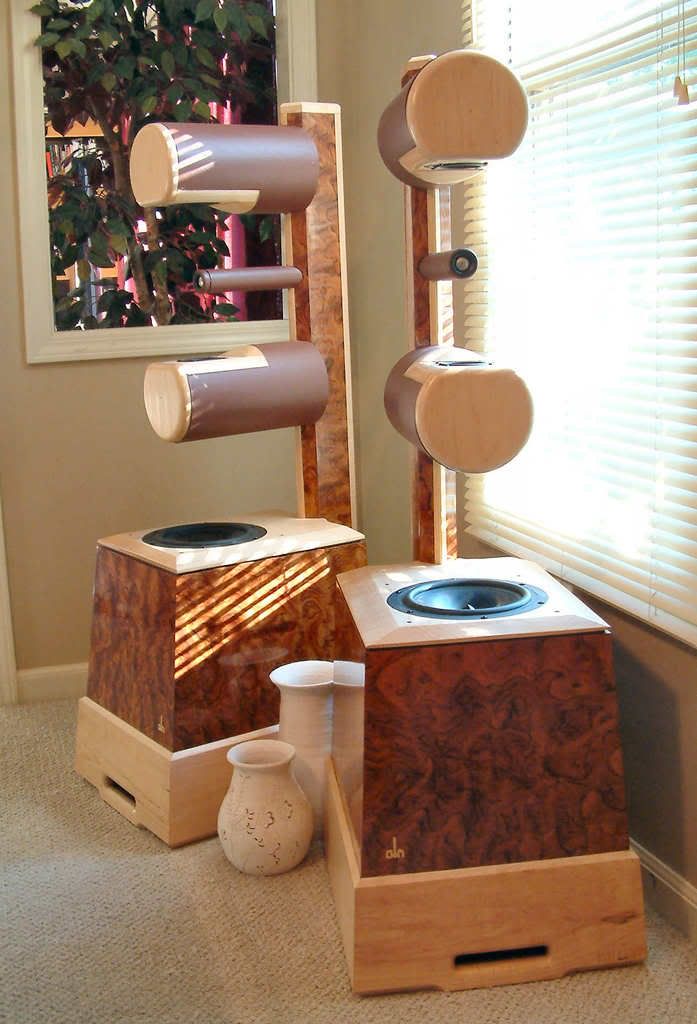

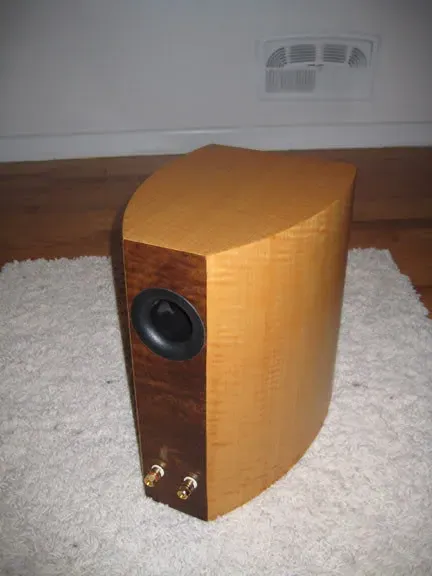

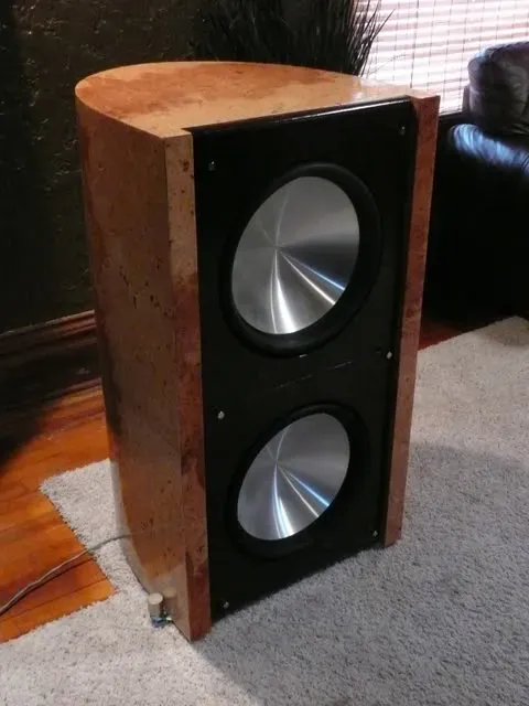

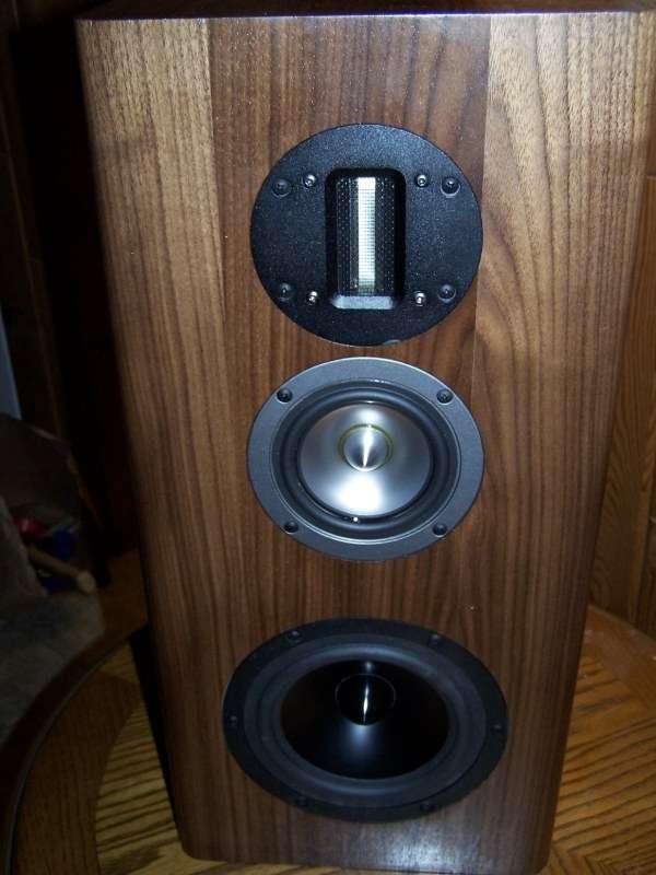

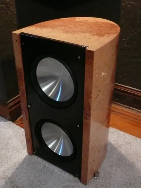

                                    Cabinet: Maple Burl Veneer - Applied using Heatlock, Sanded very smooth.
                                    No stain on main cabinet. Just clear coat. Watco Clear Gloss Brushing Laquer.
                                    Around 20 coats. Sanded lightly between each coat with 600 sand paper, then cleaned thoroughly with tack cloth.
                                    Front Baffle: Stained with Varathane Cabornet. Clear coated w/ same laquer.
                                    Sprayed with 8 coats.
                                    Last edited by theSven; 24 June 2023, 20:11 Saturday. Reason: Update image location

                                      • JonP
                                        • 692
                                        Originally posted by cobblepots
                                        That stand is incredible! Was it difficult to glue the veneer to it? What glue did you use? Paper backed veneer? How did you deal with the seam? Sorryy for all the questions but once you get excited... I definitely would like to do something along the same lines with my statement monitor stands. I'm covering all my speakers and sub in a mottled Makore. It'll cost me a bit but it'll be worth it. Hopefully I'll be able to do the grain justice. Everyone's finishes look fantastic!
                                        Yep, it was the same paper backed Mahogany as the boxes, thought it might be a nice touch to have the wood match. And, black truckbed liner paint on the rest of the stands to key with the black drivers... I like how it turned out.
                                        I used the Titebond yellow glue iron on method for the boxes, and for the posts I had my first experience with contact cement. Had a few lumps from painting on the cement, you CAN'T go back and rebrush if it's started to dry, and it starts in a minute or so... I almost had a real problem. Still had a few bumps under the surface. I did an overlap glue and cut as described in Lou C's website (lonesaguro.com?) and it worked pretty invisibly. The seam did seem (heh) to migrate apart during the many shellac coats, but not badly.
                                        Kind of like a stocking with a seam.. I put them on the back sides.

                                          Very nice work from all! Here are my SoundRounds. SoundRounds
                                          Satin Poly finish on the solid Maple parts
                                          Old Masters High Gloss poly over Zinsers Sealcoat
                                          on the Waterfall Bubinga veneer
                                          Limewash on the PVC tubes covered by egshell latex paint
                                          Last edited by theSven; 24 June 2023, 20:13 Saturday. Reason: Update image location and htguide url
                                                  Is that a raw veneer? If so I would expect a seam at the back? How did that turn out with Heatlock?

                                                        Thank you. This has been a long project that finally came to an end. I used the Trans Lamination technique, So the finish you see is the natural look of the ply. I used sanding sealer which brought out all the grains of the wood, then I used wipe on water based poly, with cotton rags. The stands are also trans lam, composed of 3" disks piled on top of each other using a 3/8" threaded rod. The bases are also cut using a CNC router. You can see a log of my work on the speakers if you do a search for translam. I think from now on, Im just going to stick to wipe on Poly. I also like to use BB plywood, which is both good material and has a good finish already.

                                                          Here is an old one of mine, matching veneer and solid wood is not as easy as I thought it would be.
Name:	Finished Port Valve Open.jpg
                                                          Last edited by theSven; 24 June 2023, 20:15 Saturday. Reason: Update image location

                                                            • Rolex
                                                              • 386
                                                              Here is my latest. A re-veneer of an older project.
ID:	942655 Click image for larger version
                                                              Last edited by theSven; 24 June 2023, 20:16 Saturday. Reason: Update image location
                                                              • David_D
                                                                • 197
                                                                Very Nice Rolex. How do you get your veneer seams so tight so the endgrain doesn't show? I assume it's raw & very thin.
                                                                -David

                                                                    I thought I would throw a couple more pictures on this thread. I recently completed the Zaph SR71 speakers. I did another stacked lamination. This time the cabinet was quite a bit bigger to meet the approximately .5 cu ft of volume this design calls for. The veneer is more block mottle anigre because I like it, and it's what I had laying around. It has a very light oil based stain to help bring out the grain just a little before applying precatalyzed lacquer with an airless spray.
                                                                    Last edited by theSven; 24 June 2023, 21:04 Saturday. Reason: Update image location
                                                                    • lunchmoney
                                                                      • Jul 2008
                                                                      • 152
                                                                      Painted Tritrix's...
                                                                      Last edited by theSven; 24 June 2023, 21:03 Saturday. Reason: Update image location

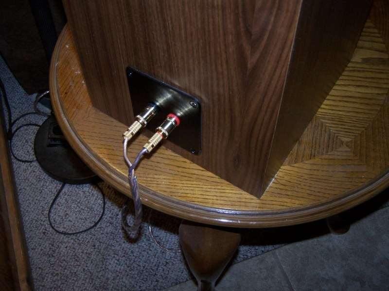

                                                                              • flamethrower1
                                                                                • 392
                                                                                statements
                                                                                statements, black walnut and hand rubbed danish oil
                                                                                Last edited by theSven; 24 June 2023, 21:35 Saturday. Reason: Update image location

                                                                                        • cobblepots
                                                                                          • 102
                                                                                          Mini Statements. Black lacquer for the top, fronts, and bottom. Mottled Makore for the sides with 3 coats of tung oil and 3 coats of brushed on poly. The poly and tung oil were lightly sanded between coats with 0000 steel wool.
