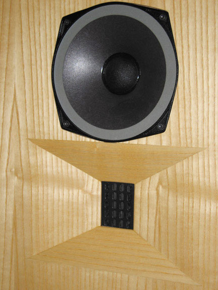

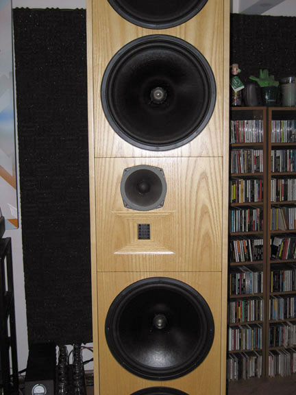

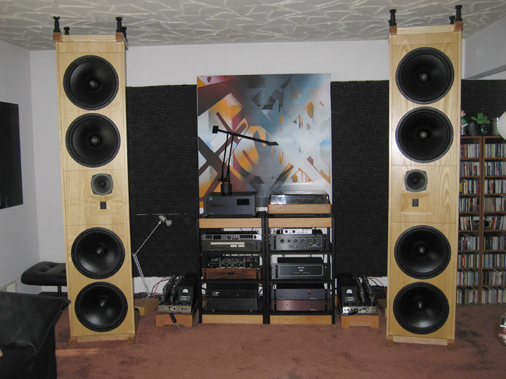

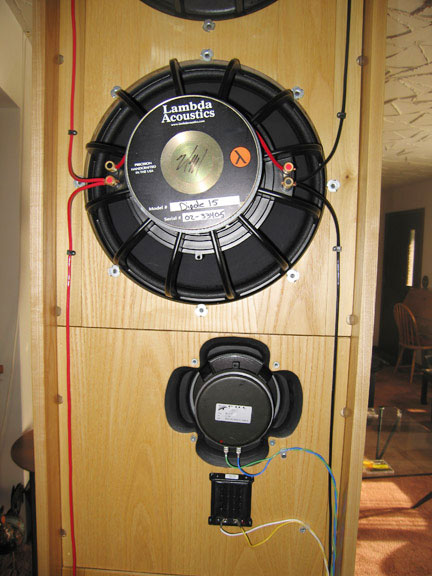

            Beautiful work here! ;x(
            Here's my last project, named "The Wall" when my wife came into my workshop and asked "What are you building, a Wall?
            Solid and veneer ash finished with wipe on poly. Veneer was self adhesive kind from Rockler.

              Both the stand and the speaker look awesome :T
              I like how you snuck the wii sensor bar in there too
              -Chuck

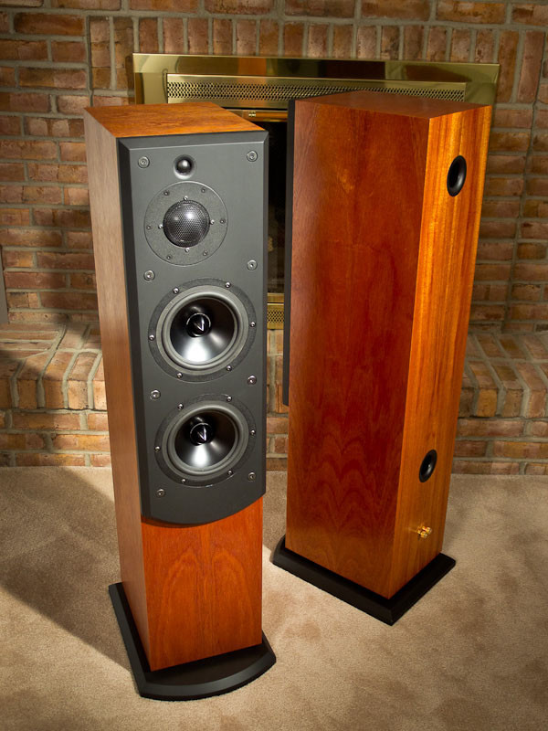

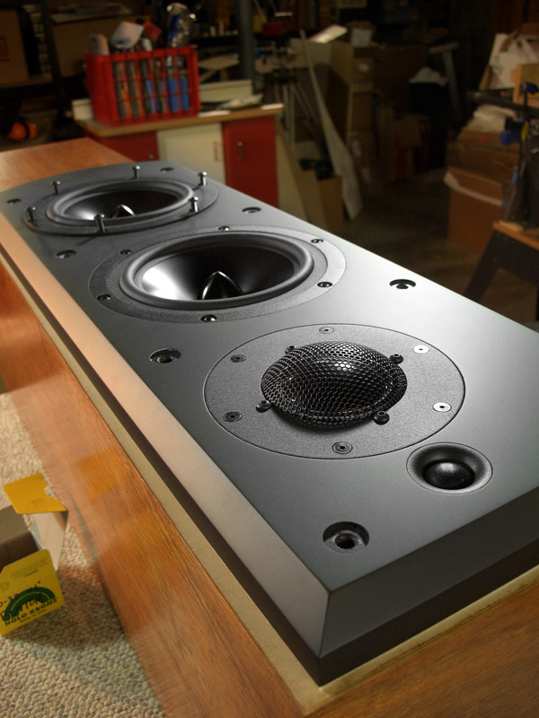

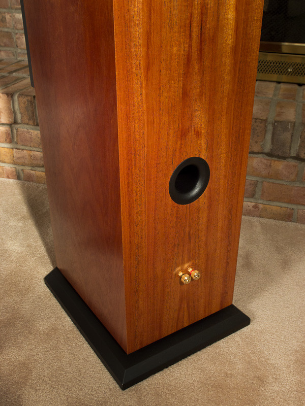

                                After a couple years' worth of procrastination, I finally finished my build of Zaph ZDT 3.5s.
                                I used mahogany paper-backed veneer.
                                The finish was about 5-6 coats of Watco Danish Oil applied over a two-week period. I'd wipe on a coat using pieces of old T-shirts, wait an hour, and wipe off the excess. A couple of times, I used white 3-M fine abrasive pads to rub the oil in.
                                After waiting about a week after the last coat, I used some #0000 steel wool to rub in some Johnson's Paste Wax, then buffed it off after a few minutes dry time.
                                The baffles were painted using General Finishes Lamp Black milk paint. It's partway between matte and glossy, but probably a little closer to matte. I used a small detail spray gun and compressor to apply this water based paint. Baffle prep consisted of Zinsser Seal Coat (shellac) and some automotive spot putty, then shellaced/sanded again before painting.

                                Build log here, in case someone wants more detail...
                                [build log]

                                  Bill - Those turned out very nice. Those driver cut outs are spot on. Great job! Curious how you've been liking the sound, especially the RS52's.

                                    Bill, beautiful work!
                                    • Ray Collins
                                      • 257
                                      #108
                                      Outstanding!
                                      Doc
                                      BENJAMIN FRANKLIN
                                        • 3815
                                        #109
                                        Awesome work, very precise! I love how the baffles are removable (excuse my ignorance if that's simply part of the original design).
