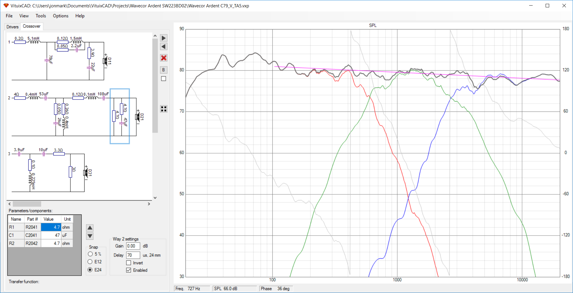

                                    Update for BD02 woofers
                                    As posted in Bob Ellis's thread:
                                    This is basically the TA5 (test article 5) release with modified resistors (the RIGHT resistors modified the RIGHT way; they interact differently with the network as some of you have discovered)
                                    However, the value for L1/L1011 (as numbered by VituixCAD) is suggested to be changed from 5.6 mH to 5.1 or 5.0; if you already have a 5.6, use as is (just slightly flatter with the different value) OR if you have an LCR meter unwind your inductor to that value. seriously, just how you have them setup in your room will make more difference in the lower midrange than this.. but this would be the optimum for the BD02.
                                    With regards to the tweeter, two points:
                                    • Using the new values, and if you should want to raise or lower the overall trebel level, do it by adjusting the shunt resistor R6/R3051 or better yet, use the voicing filter (or use the Force, Luke!)
                                    • Second, the dip in the response around 4 kHz is due to a cabinet diffraction effect which goes away as you get slightly off axis - it's not something to fix in the crossover, the power response being radiated by the tweeter is quite steady. You'll also see less of this effect with the grilles and recommended felt diffraction contol in place, but these are from bare cabinet measurements.
                                    Last edited by theSven; 24 May 2023, 16:37 Wednesday. Reason: Update image location

                                      Thanks Jon for updating the crossover for the Wavecor BD02 woofers! When you have time, would it be possible to post a full schematic of the BD02 crossover similar to the first post? I'm going to start working on the crossover BOM for my build and I want to make sure I'm using the correct updated resistors and inductor before I order anything.
                                        #199
                                        Horio, you can take a look at my thread for a BOM. It's missing the 10 uF Clarity MR because I bought it a while back.
                                        In the tweeter circuit in using two 1R5s to make the 3R and a single 3R3. You could use 4 pieces of 3R3 in series/parallel to reduce heating effects.
                                        In the midrange circuit it's a pair of 8R2 in the 4R spot, 2.5% high. The 4R7s are made using 10R, 6% high. You could get closer using a 10 and an 8R2 in parallel but that's on the low side by 4%.
                                        In the woofer circuit Jon had suggested 4 Mills 12W 16R in parallel. The closest available in 15, which results in 4% low. I chose 5 parallel 20R, 2.5% high keeping with Jon's err on the high side philosophy.
                                        Hope this helps

                                          Thanks Bob, your BOM was very helpful. Studying the original BD01 schematic and the updated one Jon posted above, I think I now understand the changes between the two. I'm going to take a swing at marking up the changes on the full schematic, and maybe I'll post it here for comment and reference.

                                                      SW223BD02 Crossover
                                                      Here's version two of the crossover using the Wavecor SW223BD02 woofers with updated resistor values and capacitors. Capacitors in series in the mid-range changed to Obbligato per Jon's recommendation.
                                                        #207
                                                        R5 target is 3R9, you can get closer with 5 Mills 20R in parallel at about the same cost as a pair of Mundorfs.
                                                        R2 and R4 are 4R7 target - a pair of 10R is closer.
                                                        R6 could be drawn as a pair of 1R5s in series unless you know a source for 3R 20W resistors.
                                                        • Renron
                                                          • 751
                                                          #208
                                                          R2 / R4 are mis matched, one of them is going to do almost all the resistance work and the other will be loafing.......... One will get hot(er) than the other.
                                                          R's in // should be the same value
                                                          Yeah, what Bob said.

                                                            Updated SW223BD02 crossover diagram above (post #206) per everyone's recommendations.
                                                              #210
                                                              The group think has some "clarity" in this case... you appear to be well on the way to a successful build, though we won't be convinced until we see sawdust and it's byproducts...

                                                                C3 A and B are a waste of $$$ to use Superior Z in this location, use something less expensive for shunts, Cross Cap or similar price.
                                                                Personally, I'd change C6A to a Superior Z to break up the sound monopoly of the Obbligatos. They each add a different flavor the the sauce.

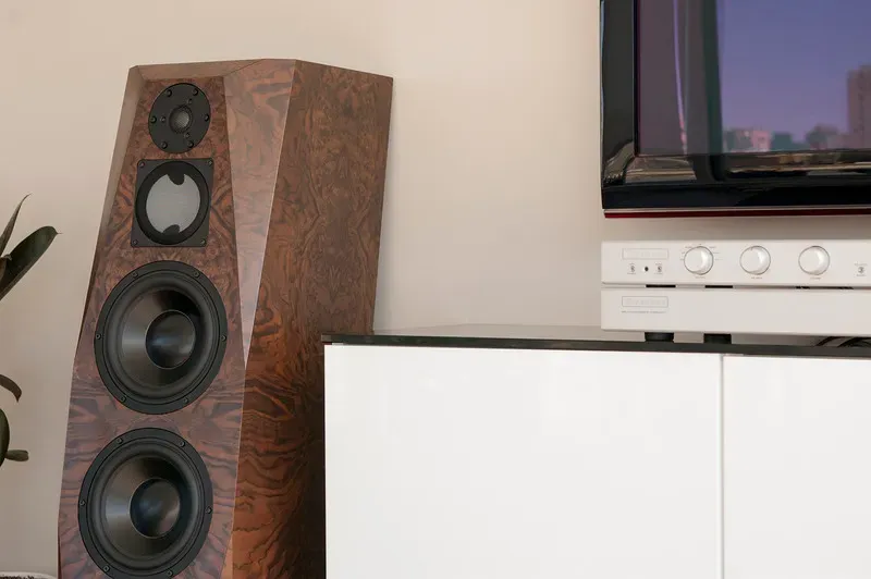

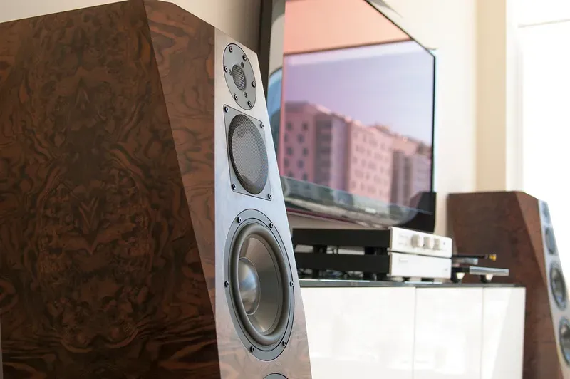

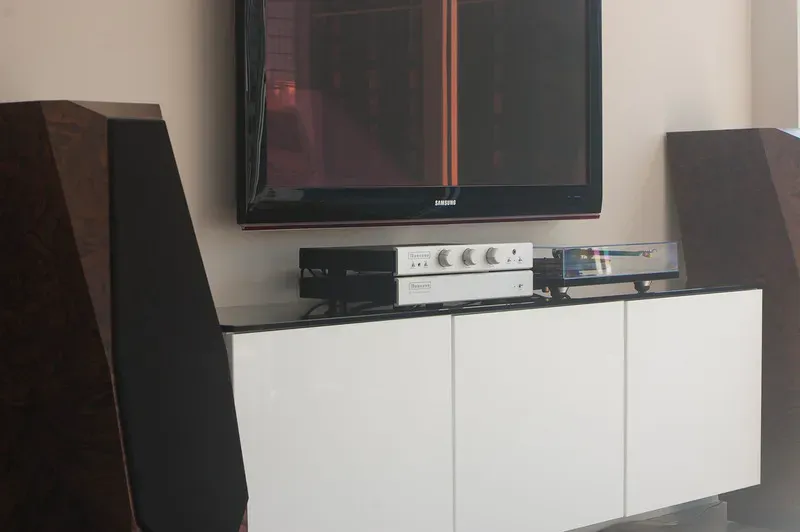

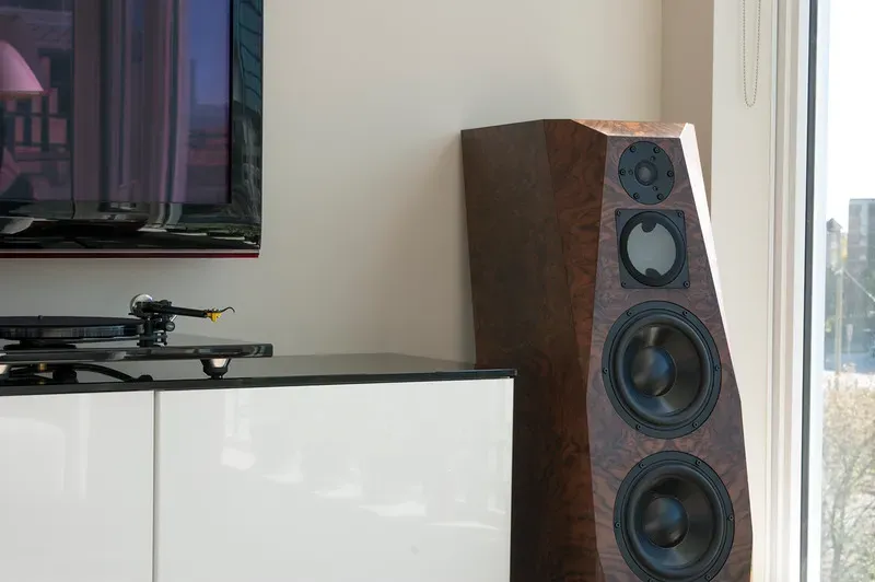

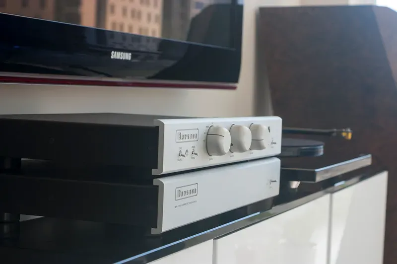

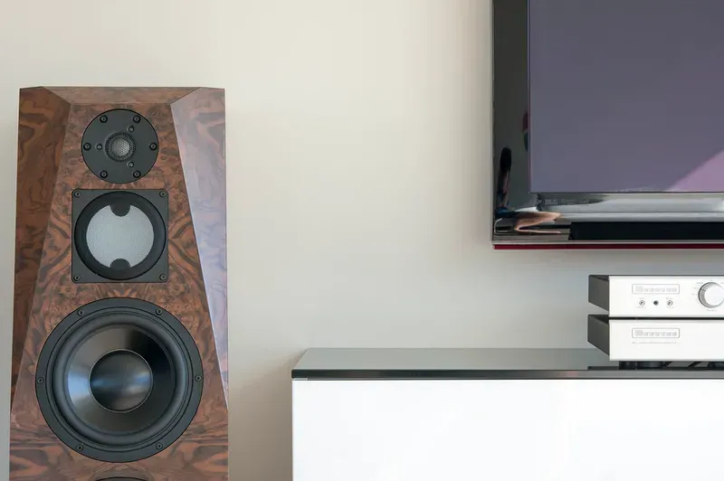

                                                                        I'm a little late (two or so years?) to show off the final pictures but we just moved into our new place and have a lot more light.
                                                                        The new media stand is based off this unit. I used Ikea kitchen cabinets and had 12mm back painted glass cut. Saved quite a bit going the DIY route.
                                                                        Anyways the pictures!

                                                                          #216
                                                                          Very nice Ben ...... is it floating like in the link you attached?
                                                                            • 16091
                                                                            #217
                                                                            Looks very classy, Ben! Clean and elegant! :T
                                                                            • benthe8track
                                                                              • 371
                                                                              #218
                                                                              Thanks Steve. You bet, these are top cabinets technically and they hang from a single rail mounted to the wall. The only thing I may add is a computer fan in the centre compartment. I put my hypex guts inside a ghent case (my stainless case wouldn't fit) and it gets really hot in there.
                                                                              Thanks Jon! I'm pretty happy with how it all eventually turned out.
                                                                                • 1671
                                                                                #219
                                                                                Holy shit Ben! I had forgot how butiful you had got that veneer.
                                                                                You used paper backed veneer? How did you get the edges that good? Seems to me as if you have got those edges just as good as with raw veneer. I have always got some of the paper edges showing trough a little bit when using paper backed veneer. And what finish did you apply?
                                                                                Oh yeah, very nice bench as well!
                                                                                PS: missing a picture capturing the whole setup at once :-)
                                                                                • benthe8track
                                                                                  • 371
                                                                                  #220
                                                                                  Thanks Tek! You bet it's paper/PSA backed veneer. The incident angle (for a lack of a better term) of the front surfaces kind of naturally hides the paper/glue lines. The finish is industrial conversion varnish that were sprayed at a cabinet shop. They guy who sprayed them also used one of those brown touch up markers (crayons?) under the coating. It worked really well. The only place you can see paper/PSA is on the back. I think that's also a function of the raw veneer on the back being thinner than the PSA veneer. I don't have a wide enough lens to get it all in one shot, hence all the angled pics!
                                                                                  • scottvalentin
                                                                                    • May 2015
                                                                                    • 175
                                                                                    #221
                                                                                    Those are looking great and fantastic job on the TV stand - great use of IKEA cabinets!
                                                                                    Are you hosting Ardent listening parties yet?

                                                                                      #222
                                                                                      Ben that is a fantastic looking setup you have, Walnut looks perfect too.
                                                                                      Great idea with modifying the IKEA cabinets. May have to steal that idea..uhhum borrow that idea.

                                                                                          Click image for larger version  Name:	DSC_6061_zpsaute1nfe.webp Views:	0 Size:	18.6 KB ID:	937453
                                                                                          Click image for larger version  Name:	DSC_6064_zpsfkpfv8yw.webp Views:	0 Size:	21.7 KB ID:	937454
                                                                                          Someday, just for fun, try pulling these out away from the wall and use a Cardas style setup (math described in a note on their web site).
                                                                                            #225
                                                                                            gorgeous
                                                                                            absolutely gorgeous!
                                                                                            details on the TT & phono-pre, please.....
