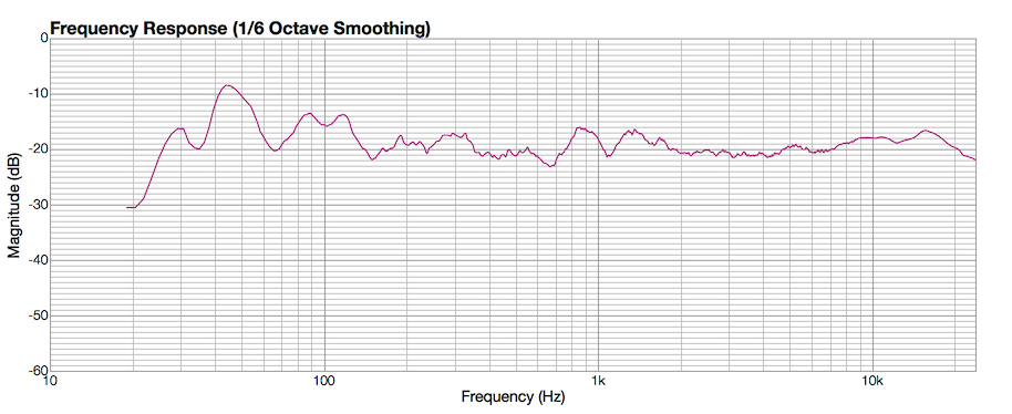

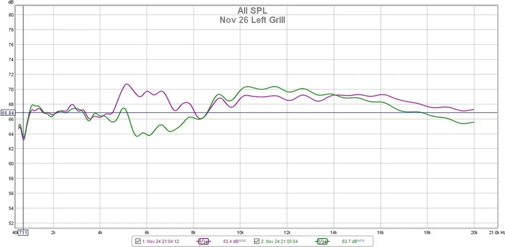

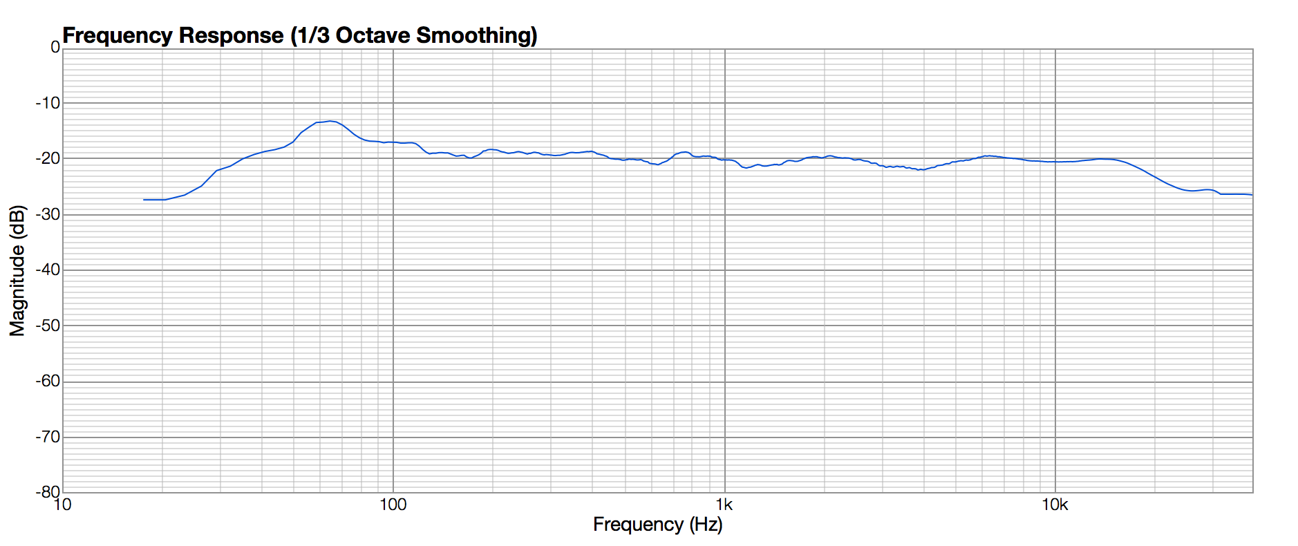

                                  I think I got some better measurements of my speaks in there permanent place at 1m, 3.4ms gating, grills off and on with my felt sanded bevel facing out. Left speak grill with felt in is the green, purple no grill.
Name:	Nov 26 Lrft Grill_1.webp
                                  Right speak no grill Blue. I Like what the felt does in the 4 to 8k range with no penalty up top 16k+ as it's pretty much the same with grill no felt up there.
                                  I guess I could tweak the padding for 2db but it's not bad to just take grills off if your wanting a little more tweet.

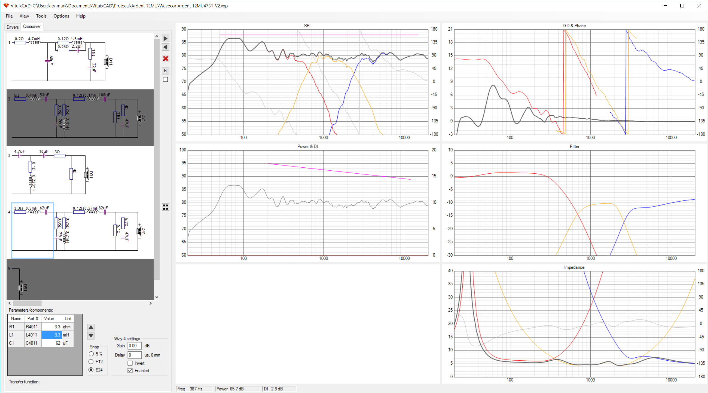

                                                                        Ron, BTW, been simulating the 12MU build a little more, a tweak to the LF crossover first inductor- not a big one. 5.6mH to 4.7mH; keeping the original 78uF to ground, I'd go as low as 4.3mH; that can be done by unwinding the inductor; can provide details later about how many turns. Wait until I've really checked all this out- will be fairly soon. I'm going to be doing some correlation testing soon- still, where are you on your component buys?

                                                                            Things went well yesterday, I feel better today than the day following the procedure in Germany, and no pain killers, either.
                                                                            I have test parts already on order, so it's my intent to give more feedback on this ASAP, maybe by next weekend. Good that you have an inductance meter of some sort around- that makes things more reliable.
                                                                            Note that in some subsequent re-evaluation for the base design I've gone as low as 4 mH on that inductor, LF impedance dips a little more (but not below 4 ohms- around 5 ohms). I may play with that some more today, since I'm officially off work also (other than a conference call with my boss...)

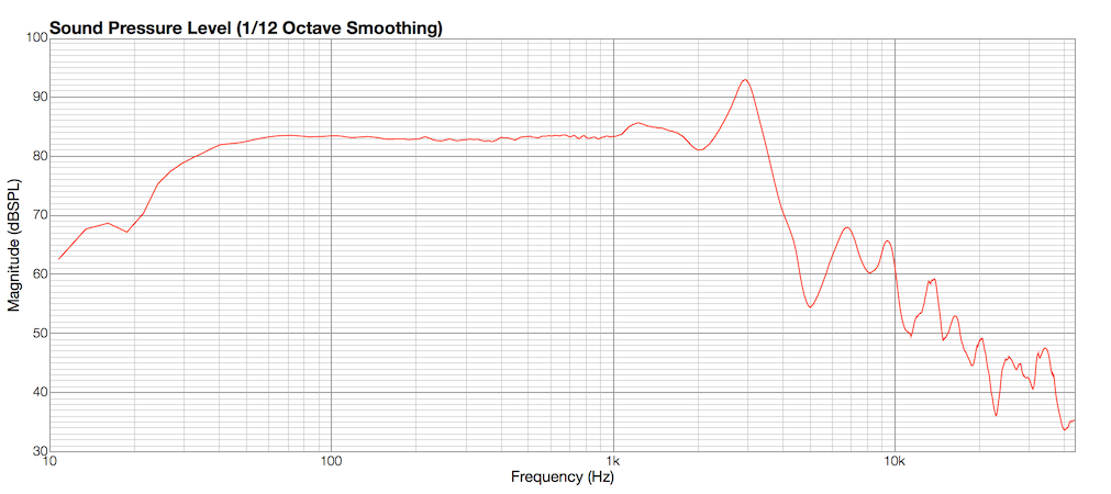

                                                                                          As to what the SW223BD0X drivers look like close up without room stuff, here's an on axis example-

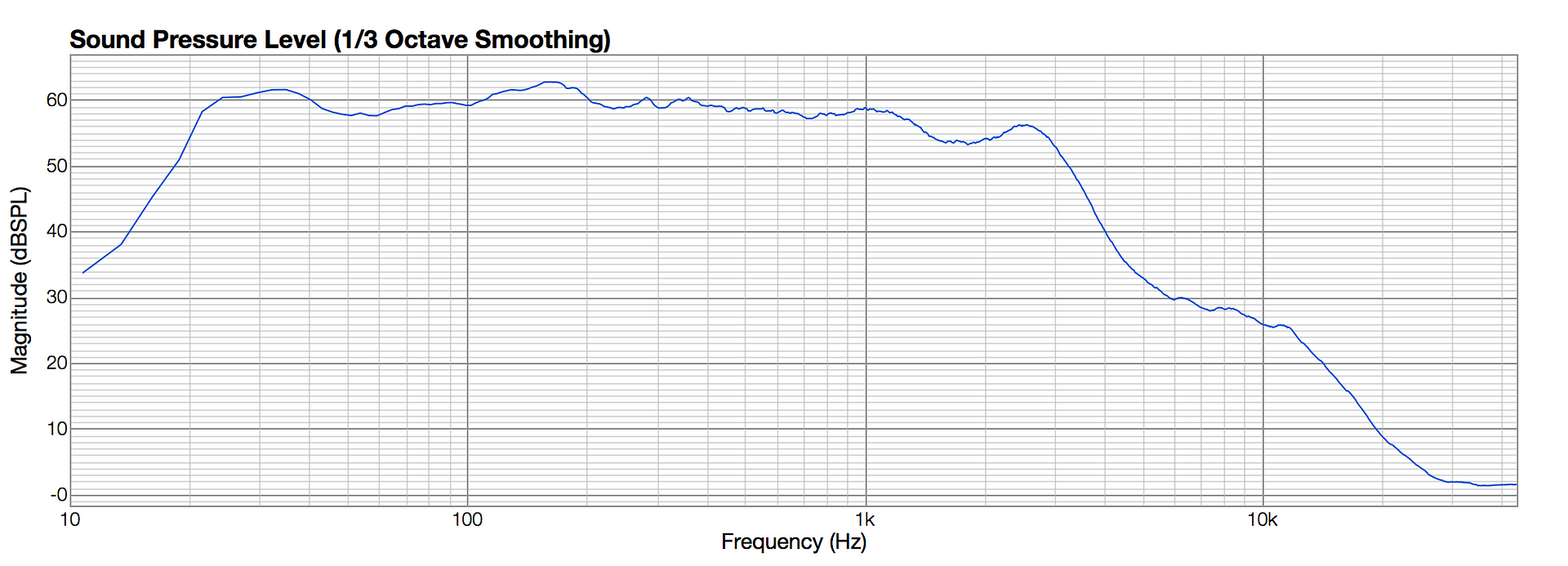

                                                                                          And here's off axis with a PR, measured way off to the side, so the breakup mode isn't very prominent, but the PR contribution is more evident:

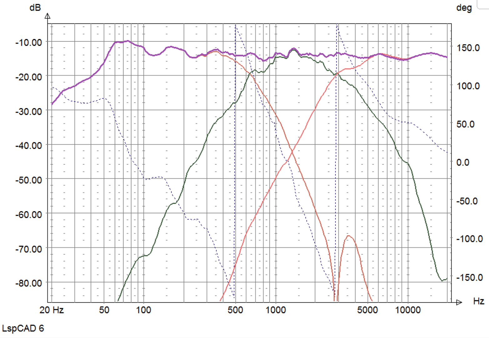

                                                                                          The nominal crossover points for the Ardent are illustrated in the LspCAD simulation:
                                                                                          (about 650Hz and 3 kHz)
                                                                                          And I can show you other in room measurements taken during development which don't have the dip at 50 Hz because they have a peak!
                                                                                          The surest way to eliminate those kinds of issues are to build the speaker into a wall or the junction of wall and ceiling, and design it for that location- haven't seen that go over very big with the ladies.
                                                                                          Or, add a rear firing woofer and some DSP and convert the radiation pattern from an OMNI at low frequencies to a cardiod. this is also a good argument for more placement flexility to use a wall boundary loaded sub, and crossover around 50-60 Hz.
                                                                                          Last, here's a measurement of the Isiris in the same room after I'd disrupted the couch and speaker positions and set things up as "right" as I could prior to a visit by my friend from Munich (the one with the Savoy's now)
                                                                                          GF won't let me leave the family room setup that way, unfortunately... :W

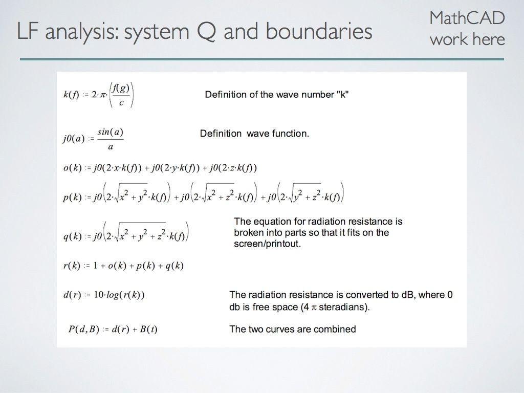

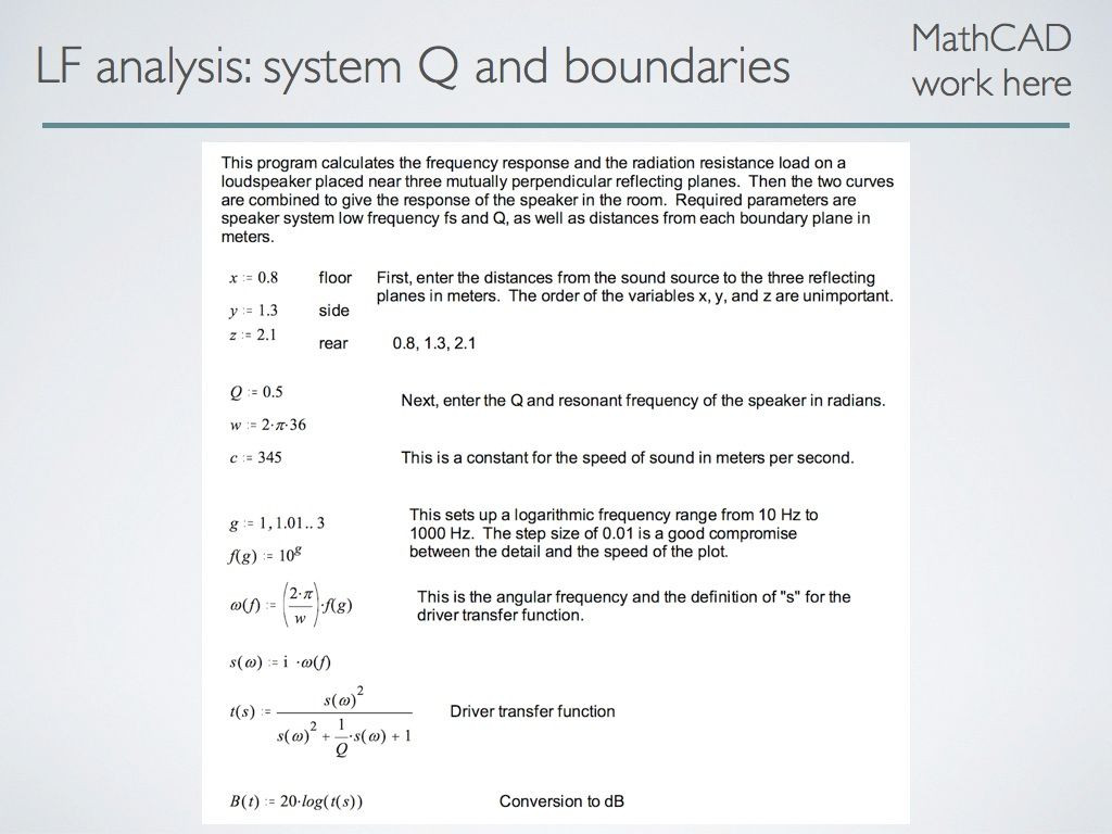

                                                                                            OK, since your friend is an engineer, here's the math....
                                                                                            (BTW, what loudspeaker company does he work for? I'm assuming with the statements he's making he as actual experience designing and testing loudspeakers, including in a home environment?)
                                                                                            (One more BTW, back around 2007 our former moderator and I did a count up of the number of speaker builds I've done since starting in this activity, of course, that includes times when I was actually working for two different pro audio companies and doing this at times as part of my living- at that time, we counted 55 different system designs I've done. Since then I've done a few more, including the Modula MT XE and the other ones lower on that list, and a few I've never published on the board) This doesn't make me any kind of expert, but it does mean I've been down this road quite a few times, and have some skills in the art...
                                                                                            Anyway, MathCAD is a fine little tool for doing this, though it was a better one in some earlier incarnations that allowed you to make a few tricks in defining functions- this was developed back in the 90's, and I still keep an old early version of MathCAD for Windows just for the freedom it allowed in recursive functions.

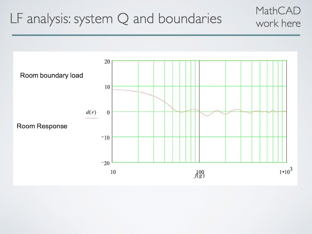

                                                                                            Bottom line, for different sets of boundary distance, you can enter a function that describes the low frequency alignment of the speaker (such as a 2nd order sealed box, Q as defined; 0.707 for Butterworth) and combine that response with the net boundary reinforcement. Hey, I didn't invent this math, go read up on the papers by Roy Allison.
                                                                                            For prettier graphing, the data was output to PRN files, and plotted in Excel...

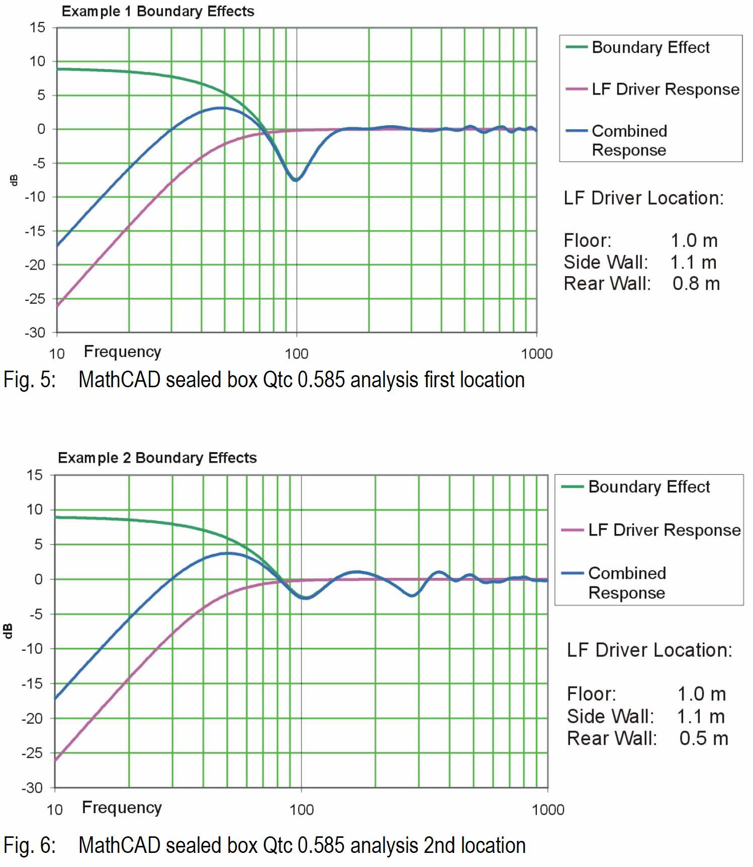

                                                                                            Let's look at some examples from the M8a design paper (long in the tooth, from 2004, but still some nuggets in there).
                                                                                            LF driver plus cabinet transfer function is the magenta curve- then we show the boundary curve (green) and the combined curve (blue)
                                                                                            Two positions- first not at all ideal, with close to the same distances for all three boundary spacing; the second with two dimensions similar (common) and one different:

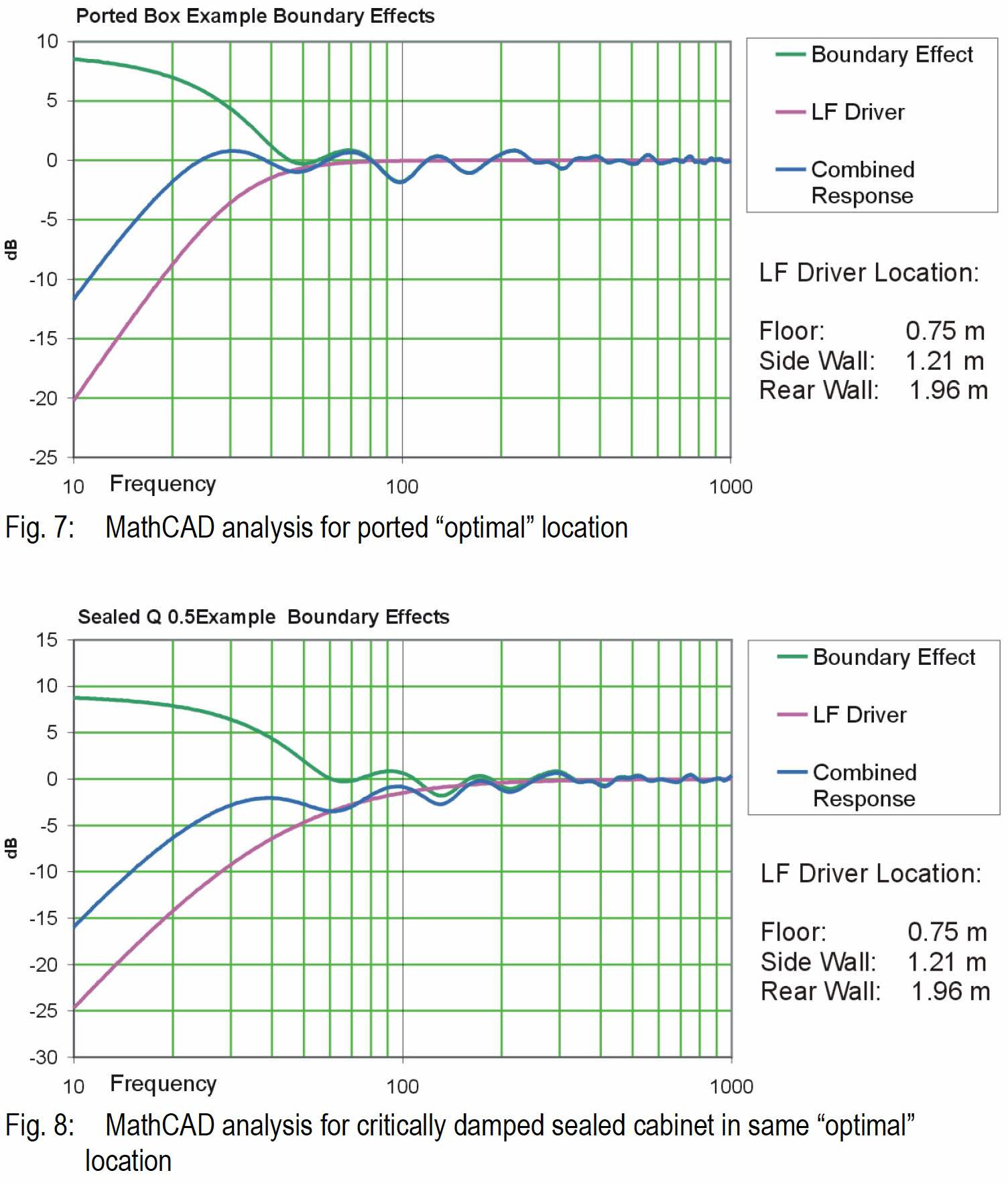

                                                                                            Next, we show a more ideally spaced boundary location set for both a ported example, and in the same location a critically damped sealed box example, (mind you, this is just modeling boundary reinforcement issues- room dimensional modes are another can of worms)

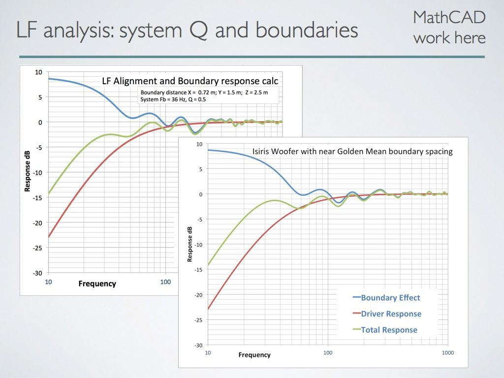

                                                                                            Last, reversing the blue and green colors, here is a notional analysis for the Isiris, big brother to the Ardent.
                                                                                            Now, if you don't space out those boundary distances just so, you have the reinforcement modes stack up, creating both peaks and dips. That was highlighted in the M8a design article.
