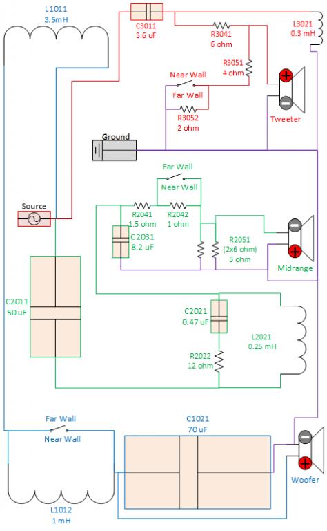

    Crossovers: I've decided to build the switched version of the Monitors as they will play the role of mains until my Statements II are completed. After the Statements II are completed I'll place the Monitors near wall in the rear surround position, hence the need for the switchable crossover.
    For reference, here is Curt's original schematic
    I've attached several images.

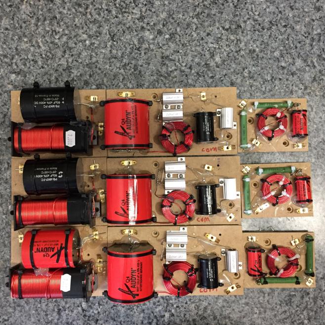

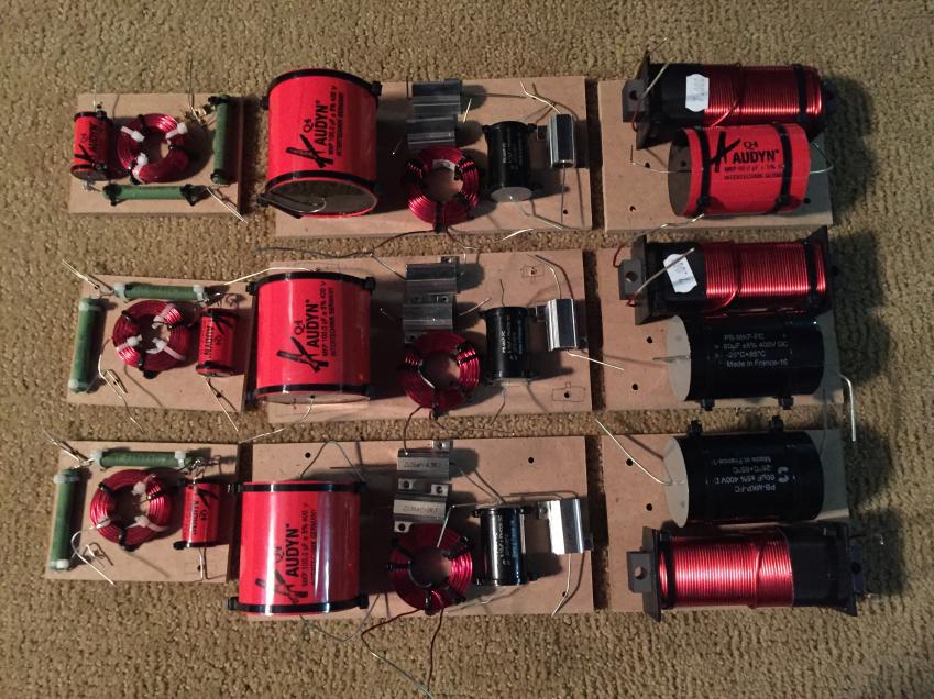

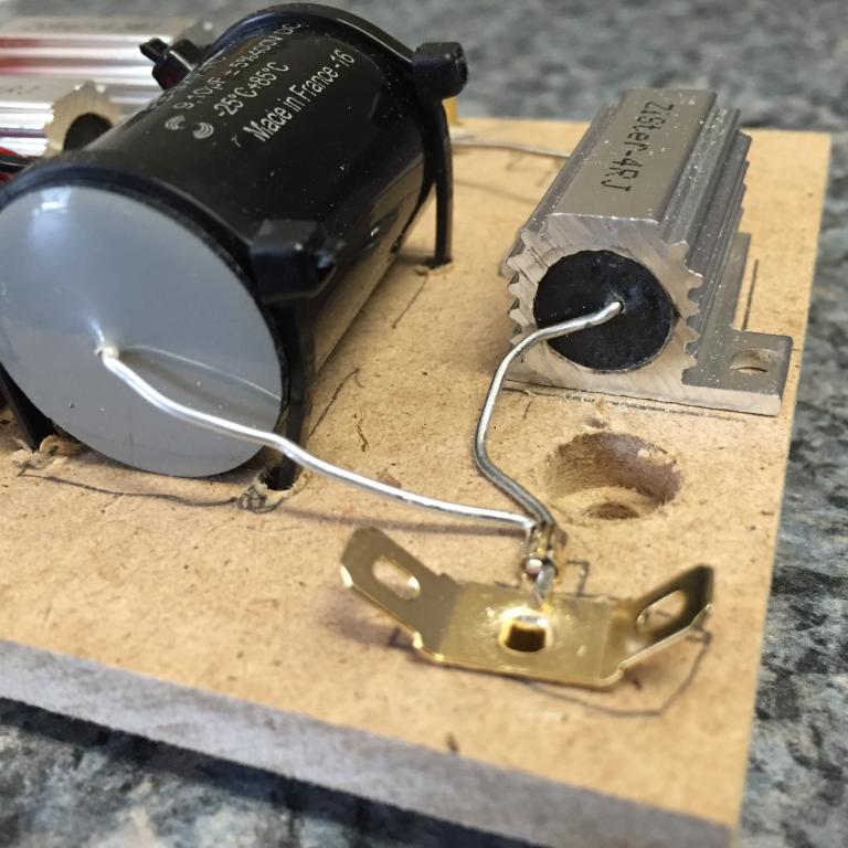

    The first is a diagram I drew up to verify that all of the components would fit on a single board, and determine my wiring path.
    Click image for larger versionName:	Statements Monitor Crossover.jpgViews:	1Size:	40.6 KBID:	872002

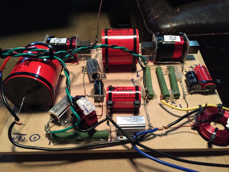

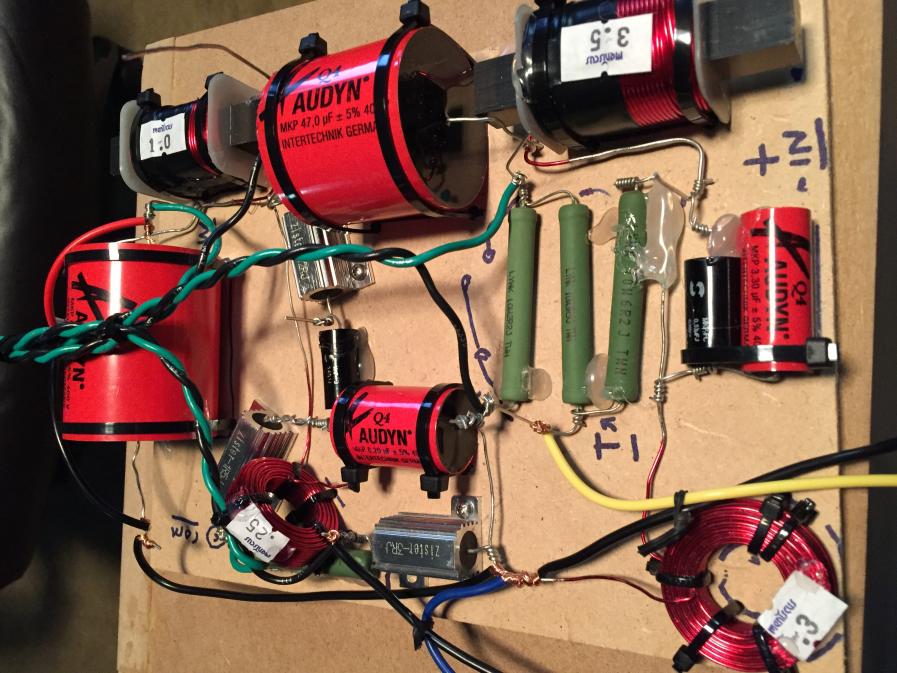

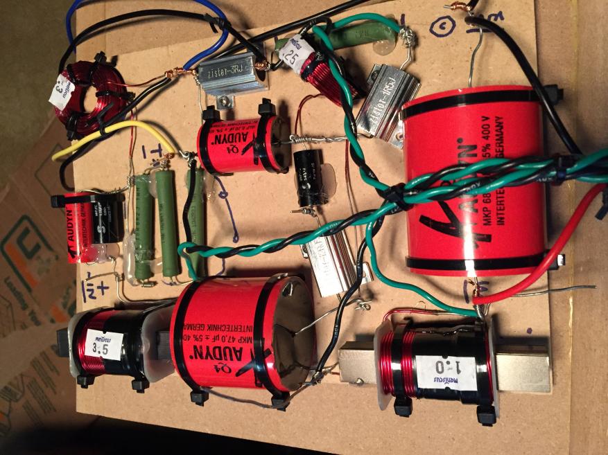

    Here are some phone shots from the crossover, please excuse the image quality.
    • Green and Black twisted wires will route to a 3 pole switch.
    • Yellow and Black wires are for the tweeter
    • Blue and Black wires are for the mid
    • Red and Black wires are for the woofer
    Click image for larger versionName:	IMG_0622[1].jpgViews:	1Size:	106.9 KBID:	872003
    Click image for larger versionName:	IMG_0623[1].jpgViews:	1Size:	107.3 KBID:	872004
    Click image for larger versionName:	IMG_0624[1].jpgViews:	1Size:	104.6 KBID:	872005

    Hi Nate,
    I'm glad to see you are moving forward with your Statements builds. Didn't Curt take a look at this?

      Hi Jim,
      Curt did indeed look over my diagram and a couple initial shots of the crossovers to verify inductor spacing and orientation. I hope to have them completely finished and ready for mounting this weekend. Boxes are mostly complete, need to flush route, sand and cut the foam before gluing on the front baffle.

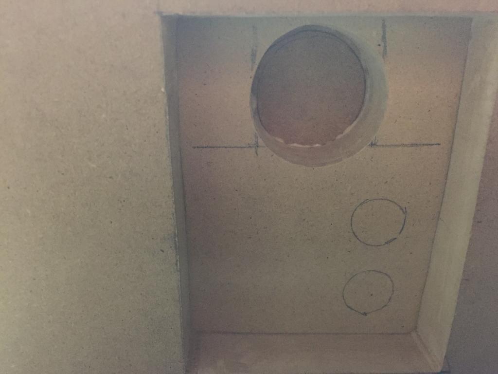

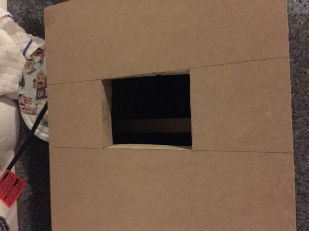

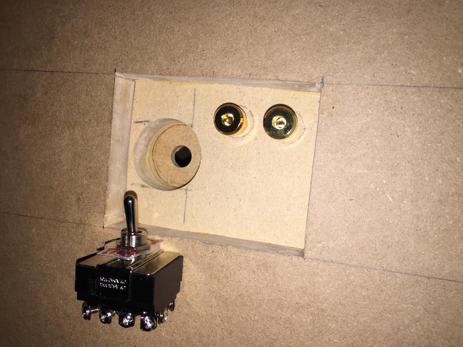

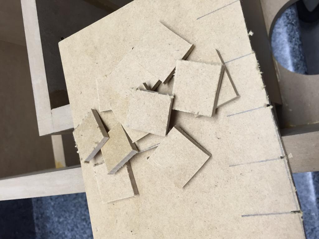

            Melby Audio's flat-pack comes pre-cut for a round terminal plate, but I wanted to use the binding posts I got from the Meniscus kit, so I'm cutting the round hole into a square hole, and I'm going to glue a section of MDF behind the new square hole
            My new square hole!

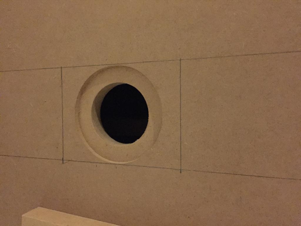

            A piece of MDF glued in place, with a 1 & 1/2" circle cut for where I'll mount the switch and crude markings for where I'll drill pilot holes for the binding posts.
            Back side view of the MDF as well as a backer plate for the switch, made from 3/16" HDF
            Getting close!

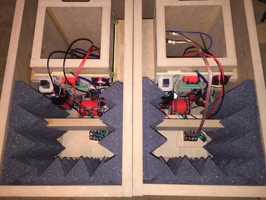

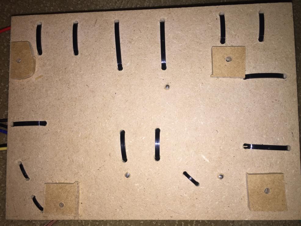

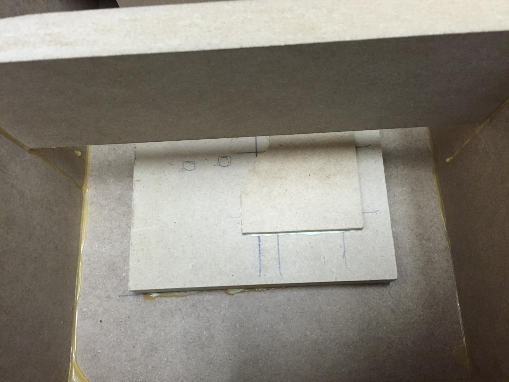

              I wanted to mount the crossovers to the bottom of the mid tunnel, but because I used zip ties, I needed some spacers. I cut these from some 3/16" HDF and drilled pilot holes in them.
              Here I am gluing them to the bottom of the crossovers, strategically placed near the inductors so the screws are as close to them as possible.
              Crossovers mounted, foam glued in place, wires for tweeter and mid also hot glued in place

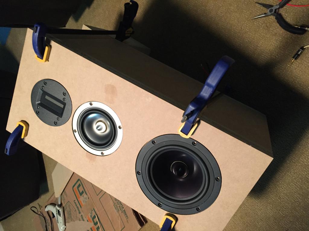

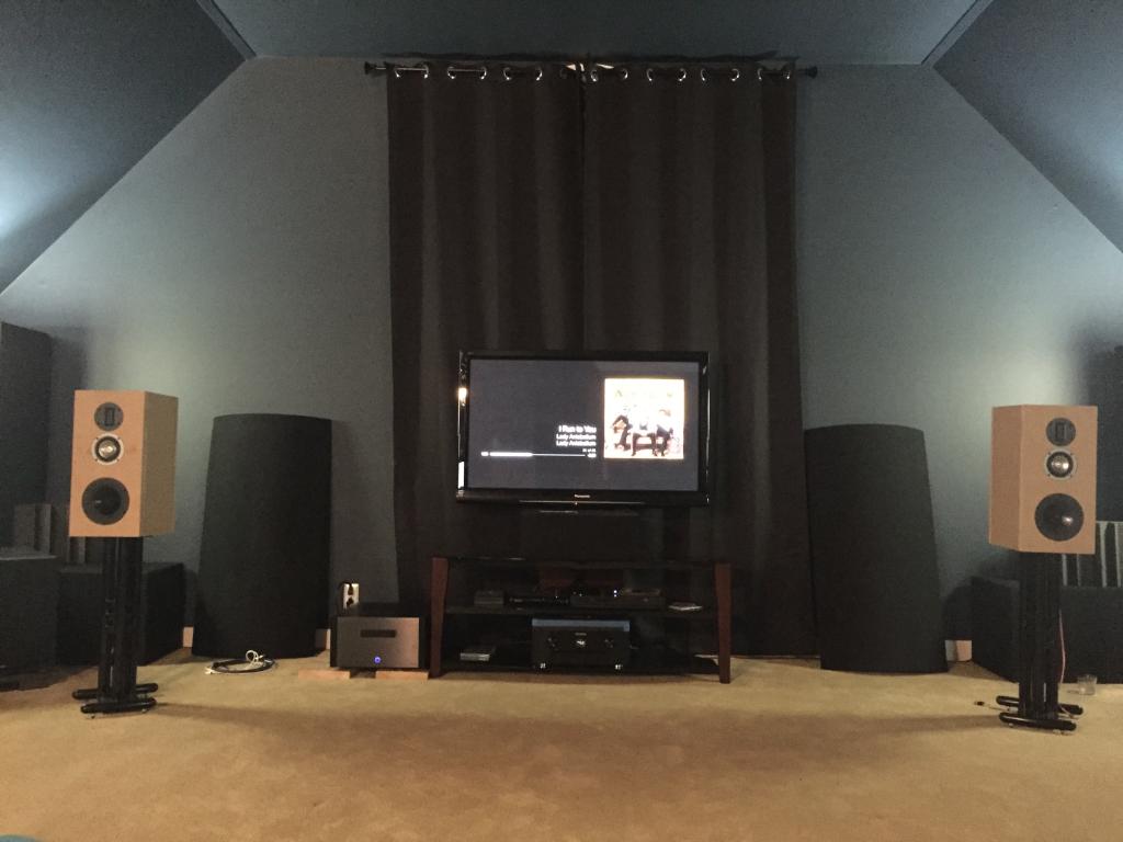

                They're making music! I still need to flush route the edges and sand everything smooth and decide on how I want to finish them, but they're making music!
                I'm really blown away at how well they image. I don't have a lot of speakers to compare them to, but I've been able to compare them to four different speakers in the same room with the same setup:
                • KRK Rokit 6's
                • Paul Carmody's Classix II
                • Paul Carmody's Speedsters
                • Paradigm Studio 20's (Circa late '90's)
                Since this picture was taken, I've replaced the stands with a pair of 12" subs, as the stands in the picture were way too tall, and the 12" subs put the tweeters only about an inch or so above ear height.
                I played around with two diffusion panels directly behind the speakers to see how it impacted imaging. In the sweet spot, it made the center state a bit "fuzzy" and not very defined, but off center in the 2nd and 3rd listening positions they REALLY anchored the center stage very well, quite impressive really. I've since moved these panels to just behind the first reflection point as my wife doesn't appreciate great sound.
                First and second reflection points are being controlled by three (each wall) GiK Accoustics bass traps. four GiK Soffet traps in the room, two in each of the front corners (on the floor). I plan on getting four more for the rear of the room, as low bass notes can be heard reflecting from the rear of the room.
                Everything I've played through them sounds fantastic, even stuff that isn't well recorded (like 128/160kbps OLD mp3 rips from the 90's)
                I think I'll start on the Statement II center next, then on to the full sized Statements II

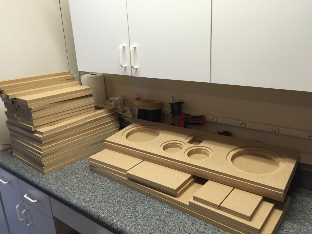

                                                      I've delayed my plans to do a custom set of Statements II (curved) and have ordered the knock down kit for the center and full sized Statements II from Melby Audio - the wood should be delivered tomorrow - looks like I'll be spending my weekend gluing and clamping!

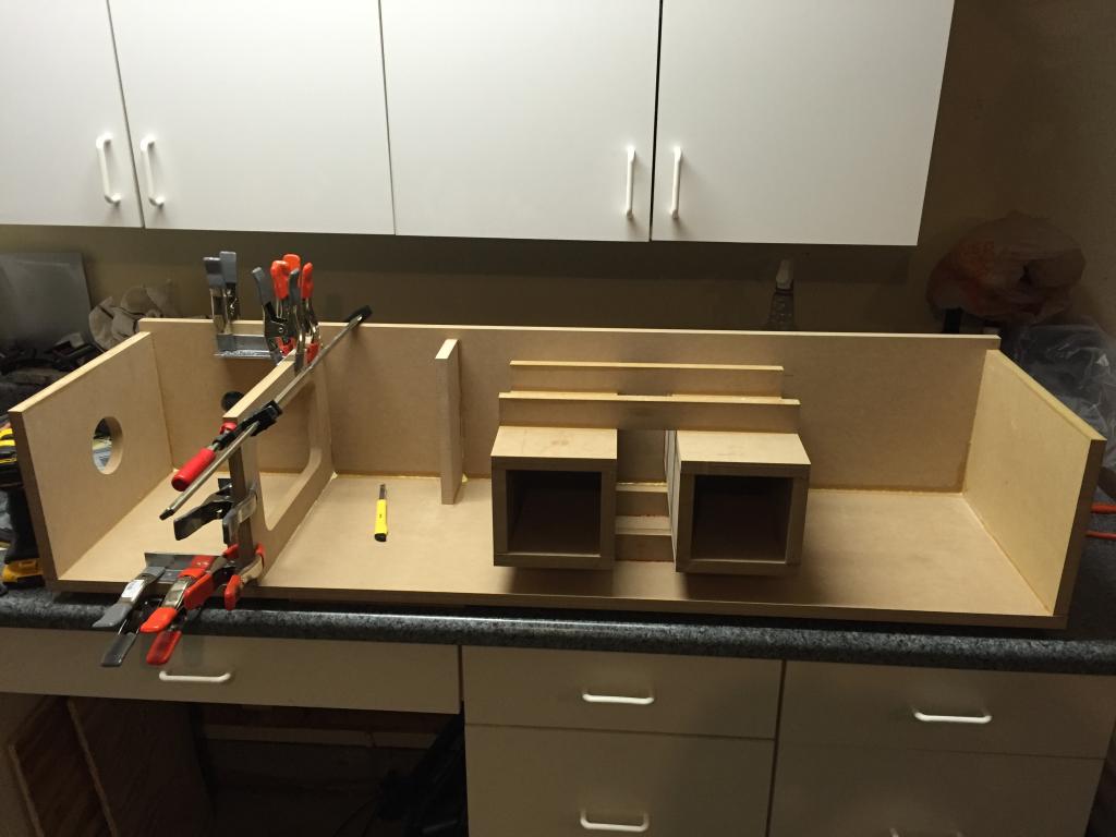

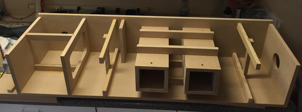

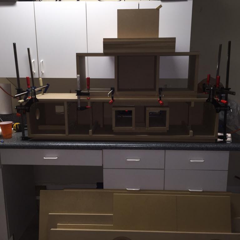

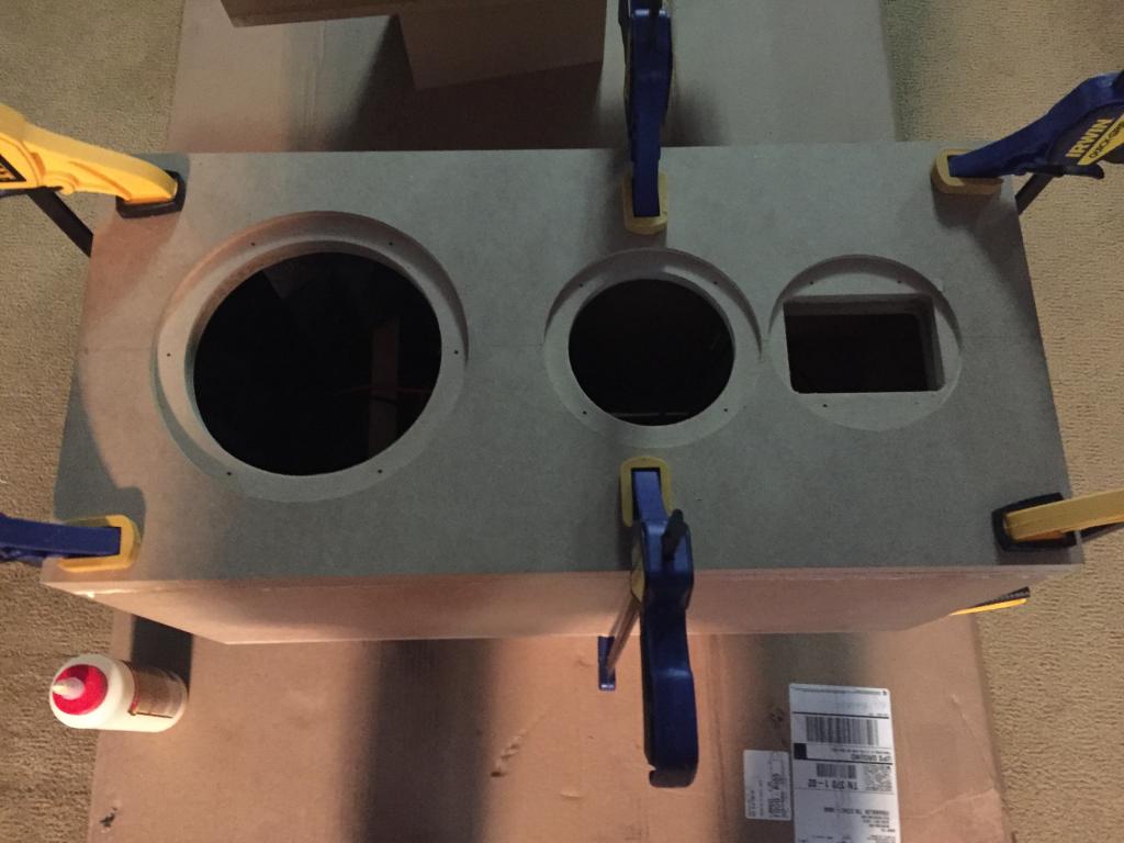

                                                                    Made lots of progress so far this weekend. I have all of the tunnels glued and the baffle pieces glued together. That is a lot of progress when you consider I could only do one glue joint at a time, as I only have a hand full of clamps....need more clamps!

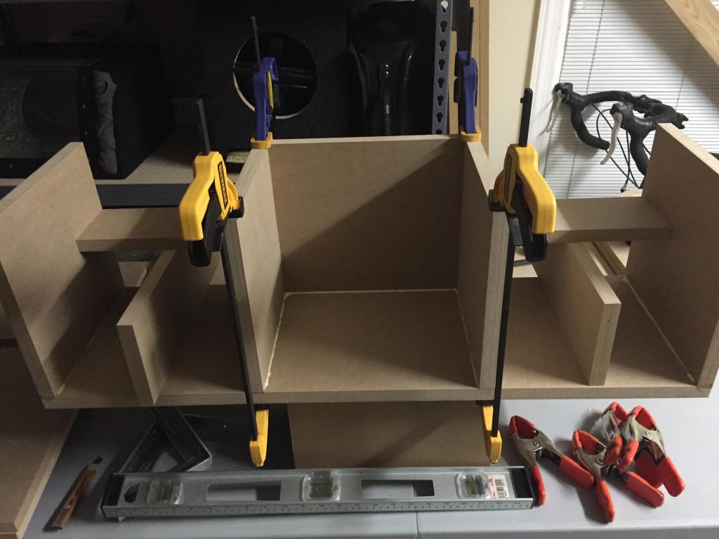

                                                                    I do have a question for those of you who have built the Statements. How did you go about lining up the tunnels in order to glue on the side 2" strip braces? Did you glue the tunnels to either the baffle or rear panel and then glue on the bracing, or did you glue the bracing before gluing the tunnels to either the baffle or rear panel? If you glued the braces on first, how did you ensure that the tunnels were perfectly aligned?
                                                                      Hi Nate,
                                                                      It's been a while but if I remember correctly, I built them from the side up. In other words, I glued one side, top, bottom and an inner front to start with. I then positioned the tunnels to correspond to the front driver cutouts with the side tunnel braces glued to the tunnels. Then I glued the back on (without mid tunnel holes) and finally after making sure everything fit perfectly, glued the final side on. The outer front baffle was last.
                                                                      you're correct, you do need more clamps!
                                                                      HTH!
                                                                      • Pknaz
                                                                        • Mar 2013
                                                                        • 98

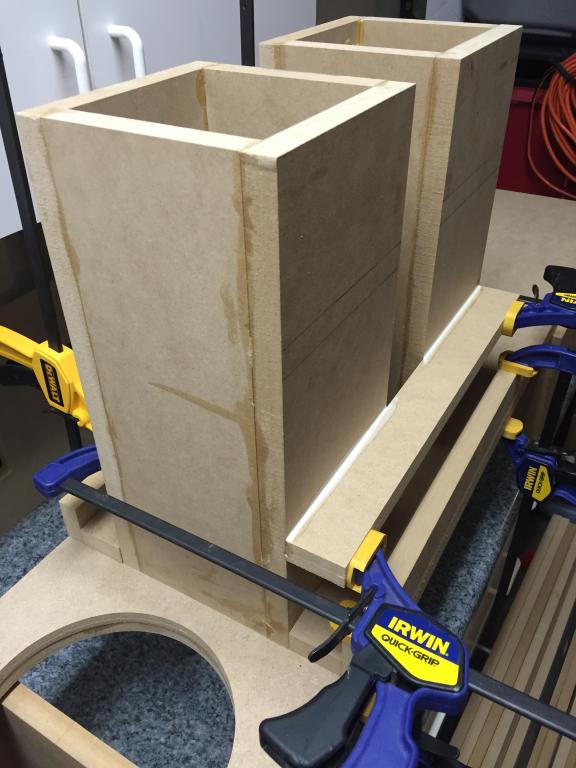

                                                                        Thanks, Jim, for the input.
                                                                        All of my MDF was cut already, so I had to come up with something creative. I used a few of the 2" strips to create a jig to hold the tunnels in place on the front baffle, while I glued one of them to the side of the tunnels. I can repeat this for the other set of tunnels, again, one at a time I need more clamps.

                                                                          I took this week off work to spend some time moving this project forward. I ordered the kits from Meniscus and will be working on the crossovers in the evenings. I'm taking a page from Ben's book and using zip ties on all of the components!
                                                                            Looks great! :T
                                                                            • Renron
                                                                              • 751
                                                                              PKnaz,
                                                                              You're progressing nicely, it looks really good.
                                                                              When your zip tying the capacitors slip a piece of thin medium density foam rubber underneath them and don't zip them too tight. The foam will help to stop the internal vibrations somewhat. At least I think it helps. (doesn't hurt) LOL.
                                                                              What is the final finish going to be?
                                                                              Ron
                                                                              Ardent TS
                                                                              • Pknaz
                                                                                • Mar 2013
                                                                                • 98
                                                                                Originally posted by Renron
                                                                                PKnaz,
                                                                                Ron
                                                                                Foam would have been a fantastic idea about 12 hours ago!

                                                                                  Crossovers coming together. It is raining today, so I'll have to do non-"Dusty" work today (Since I can't work outside). Looks like I'll be finishing up the crossovers and doing the internal wiring inside the cabinets.

                                                                                    There was a break in the rain yesterday and I was able to get outside and make some saw dust. I used carpet tape to attach two panels from the Melby Audio knock down kit to two scrap peices of 3/4" MDF I had laying around. I used a pattern bit with my router to copy the two panels (Bottoms and tops of the cabinet). I then used a circular saw to rip the panels into small strips roughly 1.5" wide to be used for additional bracing. I used this method to ensure that the length of each brace was exact, since it was the most important. This is where I've ended up, which I think is a good compromise between silliness (over bracing, if there is such a thing) and what the plans call for.
Name:	Bracing Structure.jpg
                                                                                    You may notice, that I goofed on this cabinet, I accidentally glued the top on the bottom, and the bottom on the top! So I'm thinking I'll sandwich the top with some HDF to cover the hole.
                                                                                    I need to run internal wiring and decide on where I want to mount the crossovers next. Then on to cutting the foam and gluing on the side and baffle.
                                                                                    • Renron
                                                                                      • 751
                                                                                      PKnaz, it's not a goof up, it's a feature! You invented a new speaker called "The Dolphin". JK. You're fix sounds like a good idea / save. Nice job on the extra braces.
                                                                                      Thanks for the pictures and updates.
                                                                                      Ardent TS

                                                                                        Progress so far:
                                                                                        • crossovers are finished and ready to mount.
                                                                                        • Internal wiring has been cut to length and zip tied ready to be secured inside the cabinets.
                                                                                        • Cut the circular holes for the terminal cup into a square hole to recess binding posts instead, very similar to what I did for the Monitors on page 1.
                                                                                        • Cut a circle out of the bottom of the goofed up cabinet for the port tube
                                                                                        • Cut mounting block for woofer circuit, to give more depth for larger screws to hold the boards in place (will add a picture of that later.)
                                                                                        All components are either zip tied or screwed into place (Zister resisters).
                                                                                        I then used hot melt glue to keep the larger components from rattling, and to secure the terminals.
                                                                                        All connections between components were secured before solder was applied.
                                                                                        Here I'm gluing on the second side of one cabinet, will do the other in the morning. Then I need to sand the bracing flush with the side panels in preparation for the baffle glue up.
                                                                                        Once all the sanding is finished, I'll vacuum out the cabinet, glue in a few more pieces, secure internal wiring and crossovers and start fitting the foam.
                                                                                        • kevinm
                                                                                          • Jun 2013
                                                                                          • 417
                                                                                          Those are some clean crossovers. Very nice!
