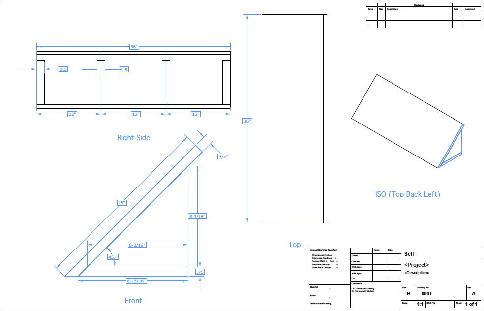

                                                              Facet Jig plan:

                                                                  I like the idea of the table saw jig for the facets better than using a miter saw. I printed out your plan for the jig. Thanks again,

                                                                      When completed there will be full sets of PDFs for not only the main model, but all individual piece parts and the jigs/fixtures.

                                                                            Facet Jig plan:
                                                                            Click image for larger version  Name:	FacetJigPrint.png Views:	5036 Size:	58.7 KB ID:	853372
                                                                            HEY...... that jig looks vaguely familiar!! :rofl:
