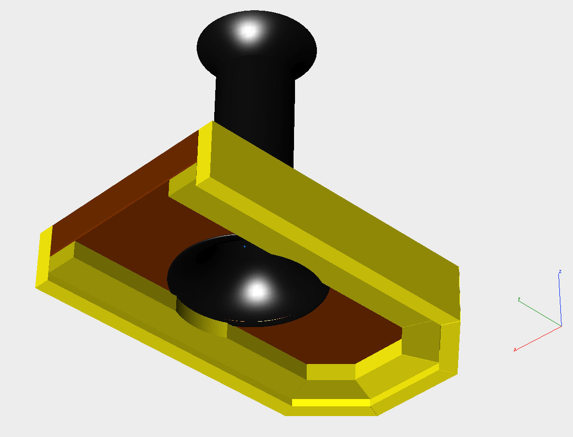

                                    Base design and drawing a PITA...
                                    Maybe I'm just getting lazy, maybe it was the past week at work!! Definitely on the ugly side. Work, that is... :W
                                    Finished it up, though, listening to some Ottmar Liebert on the music server. Seriously nice music and sound. The changes in my system over the last six months have revitalized my music collection, and I think another revolution may be coming soon.

                                        So the riser being right at the edge of the port flare won't effect anything much? Looks really nice!
                                          • 16125
                                          #560
                                          The whole base sits on points off the floor a ways- they're on the 1-1/2" maple that's laid flat to the MDF.
