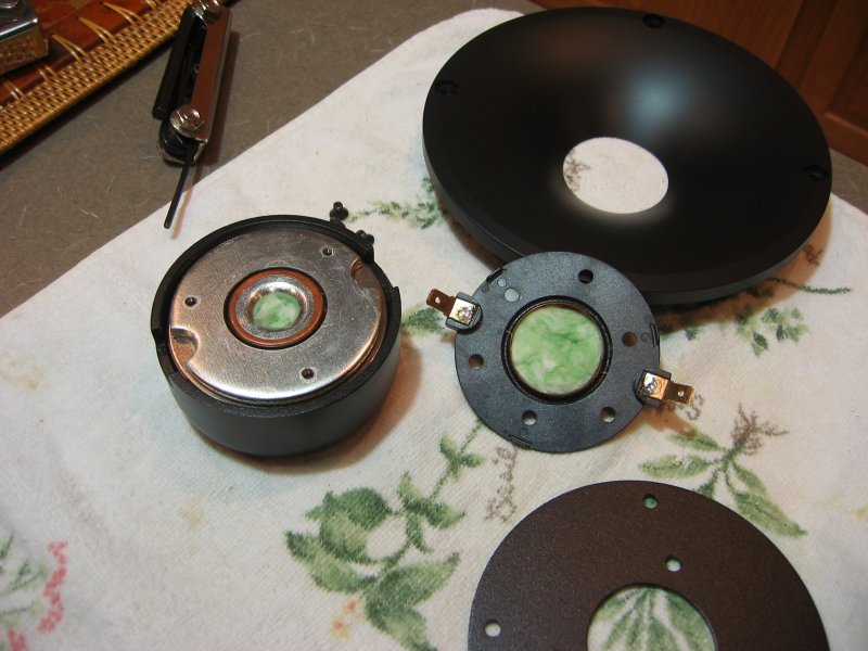

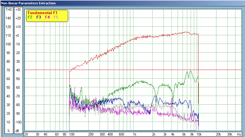

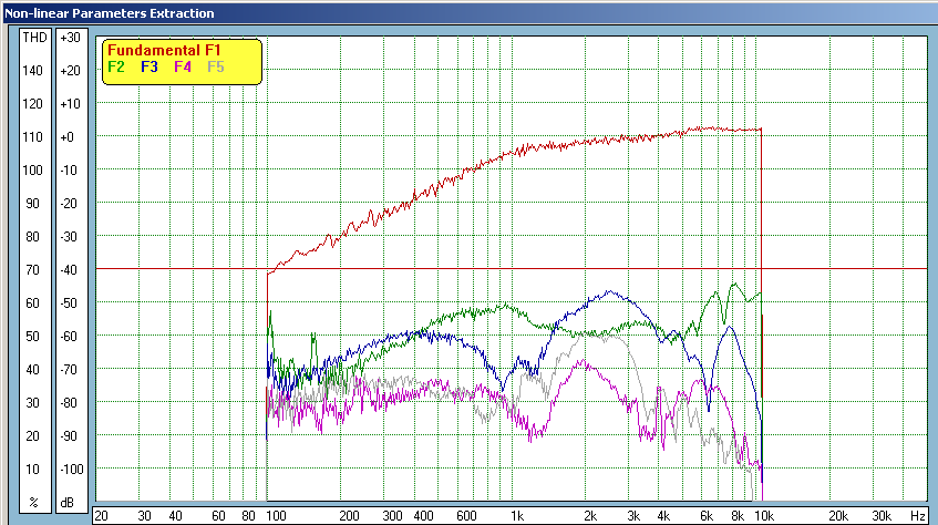

      Just to expand on the distortion of Ciare MT320 a little. Once it didn't work well in the waveguide I didn't pursue but I think the distortion could be improved further. Again below is the MT320 along the Jantzen WG
      Damping "pillow" in place
      pillow removed.
      The distortion with the "pillow" in place,
      pillow removed.
      I think the 2nd order would be smoothed/reduced if a proper felt pad was constructed that did not touch the dome and provide good ventilation like the Scan tweeter pads...another time :W

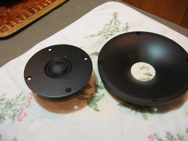

                                      Click image for larger version  Name:	58df2276.webp Views:	0 Size:	50.3 KB ID:	936649
                                      And I now have a pair to mess with! Awesome door prize... What to do with them though...
