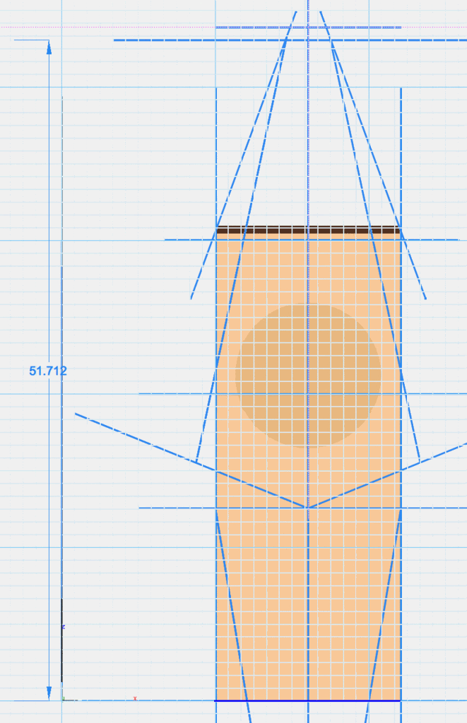

                    #1269
                    I was thinking this:
                    Top design not shown yet. Thomas has a nice Raal that would fit on top (hint, hint).
                        Click image for larger version  Name:	b9949186.gif Views:	0 Size:	120.7 KB ID:	936642
                        Cj
                        Point taken- some flexibility in cabinet layout. I haven't tested the Raal's, but it's in interesting idea. Tenrptatively calling this system the Deathstar- will use outboard subs, too. Acoustic design optimized for 3 rd order interface to deep subs. The general outline is as above- dual 10" SS for the midwoofers, still using the flux capacitor bass tuning- with a separate crossover chamber in the base. Probably locate the Mid and HF crossover up top. Still thinking about a removable top module to keep the total weight of any one piece (and complexity) down. Pondering how to do that and get good cabinet locking without having ridiculous assembly precision requirements.
                        Not planning on this being a waveguide- but have a couple of new ideas i'm kicking around for a performance upgrade of the NatalieP which will be waveguide, depending on how some upcoming tests workout.
                        Think of it as a NataleP-FE. Force Enhanced. Not a budget system, but with a clear derivative pedigree- an aluminum woofer MTM with same "seamless" NatalieP style crossover. Waveguide tweeter with lowish crossover point and high power handling. not quite as small as standard NatalieP, but not ginormous, either. Ardent style build quality, but not as difficult. Have all the drivers... Will finish Ardent update first. Will probably do the NatalieP-FE next, then the big system build. THAT will be quite an undertaking- I need to put some thought into it, to see how I can make it a bit more manageable to build than the Ardents. If possible.
                          • 16172

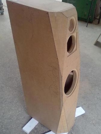

                                  #1276
                                  Thought you might like to see my (unfinished) efforts. They have been in the making for nearly two years, Baby came along and slowed things just a little...
                                  Drivers are D2608 in MCM waveguide, Accuton c173n-t6-90, and Ae AV10H woofers, loaded by dual 15" pr's.
                                  Originally the woofers were to be the Scan buyouts that were at Madisound but silly me let everyone else know first and by the time I ordered them they only had 3 left, DOH!!!
                                  Anyways, a bit more bracing to go in and the wg's to be trimmed and they will be ready to go.
                                  Cheers Beau.
                                  • Beau
                                    • 74
                                    #1277
                                    Forgot to add, You cant really see it in the pics but the lower portion slopes back by about 10deg, then meets the vertical MT section.
                                    Dont even get me started on how painful it was to do a tapered, cuvred and angled chamfer!
                                      #1278
                                      Very nice!
                                        • 16172
                                        #1279
                                        Great looking cabinets, Beau- I certainly understand how life get's in the way of DIY endeavors! I'm torn between "diversifying" my personal life (which has gotten much more complex since last fall) and making progress on the projects, which are also dear to my heart. And of course, things are so busy at work, and even with two open reqs I'm involved with for hiring, we're having trouble finding people with the right background and skill sets, even when considering PhD's. Don't know how that's going to work out, in the mean time, good job security.

                                                                              Mini speaker camp 2011- and it's hot as a pistol out...
                                                                              Which means, better not to work outside on the patio!
                                                                              Seriously, have a few days off to work, but the weather has flipped from a relatively cold damp spring to normal late August weather but in late June/early July. Can't win for losing.
                                                                              I'm starting by taking ONE of the Ardent's apart and modifying the cabinet for the Scanspeak woofers- will fully redo this one and compare to the "reference" original. Hopefully that will help keep me honest...
                                                                              One "blessing" from the hot weather is that I don't even want to go out on the scooter- it was 95 around here just at lunch time. Big high pressure sitting over the bay area, so no ocean breeze in the late afternoon/early evening- doesn't cool off much until after 10.
                                                                              Let's see what we can get done in a few days...

                                                                                        A quick and easy way to enlarge woofer holes: Get some 1/4" MDF. Cut a circle using your jasper jig the same size as the existing opening of the woofer recess in exisiting baffle. Tack the circle in place with some hot glue in a few spots so when the new circle is routered, it won't fall out of place. Once the complete woofer recess is routered out, pull the 1/4" MDF circle out of the hole and reset the depth of the router to complete the job by freehand. I've had to do this a few times. Works perfectly every time.
                                                                                          • 16172
                                                                                          #1304
                                                                                          Good suggestion Jed.
                                                                                          My solution was a phenolic tooling plate (more stability than MDF for tooling, a little more re-usable, and besides, phenolic is cool... ) which I cut to the overall cabinet width, then routed a hole most of the way through that's the diameter of the new inner hole I need (that needed to be larger, too). Cut it out the plug the rest of the way with a saber saw and jig blade, then clean up the hole flush with an upper bearing follower bit.
                                                                                          Clamp that to the cabinet over the hole to be enlarged. Used the same upper bearing follower bit to use the plate hole as the guide, hog out the inner hole (taking some care here, it's LBL). Produces a very smooth accurate "through hole".
                                                                                          Remove "hog out fixture", then use a router setup with adjustable rabbeting bit bit to provide the needed enlarged rabbet recess for the woofer frame. Needed to enlarge both with the SS Illuminator.
