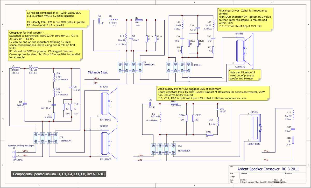

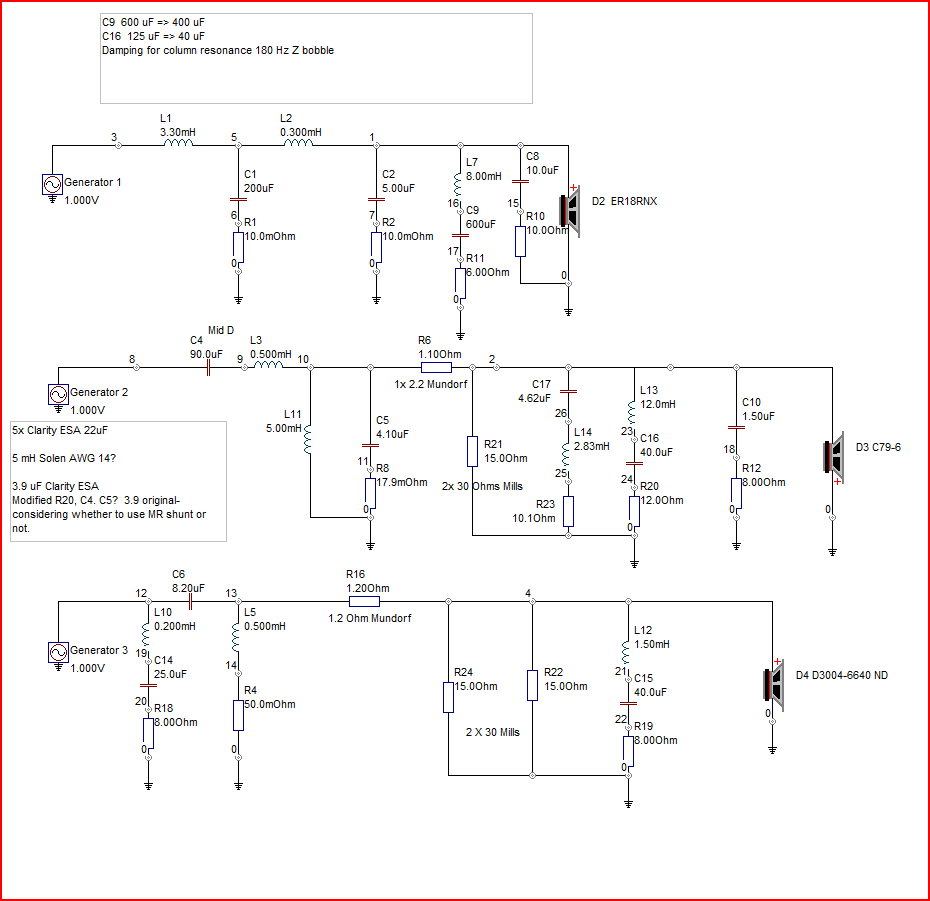

                                                    While the Ardents have been really neglected from a time viewpoint, they've always been in my thoughts and some occasional design review and what if ongoing, based on things I've learned from the Modula Xtremes.
                                                    Before switching and trying out the SS woofers, there's one more update pass on the crossover with the Seas ER18RNX which I hope to squeeze in some time to wring out in testing this weekend (evenings) and decide if it's the "final" version of the crossover for that driver configuration.

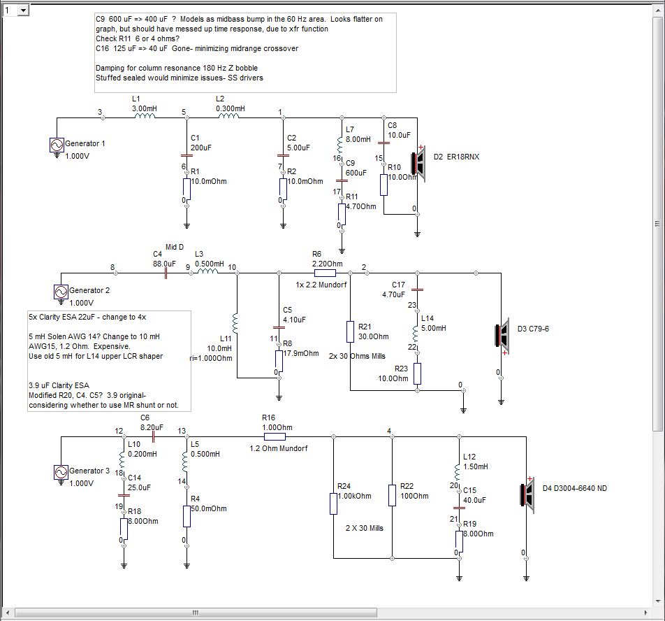

                                                    Then I'll be modifying the cabinets to handle the Scanspeak drivers and updating the crossovers again. But probably not till the second half of May, as I'm basically on a 7 day a week schedule until then.

                                                        #1242
                                                        Some of the resistors in the crossover have "mOhms" for units. Are these milli-ohms?
                                                          • 16145
                                                          #1243
                                                          Some "resistors" are just parasitic components of capacitors or inductors, for a more accurate simulation, or in the case where initial investigations considered placing a resistor as part of the shaping network. This applies to R2, R2, R4, and R8. The "finalized" schematic drawn in Altium Designer doesn't include these "parts". Sorry for any confusion.
                                                          • saevox

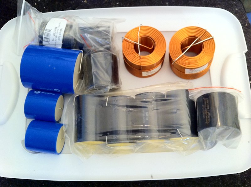

                                                                By two weeks ago, I had a pretty nice pile of new parts....
                                                                Some for the Modula Xtreme, some for the Ardent update, to implement this revision of the crossover:

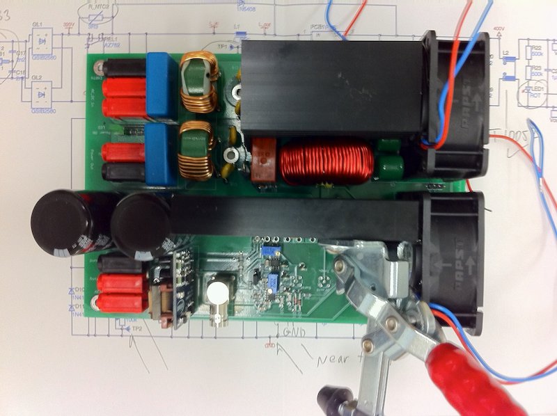

                                                                Sadly, all I did last weekend was work in the Office lab on a PFC DUT measurement board, as the tech in Raleigh couldn't get his work done as scheduled, and I got a box of parts and heatsinks (including the wrong ones) Friday last week, and spent all weekend either machining or soldering to put together this, in time for FAE training this week just finished. (and for next week in Raleigh, leaving this Sunday for their early in the AM).
Name:	PFC Board.jpg
                                                                It's been an ugly couple of months- two straight months without a day off. My manager is in Raleigh, and we're having a chat while I'm there.

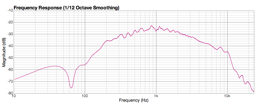

                                                                                            #1260
                                                                                            Final ER18RNX Update
                                                                                            A quick summary of what I've been doing- updating and finalizing the crossover design with the ER18RNX.
                                                                                            Why changes? Well, even though my past FR response plots looked pretty good, they just didn't sound right at times to me. Mostly the issues I wasn't happy with were in the low mid/upper bass, and overall integration and balance from 100 Hz to 5-6 kHz.
                                                                                            Using experience from the Modula Xtreme's, I took a closer look at the LF and midrange crossovers AND the crossover components...
                                                                                            The Jantzen C toroid core inductors seemed quite promising for reducing DCR- which they do. But detailed testing with a number of different LCR systems, including an HP4192 analyzer showed some inductance non-linearity issues at LOW power levels, not at high- at high, they're not badly behaved for a cored inductor. But at lower current, the permeability of the core is higher, and the inductance higher than the stated value. And it varies where that sets in depending on the value- same core type used for all parts, not different mu cores. So they got kicked to the curve, and the LF network redesigned with a combination of LspCAD and empirical tests, resulting in new North Creek AWG air core coils with new values for L1: 3.0 mH. Now we're cooking with white gas, as we used to say in Texarkana.
                                                                                            The mid crossover was also scrutinized for behavior at the lower crossover point. Earlier I'd believed I would be fine with a 5 mH shunt inductor on the high pass and adjusting the series cap to get the needed curve, but this left the impedance behavior a bit squirrelly at the crossover region. After some simulation and analysis and measurement, L11 is revised to a somewhat spendy 10 mH AWG 15 coil, but the behavior is better and the measured response for the mid alone is where I want it to be. I also looked at some alternative network variations for the upper mid shunt EQ LCR in LspCAD and by measurement, but ended up sticking with the values determined last year.
Name:	Ardent May2011 Mid.png

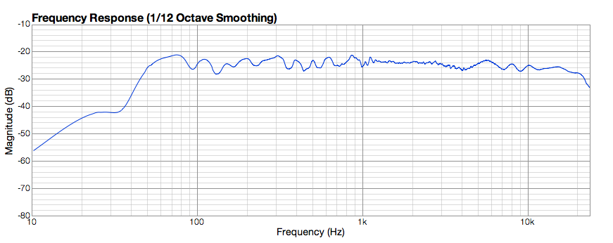

                                                                                            Put this all together, and the result doesn't look that much different on paper from the last set of sweeps I ran in 2010, but it does sound different- and much better to my ears. Distortion sweep is lower, too.
Name:	Ardent May2011FR3.png
                                                                                            Note that this was measured with about a 70 msec in room gate, and WITHOUT the felt damper on the front panel- the bump in the 5-6 kHz area goes away with that, but it's pretty OK sounding even without the felt.
                                                                                            Test amp was an Aragon 8008 X3; speaker cable Cardas Golden Presence.
                                                                                            Here's a pic of the updated schematic. Email or PM me for a nice PDF.
Name:	Ardent ER18RNX-S.jpg
                                                                                            Next step is cabinet mods/update to evaluate the Scanspeak illuminator woofers.
