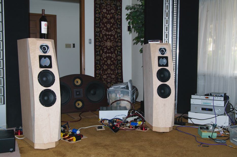

                    At the Denver airport this AM- flying to Austria shortly on business, then Germany- will be back in Denver the 16th.
                    All the initial crossover construction was finished- one cabinet wired up and tested, as reported in the RMAF thread. Mid and tweeter level need to come down about 2 dB, otherwise very flat. It's a puzzle palace to get everything in the box, I think I've figured out how to add the midrange zobel back in. :W
                    If things go according to plan, should have things sorted out by Sunday the 19th. I figure these aren't overbuilt after all (Hank!), as cranking the one cabinet up with some David Garfield, I could just detect the hint of a vibration in the cabinet front near the woofers. Midrange/tweeter area is quite solid. Sides are mostly good, just a hint of vibration in one area.

                                                                                          #809
                                                                                          Testing and listening update
                                                                                          Thomas has been cracking the whip the last two days, and Colorado Tom came over this afternoon to check up on things.
                                                                                          Yes, there are two of these.....
                                                                                          And I measured both, but not having quite enough damping material on hand for the right hand cabinet, I'm just showing measurements for the left hand one for now.... :W
                                                                                          Thanks and a tip of the hat to Colorado Tom for the excellent photography aid... :B
