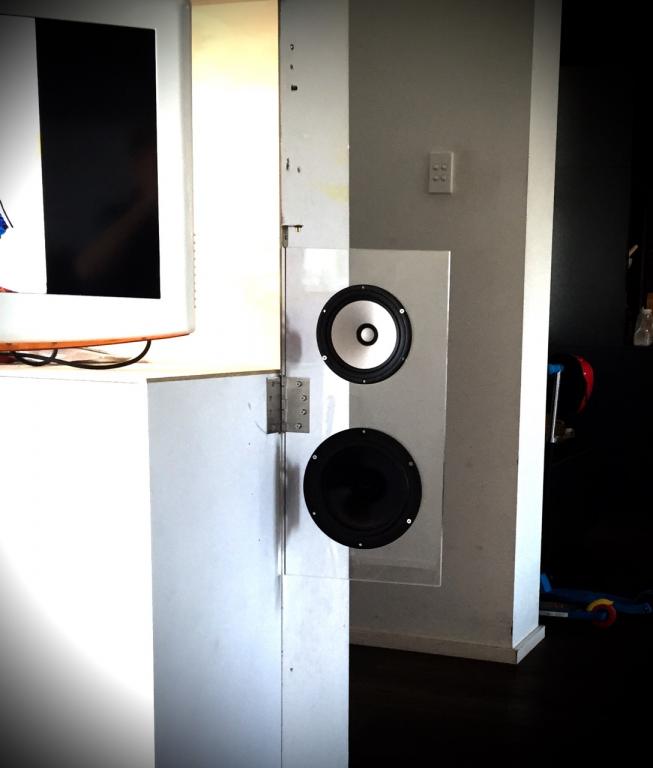

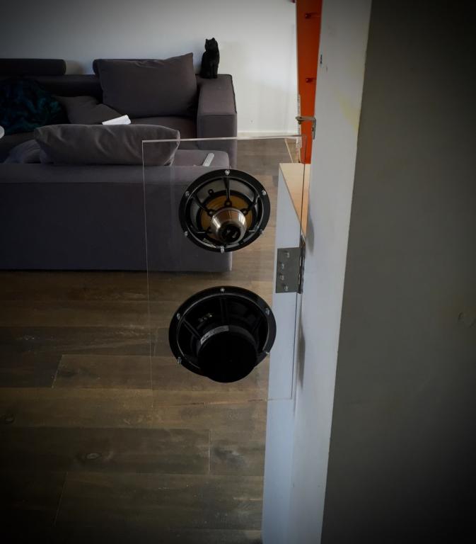

                      Well, it seems I'm joining the C18 club too.
                      My plans are a little different since I am going to start with a three-way open baffle, probably with passive at the top then active to an 8 or 10 woofer (or woofers).
                      But I'll be following Jon's journey with great interest.

                          #147
                          Yes, I'm still debating whether to go variable width baffle to get maximum dipole effect as I did with my Neo10 OBs, or simple Orion style rectangular, which will look better and run deeper. I'm going to cross to a servo sub below 80Hz.
                          More importantly, I need to find some woofers which match the cool aesthetics of the C18.

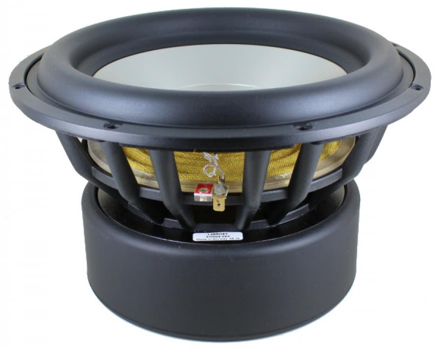

                                      Seems a bit of a waste to pay that much and only use it from 80 to 300 or so, but it is the prettiest 10" driver. What I'd really like is a cheap 10" Accuton. 😄

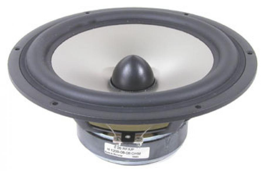

                                        SEAS L26ROY isn't a princess, but the cone matches with C18 well https://www.madisoundspeakerstore.co...1001-04-4-ohm/
                                        Madisound has special offer for L26, only 139,- now - just paint the plug white! https://www.madisoundspeakerstore.co...m-cone-woofer/

                                                  How high could you crossover the L26ROY?
                                                  Click image for larger version  Name:	h1209.jpg Views:	0 Size:	55.5 KB ID:	942423

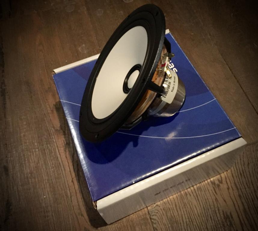

                                                          My C18s arrived today too. They are certainly pretty things. With that shiny rear they look made for OB use.

                                                                            Let me know if I should toddle off to my own thread, but I whipped up a test baffle and did some quick measurements. These are with a temporary crossover (3rd order 2.5K) I picked up on eBay. There is no EQ boost or dipole peak cuts. The RS225 isn't wired up.
                                                                            Last edited by theSven; 24 June 2023, 17:26 Saturday. Reason: Update image location

                                                                              That's not looking too bad! Have you simulated the crossover you picked up, just to see how it should be interacting with the drivers? I do suggest you consider the possibility of an LR6 like mine for the mid to tweeter- then EQ the low end of the midrange and do your other stuff active?
                                                                              No worries having this discussion in the thread- it's not an official build thread, anyway, more a "concept engineering" thread for solutions with the C18EN001, so I consider your experiment quite relevant.
                                                                              How does it sound to you? Have you listened to any program?

                                                                                  Thanks Jon. I only have one speaker hooked up for testing but they sound very promising even with the cheap-ass crossover. Very smooth and coherent in any listening position, which is what I was after. I'm still deciding about crossovers. It would be nice to be able to go three way passive and then EQ actively so I can use just one amp, but I do have a bunch of MiniDSPs and some spare amps if I decide to go full active or some combination.
                                                                                  To complicate things, my sweet partner doesn't mind the looks too much (although she prefers the Maggies), but she doesn't want them to be as low on the wall as they are now in case kids fiddle with them. This would mean mounting them much higher. So I need to move them up and see what that does to the response.

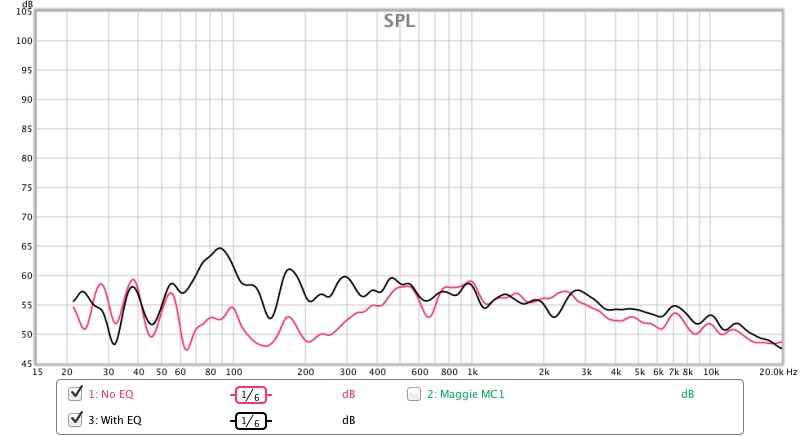

                                                                                      I've mounted the speaker high enough to avoid fingers, and did a quick and dirty EQ using the RS225 for the bass. I just ran it in parallel so there no crossover on the RS225, but the combo does get down to 90hz or so which is what I need. It needed considerably less EQ than my Orions, which I assume is because the nib wall it is mounted on extends the baffle.
                                                                                      It sounds a little weird with the soundstage up so high, but the dispersion of the C18 certainly works as advertised.
                                                                                      We'll see what my darling says.

                                                                                        I take it you mean what your darling says about the esthetics?
                                                                                        Well, what you've done so far certainly qualifies for "proof of concept", though I imagine getting that RS225 a bit more band limited won't hurt the sound any... :W

                                                                                          My darling has agreed we can keep the C18 speakers, which is nice after spending over $1000 on the drivers. So now I just have to decide on bass drivers and crossovers. At the moment I am leaning towards the Seas L26 RFX, or a pair of HiVi M8s, for aesthetic reasons as much as anything else. I could also go a single Seas W22 but am a little worried about displacement.
                                                                                          It would be nice if there was alternate that looked good with its bum naked the way the C18 does, something like the Scanspeaks but larger and with a silver cone.
                                                                                          That leaves the crossover. I'm tossing up between a simple hybrid LR4 passive on the top with active to the woofer and EQ for everything done by a MiniDSP, but am also pondering a simple three way passive using LR4s and the MiniDSP to simply provide EQ.
