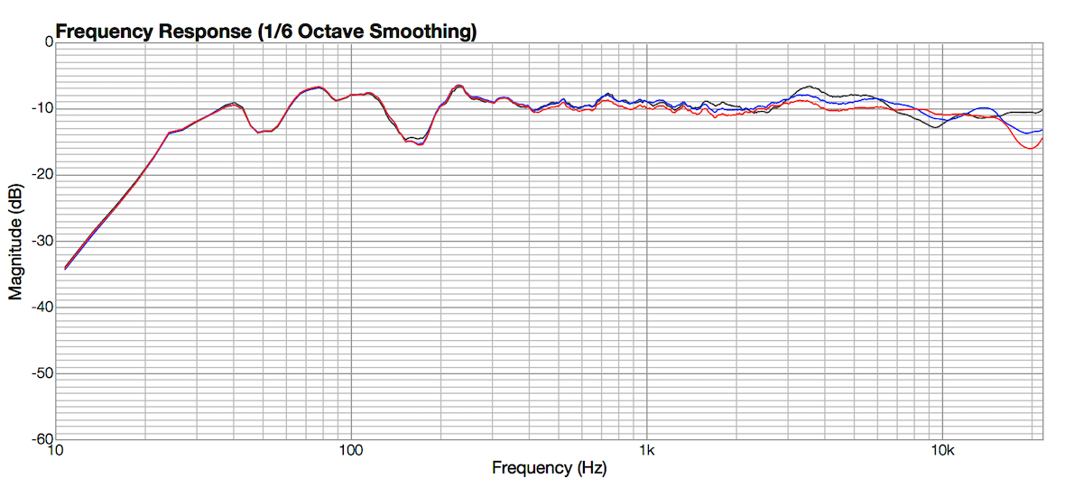

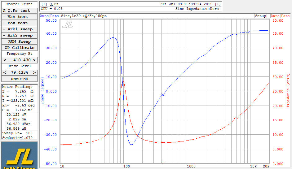

    Jon, I was looking at the spec sheet on the C18EN001 and it was calling for a .2 cu ft sealed enclosure for and F3 of about 135Hz, seeing that your test box was at .75 cu ft, I was curious as to why the extra volume?
    was trying to get the impedance bump as far away as possible from the crossover point.
    In the 0.75 cu ft box (not the proportions I want in final version, which will be deeper and not as tall for the midrange) Fb is right at 100 Hz. The crossover frequency is 250 Hz, as planned and implemented, and I didn't want the Fb so close to that point.
    Here, you can see the impedance curve of the midrange driver by itself.

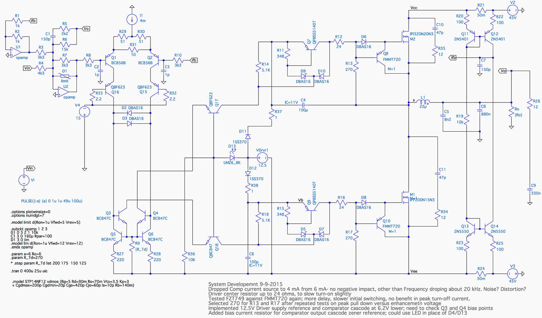

                  've got the Aires streamer for the AURALiC Vega, and the few times I've had a chance to listen to the Vega, it's seemed quite good, certainly in the range I expect for that amount of money.
                  The real problem is that I've been so busy with work and other aspects of my daily schedule that I hardly ever get a chance to listen to music since I've been working so much on the weekends. Right now there isn't time in the evening- by the time we get dinner, get the dog walked, and cleaned up, I'm turning in to bed, and GF is watching something streamed like Orange is the New Black. (retired, unlike me).
                  I don't even have time to watch my iTunes TV shows unless I do it at lunch, and mostly now I'm studying software of one sort or another at lunch- SIMPLIS-SIMetrix a lot lately, LTspice, Eagle PCB, and today 2015 SketchUp Pro. I've got several days of tutorial files for SketchUp (for lunch) at that rate to go through.
                  Big push to finish this b*tch of an application note, it sure would be easier if I didn't know enough to sweat the details, like 80% of the stuff that goes out doesn't do. But between that and the deadline for an FAE training from scratch, 7 days a week is the only prudent thing to do, until it's done.
                  But, it's all progress. Oh, and sometimes at lunch or in the evening I work on my little side project- it's coming along well, based on the current simulation results, all discrete circuitry so far, and I've probably evaluated 4-6 different transistors in every functional position. I'll give you a hint what it is, the idle frequency is about 425kHz. Balanced instrumentation style front end is next, plus start up and protection circuitry. Got bins of parts to build these, once I decide on a specific component for a specific function, I just order them... kind of nutso, I suppose... maybe it's just pride of ownership. :W There's a lot of necessary physical details not shown in the schematic, such as the output filter which must be composed of WIMA 220nF film caps in parallel, to get the AC voltage handling at high frequency.
                  A lot more work to do... but it's fun, when I have some time to do it. It will likely never match an nCore 400, but sometimes it's just the journey that's entertaining....
                  Final design will run on +/- 65V rails- it's pretty much there for that already. Gotta update the front end, though.
                  Last edited by theSven; 24 June 2023, 17:01 Saturday. Reason: Update image location

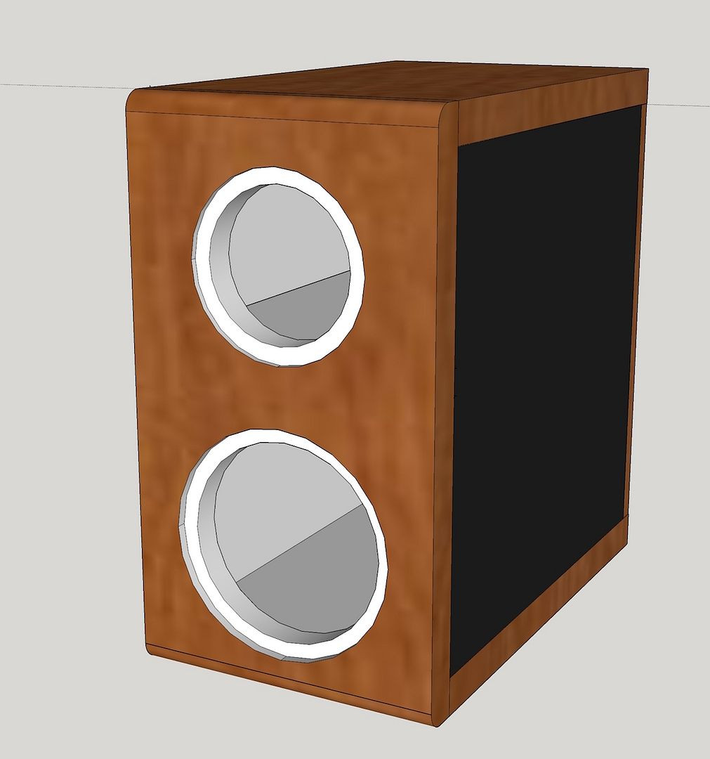

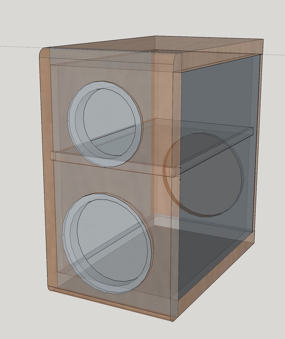

                        well, a bit of progress this evening...
                        I have to say I have too many reflexes still born of other 3D CAD programs, but I can see the attraction of SketchUp, and for somethings adjusting and tweaking things can be much quicker, but I've still got a ways to go to really feel comfortable in it, and how some of the commands and cursor tricks work. I wish it had a little more of the smart cursor stuff of ViaCAD/Shark. But, regardless, the experiment is working, and I'll likely buy the full Pro version well before the 30 day trial expires.
                        I still have some additional beveled side panels to put on, but pretty much everything else is at a usable point for the first build.

                        Most of the material is LBL; the black side walls are some phenolic covered BB ply I have on hand, normally used for tooling, but it's great for building. Will probably use the same for the chamber divider.
                        Particularly if one can get by with the limitations of the free maker version, it's a heck of a deal. It feels like some care was put in to writing it, in terms of optimizing the on screen performance, because with the native version on my Mac Pro, the CPU usage is quite low, and it's like a knife through hot butter as regards panning and working with objects, including loading in some demo files. Reminds me of LTspice on the Mac.
                        Now let's see if I can squeeze in a bit of time to cut and route the front and back panels this weekend, and make the dimensional drawing using Layout at lunch tomorrow!

                            Looking good Jon ........ and welcome to the dark side You may already know, but as an fyi when you draw your first circle in a drawing you can specify the number of "sides" that it uses ( I think the default is 16 sides which looks a a little rough). So as soon as you layout the first circle type a number followed by an "s" in the command box and hit enter, example 48s is what I typically use, and it will give you 48 sides, this will now be the default until you change it. The higher the number the prettier it looks, but just adds more data which slows things down, so it's a trade off.

                              Thanks much for the tip... that's exactly the kind of thing I need to know. Me, I'm a "make the system work and have it look pretty" kind of guy...
                              Now I'll have to see if there's any way to make that retroactive or to modify an existing one... I suspect there's a lot of little tricks and features like this that don't work the way most other programs do= usually I'd go in to a global preference and just define how I'd want circle and curve resolution handled...

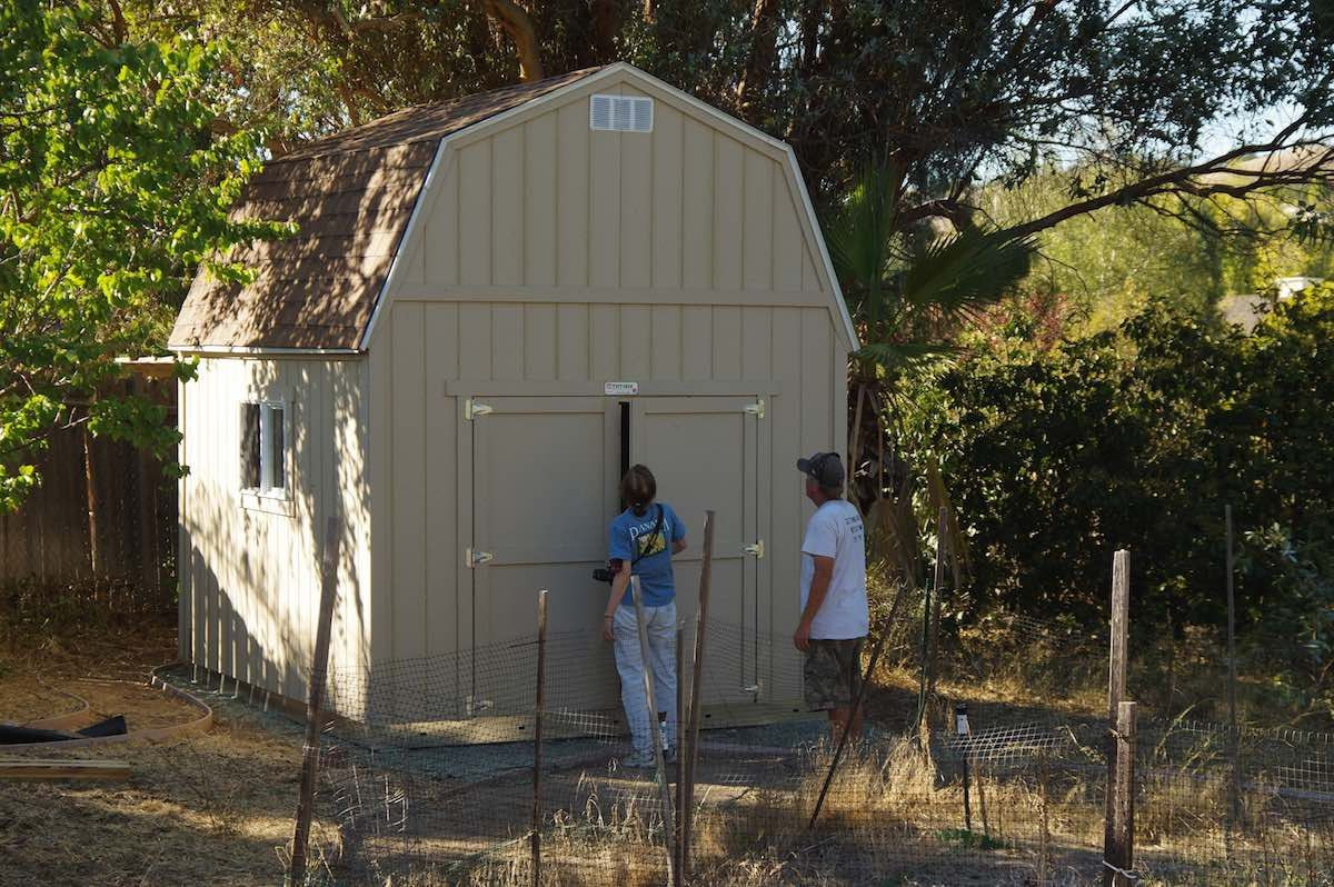

                                                  we finally got the work shed put up today- supposedly it's a storage shed, but it's going to be storming my power tools and providing a space to work out of the sun on wood projects and motorcycles, among other things. Film at 11... actually, I should probably wait to post pictures until we've got it painted- but even with just the primer exterior it doesn't look bad. Need to do an epoxy paint coating for the flooring, and some other detail work- too bad I'm booked for work-work this weekend and next. Going to do a few things on it after dinner tonight, though.

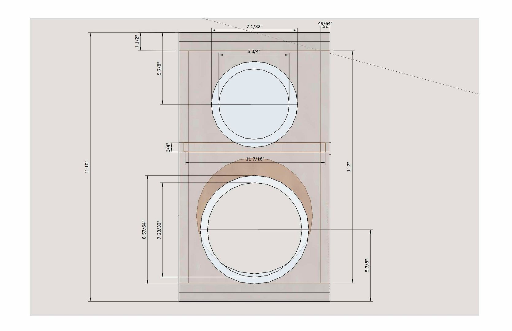

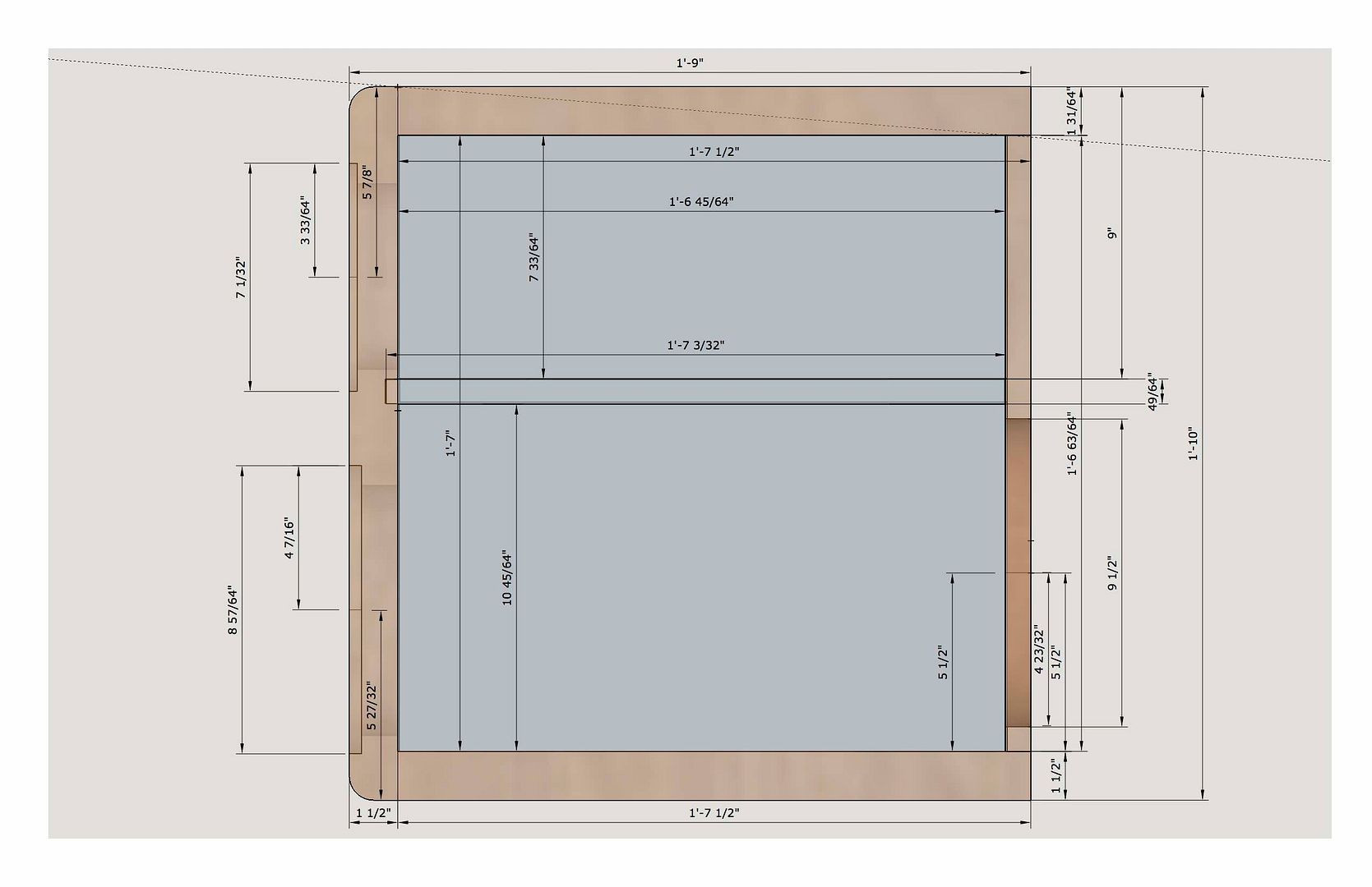

                                                    Just some documentation update- I'm still getting familiar with Sketchup and Layout- yesterday evening, it was my turn with layout. It's a bit different than the tools I'm used to working with, doesn't have some of the automated 3D model to 2D drawing functions, but I'm getting the hang of it (perhaps slowly), and I like the way it is responsive when actually editing and updating stuff. The Sketchup for Dummies book is proving quite helpful, but I confess to still just using it enough to get what I immediately need done, done- just don't have the time to dig into it properly.
                                                    But I've got my dimensioned drawings for the basic cabinet done, and hopefully may find a bit of time this weekend to do some work on the pieces.

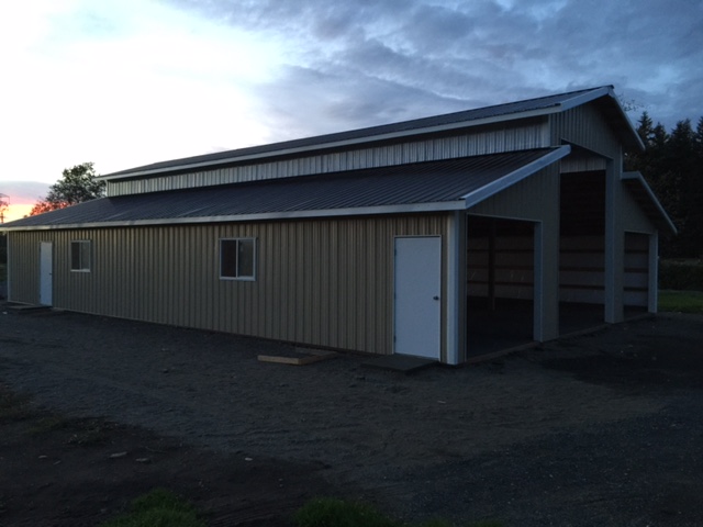

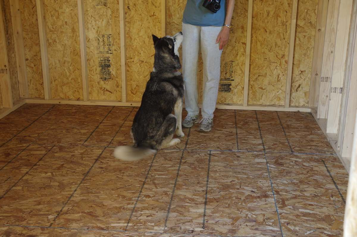

                                                    Something else that will be soaking up some extra CPU cycles is the new "out building"... no, not for that purpose, but for storage and even for woodworking out of the sun!
                                                    This was just put up yesterday- yes, in one day. Well, actually, we had the site preparation and leveling done a couple of weeks ago, and the ToughShed installer team said our site prep was well above average. But the actual construction on site took from a little after 10 AM until about 5:30. They say they do two of the smaller ones in one day, but the bigger guys like this take more time.
                                                    Not visible in this picture below is the 4 ft deep loft, installed at the side wall height of 7 ft; (extra cost option- 6 ft is standard), which with with the high gabled roof gives quite a bit of storage. This one also has upgraded shingles- but no paint, GF is going to do the painting with supplies she's just bought matching the house colors.
                                                    Yes, those are sliding windows with window screens, another extra cost option, but I believe well worth it. Below we have the final acceptance inspection being conducted by the K9 Corps and discussed with management.
                                                    Will this result in a new level of productivity on speaker projects here at Verde Mesa Estates? well, maybe not, but it will likely be easier and more comfortable, and I'll have a better spot for storing the big table saw and a couple of the motorcycles...

                                                      ... the ToughShed installer team said our site prep was well above average.
                                                      Gee, there's a surprise. I'd be very surprised if you have ever uttered the words, "Not perfect, but it's good enough."

                                                        Drawings are looking good Jon, so is the shed. If we end up staying where we are (job dependent) I want to replace our present shed with something similar to what you have there. It would let me move some stuff out of the garage and leave my tools in a permanent setup.
                                                        What I'd love to have is what my brother and step father have just put up ........
                                                        A nice little 40' X 60' pole barn ....... one could do a lot of speaker building in that!

                                                                    Jon, was the shed stick built on site or did they have some of it prefabbed off site?
                                                                      • 16086
                                                                      #124
                                                                      The wall assemblies and roof pieces were assembled off site. The steel base was attached to the floor piece, if I remember correctly. The doors were mounted and windows put on on the site, as were the roofing shingles.

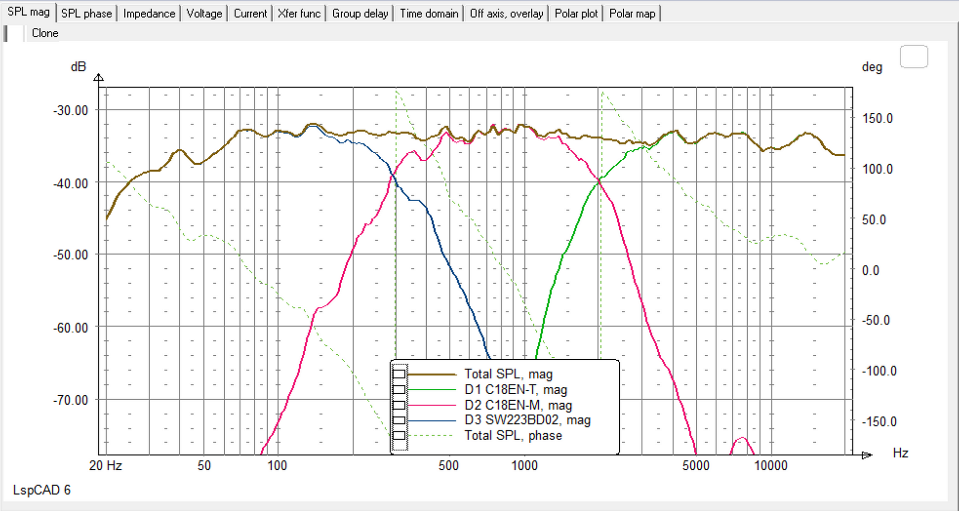

                                                                                            Step by step things are getting done today- sent off some more enclosure/LF alignment into to Steve today, he's got an itch to play with Sketch up and some concepts we've been talking about for the larger version.
                                                                                            But meanwhile things are moving forward here- that floor epoxy coat got updated early this AM, with the tan version, and it's looking pretty nice, GF is happy, so we're all happy here...
                                                                                            And the crossovers have been tweaked (oooh, changed two resistors total, really had to work my fingers to the nubbins for that one, but hauling all the gear out to test them in the backside of the family room, THAT took time! Here's hoping I can talk here into letting me leave them set up for a few days and try to get some good electronics hooked up. But you know, for just running on the test rig with TC Electronic interface (OK, it's a Firewire DAC with the JET PLL chip set, so it's not ALL that bad...).
                                                                                            SO, bottom line, this has been the easiest tweaking on a three way crossover to get it pretty much where I want that I've ever done....
                                                                                            Still have the floor bounce issue with the test distance, but the overall balance is dialed in well... they're a little "present" on axis (black), but really sound nice at 30 degrees off axis. Vocals are quite nice... actually everything is nice, and the rattle stuff in the room nicely at the start of the sine test chirp in the low end, too. Coherent, nice timbral rendering. Not quite as refined in the top end as an Ardent, or quite as bone clear in the midrange, but holds up nicely, very coherent sounding.

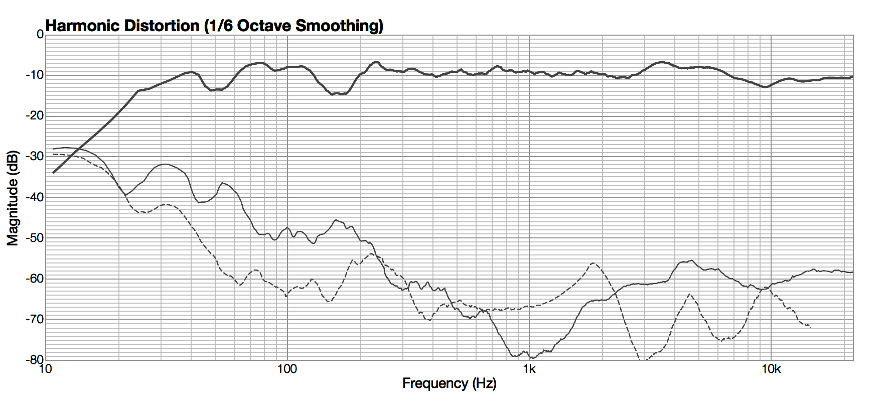

                                                                                            Distortion plot is probably going to be a bit odd looking to most, but there are good reasons for why it looks the way it does, and in fact, turned out better than I was really expecting.
                                                                                            Notice how the midrange 3rd harmonic has something of a ski jump profile, pretty flat from 500Hz to 1 kHz, then starting to curve up sharply- that's the HD3 resonance amplification due to the midrange cone breakup mode, but it's being suppressed as hard as possible with the quasi LR6 crossover electrical transfer function, so I think it may be in control enough. Also, the tweeter really doesn't like going low, so the steeper electrical filter seem to be working well helping with that.
                                                                                            Note state of the art, but pretty fair. And then there's the wide, wide listening arc these have, and very coherent reproduction of instruments with a lot of midrange and treble energy in addition to the fundamentals.
                                                                                            Probably we can go with this for the first build.
