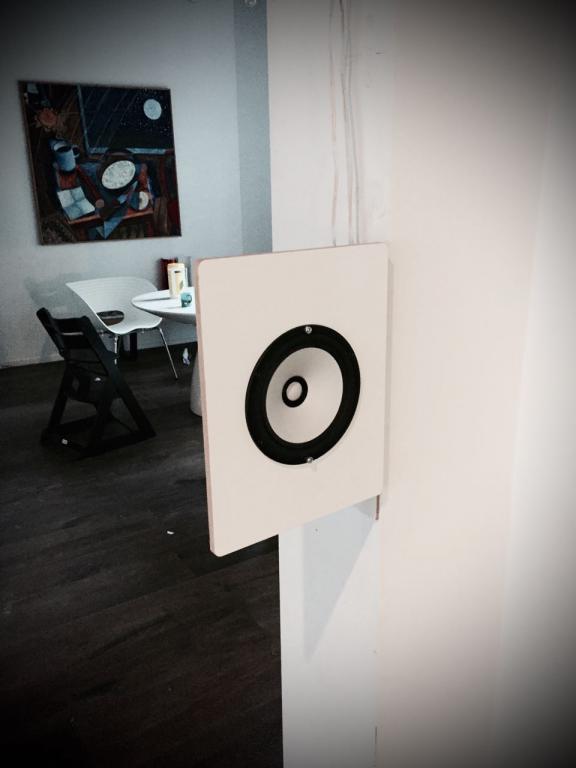

          There's been movement at my C18 station too.
          I've changed the baffles from acrylic to white film faced ply, purely for aesthetic reasons. They fit in better with my modernish decor now.

          I've also been experimenting with crossovers. I have been using a cheap generic crossover from eBay, but figured the dudes at Seas might know what they are talking about and so nabbed the crossover for the King4Roy kit from Madisound.
          This page has been removed, but Madisound has thousands of loudspeaker parts. Contact us today at info@madisound.com.
          Unfortunately (or fortunately as it turned out) there were issues with the build as I needed it on one board and it came on two so it is going back, but the cheap generic crossover both sounded and measured better in a quick test. I lucked out with it as it crosses in precisely the right spot (2.2k).
          However, it is 3rd order and there are issues compared to the LR4 I've tried when going fully active with a MiniDSP, so I will get something made up.
          My boundary woofers are also changing, but I'm too embarrassed to admit what I'm going to do given the superb standard of the builds here.

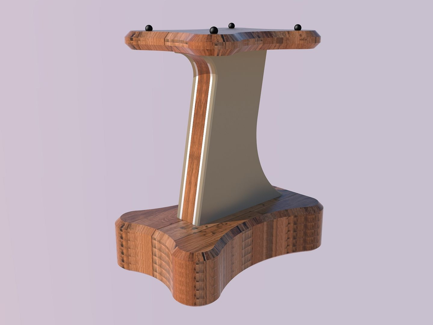

            Click image for larger version  Name:	Front_zpsp4kmtxsu.jpg Views:	0 Size:	183.3 KB ID:	942433
            Click image for larger version  Name:	20_zpsv7yvd4ng.jpg Views:	0 Size:	118.2 KB ID:	942434
            Yes, you guessed it, crossover in the base of the stand. And yes, this is going to be a metric ton of LBL ply... (well, close to it...)
            Between these construction concepts and what I'm hearing today, I'm looking forward to early 2016!
            What are those side panels going to be made from?
            It kind of looks like a ply, and then a metal sheet (3mm thick or so) and finally "something else"...

              Hey TEK ..... the plan is the side panels will be painted lbl and your right, the in between is metal, aluminum in this case.

                      WOWZERS! And that stand concept - outta the box for sure.
                        yup- Steve should take a bow for his second pass on the stand design. Mind you, we have to run a bit of cabling up the center of the stand, so there are some good design reasons, too.

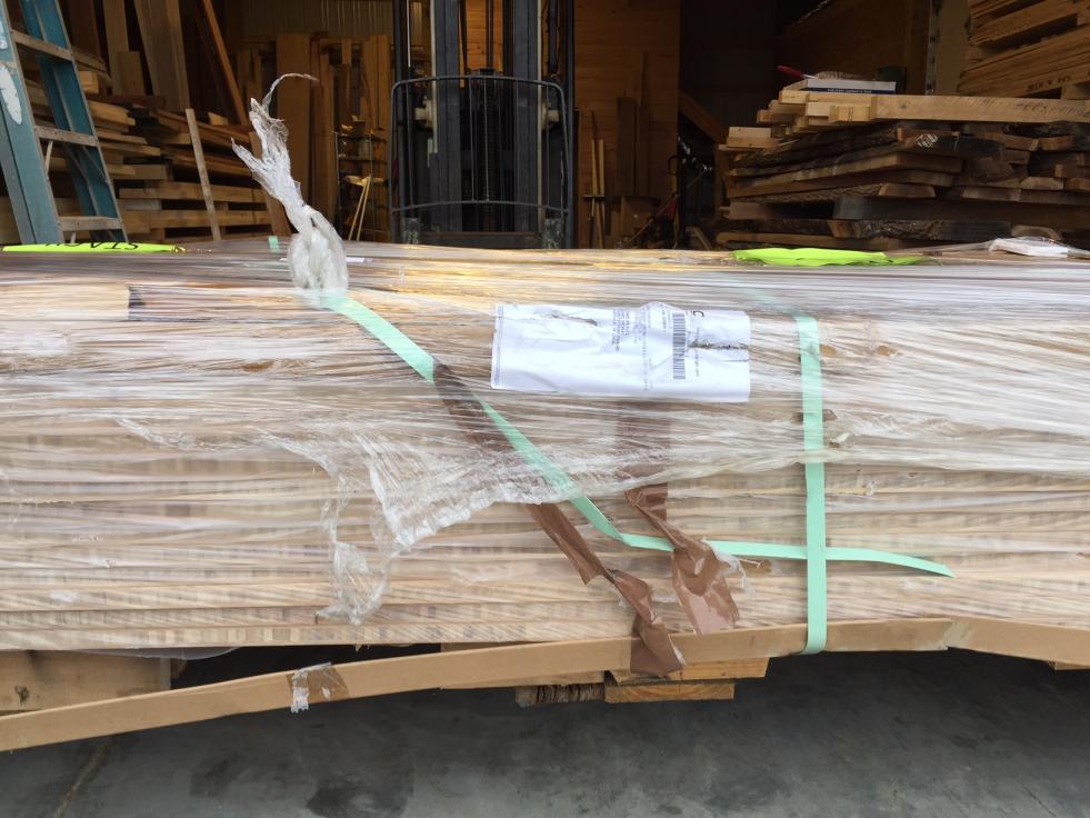

                        Good news from Steve today, too, as the LBL ply has arrived at our vendor.

                        Now, this is one of the weirder posts I've ever made, as regards methodology- I'm posting from Edge on Windows 10 running in a virtual machine on a MacBook Pro I just bought off of eBay and upgraded to handle running test interface and data acquisition from an Audio Precision as well as more LspCAD work.
                        Anyway, maybe 2016 will be the GE year- "Progress is our most important product". Gonna involved some jumping through hoops I think!

                          Good new! 1200lbs of LBL is a lot. How many speakers do y'all plan on building?

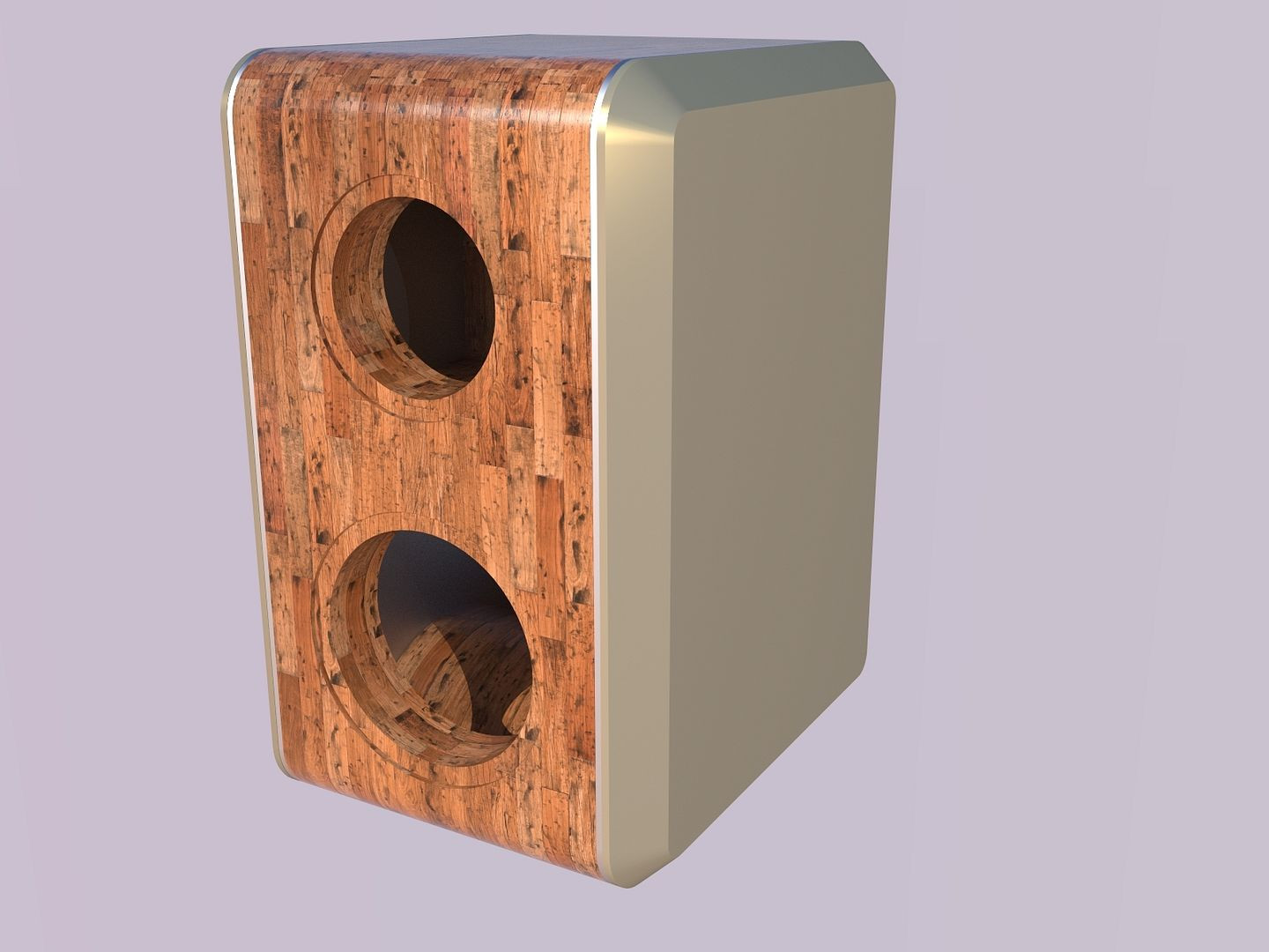

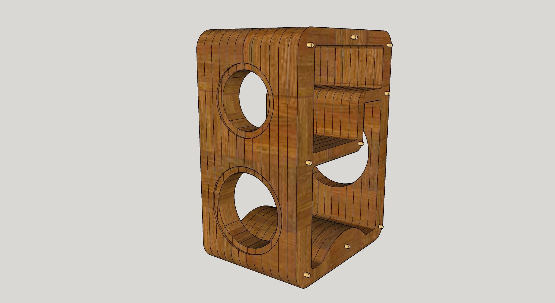

                            Think Translam construction.
                            One pair, with a pair of stands, as visualized above. These will use as much or a bit more than I used to build the Isiris three ways. Translam is not an efficient way to use wood, but it allows most of the hard work to be done with CNC milling, and gives more freedom in cabinet design.

                            Now, I'm sure some will say this is kind of crazy, but keep in mind the target design is the TAD Compact Evolution One, which is basically a 6-1/2" woofer ported with a 5" concentric midrange tweeter driver, (that costs $28K per pair) so we're going for bear using the 8-3/4" long throw SW223BD02 Wavecor woofer with Scanspeak 10" PR, plus the 7" Seas C18EN001. So, for a variety of reasons related to some of the target usage of this particular pair (CLASS D amplifier evaluations, including within my day job), going a bit further for the investment on this seems justified, in a certain light.
                            We talked about using BB ply, but the problem we see over and over again with that kind of ply is delamination of the material in Translam enclosures. Additionally, the woods it is made of just aren't nearly as hard and strong as LBL. That doesn't preclude someone else from trying BB ply or even specialty high strength MDF; but that is up to the constructor.
                            So, yeah, for DIY, this is sort of a "Magico" class effort, IMO. A bit over the top, I'm sure some will think. But the use of CNC facilitates some extra bang for the buck, in my opinion. It's interesting to note, what I would say is my generation calls this DIY, but Millenials call this Maker movement. The latter is characterized by more effort to use technologies more advanced than a table saw, whether it is CNC cutting or 3D printing- I have 30-ish quasi-relatives and relatives involved in what is known as the "Maker scene". It's an interesting contrast in approach.
                            But you know what they say, if some's good, more is better, and too much is just enough! :B
