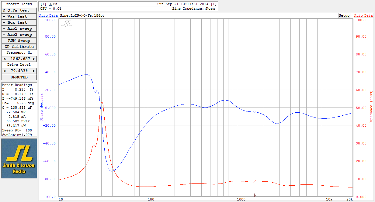

    In a 30L enclosure with the Wavecor PR using no added weight, just the stock cone mass, for a PR FSP of 15 Hz, we can get a fairly flat alignment down to about 23 Hz. To say that will spank the M8a two way is one of those understatements that beggars the imagination. But then, the SW223BD02 is a bit more power hungry, and features about double the Xmax of the HiVi driver. What's hilarious is that this sub style driver has a higher resonant peak break up frequency- some good engineering there.
    From one cabinet we should be able to crowd close to 100 dB anechoic all the way down to the roll off point:

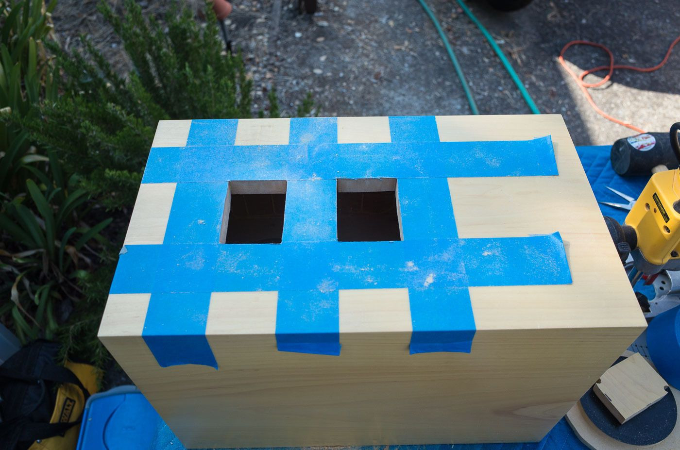

    In the meantime, I'm gluing up panels for side walls and getting ready to transfer testing back to the Livermore homestead- it's a little too industrial around here for GF- can't hardly blame her!

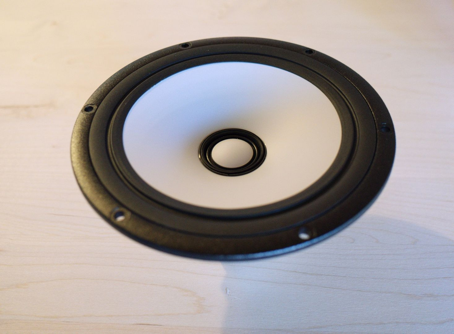

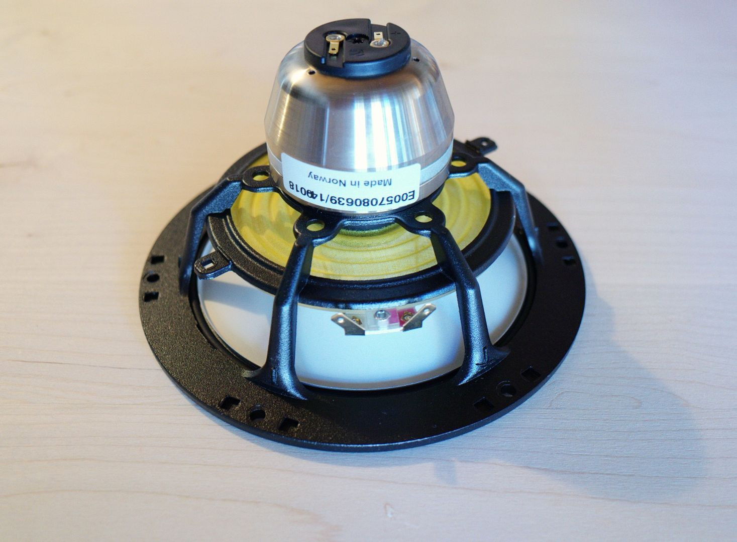

              The C18EN001 should be delivered today- I'm going to be at home, and I've signed the delivery release! I'm looking forward to seeing and measuring them after seeing Troel's measurements. I've got the box and baffle already setup... still hoping to keep this in the range of 26-27" tall, outer dimension about 12" wide, and something like 15-17 or 18" deep. A largish stand mount or shelf mount box... have an idea for a tapered side front bevel, and bevel at the top. Gotta find some time to work on CAD drawings....
                • 16202
                Since it's not real on the internet without pictures, voila, Pictures!
                These are little gems... I'm sure not inexpensive to make...
                Can't wait for the weekend and some time to mount them up and test!
                Last edited by theSven; 24 June 2023, 16:41 Saturday. Reason: Update image location
                  There are many reasons why I would enjoy using a pair of those

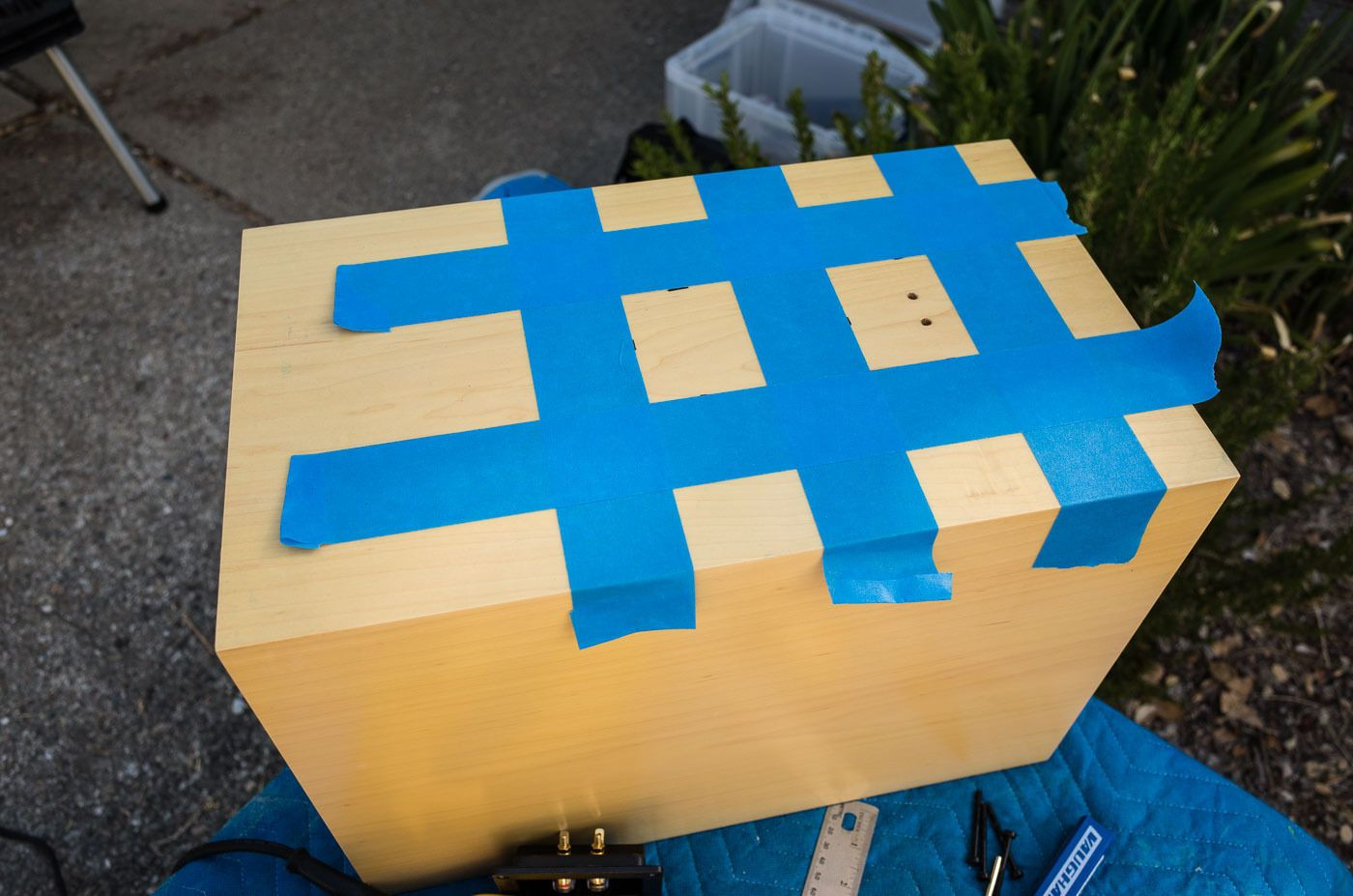

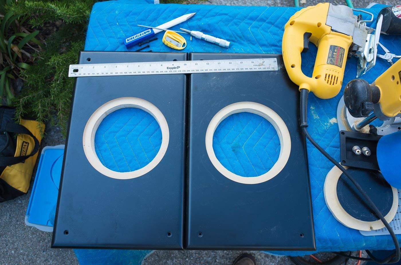

                          First path of attack was the cabinets, I unpacked one of the two extra Maple 0.75 cu. ft PE cabs I keep in the shoe closet, and masked it off (literally) for some inexpensive Dayton binding post cups.
                          Pretty easy to cut out without messing up,
                          and what do you know, but they just drop right in. (truly not what I would call challenging wood working...)

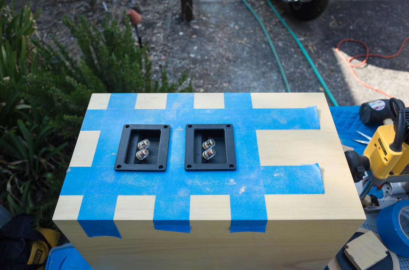

                          Because it occurred to me that I might actually want to prototype a pair of these and evaluate the crossovers before building the final cabinets, I went ahead and routed another front panel up...

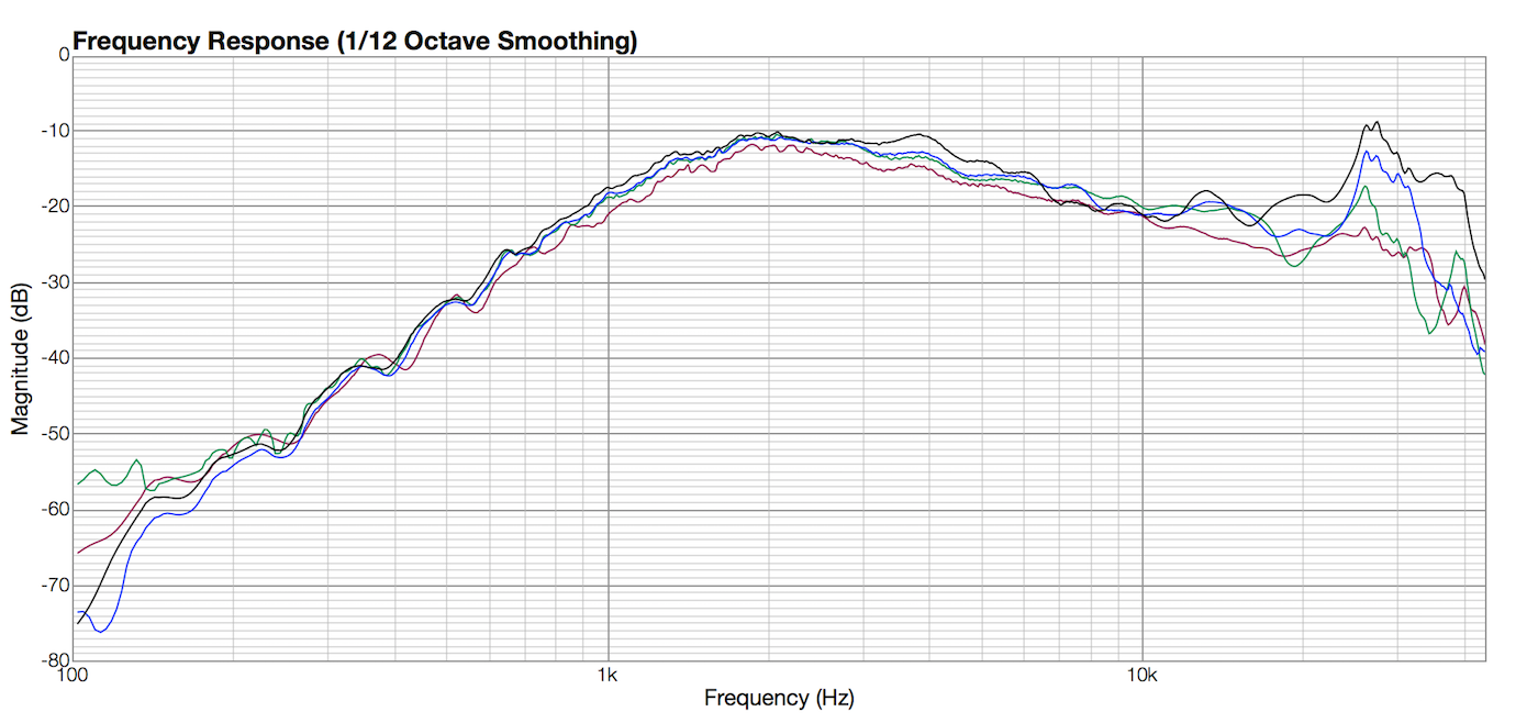

                          Not any big surprises here, either good or bad. All measured at 4.25 VRMS, a bit hotter than the normal 2.83 VRMS. Scope monitored.

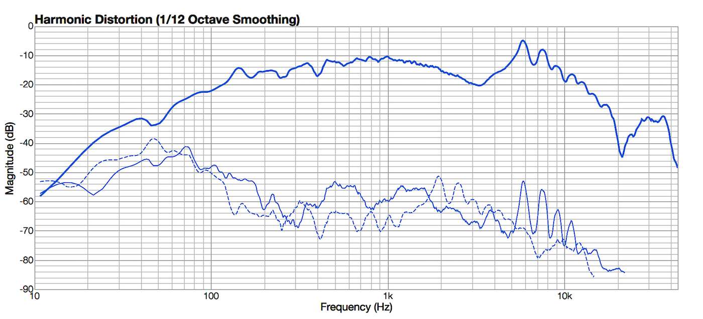

                          On axis, 15 degrees, 30 degrees, and 45 degrees, midrange.
                          Distortion on axis. A bit higher 2nd than 3rd, to be expected.

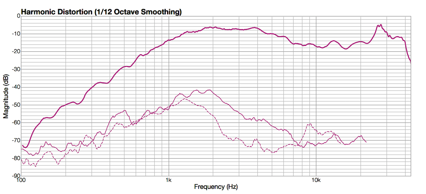

                          Tweeter measured the same way, from 0 degrees to 45 degrees.
                          Pretty similar to Troels' results, but with above 20kHz also.
                          Tweeter distortion up last, note that by graphing with dB, you get a lot more relative difference at the bottom end of the scale-
                          Really not bad, though not astoundingly good, either. Perhaps "quite serviceable" would be a good expression?
                          What will be interesting to see is how nice a crossover can be put together, and how the final result looks. Certainly looking like some kind of acoustical 4th order at roughly 2 kHz.
                          Last edited by theSven; 24 June 2023, 16:43 Saturday. Reason: Update image location

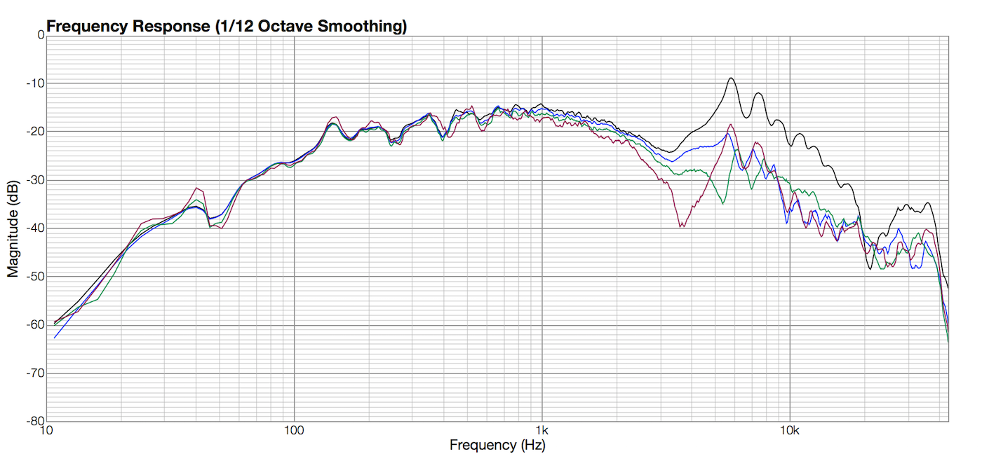

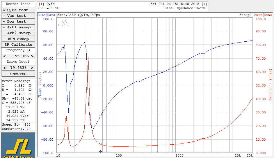

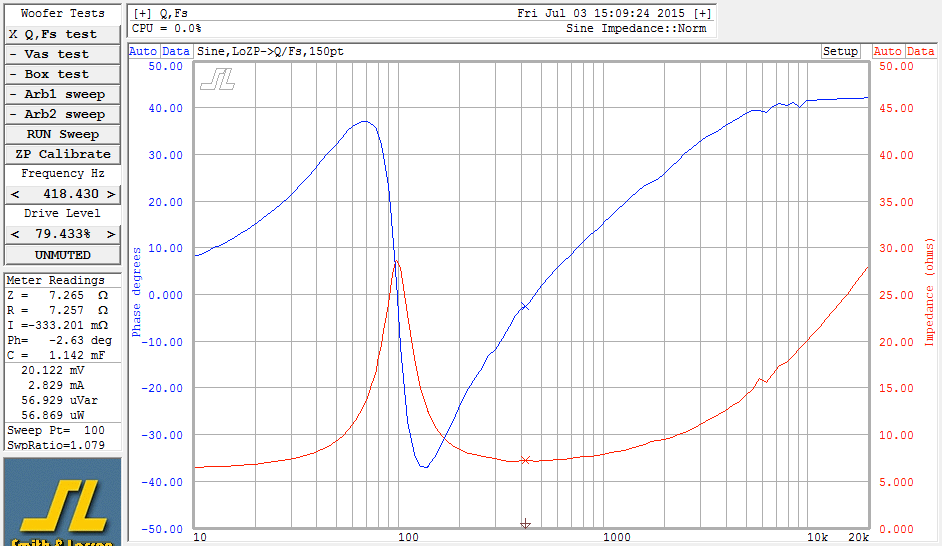

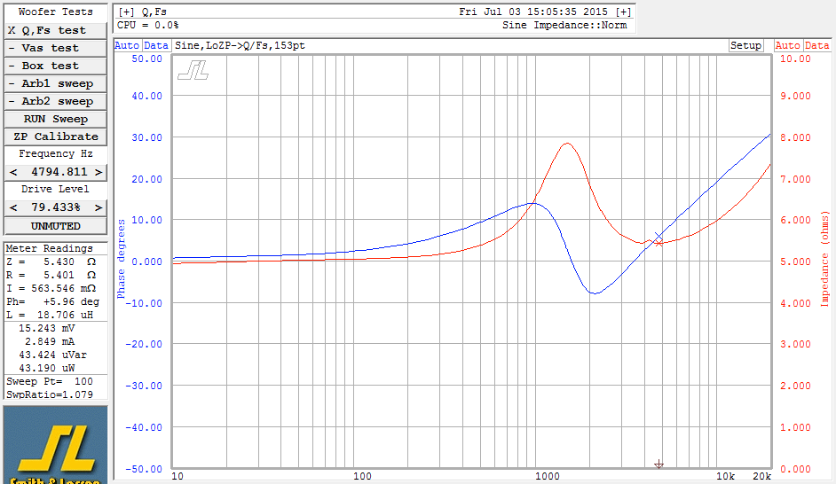

                            Of course, we're not done collecting data. But this gets it a little closer:
                            SW223BD02
                            C18EN Midrange
                            C18EN Tweeter

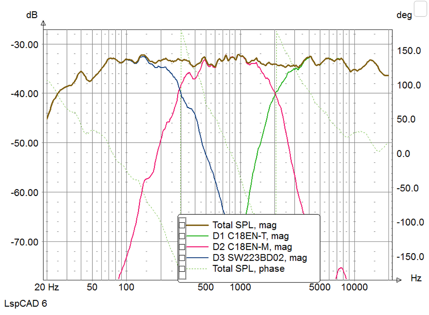

                            Definitely going to need a full zobel around that fundamental tweeter resonance- it's been ages since I've seen one up that high!
                            I'm thinking 350-400Hz for the woofer to midrange transition, though a bit higher would allow a less expensive crossover; I wouldn't go over 500Hz; that would be just 2 octaves for the midrange, with a 2K or so crossover to the tweeter. I don't see the mid working well for a crossover point beyond 2200 Hz.
                            Last edited by theSven; 24 June 2023, 16:44 Saturday. Reason: Update image location
                              Looks like the standard SEAS performance. 3rd harmonic dipping to around -60dB and then hovering at -50dB for the most part, with the 2nd around -50dB. Excellent performance really but not quite as good as the best. I am glad you did distortion measurements, Troels' always does % scales that squash out the fine detail, these let you see everything as it actually is.
                              With the midrange breakup causing the peak in the third order you most certainly want to use a 4th order 2kHz minimum on it. Luckily the tweeter, with the wave guide loading of the mids cone, should be able to handle that without issue. It even has a decent amount of output down to 1kHz, quite surprising for a tiny dome like that. Your measurements at a higher drive level are nice to see because they give you more of an indication of what the tweeter can do. Troels' lower level distortion measurements show rising 2nd order below 2kHz, but at the higher drive level it starts to rise far higher.
                              Your measurements also show somewhat nicer 2nd order performance on the mid down at its lower end, it should easily be able to cope with a 150Hz 4th order no problem if you wish to go that low.
                              Linear distortion is very nice for both, nice and smooth, especially the tweeter, amazingly it's smoother, both on and off axis, than some standard tweeters! The breakup is fairly benign too. I really want to use a pair of these.

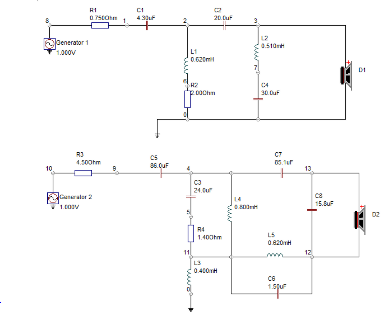

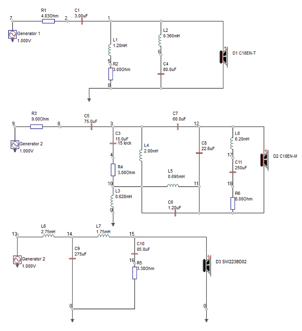

                                Once more, unto the breach...

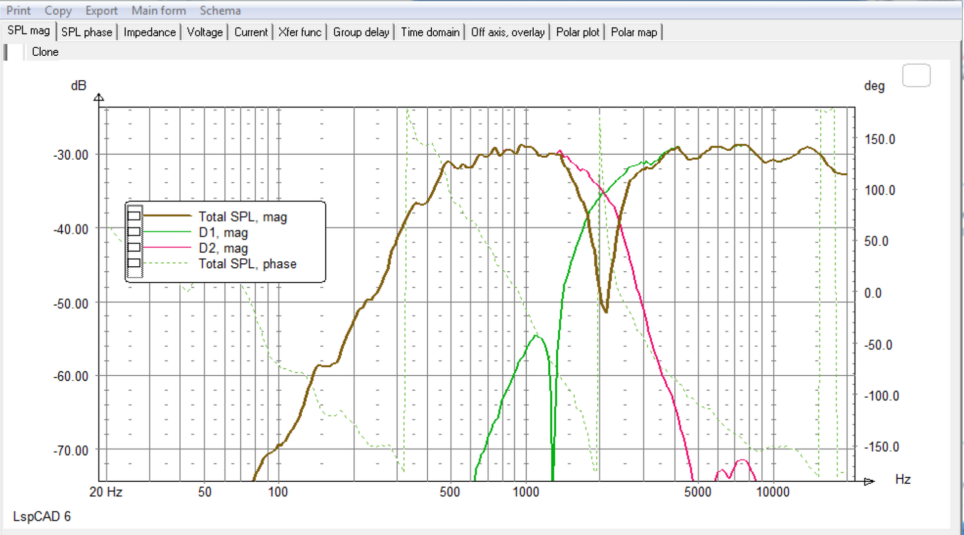

                                Well, believe it or not, I didn't just dive into whipping up some typical crossover... no sir, not me!
                                Let's "phase it", metal cone drivers can give anyone a case of "audiophilia nervosa", and looking at the response curves of the C18EN001 made me realize it was likely a bigger challenge than even the estimable Dayton RS-180 with it's hideous breakup peaks- that, and the high Fs and limited low frequency capabilities of the tweeter...
                                BTW, I made an "executive decision" to use the 15 degree axis as being the most typical of the averaged forward response, in this way, I think the forward averaged power response will be more accurate than using the direct on axis curve.
                                Hmmm, seems like a job for the Dark side.. reaching back into my older, more evil bag of tricks. Can you say, "elliptic filter"? How about, "high order LR acoustical targets"? Well, LR6 acoustical for the mid and tweeter.
                                The one thing particularly working in favor of that sort of approach is the coincident time aligned configuration- in fact, that makes goes a long way to making something that is possibly border line feasible quite realizable, if not quite a walk in the park. :twisted:
                                All I've been working on is the midrange to tweeter network. I figure a plain old LR4 will do nicely for the mid to woofer; for now I'm thinking around 300-400Hz, to keep the component cost in check- yes, we could take this down lower, but then that would also lead to cost issues with the woofer crossover.
                                So, here we have "Exhibit A".
                                Believe it or not, this IS an effort to keep the component count down. Remember, the midrange is component rich, and there's a LR4 acoustical high pass in there, too!
                                How's it look?

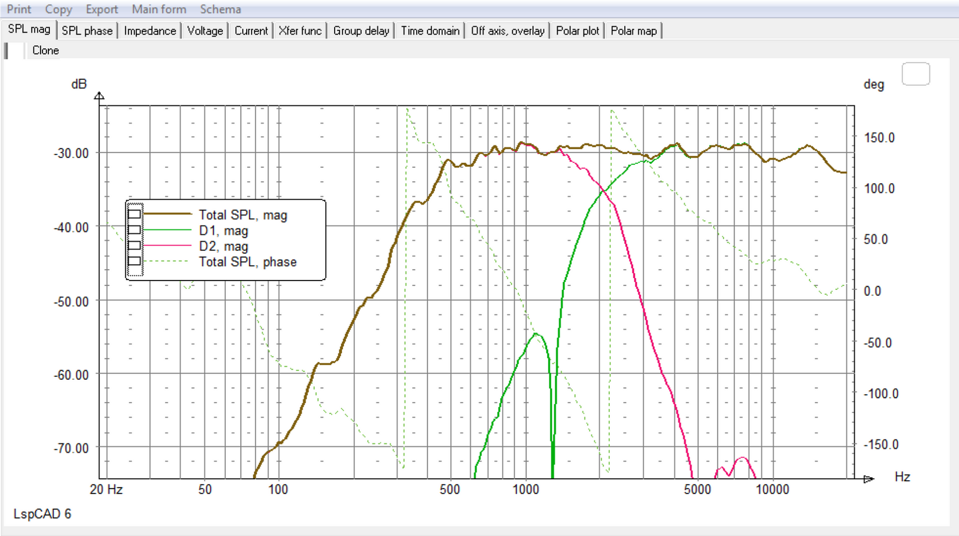

                                Pretty dang good, I think, as regards the overall pass band, and the suppression of break up modes.
                                Of course, the obligatory inverted phase response:
                                Nice deep symmetrical null, and I believe that's exactly what you'll measure, as there won't be lobing issues from non-coincident drivers. And being coincident drivers, the summing in the crossover region with the normal connection will be as complete and ideal as possible, with the best overall forward power response in the crossover region.
                                I can't emphasize enough that I think the time aligned coincident configuration will allow this crossover configuration to perform and sound much better than with conventionally mounted drivers. And I believe the extra attenuation is really necessary to give the C18EN001 it's best chance to bloom.
                                Of course, there may be other voicing issues to address; with as uniform a forward power response as I suspect we'll wind up with, some down tilt from the crossover region may be desirable, and adjusting the input resistor to the tweeter network has that effect. Obviously, a lot more work to do, but for one day, I think this is some real progress, definitely getting a handle on things.
                                Last edited by theSven; 24 June 2023, 16:45 Saturday. Reason: Update image location

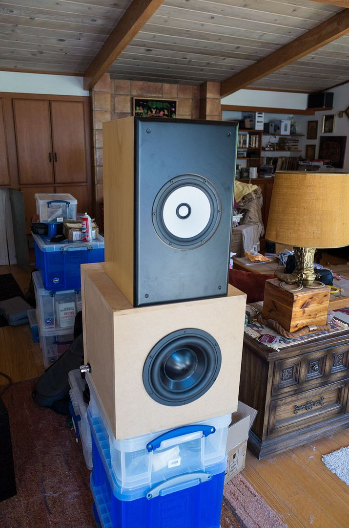

                                    The configuration shown above is just for prototyping. I'm planning a 12" wide by about 26-27" tall by about 16" deep bamboo cabinet for everything, with a three layer front panel, with a tapered bevel top to bottom on the sides, and bevel on top. Gross volume about 48L, with a tapered midrange enclosure front to rear, plenty of room for crossovers internally. Might have a partially removable back to facilitate that (behind the midrange; woofer/PR chamber completely sealed separately.)
                                    These have two planned functions: monitors for music recording and mixing, and also possibly demo monitors or evaluation speakers for the Class D SMPS project, which seems to be a full go ahead, based on the response to my proposal. Demo room reserved at CES. I have NO idea what the class D module guys use as reference equipment, but based on a sort of 3rd party eval of their current pride and joy, it could be better, perhaps. Anyway, I'm leading the local team, developing two scalable designs, one in the "low power" range, (225W) and another in the high power range (1kW max for now). And I think I have a cool plan and concept, but shouldn't talk about it online until we have running hardware. Maybe not even until January.
                                    A lot of this is like a contingency plan - it's a situation I never expected to find myself in, where I'm doing audio related work at work (actually did some a couple of times before, but not with this exposure or impact). Leasing a team on this, working with the El Segundo TM manager.
                                    So that's why a more portable digital source system is being put together (the Auralic Aires should ship shortly, to go with the Auralic Vega and Mutec that I have; I'm going to build a LLC resonant SMPS supply and Rubidium oscillator into a small Par Metal chassis soon). I have no idea what the IR guys use... I'm going to be prepared- if I have to go to CES and demo it, and also for subjective evaluations (I'll build a version compatible with nCore modules, too, and I have my M22 as a reference. On the module side, the big deal is the expansion of GaN based versions, for higher switching frequencies, and moving the output filter load dependence well above the audible range.
                                    I am jazzed about yesterday's work- the crossover actually started out in Modula/NatP territory, and quickly evolved into something a bit different as I wrestled with the whole midrange thing. I also quickly concluded that LR4 just didn't provide enough suppression of the break up modes, or protect the tweeter on the low end, but LR8 was just a bit twitchy for component tolerance, though at one point I had a nice version of the tweeter high pass working nicely that way. LR6 elliptic filter just ended up "feeling right". (that's what happens when a musician and psychologist tries to play an engineer on TV...)
                                    Of course, it's the listening that will be critical- I'm debating building a sort of low cost parts version crossover just for measurement basis and initial listening before buying all the expensive caps... and of course, wondering how far to go with the caps this time... :W
                                    Now, after we get the GF's big activity of the day out of the way (Danville 4th of July parade, she is one of the participants) then I'll do some "normal" measurements of the SW223BD02+PR box, and see how close we can get to a finished crossover.
                                    I don't want to sprain my arm patting myself on the back, but I'm starting to think these are going to rock, to use an older turn of phrase. In an old school sort of way, hence the thread title. But when I started the thread, it was just a hope. Now I think I can taste it a bit, after the work finished yesterday.
                                    And they'll confuse the average person, too, because from the front, there will seem to be just three woofers of different sizes: one seven inch, one almost nine inch, and one ten inch. I love it... :B
                                      At 12"x27"x16" they will go in the element nicely but I bet they are going to be very heavy and require a sturdy short stand.:T
                                          Click image for larger version  Name:	C18EN-LR6-4_zpsyvp0ovm4.png Views:	0 Size:	179.0 KB ID:	942381
                                          Interesting coincidence: in terms of parts count you're right where Andrew Jones was on the S-3EX concentric: 10 on the mid, and 7 on the tweeter.

                                                  I've got a couple more sets of woofer measurements, trying to get cleaner ones while still indoors (it's 96 here...) and almost through integrating that with the rest. And I'm trying moving the lower mid crossover point down a little further...

                                                    Well, it's only a sim, and unfortunately I had to up the component count after lowering the midrange to woofer crossover frequency, and doing my best to optimize the phase in the mid roll off as well as all the other things going on- the Fs driver impedance was an issue.
                                                    Took out one cap, added in a conjugate network for impedance compensation, that I just decided I had to have to get the midrange roll off to really behave properly.
                                                    The SPL magnitude and phase behavior looks pretty good, could have been nicer looking if I had outdoor measurements- too hot!
                                                    But this will be a good test for load invariance in amplifiers, as with a nominal 4 ohm woofer the impedance is sort of punishing in the low end, being around 3 ohms from 50 Hz to 250 Hz. So, while the speaker should have a nicely extended bottom end, if the amplifier or power supply doesn't, it will likely be obvious...
                                                    Baseline will be any of my Aragon's (8008 X3, or Palladium Monoblocks) or the NAD M22. The Palladiums are kind of like the "anti-Class D" amplifier, being about 100W in class A, and not clipping with 8 ohm loads until close to 600W. Pretty brutal power supply. Of course, they weigh about 72 lb. a piece, too. If this ends up being able to compete with that at all, we just may have something. Thats a big "if" though.
                                                    I'll probably look in the parts bins and see how close I can come to roughing this out and testing it; I can always unwind some inductors to get values I need. But we'll have to see if I have time to do that during the next week- have a lot of logistics chores and other stuff on the to-do list.

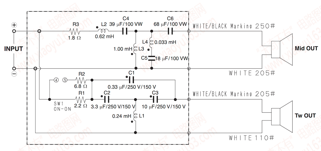

                                                    • DS-21
                                                      • 171
                                                      They're supposed to be.
                                                      Everything past this sentence was too much for me, whether it's talking about "tonal balance" in amplifiers (IME, the only amplifiers with tonal issues are ones that aren't load-invariant, i.e. ones that mess up the FR) or the technical details. (I have no mind for electronics, and no incentive to learn because the performance differences in electronics throughout my exposure to this hobby - i.e. since the mid-1990s - have been minimal to non-existent unless something really sucked.)
                                                      I presume from your statement that the S-3EX crossover is posted somewhere on the web? I'd be curious to see it...
                                                      No, it isn't. At least, to my knowledge it wasn't until this post.
                                                      From the service manual:
                                                      Tweeter:
                                                      Midrange:

                                                          Well, those Pioneer schematics are very interesting! A remarkable coincidence, or just engineering inevitability? The first time I used an elliptic filter in a crossover network was in an 8" two way project I designed in 2003, and which was published in 2004 in AudioXpress - same component topology in the tweeter network, because if you're doing a modified 4th order electrical converting one element to an elliptic filter, there just aren't many ways to do that.
                                                          Bandpass crossovers see a lot more variation- especially depending on what the driver performance is, if you're working near a natural roll off point of the driver, or if you have to go full boat electrically. The most effective way to do a complex high order bandpass is to split the series elements to opposite sides of the signal path - again, converting the last element to an elliptic filter. There aren't a lot of different good options for how to do that, if the basic electrical intent is similar...
                                                          Have you built or modeled the Pioneer crossover? (since you have those drivers) How does it look? I did come across the crossover for the in wall using that driver, but it's quite a bit different...
                                                              Now I get it. I was puzzling over exactly what was going on there.
                                                              No, but it's on the to-do list. I actually use them with the stock in-wall crossovers (dual-woofer model) and for the left/right speakers use Anthem ARC to get the bass balance right. Other mod is two F-13 felt strips between concentric and woofers to reduce diffraction. It's admittedly a total kludge that should not have lasted as long as it has, but it works pretty well and I find myself wanting to listen instead of tinker when I have free time. I may try to find time
                                                              In the future, I expect I'll be using some variation of that circuit (all three standalone models with this driver use a similar circuit design with different component values based on desired voltage sensitivity, etc.) for the concentric, except with the midrange highpass reduced to one pole (that just to protect the driver from DC) and just go active from midbass to concentric. Since I already own a miniDSP and enough amp channels, the cost of going active is much less than buying big coils to build and tweak a midbass passive crossover. Also that way I can use whatever midbasses I want, be they 94dB/W/m B&C's or 85dB/W/m Revelators, without worrying about matching things up.
                                                              But enough about my future vaporware project. I'm eager to see what you come up with next for this pairing.

                                                                    I think this is going to be a fair amount of fun, once I get them running...
                                                                    There are multiple motivations, including wanting to try out a nice concentric driver, and also intending "deliberately, and with malice aforethought", to make a test system this is something of a b*ll-buster as regards impedance characteristics and testing the old concept of load invariant amplifiers. If the LspCAD modeling is correct, it will be in the 2.5-3 ohm range from about 60 Hz up to over 200 Hz, but as you'd expect, going much higher in portions of the midrange and high frequencies, due to the waveguide operation and resulting crossover. Not at all like the Wavecor Ardents or the Isiris; for example, the Ardent is one of the most benign to drive systems I've ever designed, varying between about 5 and 9 ohms, due to the behavior of that funny 3rd order crossover alignment I like:
                                                                    But that's a big part of the reasoning, to have a challenging test speaker for some of the power supply and Class D work I'm going to have to do over the next six months.
