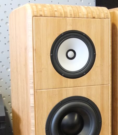

                                                    • 1670
                                                    #430
                                                    Other solutions:
                                                    - Add a front cover, like on the picture below. Will not fix the problem, but it will not be visible any more.
                                                    - Add some kind of visual separation between the top, middel and bottom that prononces and covers the problematic areas. Like a gasket or something.
                                                    Last edited by theSven; 26 March 2023, 11:52 Sunday. Reason: Update image location
                                                    • cochinada
                                                      • May 2014
                                                      • 661
                                                      #431
                                                      Originally posted by TEK
                                                      Other solutions:
                                                      Those look like fillets of some kind of wood but the idea of some sort of gasket is interesting indeed.
                                                      BTW can you guys please show me some links of builds with curved faces not using translam but curved sheets? I'm searching here in the forum but can't find many examples.
                                                      It's too late for me but I'm curious and would like to study the subject and see if and how I could have built mine in a different way.

                                                                            So, I have a feeling of déjà vu but the challenge is immense. I don't know if it is because the drivers are removed but now this vertical gap on the baffle looks huge! I don't know what is worse...
                                                                            I'm waiting for my carpenter to come and pick up this box first.
                                                                            The gap...
                                                                            and the crack...
                                                                            Last edited by theSven; 26 March 2023, 11:53 Sunday. Reason: Update image location

                                                                              Hi, first of all, sorry if this has been adressed earlier, i only joined the forum today, and have just skimmed through this entire thread.
                                                                              The cracks is IMO natural and logig, because wood tend to move alot more one way then the other, lengthwise (thinking the way the three grows) it is shrinking very littl, but the other way it is moving alot, when you have built the speakers like you have with the baffle using the "length" of the wood and the cab sides the "width" of the wood they will shrink and expand differently, and eventually crack, even with plywood this will be true, just not as much as if you used hardwood.
                                                                              My guess to fix this permanently would be to either get a perfectly constant humidity and temperature in the room (almost impossible) or cover all the wood inside and out with something 100% water and diffution proof like epoxy...
                                                                              Really sad though, its a beautiful build.

                                                                                Yes that makes perfect sense. The most curious is that the crack happened exactly in the middle of one entire layer but not between two different layers. So the problem was not with the gluing but with the material itself which according to my carpenter was of the highest grade available here and this wasn't supposed to happen this way. I think it's also possible to see on the picture that half of the piece has cracked in one direction and the other half on the opposite direction. Weird stuff really...
                                                                                Anyway, after much pondering I decided I'm going to paint them. I think, under the circumstances, that it is the best way to solve all these visual problems with the gaps and so on.
                                                                                Unfortunately it's not possible anymore to cover the inside walls with epoxy or any kind of material as there is no access to most of it. This is even more the case since they are already completely filled with acoustic stuff and with the cables soldered to the rear terminals which I'm not going to remove. Just the thought of it makes me tired and anyway it wouldn't help. There was a chance perhaps to have done this before gluing the outer panels but now is too late I'm afraid.
                                                                                For those who are curious I've decided to go with.... piano black. :P
                                                                                Yes, I know it will reveal all minor imperfections if the preparation is not up to the higher standards but I'll give it a shot, mostly because the only color that I find in harmony with my living room would be some sort of metallic red dark tone but I already have a pair in red and I want something different.

                                                                                    I'm afraid not hiding the wood means living with all the flaws and possibly becoming worse with time so...
