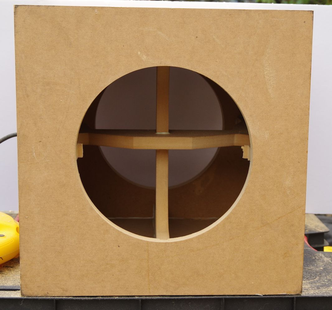

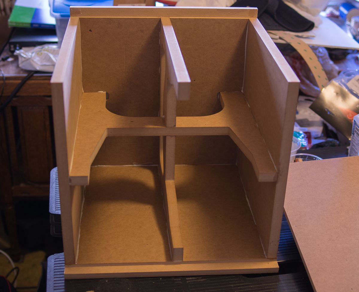

    Enclosure
    The ideal enclosure starting point should be ~40L, well braced, compact in dimensions, and as a stretch goal, available with a cutout for the driver matching the Seas L26RO4Y. Note the mechanical dimensions of the Seas woofer.

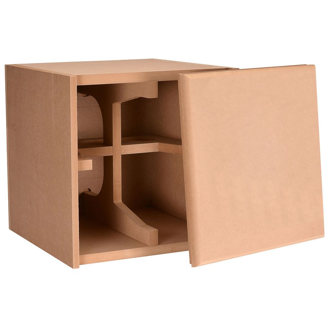

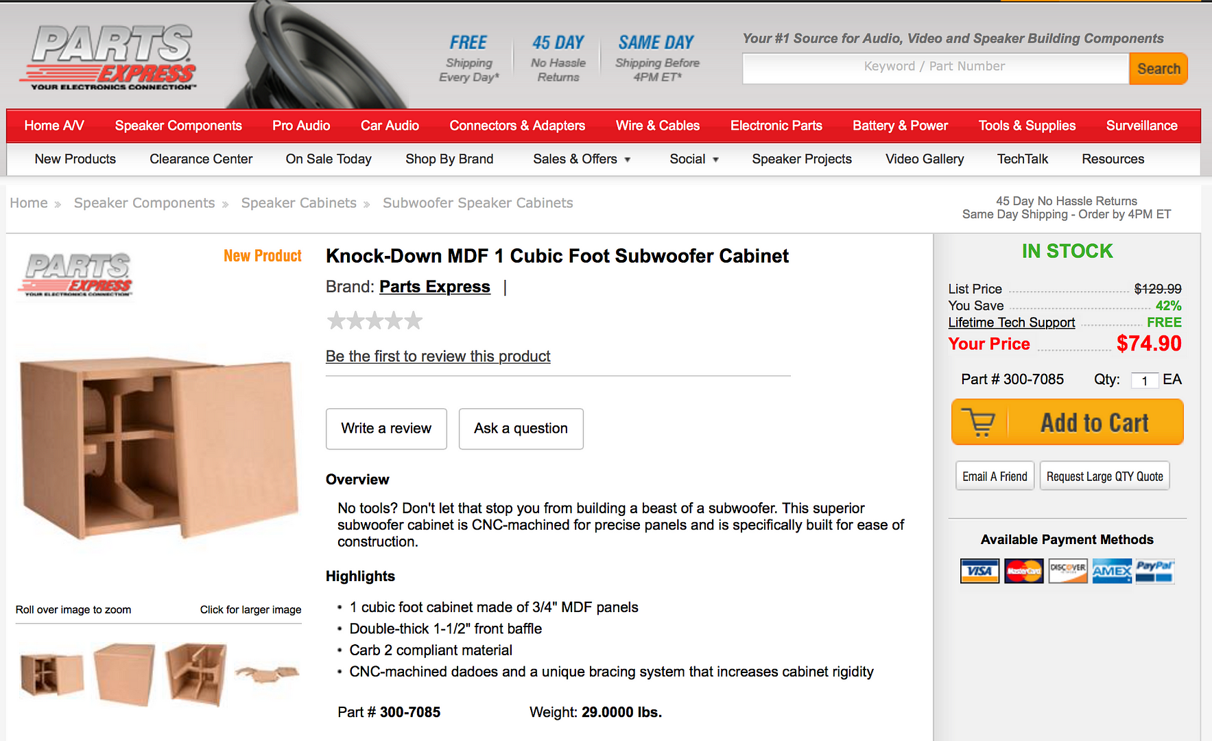

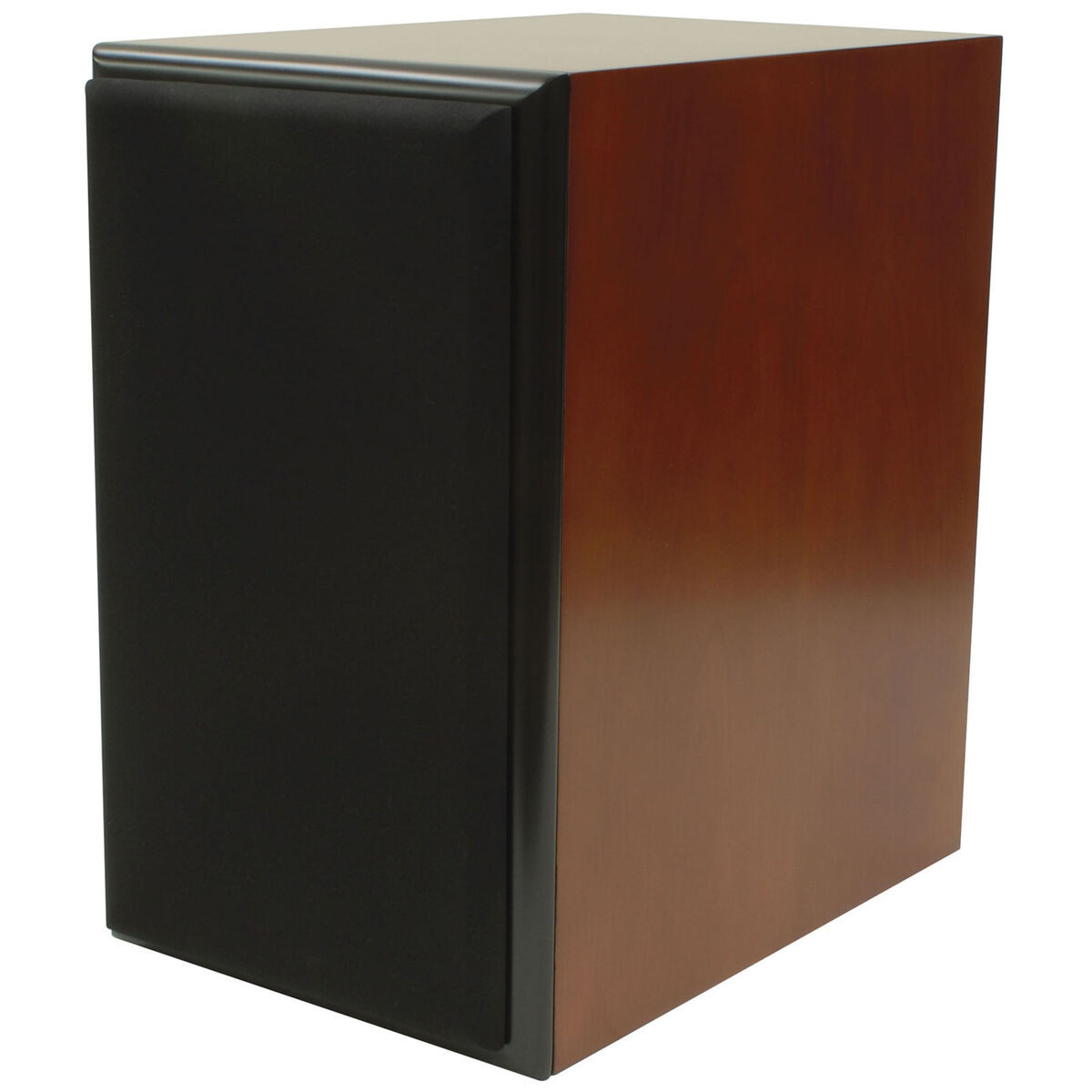

    Sometimes, the Force is with us....
    PE Enclosure for Ultimax 10" subwoofer
    The L26ROY fits quite well in the rebated mounting for the Ultimax woofer, being just very sightly smaller in outside frame diameter and cutout requirement. Construction of one of these to test is nearly complete. Details, including modifications for optimizing the PR mounting, will be posted soon.

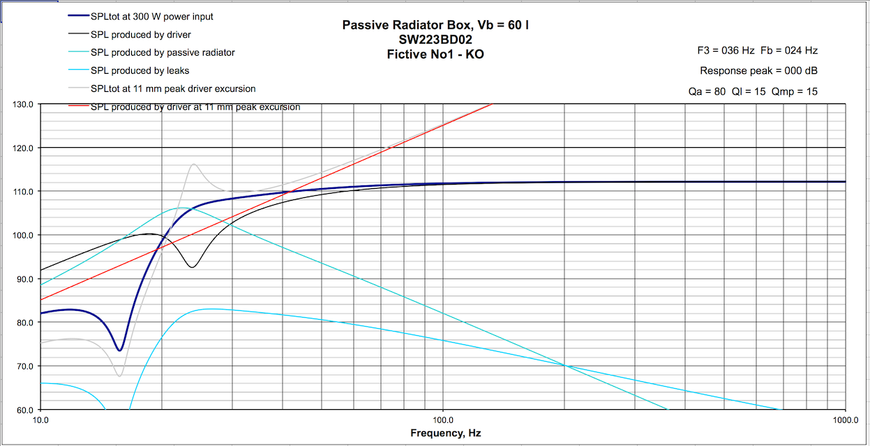

    What do we mean by not stressing the drivers? This is the predicted cone excursion with 100W to 2 drivers, the same nominal 50W working per driver- clearly, over 3 dB of headroom exists for the woofer and PR.

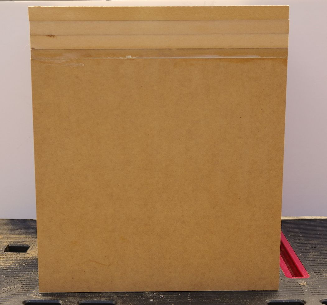

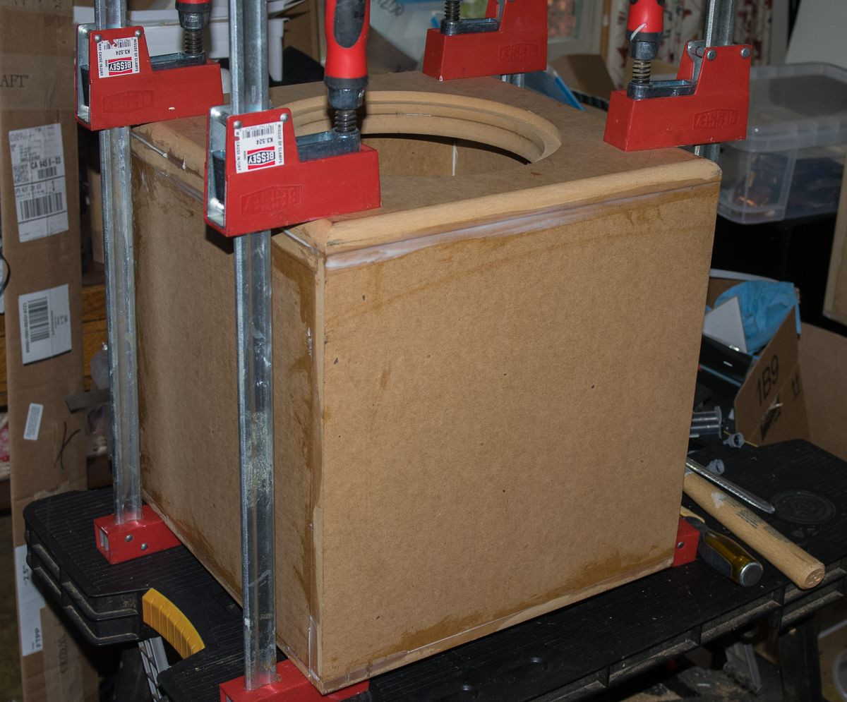

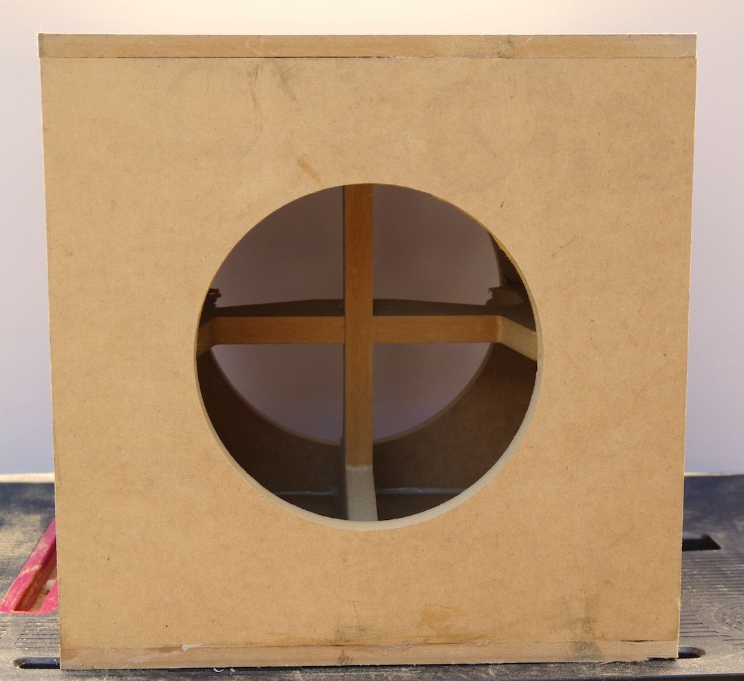

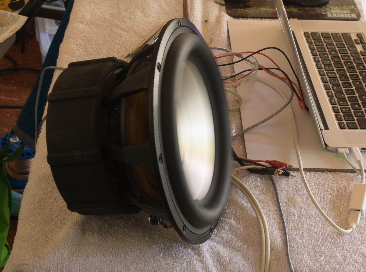

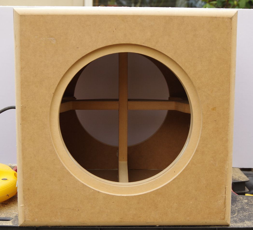

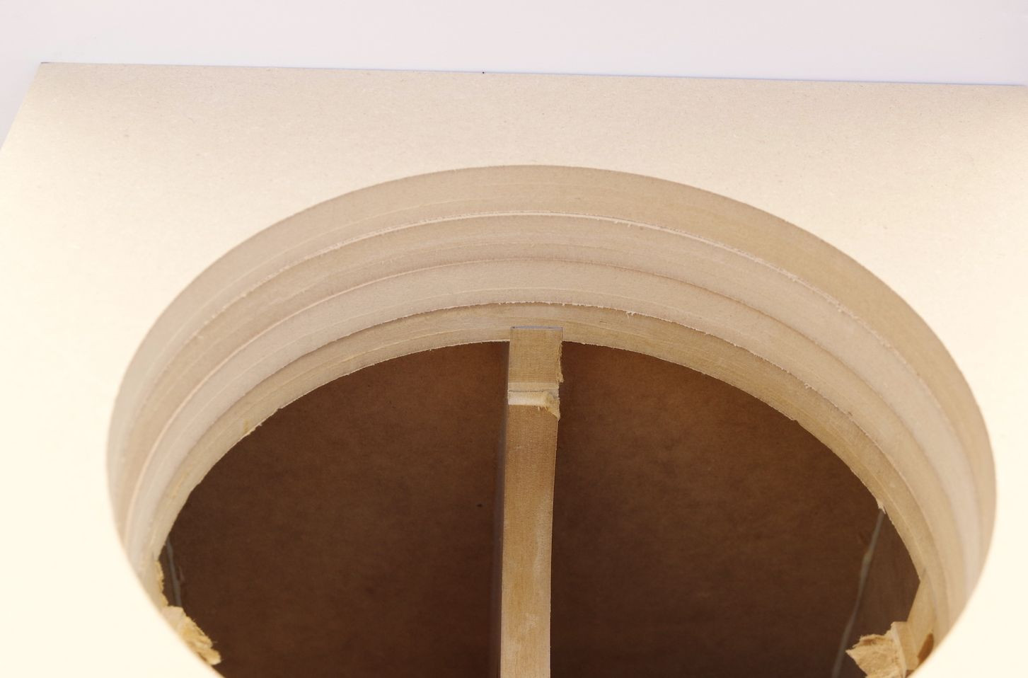

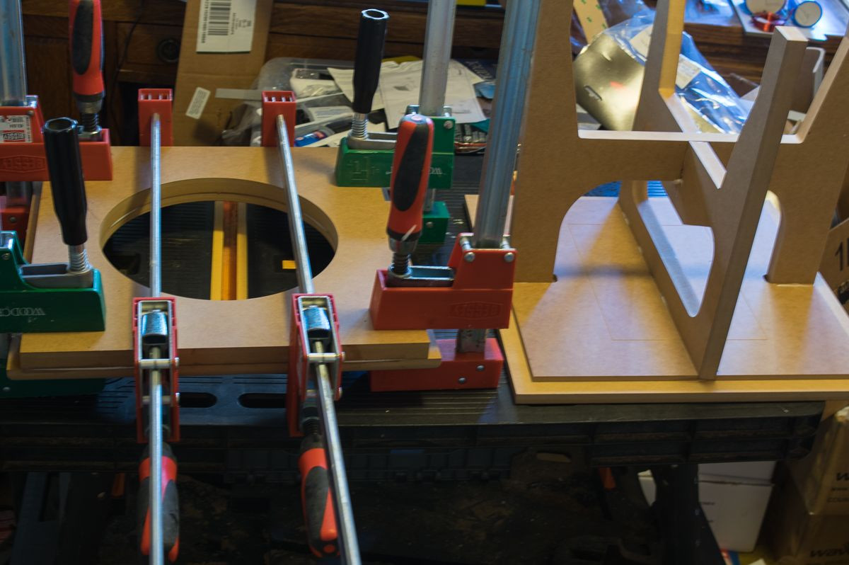

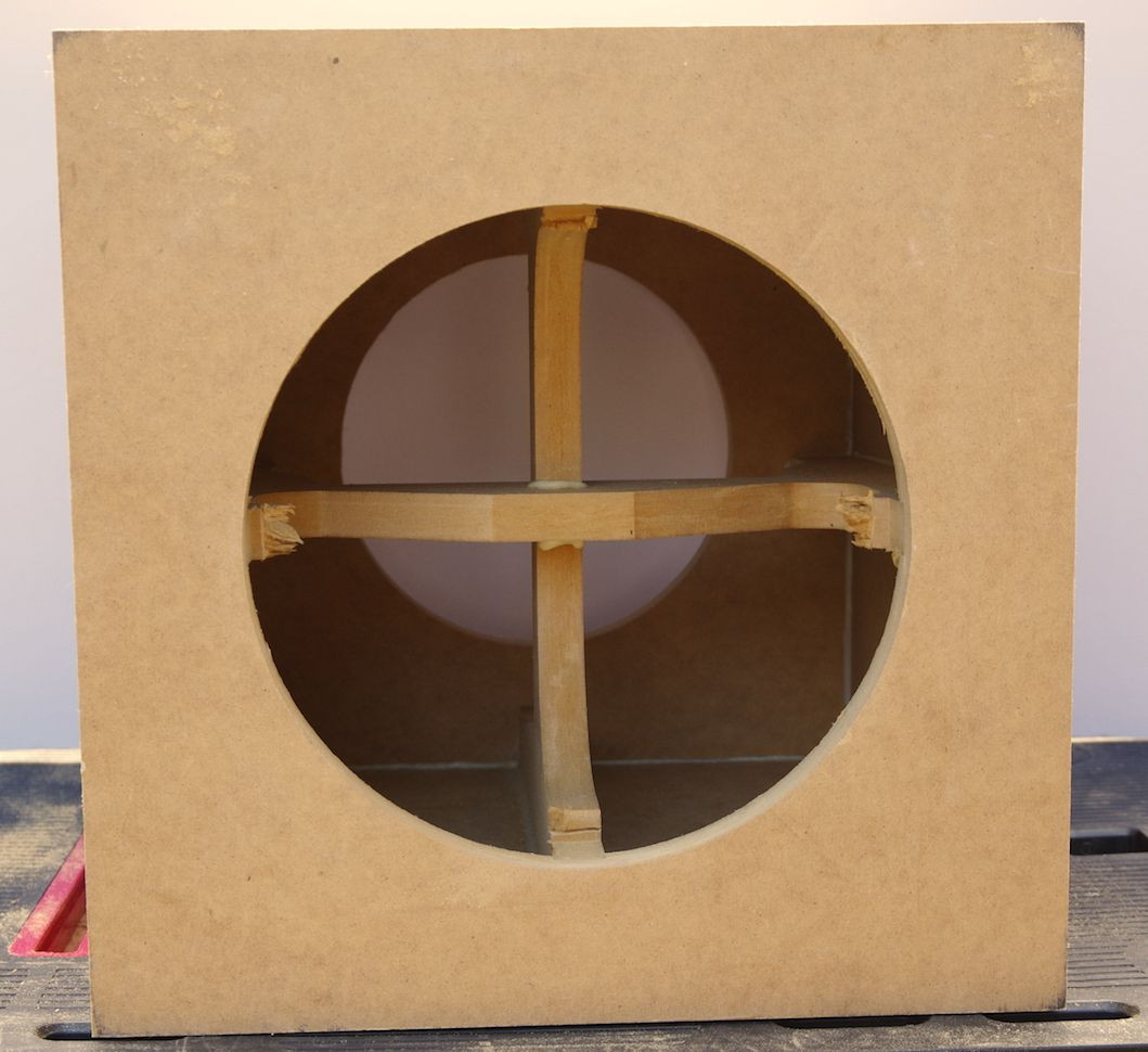

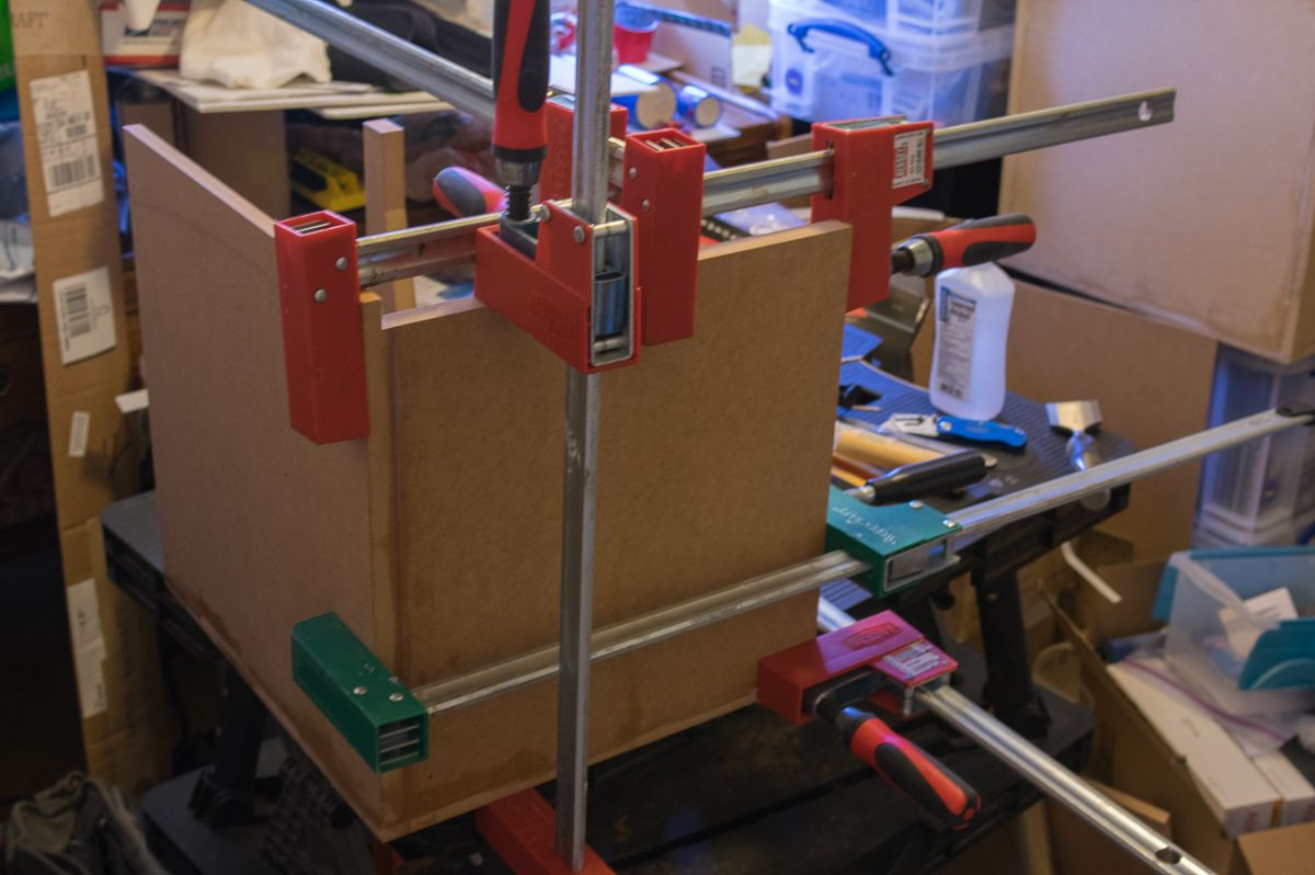

                      The easy part of the assembly work for the first test module is complete-
                      A short break in was applied, but it was probably not early enough to fully bed in the driver....

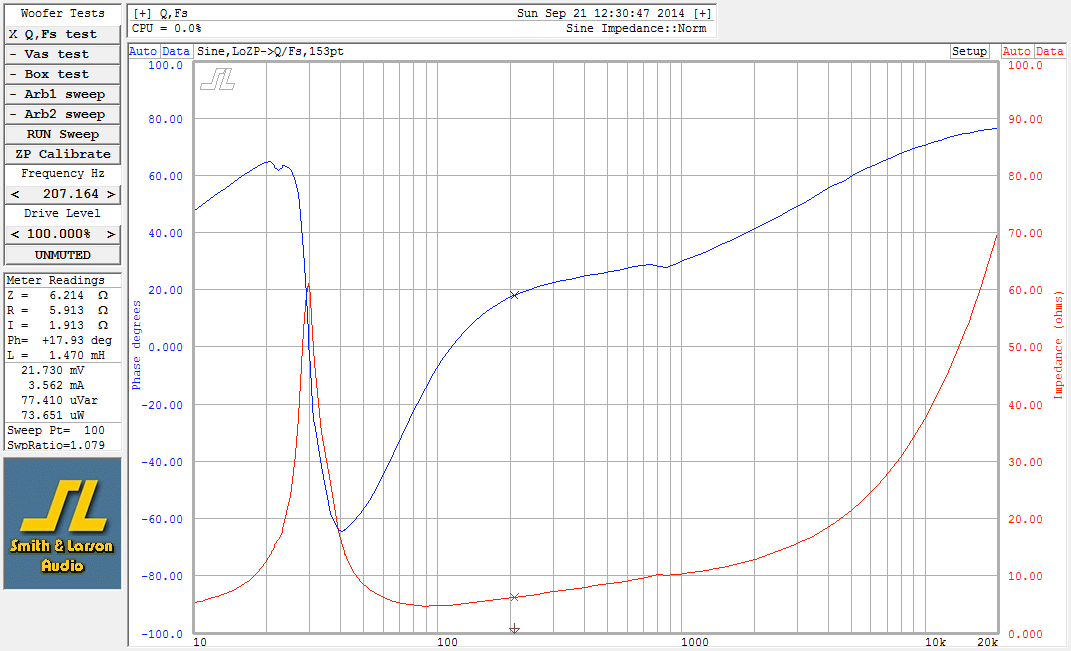

                      The impedance curve was recorded, and base estimated T/S parameters noted- the impedance curves looks clean and with good behavior in the intended operating range.
                      Buffer[0] Q,Fs Ver 7.01
                      Completed: Sun Sep 21 12:28:17 2014
                      Drive level 100.000% [3.540 mA]
                      Sine,LoZP(LV/LA)->Q/Fs,153 pts
                      Re = 3.1827 ohm
                      Fs = 29.6943 Hz
                      Zmax = 60.8791 ohm
                      Ro = 13.8925 ohm
                      F0 = 20.8794 Hz
                      F1 = 41.7602 Hz
                      Fmin = 207.1638 Hz
                      Qes = 0.3431
                      Qms = 6.2196
                      Qts = 0.3252
                      Le = 818.7447 uH @1k
                      XLe = 10.3122 ohm @1k
                      PLe = 29.9246 Deg @1k
                      ; Approximate Impedance Fitting Constants ;
                      ; (Improved with Completion of Vas Test) ;
                      Krm = 224.606E-03 ohms Freq dependent resistance
                      Erm = 346.627E-03 Rem=Krm*(2*pi*f)^Erm
                      Kxm = 27.769E-03 Henries Freq dependent reactance
                      Exm = 664.760E-03 Xem=Kxm*(2*pi*f)^Exm
                      The next step awaits the arrival of the first test PR, and double checking the overall depth- it is likely necessary to build up another layer or two on the back panel so that when the PR is installed it will clear the existing bracing design.

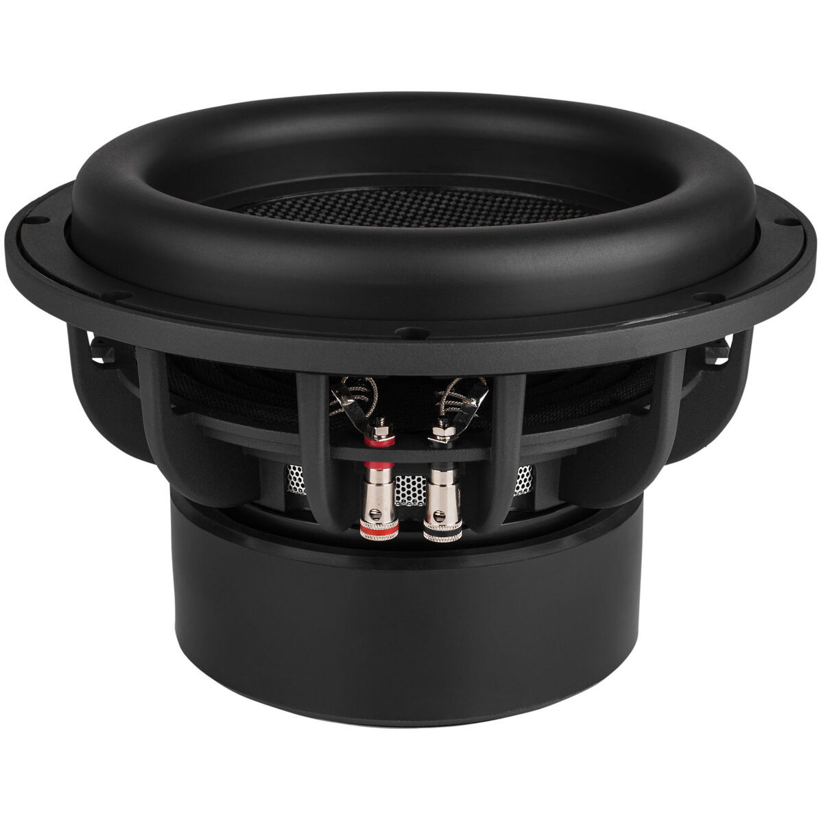

                        In addition to the proposed test configuration, a determination has been made to test the "logical" driver for the UMAX 10" woofer cabinet. One is now on hand, and the construction protocol may be modified in order to first test in in sealed.
                        The Dayton UMAX driver has a few interesting characteristics-
                        • Relatively low cost- $139 USD
                        • Max of 19 mm
                        • Copper sleeve and pole cap to reduce distortion
                        The knock down enclosure is designed for this driver, in principle
                        Even a PR solution seems possible in this size enclosure, with the same PR type as for the SEAS.
                        Whether this is actually realizable remains to be seen, but the potential for high output level, perhaps not at as high frequencies, is clearly interesting...
                          Those drivers sure are built like a tank!
                            • 16203
                            You're not kidding, these are pretty brutal looking drivers, both spec and performance wise, and don't cost an arm and a leg...
                            It will be interesting to see how the European solution stacks up versus the US/Taiwan contender.

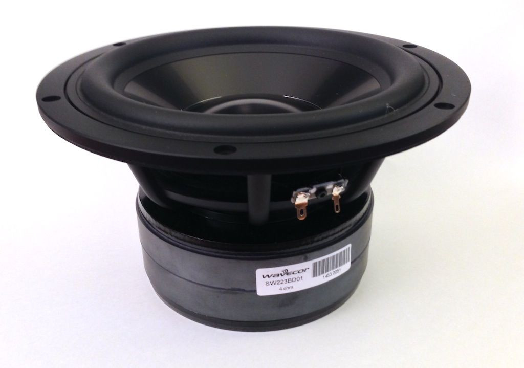

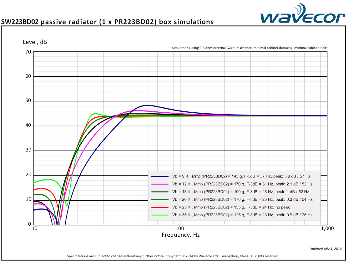

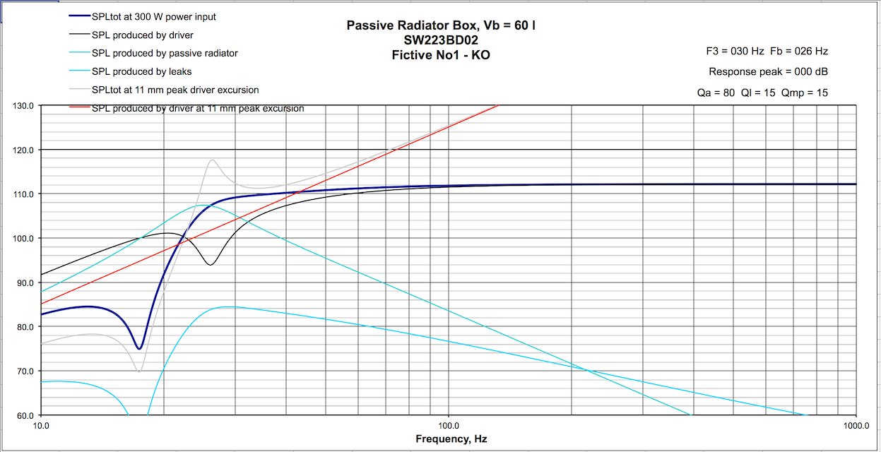

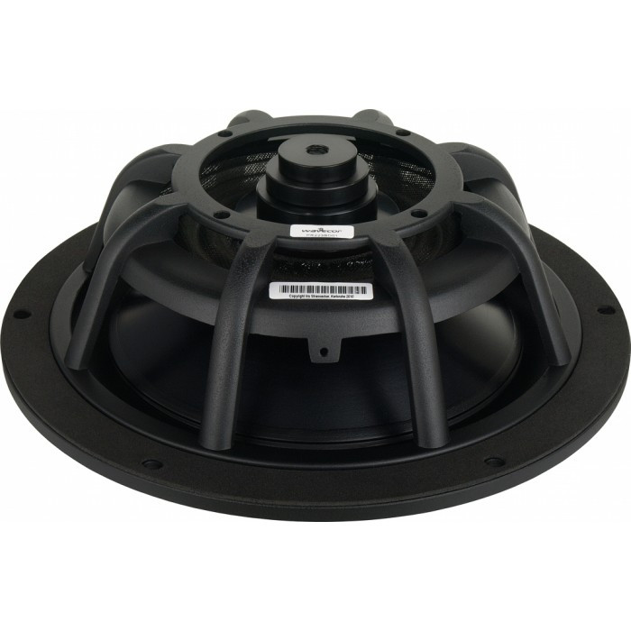

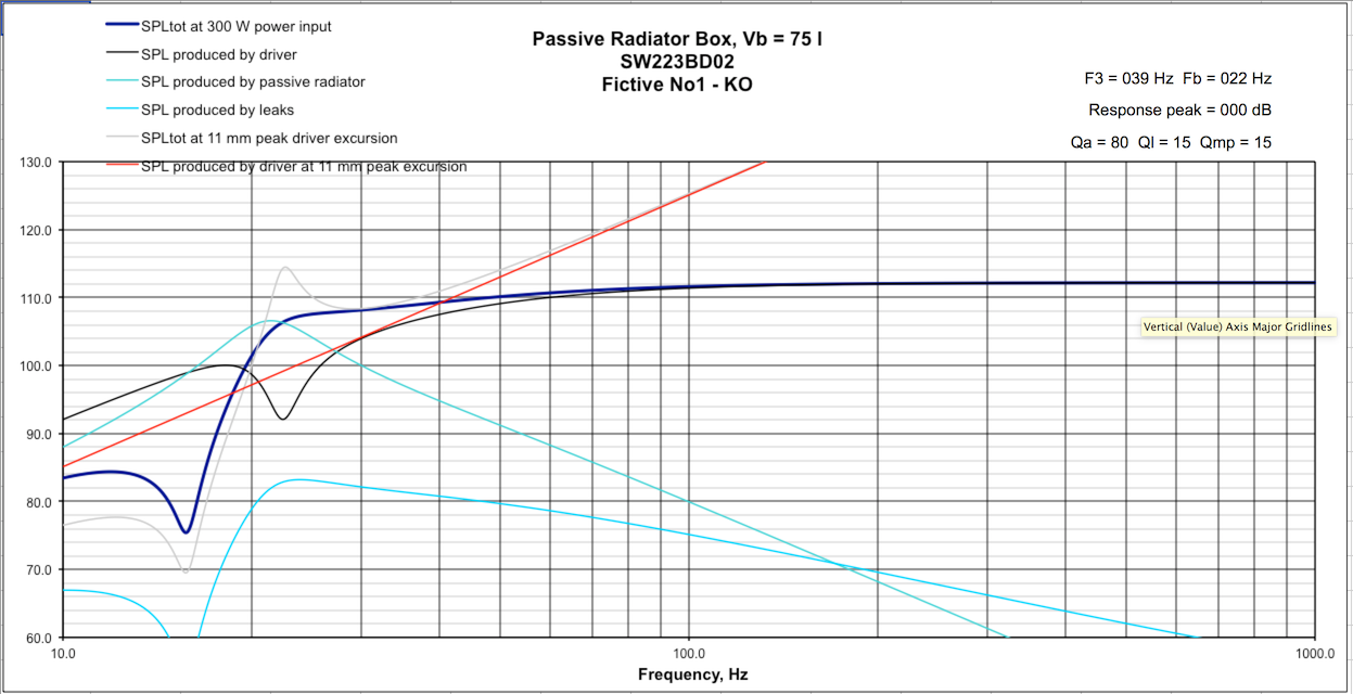

                                            Another, more compact alternative to evaluate
                                            Another possibility will be evaluated- for situations requiring a very compact solution with minimal footprint
                                            The Wavecor SW223BD01 delivers nearly 11 mm of Xmax, with using a "Balanced Drive" motor design (low 2nd order distortion) with low noise at high excursions, and can deliver low Fb's in fairly small enclosures. On the other hand, it does pay a price in sensitivity, and it is more expensive than the norm for this size driver.
                                            The principle advantage to consider is compactness- combined with LF extension-
                                            The response alignment for a 25 liter net enclosure with MMP of 155 grams is well worth considering. In this case, a three driver array would only need 75 - 80 liters.

                                              Some calculations have been completed independent of Wavecor's PDF for the PR223BD01 combined with the SW223BD01...
                                              Using three in 60L , with no parameter changes from the base PR configuration:
                                              With extra mass loading on the PR to tune Fpr to the 16 Hz range:
                                              And with similar PR tuning, but allowing 75 liters net for three woofers and PRs:
                                              For a very compact system with small footprint, these configurations may have characteristics worth evaluating.

                                                I wouldn't be surprised if this PE knock down cabinet wouldn't work pretty well for the SW223BD01 + PR223BD01 combination:
                                                Only 14.25" wide, too...

                                                                  More work has been completed, and the SL26R PR is now available, and one is on order- though Seas provides little information on the parameters, and my own intuition is that the mass and compliance are not as optimized for the considered application as is the case for the ScanSpeak PR. Two more Scanspeak PR's have been ordered for evaluation with different LF drivers.
                                                                  In the case of the small footprint test cabinet for the SW223BD01 and 26W PR, the rear of the cabinet has been extended with an additional 3 layer stack-up; this eliminates the PR volume from reducing the working cabinet volume.
                                                                  The outside dimensions before adding the rear panel stack is a mere 14-1/4" on each side.
                                                                  This configuration does have an unusual aspect, with the 9" woofer mated to a 10" plus PR.
                                                                  Front View
                                                                  Rear View before adding the panel stack
                                                                  The test cabinet for the L26ROY is also nearly complete at this time.
                                                                  Front View:
                                                                  Rear View
                                                                  The testing plan initially will be to place the cabinet loaded with drivers on one side on a large concrete patio, and suspend a test microphone overhead, about 1M from the cabinet, to simultaneously capture the driver wave and PR wave, considering that at up to 200 Hz, 90 degrees off axis should be essentially omnidirectional.

                                                                          Setup for tests should be complete within the next few days... fortunately, assembly droids do not get time off for the Holidays...
