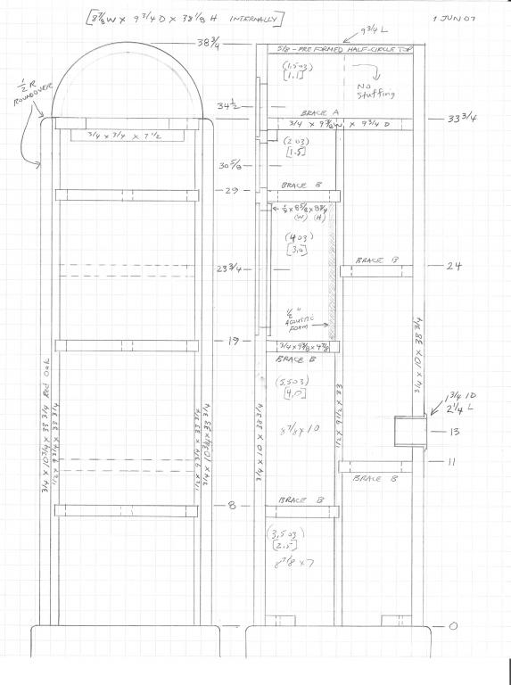

                              The TL cabinet had to be that large for a line about 5-1/2 feet long containing enough volume to achieve an f3 below 30 Hz.
                              Paul

                                I understand that- it reminds me of a TL line I did for a 10" woofer in the mid 70's, expect that system was taller and shallower. Long lines are big, no question about it!
                                Now, as this thread proposes to be about a compact 8" 3 way, I suppose a TL would be ruled out! :W
                                I suspect that Dennis optimized the height of the drivers and the enclosure design in consideration of typical seating height and the vertical dispersion of the Neo8.

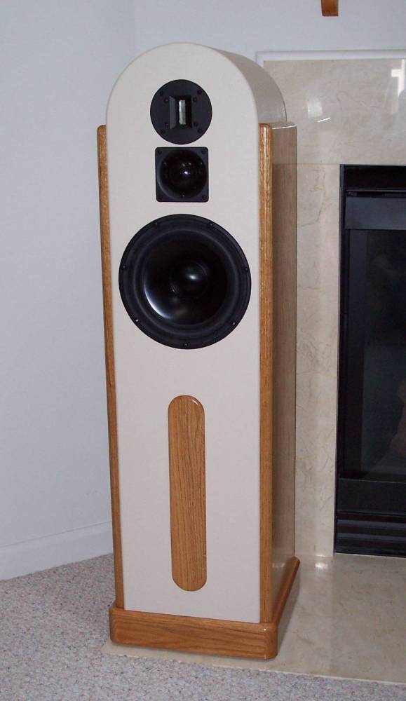

                                      You mean sort of like this?
Name:	Front without grille.jpg
ID:	859048Click image for larger version
Name:	cenTiLana Cabinet.jpg
                                      This design, Centilana, used the RS180-4, RS52 and XT19.
                                      Paul

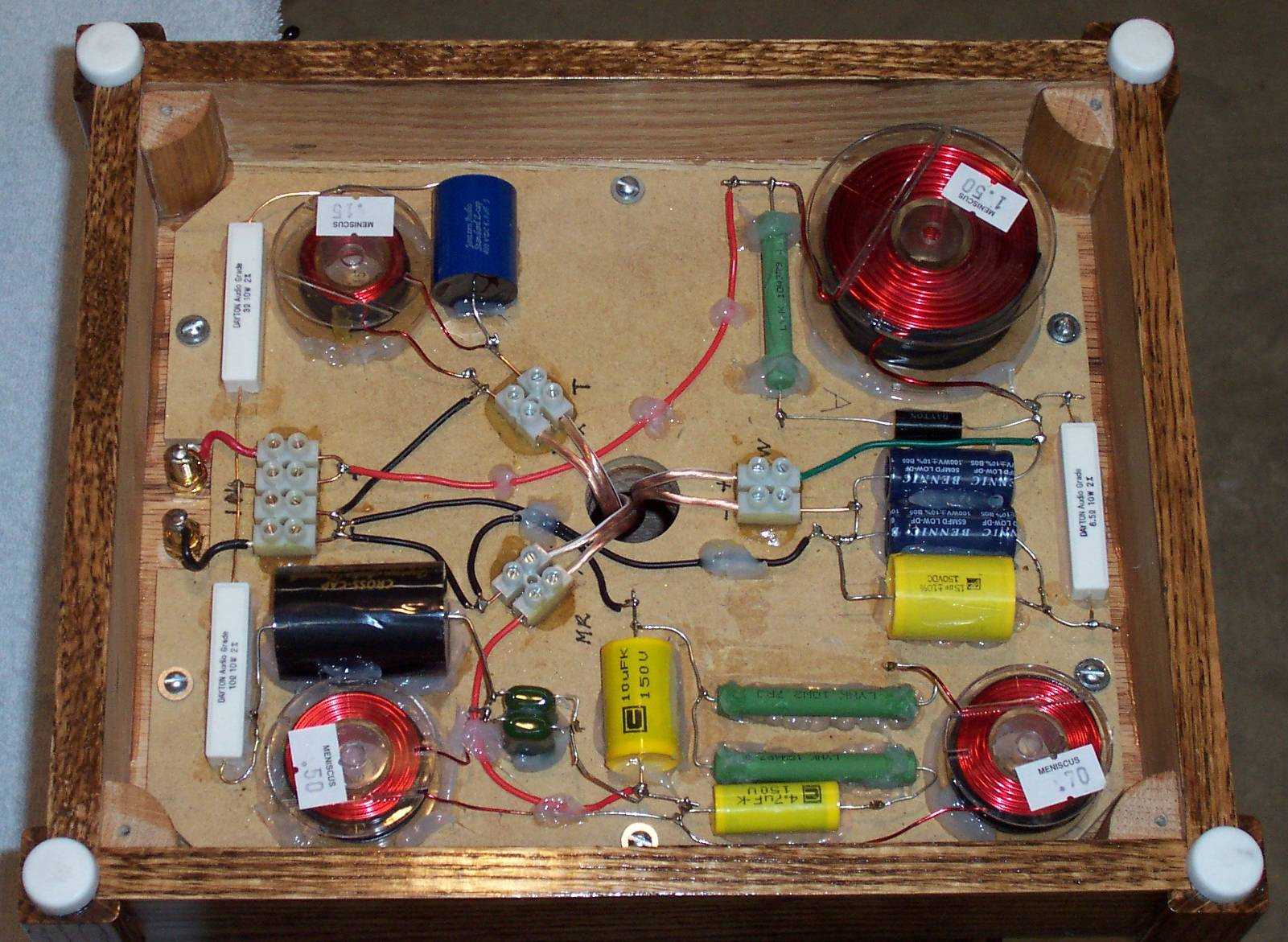

                                        And nice packaging of a 60" single fold MLQWTL or whatever it's being called these days! Any response measurements of the system? Looks very nice! :T
                                        I bought a bunch of Martin's MathCAD files some years ago; I should go back and look at them again...

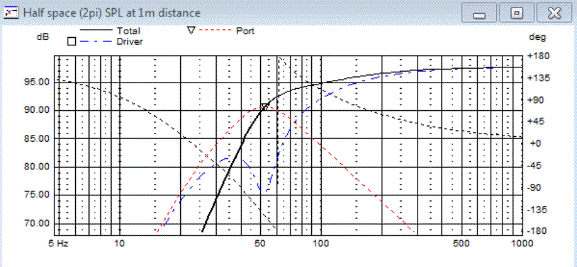

Name:	Centilana Response.gif
                                          Paul
                                          That's a very nice example; now what would happen if we just scaled that up to an 8" woofer, and investigated a range of tweeter options? Nice job building the crossover into the base...
                                          Click image for larger version  Name:	NewCrossover.jpg Views:	1 Size:	478.4 KB ID:	943105

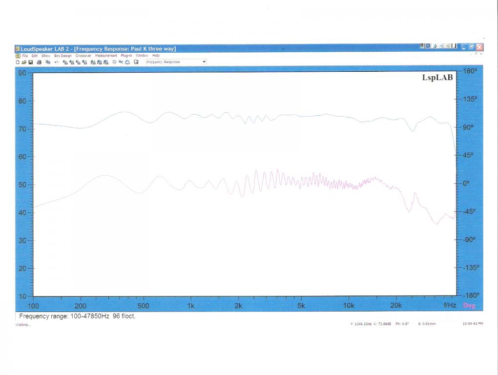

                                            I manage to dig up a measurement of the system response that was made at DIY Iowa 2008. I had a printout that I scanned in. The quality of this scan is not great but I hope it's adequate.
                                            Paul

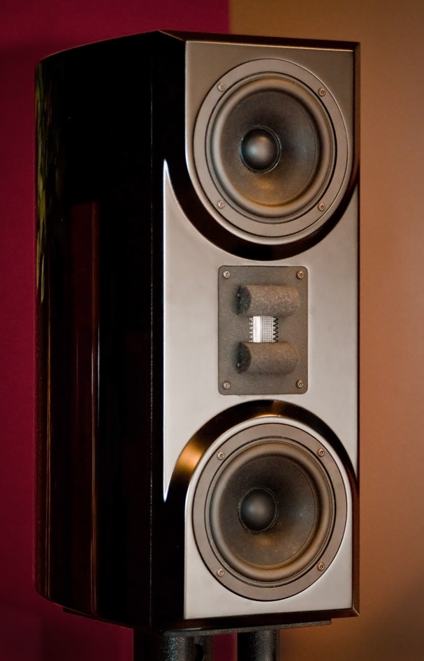

                                                      Well, after some recent discussion, another possibility has become apparent, though to realize it would mandate changing the name of the thread- Jon Marsh has been "persuaded" that his M8ta cabinets are not the enclosures he's looking for, and will relinquish them into my custody for possible rough prototype evaluations.

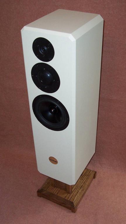

                                                                  Speaking of the SS 22W/8857T in a 3-way with the RS52 reminds me of my 3-way from 2007 using the very same woofer in a folded ML-TL with an MDM55 and NeoCD1.0, the canTiLena.
Name:	CanTiLena, no grille.JPG
                                                                  Paul

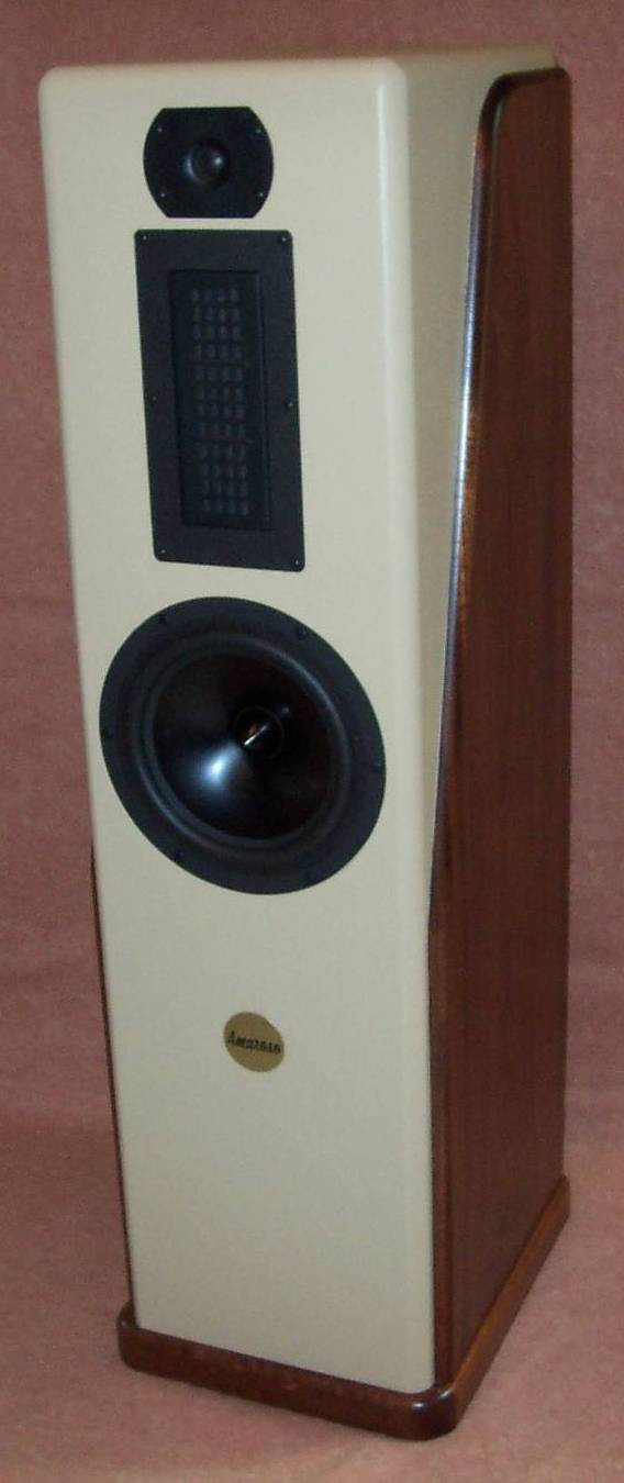

                                                                    How do you like the canTiLena compared with your Amarosos ML TL?
                                                                    I see you used the Neo8 in the Amarosos; a lot of guys have been doing stuff with the Neo10 of late, but it seems to me like there is some considerable variability in performance of that planar- any thoughts or experience from your side?

                                                                      To be honest, Jon, I have yet to do a side-by-side comparison between the two. The Amarosos have remained in my living room since they were finished and the canTiLenas are in the basement (covered so they don't get dusty). I love the midrange sound, especially on violins, from the Amarosos, and even though the SS woofer has more capability than the RS225, I don't play any speaker loud enough to be able to hear that difference I don't think. IIRC I've only heard the Neo10s on one speaker, Dan Neubecker's Echelons (I think that's the correct name) from his win at MWAF 2012. Dennis Murphy sure likes the Neo8 and I didn't have room for the larger Neo10, so I settled on the Neo8 (and I have no input or experience on variability in the Neo10).
                                                                      Paul

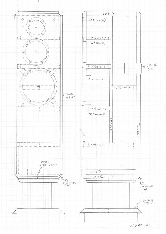

                                                                          Paul do you have a cabinet drawing of the interior layout of this design,just interested in your
                                                                          different approches to TL design Thanks Mike
                                                                          • Paul K.
                                                                            • Jul 2008
                                                                            • 180
                                                                            Yes I do but what I've attached may not be all that great since it's a scan of a pencil on paper drawing. This is a single-fold ML-TL, starting at the bottom of the front, rising to and making a U-turn at the top, then going down the back to the bottom. The line is 76.5" long, the woofer's center is located 23.75" from the beginning of the line, and the mass-loading port's center is located 13" from the end of the line. The first half of the line is stuffed at a density of 0.8 lb/ft3 with poly fiber.

                                                                            Paul
