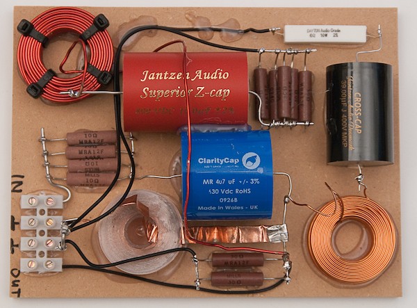

                  Sunday Crossover Portn
                  The newer build of the tweeter crossover. One down a few weeks ago, one to go someday, maybe in July.

                    Question for you Jon, it looks like you unwound your red inductor a little to get the wire to go all the way to the other side of the crossover to the resistors. I've never unwound an inductor, how much change in the value did that little stretch make? Not much I'm guessing. I'm just wondering about doing this on my next project and if you can provide any rules of thumb.
                      • 16209
                      #190
                      Actually, the inductor was unwound both because it was larger than needed and to make the "reach" easy. It was a 0.2 mH that needed to be a 0.15 mH, otherwise known as 150 uH.
                      Usually I find air core inductors are very close to the nominal value compared with caps- it's easy to nail them within 1-2%. Iron core inductors are another matter... I never install one without measuring.
                      Taking one or two turns off will slightly lower the inductance (can give you the equation if you're curious, but you have to know the starting turns and physical dimensions), but would easily keep it within 3-4% of nominal value, which would rarely be an issue, as it would take a 50% cut to halve the corner frequency.
                      I have an HP LCR meter and Audiomatica CLIO on an older Athlon PC, which has full LCR four terminal functionality.
                      If you have an inductance meter and you think you want longer leads, just buy the next up value and unwind to the needed value, you'll have plenty of wire left over!!
                        #191

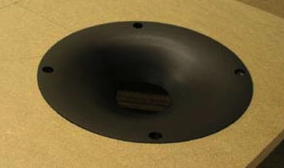

                            So of course, when Jantzen finally got back to me about the waveguides, I ordered some today. They'll come from their distribution warehouse in Poland.
                            I just love Eastern Europe- so much cool stuff comes from there- AudioPraise boards, Jantzen waveguides, and my best friend at work, Jens. :W
                            Just being solid, and not having to do any fiberglass and resin backfills makes the price worthwhile.
                            I hope I'll be able to use my Millenium Excels with these; otherwise the SS D2608 with a short beveled throat adapter plate, or, heavens forbid, a TW034XO!! :W There's some weird stuff going on in the CSD plots of the 034 in the 2 kHz range, I suspect internal reflections.
                            Main reason for these is if I do a new piano black build of the Modula Xtreme cabinets. Giving that a lot of thought at the moment, three woofers modules per side, one at the bottom just to house the crossover. Do it from scratch rather than rebuilding this set.
                            I'm even thinking about a weird four driver TMMWW with this and the Vifa NE180W; think of the two M drivers connected MTM like with the tweeter in the center, then the 0.5 Woofers flanking top and bottom; net total impedance of four ohms. Could even use a different four home driver for the 0.5 woofers. Will have to give that some thought.

                                          #200
                                          Hi Jon,
                                          Did the original waveguide not work as intended?
                                            • 16209
                                            #201

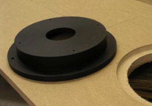

                                            The original MCM H65 waveguide works pretty well, but it's not a theoretically ideal profile- so I'm always looking into possible sources for something a bit better. Whether they'll prove to be or not remains to be seen- could be an expensive flop, possibly, but this is the one used in the Troels Graveson/Jantzen TQWT high efficiency system.
                                            Heck, I may even try out the TW034XO, just to see how it works and if the issues I've seen elsewhere in the impedance curve and CSD plots are there.
                                            Considering I built a lot of systems in the 70's and 80's with Audax drivers, it would be very funny if I ended up going back to this one.
                                            Compared with the JA8008 system, instead of a high efficiency paper cone 8" woofer, the Accuton C173N-T6-90 provides better controlled cone behavior and an even lower distortion motor, with similar net sensitivity around 93 dB.

                                              I see, are they super expensive? They look to be a lot easier to work with.
                                                • 16209
                                                #203

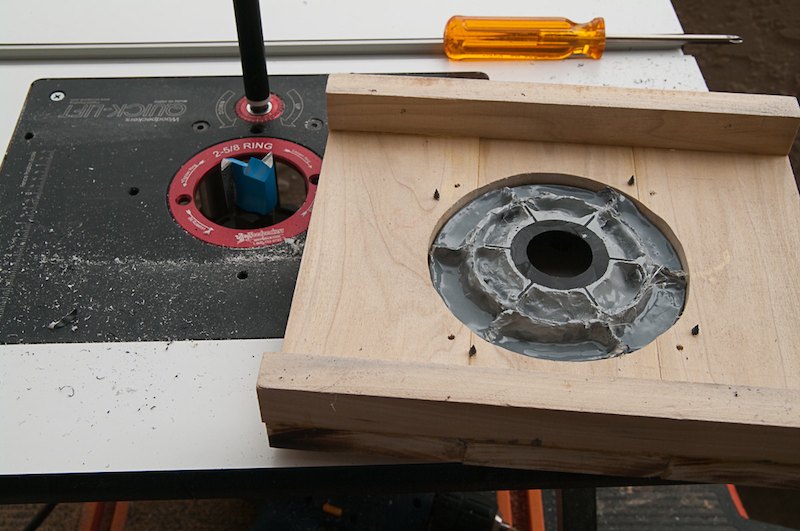

                                                They are expensive in comparison to the MCM H65 (which is about $12)- buying six, they were $47.50 each. They're milled out of solid black POM plastic, 180 mm diameter rods. Obviously, resonance is no issue. Compared with a DDS waveguide for a compression driver, they're quite inexpensive. Compared with an SS tweeter, ditto. Shipping's not bad when you're buying six, only a little more than for two.
                                                I probably will buy an Audax TW034XO just to see how well that combo measures for distortion and dispersion, as well as try adapting it to some others I have in mind. Troels didn't have much luck with other parts he tried, but he was looking for 93 dB efficiency, and trying to get the combo to be as flat as possible before the crossover. I'm more concerned with loading and distortion and dispersion- he didn't measure or document any of those.
                                                I think it may be adaptable to the Millenium Excel, with the expected effect on the net dispersion curve, I'm going to try that first. I think it is adaptable to smaller domes using a thin adapter plate with an inside bevel, such as my favored SS D2608. Mostly I'm hoping for even more uniform dispersion with regards to frequency, though with the crossover point I'm using, I've been getting pretty good results with the H65.
                                                I won't miss spending the time it takes to do fiberglass layup and routing and so forth to get the H65 to work optimally- that alone is worth the $47.50!

                                                I'd say the H65 has been a triumph of determination over inherent suitability. Problem being that there hasn't been many alternatives, hence all the discussions on board about finding guys to CNC machine a front baffle, for example, at this forum.
                                                In the end, it's an experiment, of course- I'll let you guys know how it turns out.

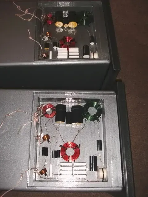

                                                        About resistors...
                                                        Ryan and some others have asked me about why I use so many paralleled resistors in most of my designs, including the old M8a back in 2003, and the current Modula series.
                                                        MOST of the time you may not need that "overbuild". But if you're an ex rock and roll guy like me, and you know you may want to crank things occasionally, you have to consider the possibilities.
                                                        As Dave discovered with his mini-statements, you can cook the crossover resistors before you cook the speakers or your ears (hats off to Curt for the basic robustness of the design).
                                                        If you never turn things up past "five", then likely no worries. But with shunt networks and even high power zobels, power dissipation is as much a factor for the networks as it is the drivers.
                                                        Just keep that in mind. :W

                                                            #209
                                                            +1 on not taking chances with resistors...can help lower inductance as well :T

                                                                                        The "Forward to the Past" retro aspect of "What If's" for the Modula Xtremes is coming together, the TW034X0's arrived yesterday, looking VERY 70's and very familiar, as Audax tweeters and mids were something of a mainstay in the late 70's for me.
                                                                                        I don't really expect to wind up actually using them (you never know, though), but they'll be a baseline for comparison for the Jantzen waveguides coming in from Poland.
                                                                                        After the waveguides arrive, the order of the day will be to assemble one on a test baffle, and do some SPL and distortion sweeps.
