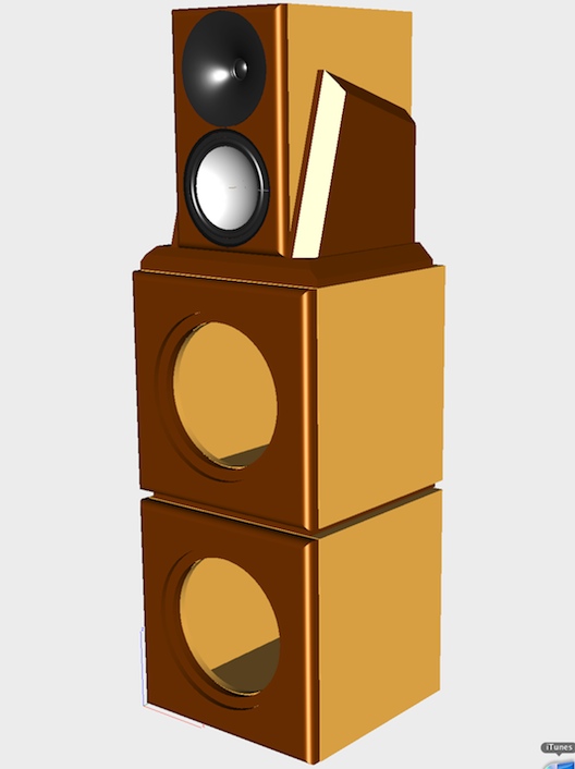

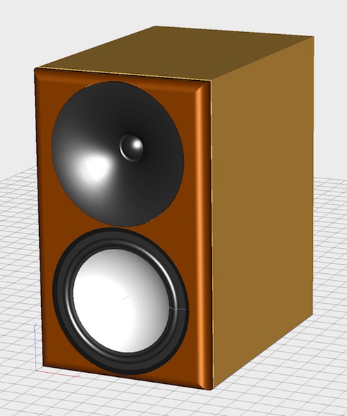

    The Modula Xtreme is getting a bit more loving for now... completed the CAD models so I can start cutting final front panels.
    I wish there was just a magic wand to wave and have this directly translated from my head- I do prefer to be making sawdust to pushing pixels.

      Looks good, the drivers are a very tight fit on the front face

        You bet they are, as this inadvertently leaked spy photo of the Xtreme head unit from the Ardent thread shows....
        Cut front panel and sub panel blanks yesterday for the LBL baffles for the head units and bass cabinets.

          Front panels in fabrication, CAD model essentially completed. Not high end industrial design, but this is a "Modula" system, which means PE cabs, or derived from PE cabs. This one is a bit more like derived from PE cabs via the Borg.

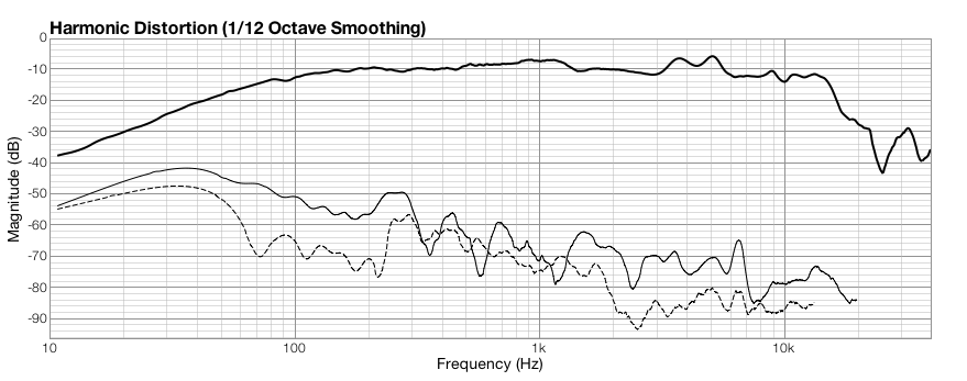

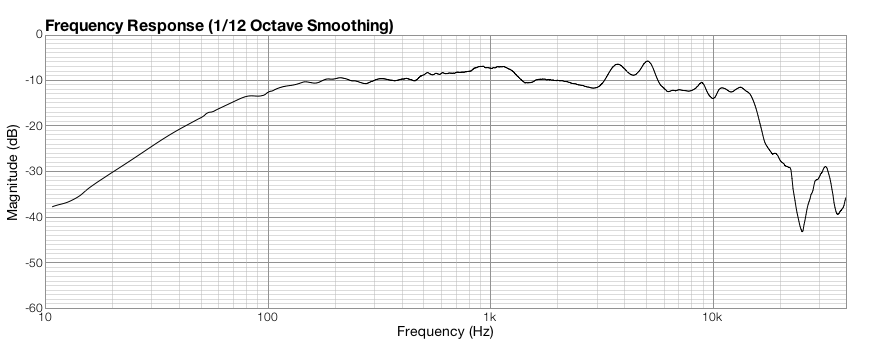

                                            Distortion measurements are done several ways; the software I use can (Fuzzmeasure) take any speaker measurement and turn it into a distortion measurement.
                                            The plots for the Scanspeak W26 were done relatively nearfield (4-6 inches, as I do when doing a "dedicated" distortion measurement (keep in mind I have an ACO Pacific instrumentation mic with 200V power supply; it has a lot of headroom). This sort of measurement I do with a relatively slow sine chirp sweep and in the convolution to impulse response, a long gating window (200 msec). Because of the nearfield measurement point, there is almost no impact of baffle step, and the result is very similar to an IB measurement, though with some affect on the response above 2 kHz (which for 10" woofers is not too important... )
                                            The measurements of completed systems, not just drivers, are done using the system measurements, which are typically done at 1 or 2 meter (small two ways at 1 meter, larger systems at 2 meter) and using a 100 msec window in most cases. Same SPL measurement for a completed system (Ardent, for example) can be used for distortion plot.

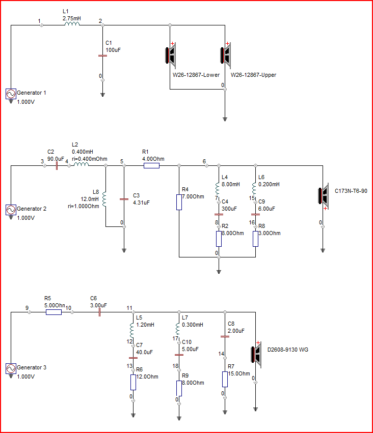

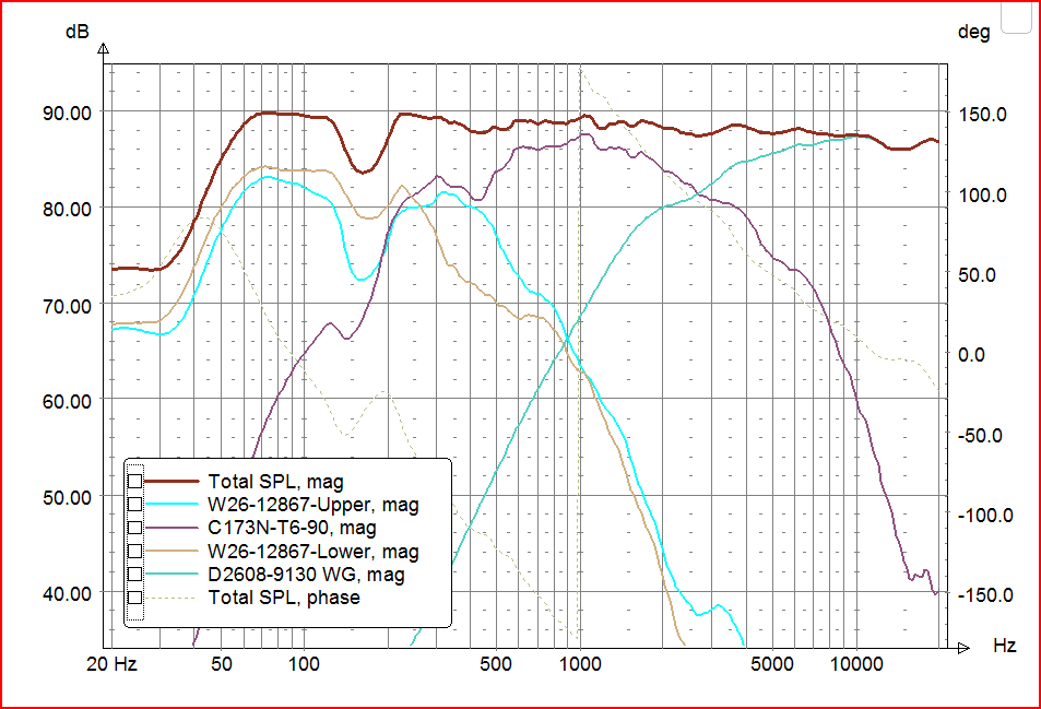

                                                          OK, I haven't been sitting around twiddling my thumbs, UNFORTUNATELY, I made the mistake of looking at my personal emails and got some urgent support requests from work that tied me up most of yesterday. But still things are moving forward- now it's time to see if I can whip up a junk box crossover quickly to test out the LspCAD design I've put together- I've been out to my off site storage and gone through my parts collections, it's looking good, as long as I setup CLIO to be my computerized LCR meter.

                                                          The big dip at 175 Hz is a low frequency room issue at that measurement position, but I didn't want to pull the mic all the way back to my normal listening spot, as that would allow even more reflections in other parts of the band, which for the purposes of design wouldn't be addressed at this point.

                                                          The idea is to get something roughed out and do measurements with the crossovers in place on one system ASAP, see what fine tuning may be necessary to the concept. Also to listen to it. :yesnod: I expect to need to do some tweaking because the mids won't hold up that well off axis above 5 kHz, and this will impact the overall level off axis; I may need to bump the tweeter a little bit on axis in the 4-7 kHz area to smooth out the power response.
                                                          Funny, I just noticed now that the tweeter and woofer alignment seem just about perfect with the midrange- the target functions was a Duelund with 900 Hz center frequency, and that's exactly where the tweeter and woofer are crossing over with each other. I should have been checking that when working on the network and looking at the final SPL response, but I was more fixated on the midrange curve and the overall voicing with a slight down tilt. The phase stack up worked out well for all drivers; having the tweeter offset by the waveguide helps nicely.

                                                            What do you estimate for their efficiency? 90db w/o BSC?
                                                              • 16138
                                                              Estimating the sensitivity might not be easy to do- one reason I measured both woofers separately is because one is boundary loaded at low frequencies to a greater extent (due to the proximity to the floor). That one has less sensitivity to the room interaction and floor bounce.
                                                              I expect the sensitivity before BSC to be somewhere around 89-90 dB, just how much BSC is really dialed in is not clear- the mid, for example, has a fair amount of amplitude cut, but it's 94 dB/2.83 VRMS in the upper midrange. I'm wacking it down a bit, but not as much as you might think because the Duelund response profile is partly taken care of by baffle step and diffraction effects- the electrical XFR function feed is pretty flat between 300 Hz and 2 kHz.
                                                              I've got a "special" set of back panels made up so I can work the midrange and treble crossovers external during development; then once everything is wired up and finalized, the "normal" panels will be bolted in, probably epoxied, too. The permanent ones are reinforced a bit more also.

                                                                                  IMO, the NE180W has the edge considered as a pure midrange- a more extended top end (less phase shift in the region of interest, though we deal with that in the Modula MT crossover), and lower distortion in the midrange and presence region. So, for a pure three way, not a 2.5 way, I think it makes some sense, and since I bought a pair and they actually test out OK for the intended application, then for an SO variant for those on more of a budget, I think it makes sense.
                                                                                  Additionally, the NE180W has more sensitivity, which means more freedom in crossover design.
                                                                                  Very low distortion for this type of driver in the upper end, due to the low inductance and low inductivity modulation- that's more important I think for a midrange used above 300 Hz.
                                                                                  Last edited by theSven; 01 August 2023, 20:37 Tuesday. Reason: Update image location
