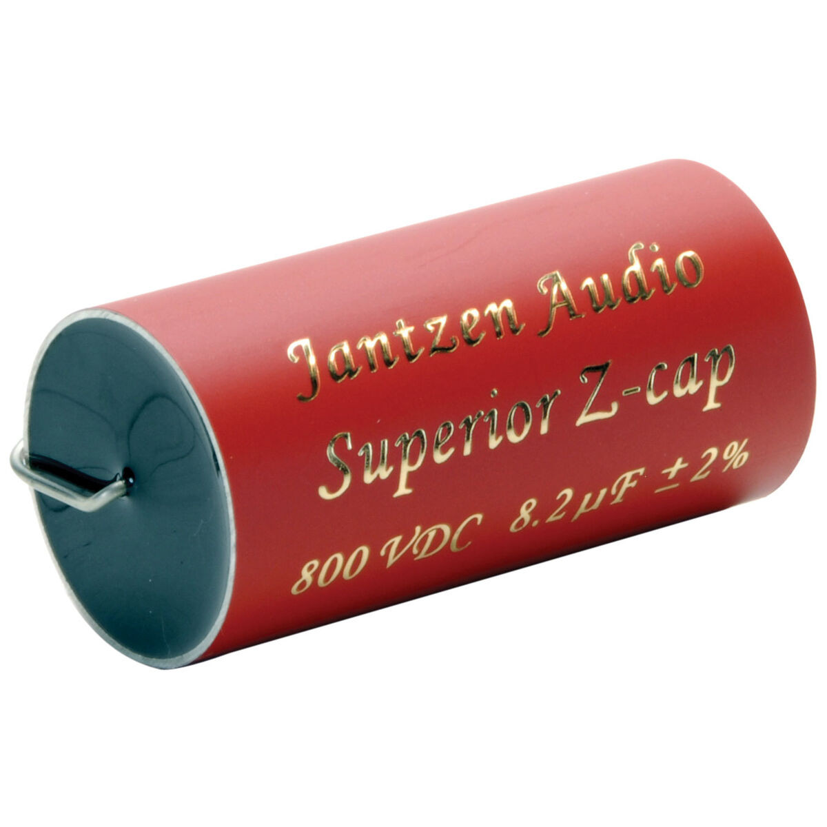

                                    The 10 uF version of this used in the shunt EQ network is almost the size of a Dayton 100 uF Film cap!! Yes, they're potted in their own aluminum tube...
                                    So the dilemma is, small cheap caps and good bass for a little while, until the NPE's die because of power dissipation (look at the dissipation factor in those, putting them in the Flux cap position is probably a no-no), or big caps and good upper bass through highs?
                                    Or another box? I've got the speakers stacked on an additional cube now, so I can assess the frequency response and imaging with the system elevated to that height.

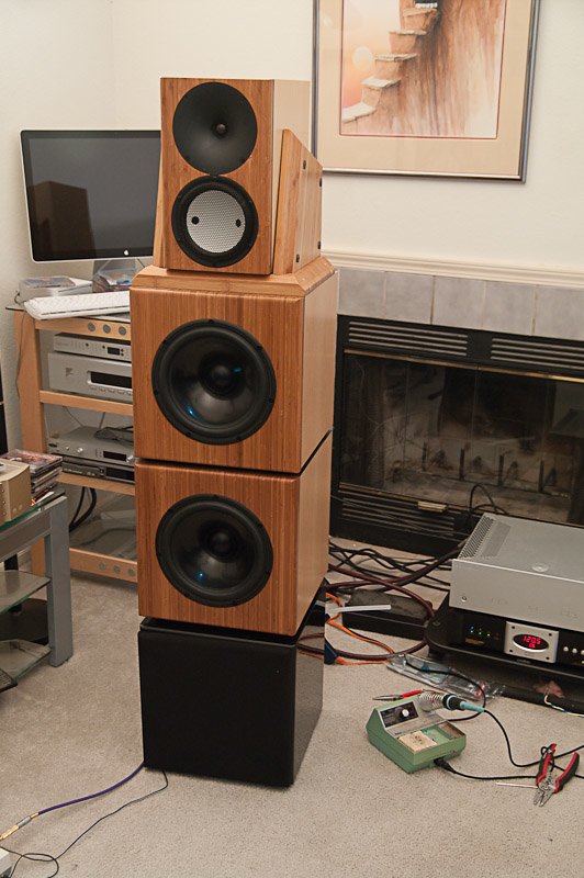

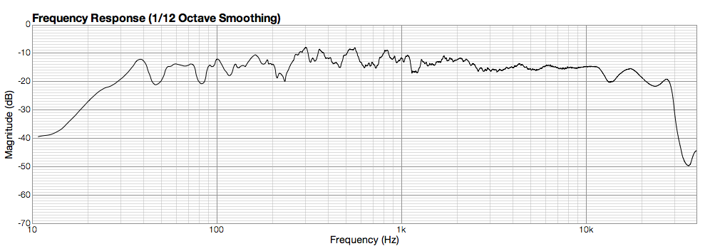

                                          OK, while I was talking to ThomasW earlier this AM, I stacked up my Modula Xtremes on a new pair of PE boxes, just to see how the room interface for LF would be with the revised woofer positioning, and the imaging and overall balance.
                                          My brief listening impression was that the midbass was a bit smoother, and that we'd picked up a third to half octave in the bottom end. Now, as they were previously nearly boundary loaded on one woofer, I did not expect there would be an improvement in LF response picking the whole thing up off the floor. Seemed like a classic case of placebo effect- you hear what you wish you would hear.
                                          The microphone doesn't lie, though, at least not if you treat it right, so that was next.
                                          This is a 2 meter measurement, gated at about 160 msec, in room. Damn, if it doesn't look like the midbass is smoother and we picked up a third octave in the bottom end- with no other modifications.
                                          Am I lucky or what? Like I said, Jed must enjoy me watching me walk around stumbling in the dark, barking my shins now and then and also coming on a little gold at other times.
                                          Well, it seems to me we've at least got a valid argument for using a pair of the 1 cu ft boxes as speaker stands... but I think doing a full addon with the crossovers relocated will be in the cards now. Sheesh, if I'd come up with this response curve just by doing the full mod, I'd be happy, but now I suspect there may still be a little more performance to wring out of these with making more of the woofer modules available to the woofers.
                                          Size is getting a little out of control; they're about 59" tall, only 1-1/4" short of an Isis, for comparison. Don't look anywhere near as nice as an Isis, but they're not $60K, either.

                                              • 16142

                                                    The questions I'm pondering, once I get another pair of maple boxes for now, is do a BORG them all together, or keep the crossover box free as a plinth, and use external wiring and binding posts, which is a bit of a PITA.
                                                    Probably I'll have to check the Element and see if I can handle a 60" cabinet; if not, that will argue for keeping them detached. Believe me, lifting the existing cabinet set with crossovers on top of these piano black boxes was not for the faint hearted- more for the dumb as an ox type.
                                                    Got some more Jantzen and PE caps due to be delivered today- stuff for the Modula Xtreme and for the Ardents.

                                                                Hi Jon,
                                                                Three further questions for you! I put off buying the drivers before as I wasnt really in the position to do so. However, I am in Florida at the moment, and im thinking its a good idea to try and buy my drivers before I go back to England since they are so much cheaper over here.
                                                                Are the drivers for the Modula Xtreme SO set in stone, or is there still a possibility they will change? I think I asked you before, but that was about 2 months ago and wanted to confirm nothing had changed since then.
                                                                As an extremely loose estimate, how much do you think the crossover components would be per two speakers? $100, $200 etc?
                                                                If I had a sub-woofer, would I be ok just to crossover the Modula xtreme So's over at 60Hz using my amp, or would I need to make alternations to the cross over inside the speaker?
                                                                Thank you!
                                                                  Ah... which cap are you looking at in the crossover.

                                                                        #170
                                                                        The crossover compoents for the two speakers are $1000? Even for the SO build? Wow did I get that wrong. These caps and resistors got expensive all of a sudden :x
                                                                          • 16142
                                                                          #171
                                                                          Of course, it's always possible to use the minimum cost components available, like Dayton film caps, Erse or Madisound cored inductors, it's up to you how much to cut corners. But a three way crossover is always an expensive proposition compared with a two way, as the differences in crossover frequencies and reactive component size makes the LF crossover point components large and expensive. No way to get around it, a low DCR 2.5 mH coil is expensive, a Jantzen C-Core being about $50. Now, you could use a more typical inductor as you might for a small two way, but with a 4 ohm load on the woofer, the insertion loss of a 0.5 ohm Inductor is substantial- that's burning power in the crossover. LCR zobels allow using high DCR, but you still need the caps. Three way crossovers just aren't cheap.
                                                                            • 16142
                                                                            #172
                                                                            I don't want to get a long discussion of capacitor quality and tradeoffs; I wouldn't spend the extra money on the premium parts if I didn't think I was getting my money's worth.

                                                                              #173
                                                                              I guess i was a little naive, i had no idea it would be that cost. The thing is you have spent time designing it with these specific components in mind, and with my lack of technical knowledge I don't think it's a good idea for me to be tweaking your components.
                                                                              Realistically is a pair going to cost in the range of $1600-1800 for the drivers and crossover components as a very loose estimate? I've done the maths on the drivers but can't begin to estimate the crossover.

                                                                                I'd have to put a Numbers or Excel sheet together, I don't believe in "loose estimates" :W, comes from doing an EE job for a living.
                                                                                I need to do that in Numbers for the existing Xtreme, at the same time I'll put a generic BOM with "low cost" parts alongside.

                                                                                      Another alternative would be to build with the budget crossover parts and then upgrade components over a longer period of time. An occasional pair of caps, and you end up with the "top drawer" system without so much short term pain.
                                                                                      I have never regretted buying good drivers and suspect, provided you don't go so far as substituting electrolytic caps, even a system with the budget crossover will amaze you.
                                                                                      Paul
                                                                                        • 16142
                                                                                        #178
                                                                                        Yeah, what Paul said.
                                                                                        I even did that, in the process of upgrading midrange and tweeter caps from Clarity ESA to Clarity MR. In fact, I haven't finished, as the mids aren't installed, and only one speaker is updated on the tweeters. It's this stupid seven day a week job I have lately...
