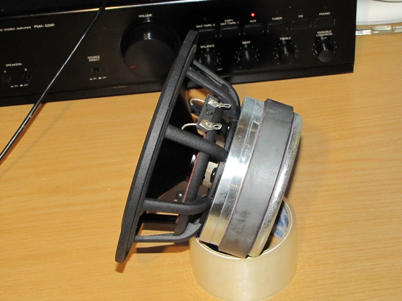

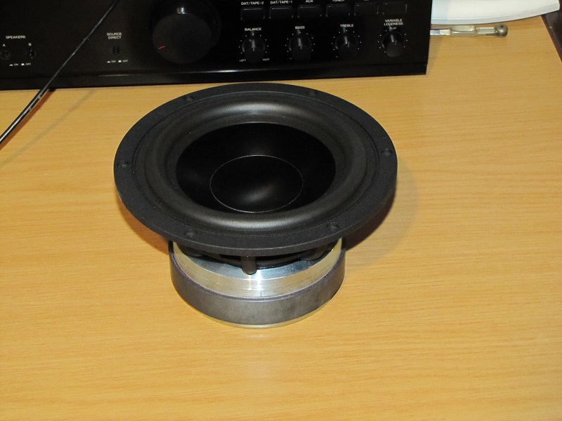

                                                                                      I guess being a new startup company they have weighed their options regarding pricing and set it to a high side first. One can always come down from that if numbers in first months do not meet the expectation. Going the other way is very much harder. So business wise I do understand the logic I think.
                                                                                      Would be interesting to try these out, but yeah with 450 a pop makes one think that perhaps going after them right at start seems a bit expensive.
                                                                                        It's a 6.5" driver. The world is your oyster when it comes to such devices.
                                                                                        Yes this driver does seem like a nice combination of specs. Very low distortion. No apparent cone edge surround resonance, although there is definitely something happening at ~400-700Hz. Needs more detailed measurements to see what, though the frequency response definitely wiggles about a bit. Huge xmax. Useable up high enough to mate with a tweeter.
                                                                                        My gut feeling is that if you want completely pistonic/resonance free operation go with the SB17NAC/BNAC/CAC. If you're okay with some soft cone properties pick a Satori.
                                                                                        The textreme Satori, if the marketing can be believed, should offer resonance free operation, within the typical passband, and without aggressive breakup later on. The cone materials are also very cheap. Carbon and epoxy?
                                                                                        If you absolutely need the xmax for a potential 'one driver does it all' speaker then it seems like a good choice. Otherwise choose a different mid/bass and use a small sub.
                                                                                        It makes me wonder what Bruno would use it for? A remake of his kii but with 4 of them? Front rear and sides? That would seem like a nice upgrade over the real basic peerless drivers he currently uses but that would completely screw the current speakers economics. I mean the peerless bass drivers are €30 each? Yeah replace those with €450 drivers.
                                                                                        • Zvu
                                                                                          • Oct 2013
                                                                                          • 436
                                                                                          Those are about 14$/piece if you are buying over 500 pieces. And if you're using 8 woofers for pair of speakers, you will need a whole lot.
                                                                                          In that 14$ there are all of the production expenses in making an alu cone 6.5" woofer with profit. Puts things in perspective how large the profit is for Kii Three. With Kii Three the idea is what matters to me. It is one of the reasons i've given up on hyped expensive drivers that are better than the rest by few tenths of percent but cost up to 10 times more. Bruno just did engineering job properly using what we consider (at very best) mediocre drivers and the result is phenomenal. I, and probably rest of the world, can't wait to see the midrange in it. Purifi driver is produced in Indonesia and costs out of the factory probably whopping 30-40$ a piece - and it is that expensive only because it is not made in tenths of thousands. So it might be profitable for him to start using Purifi woofers in updated Kii but i'm guessing that the end price for updated Kii would also be substantially higher. Not because it is justified, but because upgrade must not cost less.
