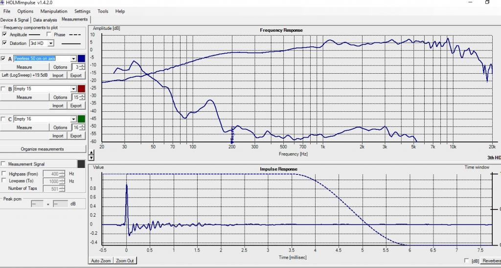

    Nice driver, attached my measurement of it the other day (on a 23 x 37 cm baffled box - improvised with duct tape!), 50 cm on axis, scale 70 dB to show the 3rd HD.
    I think there is a reason why its' grille is fixed!

            though I'd hoped not to see the rise above 1 kHz due to inductivity modulation.
            Well, considering its' cost, I think it is more than acceptable..... I do think this one has one of the highest price/quality ratios. Sitting hidden behind the Kii3 grille.

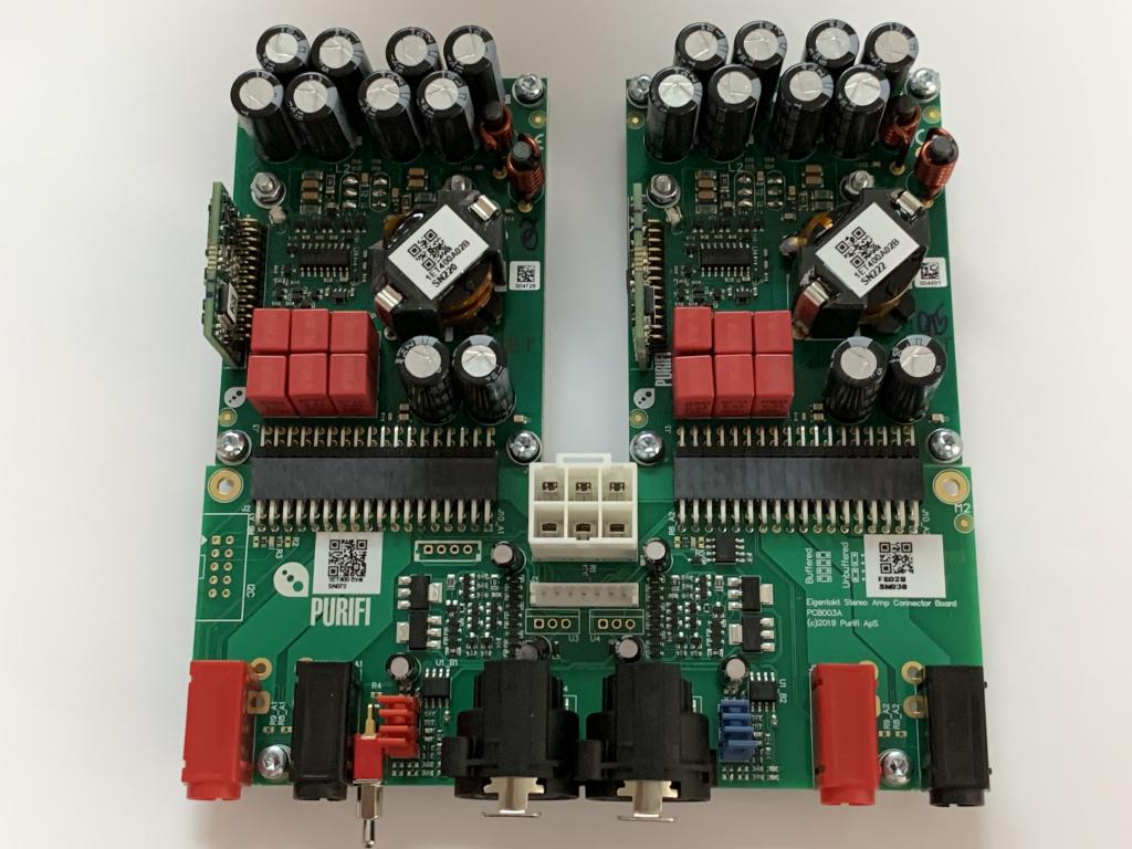

                                    We are pondering with my friend (who we built the OLA speaker project for) if we would buy Purifi modules for both of us or only for him for now.
                                    The other point is a decision if to go for the EVM kit which includes "stereo front-end board (which has connectors and a configurable pre-gain stage)" or only the modules themselves. Latter is of course cheaper but would need some version of buffer still. I have balanced DAC-pre, but my friend has a single ended out on pre-amp. So balancing that signal would be needed. So thinking through the options there - even transformers as Jon considered in past, but the other way around - ie for balancing the SE signal coming in

                                        Similar progress... got the Eval kits and enclosure from Italy is waiting at office. Power supplies and connectors etc. should arrive next week as well.
                                        ILCCC, what type of pre-stage/buffer you have for the module?

                                            Yes - e-mailed the sales e-mail and got a price quote back in matter of hours. The modules shipped from Denmark.
                                            PS. There is a good discount if buying 4 or 6 or ... If buying only 2 then getting the Eval kit makes sense at it is relative low addition to the full sum. I might attempt a custom buffer stage in future but the eval buffer will sure help get it up and running faster.

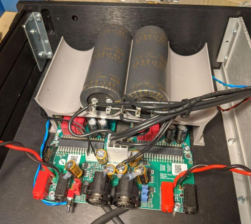

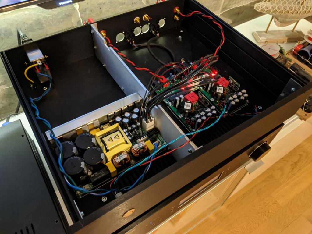

                                                • 698
                                                Purifi amps initial phase complete and the modules are singing. Too early to commend on sound yet.
                                                I created XLR socket holes for the potential upgrade with BPPBP - Bruno Putzey's Purist Balanced Preamp. That module has two XLR inputs and output.
                                                I bought an extra 4mm front panel from HiFi 2000 and cut it down on band-saw to use as a separating wall between the power supply and amp.
                                                The case is extra big to allow potential upgrade with "Integrated amp functionality and different buffer stage etc.
                                                  • 698
                                                  As I struggled with figuring out what exact wiring is needed to be done between Purifi EVK and the Hypex SMPS1200A400 I'll inlcude few photos that hopefully show enough.
                                                  (Note how 7 pin connector has last 3 connected on Purifi EVK end but a different pinout on SMPS end!

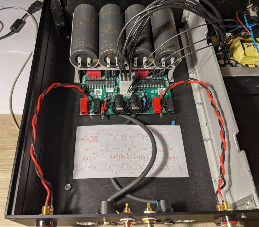

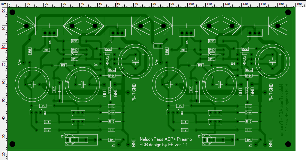

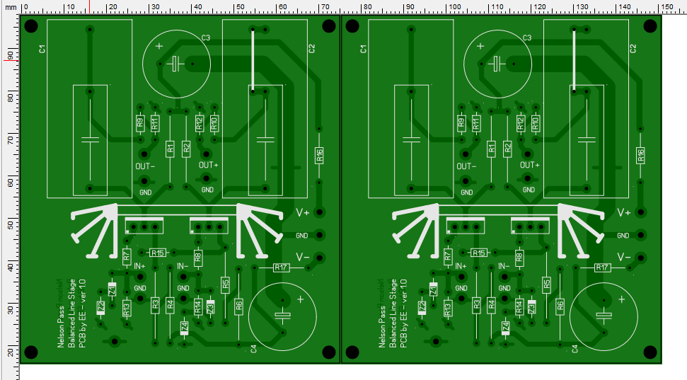

                                                        • MikePM
                                                          • 24
                                                          Have you considered obtaining the Nord buffer boards that include two of either the Sparkos or Sonic Imagery Op Amps? I know Nord sells the boards as an upgrade for its NC500 based amp, and appears to be using them without modification on their purifi amp. The Nord One REV D Input Buffer Board is listed for 274.50 pounds sterling, so two of them would not be cheap, assuming they are compatible.
                                                          Also, has anyone used any of the Chinese amp chassis from Aliexpress. I would love to buy local, but there is limited selection, at least until someone builds a kit for these boards.
                                                            Thank you Ergo for sharing your experience and comments with the board.
                                                            I have done brassboard experiments with different buffer circuits for the NC400 and NC500 several years ago, but due to various exigencies have not been able to follow up with fabrication.
                                                            The front end buffer seems to have impacts that are not easily revealed on the test bench- do not underestimate the difficulty of many preamps driving a 2k ohm load- while 600 ohm capability is often claimed, the listening experience that way can be most unsatisfactory. My own experience is that if one designs to drive a 75 ohm load robustly, then 600 ohm will sound quite "adequate". If one "designs" for 600 ohms, the results may not please...
                                                            Steve Manning is looking at a similar situation as he hopes to get an NCORE solution running in the not distant future. He has some options, with his Auralic Taurus Pre.
                                                            Just to whet your Dark Side Appetite, here is an interior picture of that preamp...

                                                                  Have I qualified for the Purifi Club?
                                                                  Documentary evidence-
                                                                  and what I find to be incomplete documentation-
                                                                  The EVAL1 manual provides the necessary information for connecting and controlling it.
                                                                  But...
                                                                  I have been expecting to see documentation about the 1ET400 pin interface and the application schematic- the component connectivity and a schematic for the Eval 1 would all be necessary to proceed with a proprietary development.
                                                                  Is there something I have overlooked on the Purifi web site? Perhaps some one can point me in the right direction...
                                                                  But so far I have seen no module data sheet and no schematics of the module board interface, not as provided commonly for Hypex Consumer or OEM module products- for which I have all information.
                                                                  If some one could enlighten me, it would be most welcome... Google has not helped.

                                                                              While others are making sawdust I've switched to different mode
                                                                              Plan is to see if providing a lot of drive current to Purifi modules will make them better and Passlabs design are on table as they have always known the benefits of lots of current... luckily here we only talk about pre amp class-A that will not fully kill the nice efficiency of the class-D power modules.
                                                                              First one is an old design from Nelson Pass from 1997 - Balanzed line stage or Bride of the Son of Zen. I've always wanted to try a transistor pre with crazy high rail voltages and this one will be happy with the same +/-64V as the Purifi main supply. This should be closest sound wise to tube stage without actually using tubes

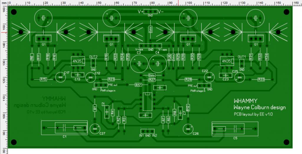

                                                                              WHAMMY is from Wayne Colburn from Pass and is directed more as headphone amp, but it will sure have enough current. This one will allow playing with various dual op-amps available...

                                                                              Last one is again from Nelson Pass but from 2019. Basically a JFET/MOSFET discrete gains stage with mostly 2nd harmonic distortion.
                                                                              I also got 4x 6800uF caps to try out on main supply rails... not sure if the switching power supply will be happy to start with that 'powerbank' as a load. But I will try and see... perhaps it takes few attempts before it fully powers up but then it should run.

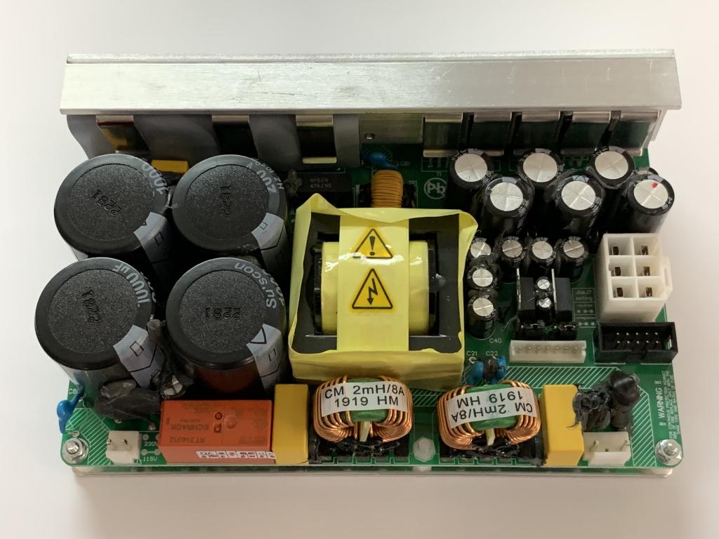

                                                                              As my friend has the other Purifi kit we will have one that can run in stock Hypex PS + Purifi EVK buffers while we tweak the other one. That should keep us honest if we truly get benefit or just fool ourselves into thinking that every self made mod is a good one

                                                                                    Is that the Hypex SMPS1200 Power Supply seen in your test rig above?
                                                                                    If the answer is 'yes' is it the model SMPS1200A100 or one of the higher voltage 'A180, 'A400 or 'A700? A few lunch hour minutes comparing Purifi vs. Hypex documentation it appears Purifi may have had this in mind as EVAL1 and Hypex SMPS1200, the connectors 'J1' on each look compatible. And for the lower voltage rails EVAL1's J3 pins 5 (+Vunreg), 6 (GND), and 7 (-Vunreg) getting power and ground from SMPS1200's J5 pins 3 (+Vaux), 5 (GND), and 7 (-Vaux).
                                                                                    One has to wonder at the human/business story of Hypex and Purifi. Launching a new company with evaluation boards that use a previous employer's and intended competitor's power supply module has to indicate the most amicable split imaginable OR a metric ton of nerve.
                                                                                      • 698
                                                                                      Yes it's the SMPS1200A
                                                                                      It took a bit of reading and pondering of both datasheets as for example Purifi one has -VP power while Hypex module output VDR-. Also the 7pin strip connector has a different sequence of powers/signal. This is why I added many photos of different angles... I was assuming that they will revise the EVK datasheet to make it easier for self builders as matching these two should be how most would use it. But this far that has not happened it seems.
                                                                                      As an update on my tweaking -
                                                                                      I have replaced the small caps on EVK module. Interestingly the originals were 22uF/63V type... but they are all in aux supply lines that come in at about 20V and then get stabilized to +/-12V. So I replaced all with Panasonic Fine Gold 220uF/25V
                                                                                      I also added the big 8200uF/80V ones for the main +/-60V supply. The SMPS has absoluttely no trouble starting up and there are no ill effects. Starts just as well as before.
                                                                                      I'm bringing the amp to my friends place tomorrow for A/B listening. He's Purifi + EVK is fully in stock form still. So I'll post listening impressions after that.
