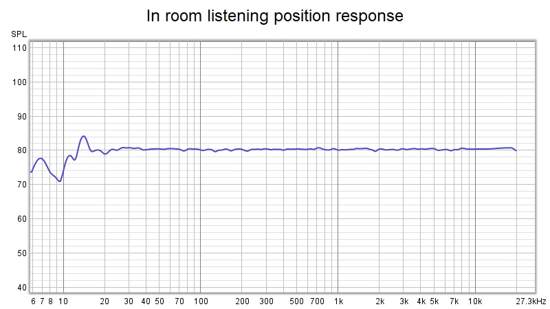

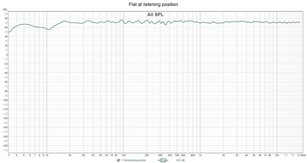

      Regarding the room correction, my system measures from 40 points in the room. And with these drivers crossed over at 1.5k with a 4th order, the power response from all room positions is pretty amazing. However I did settle on only correcting below 300hz, with mild correction. Because the response is pretty amazing with these drivers without correction.
      Here’s the response with no EQ at all above 300hz. From the listening position 8’ from the speakers in the centre. The room is 18x34’. With hardwood floors and many windows. No carpet or acoustic treatments. And the measurement using no gating at all. All reflections are included.

        A 300 (!!) dB scale? Wow....

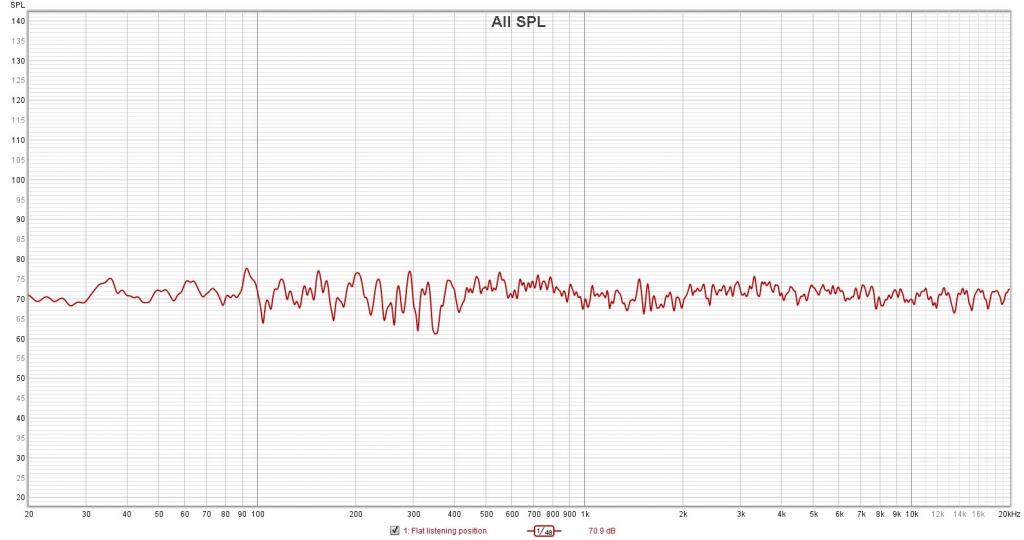

          Here’s zoomed in more with 1/48 smoothing.

            Is "flat" really where it's at?
            This is more like what I'd expect to see in the room.
            But if you have this much control over your filters, here's a suggestion that's been vetted by quite a few other people, and promoted by Sigfried Linkwitz, too. Several on the forum here have tried the passive filter version I proposed and find that they really prefer the listening experience that way.
            Some specific EQ curves proposed and considered/evaluated by Linkwitz and associates
            Passive circuit simulation and implementation for NAD M22 (or similar power amplifier with input impedance in the 100K range).
            I know of several sets of these voicing filters built up and in use now with members, after their evaluations.

              When you’re doing listening position measurements in an untreated room I think using 1/12 smoothing is fair. However the first measurement I shared with the +-0.5dB 20-20 from the listening position had no smoothing at all. And that measurement was taken with REW. When the correction was done with completely different software.

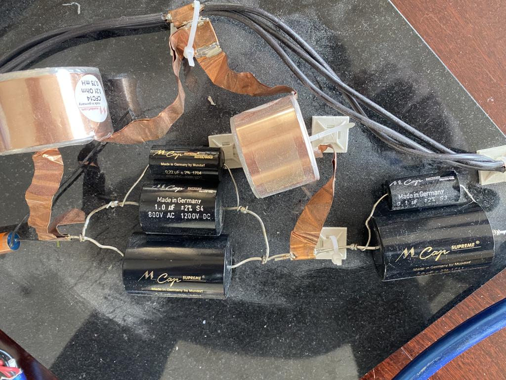

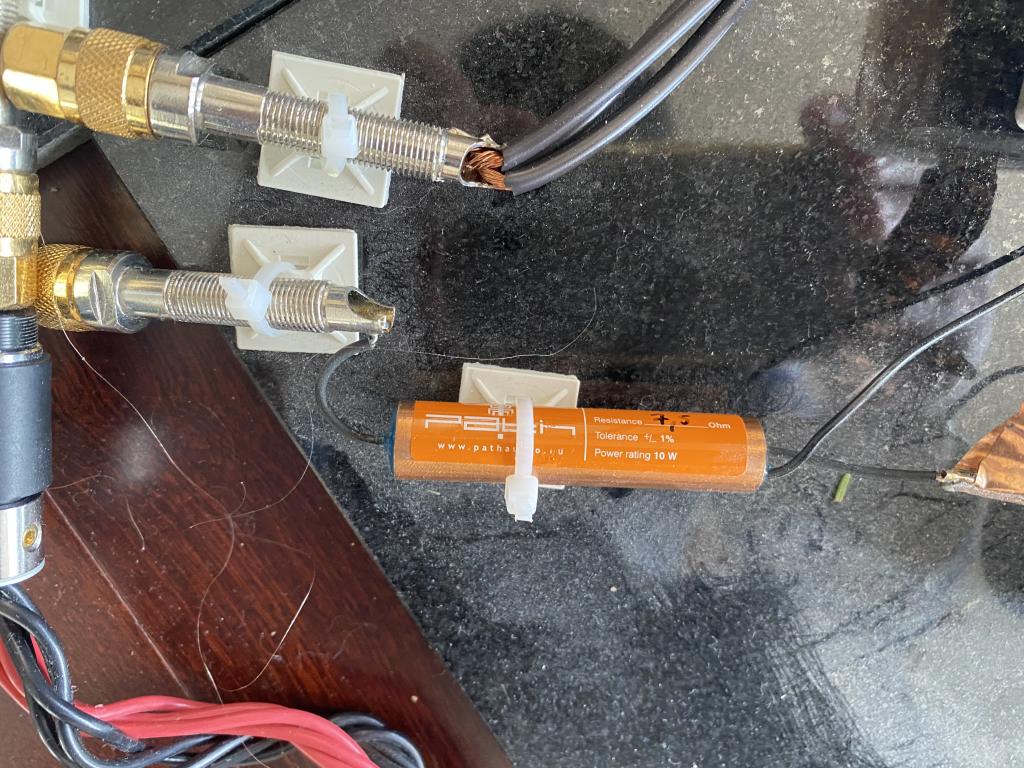

                    Here’s the types of components I use for reference when comparing to the DSP. Sounds like cotton is in my ears with the passive parts. And the soundstage is on another planet. Active. Same with the dynamics at all listening levels.
ID:	866591Click image for larger version

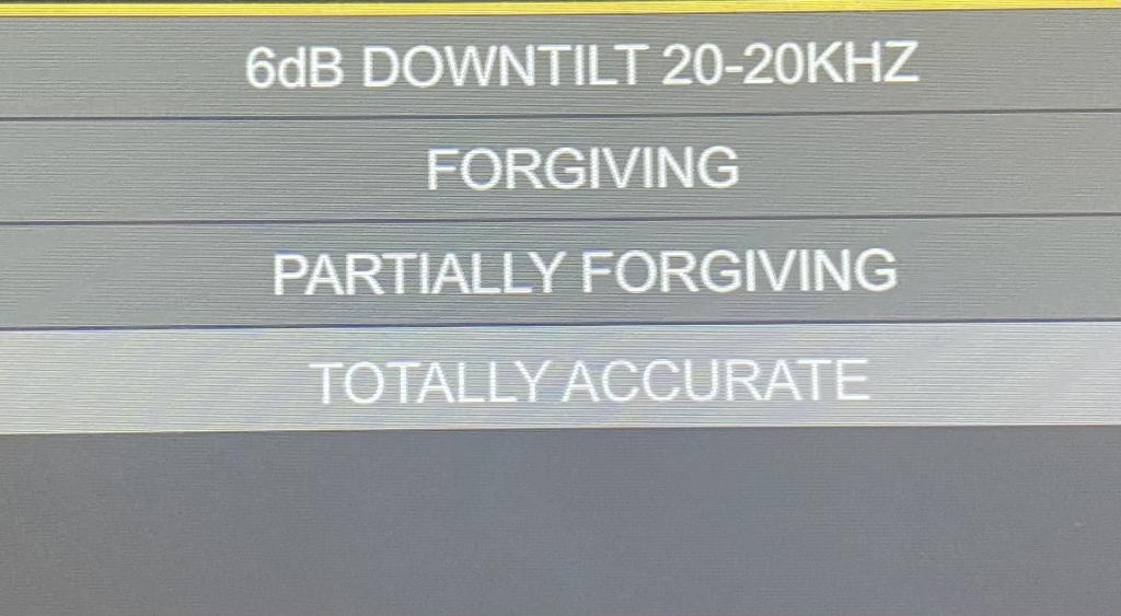

                                    I don’t want to dominate this thread, however I thought I’d chime in on my recent thoughts on target curves like you mentioned a few posts ago, along with curves, like the Harman curve. My recent experience with my DSP system and these extreme quality monitors has me questioning the conditions in which both the Linkwitz and Harman listening tests were conducted under. One thing I know for sure is they were using crap electronics, and mediocre drivers. One thing I know for sure as well is I’m certainly not with my test conditions as of late. And what I’ve discovered is when I set several target curves in the DSP like the Harman curve, and the 1974 B&K curve, is with well recorded music I prefer the flat setting at the listening position. The main reason I suspect is how clean and pure the electronics and the drivers are. And the second reason is the sound engineers did a great job in the studio already tuning the sound, based on studio monitors with a flat response.
                                    However the beauty with a system like this is I can change the target curves in 1 second with the tablet app from my listening chair. So no need to redesign the crossover if a track comes on where the studio engineer did a poor job. Then swap it out with another one when listening to tracks where they did a great job.
                                    Example of some custom presets I made for these speakers.

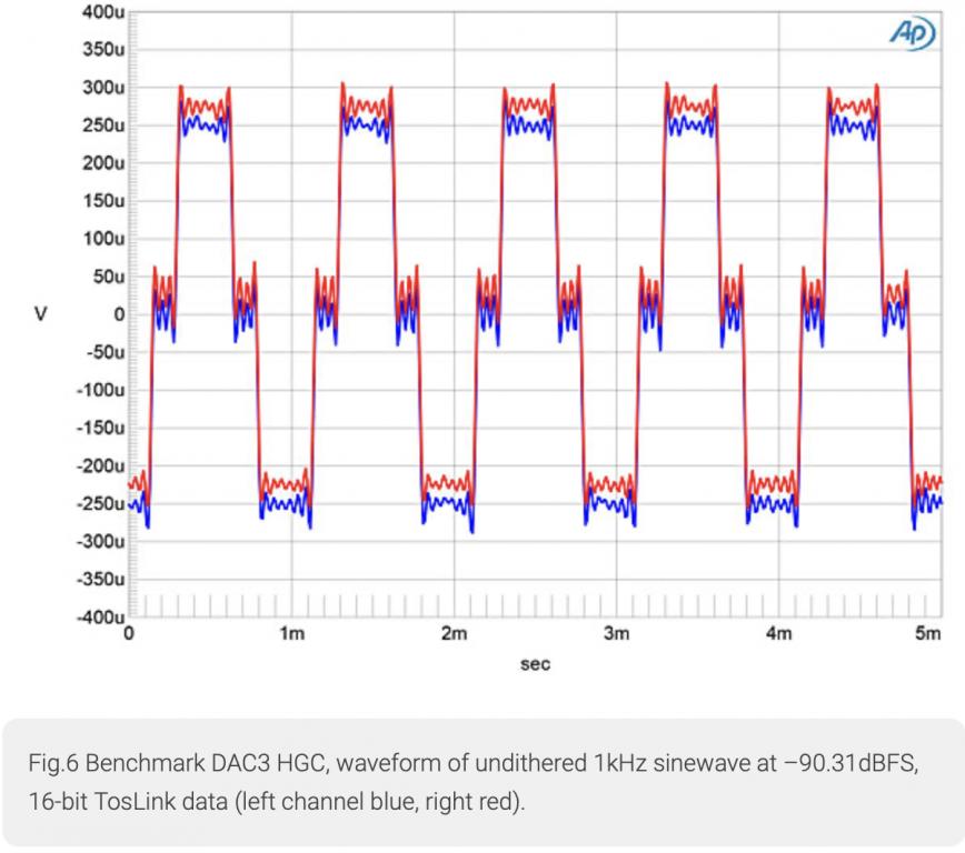

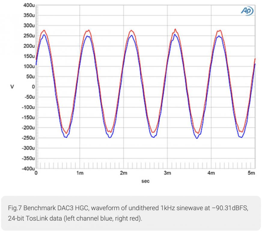

                                      This review of the Weiss Engineering DAC502, an updated product from Weiss, is a good example.
                                      https://www.stereophile.com/content/...r-measurements
                                      At a much more modest price level, (about 1/5) the Benchmark DAC3 HGC also provides superlative performance, and very low noise- just look at -90 dBFS 16bit and 24 bit performance.
Name:	16 bit DAC3.jpg
Name:	24 bit DAC3.jpg
                                      I also tend to be keyed in on 19+20kHz intermodulation performance, and how that folds upwards as a function of the DAC filter.
                                      The analog part of the DAC3 HGC is also quite credible; I suspect it has some genetic heritage from the Benchmark LA4 line Preamp, which I use for my acoustics test system.

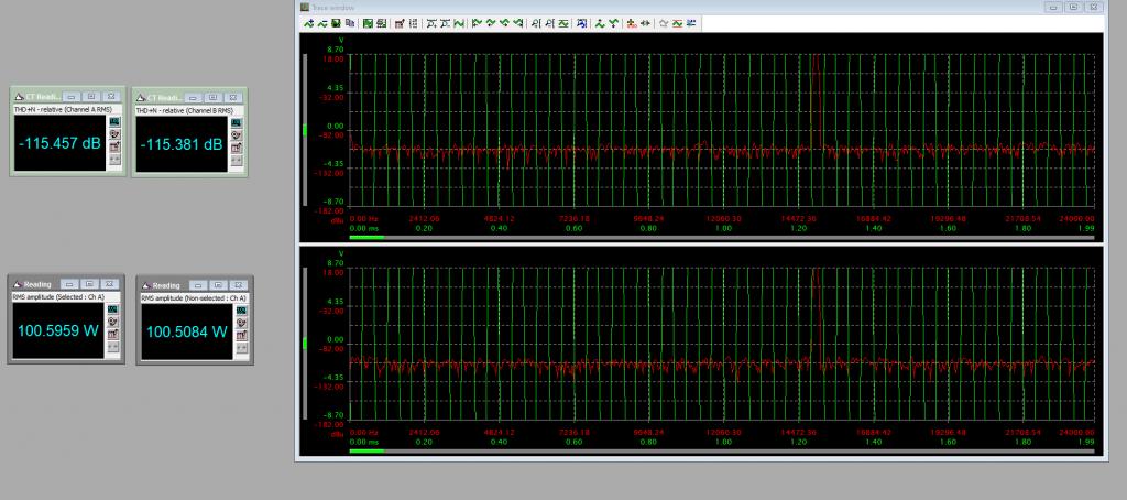

                                              Nothing scary for me. Here’s the 100W THD+N into a 4 ohm load, of the entire system from Ethernet input to the analog speaker binding posts. If this isn’t clean enough might need to pack it in on this hobby altogether. Because it doesn’t get better with todays amp technology.
