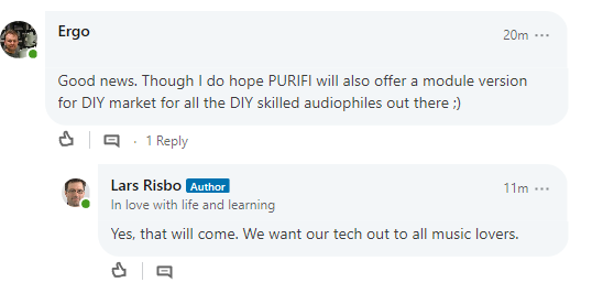

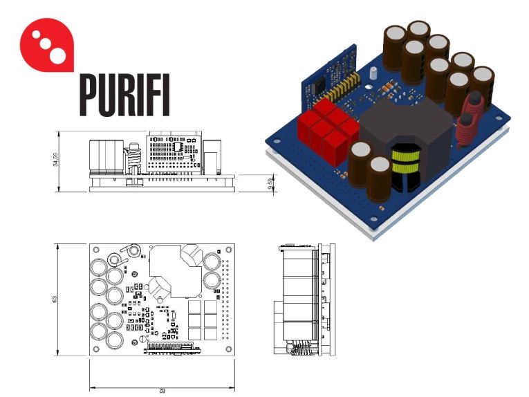

    Not sure if we'll be so lucky and this comes available as DIY module also, but it sure is interesting and from people with great track record.
    A new Danish company, founded by Bruno Putzeys, Lars Risbo, and Peter Lyngdorf will be making its first public presentation to the industry in Munich 9-12 May, concurrently with High End 2019. The name is Purifi Audio, and as you can guess from the founders involved, the venture promises Class D amplifiers with record-breaking performance "unmatched by amplifiers of any operating class." But the new company will be doing more than amplifiers, since it will also reveal a new 6.5" woofer with "magnitudes lower intermodulation distortion across frequency and SPL."

    Impressive... most impressive.
    Unquestionably these tiny technological terrors could have an outsized impact in some sectors...
    The Force is strong with Bruno and others on this team... I think we will see for the first time that Bruno is truly collaborating with peers now...

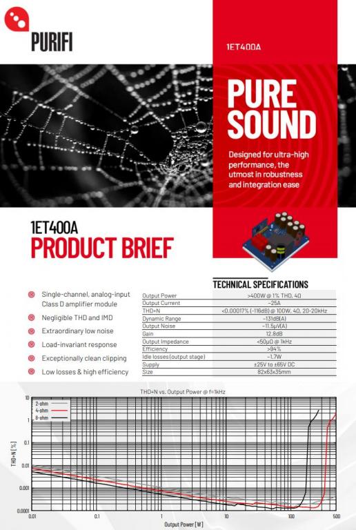

      Very interesting.
      Two observations-
      • Notice the gain level, and the implications for the input necessary to achive rated output. This only makes sense in order to achieve THD+N at this level, N must be very low- and level must be higher at the input. This is a pro audio input/output gain structure setup. My Benchmark preamp wouldn't have any problem with this.
      • THD is now falling into a level I have only seen approached with amplifiers like my Halcro DM68's. "Triple oh two" is getting down there, and you need a unit like the APx555 to measure reliably at that point.

          As for gain - indeed. At least I would need to either mod by Bruno Putzey's Balanced Preamp or then go for some other design that could pull that much pre-gain off.
            • 1678
            They have comparable gain to my TI post filter feedback tpa3250s. One of the design benefits of that is lower noise.

                They are using this design concept in a new Lyngdorf 8 channel amplifier, but the physical realization is not in modules as shown in the PuriFi data sheet.
                Looking at the module render, I think the physical construction is not very different from nCore. Note that the output level is somewhat lower, even compared with the nCore NC500 module; I think they are most likely using pre-clipping/limiting like the class D modules from Merus audio, who was bought last year by the company I work for in my day job. Unusual compared with Hypex modules, the power spec is essentially at clipping, like many other Class D modules, approaching 1% distortion.
                The performance should give them an opportunity to charge more, but on the surface it doesn't look like they'll be significantly more expensive to manufacture than nCore modules. Same RM core inductor concept, same 6x WIMA caps in parallel for the output filter. The secret sauces is in the gain structure and feedback loop, I think.

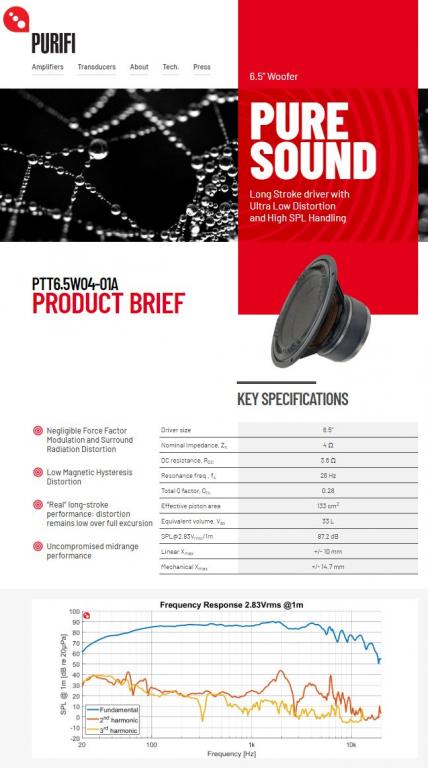

                        A new speaker driver data here
                        Whitepaper here
                        Very unique looking surround on that driver. The 2nd harmonic THD has a rise at 2k, but I guess there need to be some tradeoffs as the Xmax in turn is very big and some other parameters look very good.

                          Regardless of what they say, that smells to me like very good pure woofer driver, not midwoofer. Really looks a lot like Denovo Anarchy 704 (costs 66$) but Denovo being a little more potent with +/-12.5mm Xmax.

                            I'm thinking an MTM with a large wave-guide loaded tweeter designed for a low crossover point.,..
                            These specs are somewhat different from what earlier blurbs implied. But it's an interesting looking driver- I like the impedance curve, too, pretty well controlled inductive rise.
                            Might be great for a mini- Ardent. I'm in agreement that three way applications seem more reasonable.

                                I'm most impressed with the drivers very low levels of 3rd harmonic distortion. We're talking Satori levels here.
                                The rise in 2nd harmonic coincides with cone breakup at 2kHz. It is described as being a mid/bass and it would seem it's definitely targeted at 2 way use.
                                Given the no nonsense design methodology of Bruno and taking cues from his Kii loudspeaker he would clearly not use this beyond where the driver started to beam and would probably match it to a tweeter with some control over its directivity. So just as Jon said, with a waveguide. As a mid/bass it's fine for that.
                                The surround idea basically looks as if they've attempted to make half of it a forward roll surround and half of it a rear roll. No doubt so the surround non linearities in the forward vs reward going motion can make a stab at cancelling out.
                                The higher order midband distortion looks to be an order of magnitude better than the anarchy but the price is where things will really be determined. Not to mention there's the reckhorn sub driver if you want just bass and that's dirt cheap.
                                It does make for a decent proposition on a small active speaker with lots of watts, a low xover point and suitable tweeter. If the mid band distortion is to be believed it would sound fantastic and have the ability to churn out lots of bass. It does have a pretty low qts though, has anyone simmed it ported? I get the impression that it might not optimise into giving too much extension without an ebs alignment. Maybe the idea is to use it sealed with eq and lots of those class D watts.

                                  Looks pretty good to me-
                                  A quick look with my trusty online box modeller-
                                  Online speaker box design & subwoofer box calculator for sealed, ported, bass-reflex, bandpass, passive radiator and transmission line enclosures with 3D tools and blueprints.
                                  This 6.5” midwoofer can be squeezed into a 1/4 to 1/3 cu.ft cabinet for an F3 of 50Hz to 44Hz in a traditional vented box. But with a couple of passive radiators and DSP/Class D power on tap...
                                  At 94dB@1m, the 3rd harmonic is -60dB (0.1%) from 100Hz to 2000Hz.
                                  If the 3rd harmonic is at 35dB, that likely means that the 3rd and higher order harmonics would like be buried beneath the noise floor.

                                      It models reasonably well in volume of 15 liters and tuned to 35Hz.
                                      Port resonance problem can be seen and while it looks severe, it can be absorbed or mitigated to some extent by placing the vent on the back side. Other problem is port noise and at 18W when port diameter is 50mm and length is 26.7cm with two flares it looks like this.
                                      For loudspeakers that i want clean bass from i keep port air speed bellow 14ms. Lets say that at 17m/s it becomes audible, and that you really don't want to go above 26m/s then maximum power you can let through these woofers is 39Watts. All this happens at 60% of Xmax, over that and chuffing becomes serious distortion source so the point of low distortion woofer with 10mm Xmax is lost.
                                      If we make the port larger, let's say 68mm, to minimize port air speed, port resonance goes down to around 320Hz and good luck mitigating that.
                                      Again, the port induced distortion is too large to be neglected in my opinion.
                                      I'd say that passive radiators should be used with these woofers or closed cabinets with appropriate low frequency boost. Then there are some advantages of low distortion that can be put to good use. But it would have to be quite a boost to get these results in closed cabinets (6-8dB boost at 40Hz actually). Distortion levels rise as well.
                                      Thing that really puts me off for two way is 30 grams Mms, more than double from Revelator, Satori, Seas Nextel, Excel and Prestige woofers. Although Cms is 1.3 i am doubtful how would it sound. I guess that we'll just have to wait and see.

                                        Upon closer inspection, did anyone notice one HD plot is -35dB at the 2k resonance, and the other HD plot is -45dB?
                                        Wolf
                                          Certainly agree that's a problem- either a passive radiator or a more radical port design than a tube is required.
                                            Wolf
                                            One is 2.83V/1m
                                            The other is 94dB/1m...
                                            A higher drive level to reach 94dB will raised distortion products?
                                            • wolf_teeth
                                              • Feb 2011
                                              • 223
                                              This still will not typically vary by 10dB. No matter the level unless swamped by the noise floor, it should remain at the same level down from nominal. The gap should be presumed equal, right? If not, then it has compression issues too.
                                              Please correct me if I'm wrong,
                                              Wolf
                                                • 1678
                                                This could be a different driver that's being measured too, but the driver is nominally 87dB @ 2.83Vrms. So 94dB is 7dB higher in drive level. Harmonic distortion at breakup like this does degrade with drive level so that's not a surprise.

                                                    I don't see any pricing or 1ET400A's for sale. Is this not yet available? Any idea what it costs?
                                                    • tktran
                                                      • 703
                                                      I've just realised that amp has a gain of around 13dB. There's no way to achieve 400W/4ohms with a standard 2V output of a disc player, or let alone the more ubiquitous ~1-1.5V of portable players or DACs.
                                                      If my mental calculator is correct, that works out to be an input sensitivity of some 8-9V...
                                                          Yeah, will need a hefty pre-amp which has me pondering options that perhaps I should start research into suitable DIY options for achieving high gains and be able to provide such output voltages with comfort.
                                                            Not having seen the architecture, I can only speculatively remind one that this sounds quite similar to the gain architecture of the core of an nCore module, before putting the high performance op amp front end on to make a complete amplifier.
                                                            It should be most interesting to see complete details when available...

                                                                Exclusive measurements of This new model vs ncore 400
                                                                As usual, looks like Bruno has further refined his designs.
                                                                Summary:
                                                                eigentakt > nCore
                                                                Available to DIYers
                                                                Stereo Pre-amp board available
                                                                Compatible with Hypex SMPS1200A400
                                                                For the OEM this low gain eigentakt allows for custom input buffers for market differentiation (eg. Customised valve preamp, discrete preamp). whilst the eigentakt does the (transparent) heavy lifting

                                                                This is a review and detailed measurements of the Purifi 1ET400A Class-D amplifier module. Company was kind enough to send me a complete, assembled kit consisting of two modules, power supply and case, ready to go. They have not disclosed the cost of the unit. Modules will be available to DIY...
                                                                • dwk
                                                                  • 251
                                                                  Yeah, not what I'd call a massive improvement over the NC400, but still a clear step forward. A basic NC400 setup (one spms1200 + 2xNC400) is pretty darn affordable (relatively speaking) with the current exchange rate, so it will definitely be interesting to see where these come in price-wise.
                                                                    • 16101
                                                                    Thanks very much for the link. Actually, not intending to be disagreeable, and truly it's all relative, I suppose, but in a technological sense achieving an order of magnitude improvement in the fundamental SINAD performance is a pretty massive improvement, IMO. Now the front end stage and approach will be even more critical. It will be interesting to see what people come up with, and this goes on my list of things I MUST do next year if I can find the time. My APx555 is drooling at the thought of having a switching amp to compete with the Halcro's.
                                                                      • 1678
                                                                      As far as I can see it isn't an order of magnitude better. Noise levels are comparable and distortion is only of minor improvement when approaching higher power levels.
                                                                      Of course this is the main area of issue with the ncore so it's nice to see that Bruno has solved it.
                                                                      The other issue with the ncore, that seems to pop up, is the performance variability. Sometimes you see distortion down to 0.000x% and other times it only reaches 0.00x% The same is true for the distortion rise approaching 10kHz. Sometimes measurements show the distortion rise as quite severe Vs non existent. Measurement sampling rate aside a cover up of higher frequency harmonics isn't cool.
                                                                      I do know that the various stock hypex boards have quite variable performance, which appears to be from variations from the input circuitry. At least according to the datasheets.
                                                                      It's interesting that one bare/basic ncore goes down to 0.000x but others only 0.00x. The one with the highest performance is the OEM nc500 which doesn't come with an input gain stage. The Purifi under test is very much like the nc500 so this is probably an example of as good as the Purifi gets. This is no bad thing as it's superb. What will be interesting is to see is if this performance is replicated in other modules and when it's also tested by others.

                                                                                  Price for a product is always more than value of bundled parts. I don't have a problem with that. Ncore NC400 was good example when it came out since you had to work really hard to achieve those parameters when making an amplifier and it would almost certainly cost you more than what 2xNC400+SMPS cost in Hypex shop.
                                                                                  This time perfomance offered is not on par with asking price since we can get same/better for less money, if we disregard the size of loudspeaker - but i really don't consider 50l volume as large.

                                                                                      I guess being a new startup company they have weighed their options regarding pricing and set it to a high side first. One can always come down from that if numbers in first months do not meet the expectation. Going the other way is very much harder. So business wise I do understand the logic I think.
                                                                                      Would be interesting to try these out, but yeah with 450 a pop makes one think that perhaps going after them right at start seems a bit expensive.

                                                                                        It's a 6.5" driver. The world is your oyster when it comes to such devices.
                                                                                        Yes this driver does seem like a nice combination of specs. Very low distortion. No apparent cone edge surround resonance, although there is definitely something happening at ~400-700Hz. Needs more detailed measurements to see what, though the frequency response definitely wiggles about a bit. Huge xmax. Useable up high enough to mate with a tweeter.
                                                                                        My gut feeling is that if you want completely pistonic/resonance free operation go with the SB17NAC/BNAC/CAC. If you're okay with some soft cone properties pick a Satori.
                                                                                        The textreme Satori, if the marketing can be believed, should offer resonance free operation, within the typical passband, and without aggressive breakup later on. The cone materials are also very cheap. Carbon and epoxy?
                                                                                        If you absolutely need the xmax for a potential 'one driver does it all' speaker then it seems like a good choice. Otherwise choose a different mid/bass and use a small sub.
                                                                                        It makes me wonder what Bruno would use it for? A remake of his kii but with 4 of them? Front rear and sides? That would seem like a nice upgrade over the real basic peerless drivers he currently uses but that would completely screw the current speakers economics. I mean the peerless bass drivers are €30 each? Yeah replace those with €450 drivers.
