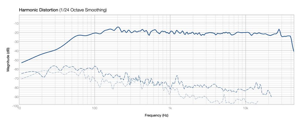

          You know, there's no substitute for measuring verification. The notch filter on the SMJ Calliope is a good example- totally cleans up the top end HD3 induced from resonance amplification as well as the frequency response. And the Q control can be a resistor in series with one of the reactive elements.
          Here's example measurements for the DA25TX, raw, and in the Calliope system
Name:	DA25TX00-08 0 deg Distortion.jpg
Name:	Ref Voiced Notched Disto.jpg

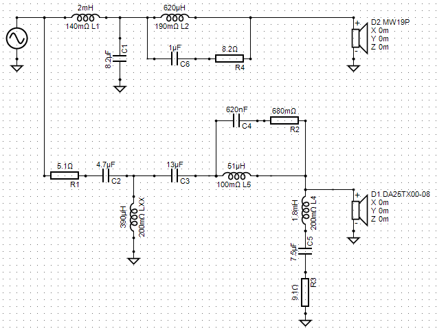

            Do you have the filter schematic for that Jon so we can compare the implementation to the white paper?
                Sure- here's the schematic for the Calliope two way -
                  • 1678
                  Right so the series connected notch filter, that's in parallel with the driver, looks like it's tuned quite low in frequency.
                  The one before that, with the tiny inductor and which is very similar in nature to the one in the purifi paper, is tuned for the ultrasonic peak. This definitely reinforces their research, which is great to see, and gives additional food for thought when using metal drivers.
                    • 16081
                    The LF notch filter like that to kill the initial woofer breakup has been standard procedure for me, and given that I'm using my own concept of an LR3 since WAY back when (Modula and Natalie P) it's something I'd consider tried and true; and it's just the added parts tuned to work with the second inductor. With those quasi series crossovers, I think folks were so confused by the overall topology that they didn't really notice the notch filter.
                    For the Tweeter, I wind up using something in the range of 25 or 50uH. Not easy to get those values, but then you can unwind larger parts, too. I like parts that are clean enough up top to not need that (like the SS 6640, or the BlieSMa T25B-6) but there aren't many in that class.
                    For one design, I use a 15uH there...

                      What made you turn to a parallel XO in the Callipe then?
                        • 16081

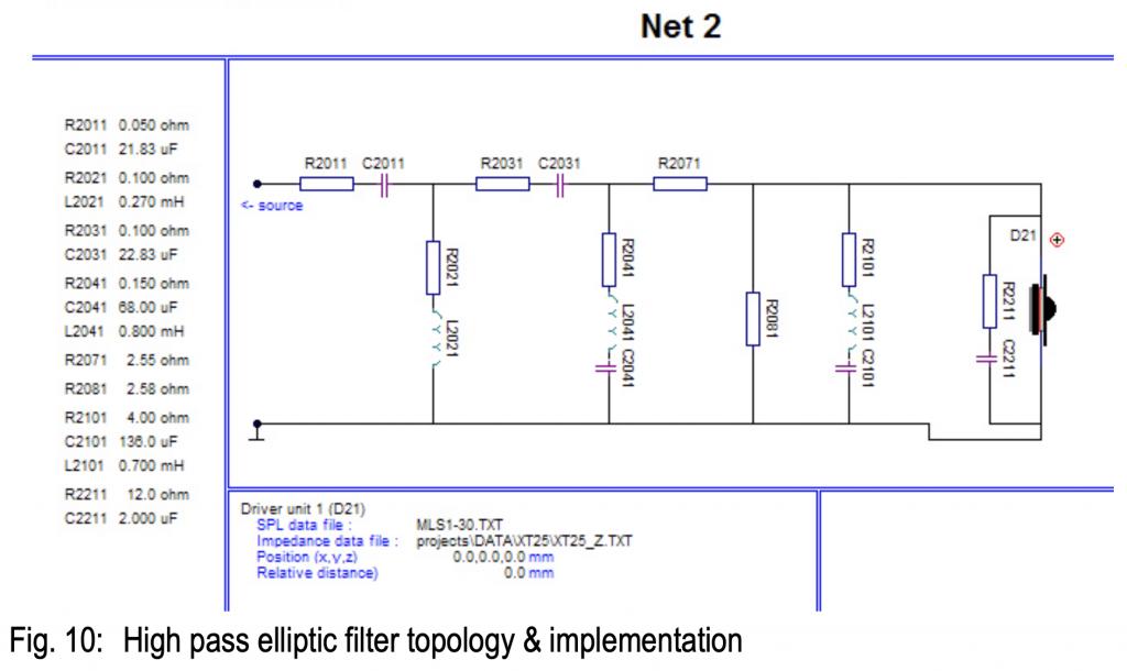

                        I think you're misunderstanding that- the network in parallel with the tweeter is an FS zobel - it's purpose is to flatten the impedance curve of the tweeter, so that their isn't interaction with the crossover filter, and the desired roll off curve can be achieved.
                        I have used parallel elliptic filters in a crossover in order to get a controlled high order roll off but using fewer components on occasion- such as having a nominal 4th order network but getting a 6th order curve for an octave or so around the crossover point. An example is the high pass tweeter crossover for the old M8 project.
Name:	Screen Shot 2022-04-05 at 8.46.29 PM.jpg
                        But that was a function of C2041 and it's interaction with the shunt inductor L2041. There is also an LCR network in parallel with the tweeter, but that is also an FS zobel network.
                        The M8 PDF explains it fairly completely. That used to be available as a linked download, but the functionality on iCloud changed. Due to all the graphics, it's a large PDF, about 48 MB, but it's no problem to send via Apple Messages. But email will rarely work. Most systems still seem to be limited to 20MB or so.
