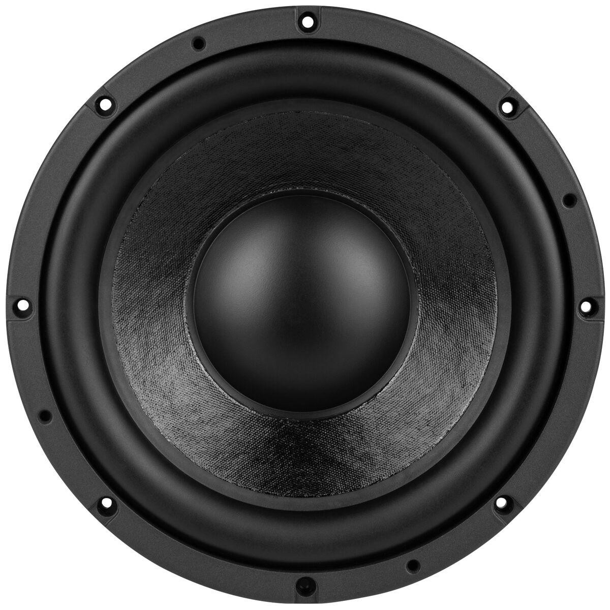

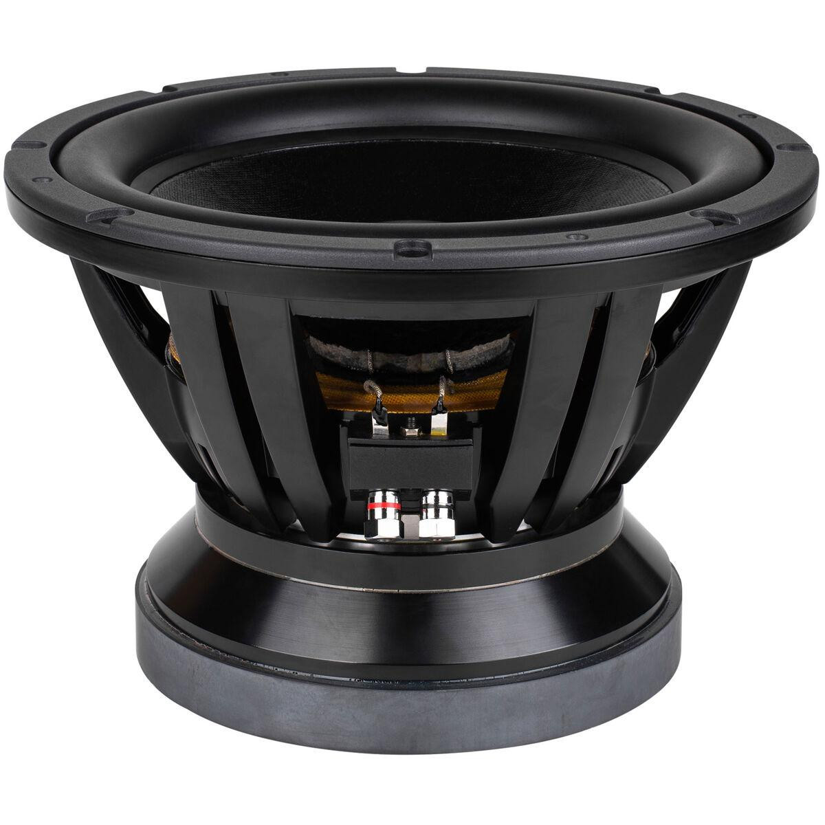

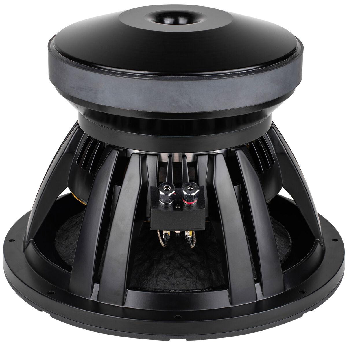

    The subwoofer of choice for this project is the CSS SDX12 XBL2 12". I took advantage of the last sale for Black Firday thanks to technodanvan who shared the sale that was going on. The sub is a monster as Steve has shared with me, I've only seen photos from Parts Express. The photos below clearly depict this sub could be used for an anchor.

    I will let Steve upload some images of the cabinet design. The colors discussed match what has been done already, the Bamboo and the dark lords favorite color... Black šŸ˜…. The plan is to build two cabinets that will reside on each side of the center channel.
    Looking forward to the new year for this project and all the fun to come along with another DIY build!

              Does CSS provide for having a bracing support at the rear of the magnet assembly?
                • 1554
                Not unless they updated the SDX12 since I got mine. Judging from the pics Sven posted I'm thinking no such updates have been implemented.
                  • 2135
                  What are you thinking it should be supported?
                    • 1554
                    He has a sub...maybe it was a Peerless?...that is a fair bit heavier than the SDX12 and has some bolt holes on the rear to brace the frame and support the magnet with the cabinet.

                                                                        Well things hit a bit of a speed bump when I test fit the woofer into the baffle. It didn't fit .... at all! I've found over time that for the most part drivers match manufactures drawings reasonably well. Any issues I find is in the required depth for the flange to fit flush. I checked that since I have the drivers on hand and adjusted the CAD and CAM files accordingly. Well imagine my surprise when I discovered the driver was too large in diameter, by 3/16"!!!!
                                                                        So .... most of Friday was spent trying to figure what happened and if I could salvage the baffle which had turned out rather nice. What I discovered was CSS Audio has updated their SDX12 drivers, but not the drawings to go with them.
                                                                        The pictures on both CSS and Parts Express reflect the older model ....
                                                                        This is what's shipping now .....
                                                                        After determining what happened I looked into how to fix it. My conclusion due to the fact that the baffle is curved as well as having a radius on the edge of the driver opening is that I will have to make a new baffle.
                                                                        So for those looking at buying any CSS drivers be aware their drawings are questionable!
                                                                        I still think this is a really great looking driver, and well designed for the application. too bad about details like this creating problems
