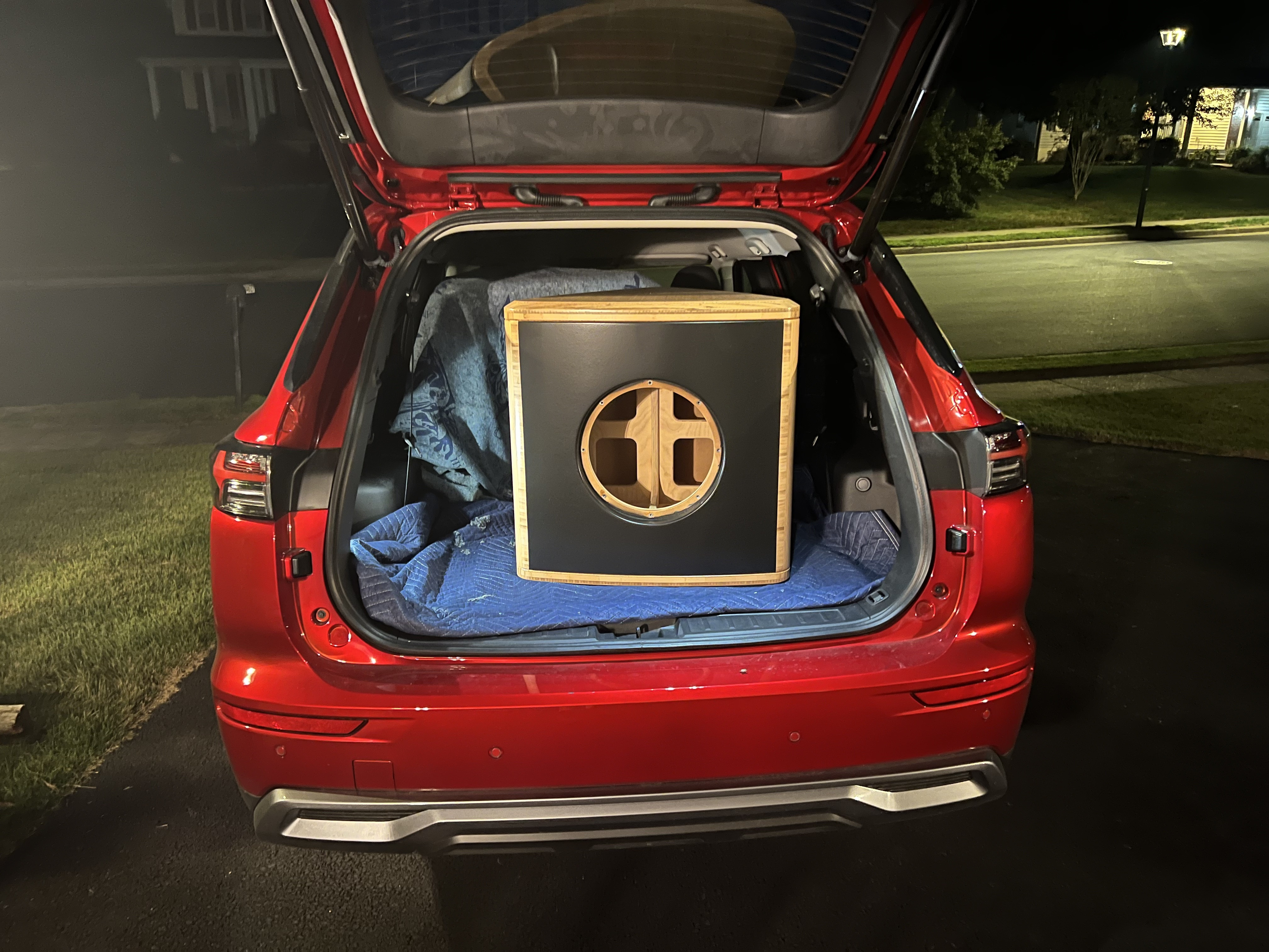

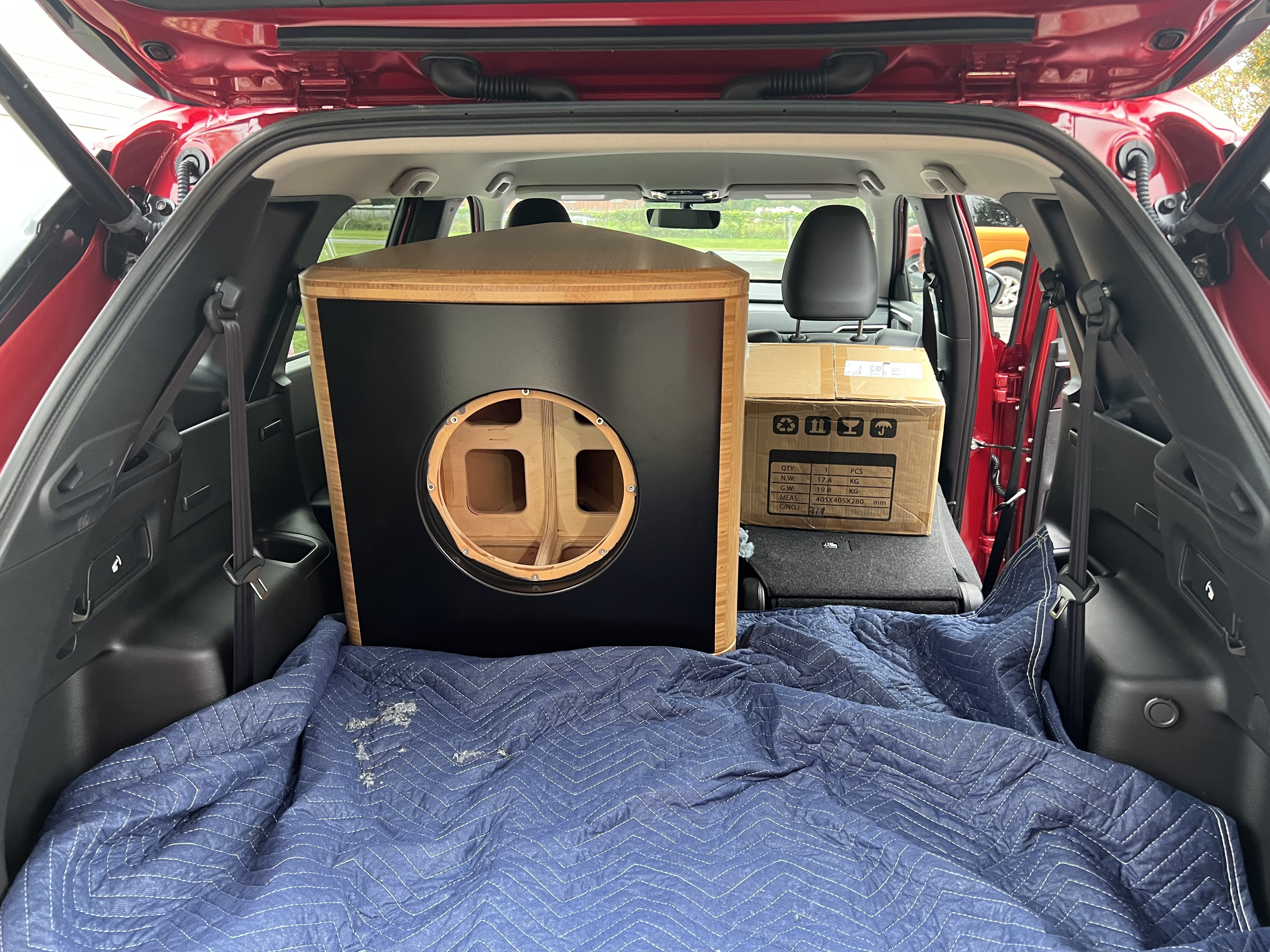

            I rented a car yesterday to drive up to SMJ Audio to pick up the subs. My car is too small for two cabinets to ft. I could have possibly fit 1, but definitely not two!
ID:	959379Click image for larger version
            First cabinet in the car, and then unloading the cabinet once I got back to the house. I was glad these were heavy and did not slide around at all with my driving.

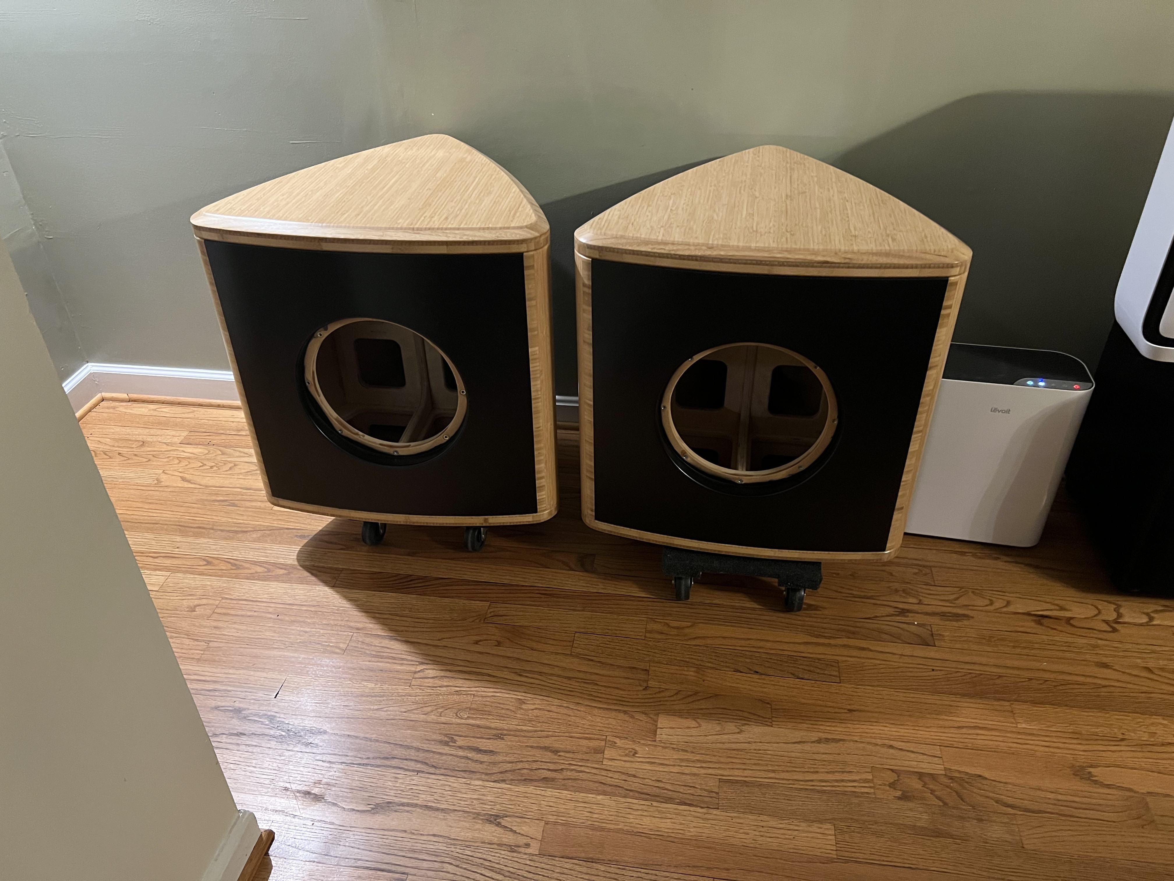

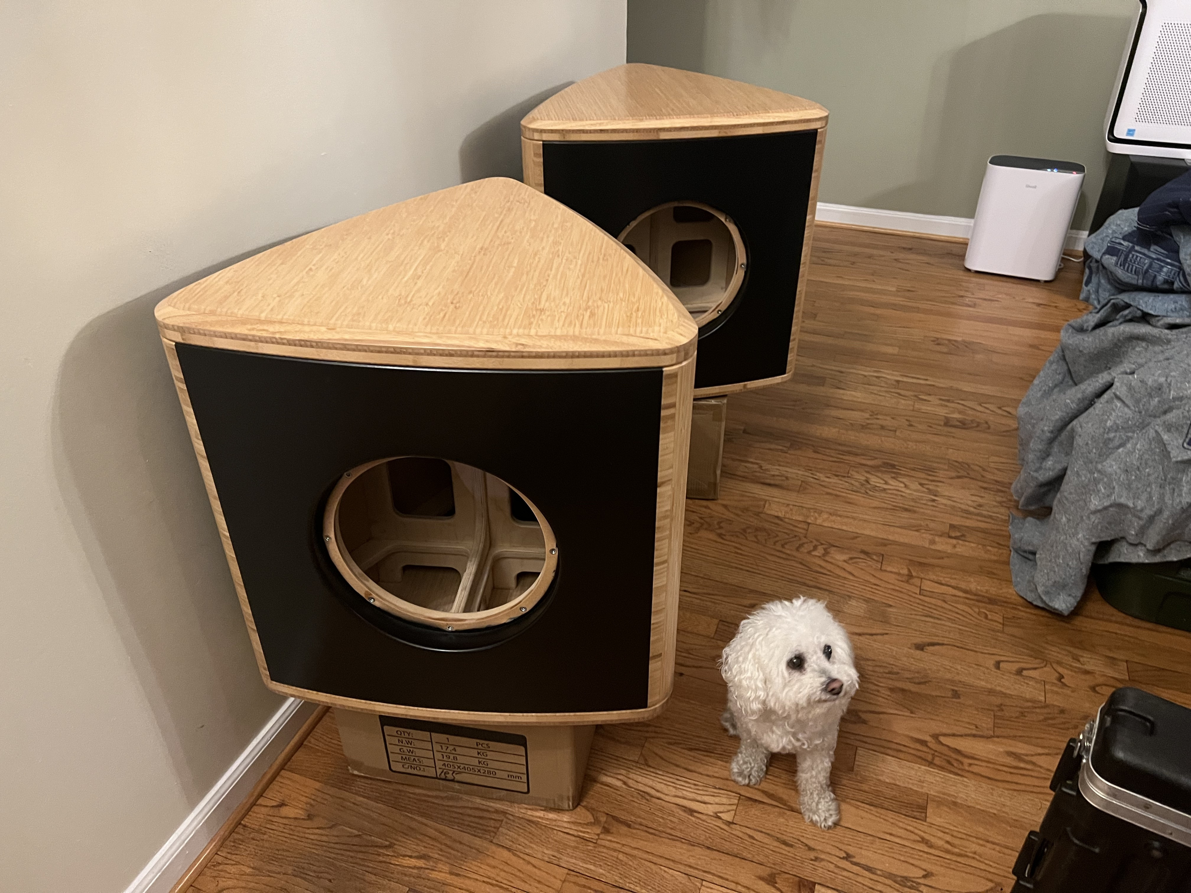

            I moved the subs inside and set them on the boxes at first, My 12 lbs dog next to the cabinet to give a sense of scale.

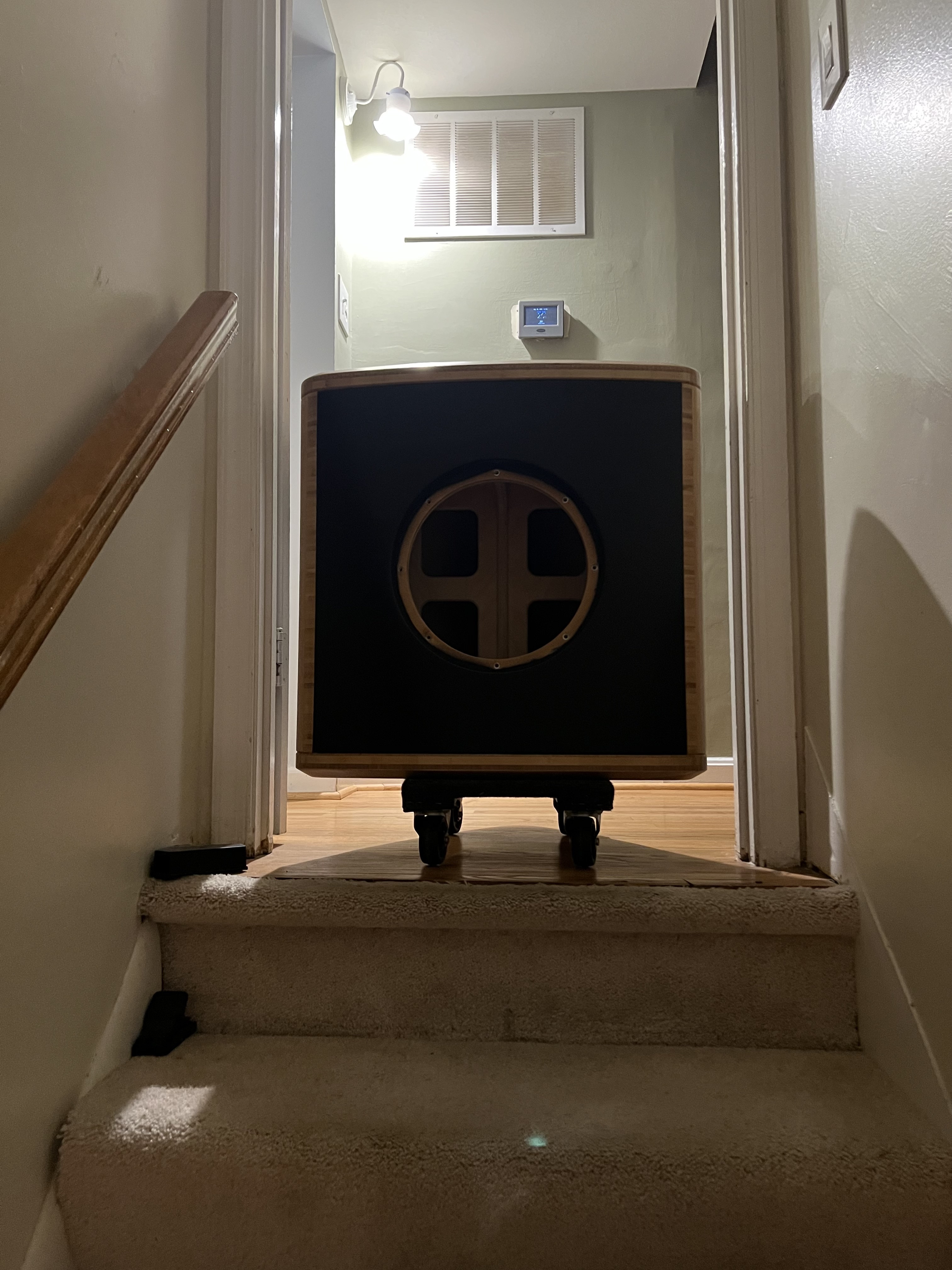

            I moved the cabinets to furniture dollies to maneuver to the stairs.
ID:	959383​ Click image for larger version

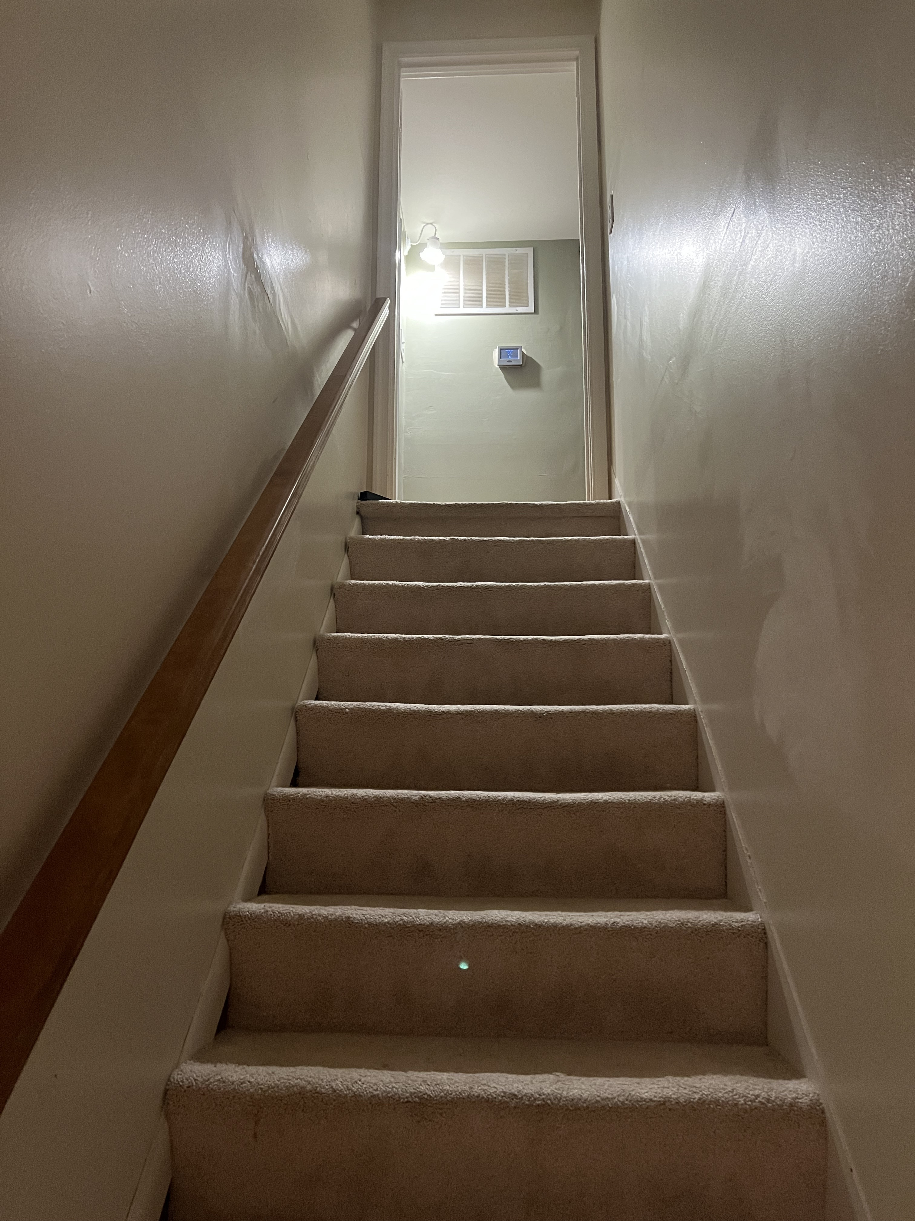

            I slide one down the stairs and carried the other one walking backwards down the stairs. That way if I needed to set it down I could do that easily.
ID:	959385 Click image for larger version

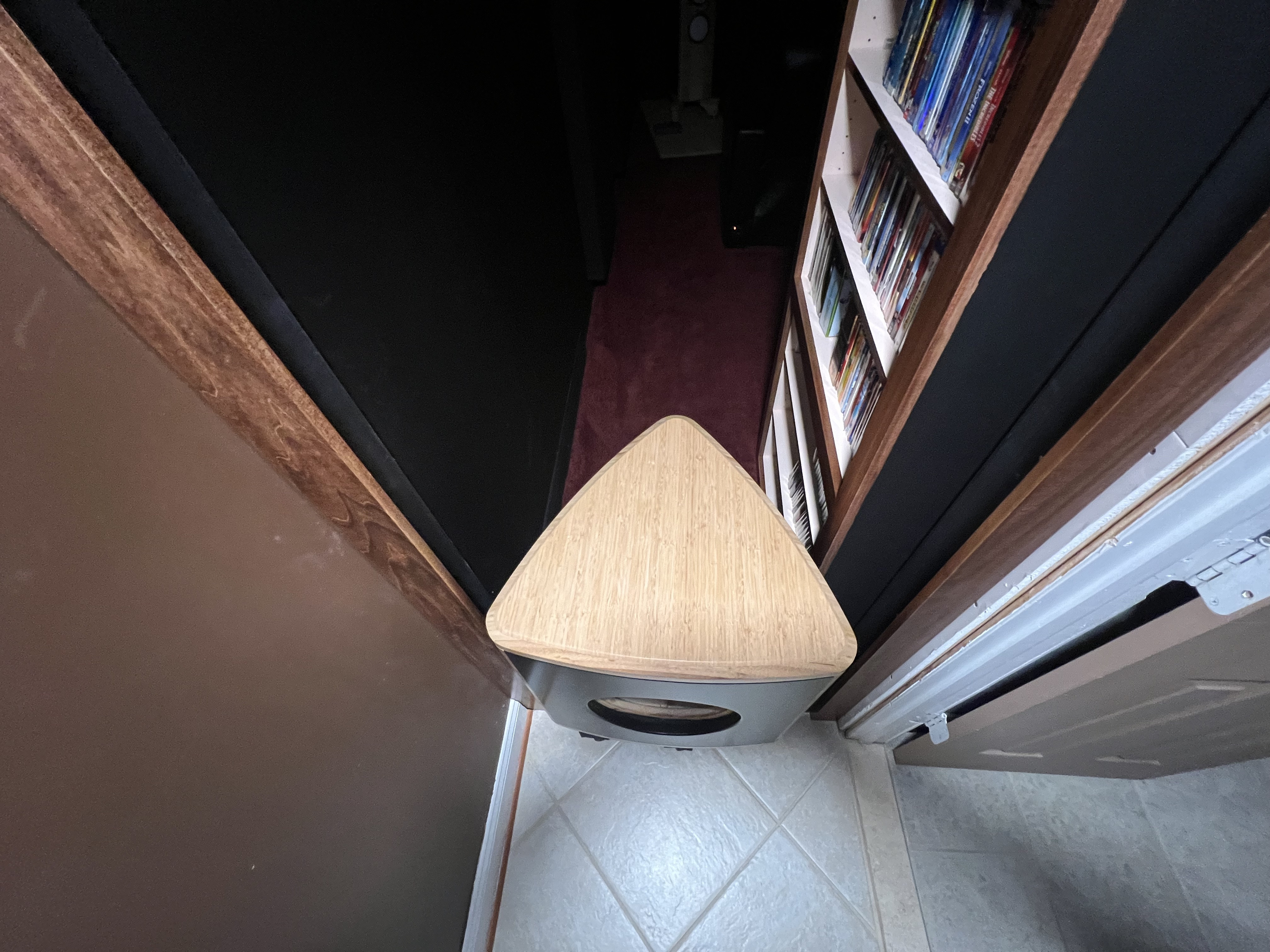

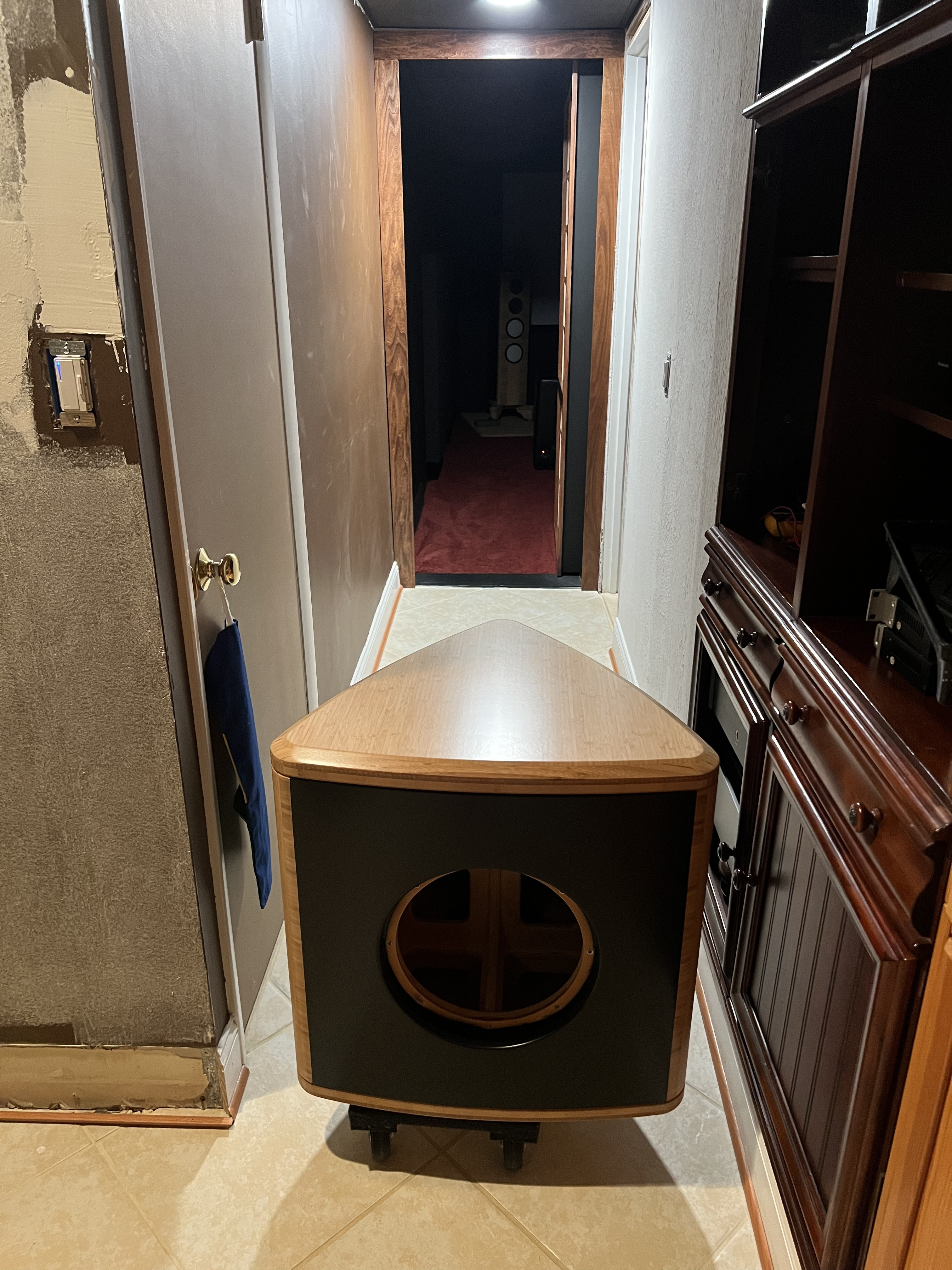

            It was a tight squeeze getting these cabinets into the theater. I was happy I could get them through the door without having to remove it.

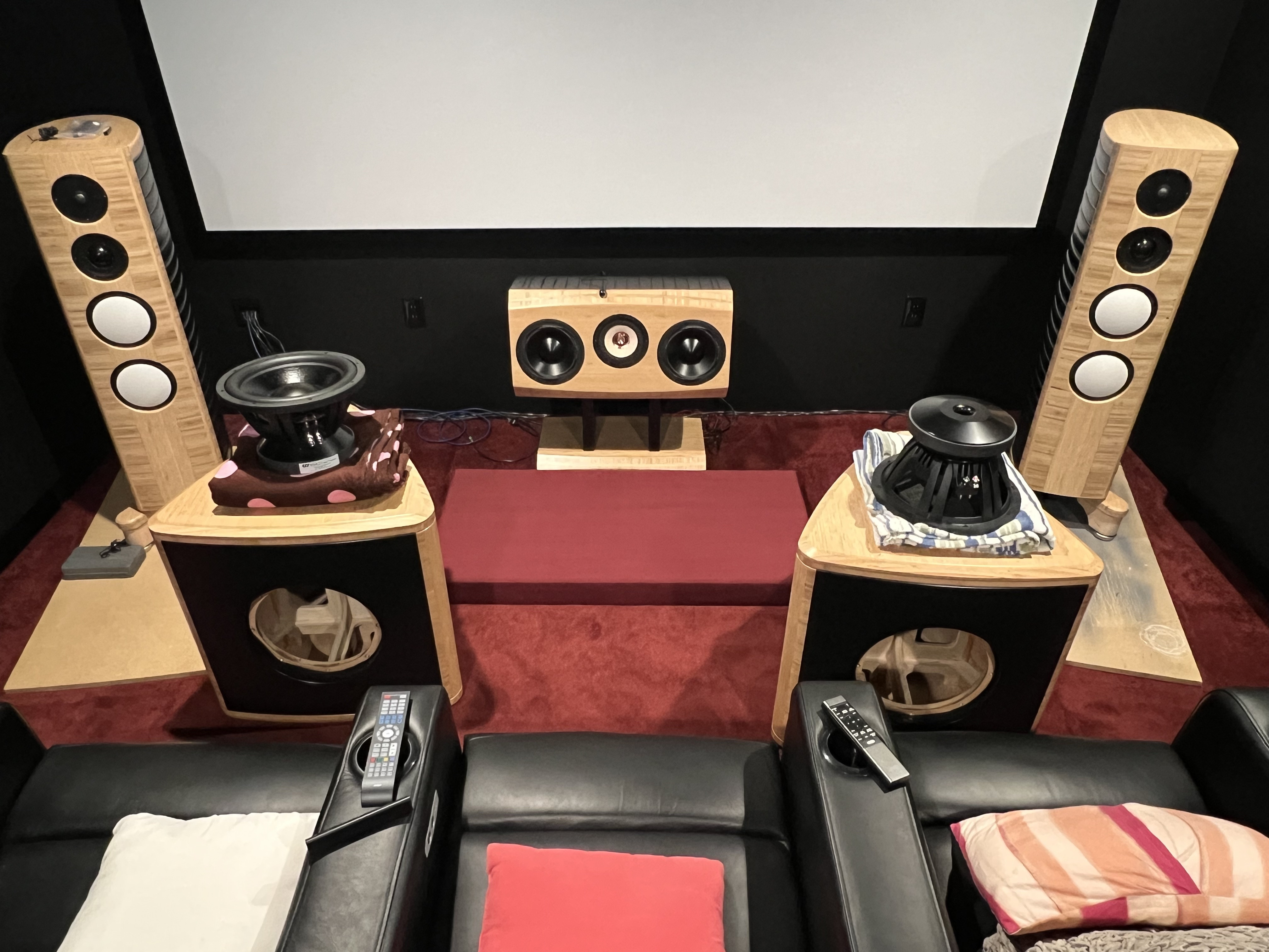

                    I got the terminal binding posts installed yesterday. I will install a woofer today and take a dats reading and then begin adding the stuffing. Oh and I need to install the feet. Progress...

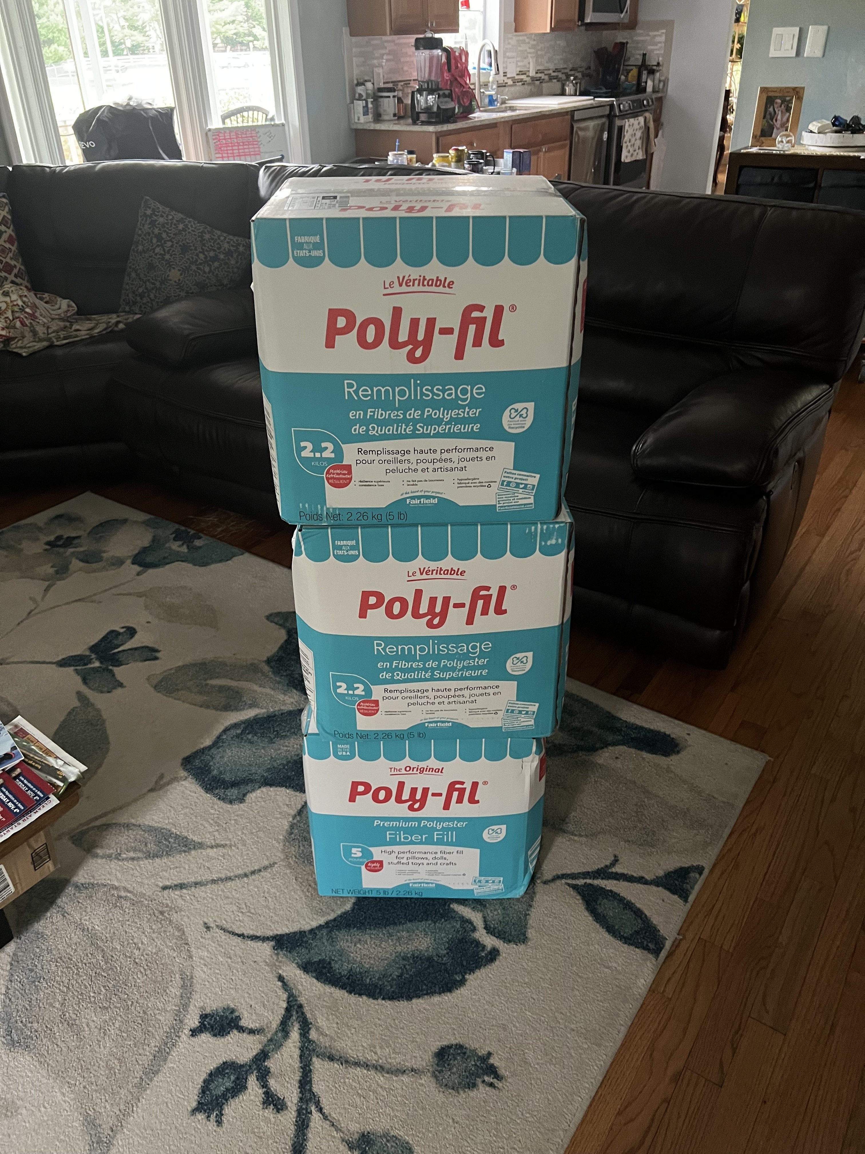

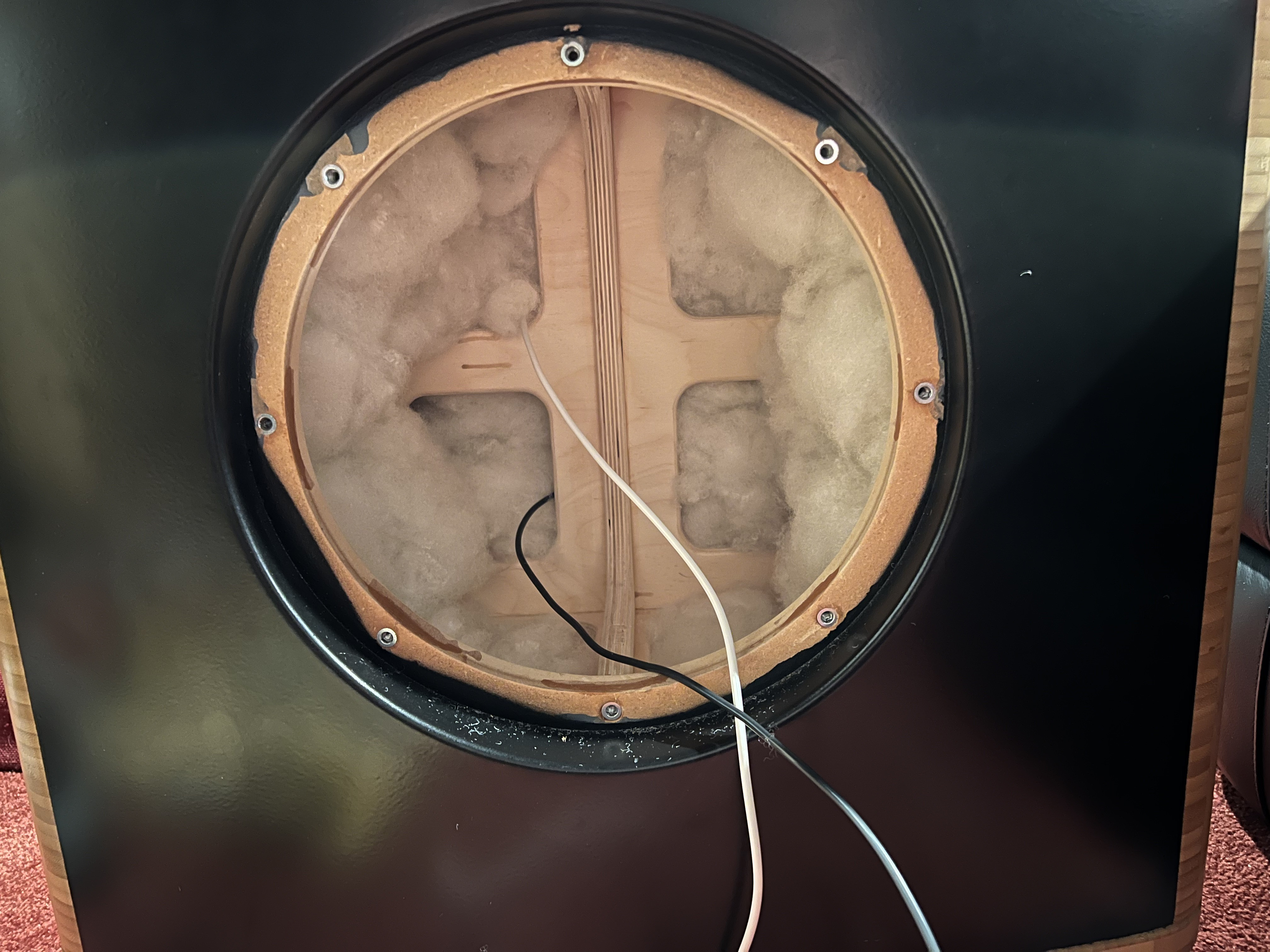

                      Over the last few days I have been getting the subs put together.

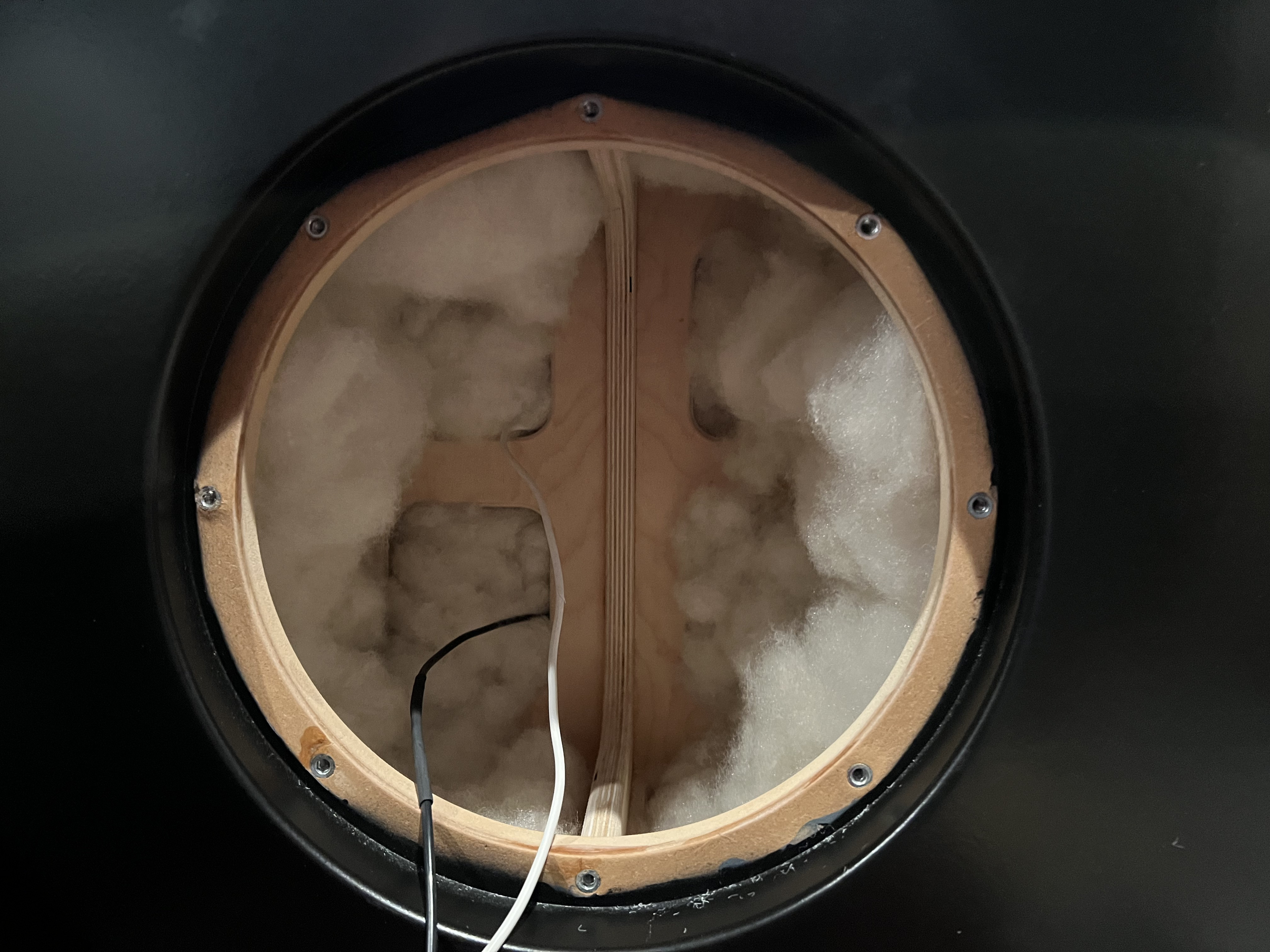

                      I bought a bunch of fill for the cabinets. I ended up using 1 box per sub.
                      The hardest part for me assembling the subs was tightening the bolt on the binding terminal. What I ended up doing is using a lock washer with a washer and the nut. I used a ratchet socket with a needle nose vice grip to hold the socket on, and an allen wrench in the terminal hole to spin it around to tighten. That worked really well!
ID:	959399 Click image for larger version
                      Both cabinets stuffed with fluff

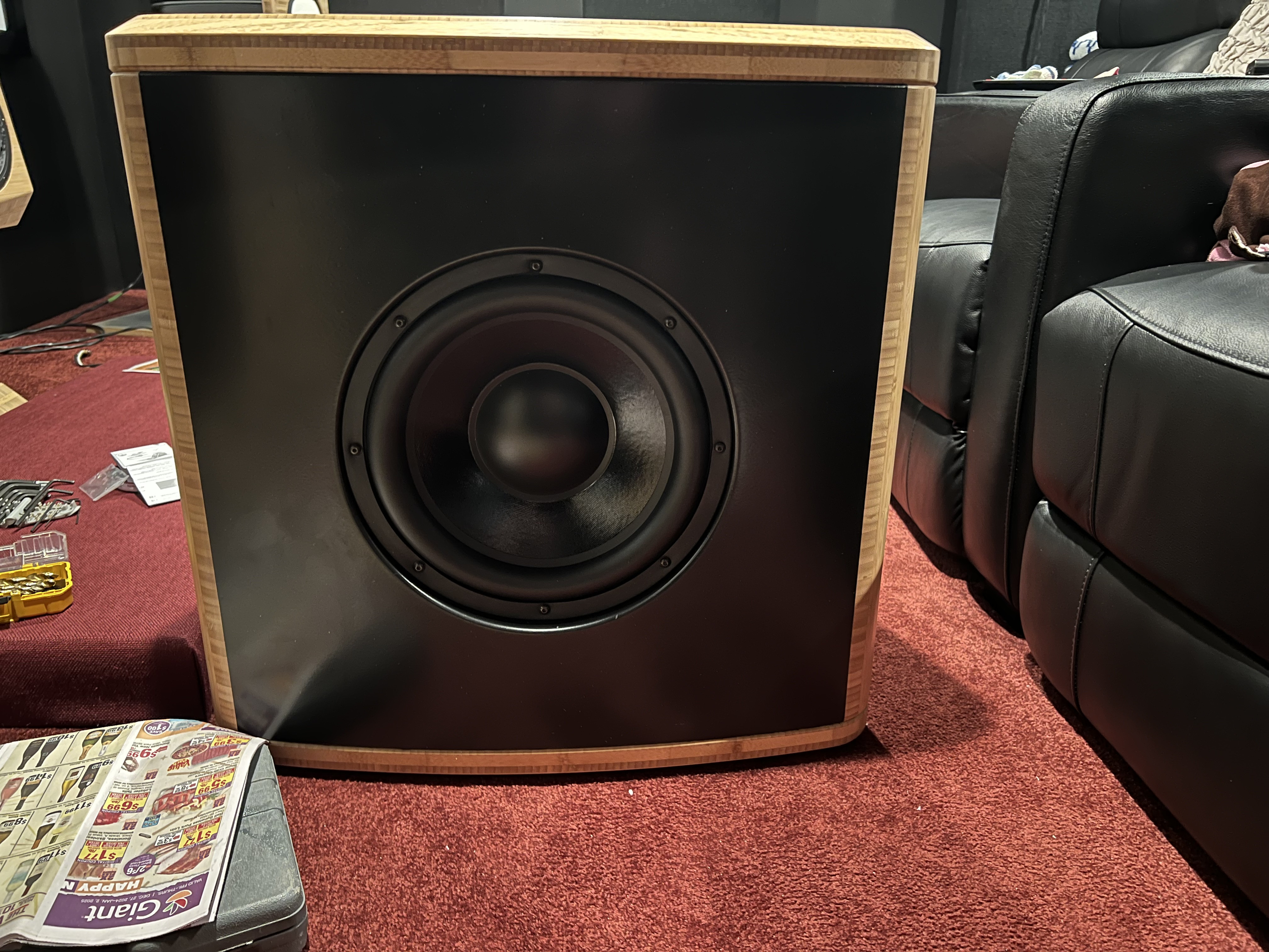

                      One sub mounted in!

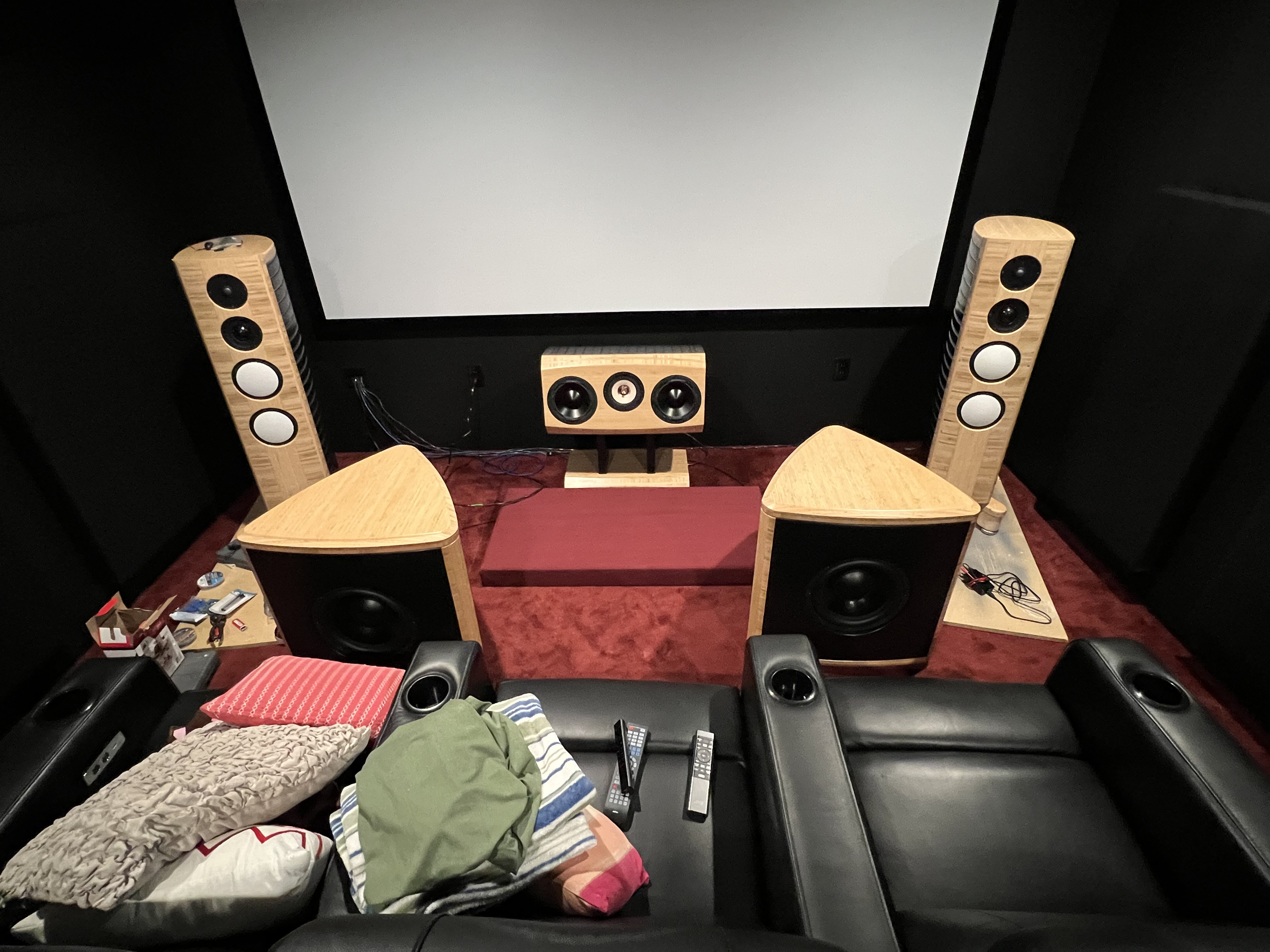

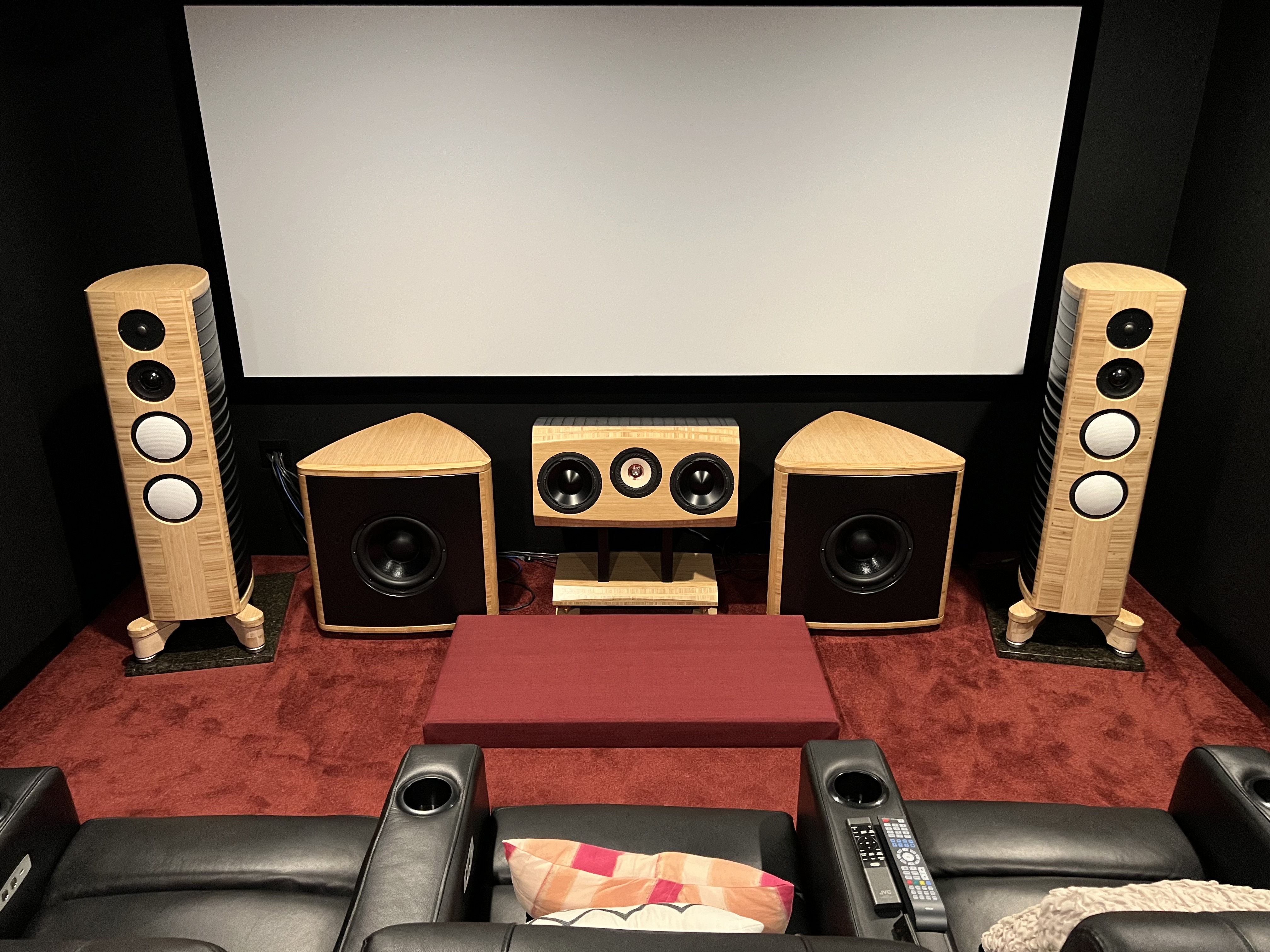

                      Both subs assembled, and starting to clean up the room.

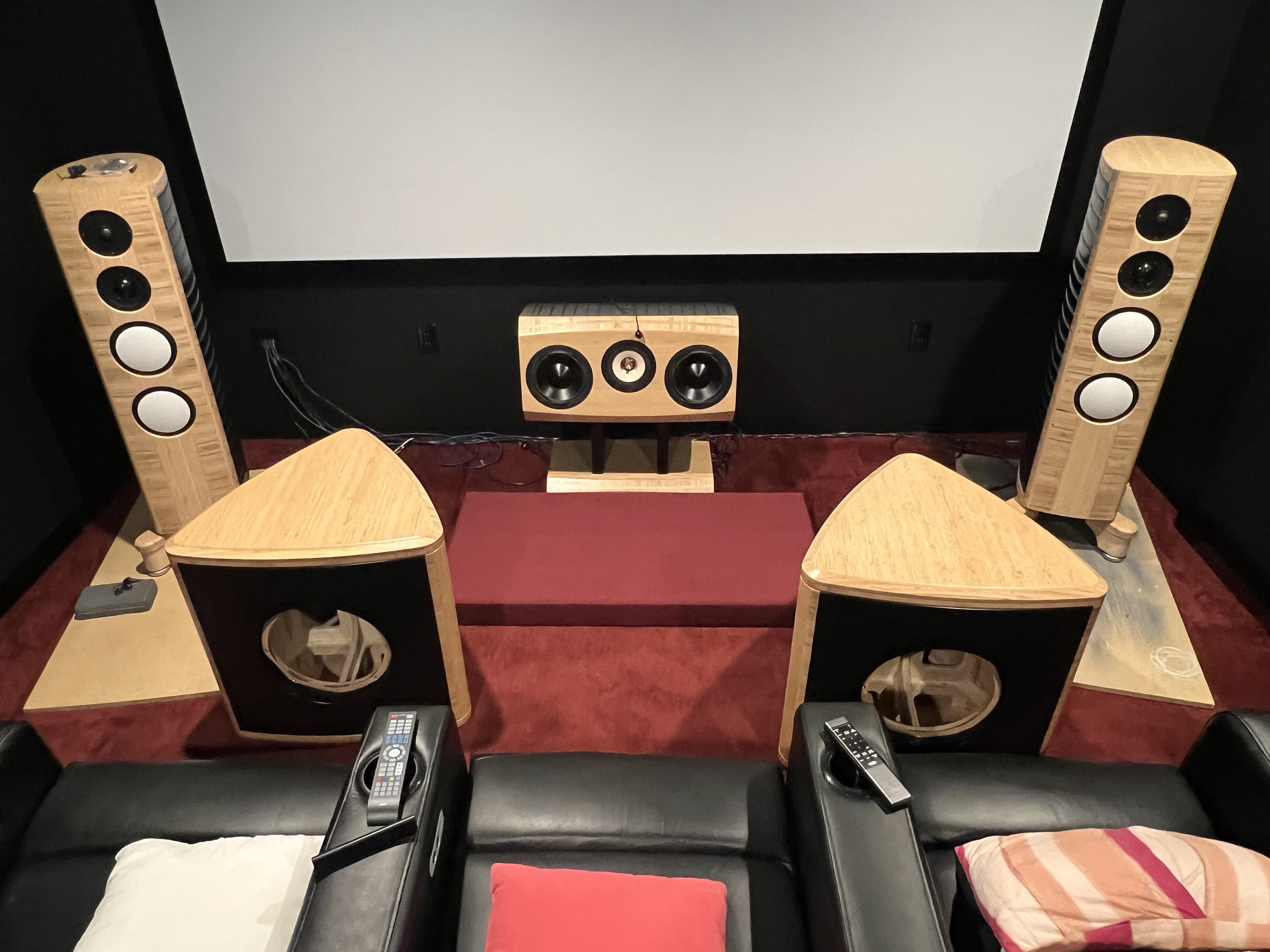

                      Room cleaned up and subs pushed into place. Yes, I know... I really need to get the granite pieces for the Ardent-D's. Now that the subs are done I can stop by some of the granite shops in my area.
                      Next up is listening and breaking these monsters in.

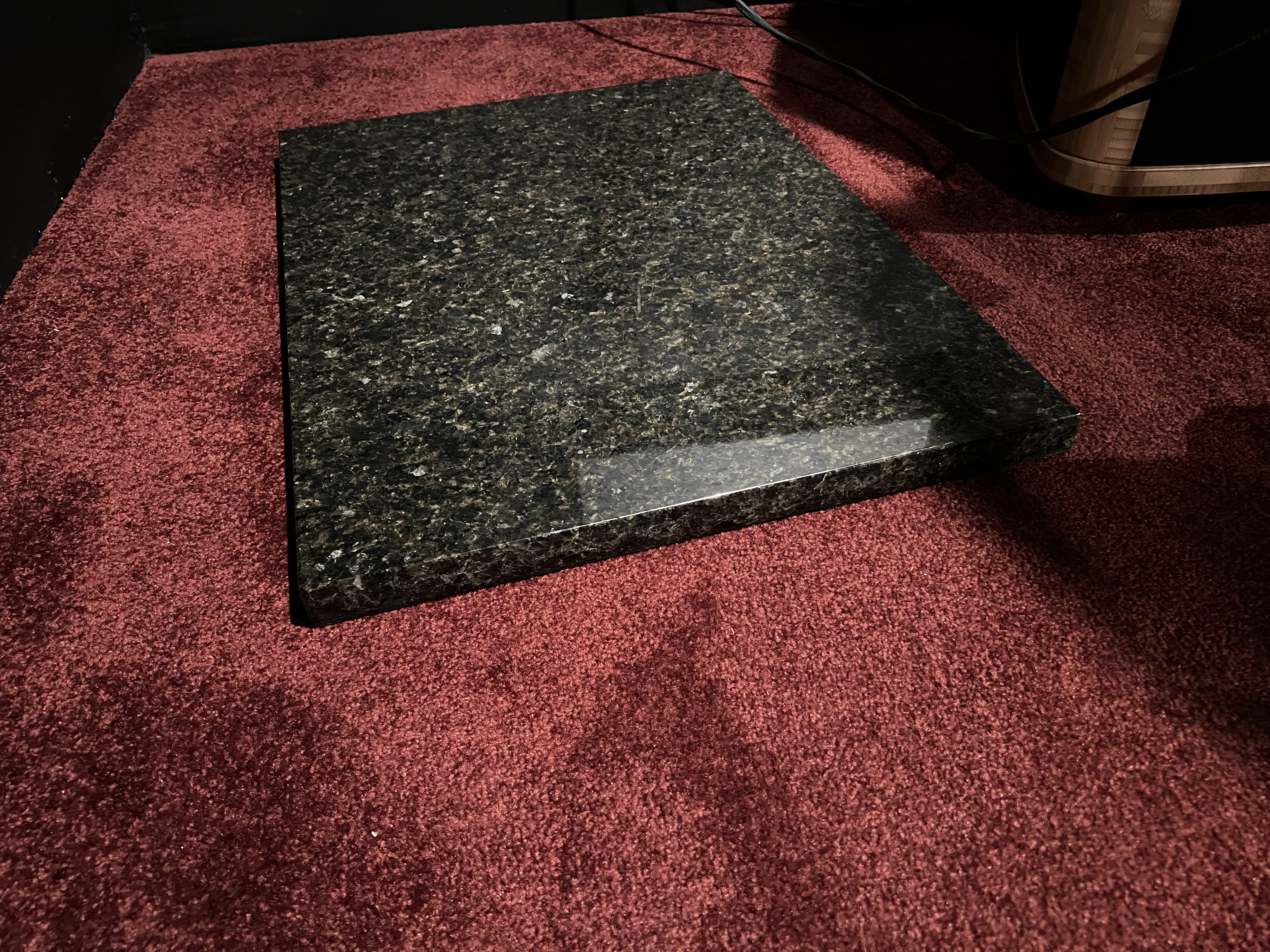

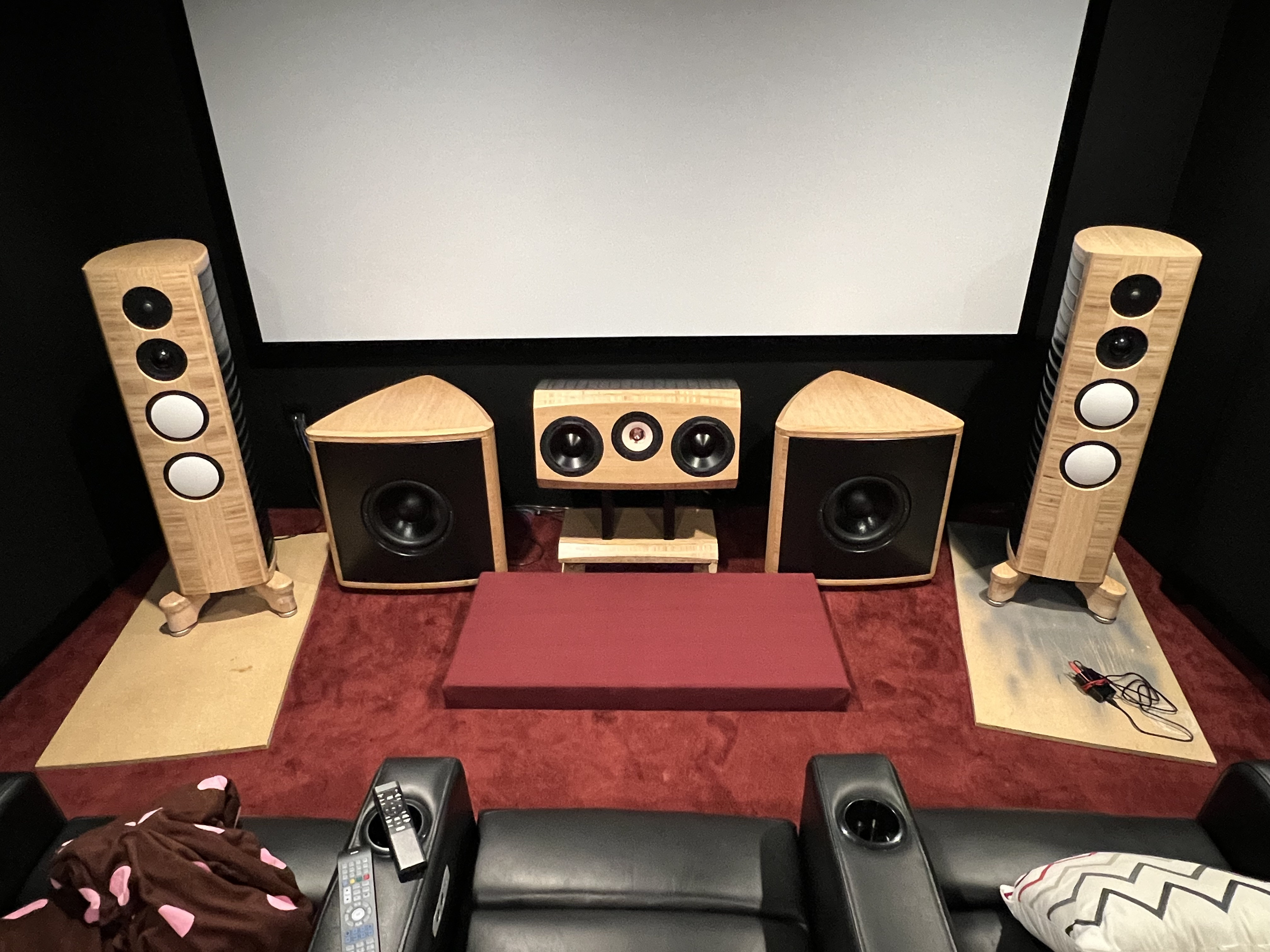

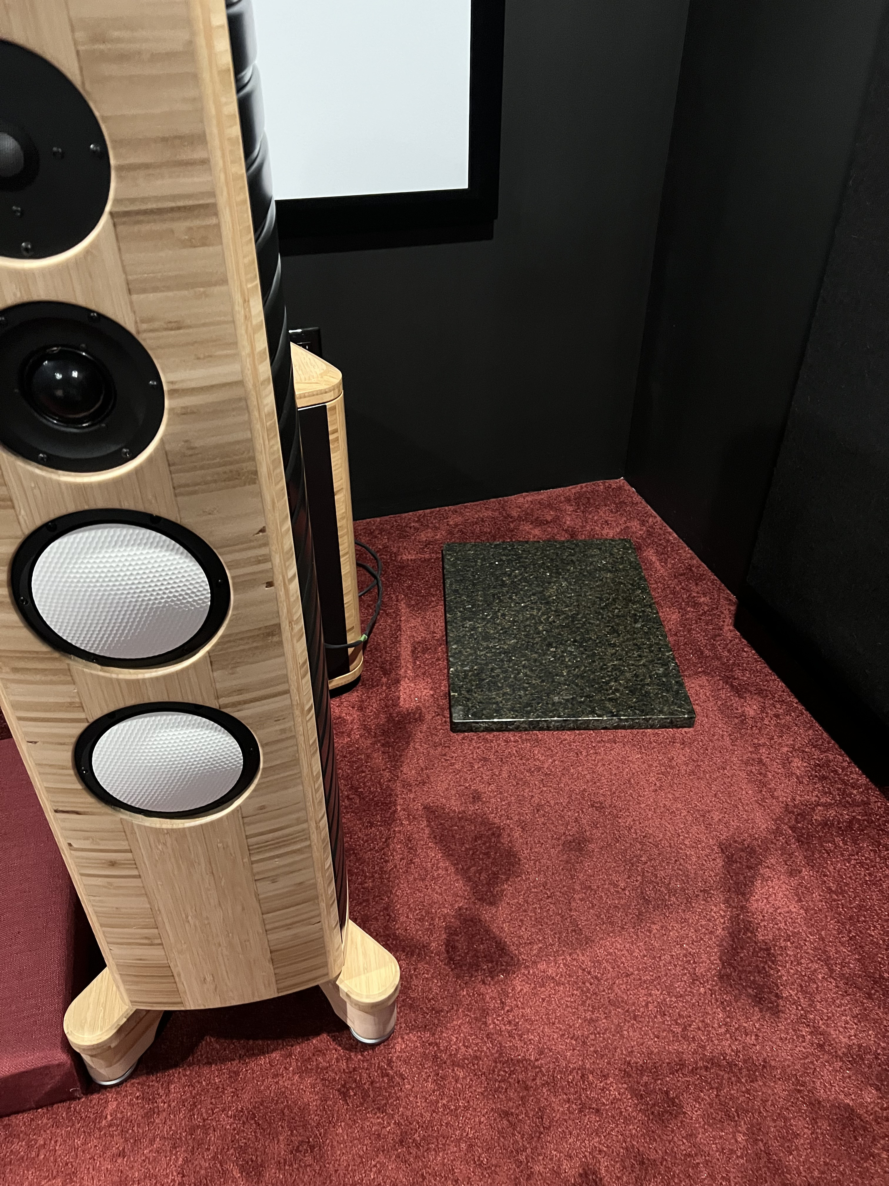

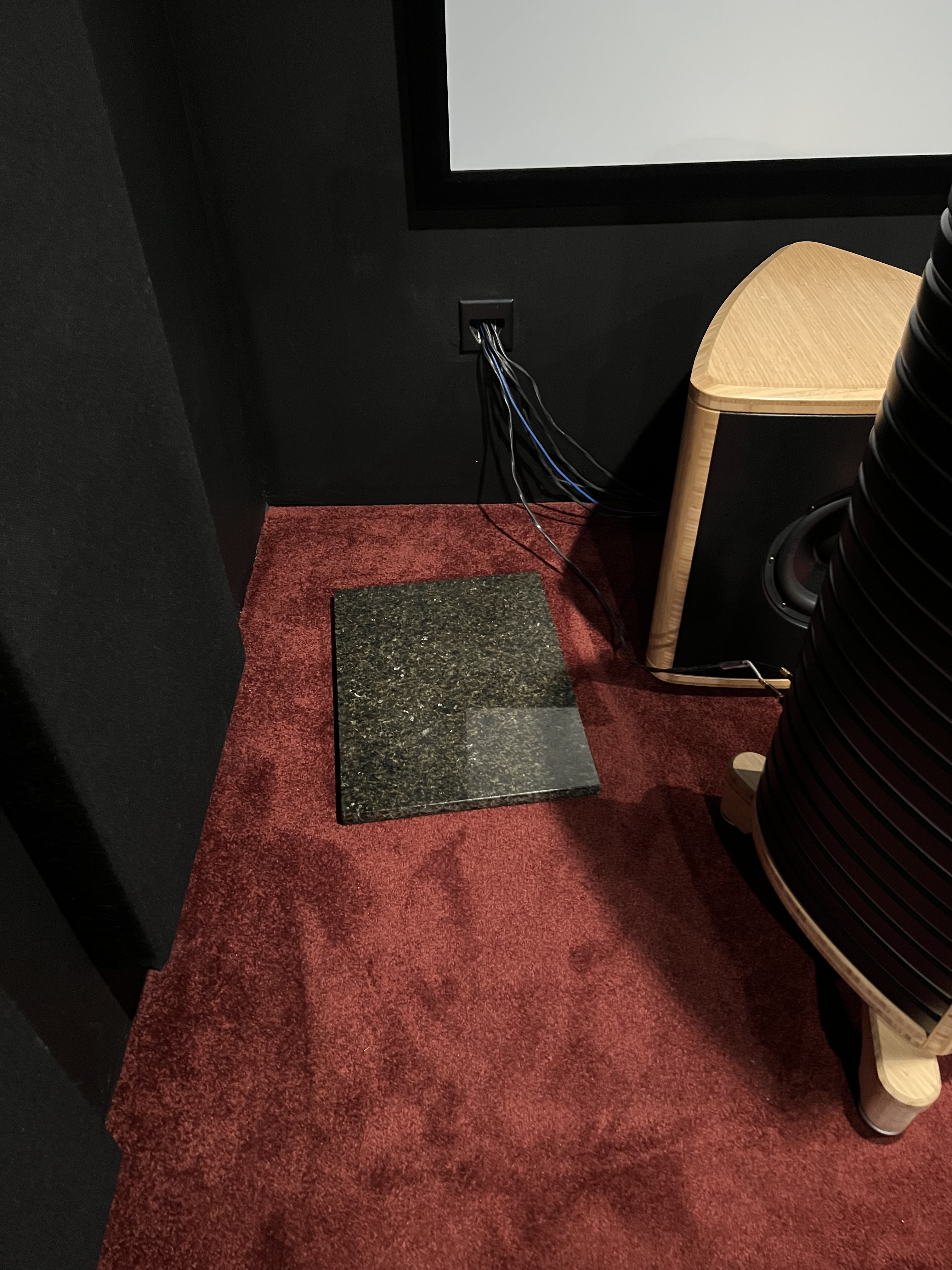

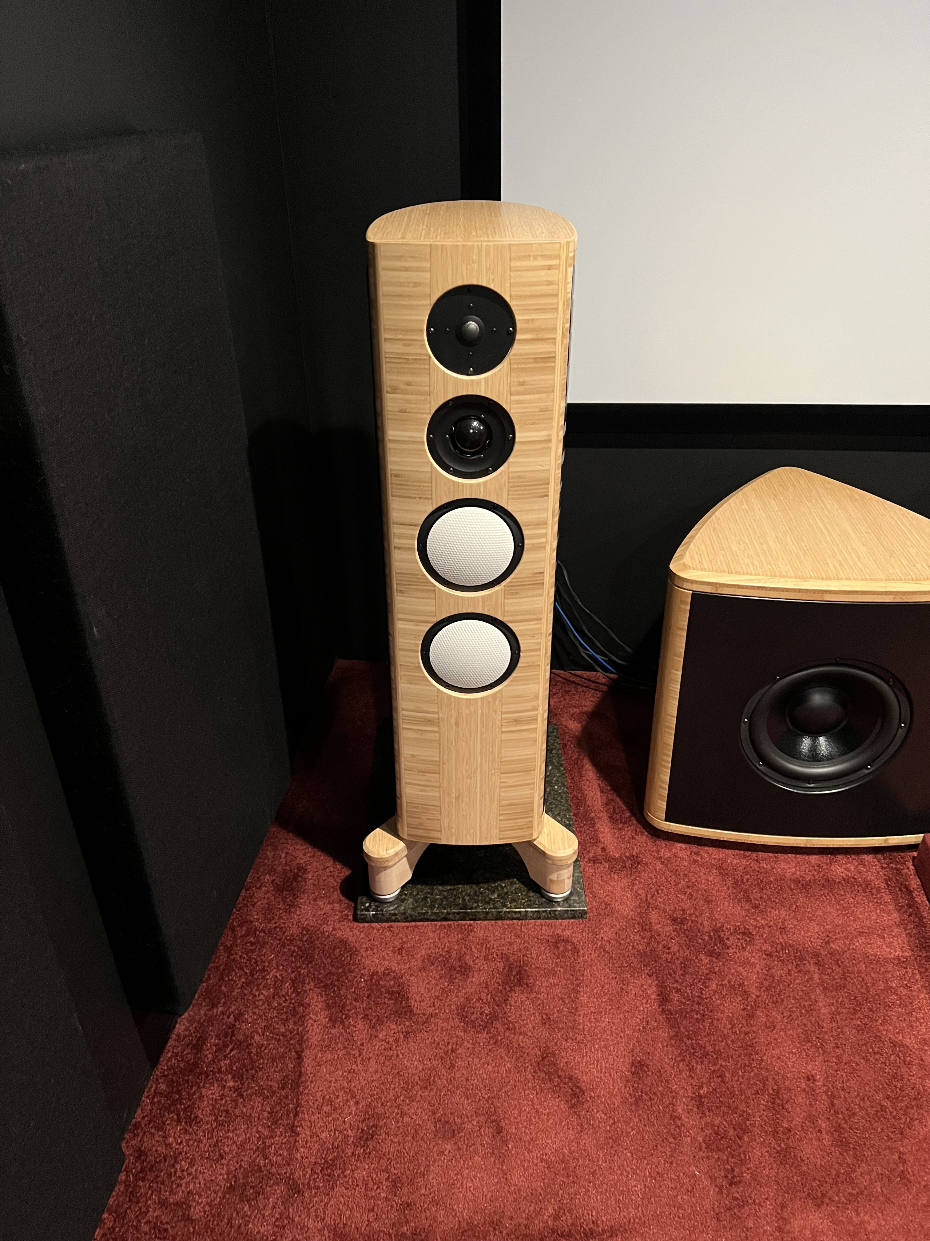

                                      I did do some pre-planning and ordered 2 granite pieces to replace the boards under the Ardent D's. I was able to pick up the pieces today and got them put in place before the next call starts.
                                      Now it looks like a proper theater setup with the boards removed and put back in the garage. The granite works nice to slide on the carpet to move these towers.
