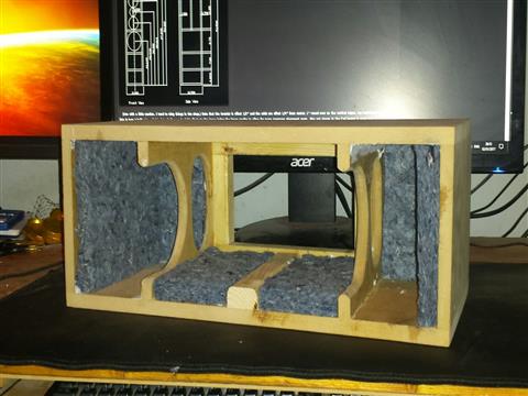

    Now with the Khanspires, I asked briefly in my old thread and e-mailed CJD about the port since I can only get 70mm and 100mm flared ports (dayton not precision), not the stated 3". Unibox was telling me 70mm could be too small, but CDJ kindly assured me it would probably be fine but he prefers overkill.
    I Have since ordered and received the 100mm ports. Holy cow these things are huge!
    So here's my concern. In my mind with a larger diameter, wouldn't it require more airflow for resonance/output to occur? So will it require higher volumes/driver displacement before the port starts to do it's job? I hope this makes sense.

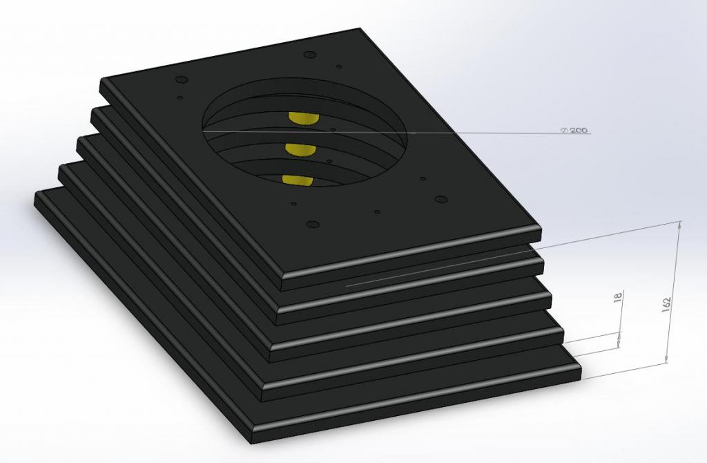

    One other concern I have is that I bought some Monacor 35mm spiked feet, but with such a heavy enclosure wouldn't these be prone to ripping out of the MDF base if someone leaned on it?
    I really appreciate the help you guys offer.
    As a side note, I included a picture to show the size of the port but also to show CJD I too like overkill. (I greatly underestimated how much 2kg of filling is, and I could only get a 14m roll of denim insulation) That's a 2ft Ruler in-between the ports for reference :lol:

    Your concern isn't founded about the port. A larger port, tuned to the correct length, just means the amount of air movement is reduced for a given SPL- remember, it's area times displacement that creates output. As long as the net turning is correct (larger diameter port requires longer length for the same box tune), you're fine.
    Good luck with your build, and of course, feel free to post early and post often about how it's going- pictures are always appreciated.
      Looking forward to your build progress. :t
      I think Jon answered the port question. Regarding the spikes. Not sure how big those are. I'd suggest using plywood for the base where the spike screw in. Mdf is weak for pull out. And even with plywood I'd be somewhat gentle. These are big 50kg+ speakers. Somewhat top heavy.
        I guess these are the spikes you were wondering about?
        http://www.monacor.co.uk/categories/...et/vnr/129130/
        From what I can understand these are memt to be mounted from the bottom. They also seems to be fairly high. I would be very sceptical to that construction if I were you. For direct downward fore I think everything is OK, but it will require little force sideways to there those nuts out of the MDF.
        Maybe if you could mount the nuts first, preferrable glued in place with some epoxy or simular - and then add a 3-5mm of plywood (or another quite dens material) above it - glued to the MDF and with holes drilled where the spikes is going through, that would give you a sturdy solution.

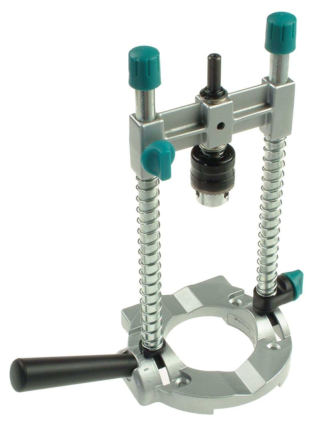

                      i use one of these:

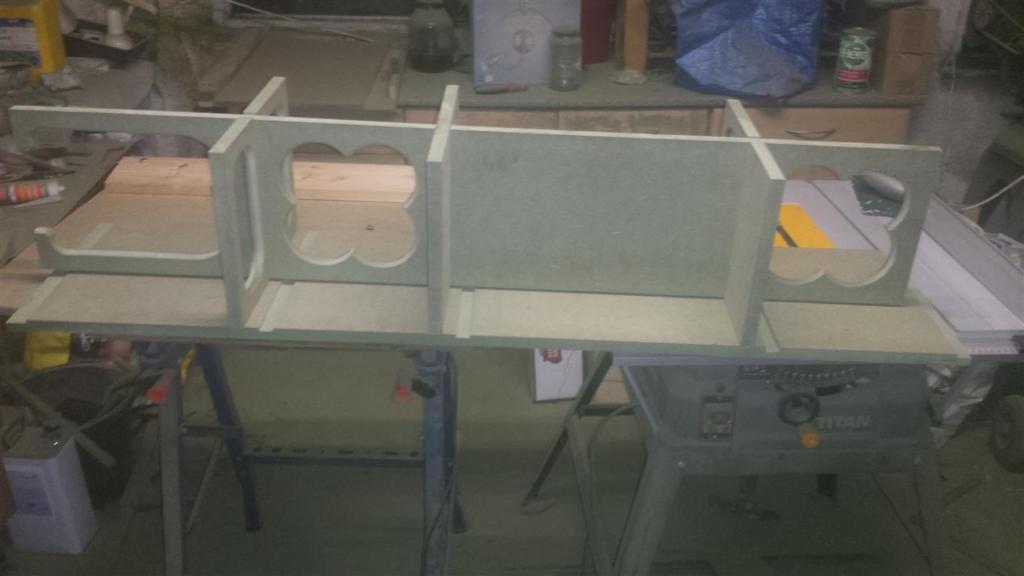

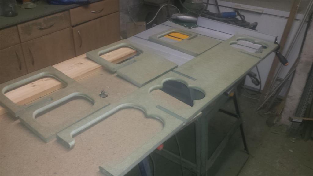

                        Absent of my drivers and electronics I've done as much as I can to the OS MTM, would you guys mind telling me if my lining is sufficient? I know paul 'lightly stuffed' his, so I'm trying not to go to crazy.

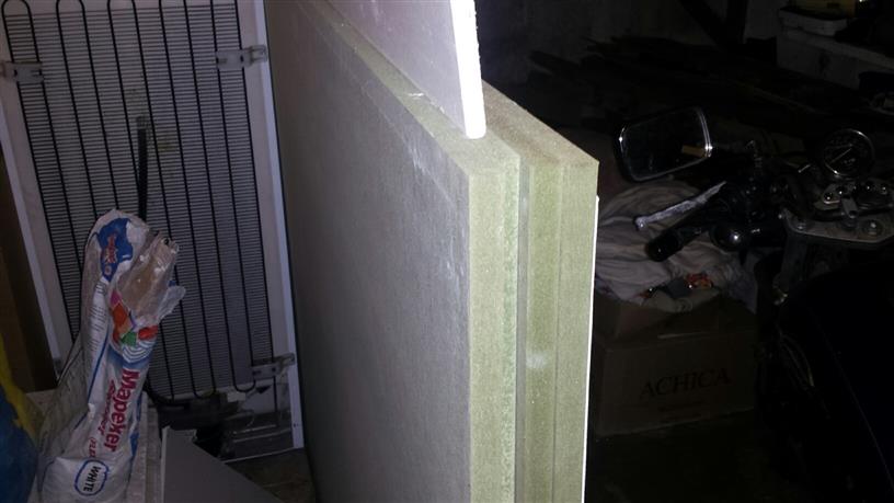

                        Finally, before I dive in on the khan's and start massacring some wood. Does my MDF look ok? strange and stupid question, but it's... green. Looks less dense etc.

                          I notice that wkhanna's photos show the inserts going into plywood. I personally, being paranoid, wouldn't trust any insert into MDF for spikes on a speaker this big. I'd use plywood for the base with the speakers. You can laminate it to MDF if you like. If you go MDF, I'd at least use some Minwax Wood Hardener on the MDF and epoxy the inserts in. MDF is great for somethings, but your right in fearing fastener pull out.
                          Can't say if your MDF is right or wrong from a photo. MDF will vary based on manufacturer. I've had light brown and dark brown before. I swore at times one was better than the other, but think that was only my anger due to my most recent mistake. There are probably some minimum standards for MDF out there, and I doubt manufacturers are exceeding them much. I'm sure it is acceptable. Remember, MDF is used because it is cheap, very machinable, and dense.
                          Your OS speakers lining look good to me, but I haven't built those or any of Paul's speakers. I'd probably try and cover the areas not covered. You may or may not still need to add a handfull or so of loose poly stuffing in the middle. Every designer is different in what they like. You might also want to vary the amount to taste. But, that can be done after the baffle is glued on and you listen to them.
                            • 2135
                            To add a little bit of info ..... I recently found out about what is called "cabinet grade mdf". I got it from an actually lumber yard. It is used in building kitchen cabinets ..... it is denser, you can tell the difference in weight and will take a finish a lot better than the Lowes variety. Cost was within a couple of bucks of what you get at Lowes as well.
                            One other comment ..... my 1071's are made from mdf and are a pretty good size speaker and I used threaded inserts for the spikes and have never had an issue with tearing them out. The biggest reason for that .... I remove the spikes prior to moving. I don't think it's wise to drag speakers around with spikes in place, regardless of what they are made from. You actually see companies like Wilson and Magico (their cabinets being aluminum) put wheels in place to move the cabinets around and only spike them once your done tweaking the final position of the speakers.

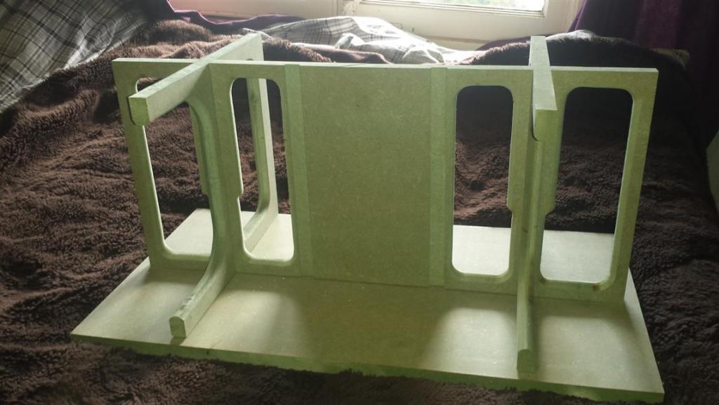

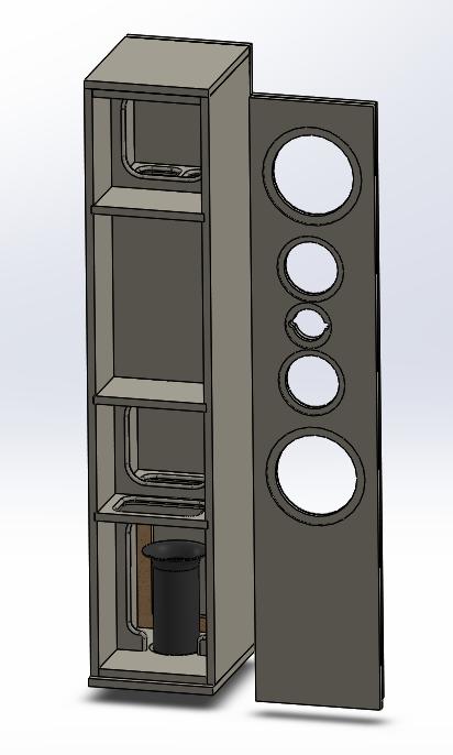

                                          Hello All! Hope your all well.
                                          Thought I would stop in with an update and a few questions. I've got my OS MTM up and running in my parents living room and its a huge improvement thanks a lot Paul.
                                          I'm sure glad I did the OS MTM to start with as well, having very little experience with woodwork I learnt a lot with the smaller build first and saved myself a lot of time and wood with the larger build. Everything is going to plan so far. Never used a router before, what a tool! I've attached some pics of my progress. I've gone so far over my original budget that I even cheapened out on the clamps and made some with threaded bar.
                                          A few questions, Is it possible to paint the pointy coney bit (good technical term) of the rs225? I'm guessing probably not a great idea due to the movement and sound quality but it would be nice if I could.
                                          I'm going to be painting these with an air gun and my plan is to seal the MDF with a 1-1 mix of PVA/water and straight PVA on the end grain before I fill and sand. Is this correct? I see so many different approaches it gets a bit confusing
                                          Thanks for all your hard work and as always I appreciate any feedback,

                                            Vent pole.
                                            I'm not recommending it. But, I believe the vent poles unscrew and you can paint them so long as you don't close up the gap between the pole and the driver. I swear I've seen someone do it once. A very light spray should be okay. You probably should experiment on a spare driver. This might be where the Y in DIY comes into play.

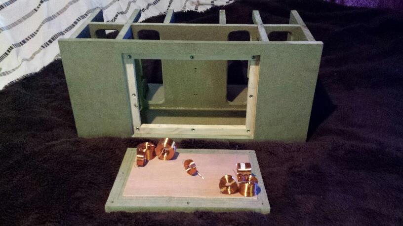

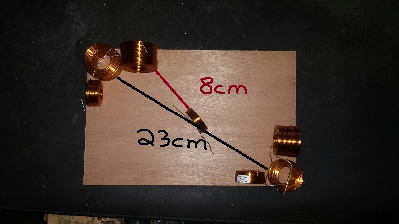

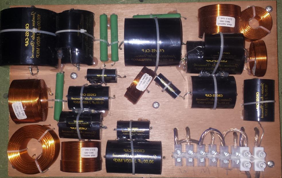

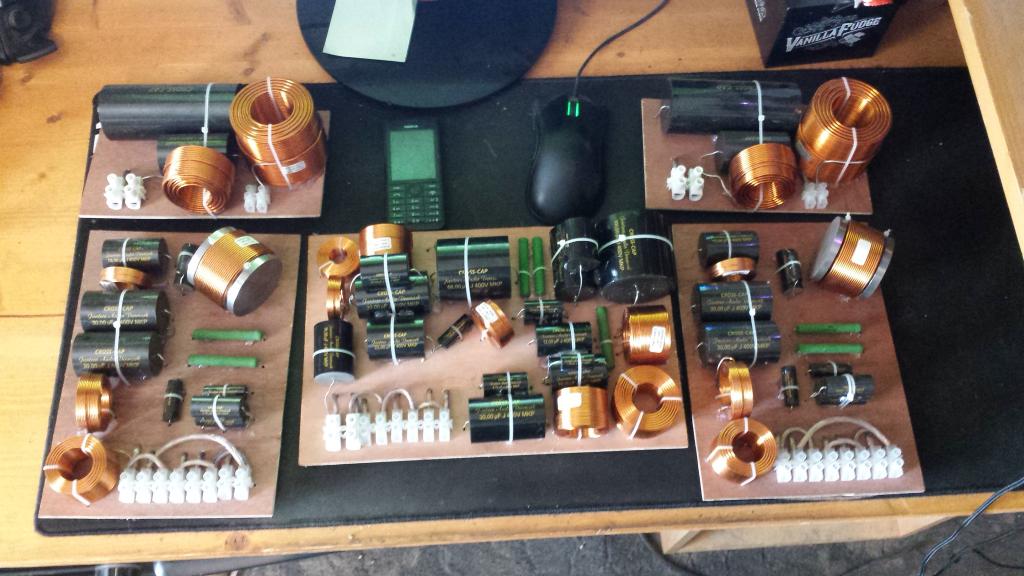

                                                Sorry but I have another boring question that I'm sure your sick of. with the inductors, I have seen the picture showing the acceptable distances and orientation but it does not mention placing them at 45 degrees. Is it possible? I assume there is still going to be an unacceptable amount of cross talk.
                                                Please see my picture to understand what I'm asking. I have seen the 3 coils close together before but I'm unsure about the middle one. Would really like to try and keep it all on one board for easy access.
                                                As always I greatly appreciate the help, I'm really enjoying this project.

                                                  Yes, we've all seen the dos-don't graphs. I think there is good and good enough.
                                                  It looks like you're trying to combine all the crossovers on one board. I separate mine out for a couple of reasons: 1) it makes laying out and checking the crossover easier in my mind. Just dealing with one thing at a time. 2) it avoids some of these issues. My tweeter crossover is in the tweeter box and the mid and woofer are behind the bottom woofer, and probably too close to each other and to close to the woofer.
                                                  I'm confused by your photo though. I count 7 inductors. The Khan crossovers only have 6 inductors for each speaker. Is that two mids and one tweeter? Maybe this is just theoretical? But even if this is an external crossover, I'd absolutely definitely suggest you not put the right side crossovers on the same board as the left side crossovers. You got to keep them separated. Not really, but the logistics of checking and maintaining is easier.
                                                  I've been told that 45* is better than nothing. This is my mid-crossover. I've never been chastized by CJD or anyone else, so I think it falls in that good enough category. You'll note the inductors are at 45*. They are a fair distance away, so I'm good with it.
                                                  I've learned most everything I know about crossover layout by staring for hours at photos of crossovers by Jon Marsh, CJD, and a few other gurus. I've stared at them, traced the graphs, and really tried to understand what goes where and how the ground wire loop works, etc. I think I understand them pretty good now. It just takes putting in effort.
                                                  Finally, I'll leave you a picture of Jon Marsh's Modula MTM crossover. I asked him about this once upon a time and don't remember his response. I'm guessing he'd prefer it to be different, but this was good enough and fit the purpose.

                                                    Well spotted as well, I should have mentioned that those coils were for the RS Centre which uses 7 instead of the khan's 6 however it was just a general question with regards to inductors at 45 degree angles.
                                                    I understand your points with regards to spreading them out. I would like to keep each crossover on one board, as this board will be attached to the rear access panel and thus easily accessible but not at the cost of performance.
                                                    Thanks for those 2 pictures, that really helps clear it up for me. The layout I showed should be 'good enough' then, though it may still prove completely impracticable in terms of circuit layout. I'll have to experiment

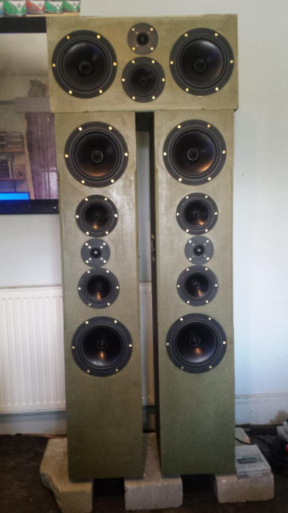

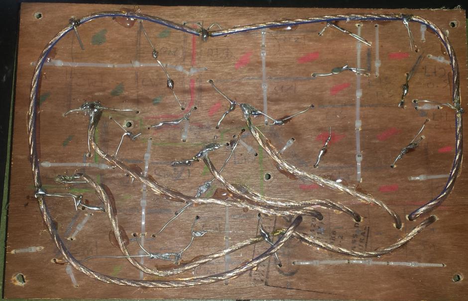

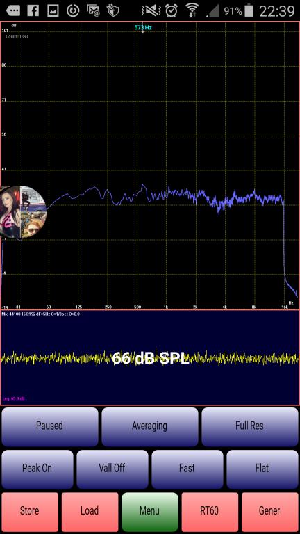

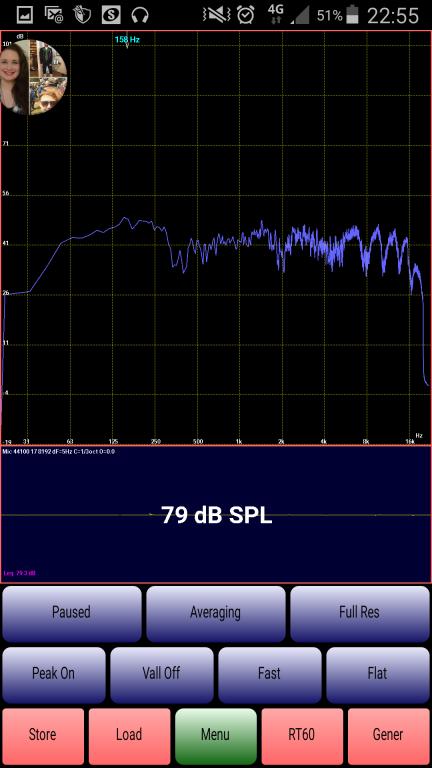

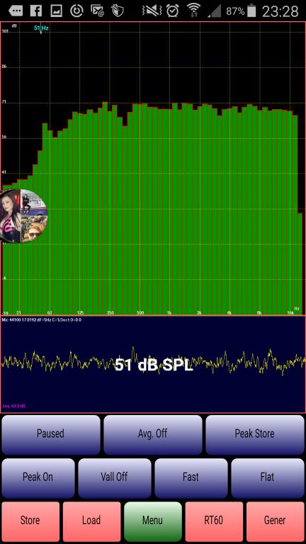

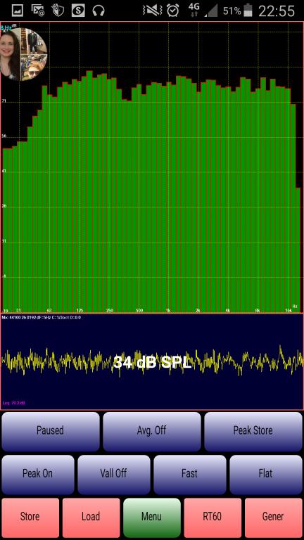

                                                      Hey All.

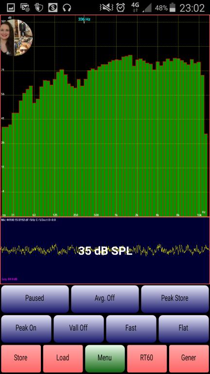

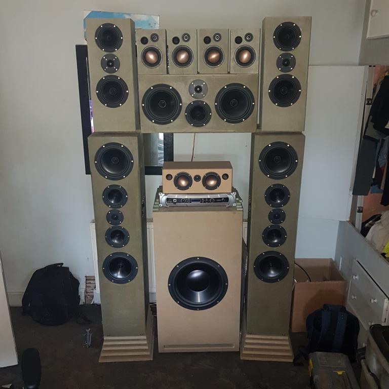

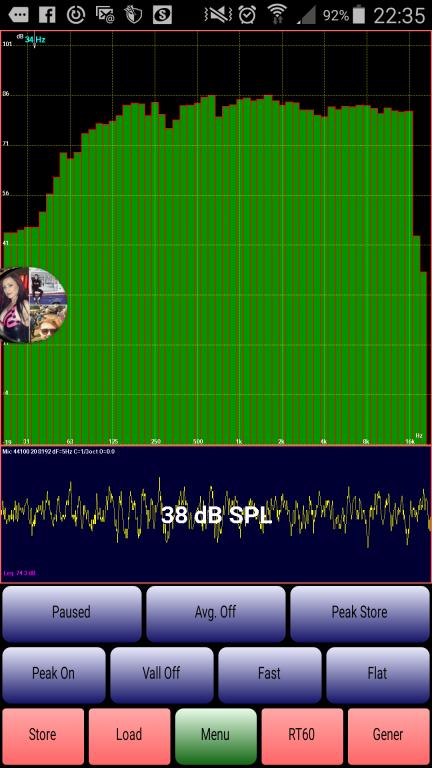

                                                      Finally got the speakers put together for testing. the Khanspires are sounding awesome, I'm really pleased! However I have done something wrong on the RS WmtW, they do not sound right. The woofers sound about half of the output they should be.
                                                      Obviously I need to go through the crossover etc, but could someone just confirm to me how the Woofers are supposed to be wired? Parallel with positive polarity?
                                                      As always you have my greatest thanks
                                                      Last edited by theSven; 10 April 2023, 14:33 Monday. Reason: Update image location

                                                        If it is lacking bass it is likely that one woofer is out of phase with the other so just try switching polarity on one of the woofers and see if that does the trick.

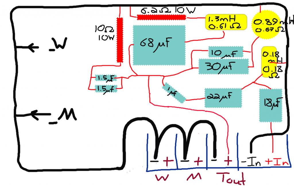

                                                            Thanks a lot Scott. I'm thrilled with them so far! (going to do a nice paint job. maybe some gold leafing). Sorry I've been away on holiday.
                                                            So I connected the drivers one by one to compare, for example the tweeters in the khanspire and the centre to compare. (the Khanspires are sounding great so I'm using them as the control)
                                                            The woofers on the centre sound find, sounds like a slightly higher crossover point which I would expect from a small sealed design as compared to the ported khan towers.
                                                            The mid sounds extremely muddy (but correct frequency range). I've tried it stuffed and un-stuffed. I'm not sure if this could be due to a poorly sealed/oversized mid chamber? It's definitely not right though.
                                                            The Tweeters are very wrong, it sounds like the crossover point is far to high, there are no high ends of the vocals just a few hi hats etc. I have checked all my solder points which look good. This leads me to believe I have messed up on the crossover.
                                                            Now please be gentle, I haven't dealt with electronics in many years haha. I'm unsure if I can use the negative loop as I have and If I have taken the Tweeter out from the correct point. I have drawn the tweeter circuit exactly as it is laid out. Would someone mind telling me what I have done wrong.
                                                            Many Many Thanks

                                                            • _luke
                                                              • Dec 2010
                                                              • 3
                                                              The 22uF in series with the 1uF looks wrong to me. That will end up as a tiny capacitance. Remove the 1uF and try it with just the 22.

                                                                oh yeah (embarrassed face). Thanks luke no idea what I was thinking there. that will be just under 1uf instead of 21uf. Hopefully thats the issue!

                                                                  Ok thanks Luke that sorted the tweeter out, don't know how I missed that one!

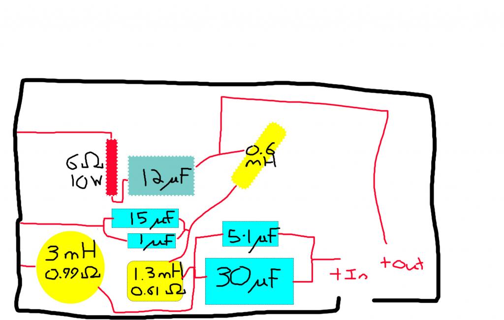

                                                                  My last issue is still with the mid sounding muddy/tinny. I connected the mids up to both the khanspire and centre crossover outside of the enclosures and there is definitely an issue with the centre. I'm certain I have not made a mistake on this part of the crossover but I don't see what else could be causing an issue? Any ideas would be great!
                                                                  Thanks and sorry for my drawing skills

                                                                    Couple possibilities
                                                                    1. I believe that was originally designed for the shielded (NLA) tweeter, and the impedance response is different... they're not really interchangeable.

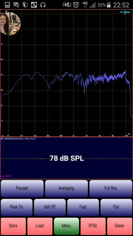

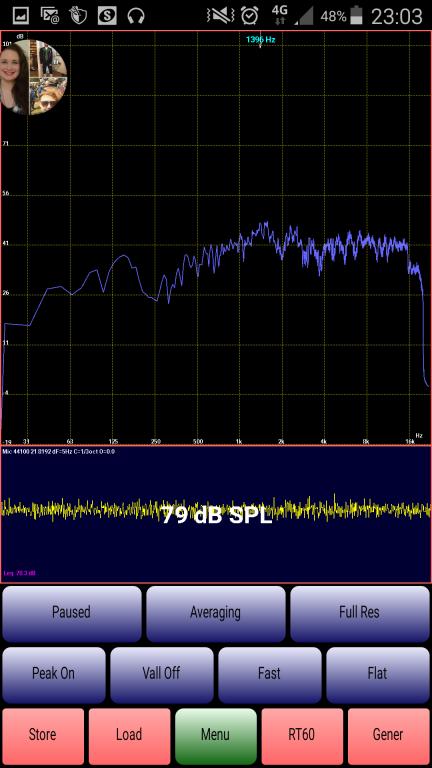

                                                                              Hi, me again!
                                                                              Right the mic arrived and I've been playing around with it for a bit now (still no idea what im doing).
                                                                              So the first 3 pictures are of an averaged frequency response over roughly 5 seconds using white noise. The first picture is of the centre and the other two are of each khanspire.
                                                                              The last 2 pictures are peak frequencies when doing a frequency sweep from 20hz -20khz. Again the first is of the centre, and the last is of one of the khanspires (can only post 5 pics).
                                                                              I don't know how accurate this is, I've no idea if I'm using the right settings etc (I did upload the calibration file for the mic).
                                                                              There is clearly a dip around 250hz on all of the speakers, however the centre's is deeper and wider, I found this quite noticeable when just playing around with the settings. Is there anything clearly wrong for you?
                                                                              Currently I have the centre wired as per the circuit diagram with the mid and tweeter wired with negative polarity and the woofer with positive (and parallel). I will try and get some data with different polarities tomorrow to see if that makes any difference. Do you have any suggestions?
                                                                              Thanks again cjd, and sorry for the messenger widget on the screen, I forgot to take it off

                                                                                First thought is that maybe only one of the woofers is working on the center, or maybe one is wired out of phase.
                                                                                The dip around 250 may be room but you can try flipping polarity on the woofers to see, if you're so inclined.
                                                                                • Moejoe
                                                                                  • Nov 2016
                                                                                  • 33
                                                                                  Right, I actually think I was using a bad audio file for the frequency sweep. I tried using a different one which sweeps much slower and the graphs look much much better (Centre is first two pictures, Khanspires last two). I also re-positioned the centre ever so slightly.
                                                                                  All the speakers still have that dip at 250hz but no where near as bad. As you say I expect this is due to the room conditions, these are currently in my bedroom which is pretty full with beds and such
                                                                                  Thank you very much for your assistance CJD, I think these are as flat as I'm going to get before I get them into a proper space. They are sounding fantastic!

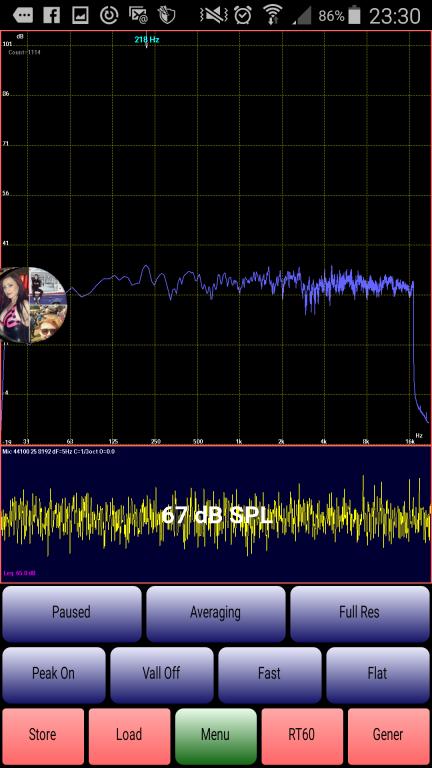

                                                                                  Now onto the in-khans for the surrounds...

                                                                                    Ahh, the joys of measuring. Center looks slightly hot through the midrange and a bit soft through the crossover to the tweeter (the latter likely the tweeter impedance difference) - but it should do quite nicely with clear dialog at lower output levels. I sure hope so. The exact location of the mic can make a lot of those anomolies move around too, but this is a place where a little EQ can fix it up beautifully, if you find it helpful to do so. And you can now measure the results, which is even better.

                                                                                      Howdy folks,
                                                                                      Long time, no see. My apologies but this project has progressed very slowly as I'm sure you can appreciate, sometimes life happens. I Hope everyone has been keeping well and building some cool stuff as always
                                                                                      Quick question for you, I'm about to strip down and prep for paint but I'm questioning my choice of base for the Khanpire towers which have down firing ports. Will a base of this design be acceptable or will it restrict the port and affect tuning? The ports are 4" diameter, flared on both ends (I cant remember the length off hand) and will be approximately 7" off the floor.
