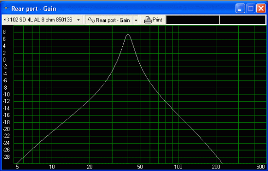

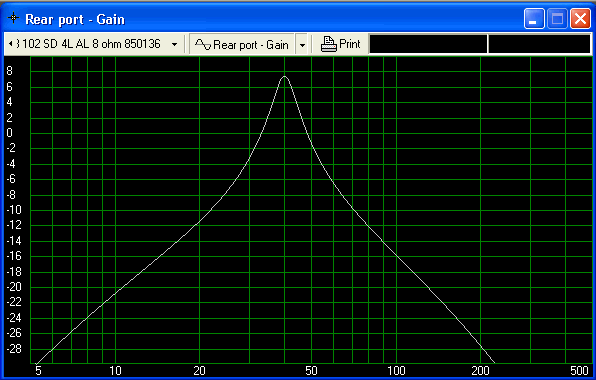

                                                                                Originally posted by bluewizard
                                                                                But despite a near consensus against me, I'm having trouble letting go of this being a problem of timing and phase of reflected sound.
                                                                                I've always found that it helps to do the math to help knock incorrect mental images out of my sometime thick head. In this case, a 30 Hz wavelength is about 37 feet. Let's say moving the port from the rear to the front would move it 1 foot. The phase shift is 1/37 * 360 degrees = about 10 degrees. Not enough to hear.
                                                                                If there's a consensus among various listeners with different rooms, that it sounds better with the port plugged, it's just a bad ported design. Plug it and be happy.
                                                                                Your talking about a port like it makes sound. Generally speaking you don't want to hear anything coming out of the port at least in my mind I wouldn't.
                                                                                Bass sound does come out of the port to fill in below where the driver rolls off. In a good design, the port rolls off smoothly at 12 dB/octave above and below tuning. In a bad design, you can get all kinds of weird peaking and I suspect Steve's speaker is tuned for the boombox sound.
                                                                                Last edited by theSven; 16 August 2023, 23:54 Wednesday. Reason: Update image location

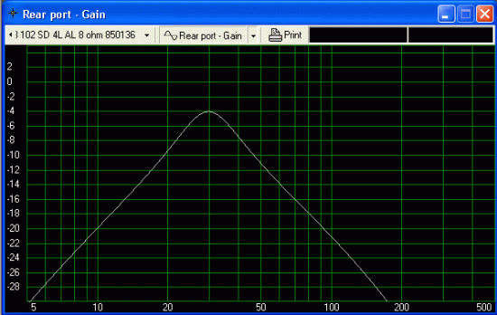

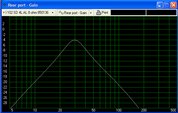

                                                                                  • 16128
                                                                                  Yeah that's what I'm guessing is the boombox sound. But the way he was making it seem was that a lot more then just the low end fill.
                                                                                    Just to be clear, that pic is for a 'good' ported design. Here's a 'boombox' tuning. Note how much higher the port output is, well above the nominal 0dB level of the system.
