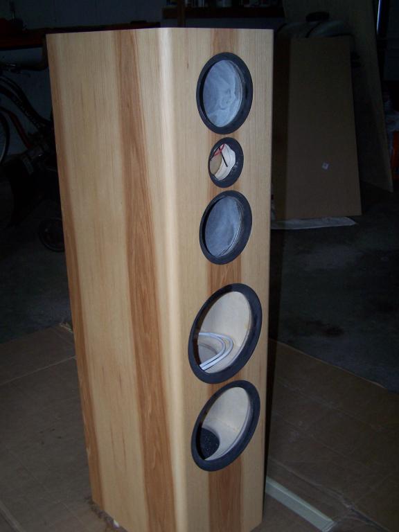

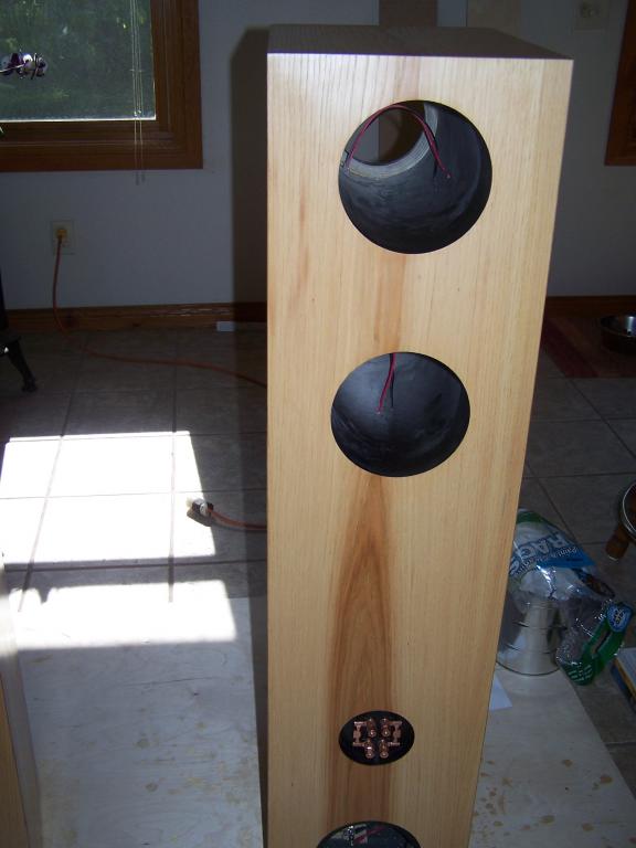

    Thanks all of you guys for your encouragement, appreciated.

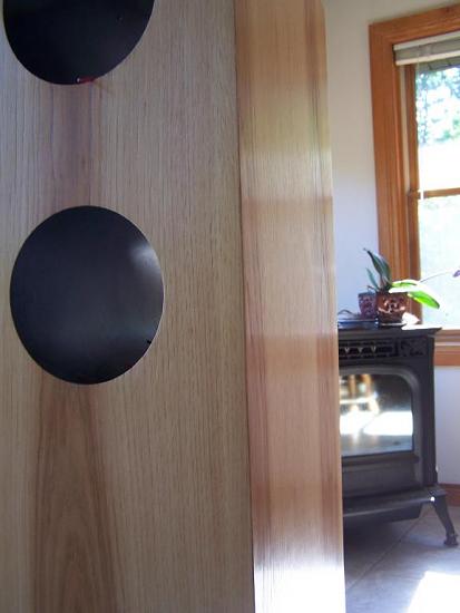

    Got them sanded and started to put the finish on them today.
    Thanks, Greg
    • flamethrower1
      • 392

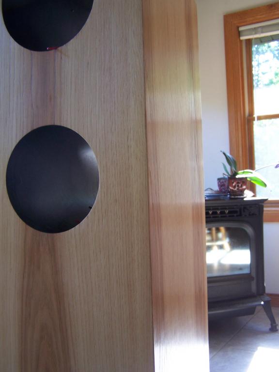

      Got the first coat of danish oil on them, made the contrast in grains really pop out.
      Should look pretty sexy with the all black drivers, sweet.

        Those are looking really nice. :T Are you then going with a wipe-on poly? What brands and application technique would be much appreciated.
        • flamethrower1
          • 392
          I kind of have my own technique of a finish that I like.
          I always start out with danish oil (Watco), it actually penetrates the wood and dries fairly hard.
          With these, I used the natural (clear) color.
          Usually I apply at least two coats with a good clean shop towels that you can get in the painting section of hardware stores.
          The first fairly liberal, let it soak in for a minute or so and wipe the excess off.
          The second coat you will not need as much, kind of a "feel thing", you cant screw it up as long as its not dripping or running.
          Then I use a mixture of 50% danish oil and 50% oil poly semi gloss.
          Try to find a "fast dry" poly.
          You can also add just a little mineral spirits to this to give it a little more open time.
          All of the coats from here on out (I usually do 3) are applied with "very fine" steel wool, let them sit for a couple of minutes and then wipe them down with a clean clothe.
          The result of this finish is more of "polished wood" verses just a top or finish coat and is very durable.
          It may sound like a PITA, it is actually very forgiving and easy to do.
          This I apply with very

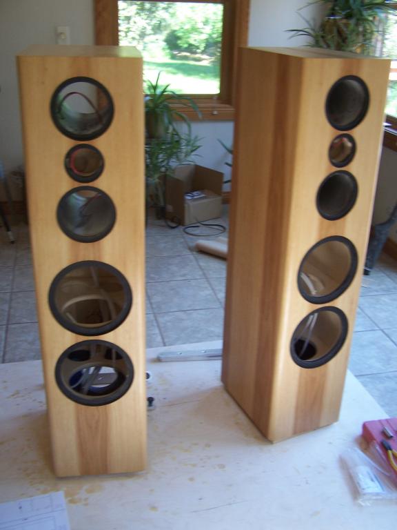

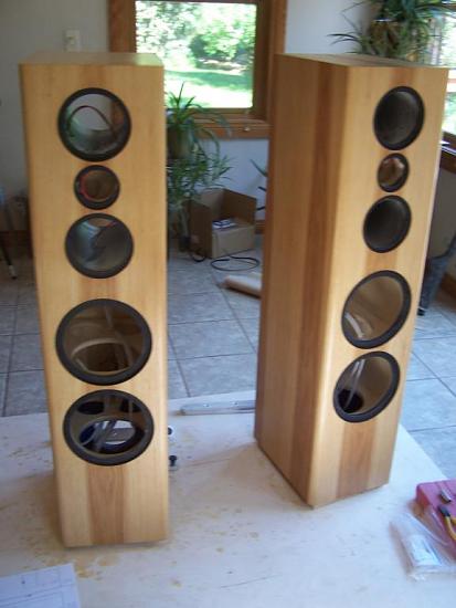

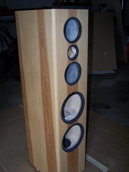

                      A little more progress, will have them fired up within the next couple of days.

                        • 571

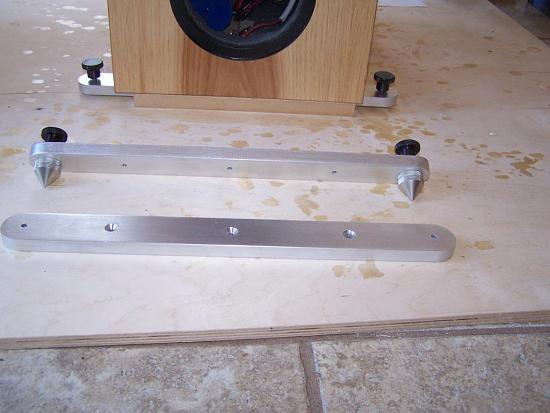

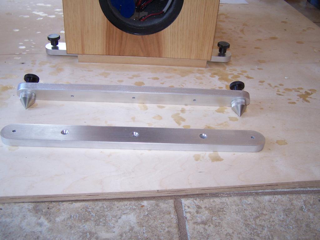

                        Nice finish...:T Similar to what I'm looking for. Did you make the outriggers? Also very nice.
                          Very nice! :T They look great!
                          Where did you get the brackets with the spikes? Those are very cool!
                            Oh and the other item in the pics is purely a decorative item.
                            Hmm... wondered about that yes.
                            Looks like it still can be taken out and be fired up for some good old fun ;-)
                            May give you some really good ear-oil before you first listening session!
                            Anyway - looks really good! Oh, yeah, the speakers to :W
                            • flamethrower1
                              • 392
                              TEK, yes it is going back outside for a little run soon.
                              As far as the brackets go,
                              The bars are 1.5" x 1/2" aluminum flat bar sourced locally, I used a place called Speedy Metals locally.
                              The knobs are from Mcmaster Carr, http://www.mcmaster.com/#60765k332/=12wv3u3
                              The spikes are Parts Express 240-698.
                              Around a $125.00 for eveything

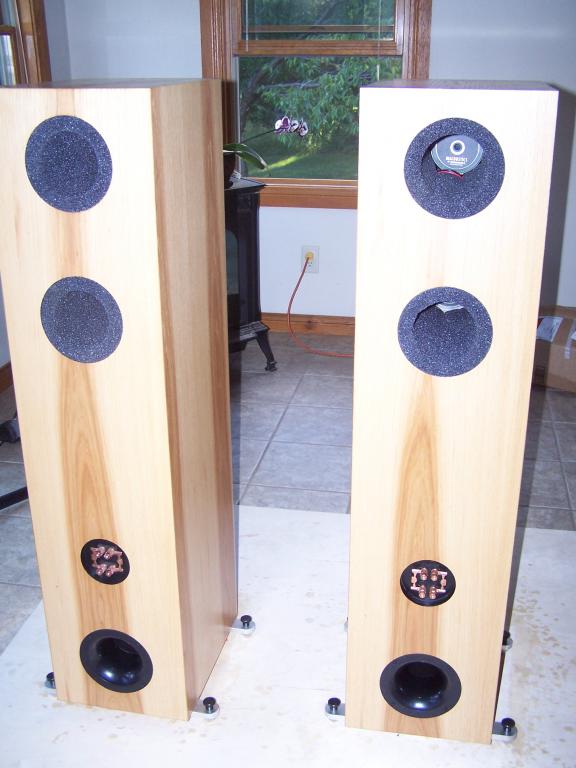

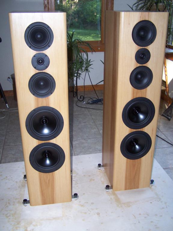

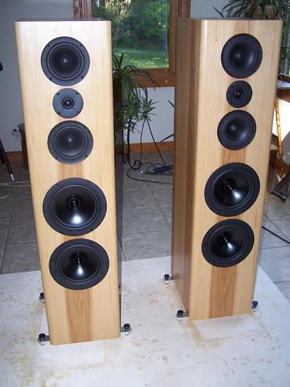

                                  OK. the end of the project.
                                  Just got to get someone to help move them, hopefully tomorrow.
                                  Thanks to all who have answered questions I have had and also the kind comments ;x(.
                                  I now have a pair of Anthology's!!

                                    • 2142
                                    Very nice set of speakers :T
                                      They look great! I'm looking forward to reading your feedback on the sound quality.
                                      Enjoy!

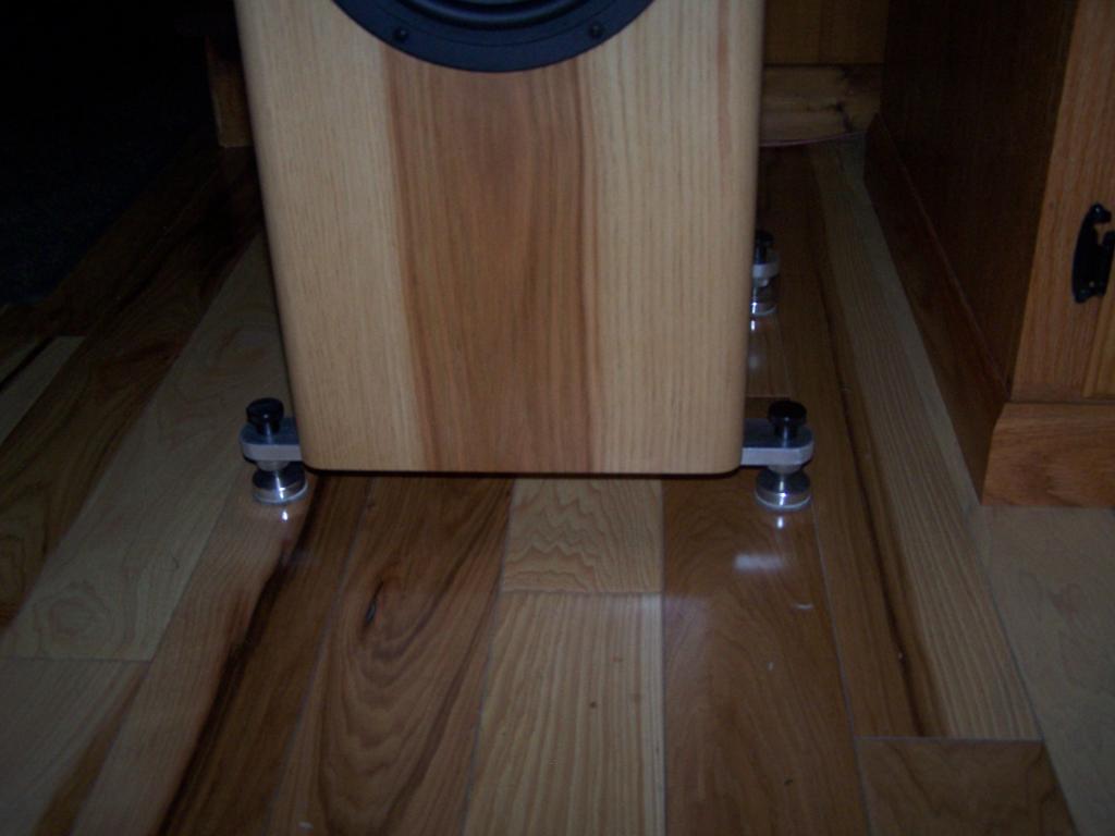

                                        I have included a pic of the floor pucks I made also, just aluminum rod cut to 1/2" thick with a stick on felt pad, they can be moved quite easily.

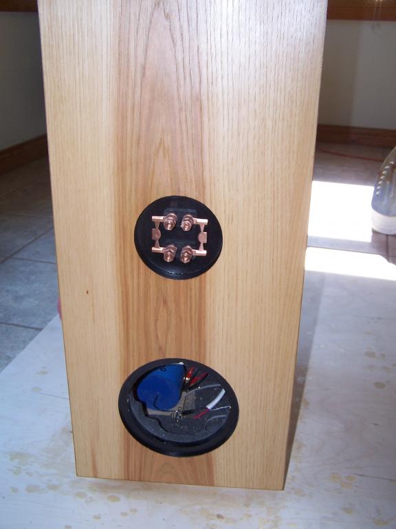

                                                Hi flamethrower,

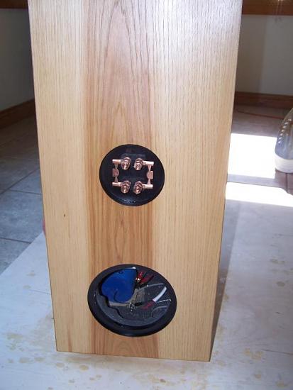

                                                what binding posts are you using? Are they made of copper?
                                                Harry
                                                • flamethrower1
                                                  • 392
                                                  Originally posted by Harry3
                                                  Hi flamethrower,
                                                  Harry
                                                  They are Cardas CCBP L, solid copper.
                                                  Take some time and shop around, the price varies quite a bit from one supplier to the next

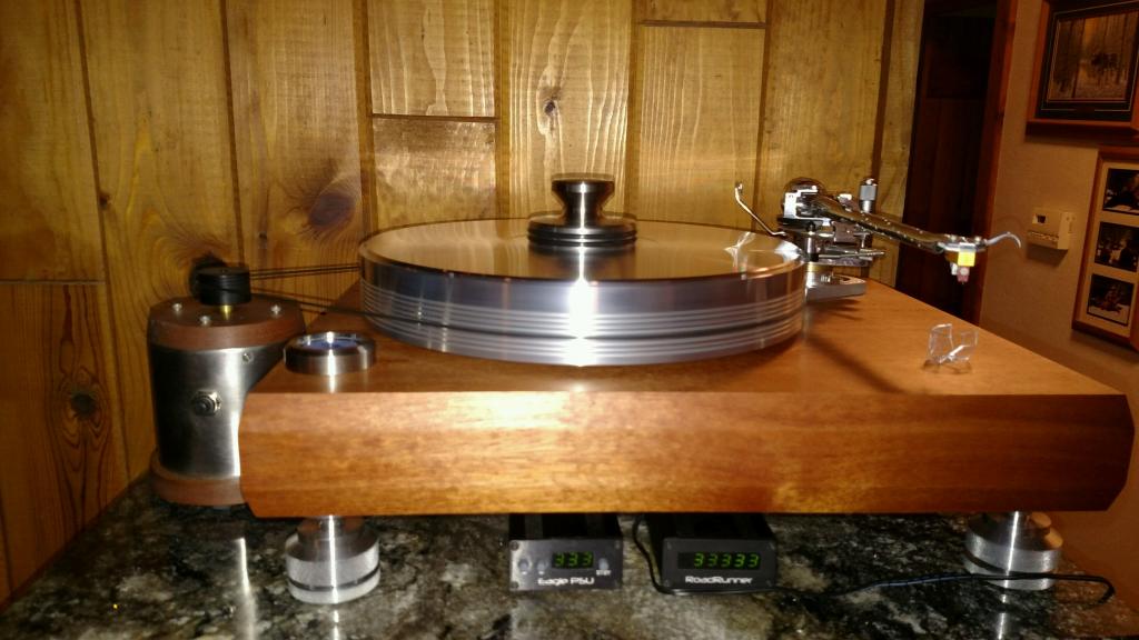

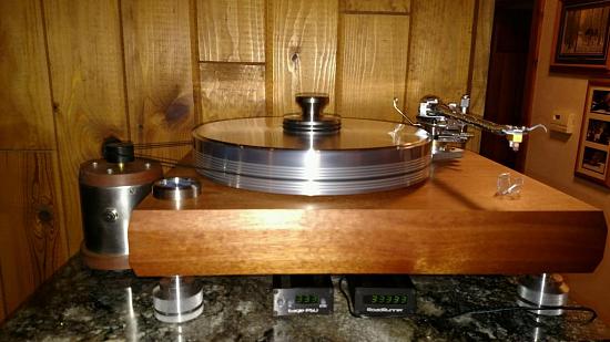

                                                                  This is what I have been feeding the Anthology's with lately.
                                                                  To date, I have not had the opportunity to hear a deck as black or as detailed.
                                                                  Took some time to build but was worth the time, money and effort.

                                                                    Wow! That is beautiful.
                                                                    I've heard some great vinyl but have never had the opportunity to own any. That looks spectacular and I'll bet is sounds spectacular too. 8O

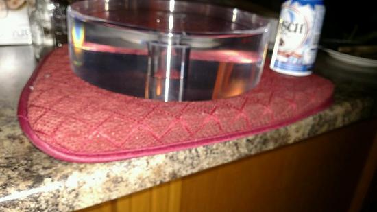

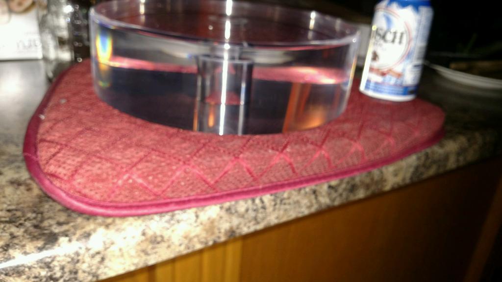

                                                                            This is what I am starting with, the beer can was used for reference only
                                                                            Click image for larger version  Name:	acrylic platter.jpg Views:	651 Size:	58.6 KB ID:	862540

                                                                              Sorry, have not checked in here in a couple of days.
                                                                              The PVC I used was 6 inch but, as Jim pointed out, you will be ok with what you have
                                                                                  that is a serious piece of of polycarb!
                                                                                  did you purchase it as-is, or have it machined?
                                                                                  what type of bearing configuration do you plan on using?
                                                                                  belt-drive or direct?
