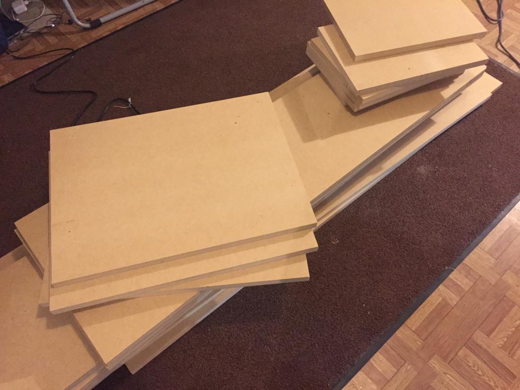

Absolute Noob at wood working and am building Jim's Statement IIs
  • silvia0073
    • Feb 2016
    • 29
    Ok, I've been a long time browser of htguide, just never registered. You guys are an absolute treasure trove of knowledge! I've recently taken the plunge into diy and to start out, as a first ever project, built Jim's TriTrix speakers with the parts express kit. Kit being CNC'd, all the cuts were pretty much perfect so construction was a snap. Being new to wood working (new as in the only thing I've built out of wood from scratch was a simple table made up of 2x4's and a particle board top)... I can't get my cuts perfect... There's about 16th to 32nd of an inch off at one or two corners on some of the boards... by some miracle, some are square. This is done with a circular saw and a self made rip, no table saw. Is this going to be a huge problem come time for assembly? I try to get one board as close to square as I possibly can with my limited tools then rough cut the other pieces of similar dimensions and flush route them to at least get them to be the same dimensions. Here's a photo of what I have cut up so far, all that's left are the tunnels and braces. I know they may look decent in the photo but close inspections with a ruler will say otherwise. I'm not sure how accurate cuts needs to be for speaker cabinets but hopefully with my poor cuts but I hope it'll at least look like a box when I'm done. If there's any words of encouragement and or advice, I would appreciate them. I will continue to update as I progress if anyone's interested. After seeing all the absolutely awesome talent that had already built these speakers on here, I feel very unnecessary to show off my less than poor woodworking skills. Thanks in advance!

    First of all, thanks for sharing and to contributing to the forum - thats great and useful information and interesting reading usually is the result. At the same time I'm quite sure you will be able to get help resolving issues and problems that may occure when traveling down the often not so straight DIY path :-)
    About your question, how square do your cuts habe to be...
    That might depend, but a little bit off can usually be handlet quite well.
    I would say that 1/8 of an inch is borderline, maybe a bit mutch. 1/32 of an inch is normally no problem.
    What you will experience is that you get issues when you try to assemble the box as it does not nessesarly fit that well.
    The more experienced here normally adds a bit of overhang to some edges (like 1/16) and uses a router to shave that off after the box has been glued together. When using that method you can have quite large deviations without getting any problem. When you have to sheets you want to be exactly equal you may use clamps and put them together and then use a router to remove any excess wood.
    I also often apply several sheets together and by doing that in effect cuts out several speaker sides at once.
    A good stearingquide for your saw is a importand investment.
    Also, as you see, a router is a invaliable tool when doing this kind of work.
    Oh, I forgot that -'if stiff goes wrong, you always have boundo (for outside) and scilicon (for inside)
      • 5204
      I agree with TEK.
      My cuts are never dead on. If you look at some of my speakers closely, you'll see some bow or wow in the sides. Usually, clamping down tight can fix things. It will really depend on where you're over and under.
      I normally use regular tightbond glue, but if you have some bigger gaps, you can use use a thick glue, like PL Premium Urethane http://www.loctiteproducts.com/p/pl_...n-Adhesive.htm it will fill and bridge small gaps. I've also used Bondo on a speaker or two to fix mistakes.
      I always oversize my baffle, which is the last piece I glue down and then use a flush trim router bit to trim it up perfectly. Actually, I usually end up flush trimming all sides. My bigger problem usually is clamping square.
      You'll figure it out. And the next speaker construction will be better than this one. and so on and so on.

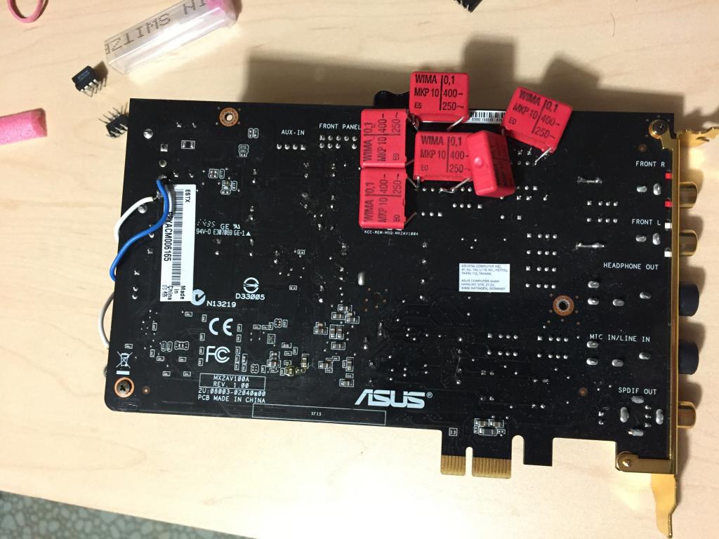

                                        I also will pair it up with a emotiva amp. It's actually going to be with my PC speakers lol... I have a modified Xonar Essence STX as the source to the emotiva amp. I currently have unfinished tritrix's and want to upgrade. Here's are photos of my modded sound card should anyone be interested. There's also a photo of my PC, you'll see the tritrix on the right. I'm going to have to pull everything away from the wall with the statements.

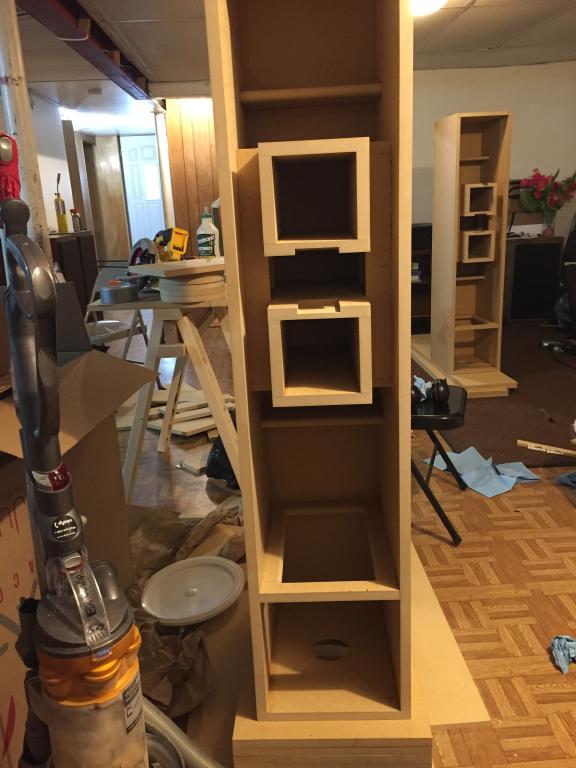

                                        • silvia0073
                                          • Feb 2016
                                          • 29

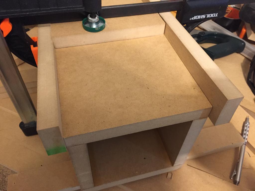

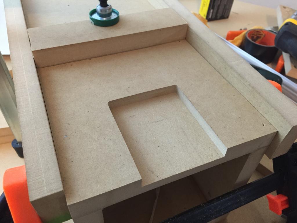

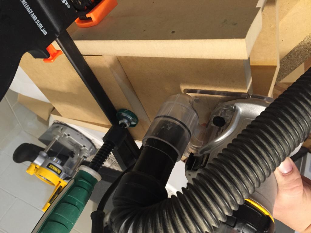

                                          A little update, working on the tunnels. Made a little fence that worked perfect with my router for the tweeter heatsink cutouts.
                                          Dont' know why one of the photos is upside down...
ID:	861244Click image for larger version
ID:	861245Click image for larger version

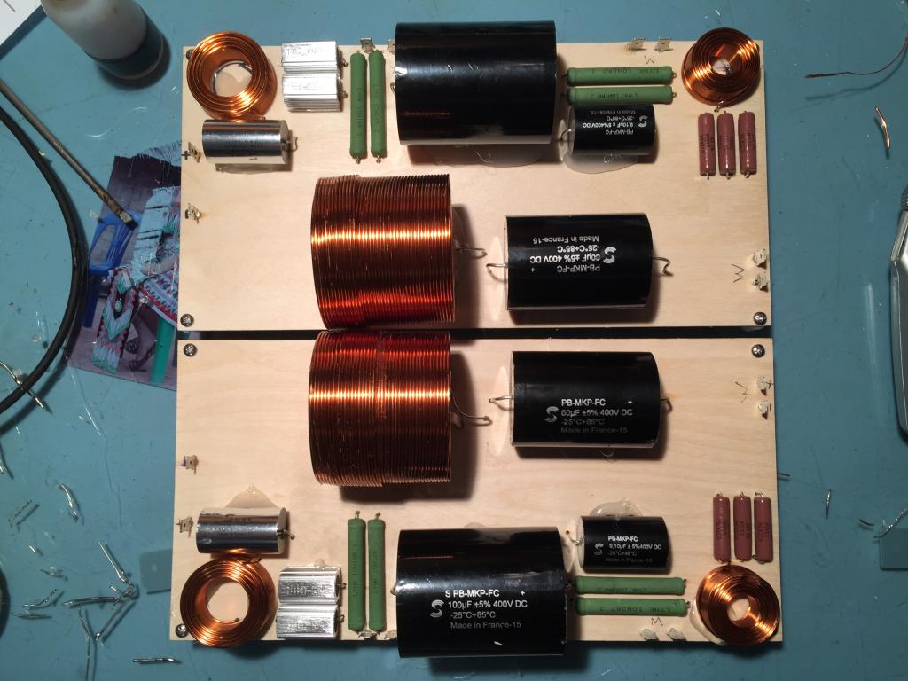

                                                Towers are almost done, working on crossovers. Got one finished. Need to do the other one.

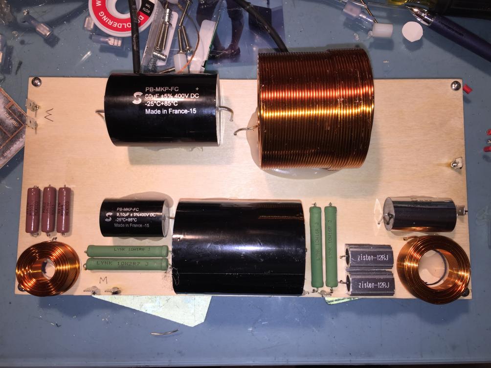

                                                • silvia0073
                                                  • Feb 2016
                                                  • 29
                                                  Was going to do a printed PCB but it didn't turn out too well...

                                                          It was all gut feeling actually lol. I started with the back, didn't cut the square holes (drilled a hole to fit my trim bit and routed them once the tunnels are glued in), I glued on the top cover, bottom cover, braces, and then one of the sides. Built the tunnels then lined them up on the half constructed cabinet. Once that's nice and dry, I put on the other side panel. Sand everything smooth. I'm probably going to install the crossovers then insulation. Run wiring then cut the front baffle for the drivers. Install the front baffle and lastly, drivers. Hope to be done by this weekend. If I do complete construction, it took me 2 weeks to build... not including finishing. Not bad, but I stayed up late, almost to 3 am every day just taking my time and working it. Too excited to sleep anyway .
                                                          • Srixon
                                                            • Feb 2016
                                                            • 40
                                                            What are the notches in the back of the tunnels for?
                                                              • 4143

                                                                    Crazy how much time these thing's took to put together... pretty close to mirror finish. This is actually the 3rd attempt. 1st was printed PCB which did not go too well. 2nd attempt, the holes I drilled didn't match up nicely, and this time, I'm finally satisfied.

                                                                      wow! really nice professional looking work! especially the crossovers.

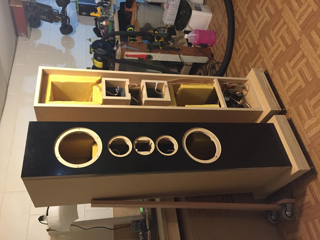

                                                                                        • silvia0073
                                                                                          • Feb 2016
                                                                                          • 29
                                                                                          Done!!! Now for the burn in, already it sounds fantastic. When hooked up to my Yammy RX-V2095... ehhh, sounds ok. Played for about an hour and it's now in my PC room and hooked up, kinda messy so I'll take photos later but here's one of them hooked up to the yamaha. They sound pretty darn awesome on my pc with flac files. Can't wait for them to be properly broken in... all I have to say is wow, the vocals are simply amazing!!! This build has been no where near perfect but as I listen to them, all the imperfections melt away and I love them more and more with each minute. Thanks again for an awesome design Curt, Jim, and Wayne!
