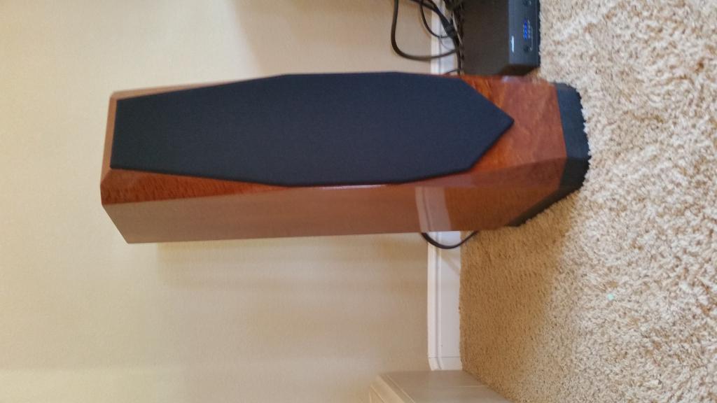

                                        Tek,
                                        Your busting my Bolls,............
                                        here's one of two. Installing the grill cloth was the least fun I've had during this entire process. I started with .190" screen spline. Couldn't make it fit worth a darn. So, I bought all the different sizes I could find, (4). .160 works for me. I can get all the corners installed and the straight track stays tucked in the groove.
                                        Not a fun part of the build. But, I think it sounds better with the felt around the tweeter. I did not put felt around the mid, I tried it, but I liked the sound better with felt on the tweeter only.
                                        I'm working on the other one as I type this. With my other two hands......
                                        Ron
                                        Wife unit and I both agree, they look better with the grills on. Sound better too. IMO.

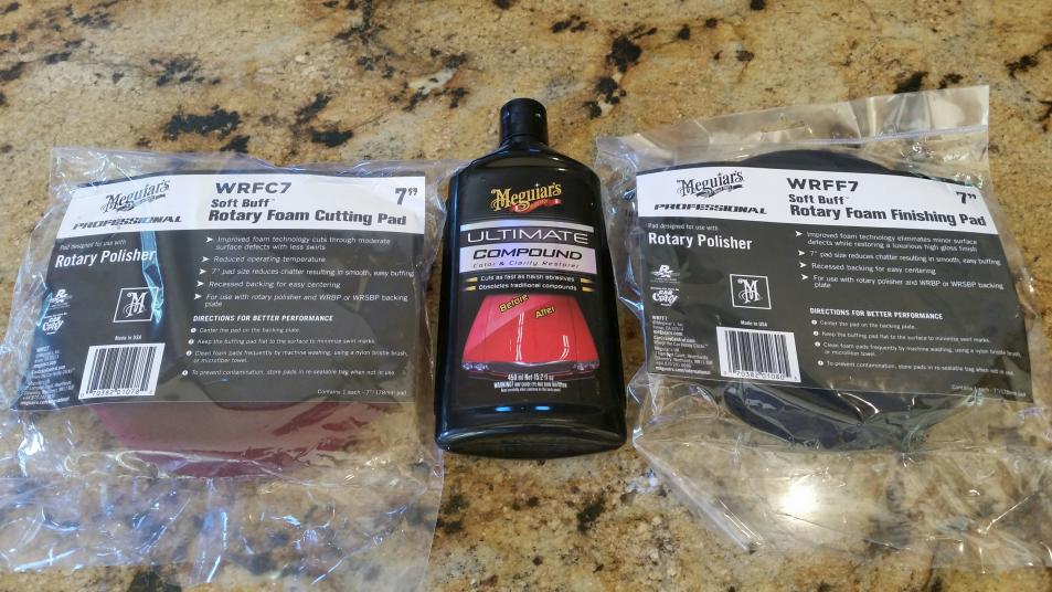

                                                            Originally posted by Renron
                                                            Sunshine photo, and compound used.
                                                            I don't know what the difference is between the Megquire's cutting compound I ordered and this one Ron got, but I ordered some of this today... just in case! :T
                                                            • Renron
                                                              • 751
                                                              #435
                                                              I couldn't tell you the chemical difference, but the ease of use, and one step worked for me. Reading Meguire's ad info, this one has some features that reduce "haze" after removing scratches and swirl marks. I was able to verify this my self. I also have Machine glaze 2 and swirl remover from Meguier's , I found the Ultimate compound worked better and was only one step.
                                                              YMMV.
                                                              Ron

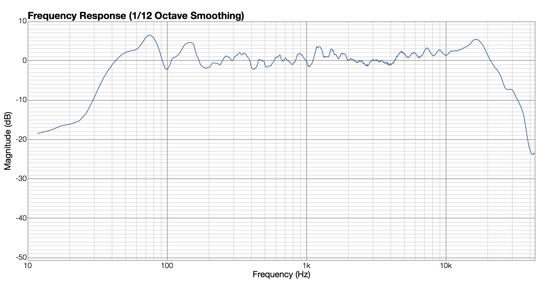

                                                                    Ron and I have been talking about getting together for a while, to check out that everything was as expected with his Ardents, because remember, they are a bit "special" with a ScanSpeak midrange and a different Scanspeak tweeter, the 6600, which is sort of the cloth dome version of the 6640. (or you could say the 6640 is the Beryllium dome version of the 6600. Take you pick of point of view...)

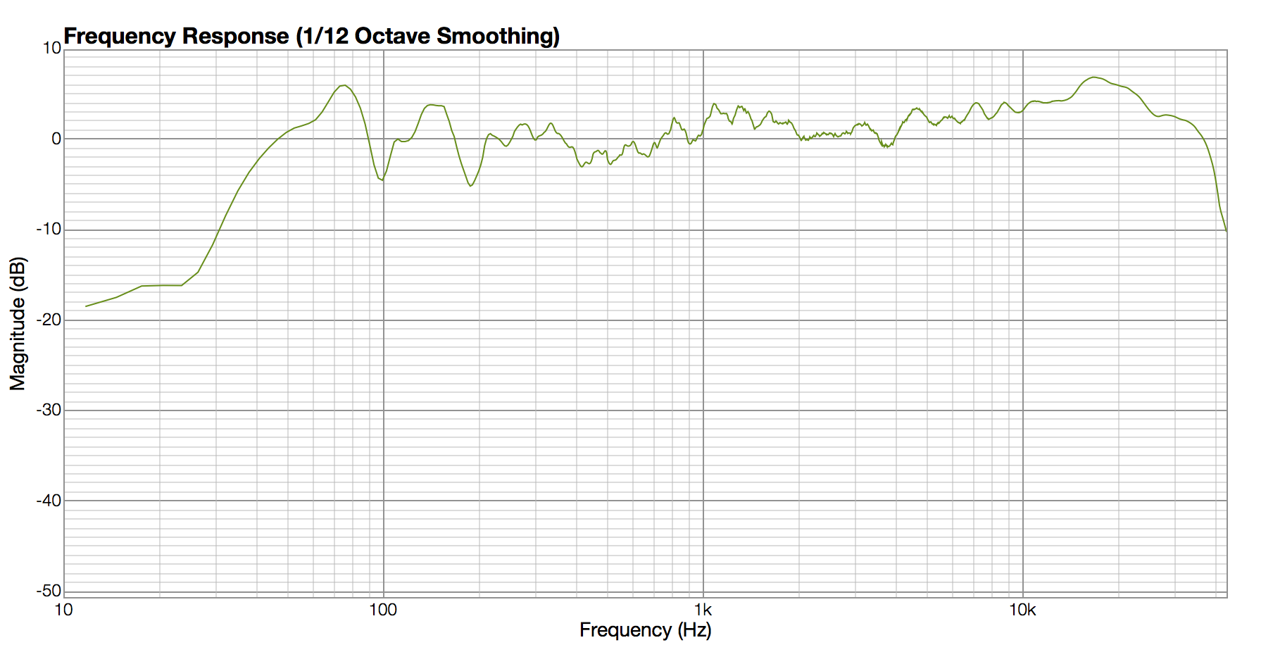

                                                                    Ron sent me the midranges, and based on measurements, I modified the overall crossover design, but you know, that's on paper (well, not paper, on an LCD screen, actually) and this would be reality.
                                                                    Let me say right away, Ron's Ardents are beautiful, a definite work of art, with a gorgeous finish.
                                                                    Click image for larger version  Name:	31452560222_45fd9a8054_o.jpg Views:	18 Size:	535.7 KB ID:	932808
                                                                    The ultimate DIY meet might be a collection of all the Ardent owners in the world, and we could have a concurs judging for which set looks the best- I haven't seen the others in person, but his would certainly be a front runner or early favorite.
                                                                    I unpacked my MacBook Pro, mic, preamps, test amplifier, and a pile of cables, and we got to work- it didn't take too long before we could get our first results.

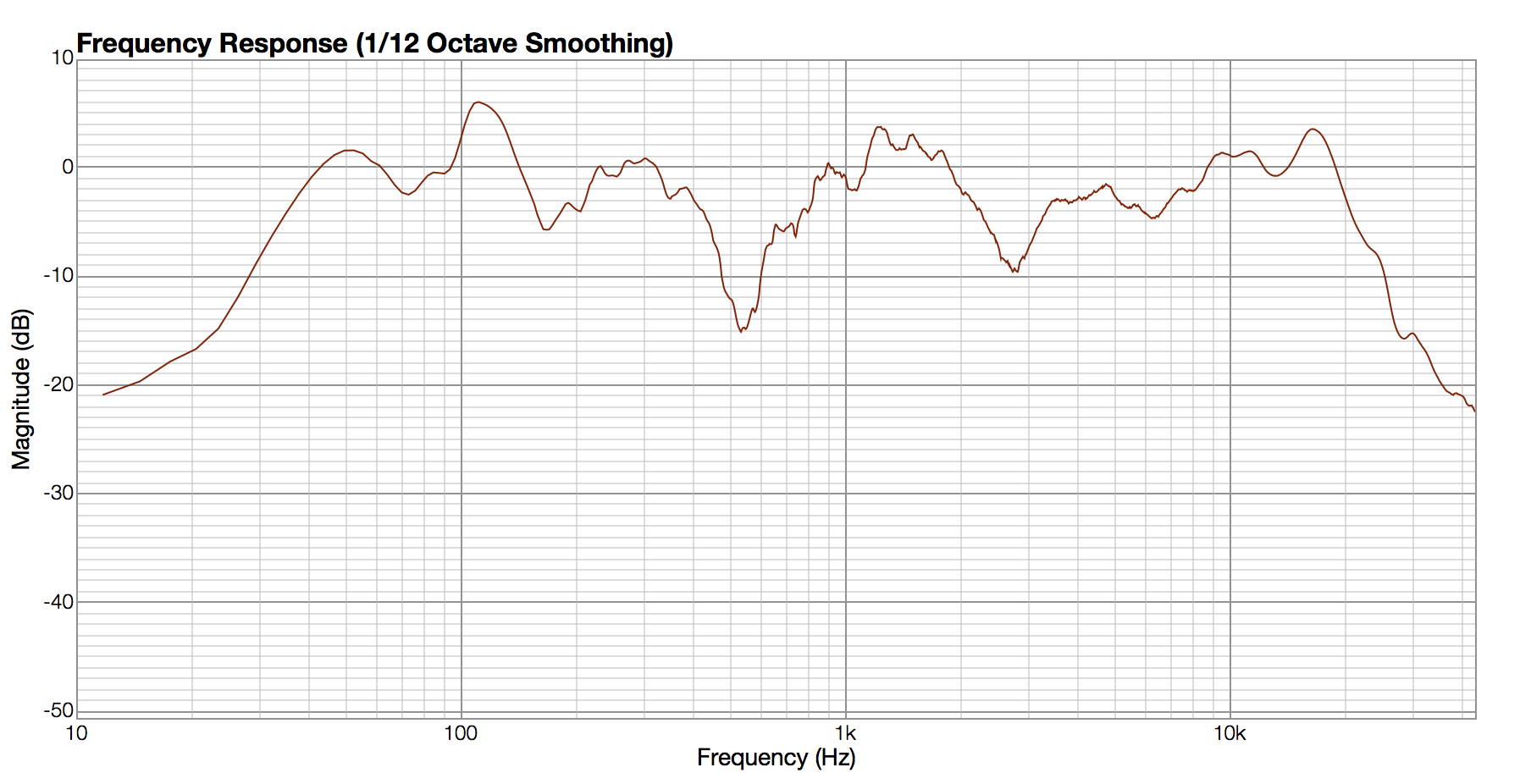

                                                                    Uh oh...
                                                                    Click image for larger version  Name:	31483132711_9eb4e092b1_o.png Views:	10 Size:	98.7 KB ID:	932809
                                                                    I checked this at several vertical angles, on axis for the mid, and for the tweeter, and got variations on the same theme. Checked the second one, same thing- so this was consistent, and as you might imagine, looks like a clear case of midrange polarization mis match needed to be corrected. (Ron's checking the files and posts to see whether I gave him the wrong info- I had the impression he was going to stay up late last night doing that just so I couldn't do one of my moderator revisionist history tricks and edit the post to reflect my preferred version of events...)
                                                                    Ron used quick connects, so the easiest way to reverse the polarity was to pop the drivers and switch the cable polarity.
                                                                    At this point we also had the cabinets pulled out into the room....

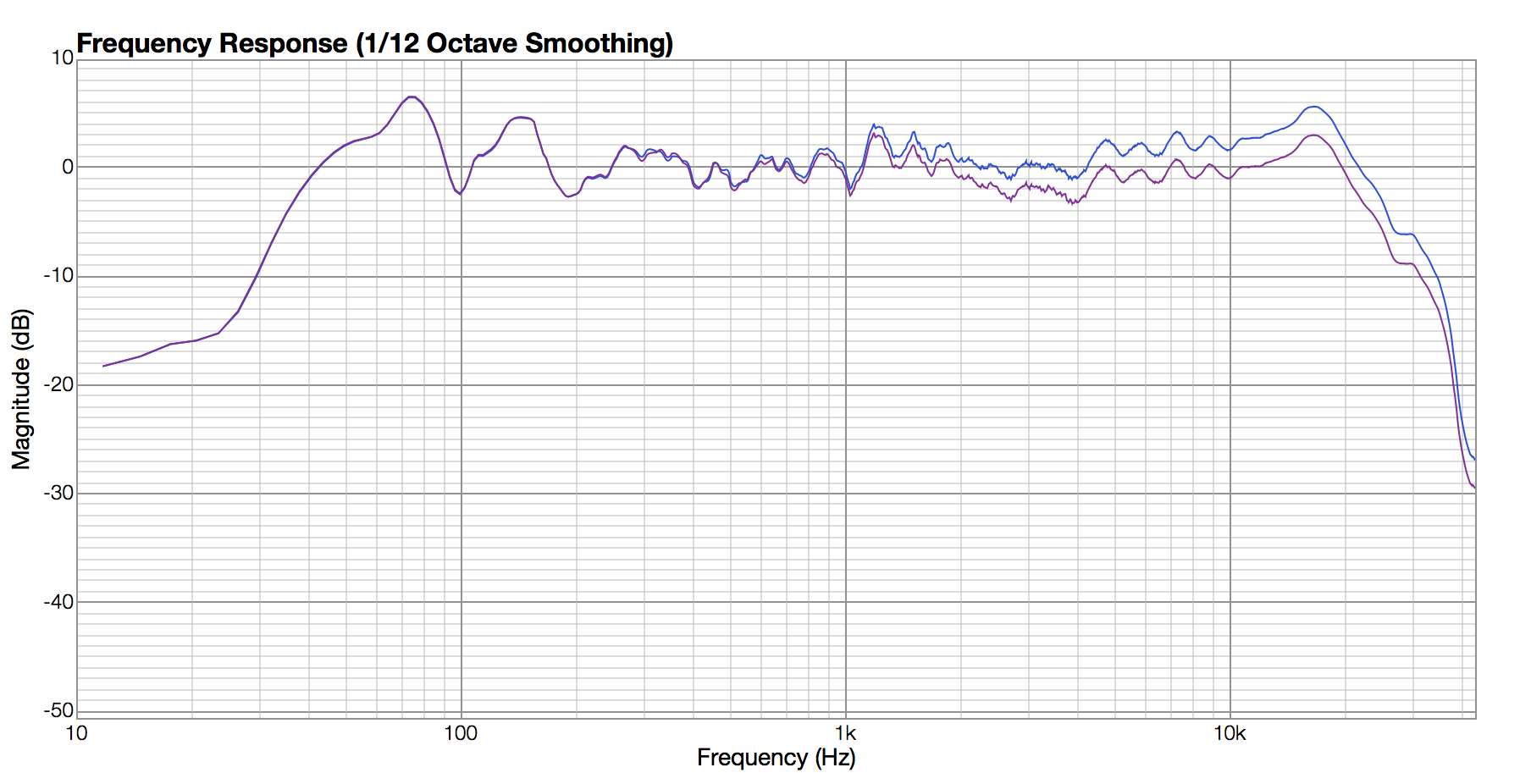

                                                                    The suspense was excruciating, but short lived....
                                                                    Click image for larger version  Name:	31452387802_af60798a60_o.png Views:	18 Size:	93.4 KB ID:	932810

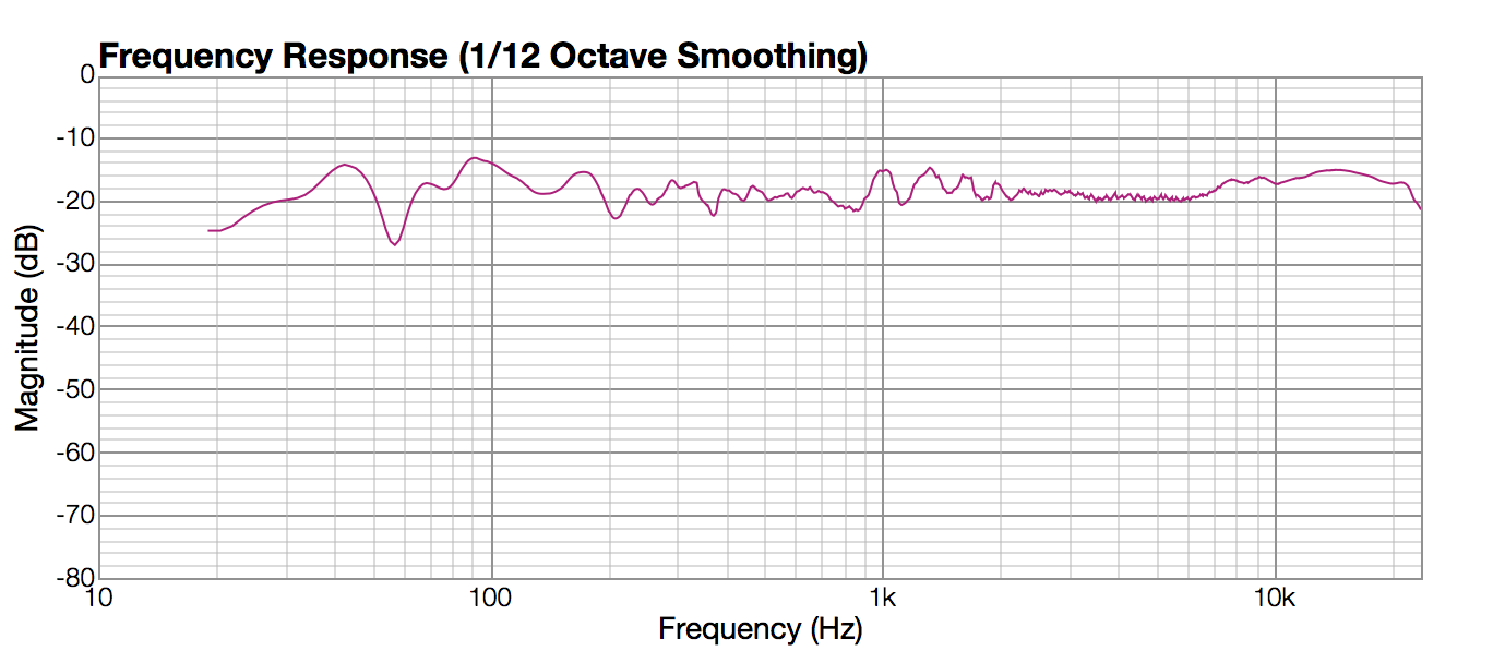

                                                                    This was measured on the midrange axis at my body calibrated 1 meter distance. (Ask Ron, he'll explain) No grille cloth panel, so tweeter output is a bit elevated.
                                                                    Given the roll off on the top, I also measured on the tweeter axis at the same distance; here, we see more extended output from the 6600.
                                                                    Click image for larger version  Name:	30758587224_70a886d102_o.png Views:	18 Size:	93.2 KB ID:	932811
                                                                    What I suspect is happening here is that the soft dome has some internal modal behavior at high frequency that messes up the off axis above 18-20 kHz, because I see better behavior from the 6640 at 10-20 degrees off axis. well, you ought to get SOMETHING for your extra $250 dollars per tweeter, right?
                                                                    I didn't have time to build any more voicing modules, but I did bring along my first article prototypes, and we hooked them up into the signal path from the preamp output cables to the amplifier input, after doing a first music cut check straight through. We did have the grilles off for this test and the subsequent listening session. Here's a level matched comparison:
                                                                    Click image for larger version  Name:	31452393702_77f8dfa649_o.png Views:	18 Size:	116.9 KB ID:	932812
                                                                    For final reference, here are plots without grilles on my original set with C79 and 6640, in room with a similar 100ms gate.
                                                                    Click image for larger version  Name:	1M5GrillNoClothFeltring_zps90497e71.png Views:	18 Size:	66.9 KB ID:	932813
