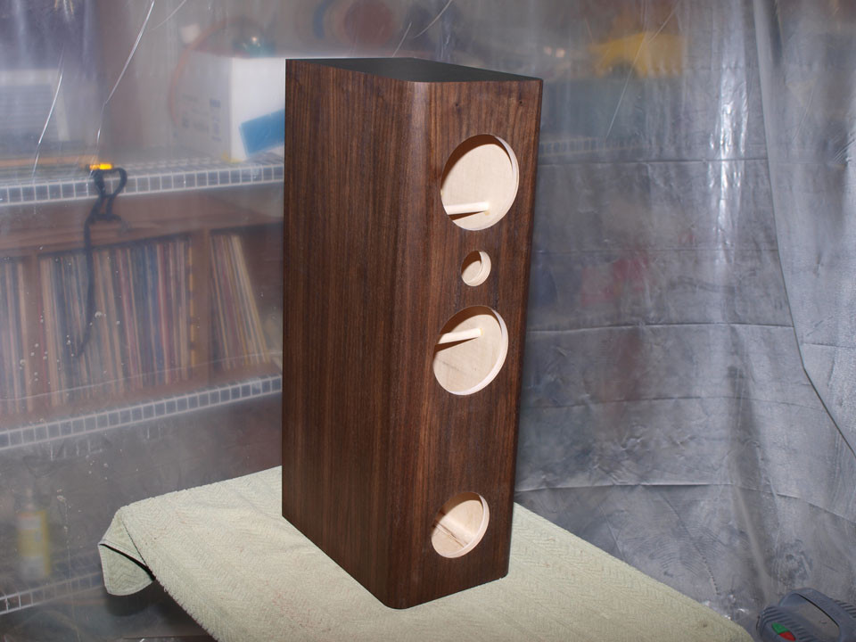

    Seeing lcolbur1's Curved Asonica's build has me very interested in a Walnut veneer - those were absolutely beautiful. Some internet searching and I found these:
    Hmmm!

      Does anyone have any experience with something like this? How to achieve that finish/color? Is it more in the type of Walnut or the finish/stain? Or both?
        Walnut comes in quite a few varieties if memory serves. Some being much lighter than others. The finish and/or stain can have as much to do with the end colour as the wood itself and some woods get noticeably darker when finished compared to others. Cherry for example is well known for becoming much darker when finished and it then darkens more over time. Something like maple isn't anywhere near as prone to this.
        The most important thing, I would have thought, would be sourcing some quality veneer that has the figuring and appearance that you want. There are many different types of finish available nowadays, all that darken to different degrees, some of which don't darken much at all. I am sure you could find something to put on top of the veneer to arrive at the kind of look that you're after.

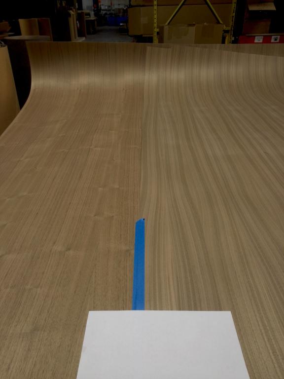

                        No problem, I think if you want lcolbur1's look it's more like Oakwood's. Here a pic of my buddies whose used veneer supplies (darker).
                        Last edited by theSven; 10 June 2023, 18:13 Saturday. Reason: Remove broken image link

                          Beautiful! That's very close to the shade I'm looking for. Any idea what he used for the finish?
                            Those were sprayed with satin poly with no stain. He going to take a pic for me tonight to see how much they have darkened over a few years. With walnut you should try and get some UV protection in the finish as others have pointed out they will darken over time.

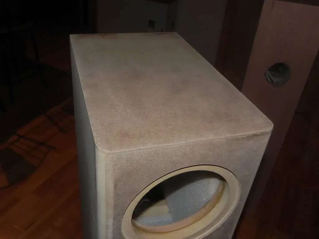

                              I'm trying to decide if I want to do a roundover or not. If I understand correctly, it only works with a really big roundover on the vertical sides of the baffle. Then the veneer is wrapped around so that the sides and baffle are one piece. Hmmm. Sounds like it would be very tough.
                                Yes, you can get samples and try different options maybe try staining lighter walnuts.

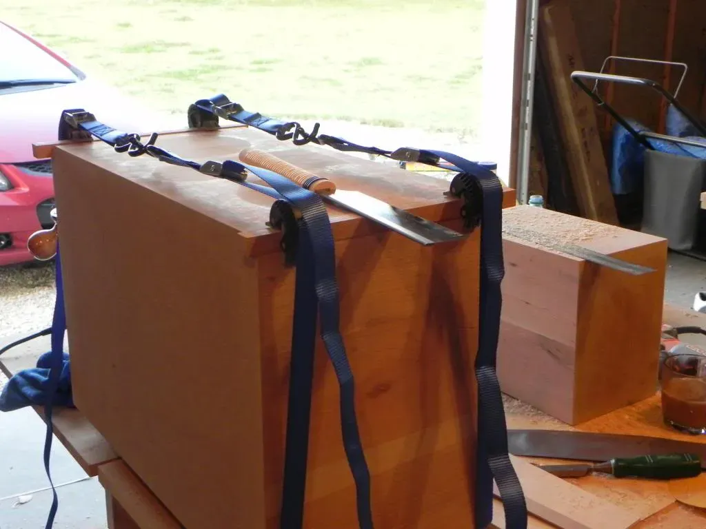

                                I have rapped side front side using a 3/4" radius bit. This is the iron on glue method. May be more tricky with a pressure sensitive back PSA veneer.
                                Click image for larger version  Name:	DSCN2028.webp Views:	12 Size:	23.7 KB ID:	935498
                                after rapping.
                                Last edited by theSven; 10 June 2023, 18:14 Saturday. Reason: Remove broken image link
                                  The other option is rabbit in some hard wood corners. You can veneer to the hardwood them round over the hardwood.
                                  After rounding over the hardwood.

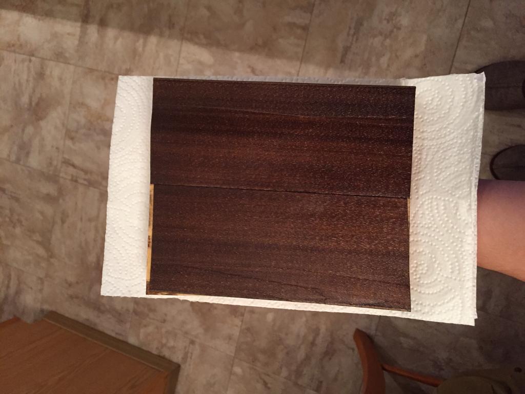

                                          I used walnut stain on walnut veneer and they turned out pretty nice and dark. Juts what I was looking for:

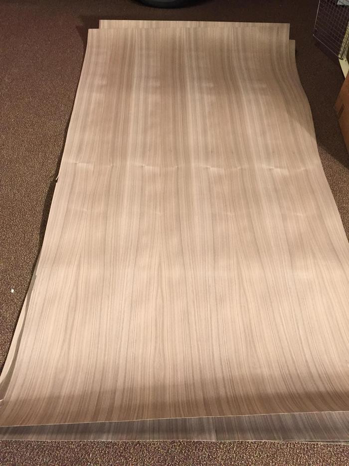

                                                          After chatting with Peter from Oakwood Veneer (highly recommend them - they called me after I submitted my order and saw that I was making speakers because they wanted to make sure I was getting the right veneer) I ended up grabbing the Walnut Rift Cut http://www.oakwoodveneer.com/walnut-veneer-rift.html.
                                                          It's the stuff on the right.

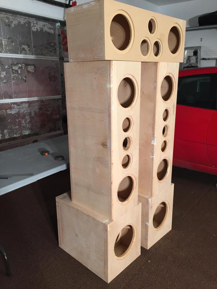

                                                            I wanted to share a few things I learned (most of it learned from others) this round while correcting mistakes I made.
                                                            Here are they in order as shown below:
                                                            1. Adding depth to a driver recess
                                                            2. Fixing uneven edges after being glued together (you'll know what I mean when you see the picture below)
                                                            3. Accidentally cutting the driver recess in the wrong location

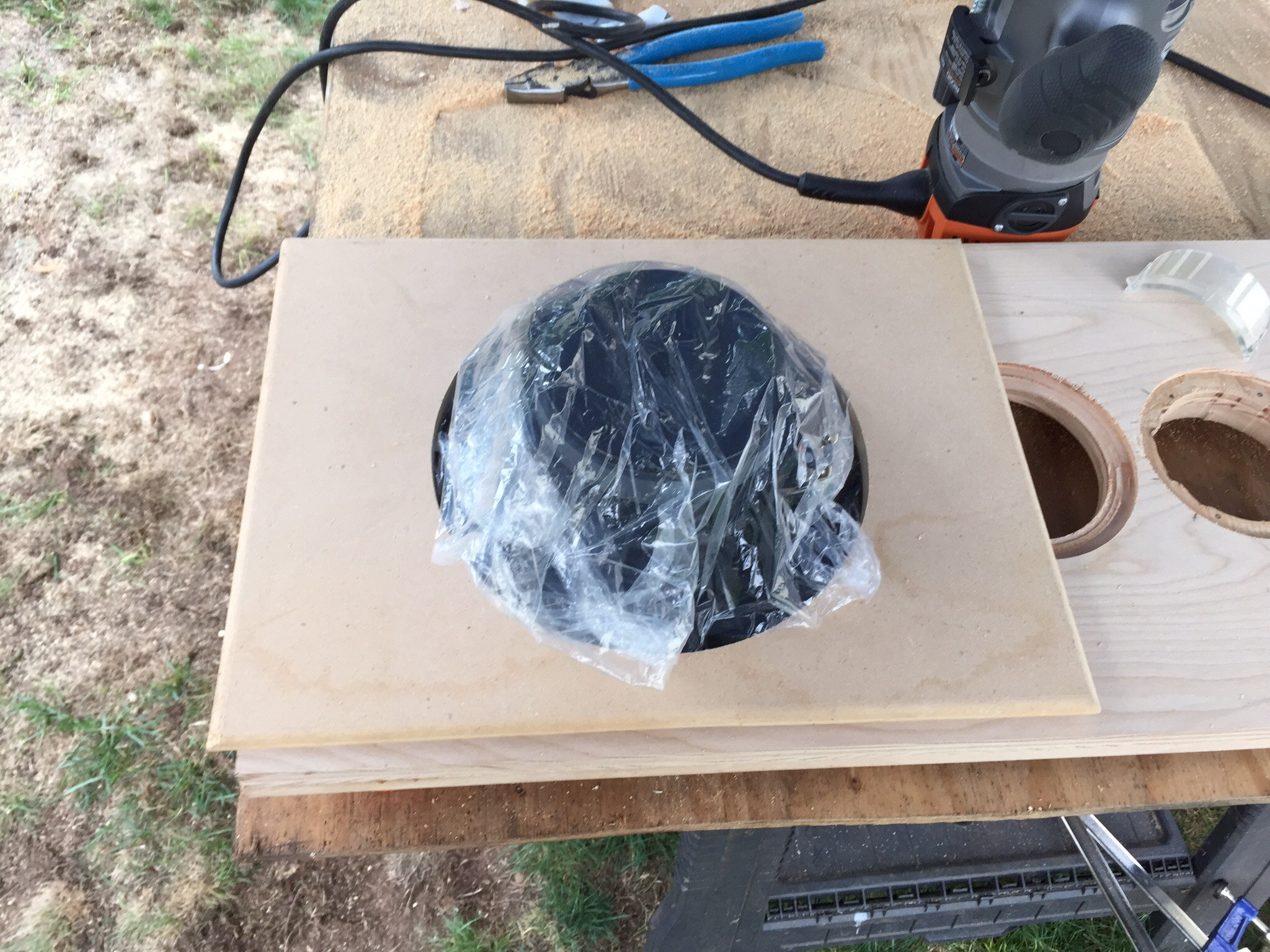

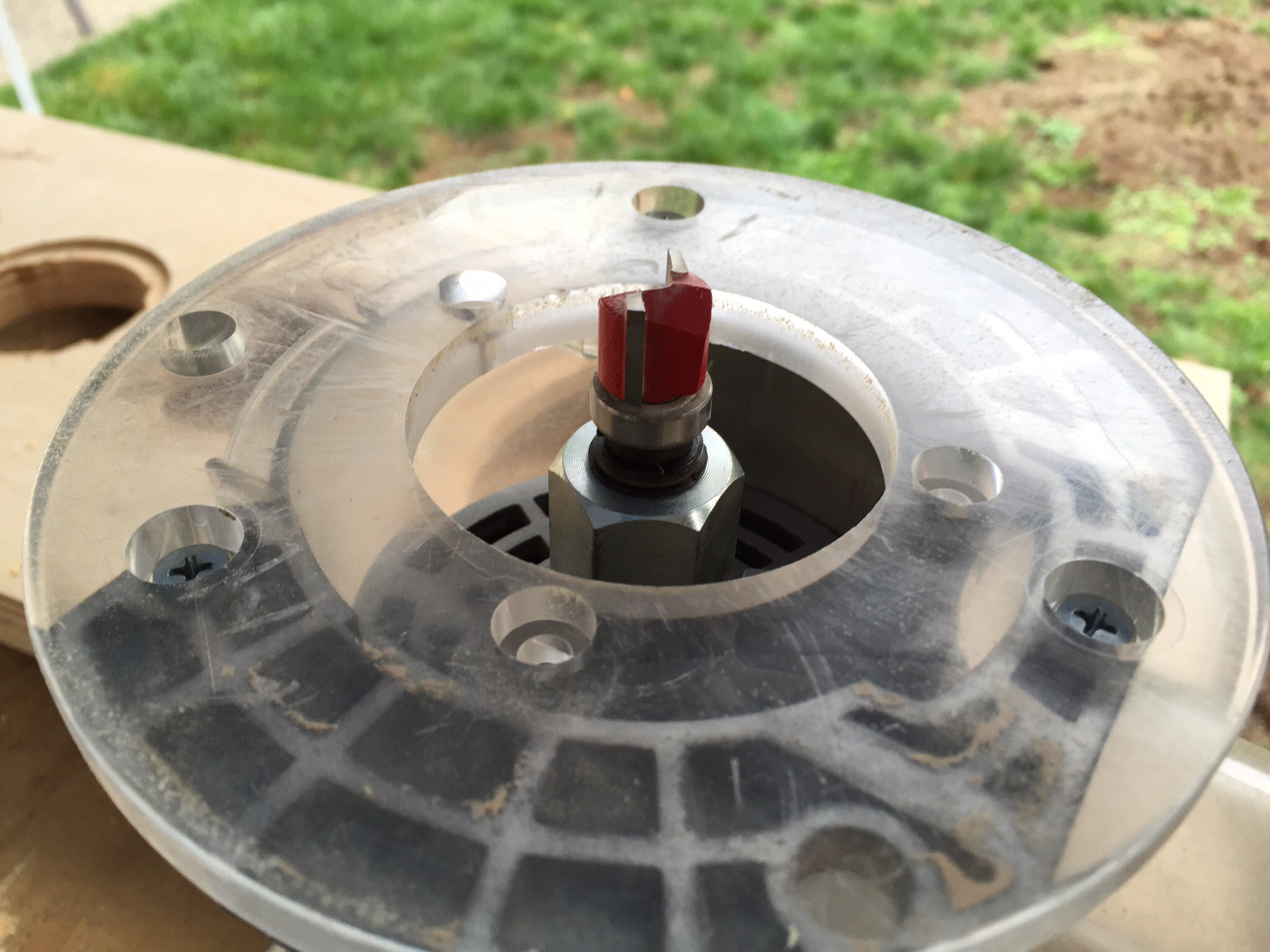

                                                            For the driver recess, I took a 1/2in scrap of MDF and cut a circle the exact diameter of said driver recess. I then placed it on top of the hole I needed to deepen. I used the driver to ensure it was lined up correctly. Example below:

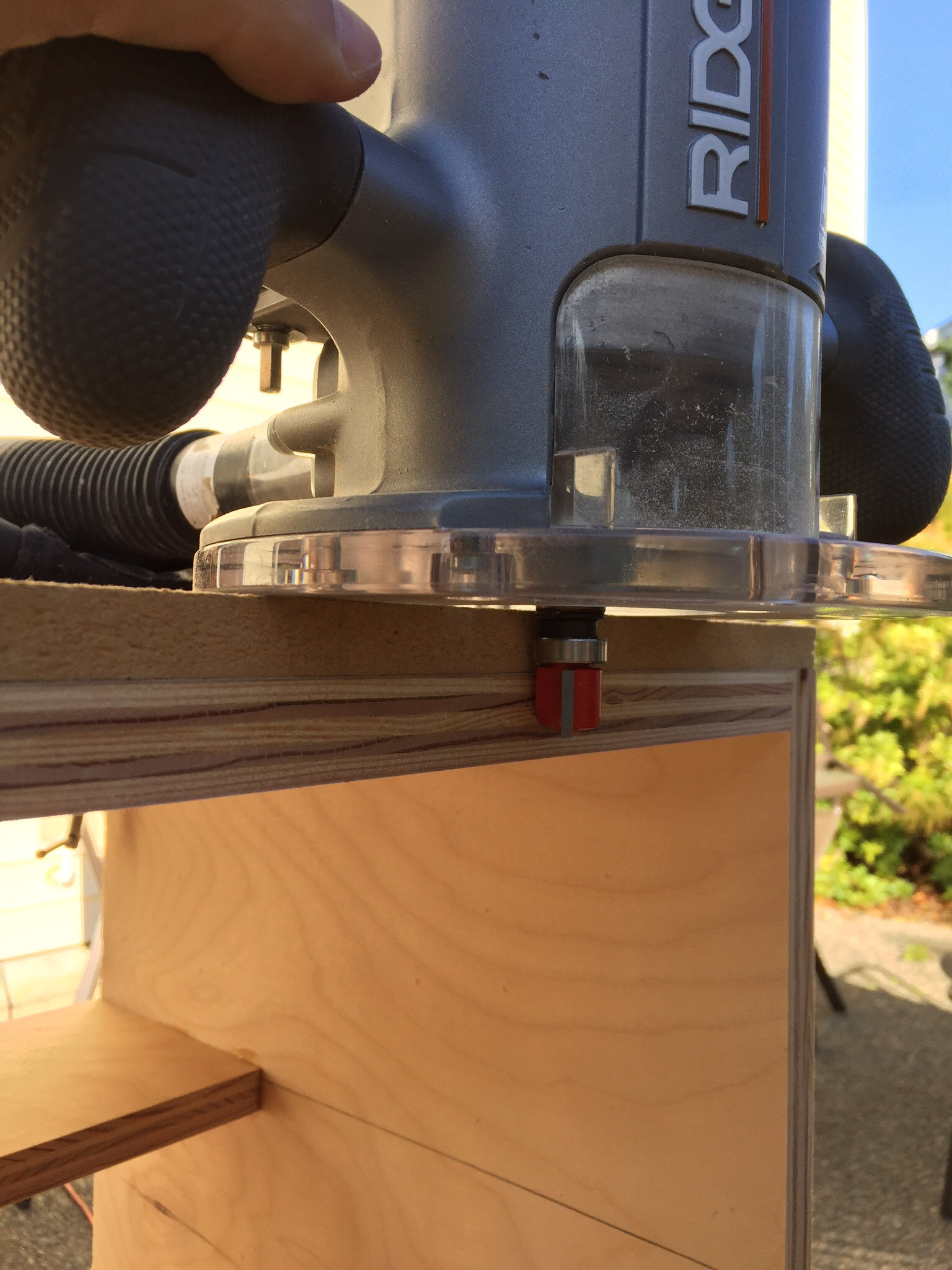

                                                            After it was lined up correctly, I used a top-bearing flush bit on my router to add the extra depth. Works very well since it used the 1/2in MDF board as a guide. Make sure to grab the 1/2in length router bit since you'll be working with shallow driver recesses.

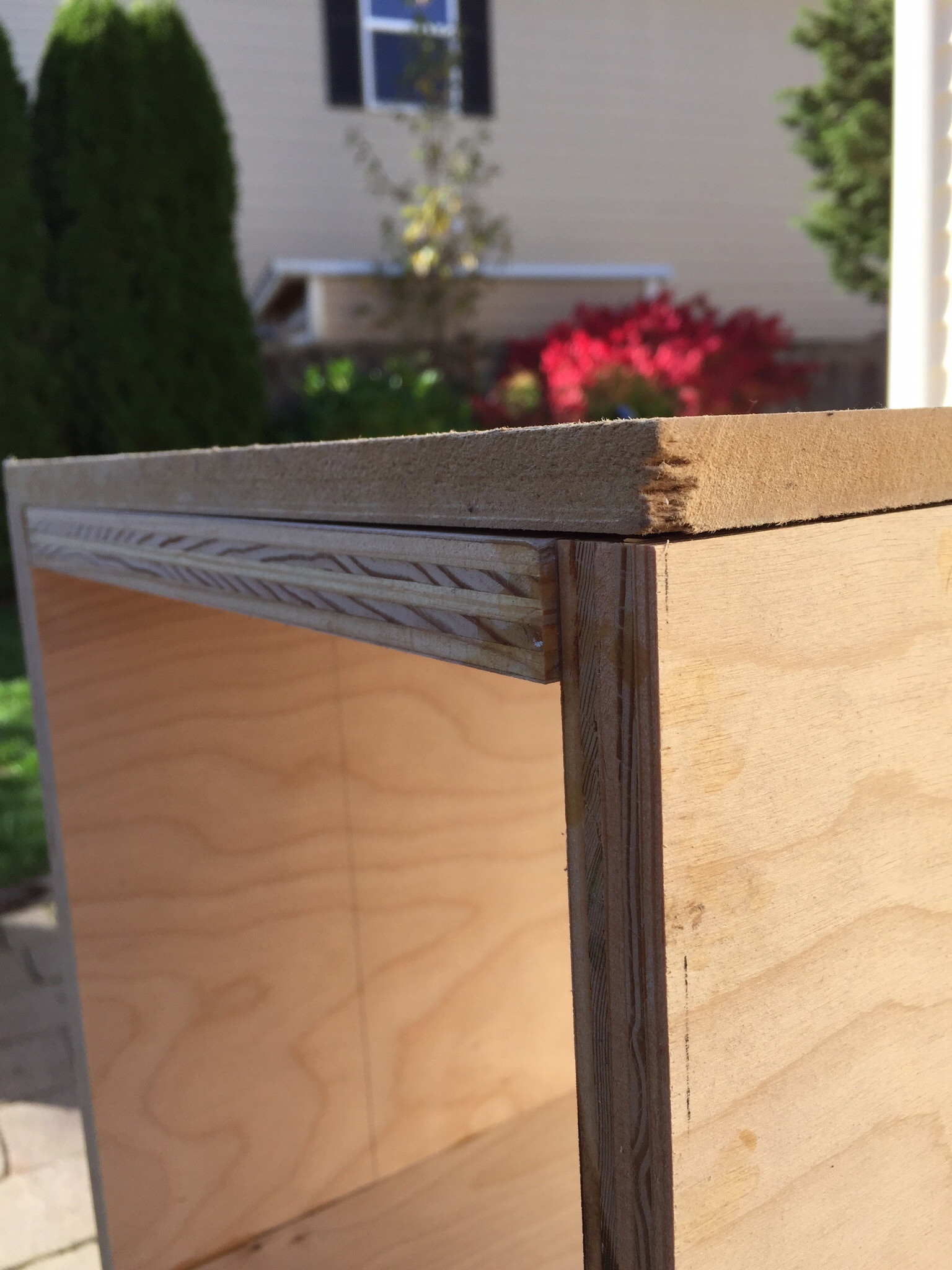

                                                            Next was trimming excess material off an edge that would caused a gap when I glued the front baffle on. With this project, I had a few places where the boards were way off, like the picture below:
                                                            So I used the same router bit as above and used another scrap mdf board as a straight edge. I clamped it into the back of the cabinet so I had a free edge to route against.

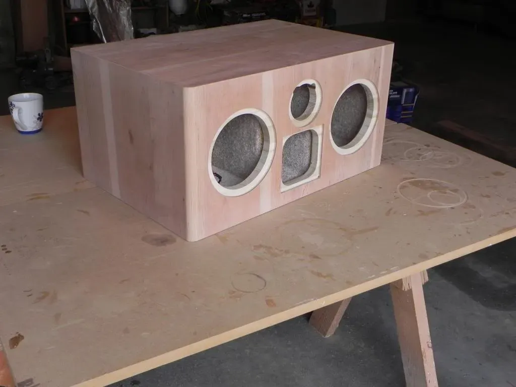

                                                            So, I forgot to double and then triple check my measurements on my first baffle. I got two first passes through before I realized I had used the wrong locations. This caused the driver holes to overlap. Naturally, I flipped over and used the other side Of course when it came time to do the chamfers for the mids, I went at it and found out the chamfer wasn't big enough to hide the mistakes. See below:
                                                            So, I filled the holes with Auto Body Bondo and THEN chamfered. It turned out great

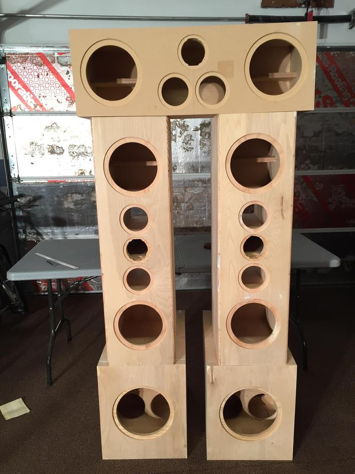

                                                              The good news is after spending an entire day tweaking and fixing mistakes, I am starting to make some real progress. I have the first cabinet in the final gluing stage - other two are next in line.

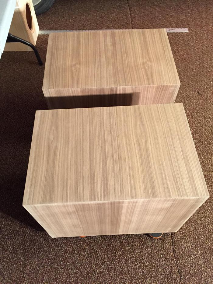

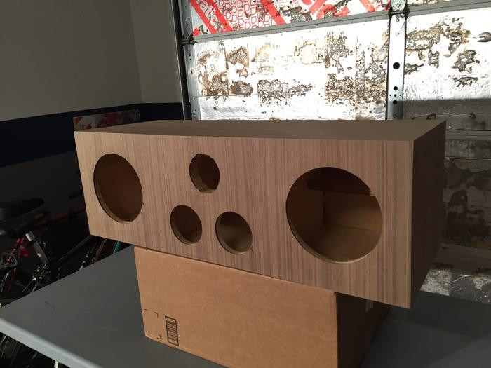

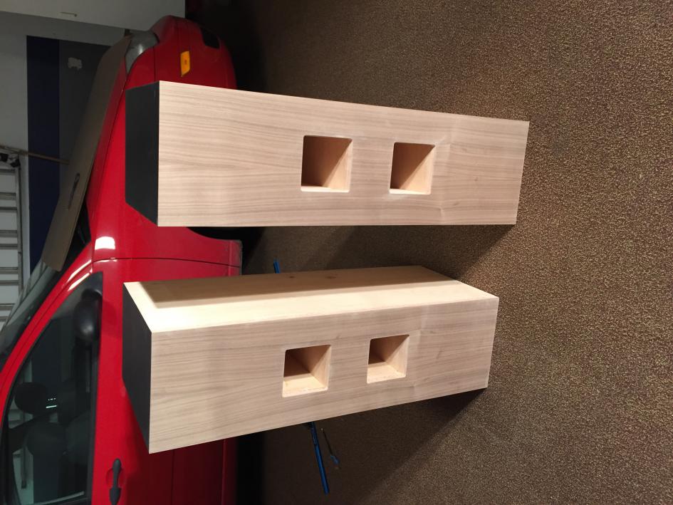

                                                                      Well, today I was able to get the veneer cut, center and bass bins, prepped and center channel successfully covered. Before and after the 'Hawks game tomorrow, I hope to successfully cover the two bass bins. Then it is on to the towers!

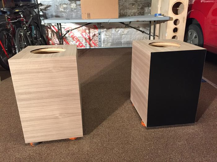

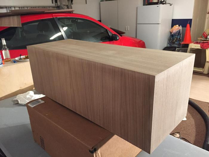

                                                                              Bass Bins are veneered!
                                                                              Here is a top picture

                                                                                Originally posted by bostonmurf
                                                                                there really turning out awesome Kevin, as always incredible work! just out of interest what router bit are you using to trim back the veneer around the driver holes in the recesses. I'm guessing like mine theres only about 1/4 in depth to play with which rules out most bits.
                                                                                Thanks, Boston.
                                                                                I'm going to use on of these http://www.ebay.com/itm/270388799194...%3AMEBIDX%3AIT
                                                                                The key is to make sure it has the uber short tip for shallow dados - mine is only 1/4in. More than short enough for the recesses. I haven't tried it yet, but I've seen Jon Marsh use one, so I figure it's a wise path
                                                                                  You're going to have more bass than your house can handle shortly :P

                                                                                      Final pair
                                                                                      Main cabinets have been freshly rounded over with the 3/4in Freud Roundover Riuter Bit (that thing is a beast - spits chunks at you instead of saw dust) and finished sanded.
                                                                                      I've gotten a head start on the veneer - completed the bottoms and back tonight. Tomorrow I start the big wrap-around piece. Yikes!
                                                                                      I've started my test piece. I lightly sanded with 220 grit, put 2-3 coats of Watco Danish Oil Dark Walnut and then 3 coats of Clear Gloss Wipe-On Poly. I planning on using satin poly as the final top coat.
                                                                                      Does anyone have any steps they recommend that missed?
                                                                                        For next time, if you're spitting chunks with a router you are cutting too aggressively. Light cuts will give you a smoother surface in the end.
                                                                                        Hard to tell from the photos, but did you use some sort of grain filler? I think I'd put a few more coats of Watco and sand up to 420 to 600 grit and clean thoroughly before the final coat(s). I tend to use gloss finish and knock down the gloss to the desired sheen with steel wool/rottenstone. I think the finish looks deeper than when using a satin finish. Of course you need a decent depth of finish, so probably 3 coats minimum.
                                                                                        • kevinm
                                                                                          • Jun 2013
                                                                                          • 417
                                                                                          Thanks, Bob. By light cuts, do you mean less material on each pass? With my 1/2in radius round over already there, I was surprised it was shooting chunks (more like splinters), but I did have my router on the lowest setting because of the size of the bit. Think that could contribute at all?
                                                                                          I didn't use any sort of grain filler - first crack at staining of any kind, so I'm noob testing. How aggressive do you sand? I just light sanded with 220 one side (the slightly dark, richer side) and left the other as is to see what the differences would be. Do you sand up to 420/600 before the stain? Then apply Watco Danish Oil and then add a few coats of Poly?
                                                                                          I've also seen some woodworkers mention wet sanding with the Danish Oil to fill in the grain a little. Have anybody tried this?
