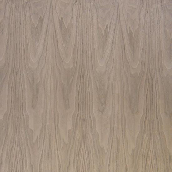

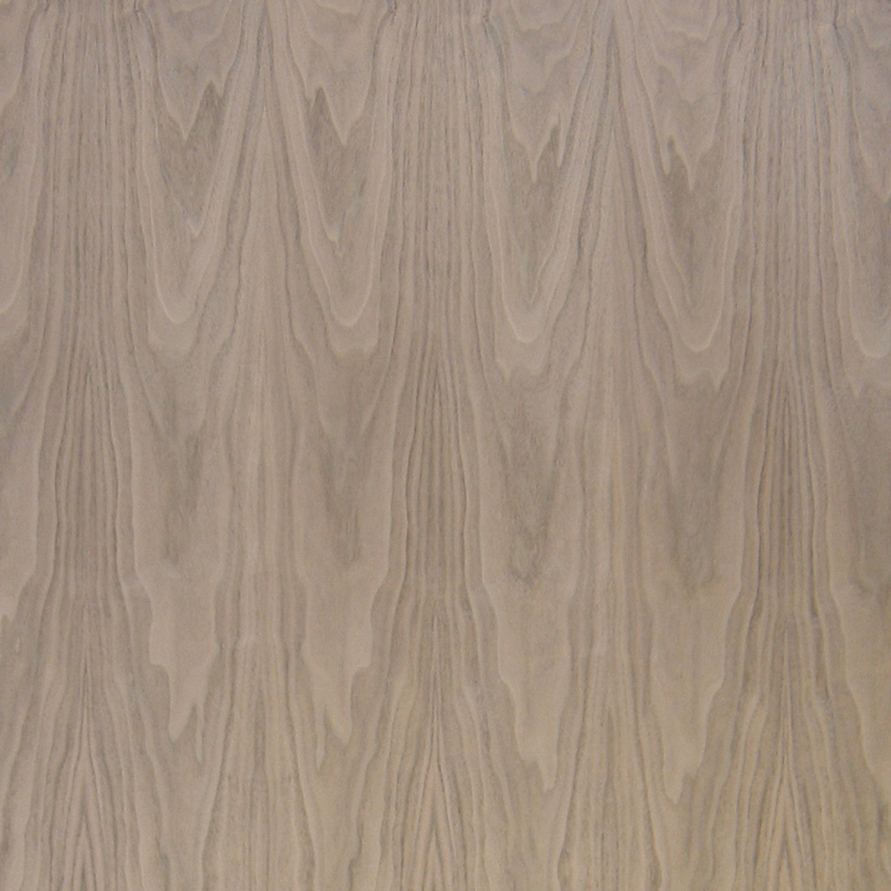

    I've read through some of the veneering posts here and have a pretty good idea on how to go about gluing it with an iron etc and trimming.
    The question I do have is, what I should stain/seal it with. There seems to be a million different options. I would prefer to keep it as natural looking as possible so maybe just sealing it? However, I am pretty open to what I do and am just looking for some ideas/possibilities.
    Thanks!

    Stain won't do much on a wood like walnut. You may see a slight difference, but not like you would on a species like red oak. Regarding finishing, it really depends on what your set up is. Do you have to work in your basement? I'd look for something water based. (Benwood Stay Clear is the one I've been using recently where water borne is required).
    Another consideration is dry time. Do you need a speedy process? Lacquer is a good one here and my finish of choice about 95% of the time. Gemini coatings is my favorite. Requires a fairly pricey setup and needs to be done in a well ventilated area ie not basement, or really even garage unless it is unattached. Spray knowledge will relieve some stress if you go this route.
    A standard brush on polyurethane like a minwax product is a good choice for a beginner. Pretty straightforward, and gives a durable finish. can yellow slightly over time.
    Oils like Danish Oil can work alright, though the durability leaves a lot to be desired. Highly labor intensive for what I would call little to no gain in end result over a polyurethane. The biggest advantage for you in this case is the lack of "plastic" looking finish. Because it is a penetrating product, you don't get the build you do with a polyurethane or a lacquer.
    Again, all personal preference. Lacquer has been my favorite for a long time. Even though I've used the others, I won't stray from the lacquer on projects that I feel are really important.

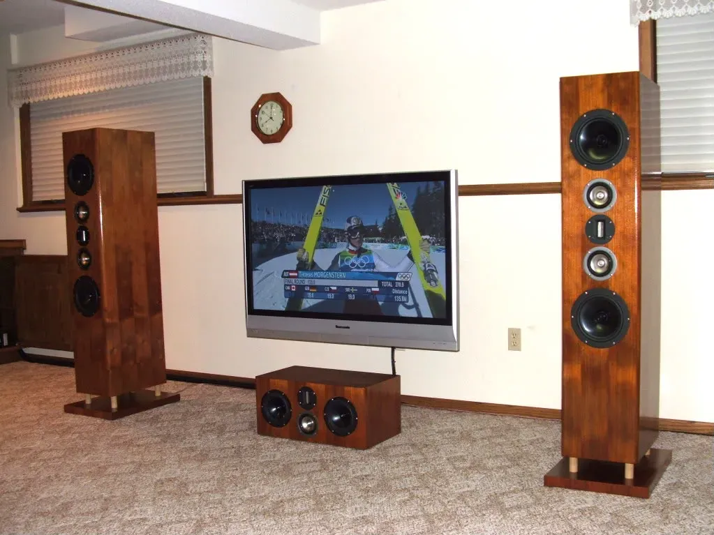

      I just got done veneering 5 speaker cabinets with a Walnut veneer from Woodcraft, so I can probably give a few tips
      I used a contact cement instead of the iron/glue method, and I don't think it could have been much easier than using the contact cement. Simply cut your piece too big, apply contact cement to both sides and let it dry. Then drop it on, roll it flat, and you're done! To trim it, I would probably try using a flush trim router bit, but only if its a good bit, like a $20 namebrand bit, rather than a $2 Tool Shop bit. A cheap router bit won't cut through it very well and you'll have paper backing left on and its annoying. I ended up cutting about half of the edges with a razor blade, which I don't recommend. Its too easy to mess up.
      For sealing it, I was told the best thing to use was this "oil & urethane topcoat" which is a type of varnish that you can see here; I think it was semi-gloss: http://www.woodcraft.com/Product/200...al--Quart.aspx
      You do not want to stain this wood. The varnish will make it look very natural
      If you want to see how the Walnut Veneer looked when sealed, check out my build thread:
      Since I got so much information from this site before choosing which speaker project to build, I thought I'd post pictures of the process for anyone else who might be looking to do the same. After months and months of research without making a decision, I decided to go with the Zaph ZA5.2 kit(s) from Madisound. I really wanted

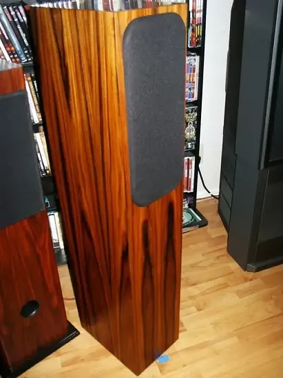

                  Maybe like this:
                  He stained them though and I don't know if I want to.

                    Maybe like this:
                    I dunno, that link looks pretty similar to the shine of mine; the lighting in the picture is significantly different and mine isn't reflecting anything... Anyway, there is a "gloss" version of the varnish I used. I simply used "semi-gloss so as to make it look slightly more natural."
                    The only reason I mention this is because the wood guy I spoke to specifically advised against using an acrylic based lacquer on this veneer... I just don't remember why.
                    BTW, his staining the wood should have an impact on the overall finish, just the color. That's why his is so much darker than mine. I prefer the natural color of walnut so I obviously didn't want to stain it.

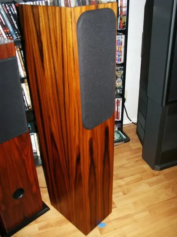

                                                  Yes, I meant lots of oil - don't let the veneer surface you're working on get dry. One can should do it. Personally, I'd use the natural walnut, as most walnut is naturally quite dark. edit: I just looked at the photo from Oakwood and even though that veneer looks a bit light, the oil will darken it quite a bit. Start with the natural and see what it looks like - I think you'll like it. If you want it even darker, then use the Watco dark.
                                                    The top appears high-gloss, like poly, but that's because of the high angle of incidence of the reflection.​

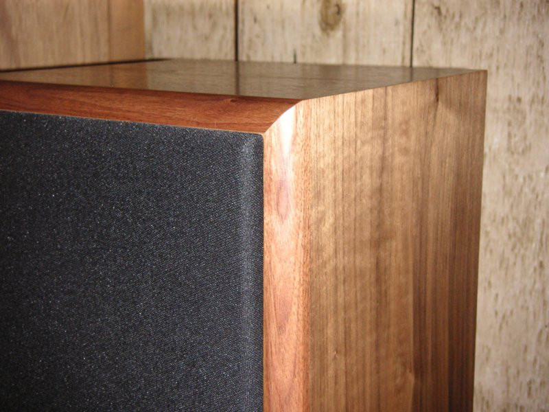

                                                      Check out mine here, used walnut too, I only used Danish oil and wet sanding.
                                                      Hello everyone, About a month ago I started my quest for DIY speakers and a week later decided to build Statements, now finally things have started to come together. So here goes: Parts Express didn't have the 4" Titanium Driver, I'm also waiting for the NeoCd3.0s in black. Kitteh disapproves of incomplete parts

                                                      • dsl1
                                                        • 33
                                                        https://www.htguide.com/forum/showpo...&postcount=187
                                                        Those look great.
                                                        What did you use to polish at the end?
                                                        How much oil should I get to do both?

                                                        • sawdust
                                                          • May 2009
                                                          • 105
                                                          Transtint orange, Danish oil, shellac and hand poly.

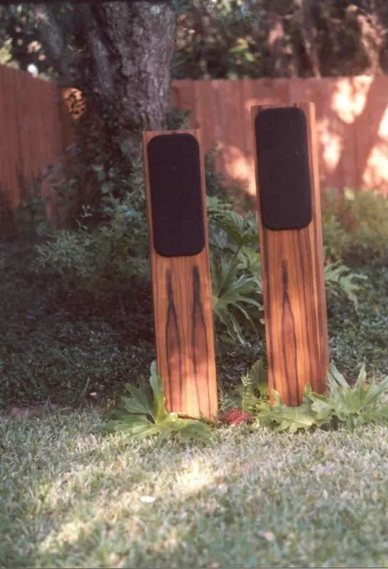

                                                            To show you how oil darkens a veneer that's lighter than walnut, here is the roseweed veneered cabinet in the photo above as it looked before my oil finish:
                                                            • jyqureshi
                                                              • 141
                                                              Originally posted by dsl1
                                                              Those look great.
                                                              I used natural danish oil(no color).
                                                              I think I used up about 3 small canisters of oil (Watco brand I think). I think three is quite plenty, two might be good enough for you.
                                                              In the end I just got some wax polish (Briwax brand I think) and followed the instructions on the container. You just wait a few months to let the oil dry and then polish it.
                                                              • dsl1
                                                                • 33
                                                                Watco has pints and quarts. I am going to order two quarts.

                                                                  • dsl1
                                                                    • 33
                                                                    Originally posted by Hank
                                                                    I start by flooding the surface, the rub (with the grain) with 400-grit wet-or-dry abrasive paper, adding oil so the surface stays wet. That develops a slurry of oil and wood particles the fills the veneer grain. Let it sit for 15 - 20 minutes, then wipe off the excess (wipe across the grain). After doing all cabinet sides, I switch to 600-grit, then 800, then 1000. Some veneer is smoooth enough that I can start my process with 600-grit. I will usually do one grit per day, so there's drying time in between grits.
                                                                    Hope that helps - it's a very labor intensive process, but worth it to me.
                                                                    Do you flood the surface at the start of every grit? Assuming so, I just want to double check before I start.

                                                                        Mike and dsl1, I just got back to this thread, so apologize for late replies.
                                                                        Rosewood is actually a naturally tight grain, so "grain filling" is not the major issue as it would be with the wide open grain of oak. I think walnut may be a tad more open than rosewood, from sample pieces I've had, but still a tight grain species.
                                                                        Total number of DO coats: If the veneer is quite smooth, I can begin with 600-grit, so it's 3 coats: 600, 800 and 1000 grit. But, I do a lot of rubbing (it really is WET sanding because it results in very very tiny particles in the slurry) with each grit.
                                                                        dsl1: Key point is to keep the surface flooded at all times - it's messy and you'll have lots of oil/slurry spill down the cabinet sides, so put your cabinets on a big piece of cardboard and have paper towels to clean up with. If you guys go all the way to 100-grit, you will have a good gloss (that's subjective, BTW - I do not like a polyurethane gloss level), call it a satin or satin+ gloss. Please try test samples and start with 400-grit or 600-grit and spend a few minutes with each, using plenty of oil, then wipe off the excess across the grain, go watch a movie or wait a day, go to next grit, etc. You will be surprised how smooth your finish will be. This is slow, labor intensive work, but as I stated, what this does for displaying mother nature's grain is unbeatable. Go for it.
                                                                          Gotta add a caution here. The oil, as it dries, has an exothermic reaction, so never wad rags or paper towels up and put in the trash as they've been know to actually ignite when highly concentrated like that (I've read that on pro woodworking forums). I just spread out the rags/paper towels on my driveway and when dry, then trash them. Stay safe.
                                                                          You guys post some pics of your experiments here - you can do this :T
