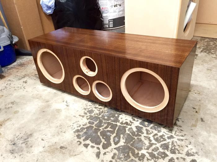

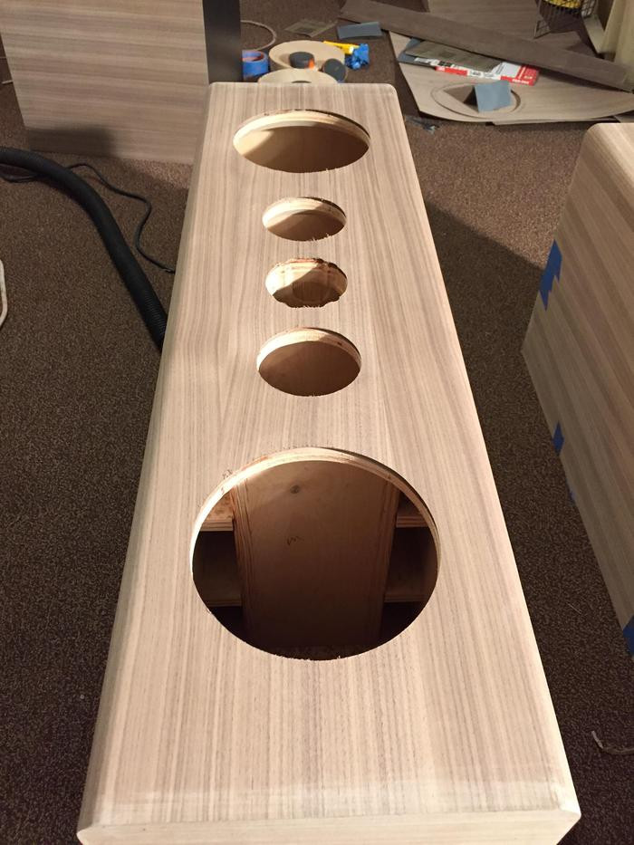

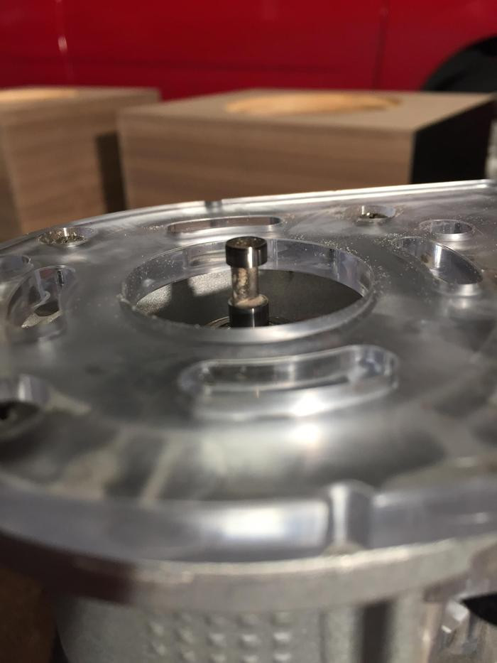

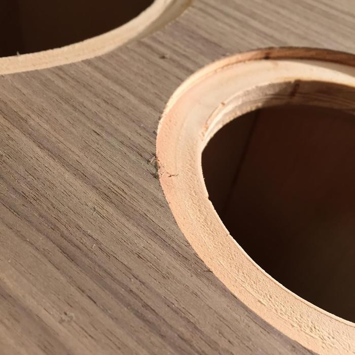

    It sure is amazing at what you can do with a router. Today I finished up my veneering and only had the driver recesses to trim out.
    I picked up the small bit mentioned above:

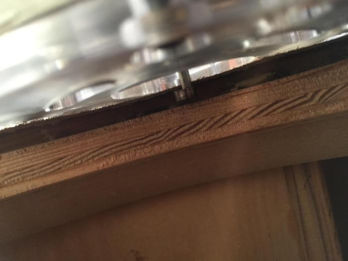

    You start with this ( just used a normal flush trim Riuter bit to get her this far):
    Adjust height of bit so it ends up like so:
    Then go bananas with it. It cuts so smooth. After you route out the recess, just run some 220grit sand paper and remove the burs.
    And all done with veneering!
    That was a lot of veneer. I would be ok with not veneering for a while

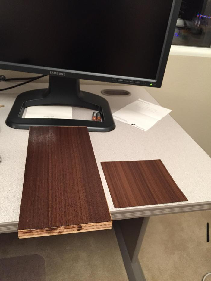

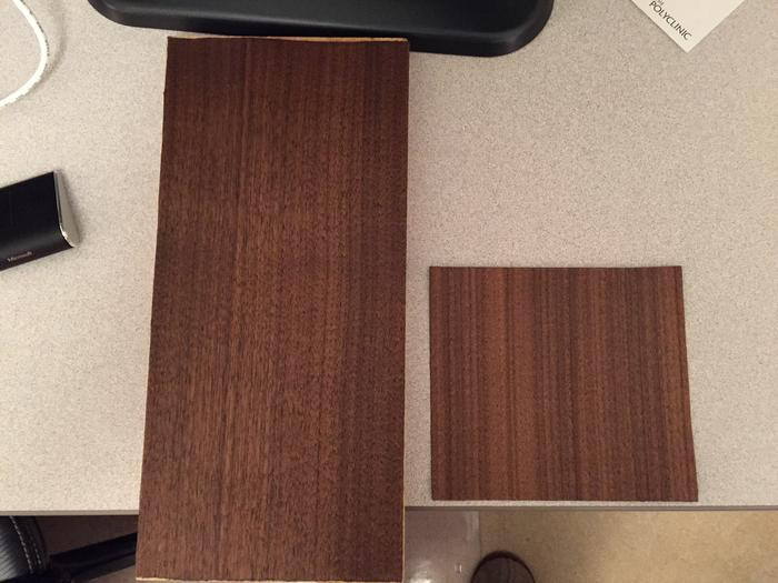

      Alright Id love some opinions....which do you guys like better?
      And another angle showing the contrast a little better
      • Carl V
        • 269
        Left

          looking good!!! thanks for the info on the recess trimming, awesome work. as for the stain id go right, i like the contrast in the grain.
          • kevinm
            • Jun 2013
            • 417
            Thanks, Boston and Carl V.
            Everyone I've chatted with is leaning to the left sample, but I'm kind of intrigued by the right for the same reason Boston mentioned. I think I can add another coat or two of Danish oil to richen it up a little more to compare to the left sample. Is that why you like the left sample, Carl?

                    I sanded with 220 pretty throughly and 400 and 600 lightly. Then just did 2 coats of Medium Walnut Danish Oil from Watco. Danish oil was applied until wood stopped soaking it up as fast as I could put it on. I'd them give it 15-20 mins before wiping it off. Then waited 2 hours before reapplying.

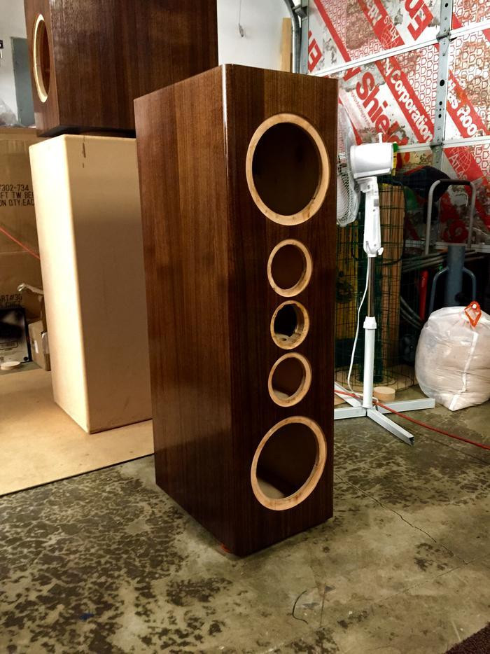

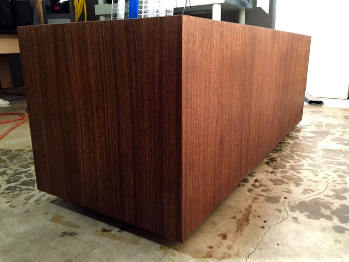

                              Cabinets have been coated with Danish Oil.
                              From my tests, I decided to do the first coat in Medium Walnut and the second and third coats in Dark. That gave me a little better grain variation, but kept them rich.
                              They've been drying for a few days - plan to start my coats of Wipe On Poly on Friday.
                              I don't want to do a full shot because the lighting isn't doing the cabinets justice - they're so beautiful in person. Dark and beautiful.

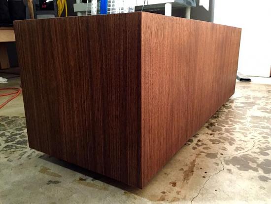

                                    Thanks, guys! They are turning out really well. I have just put my 4th coat of poly on them. They're looking incredible.
                                    Once again, the lighting is terrible again, but here are few progress shots!

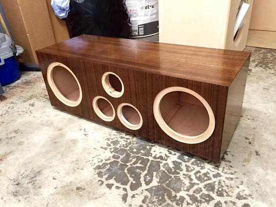

                                            Final coat was applied last night - ended up staying with the gloss over satin - my samples just showed such a richer color using gloss.
                                            Jim, where did you place your binding posts on the CC? It looks like the only realistic place is behind one of the woofers on the back panel. I didn't middle of the back panel was very feasible because of the mid chamber being so close. The "I-make-everything-symmetrical" part of me is twitching at the thought.
                                              Asymmetry is the spice of life....:W

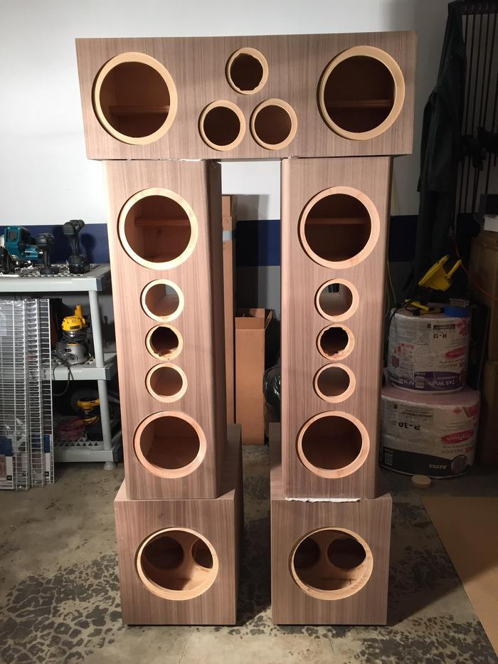

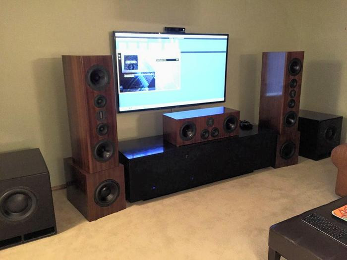

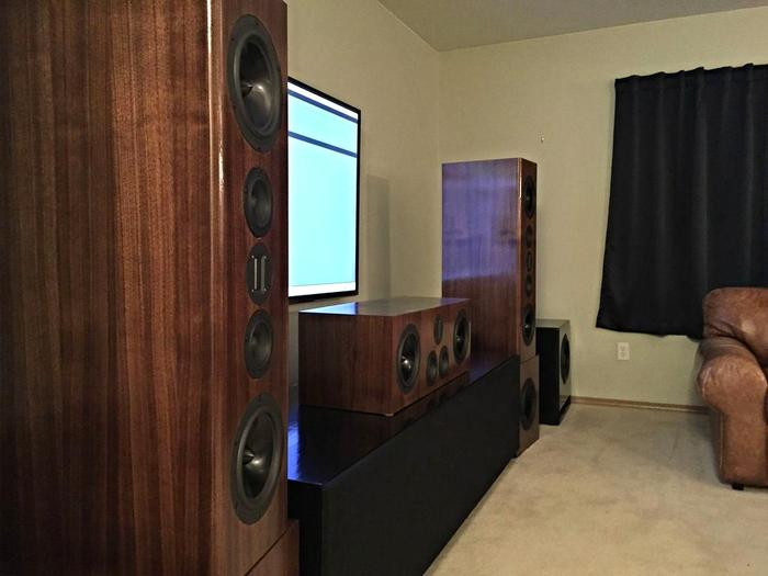

                                                      I ALWAYS underestimate how long it will take me to finish the final few steps. I think it took me about 16 hours to drill the necessary holes in cabs, install the wiring, stuff the cabinets, install crossovers, connect everything up and install the drivers (mind you, the wires were all pre-cut to "expedite" things and the crossovers already completed). Whew. Then a last minute mistake put me about 1-2 hours back - accidentally shorted BOTH cabinets with my binding post plate - more on that later.
                                                      However, I am finally up and running. Sorry for the terrible pictures (Jon, you will be ashamed - but if it helps, I think your pictures have convinced me to pull the trigger on a DSLR in the near future), but the lighting downstairs in our house is atrocious at night. I'll grab some glamour/headshots of them soon.
                                                      Also, I'll post my step-by-step finishing guide just in case anyone is interested as well.
                                                      Anyways, here is the first configuration:
                                                      No audio review yet as they are still breaking in - I've heard a nice change in sound in just the 1-2 hours they've been running. However, so far I think it is safe to say the move to sealed towers and bass bins was a success - more on that later. I am running the bass bins in stereo under each tower - I have a Minidsp 2x4 running the system. So far, I just used a really basic setup on the system to just start making noise - towers have a HPF of 40z and the subs a HPF of 22hz and LPF of 85hz. I think all slopes are 24db. I have lots of testing and tweaking to do - need to breakout REW and the mic.
                                                      I am running the towers off of Emotiva XPA-1 monoblocks and the subs are running off an iNuke 3000 in 2ohm stereo. So far, the headroom on both is clearly audible - loving it.
                                                      That's it for now, I am off to listen to everything I have. Giddy all over again!

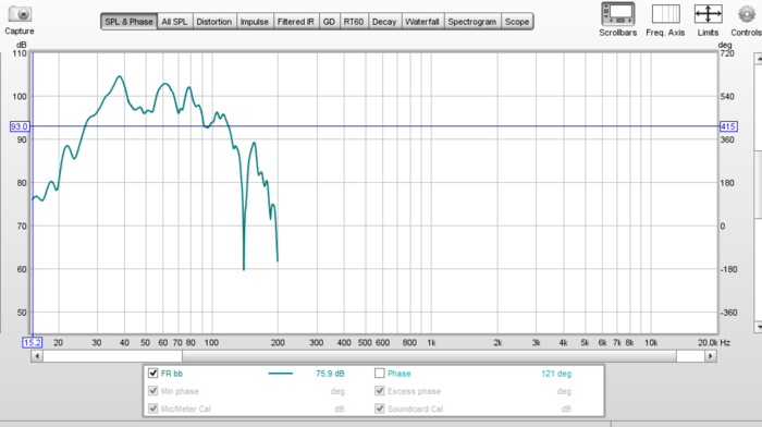

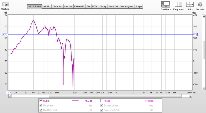

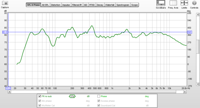

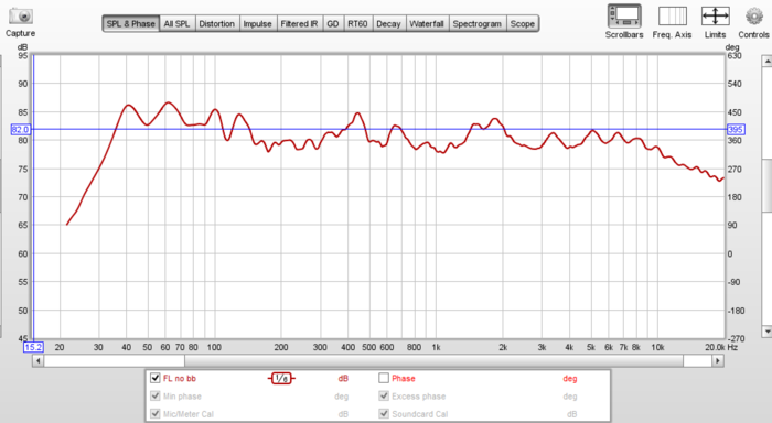

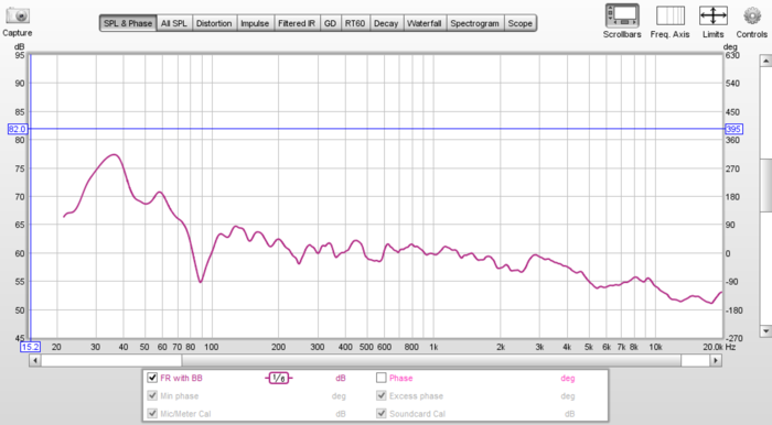

                                                                  I was playing around with some measurements. Here are direct, no eq measurements 15-20khz.
                                                                  Here is the Left speaker without the bass bin
                                                                  Left speaker bass bin
                                                                  Right front speaker without bass bin
                                                                  Right front bass bin

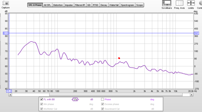

                                                                  Here are the speakers integrated through the Minidsp. Minidsp has applied the following crossover filters:
                                                                  Towers:
                                                                  HPF at 40hz
                                                                  Bass bins:
                                                                  LPF: 85hz
                                                                  HPF: 22hz
                                                                  EQ below is applied through the Minidsp as well.
                                                                  Here is the left speaker with bass bin:
                                                                  Here is the right speaker with bass bin:
                                                                  Anyone have any thoughts/recommendations?
                                                                    My advice would be to seal the statements and then apply a 2nd order highpass to them at the box f3. This will give you a decent amount of bass extension but will also protect the statements vs being over driven. I'd imagine that you'd get a box f3 of around 50Hz. People have over driven their statements, either from melting the coils of the 225s or from over excursion, where the voice coils have slammed into the back plates. Sealing them and applying a high pass will give you a nice amount of extension with a nice even roll off. You could just apply a highpass to the ported statements, but then you'd end up with a 6th order roll off which doesn't suit everyone.
                                                                    After high-passing the statements I would want to run the bass modules up to around 150Hz. The reason for this is to have more bass sources putting energy into the room and helping to even out the response. The higher you can run these, really the better, as you will get room mode issues up to around 200Hz, but the larger the room the lower this actually is. 150Hz is a nice compromise and the subs of the bass modules should easily cope with being run this high. 4th order electrical them with the low pass and it should give you a 4th order acoustic roll of. As to the EQ and/or high pass that you apply to them, I would want the bass modules to work as hard as they are capable of, but you will need to do some simulation work of SPL vs extention vs excursion vs power handling.
                                                                    You will of course then need to blend the bass modules with the statements. As the mains will work down to around 50Hz, for example, and the bass modules will cover up to around 150Hz, there is a nice region of overlap between the two where you are going to get a raised amount of output. You should be able to apply shelving filters to both the mains and the bass modules to reduce their output, between the region of overlap, such that they sum pretty much flat. This has the added advantage of taking even more strain away from the mains.
                                                                    Once they are blended you've then got to integrate your actual subs into the equation and these should, I'm presuming, have output down to 20Hz. I would want to use these up to around 100Hz, or at least 80Hz, if they are not so capable, to again maximise the number of bass sources you have within the room. This will once again require shelving filters to blend the subs with the blended mains and bass modules, but I can assure you, that if you've got the required number of DSP channels and the number of power amplifiers that you will not be disappointed. A reasonably well configured multiple source bass set up sounds nothing short of superb. Like I mentioned earlier on in another one of your threads, if you can get one of your main subs behind the main listening position that will also help significantly, instead of having all the bass sources mounted along the front wall.
                                                                    I have to say though it all looks amazing I hope you are pleased with the outcome.

                                                                      Hi 5th! Thanks for chiming in. What's yohr procedure for blending using the shelving filters? Do you use a program like REW to setermine when/where to apply them?
                                                                      Would you mind walking me through how you interpret the graphs?
                                                                      I assume adjusting my bass module/statement crossover, then providing the non-EQed graphs would be the next step?

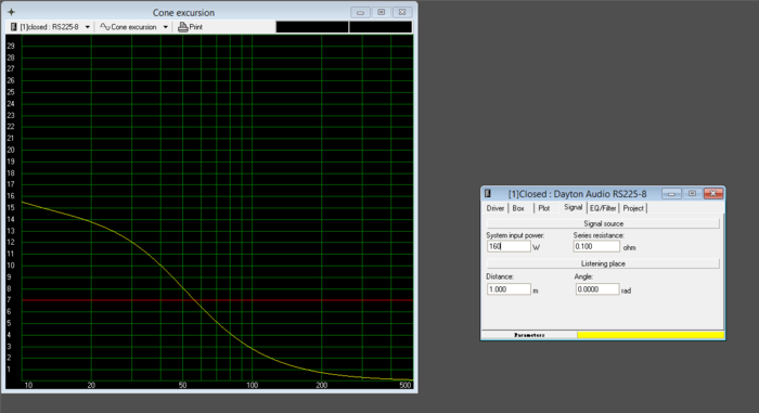

                                                                        I've just got to jump in with a few thoughts. I think his Statements are built with sealed bass and open mid tunnels. Since Curt and I introduced the Statements in 2007, I've never heard of anyone melting the coils in the RS225 from over driving them. They've been road tested up to 115 db. Here's a clip of the Statements II from the Meniscus DiY event last summer. The only driver that I know of that has been damaged by high SPL was the result of exceeding 117 db in a very large basement when the owner was showing them off to friends. He stretched the ribbon elements and had to have Madisound replace the element only. The RS225's aren't indestructible but they'll take a lot of abuse and keep on playing even when they're stupid loud. :T
                                                                        I'd also suggest a crossover to the bass bin or subs around 50 - 60 Hz. There have been many built and integrated that way and they work extremely well with that crossover point. Dual RS225's will always sound cleaner and tighter than a sub/bass bin in the mid bass. Cross them higher and you'll get "bloated" bass which is great for movies, but not so great for music.
                                                                        Anyway, this is the DIY part. Play and experiment.
                                                                        • kevinm
                                                                          • Jun 2013
                                                                          • 417
                                                                          Hi Jim,
                                                                          Thanks for jumping in. You bring up good points. If I am not mistaken, one of the reasons I think 5th was recommending a higher crossover on the bass bins was too add extra slam to the mid bass. But like you said, it can make the mid bass bloated. I first tested a lower crossover point with the bass bins (LPF at 80 hz) and I liked what I heard for music, but I think there is more tweaking/testing to be done. My limited tests this far have me willing to continue playing with the bass bin crossover - my 150-200 crossover did smooth room nodes.
                                                                          If I remember correctly, the sealed boxes are roughly 80 net litres for the RS225s, correct? If so, modeling shows the RS225's reaching dangerous excursion levels at their rated program power below 40hz:
                                                                          Now to be fair, this power results in a modeled 111dbs - which is stupid loud. I was playing them hard last night (above my normal "loud" listening volume) and I was only reaching 105db peaks at the cabinet. On the other hand, I have to say the lower end of the Statements sounds cleaner and less strained to me with a HPF around 40-50hz than say 30hz.
                                                                          Either way, I welcome the discussion and really appreciate everyone's opinions. It's been educational from both sides for me. Since we all have our own preferences, I like hearing everyone's - makes the road to further defining my own a little easier
                                                                            Just a quick response and I'll move on. The comment that prompted my response was the coil melting in RS225's. I'm guesstamating that there have been close to 2000 pair of Statements/Finalists series speakers built since the original introduction date of 2007 and melted voice coils isn't a problem we've encountered. RS225's will go bad from excessive abuse as will any driver but that's not a common problem. If we had encountered that problem, we would have quit using them years ago. Anyway, I wanted to clarify our experience over several years.
                                                                            Actually, the sealed Statements cabinet nets somewhere between 70 - 75 liters if you built it to spec. Mid tunnels, drivers and bracing all subtract from the total empty volume. Per Unibox, maximum linear excursion is reached at 108 db at a little under 60 Hz. But, there are other things to consider. The maximum linear excursion is not true total excursion. It easily exceeds that by a significant margin but becomes non-linear as volume increases. Take a look at the Meniscus Youtube video to see how crazy you can get with them. I wouldn't recommend it but you can.
                                                                            Also, the SPL calculations are assuming the total spl volume is coming from one driver when in fact its coming from all the drivers combined. When you measure the total speaker, it's the sum of all the drivers with the size of the room influencing it as well. The reason I discouraged a 150+ Hz. crossover is because of the excellent bass quality the Statements have in the mid bass range. By crossing that high with typical slopes, you might as well have a 2-way because the woofer portion of a 3-way doesn't add much. There are lots of great 2-ways you can build for a lot less than the Statements if you want to cross high. You should be able to find a happy medium with the bass bin that will give you the slam you're looking for without sacrificing the mid bass quality completely. No disrespect of your bass bin intended.
                                                                            As I ended my previous response, this is the DIY part. You can do anything you want and see what happens. Have fun playing!
                                                                              Originally posted by kevinm
                                                                              Hi Jim,
                                                                              It has nothing to do with adding extra slam (although that may happen as a result) and has everything to do with smoothing out room modes and any floor bounce issues that could appear. The more bass sources you have (and this reads up to around 150Hz for room mode issues) the more even the in room bass response will be. This is the whole point behind multiple source bass sources or multiple subs and goes directly against the usual methodology or high passing your mains and then having the sub fill in where the mains roll off. The point here is to have all the bass sources overlap and the more you have the better, especially if the sources aren't positioned in an ideal way.
                                                                              The ideal way, according to Earl Geddes, a major pioneer in this field, is to have your mains positioned as standard and run full range (or high passed to within their capabilities especially if HT is involved). You then have one sub positioned along the wall that the mains are at, one more sub ideally along the back wall of the listening room and then the third positioned somewhere NOT similar to the others, like along a side wall. So three subs with the two mains, 5 bass sources in different locations. If the subs are in ideal locations then apparently going to 4 subs offers very little benefit, vs the huge gain you get when going from 2 subs to 3.
                                                                              In your case, you've got the statements, which have two bass units each that are separated by a reasonable distance. This helps with room modes. Then you've got the bass modules, which again are separate bass sources, if not ideally positioned. And then you've got your two subs. This is why I have been suggesting that if you could place one of the subs along the back wall of the room it would be far more beneficial.
                                                                              The idea is to then blend everything together so that the frequency response is flat, or has a slight tilt, or house curve to it. Usually people prefer a bit of lift as you decrease in frequency.
                                                                              Now you can blend things in a number of ways. Geddes uses notch filters. I've used notches and shelving filters.
                                                                              Basically if you've got the mains that go from 50Hz to 20kHz and you've got a sub that goes from 20Hz up to 150Hz, you're going to have excess energy between 50Hz and 150Hz. In this case what you want to do is attenuate both the mains and the subs a little between 50 and 150Hz so that the overall summation is flat.
                                                                              Obviously you need to pay attention to the capabilities of the subs and the positions they are at. Some sub drivers aren't capable of going up particularly high without their harmonic distortion increasing significantly, but the Dayton reference series of subs are quite capable and will easily extend up to 150Hz without issue. And with the bass modules positioned directly beneath the mains you're not going to have problems with localisation.
                                                                              If anything all I'd do for now is apply very low Q notches centred at the centre frequency of where your subs and/or mains/bass modules will overlap and simply attenuate things equally until you get the FR where you want it to be.
                                                                              Integrating my multiple sub setup took quite a lot of trial and error. Geddes uses a specially designed program to do all of this for you, but you have to pay him, or buy his subs and get the setup free along with it.
                                                                              Either way, I welcome the discussion and really appreciate everyone's opinions. It's been educational from both sides for me. Since we all have our own preferences, I like hearing everyone's - makes the road to further defining my own a little easier [/QUOTE]
                                                                                No worries, Jim. I appreciate your knowledge and experience. As an audio neophyte and a builder of your speaker design, I really appreciate you jumping in and proving insights.
                                                                                Ahh, you are correct. I read a post a while back and I was remembering the volume the new generation RS225s needed for a ported box. I watched that video a while back - crazy excursion. Very impressive showcase for both the Statement design and RS225 durability.
                                                                                Is this true when you measure multiple drivers in WinISD? I was under the impression that when you selected two drivers, it was modeling SPL capability from both of them
