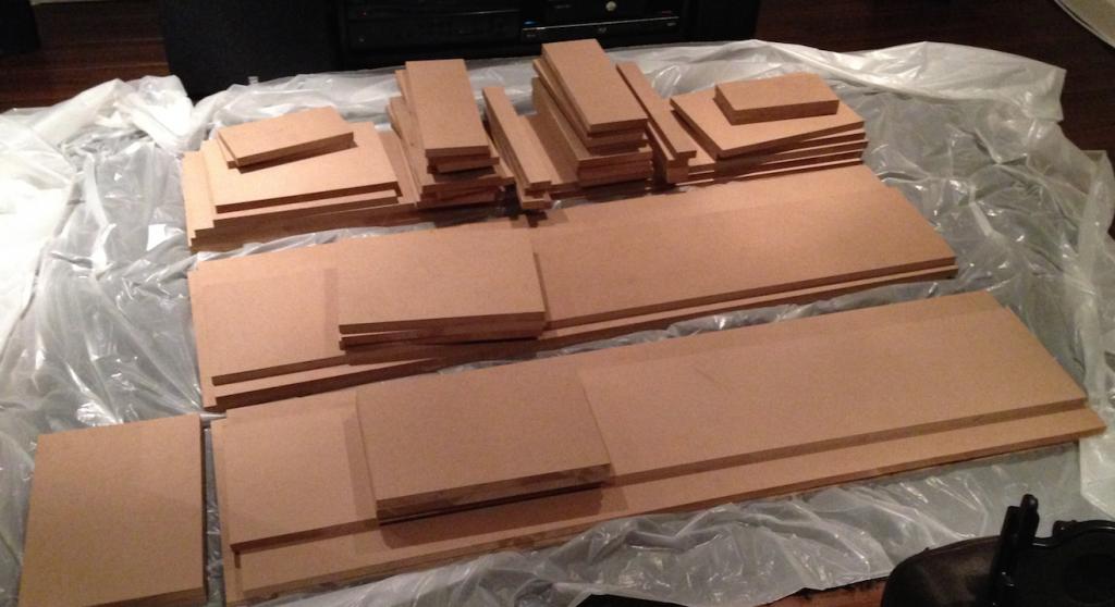

    Day One
    off to a good start, perfect weather to be outside and no dust in doors makes for a happy marriage! managed to get everything cut, table saw a little tricky with the large side pieces but everything else was a breeze - wondering if i should have opted for a circular saw? anyway i can sort out any minor problems with the trim bit on the router. does MDF stand for Makes Dust Fly? glad I’ve got the mask at hand.
    no garage unfortunately so there taking up residence in the man cave

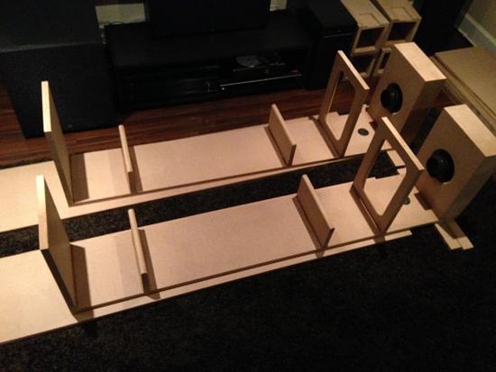

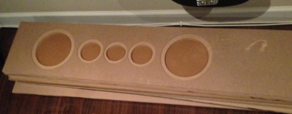

    Day Two
    A little bit slower progress although not worried, I'd rather take my time and do it correct.
    My first day using the router and a little bit nervous to be honest. 20 mins later and i think this is my favorite tool! thanks to the jasper jig, circles are a breeze.

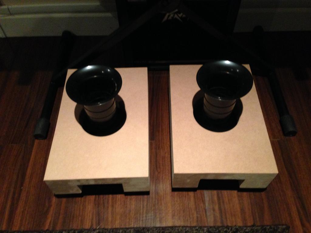

    Day Three

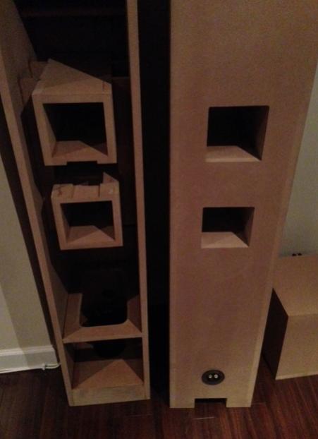

    Everything sanded and made sure to be square and level. All pieces base, shelf, bracket and top sanded to match each other. This way i should avoid any small gaps, fingers crossed.

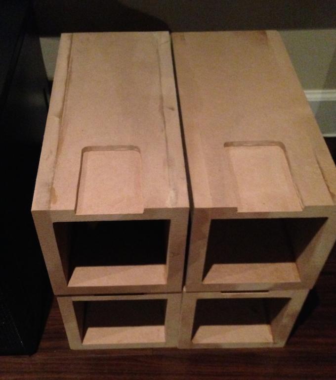

    Ports cut to length - actually used the table saw and it worked great to give an accurate cut. bit messy though.
    Question on the ports, are you guys using pipe adhesive to glue to ports together? If so I'm assuming you leave the top flare so the port can be removed if need be.
    Bases complete, thanks Jim for the suggestion to cut a 4 - 5in gap out towards the back to allow for more ventilation to the port. Floor spikes installed, everything look stood so far.
    Its going to be a couple of weeks before the next day of work due to other commitments, I've given myself about 2 months to complete them. I'm not going to rush them, I'm really enjoying this build!

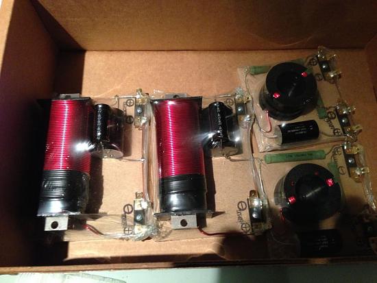

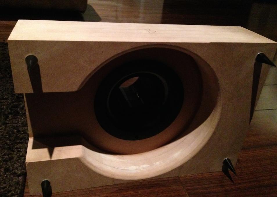

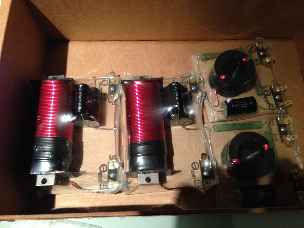

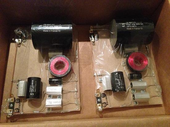

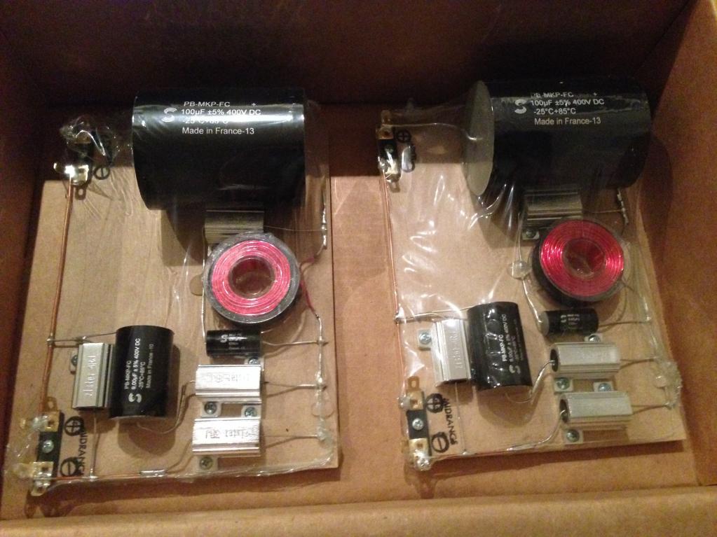

                  Today the crossovers arrived from Meniscuc Audio - they look great, a really professional job! whats your preference for wire to connect them to the speakers. 16 gauge?

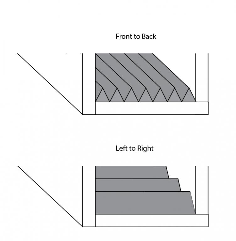

                      Yes. A 12 pack of 12" x 12" is more than enough with some left over for the next project. It's cost effective too.
                      • bostonmurf
                        • Jul 2014
                        • 170

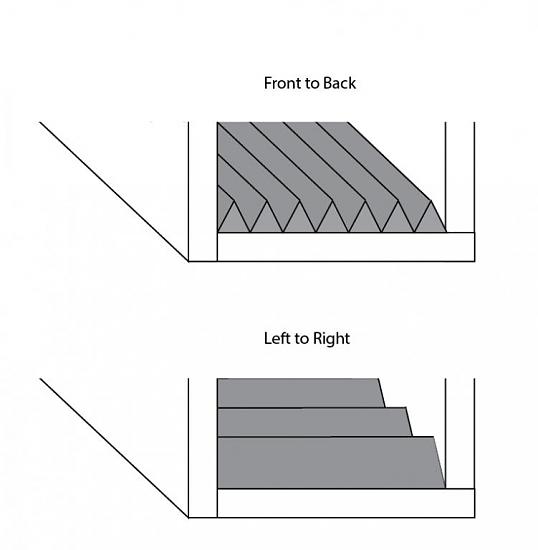

                        awesome, thanks Jim what foam would you recommend for the mid range tunnels?
                        I don't know if it'll be any use to anyone but I'm just starting to glue the shelving in, and with the help of the plans I've just highlighted the shelving positions measured form the top.
Name:	st shelves.jpg
                        Last edited by theSven; 30 April 2023, 16:13 Sunday. Reason: Update image location
                          The Foam Factory doesn't have 1" flat foam anymore or I just can't find it. I'd suggest you go to a hobby store and look for 1" flat foam in their upholstery section. You need open cell foam that you can blow through. 1" to 1 1/2" eggcrate foam would also work. 1" wedge would work too. I prefer flat but if you can't easily find it, look for an alternative. The mid tunnel foam allows you to fine tune the speaker to your room so it's flexible.
                          • bostonmurf
                            • Jul 2014
                            • 170
                            Thanks again Jim, I'll see if i can hunt some down. If I do go with the 1 in wedge should I cut it with the wedge groove running front to back or left to right.
                              I'd do left to right. It'll work better that way, I think.

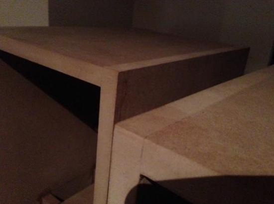

                                  originally i was thinking of just going with a matt black textured look, i know spraying MDF can be a pain but it would be cost effective and i really wanted to make the speakers sit back and not be the focal point visually as there mainly to be used as a home theater setup in my basement. However.... now ive started to build them i think i want them to stand out and am considering a burl veneer, thats going to be a whole project on its own
                                  Actually heres a question. if i do go the veneer route will i still be able to round off the front vertical edges?
                                  • kevinm
                                    • Jun 2013
                                    • 417
                                    You can, but it has to be a very large round over...something in the 1/2in range. I've seen others do it...but have no experience myself.

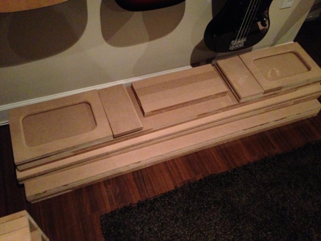

                                      progress!! managed to get a few things glued this week. did a little every night after work and took my time to make sure everything is accurate. the $4 rafter square from home depot is my new best friend

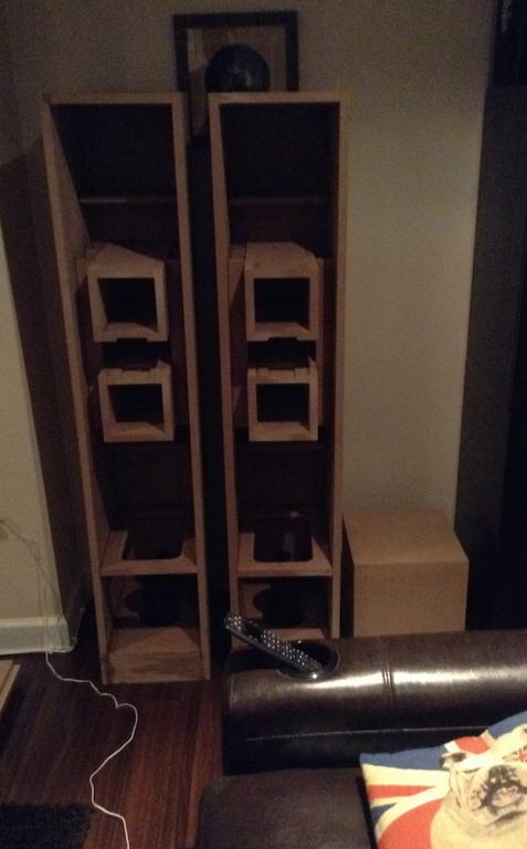

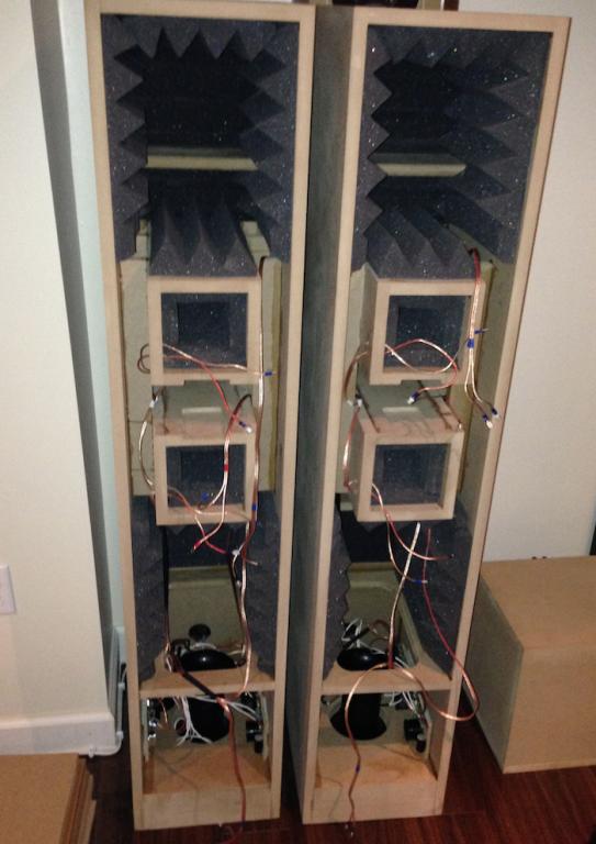

                                              cabinets have been glued and are upright. they are seriously starting to get heavy! the plan for this weekend is to sand them both smooth and then start glueing the front 3/4 and 1/2 sheets ready to start making the holes for the woofers and tweeters the following weekend. foam has been ordered so ill probably glue that in place during the week. any advice on spray glue for the foam? I'm planning on buying this http://www.amazon.com/3M-Super-Multi...=3m+spray+glue

                                                The cabinets are coming along nicely. I use the standard 3M #77 available locally at Home Depot, Lowes, Menards etc. for under $12. It's really stick stuff and holds the foam securely.
                                                You'll be listening to music soon!

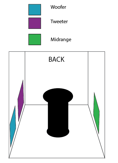

                                                  as I'm about to cut the fronts the plan was to round the 2 vertical sides but I'm still in 2 minds due to the veneer. would it make any different to the sound if i keep the corners flat, i really don't want to bevel them?
                                                    Originally posted by bostonmurf
                                                    thanks Jim.
                                                    Square vs rounded front baffle edges are measurable. Is it audible? I can't hear the difference. That's one change I won't worry about.

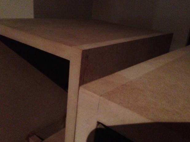

                                                        Well our Labor Day consisted of sun, rain and a tornado warning...plus a trip it ER on Friday night. Still managed to get some work done though, main boxes finished and sanded down. Both pass through cut out and front 3/4 and 1/2 glued ready to start cutting out for the speakers. Any advice before i start routing the circles? how deep should i make the outer circles to flush mount? looks like a 1/4 inch form the plans.

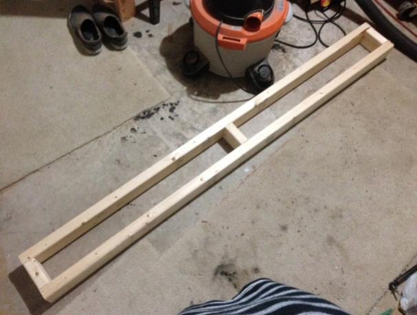

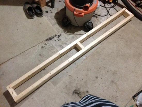

                                                        Also knocked up a quick $6 frame to help raise the speaker cabinet so i can clamp it easily and keep it level.

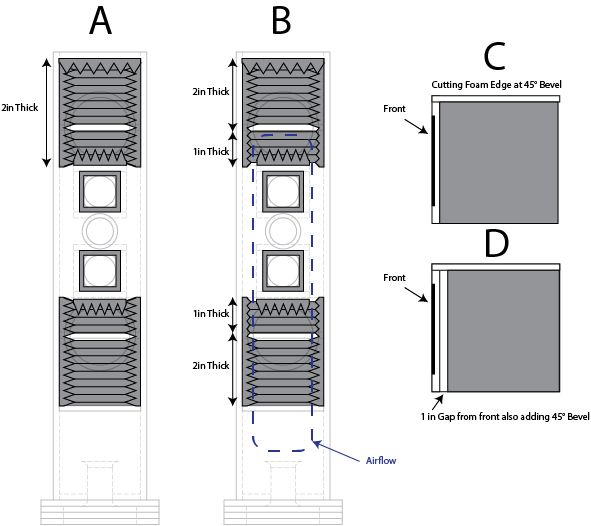

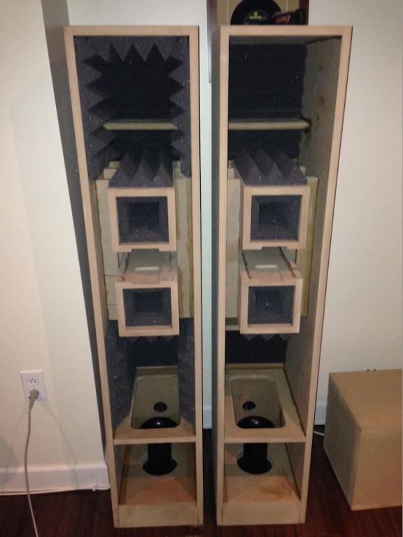

                                                                      Another question I'm afraid! when i add the foam how should i place it. if you look at diagram A and B is that all the area i need to cover with foam?
                                                                      I've seen a few different ideas where the foam should be placed so I'm wondering which is the most effective in the follow ideas.
                                                                      In diagram A I'm using 2 in wedge foam everywhere (except the pass through which are 1in foam).
                                                                      In diagram B I'm using 2 in everywhere except for the area between the braces and the midrange which is 1in wedge foam on the sides only, back is still 2in (pass throughs again are 1in foam).
                                                                      Do i need to go with the B option as it lets air pass down and up the sides of the pass through?
                                                                      on C should i run the foam right up to the front with a 45° bevel or as in D keep it back about an inch also with the 45° bevel.
                                                                      many thanks in advance, you guys are the best!

                                                                      • kevinm
                                                                        • Jun 2013
                                                                        • 417
                                                                        As you saw from my pictures, I run things a bit hot and definitely listen louder than some cats. I usually watch movies with everything being pushed fairly hard. With that in mind, I thought the original statement CC didn't have the oomph when running the system at 80-90%. With movies utilizing the center channel so much, I always felt that I could convince myself building a center like the 2RCC (or Statement 2.0 Center) would be advantageous because of the improved power handling and presence.
                                                                        Now all to his isn't to say that the original center is weak by any means. Four watching tv and your average movie, I never complain. But when you put on Battleship and shake house foundation, I can imagine a little more. :W
                                                                        Also, regarding your foam question.....I used fiberglass so I'm not an expert, but I think A and C are good. If I remember correctly, it's just foam behind the woofer chambers (saying is use "foam everywhere the woofer can 'see'")
                                                                          I'd suggest A (trimmed for airflow) and D. I hold back a couple inches from the back of the woofers for clearance.
                                                                          The center is up to you. The original Statements center is open back and needs room for the back-wave to reflect and blend with the front sound wave. If you're going to push them hard on movies, I'd suggest the Frodaddy center documented here on HT Guide. It'll handle more abuse.
                                                                          I was at the Meniscus DIY event in Grand Rapids since last Thursday so I've been out of the loop for awhile. It was great fun!

                                                                            thanks guys, well this weekend was mixed. got the foam installed for one of the speakers but ran out due to some practice cuts so waiting on a delivery this week to complete. thank god for the electric carving knife although it did make me very hungry for turkey (thanksgivings around the corner!). Saturday not so good. cut out the speaker holes but forgot to add 1/16 extra for the fit. everything is a bit tight and i had a couple of slips with the router so in the end i ran over to HD and got some more MDF. if i didn't i know it would bug the hell out of me. That's next weekends project, get the fronts done and sort the wiring out. i figure about 3 more weekends and ill be done, Sundays get taken up with house hunting.
Name:	Screen Shot 2014-09-07 at 10.28.49 PM.jpg
                                                                            Last edited by theSven; 30 April 2023, 16:15 Sunday. Reason: Update image location

                                                                              Hi again
                                                                              I'm about to mount the crossovers in the cabinet. how does this diagram look? do you think i would get any interference placing one crossover next to the other, I'm going to keep them as far apart as possible. are there any other things to watch out for?
                                                                              thanks
Name:	Screen Shot 2014-09-09 at 10.39.02 PM.png
                                                                              Last edited by theSven; 30 April 2023, 16:16 Sunday. Reason: Update image location
                                                                                Hi again
                                                                                thanks
                                                                                It looks perfect to me. I usually build all three circuits on one board.
                                                                                • bostonmurf
                                                                                  • Jul 2014
                                                                                  • 170
                                                                                  thanks Jim, i got the crossovers pre-built from Meniscus Audio (really nice job) and there in 3 pieces. i think for the next build I'm going to give it a go myself but figured for this i had enough to tackle as a newbie
                                                                                  Im already thinking about my next build before I've finished this... i think I've caught the bug!!

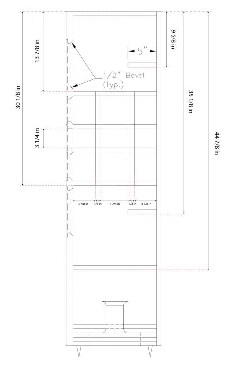

                                                                                    Hi again, so I'm getting ready to bevel the fronts around the mids and woofers. unfortunately im stuck with a 1/4" collet router so im limited to router bit sizes. i have a 45° bit, not sure how deep it is but ill check later (it came in this set http://www.harborfreight.com/12-piec...its-46832.html). are there any dos and donts for the beveling process? how deep does the bevel have to be? if need be i could rent a 1/2" collect router.
                                                                                    thanks in advance.
                                                                                      thanks in advance.
                                                                                      I can't give you exact depths to bevel. I do it by eye. I usually camfer or 3/4" round over the back of the mid front baffle as it exits into the tunnel so that the screws have as much material as possible but the rest are tapered back to eliminate any tunneling effect from the back of the driver. There are a lot of great picture examples in the various builds here.

                                                                                        thanks Jim, yes i figured 1/2 wouldn't be enough. I'm going to get a 1/2 collet fixed router, i can use it later with a router table too. ill get a 3/4 round over and use that on the mids and woofers, from what i see the ribbons don't need beveling? anyway here's some new pics. wiring complete and new fronts cut out. decided to cut out the 3/4 first then glue and router out to finish, for me it was easier to cut and if i made an error on the circles I'm only doing it to one piece of wood. slowly getting there!
Name:	Screen Shot 2014-09-18 at 9.05.39 AM.jpg
Name:	Screen Shot 2014-09-18 at 9.05.30 AM.jpg

                                                                                          Correct on not beveling the tweeter hole.
                                                                                          Looking good!
