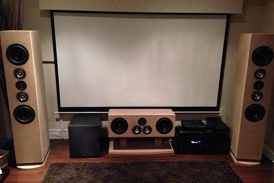

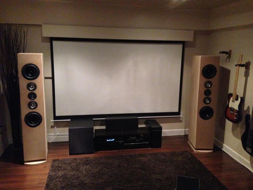

              Job Done
              letting them burn in this week before i do a proper sound evaluation. i think i need a bigger screen!
              Last edited by theSven; 30 April 2023, 16:17 Sunday. Reason: Update image location
                Excellent! I am envious of that screen.

                  Sam here! Definitely worthy of Statement power.
                  Just an FYI, I have guitars in my room too, the Statements sometimes cause them to resonate when playing loudly

                    thanks gents! yes the screen is 100 inch but the initial cost of setting up the cinema room was only about 1600. it was spare of the moment thing, i was pricing up a 55inch tv at 1500 and thought how much would a projector cost and would it be good enough. so i bought a cheapish view sonic projector ($800) thats has been AMAZING, even with some light in the room - and a cheap roller screen for $150. topped it off with a sony sound bar for cost issues and finally a couple of reclining cinema chairs for a total of 1600. even without the 5.1 surround it was great and always impressed visitors. upgraded to 5.1 with BIC America speakers about a year ago and now I'm going the DIY route. the screen and projector will last till i go the 4k route in a few years when prices have dropped.
                    had to move the acoustic guitar and im planning where the others are going to live. also moved my wifes keyboard to make space on the left hand side, something im quietly happy about at it always looked like a silent movie theatre with the piano at the side of the stage and the villain tying a woman to train tracks
                    so, center speaker next project.

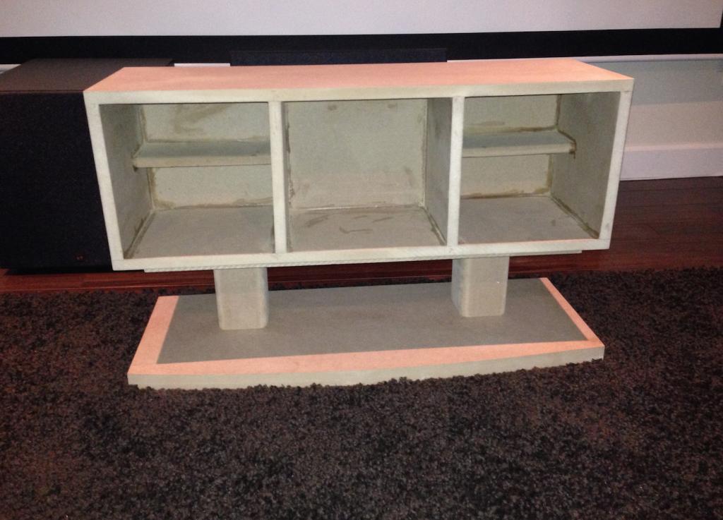

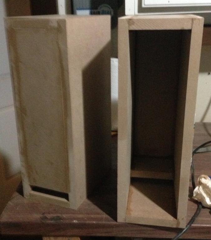

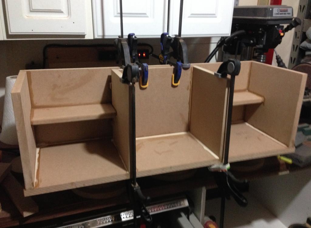

                                  Statement Center Channel
                                  So with the long weekend and my wife off to Montreal to see family its time to get stuck into the center channel. After a lot of emails back and fourth with Jim (thank you so much for your time Jim) I'm building the Statement 2 center speaker with the W4-1337 SD's. I wanted them to match my full tower Statement so I'm using the Crossovers from Jed and Frodaddy's 2RCC. Rained all day Saturday so i could only do a little work, got a bit more done on Sunday - waiting for glue to dry so i can add the top. Just using wood left over to build everything then when I have the cash ill drop in the drivers.

                                    May I ask what order you glued stuff together? I had to clamp mine into submission, so Im betting there is a better sequence than mine.
                                    • bostonmurf
                                      • Jul 2014
                                      • 170
                                      Hi Kevin, I did things a little different this time and basically cut a piece then glued it, while it was drying cut some more pieces then glued them. It made it easier to make sure everything fit perfect. I glued each part with about an hour in between each clamping in this order
                                      I started with the back and added the sides,
                                      then 4in braces and the mid chamber braces
                                      then added the base and built the mid chamber separately
                                      added the mid chamber
                                      added the top
                                      the pic is a little deceiving, i had to use a lot of clamps on the top and bottom and the wet looking glue was added after the parts had dried purely to add extra sealing to the joints.
                                      hows your veneering coming along? I'm interested to see how it turns our as I'm going for the same look on mine.

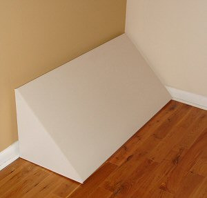

                                            My thoughts exactly. The GF won't like it in the house, but that's we ask for forgiveness before permission.
                                            I am thinking that I will do floor to ceiling with R30. I've read a lot about them and no one seems to provide any real concrete evidence comparing rigid fiberglass (OC703, Rockwool, Safe n Sound) vs the pink fluffy stuff that's actually apples to apples. So far, it looks like 10-12 inches of pink fluffy with an air gap in the corner is really effective. I'm after the GIK Tri-Trap design so they will be stackable. 2 per corner.
                                            As for surrounds, I was using a pair of Noobsters, but have since taken them out because my room configuration made them really awkward. Couch is really close to one wall and open to a walk way next to the other end. So it forced the surrounds to be right up to the couch - which meant you were only a foot or two away from the speaker. Aesthetically, I had an OCD moment and decided to just stick with the ceiling speakers that came with the house. The sound was great with them, but I didn't think it worked well enough to overcome how intrusive they were.

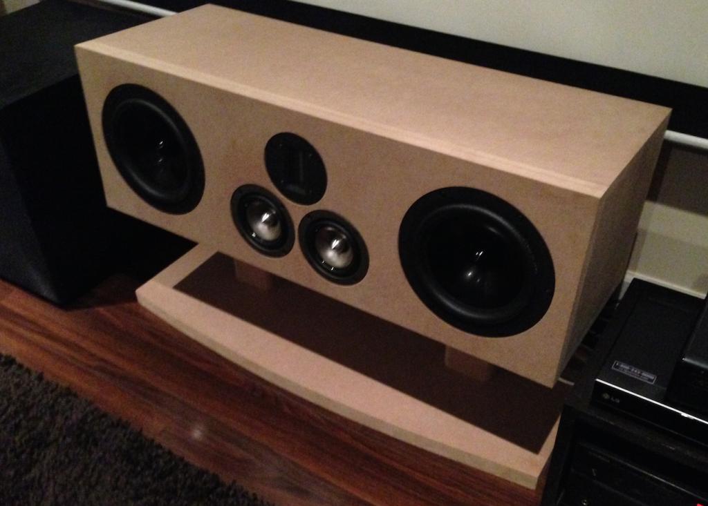

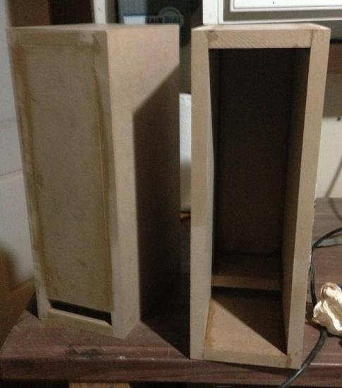

                                              did a little more this weekend, flush trimmed the cabinet and used some left over MDF to make the stand. Really happy with it!
                                              Oh and just and extra little treat to myself, a room wouldn't be complete without something that lets everyone know in a nice way where my HT throne is

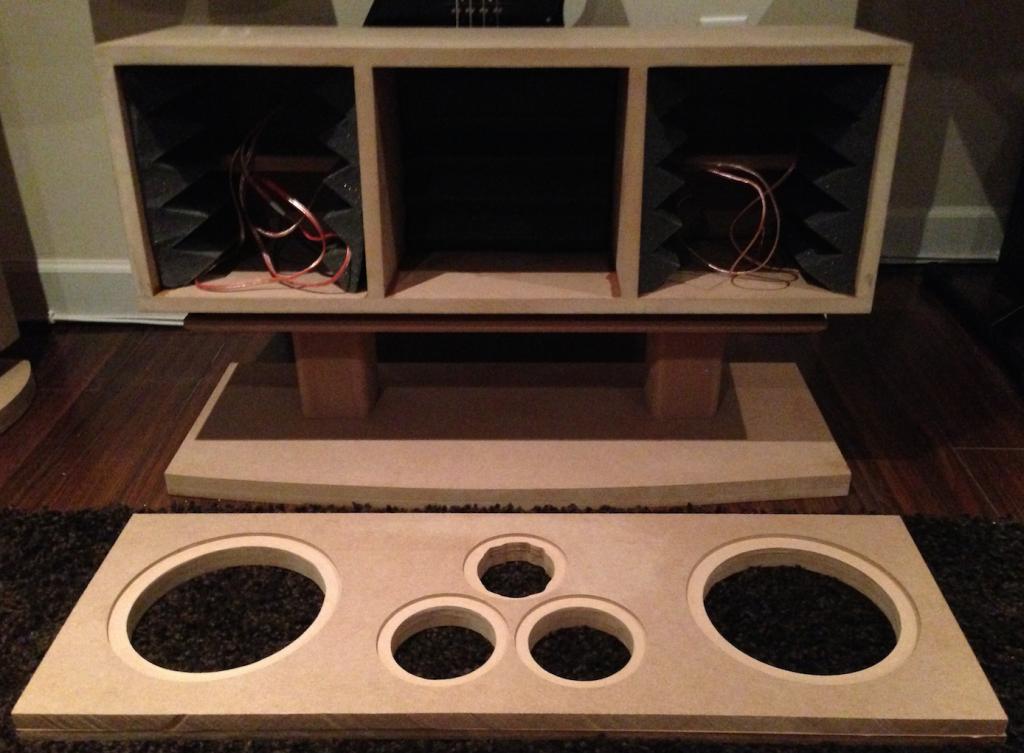

                                                some more progress. front baffles are done, wiring is ready for the crossovers. foam is cut and ready to glue. decided not to angle the stand and instead install 4 grommets for spikes but just use the from ones for now. that way when i do move house i can angle it to suit the room.

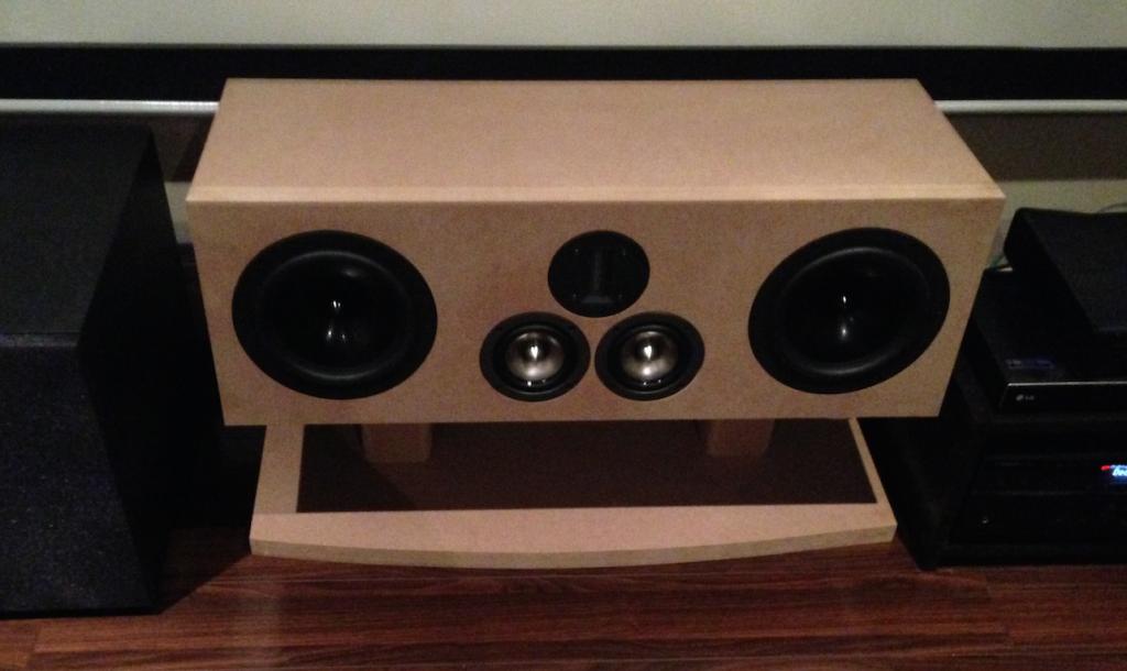

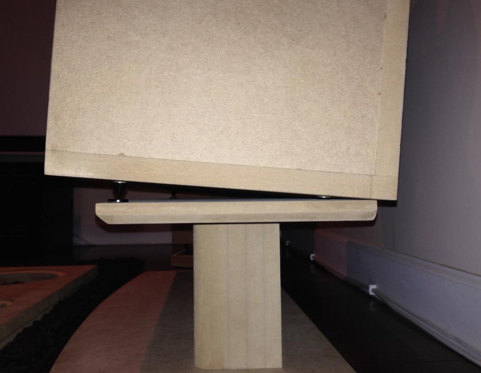

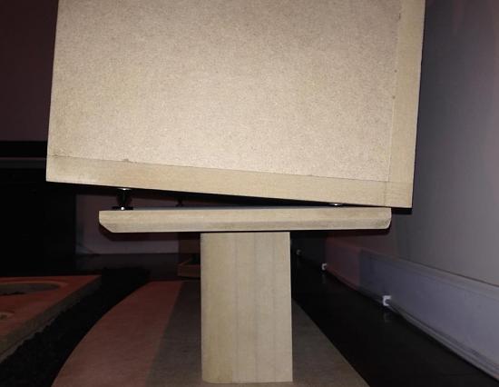

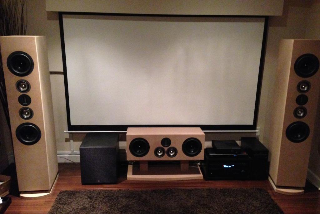

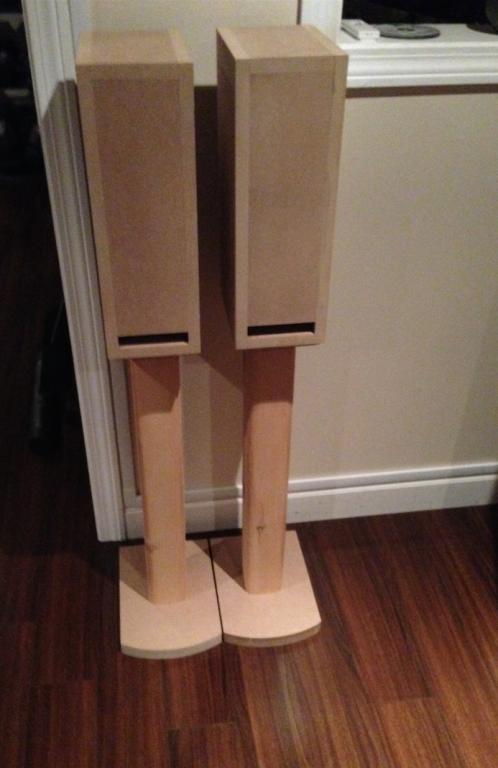

                                                          more progress! so the cabinet and stand is done, sanded and speakers installed. just need to do the crossovers which is next weekends project. really pleased how its turned out!

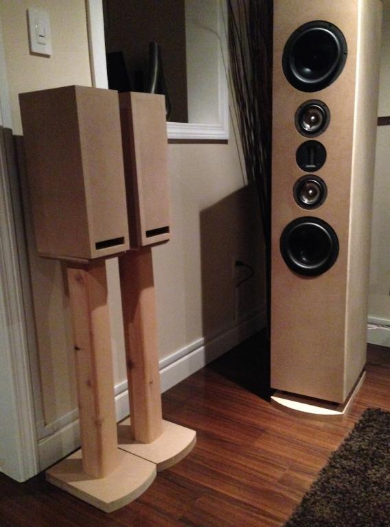

                                                          ok so question time again - I'm getting near to building some surrounds and wanted something to keep in the statement family. I don't want to spend a ton of cash to build something that I'm not going to benefit from and i do need them to be close wall mounted. I've come across Jeds R4 which seem very interesting. Now, do you think this would be a good fit for my 5.1 set up (and possibly in the future build an additional 2 and go 7.1), i really don't want a weak link in the HT setup now after all the effort I've put in but as they are to be used as rears i wondered if they would be a good match to complete my setup. sub will be built later next year but i do have one that runs fine in the meantime.
                                                          just adding this to my thought on the towers now they have settled in.
                                                          EDIT: I've been running the towers for about 40 hours now and i thought it was only fair to review them again. WOW!!! they are amazing! they have got so good I'm uterly shocked at how good they are now. they were very good at first but now there at a different level. when you play something thats a very good recording through them the sound is unreal. I'm just using airplay on my amp with an amazon prime music app and tried a variety of music and all are incredible. its funny but i was playing Heaven Can Wait by Meatloaf just relaxing with my daughter - it seriously felt (and I'm not exaggerating here) they he was in the room with us. if your on the fence about making them trust me, its the best project I've ever done.
                                                            I used the R44's back when I had surround system, and they matched the statements quite well within in there limitations i.e. no bass. I believe they are some that use the F4 as surrounds as you don't necessarily need the upper frequency range.

                                                              thanks John, thats good to know the R44s match. im considering R4's purely as a cost alternative for now. i was thinking of going R4's then when i upgrade to 7.1 build 2 R44's for the sides and put the R4's at the back. originally i was going to build the monitors but it just seems its not going to make much difference sound wise as im only using them as surrounds, the klipsch im using a the moment are cheap and do a great job pulling the sound back there. the r4's sound like there a nice upgrade and by using the same mid/tweeter should fit right in.
                                                              am i right in my assumption that the monitors would be an unnecessary/build expense just for surrounds or would they make a big difference in the overall experience? just curious to see what everyone thinks.
                                                              • bigjohn
                                                                • Dec 2010
                                                                • 61
                                                                I think the R4's will do an excellent job as surrounds, and provide a nice consistent sound all around. My personal plan is that when I build a new house on my property, hopefully in the next 3-5 years, I want to do a full size statement surround system, I know it's total over kill, but I have most of the drivers, and it'll be fun.

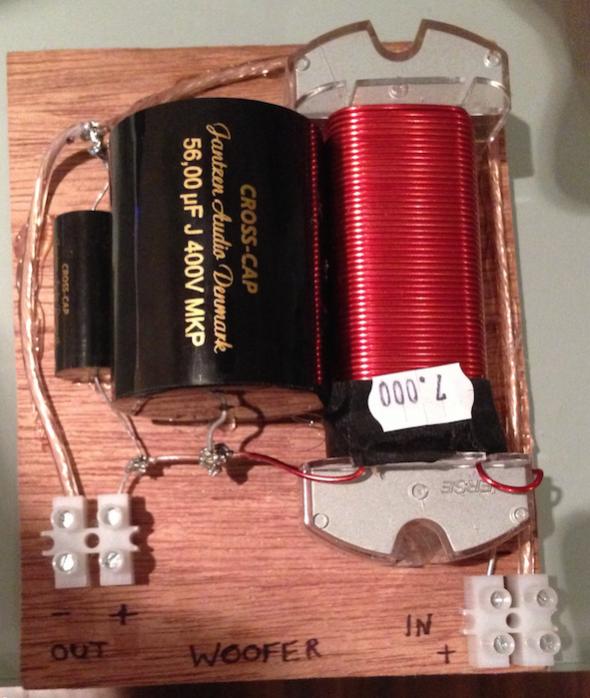

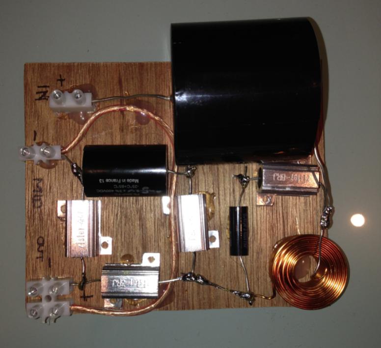

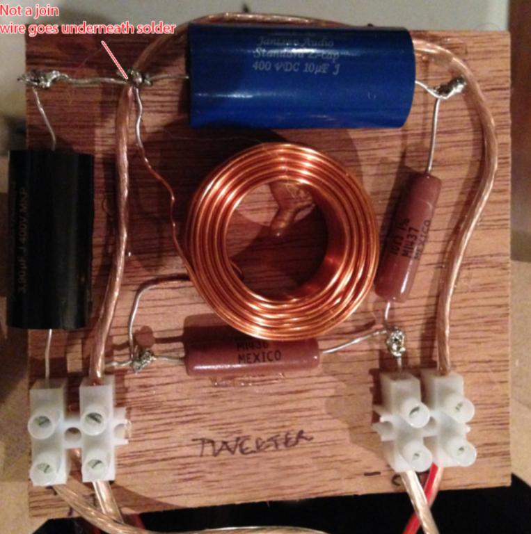

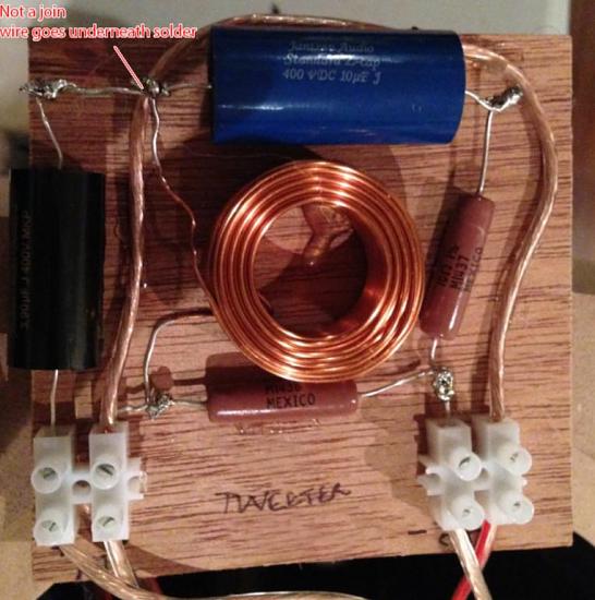

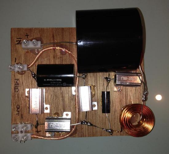

                                                                    First crossover made for the woofer. I'm doing the woofer, tweeter and midrange in 3 parts
                                                                    My first time soldering so not as neat as i would have hoped but it does appear to be ok. Please let me know your thoughts, does it look ok?

                                                                        Hi Darren.
                                                                        Your solder joints look shinny & clean.
                                                                        That is always a good thing.
                                                                        Remember that good mechanical contact between the leads/wire is the first requirement for a good joint.

                                                                          thanks Guys! So I'm all finished! soldering started to get easier to the end, I'm glad i built the XO's myself now
                                                                          ... and the sound? unbelievable! so glad i chose the statements, R4s next
                                                                          • bostonmurf
                                                                            • Jul 2014
                                                                            • 170
                                                                            first crossovers. not the best to look at but they sound great!

                                                                              Hey, those are nothing to be embarrassed about - first try or not. They're clean and logical. Excellent work!

                                                                                Thanks Kevin, they were more fun to make than i thought they would be
                                                                                sound wise there incredible, they really blow me away. I pulled the towers another 3 in from the wall and added a little stretched out acoustafill behind the tower woofers (around the brace) and a tiny bit in the mid chambers. its really helped a lot with the sound in this echoey room.
                                                                                played some Ray Charles yesterday morning, thats when these shine. the piano sounds beautiful. not played a movie through the center yet but i tried it instead of one of the towers and it was just as amazing, even better than i had hoped. incredibly clean and bright and still keeping a really nice bass.
                                                                                BTY a massive thanks to you for doing the cad drawings on the center channel, they were a huge help in building this and i would have seriously struggled without them.
                                                                                Also huge thanks go to Jim, you are the best - you've given me so much help over this project i can't thank you enough. you and Curtis have created something truly incredible in the statements - something i never thought id ever be able to afford and now there sat in my HT room.
                                                                                thanks also to Jed and frodaddy for the initial 2RCC post. another massive help, the crossover diagrams were a big help in convincing me to build them myself
                                                                                thank you all so much for your encouragement and help. i can't wait to start the surrounds!!!!

                                                                                  Monday off so work started on the R44's. Decided on the R44's instead of the R4's, I figured for another 65 per speaker its worth it in the long run and I'd only regret not doing it.
                                                                                  So the plan is to build the cabinets and add the crossovers to the back piece before gluing it on. ill use the drivers from the center to test it out, then if I like the sound ill buy the drivers - if not I'm only out of pocket the crossovers which I'm sure I can use some of the parts at a later date. I've got some walnut veneer so this gives me a great opportunity to try my hand at finishing.

                                                                                          • bostonmurf
                                                                                            • Jul 2014
                                                                                            • 170
                                                                                            Just a bit of progress this weekend due to a terrible case of man flu.
                                                                                            Built the stands. Found a nice off-cut of hickory for the posts in Home Depot, the rest is MDF. The goal is to get them the same height as the mids/ribbon in the tower. Sanded the cabinets ready for hole cutting hopefully this weekend.
                                                                                            Slow and steady wins the race....
