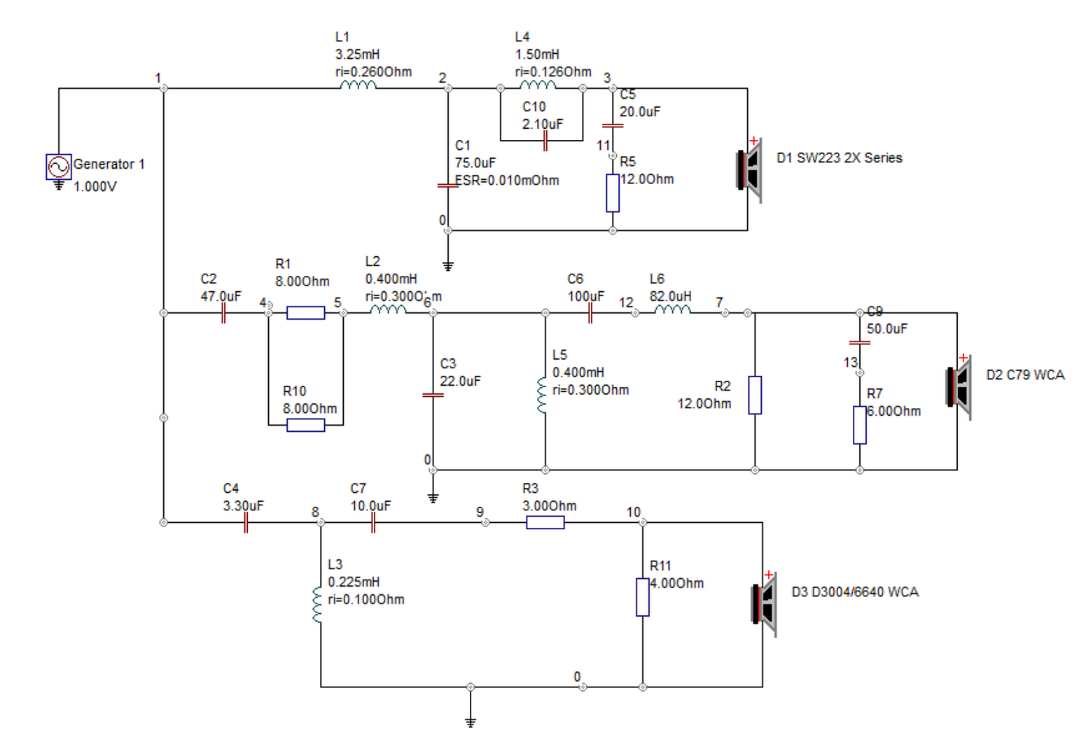

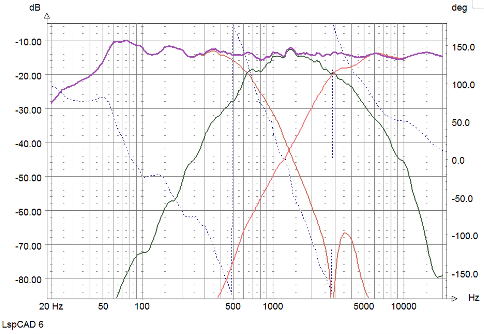

        Still more OCD...
        Ordered some more caps for testing... with regards to tweeter voicing.
        I usually seek to do a slight bump up in the response in the crossover region of an LR style crossover on axis, to compensate for what is otherwise a slight power response dip through the crossover region, but with the dispersion of these drivers, and considering the frequency region of the mid to HF crossover, maybe that's not the way to go.
        So reviewing things a bit at lunchtime in LspCAD, I determined that dropping the value of C4 from 4 uF to 3.3 uF will give us a very smooth on axis response- in this area, this may give the system a more polite presentation, which may be a plus with a lot of electronics.
        though not captured and shown here, reverse null is still very good.
        Anyway, more caps on order, and measurements and listening tests will be the order of the day before settling these values.
        I think this is getting pretty close. I probably shouldn't really be doing this phase in public, makes me look like I can't make up my mind, but frankly, this is how the process goes for me- a fair amount of perspiration to make up for only a modicum of inspiration! :W

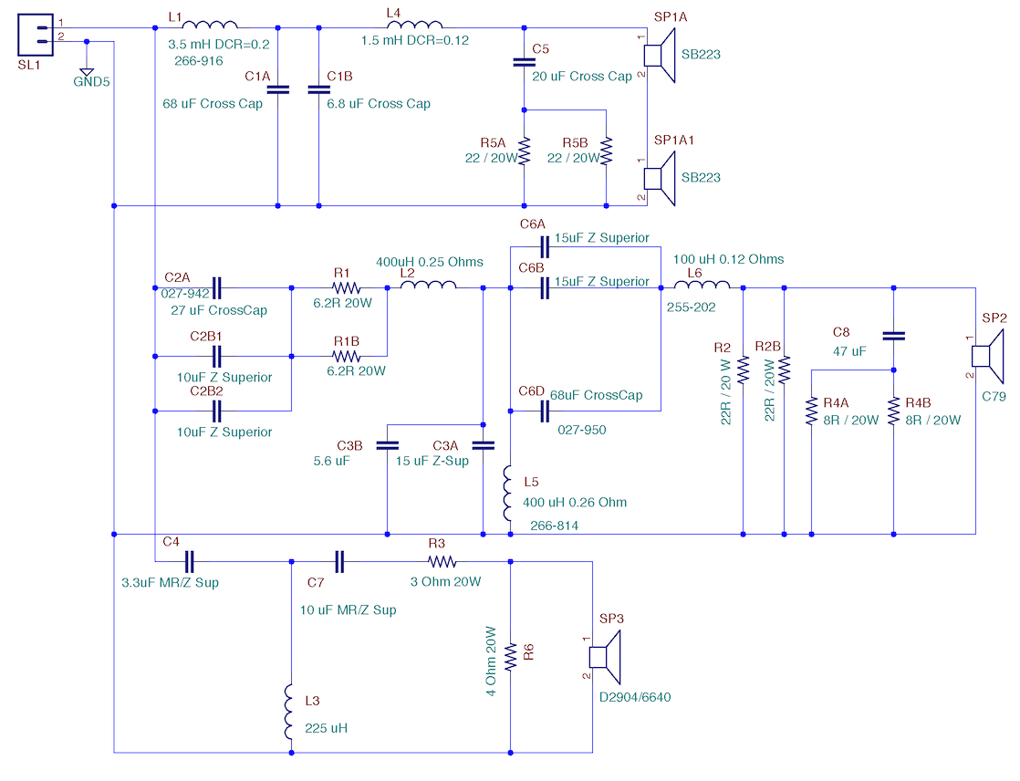

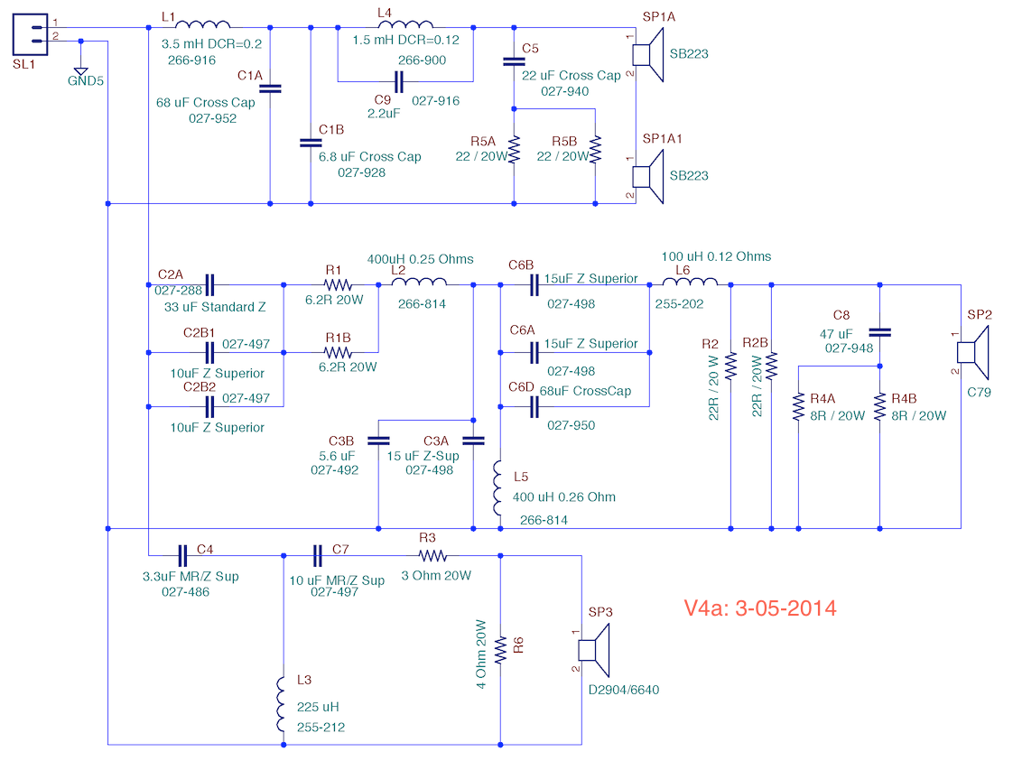

                Rev 4 "Official Build Schematic" which is by no means finalized, but likely fairly close... (i.e., if I get run over by a bus on the way home, use this for your own build...) :W
                Some midrange inductors and other parts ordered today. This should start to give a clear idea of the end target price wise, which can be sort of reasonable... a balance of nice parts and fairly good parts where fairly good gets the job done OK.

                    I tried to configure the crossover cap selections for compactness, but you could probably go further with different midrange caps- I'm paralleling a couple of premium caps with a more standard grade. On the tweeter, try to go for the good stuff; however, the MR's are huge, and the Jantzen Superior Z are smaller and also have anti-resonant construction. I did get some of the MR's on sale for the newest Isiris tweak.
                    Costing out from this should make a reasonable estimate.
                    Oops! Just noticed I left out the 2.2 uF cap in parallel with L4 on the system schematic- will have to update that tomorrow!

                          OK, updated the schematic, adding in C9 and updating PE parts numbers where suitable for possible component choices.
                          This is at a level of detail sufficient for preparing the BOM directly, for the most part, so with luck I'll find some time at lunch today or tomorrow to update that. I estimate the cost will be quite a bit more reasonable than the Isiris, as well one would hope.
                          Now soon I'm going to be doing some head scratching to see how best to package this into the enclosure. Given how the bracing is arranged, if it goes completely internal, I think it will have to be split up into three boards.
                          OTOH, I'm thinking a little outside the box, so to speak, and pondering the idea of making a new, taller base, tall enough to have a hollow part inside with a single crossover board. One ring, er, board, to rule them all. This could have two or more advantages- easier future updates or mods, a single more compact board with fewer connectors, and not using internal enclosure volume.
                          Whaddya think, guys? Do we have a show of hands? (you might be able to tell I'm not really used to this collaboration thing, having a personal working project style more aligned with Evil Twin than a corporate team player...) It would make the base design more complex, but could even use the existing base as a template to layer up the rest- in fact, that could be just a hardwood strip around the rim... have to look at this closely on Saturday. But I think its an idea worth pursuing... I'll give it some more thought.

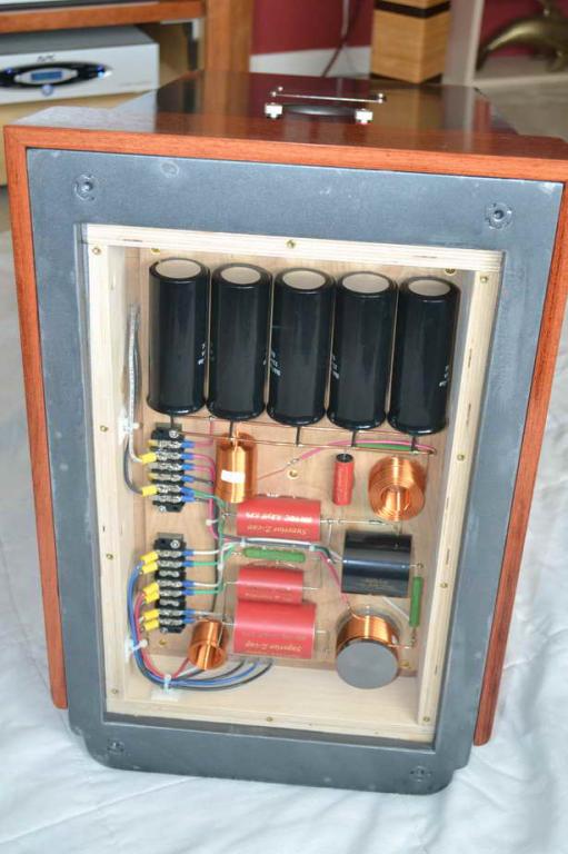

                                  Next question is wether 1-1/2" is enough internal component height, depending on the component sizes and layout.
                                  Jon .... I would think that an 1 1/2" would be a little shallow. The crossover compartment in my 1071's is 2 1/2" deep and believe the caps you are using are larger than what I have in mine.
                                  Steve
                                            Steve
                                            [ATTACH=CONFIG]23008[/ATTACH]
                                            That's really clean, well done.
                                            The BB the bases are made of are 2-1/8" but there should be 4" of clearance under the bracing. A combination of 1" pocket(could use a router or better yet throw it on a manual mill) in the bases and stacking in the footprint should work but I don't have the parts infront of me so that's mostly guessing.
                                                  Thanks benthe8track ........ Steve

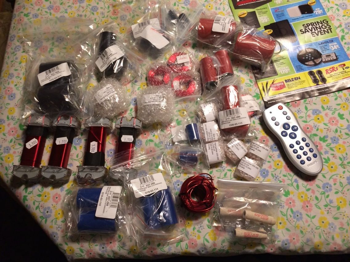

                                                          Scheduled Deliveries...
                                                          Well, my shipping timing worked out!
                                                          This isn't everything, have some other parts at home to pickup Saturday AM, but it's a lot less intimidating space wise than the Isiris parts dump!
                                                          But chuck this into a storage bin and there's more weight than you might expect...
                                                          Anyway, off tomorrow to the Livermore location to pick up parts and complete some other tasks, then back here for the cabinets. Also got a little bit of trim patch epoxy work done this evening. It's been a long week...
                                                          tomorrow having dinner with daughter and her fiancé with my GF - to celebrate their engagement- looking forward to that.

                                                              A few notes relative to the schematic above- I've turned the 68uF C6D into a 47 uf + 22 uF; C3 is now a Superior standard 22 uF, single cap.

                                                                Well I know I would get dizzy trying to follow the schematic and solder that correctly but I'm not a "sparks and wire guru" like you. Great progress.:T
                                                                I think I'm following the 2 or 3 board path. I'm still in a holding pattern waiting for the exchanged veneer to arrive so I'll just live vicariously through you for a while.:rofl:

                                                                        I did get some phenolic board on order from my favorite eBay supplier for the crossover bases and for the cover/cap for the base assembly (which is actually towards the bottom, i.e., floor). And found maple 1x4 *(actually 0.75 x 3.5" of course) at my San Ramon Home Depot for the outside shell of the new bases; will have to bring my DeWalt DWS780 over to GF's sometime this week, too.
