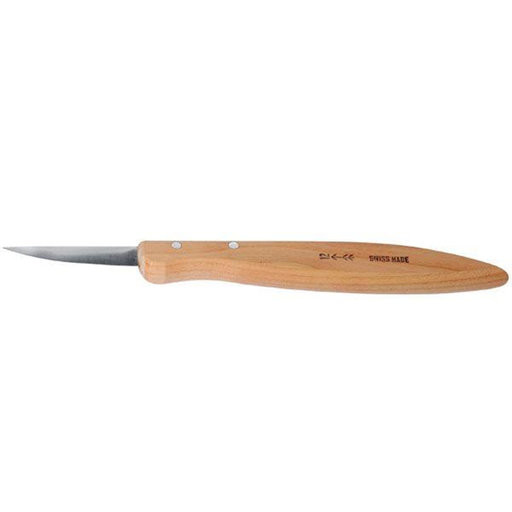

          I use a pfeil Swiss made Primetime A/V Sweep Roughing Knife for cutting and trimming veneer -

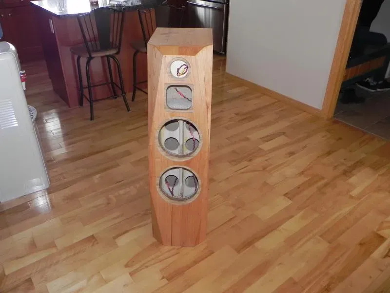

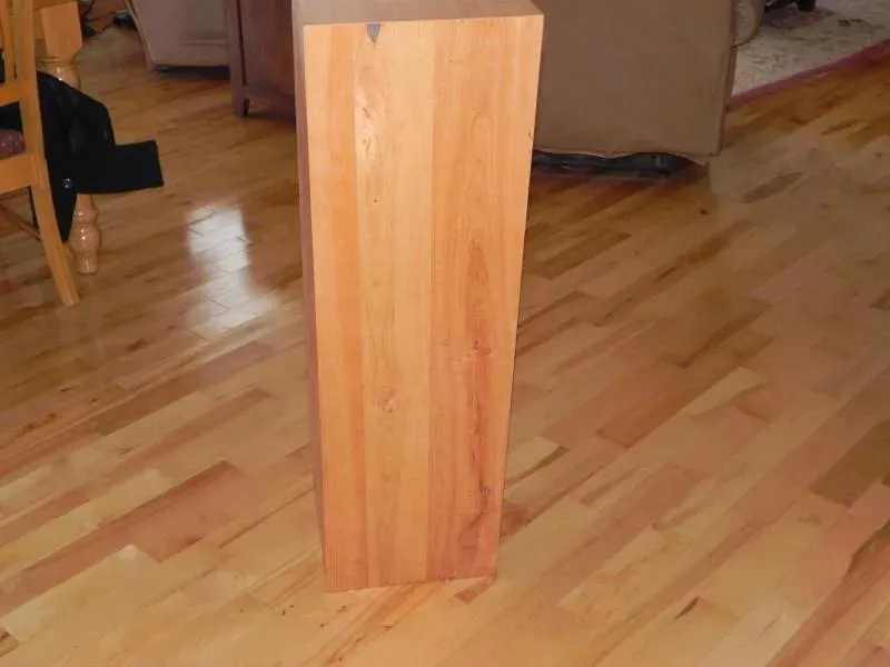

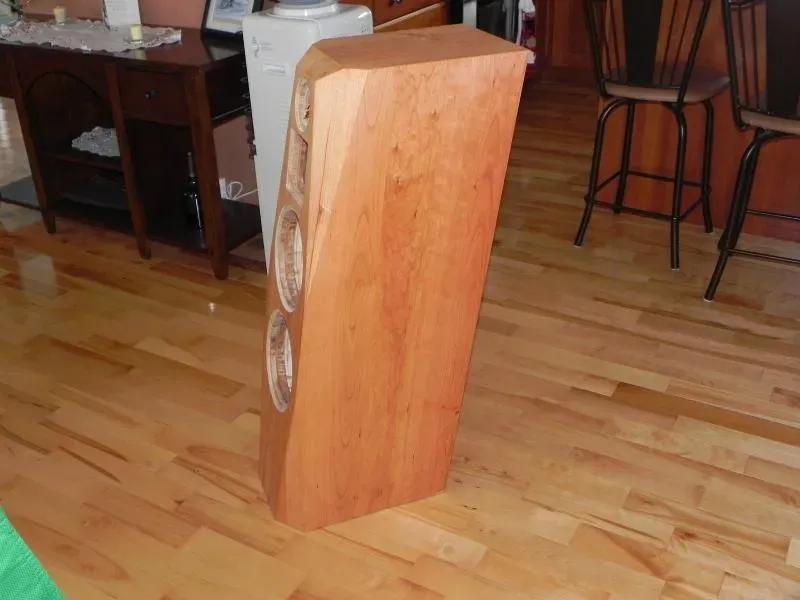

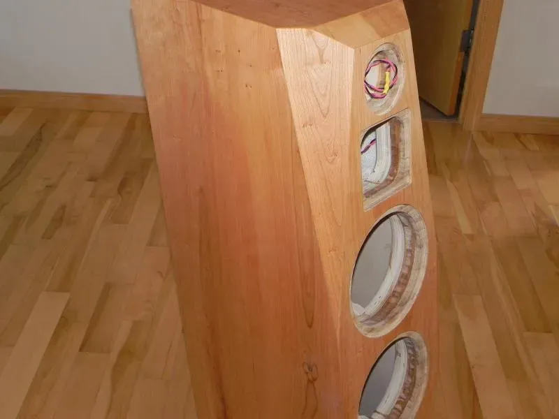

                      #415
                      I had a productive weekend, received the replacement veneer on Friday. I was able to move quite fast trimming the veneer on all the angles with my freshly tuned and sharpened small block plain, made for vary little sanding.
                      Here some pics just after a coat of natural stain which is just linseed oil and solvent. If Ben's finish price is to much I'll start with sanding sealer and then the poly after letting the stain dry completely.

                        #416
                        Very nice indeed... Good work!

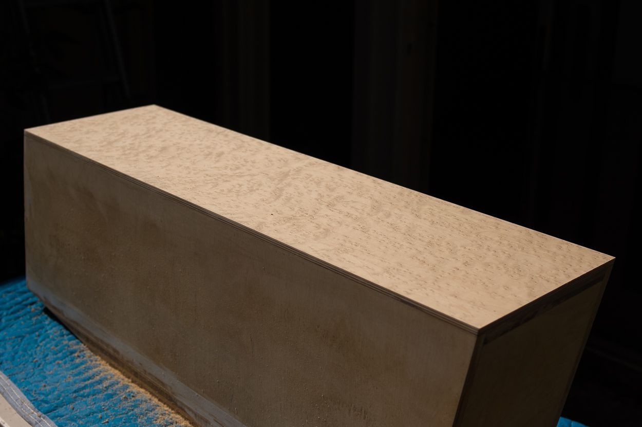

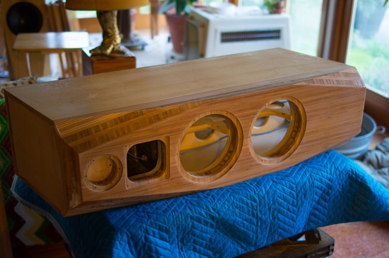

                            I just finished a second short round of epoxy cabinet touch up, then got the sanding done on that.

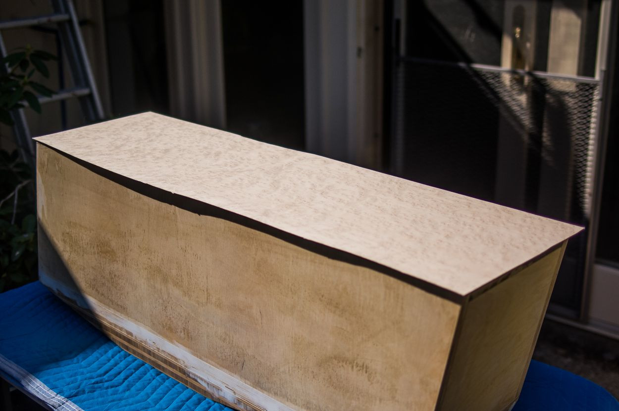

                            I went through my veneer, from the available grain figured laid out a cutting plan and cut out all the rough sized pieces and just barely got started...
                            Got the back put on the one cabinet with finished epoxy base coat (remember, the other is for driver test data until the crossover design is finalized)
                            and did my trim work with my swiss knife and two of my Bosch Colt routers, one setup with an angle plate- finish edge sand with the orbital sander, still with 120 grit Mirka.
                            I also got the front veneer piece attached, and ready to trim, but figured to let it sit up until tomorrow evening (if I have any energy after getting to GF's at 9) or more likely, until next weekend. At least, it seems my process is working OK, and I've got some veneer pieces sorted for reasonable figuring for all the important parts. I'm patting myself on the back for buying two 4' x 8' sheets, because the quality was inconsistent on one sheet, and I had to use a different orientation for cutting out parts than Ben did.
                            By next weekend I should have the balance of crossover parts and the additional phenolic parts on hand- the only thing lacking will be more time off! At least I won't be running around half the day Saturday doing errands...

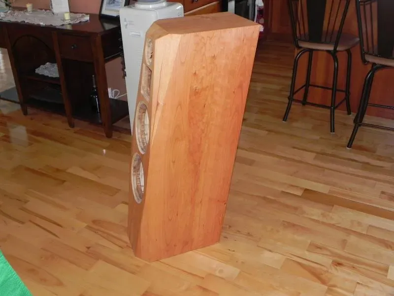

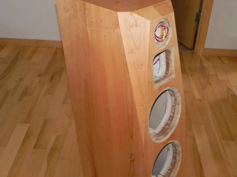

                              I've always been a sucker for some nice looking cherry veneer. I've done a few pairs in some surplus I bought for cheap on ebay years ago and I am always pleased with how nice they look.
                              A few of you are investing quite a lot in these speakers and one thing that's nice is that if you're not quite happy with the way they sound, Jon can always offer advice on how to alter the tuning to match your tastes - one of the big advantages of going DIY, you're basically ensured to get good sound.

                                                              Saw that you are using PSA veneer. I haven't used it (actually have been creating 1/8 inch thick veneer from the rough lumber I have). Sounds like you've done your homework, as the woodworking forums say prep and repeated passes with a veneer scraper or veneer hammer is the way to go. Would be interested in your thoughts once the process is finished.
                                                              Tom
                                                                • 16145
                                                                #436
                                                                Tom
                                                                Yeah, it's the sort of thing that probably deserves an after action summary! I did a test case and was fairly satisfied, but surface prep is key to a good implementation, that, and not using water based stains! (my own thought or interjection- actually, applied carefully without any soaking, probably OK...) And of course assiduous use of a good veneer scraper. After using home made presses on the first Ardent's, I decided after some research and experimentation to try this path for this new build. For me, it's a question of trying to figure out the best process accessible or usable in my situation and available working space and time.
                                                                It might strike some that epoxy is a little overkill for surface prep, but for wood sealing and creating a good surface for the PSA to adhere to, I'd say it's tough to beat. And it's easy to get epoxy types and hardeners that work well for foam roller application- so far, my experience is pretty positive. So is that of the "Winnipeg Wrecking Crew" as I like to call them... they're a righteous father/son team!
                                                                In related news, the phenolic sheet from Norva Plastics (via eBay) arrived yesterday, along with the balance of caps from Parts Express. The phenolic is of two thicknesses, and will be used for the the new base concept and the crossover boards.

                                                                  Epoxy was probably smart. Most of the problems with PSA and contact cement seem to be related to surface prep - actually this is universal in veneer work. Spend the time on surface prep and the likelihood of problems decreases exponentially.
