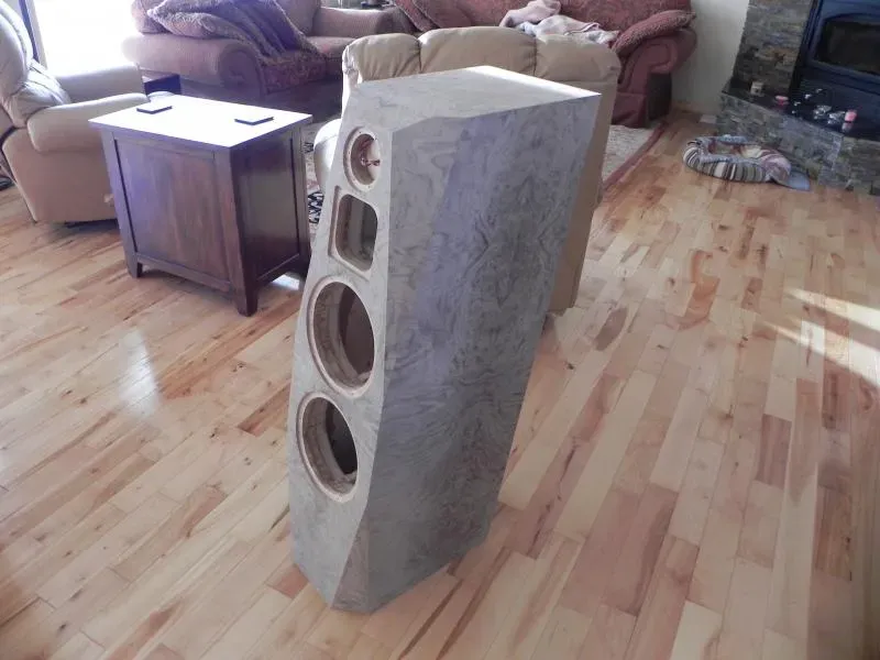

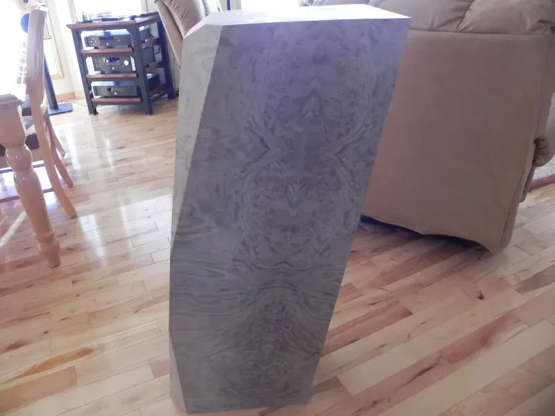

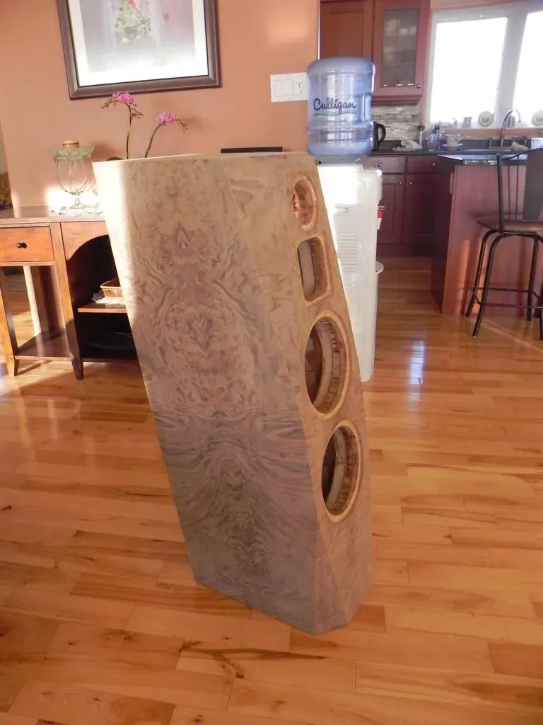

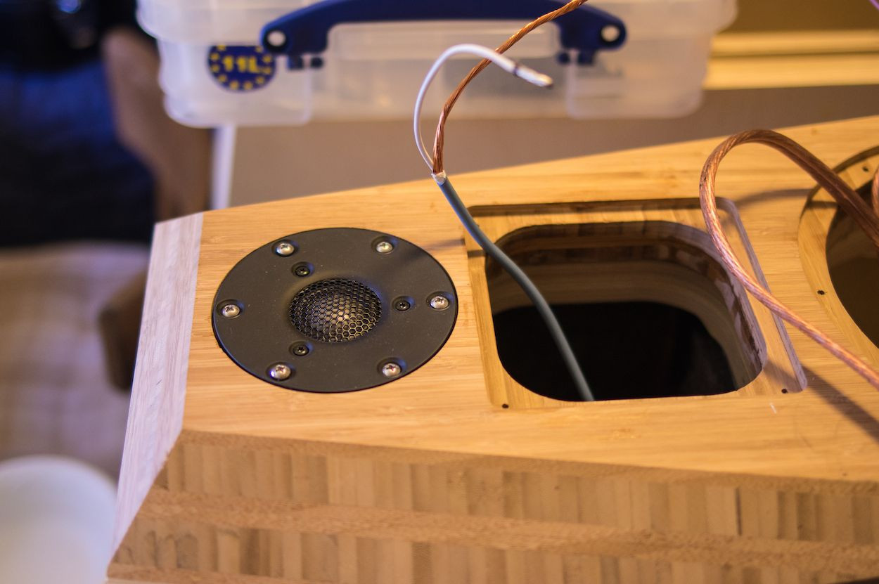

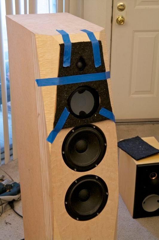

        I got one completely veneered and ready for finishing. I'm pretty happy with how the veneering turned out. On the next one I may try to do the facets first then put on the front piece.
        Click image for larger version  Name:	DSCN2272_zps56ca9d6a.webp Views:	0 Size:	46.4 KB ID:	934310
        Click image for larger version  Name:	DSCN2269_zps46bc2817.webp Views:	0 Size:	37.7 KB ID:	934311
        Click image for larger version  Name:	DSCN2270_zpse78c2115.webp Views:	0 Size:	43.3 KB ID:	934312
        Click image for larger version  Name:	DSCN2271_zpsf41bfd4d.webp Views:	0 Size:	30.2 KB ID:	934313
        Clearly the Force is strong with this one...
                Wow, those sure look nice!
                And as Jon mentioned, they seems "just right"

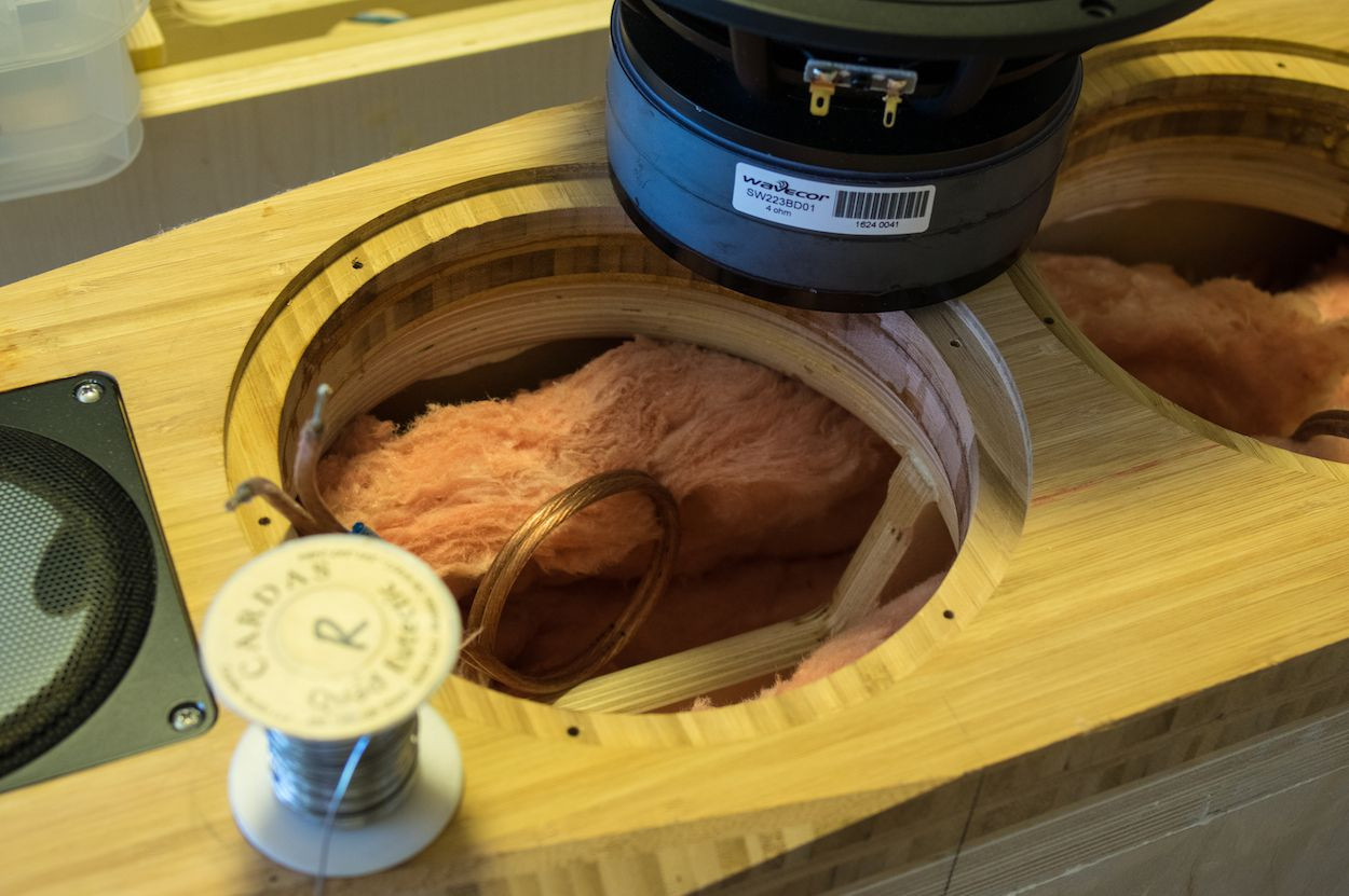

                                                    Very busy weekend, but distracted by many other tasks- such as moving organ, unpacking and setting up Leslie 3300 bought on eBay, helping GF with some storage issues.
                                                    And discovering Sunday AM I'd forgotten to bring the temperature controlled soldering station over along with the other tools last weekend! GF went above and beyond the call of duty, making a run to Radio Shack to buy their clone of a Weller soldering gun... which wasn't a very good clone, but was good enough to strip the insulation on the Cardas SE-11 wire and do some soldering and mounting of drivers.

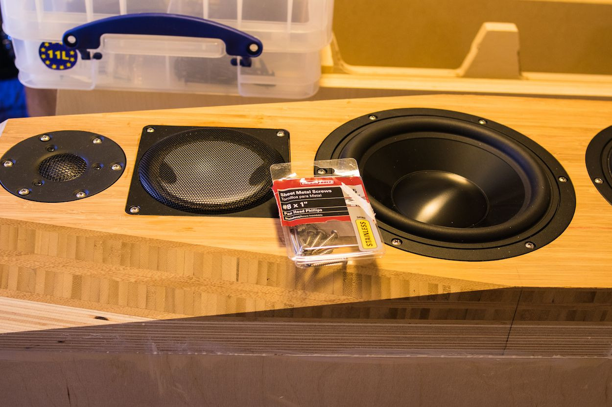

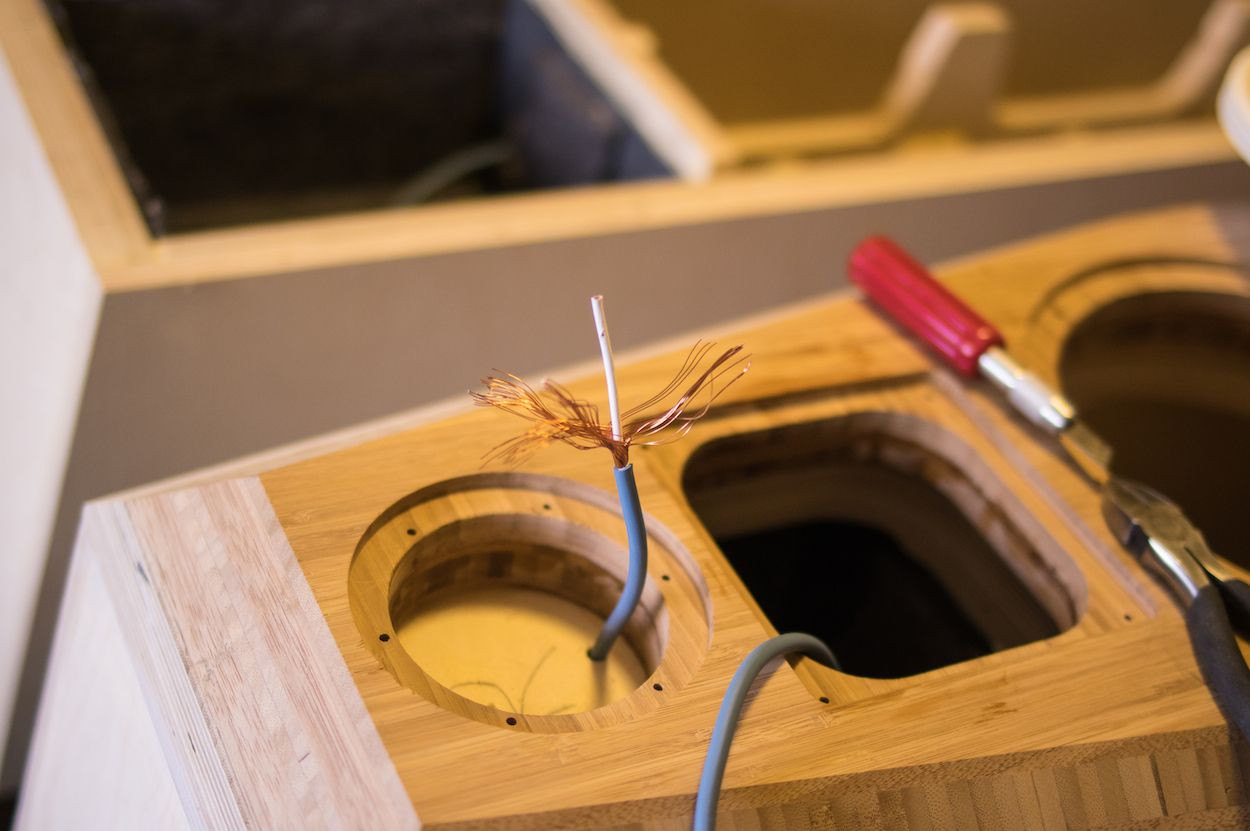

                                                    I used Private Messages stainless steel philips head sheet metal screws for mounting drivers; 3/4" for the tweeter, 1" for the mid, and 1-1/2" for the woofers.
                                                    Major stumbling block #2, after getting everything wired up for one cabinet, discovering I'd also left my HP scope at home, and had no way to set reference levels for driver testing (so that results would be directly comparable with all other testing I do). Normally 4V P, which is ~2.83VRMS; adjusted when I want to test distortion at higher levels.
                                                    Well, next Friday I managed to squeak out a PTO day, originally for Apple shareholder meeting and getting my windshield replaced in my Element; with the timing necessary for that appointment, it looks more likely it will be Wavecor Ardent testing and getting the windshield replaced!

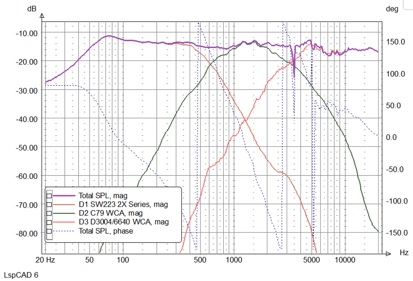

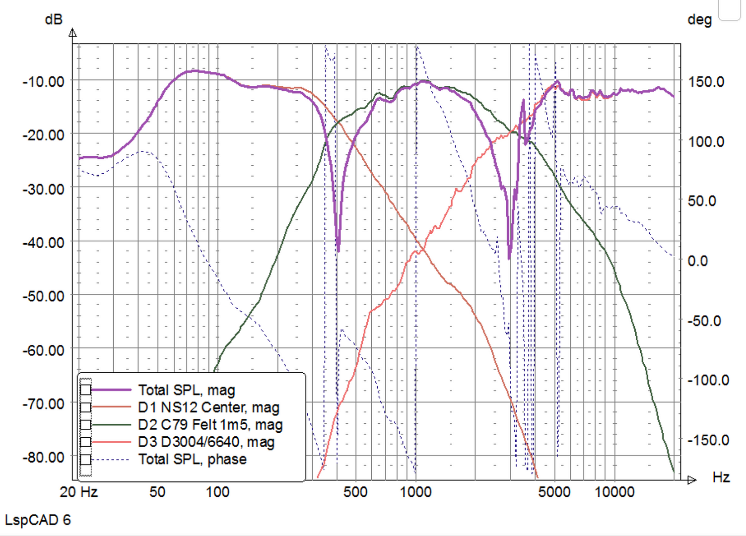

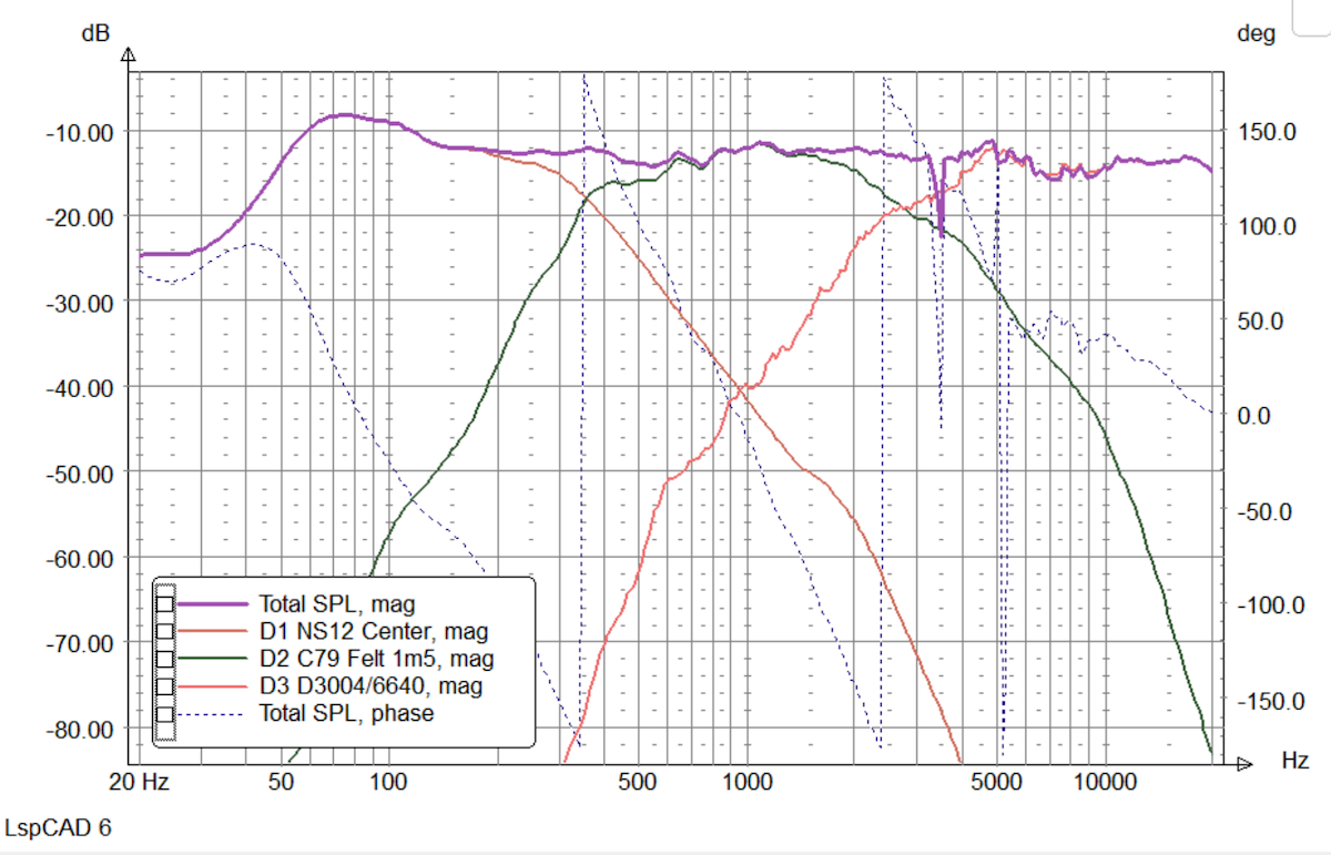

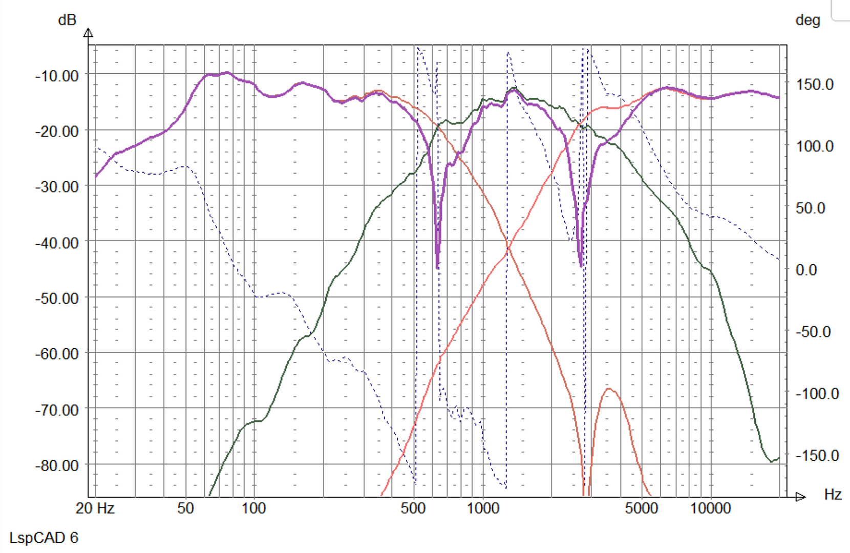

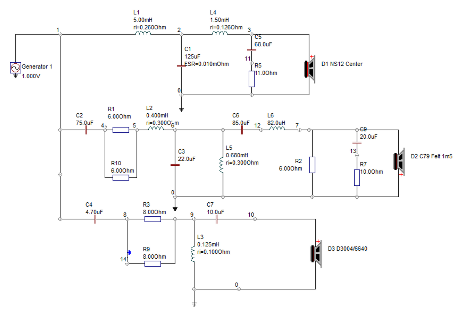

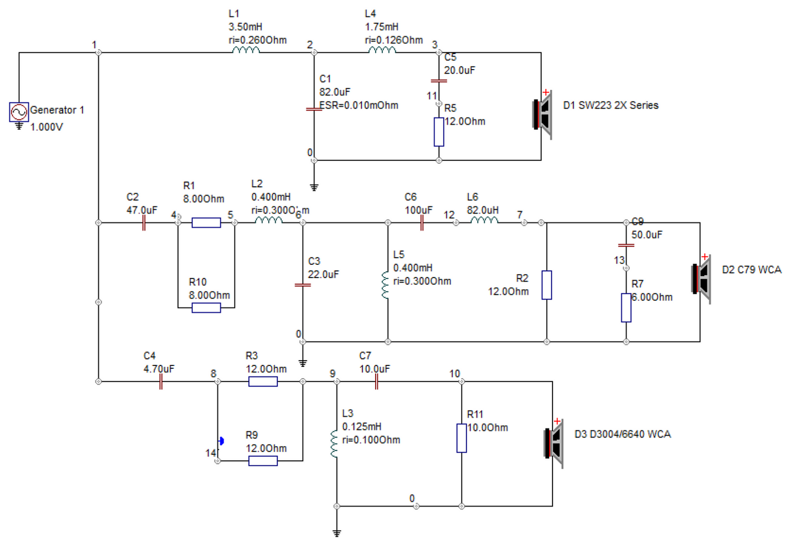

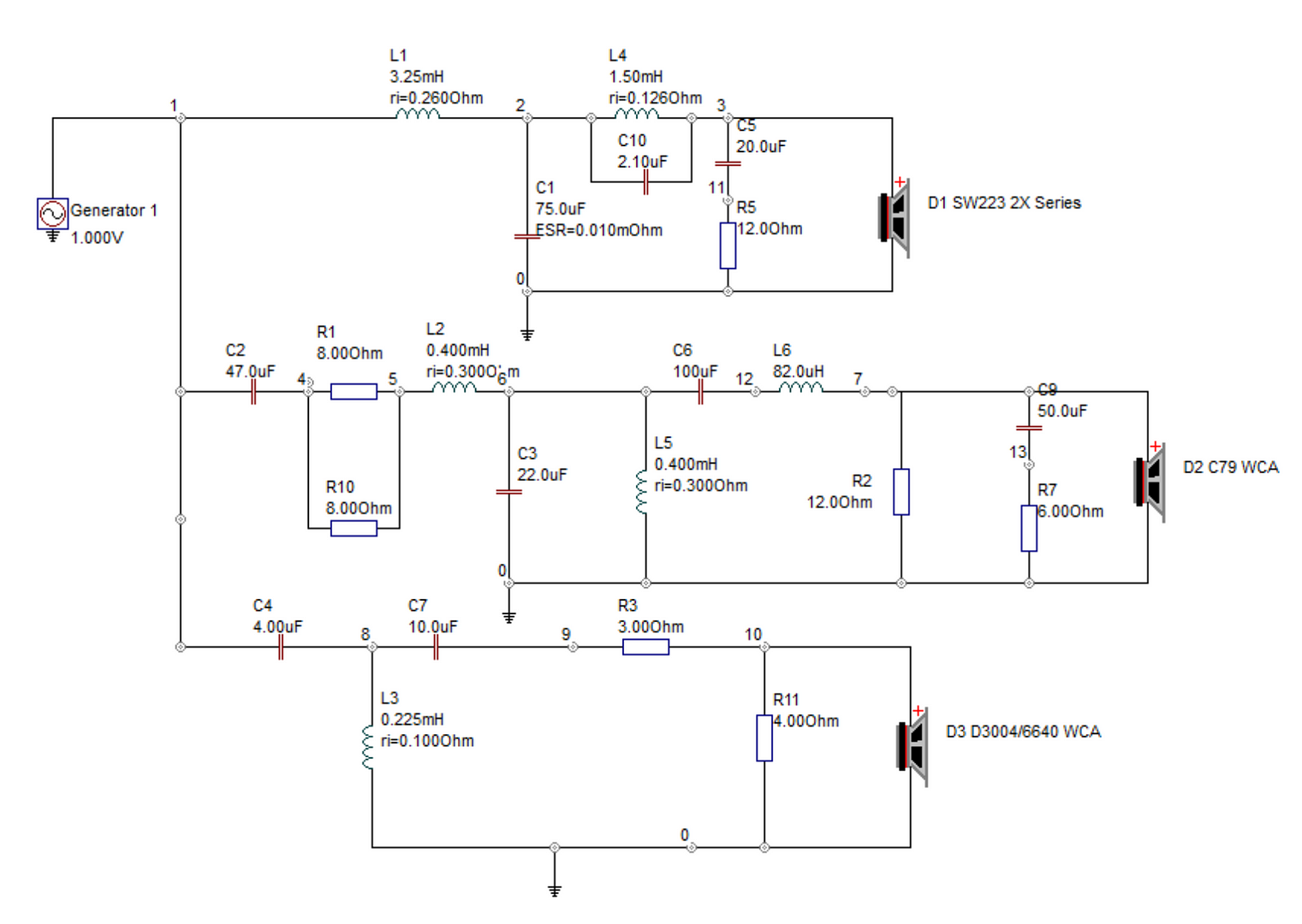

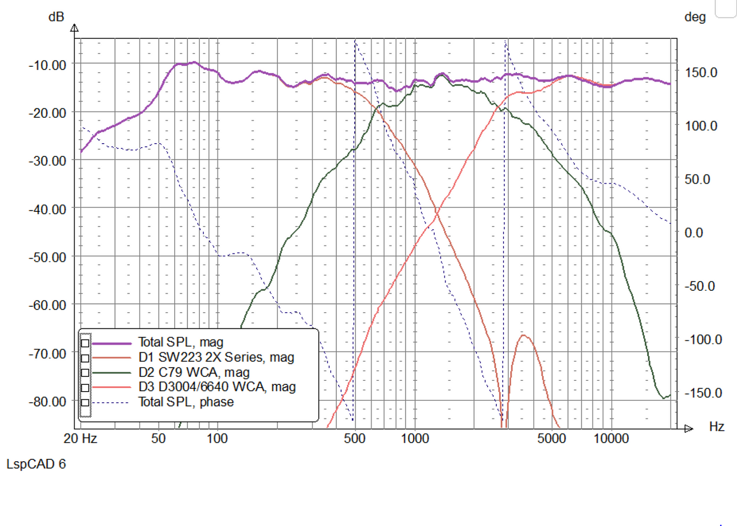

                                                            Though I don't have new data yet, I've been thinking about the design and reviewing and revising the concept test crossover. Mostly this has meant nudging the LF to MF crossover a little higher in frequency, and altering the LF voicing, and double checking and optimizing the reverse null behavior. (we don't care about flat response so much, many ways to get that at one measurement point (and not at others) but we just like to see really deep nulls in the reverse wired response... indicates high degree of phase tracking in crossover region).
                                                            Smaller component values, less expensive crossover, less volume in cabinet.

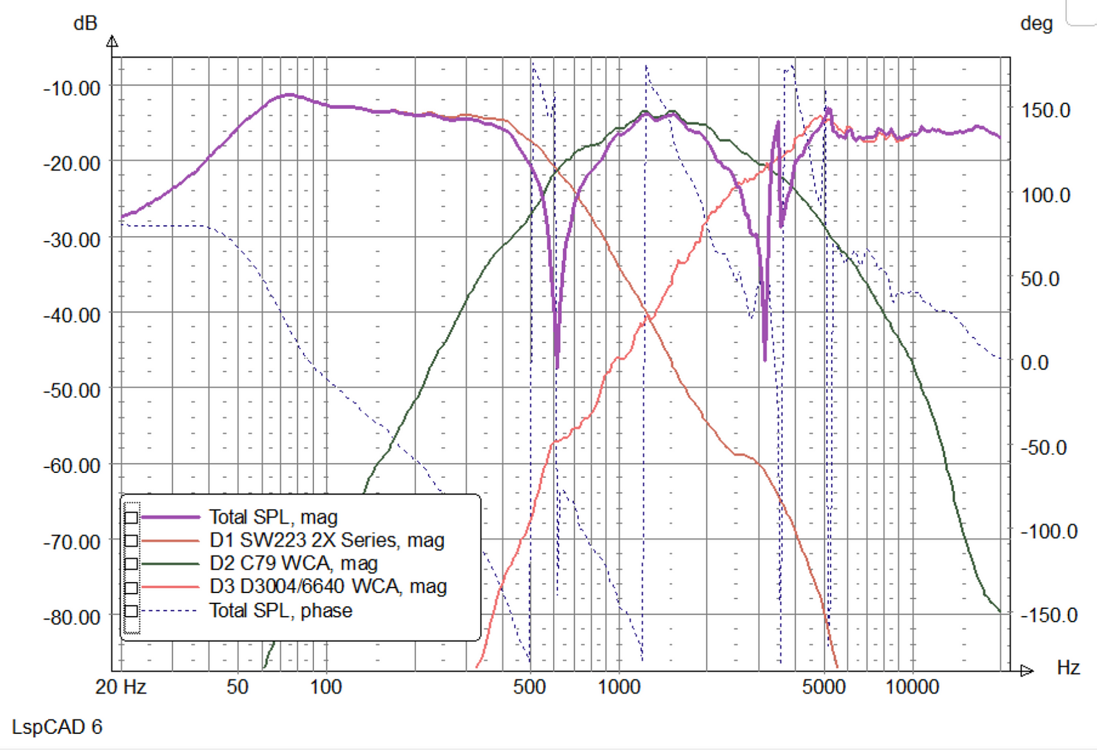

                                                            Hmmmm, nice reverse nulls.
                                                            Smoothed out the bottom end and brought up the mid and tweeter level.

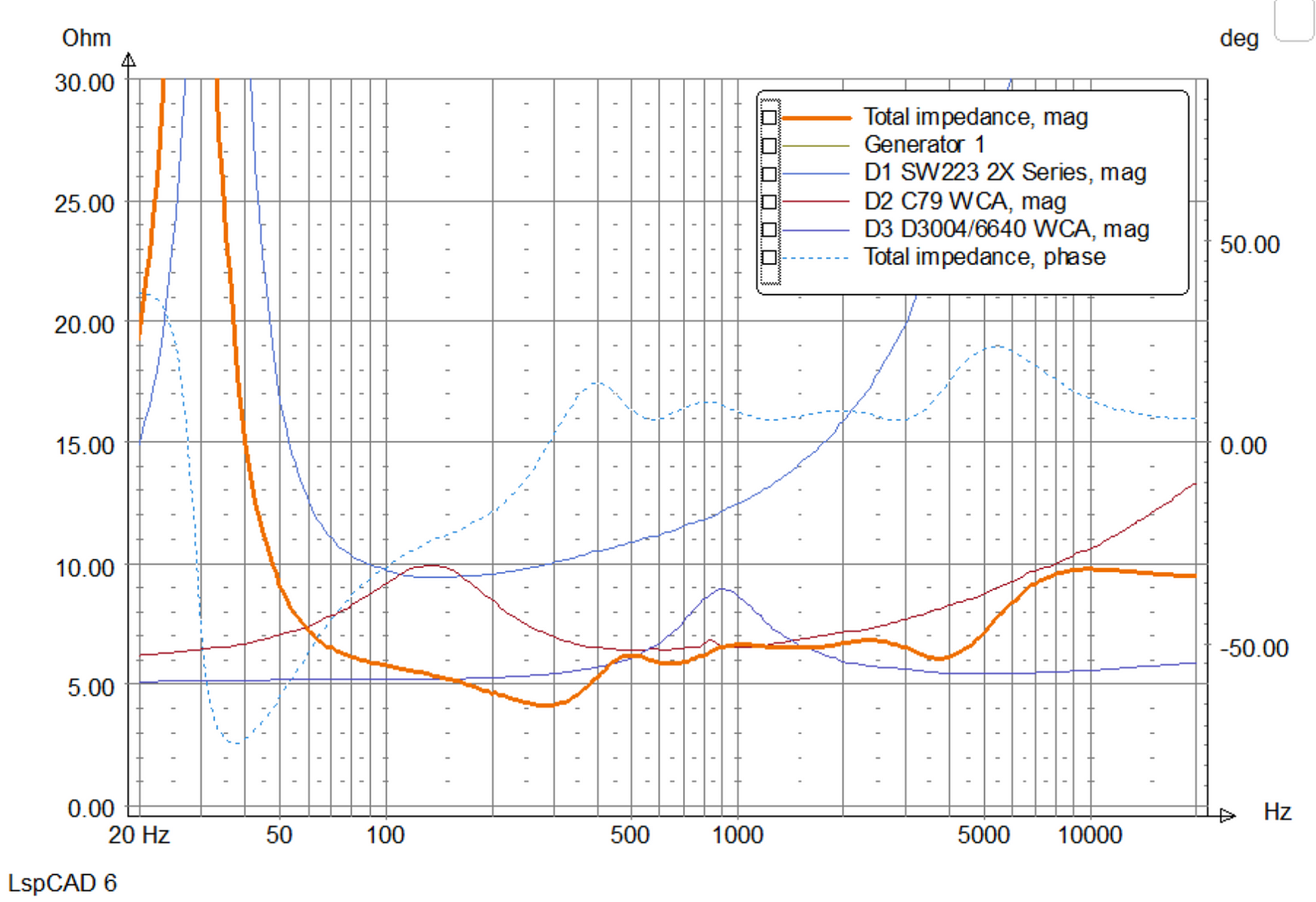

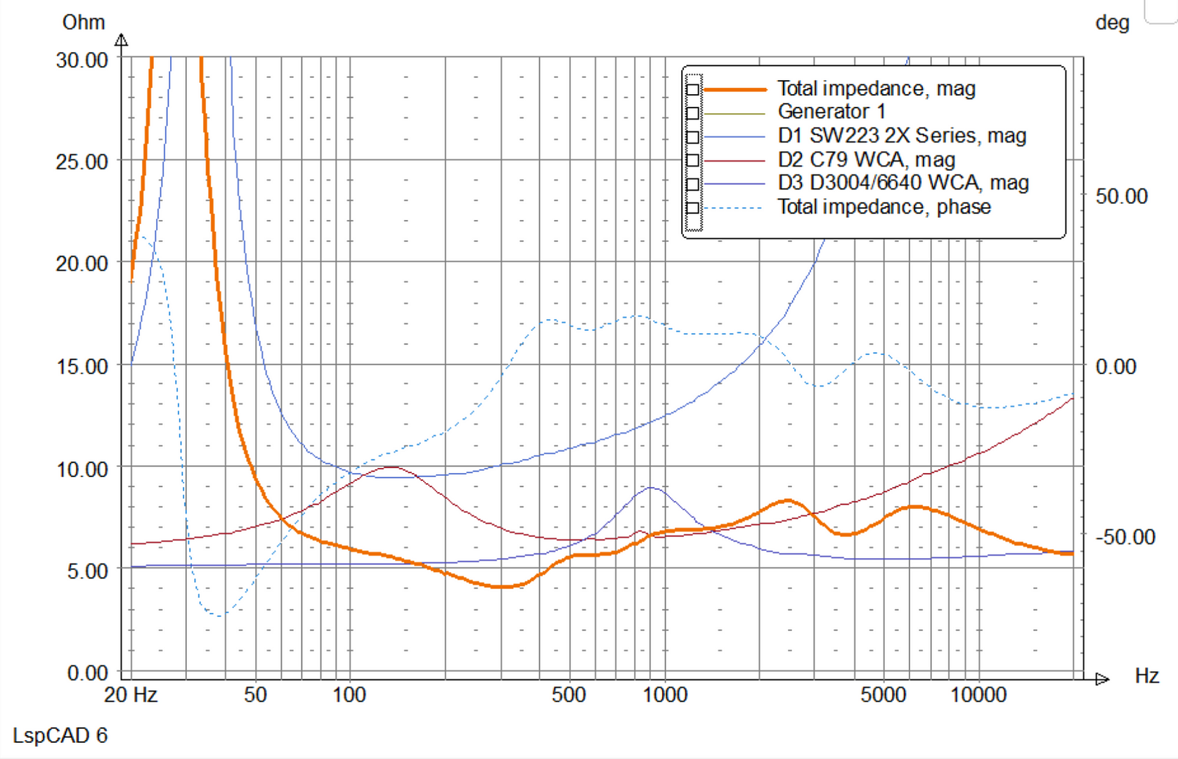

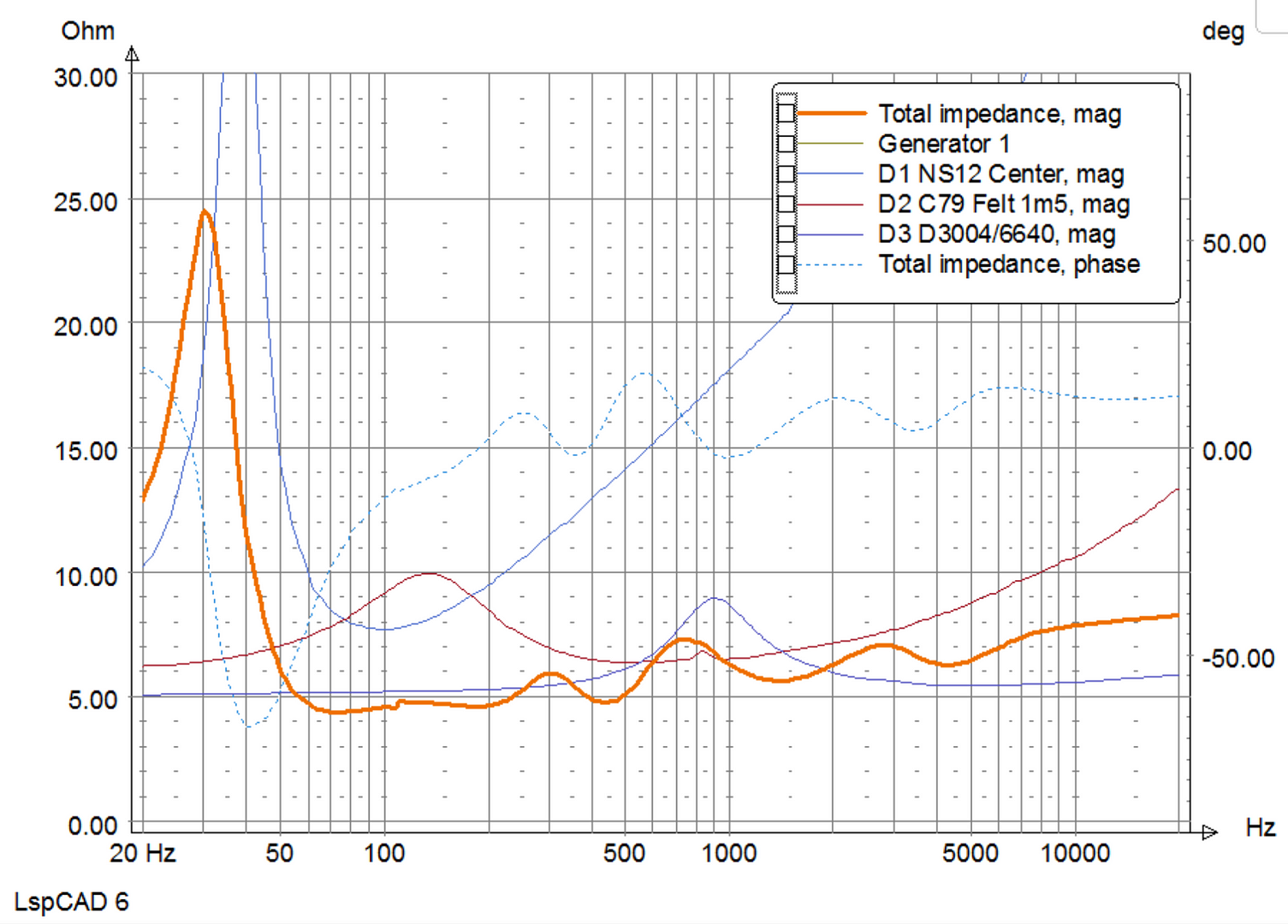

                                                            Impedance doesn't look bad, either... nothing out of sorts, and pretty smooth.

                                                              #345
                                                              Your doing great especially with all the irons in the fire your trying to deal with. It's tough to remember stuff when your not working at your usual work space, I know I did when we were at the factory down town. Jon don't feel rushed on our account, Ben's working on getting his finish finalized with samples while doing a new school term and planning a move scheduled for this week. My veneer isn't getting here till maybe Thursday, so you have plenty of time to tweak things to your hearts content. I know those cabinets must be tugging at you, Man those drivers look sweat mounted in that baffle. :T
                                                              That impedance is looking like an easy load so far.
                                                                • 16176

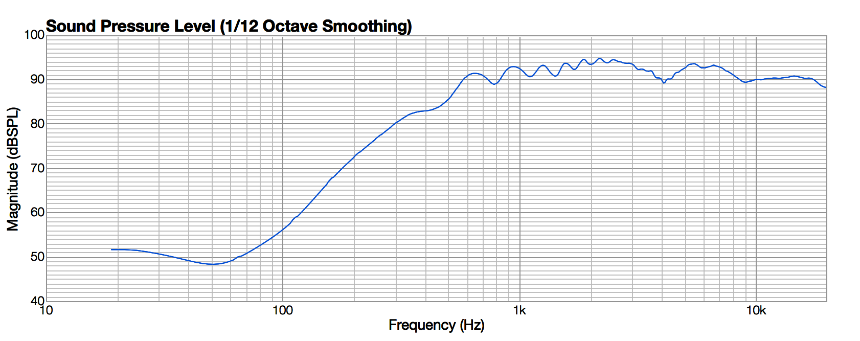

                                                                Thanks for the kind words and understanding. But I really want to get the measurements and crossovers moving along, so I can get to the finishing stage and possibly have these ready for the 2014 Northern CA DIY meeting in early May. Yes, with all the other things going on, it's a bit crazy... we're slowly getting things figured out for what of my stuff will go where over at GF's.
                                                                Yeah, the impedance curve is another "indicator" that things are playing out correctly- hopefully it will stay in this range, but it IS looking quite sweet, and MUCH nicer to drive than an Indra...
                                                                Especially considering the punishing LF impedance and phase shift!
                                                                With this smooth an impedance curve, there should be less interaction with the output impedance of an amplifier, such as a zero feedback solid state design or low feedback tube design. That's not a critical factor, IMO, but still desirable.

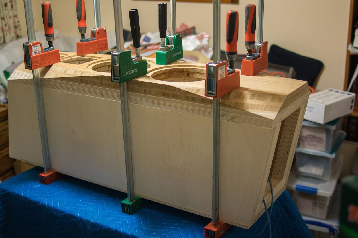

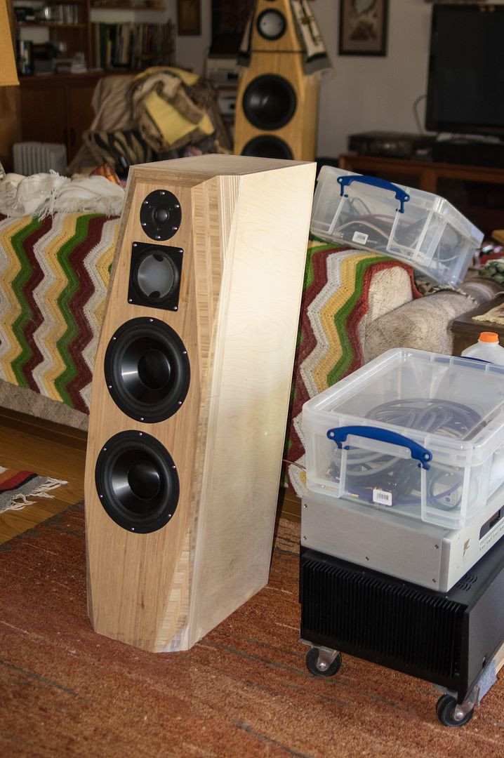

                                                                      Making progress

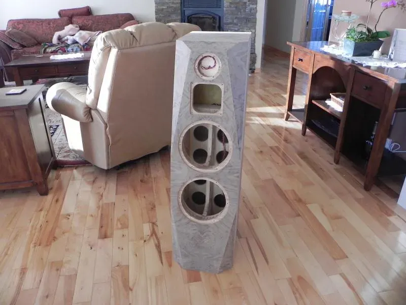

                                                                      Busy day yesterday - a scheduled day off work- got lots of errands done, including a new windshield for the Element.
                                                                      I also glued the second front baffle up in the AM before heading out for all those necessary errands...

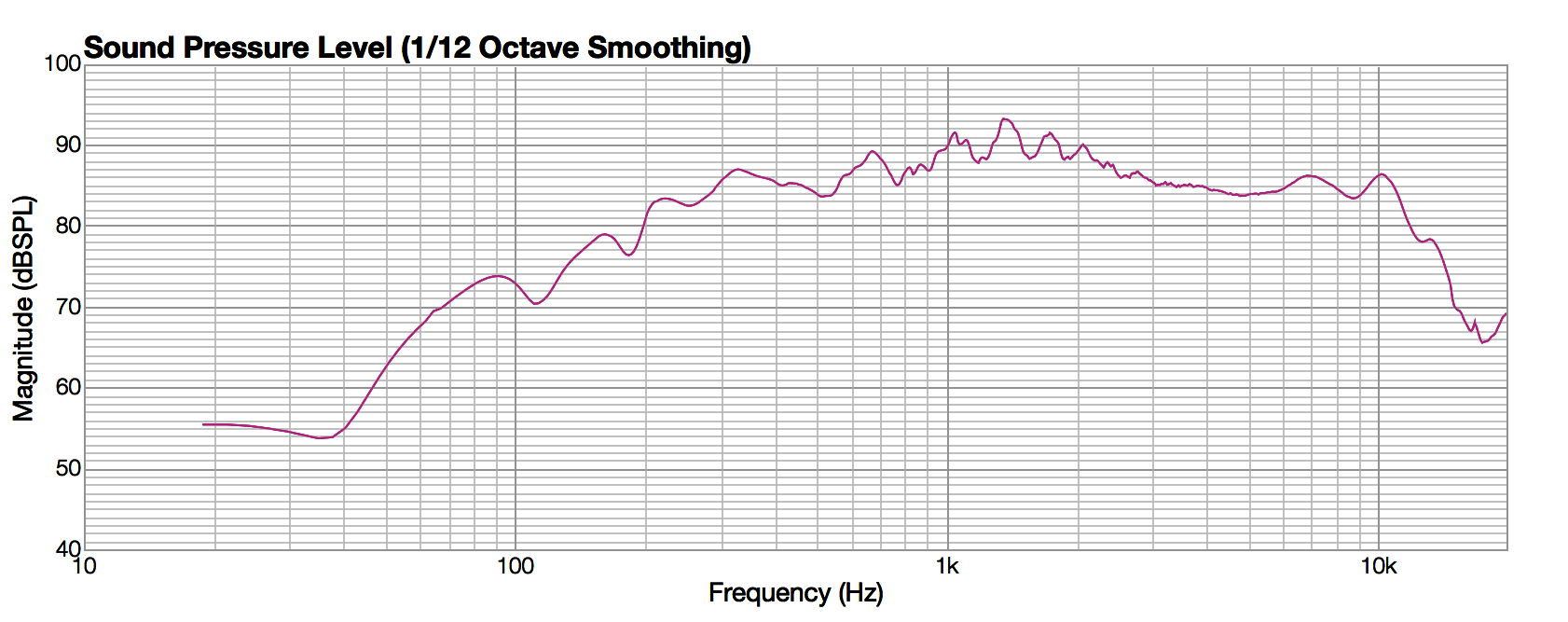

                                                                      This morning we moved things around in the family room and got setup for the driver measurements. That seems to alway have minor glitches with sorting out th signal path on the TC Electronic Konnekt 8, but nothing that I can't eventually figure out. One of the advantages of bachelor life is being able to leave things just setup- can't do that here! :W
                                                                      Things look pretty much as I expected...

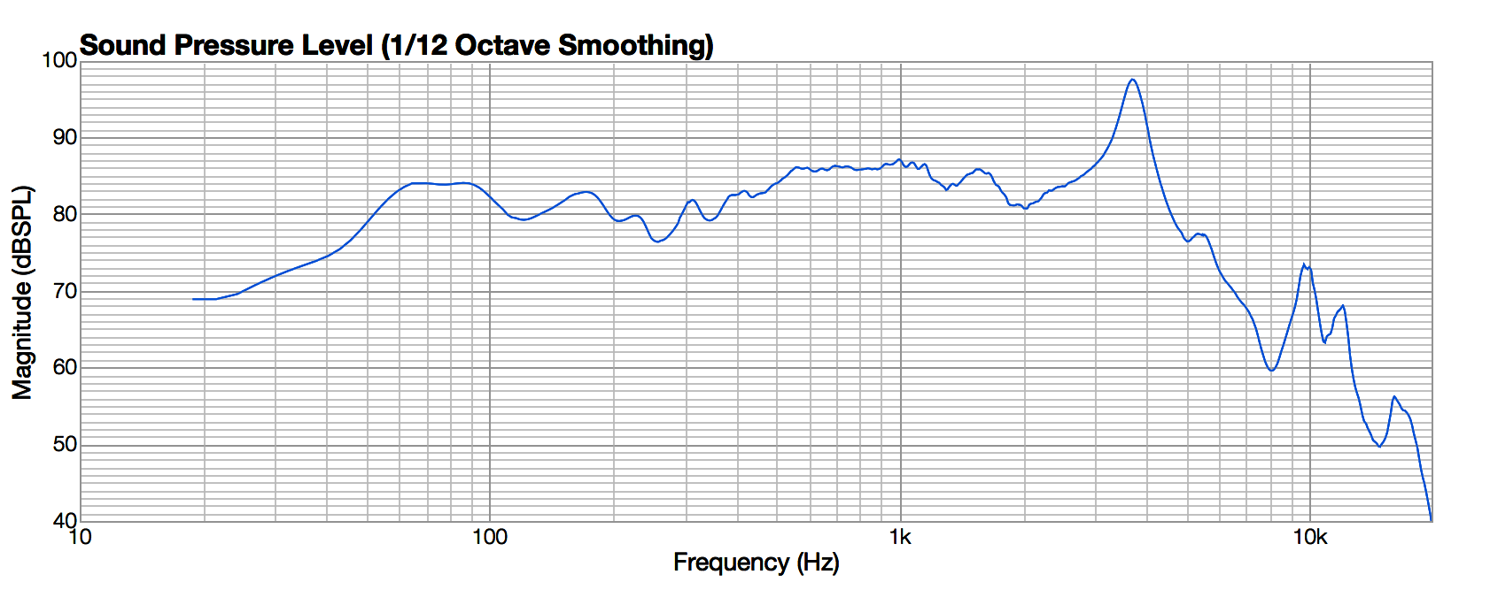

                                                                      SB223 Wavecor woofers wired in series

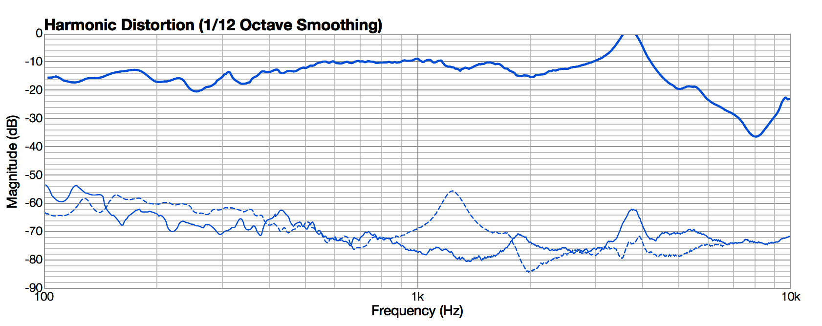

                                                                      Note that the breakup mode is at about 3.7 kHz, and that even with HD3 resonance amplification of distortion products, the distortion behavior for a 3 way will be quite nice even with a 400 Hz crossover point.
                                                                      It's also interesting how similar in level HD2 and HD3 levels are - I'd say the efforts for the balanced drive motor design have paid off,

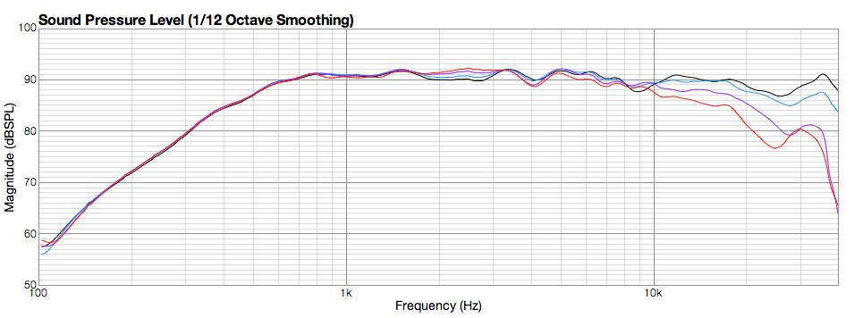

                                                                      C79 midrange
                                                                      SS 6640 tweeter
                                                                      This measurements were done more for getting clean data for crossover design, not investigating the drivers per se.
                                                                      I didn't have time to setup with a lot of additional wall damping and synthetic comforters draped to knock down reflections, so there's a bit more "ripples" in the measured response than usual, but I don't think this will impact checking / developing the crossover design. Just won't look quite as idealized and pretty, unless I use more smoothing of the data.

                                                                              Well, I got the impedance measurements done this afternoon, no surprises, either, but the woofer looks quite nice in the operating range - mind you, this is the two wired in series as we're using it.
                                                                              Fb in the low 30's, and a nice flat impedance curve in the midrange where we're using it! :T
                                                                                #354
                                                                                Eminently usable. And no sign of any resonances up until its primary cone resonance well out of band.

                                                                                  Some more progress yesterday evening...
                                                                                  This is a preliminary design with the new data, I'm going to look through my part drawers and see what I've got on hand to put together a test configuration- might be able to cover a lot of it, we'll see. It's worth a trip to the storage unit. Don't go buying parts off of this, there will be a detailed BOM when I'm ready to say ready! :W
                                                                                  Nothing should be very surprising here, but of course it's using a higher crossover point than the Isiris for the LF to Mid.
                                                                                  A reminder, no diffraction treatment on the cabinet for these initial measurements, I'm used to seeing certain bumps in the tweeter response as a result and don't try to fix those.
                                                                                  For reference, here's the tweeter on a test baffle without the diffraction issues:
                                                                                  Impedance has a bit of a dip in the 200-350 Hz range due to some peaking entered in to the crossover based on slight compensation for the in room measurements- that may not really be needed, but some more extensive measurements would be required to know for certain...
                                                                                  I didn't take any special measures for the woofer breakup mode at 3.7 kHz; it's about 40 dB down, and that seems like enough- subject to change, would be the addition of a trap cap across L4 to create a notch filter. Votes, anyone?
                                                                                  And for reference, reverse polarity on the mid, which shows some fairly nice notches due to heavy phase cancellation out of phase.
                                                                                  I think we're heading in the right direction.
                                                                                  Oh, and I found pictures of my previous felt construction for the Ardent; it doesn't show clearly, but the tweeter cut out is a vertically oriented diamond slit, as I did for the old M8a book shelf, which worked well in that case, too. I'll make a new test piece, or one to fit in the supplied parts from Ben, and detail it in a drawing after testing.

                                                                                    #356
                                                                                    The only thing that really bothers me is that hump in the tweeters response at 5k, no doubt mostly deffraction related, but it's presence is causing you to push down the rest of the tweeters response to prevent the 5k area from becoming too hot. Also the mid looks like it's running a tad hot too, no doubt to help with the upper end issues.
                                                                                    This is where the felt comes in. If it can smooth out the 5k problem then your issues go away and things will look a lot better. If you aren't going to do this then maybe a traditional lpad on the tweeter (perhaps giving C4 it's proper response shaping around FC), or going 4th order will give you enough attenuation to put a reverse knee around 5k and squash out the hump. I'd have figured that you might have done this already, but if you're banking on the felt to cure the hump, then I can see why you might have ignored it. The issue looks very similar to what I encountered in my last design. 2nd order electrical provided enough attentuation to meet the target slope, but didn't have enough response shaping abilities to pull down the hump around FC. Going third order solved everything very nicely.
                                                                                      • 16176
                                                                                      #357
                                                                                      My experience with the last Ardent cabinets and the 6640 showed that the hump was "curable" with the felt treatment. Have to confirm this, but for now working under that assumption. Since this is a 3rd order design, there is some flexibility for tweaking. I'm starting with additional focus on the woofer- I have some additional measurements made at different heights, and will take a look at averaging those and see what comes out closer to near field measurements.
                                                                                      Still, it's progress, things are pointing in the right direction, and I'm used to seeing LspCAD sims that look like the above, but with measurements of the finished crossover in system that look like this:
                                                                                      With a longish gate, no excessive smoothing, not perfect, not an Isiris like plot, but I think we can even improve on it this time around.

                                                                                          That's a REAL drag- available time, but missing critical ingredients! I hate when that happens!
                                                                                          Well, I have some time on my hands while doing laundry today, so more simulation work and pondering the design- think I've made some good progress. I did go back and use some additional measurement points lower and higher, and created an average LF woofer response- usually only something I do for balancing the power response of the tweeter on and off axis, but it seems applicable here, as I couldn't get the measurement distance as far away as I prefer (1-1/2 to 2 meters- was just using the "classic" 1 meter yesterday).
                                                                                          Also, based on 5th Element's inputs, I went back and looked at the more conventional tweeter topology, which I don't use so often because the Isiris configuration gives some input impedance advantages- but in this case the conventional approach just may work out better, since the tweeter Fs is so low and isn't interacting with the network. Also, I tried out adding in the notch element for the woofer resonance, C10, and while it could be left out, I'd go ahead and put it in- 2.0uf will do, but 2.1 (2 + 0.1) will tune it more accurately.
                                                                                          So, this is the net results after some tweaks, but with less smoothing on the imported data, so it won't look as pretty in theory (a reminder, this is essentially a modified LR3, an alignment which is not normally used, but can be very useful with the time delay in real box systems; as used first in Modula MT and NatlieP):
                                                                                          The simulated response; could possibly argue for bringing down the Tweeter by a dB or so- but need to be measuring and listening to make an assessment:
                                                                                          The reverse polarity on mid response, checking for quality of reverse nulls:
                                                                                          Impedance:
                                                                                          This I'll check the parts bin for soon, (have most of the tweeter parts already, I know...) and see what I can raid from an older Isiris Crossover for a test build.
