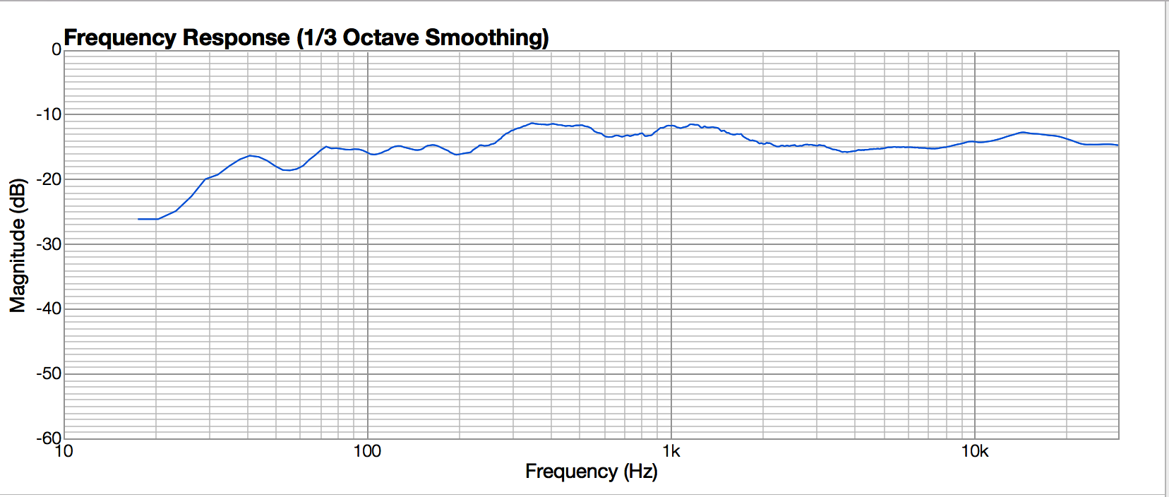

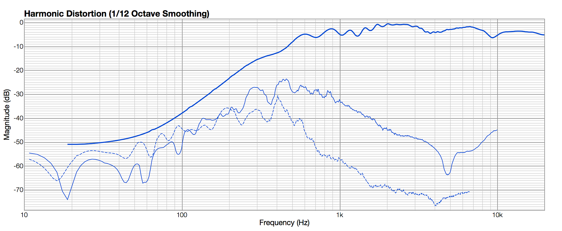

                Yesterday was auto and domestic maintenance day, including installing the new window regulator in the driver side door of my element- that went fine, and I figure I saved myself about $250 at least doing it myself- both on the part cost and labor.

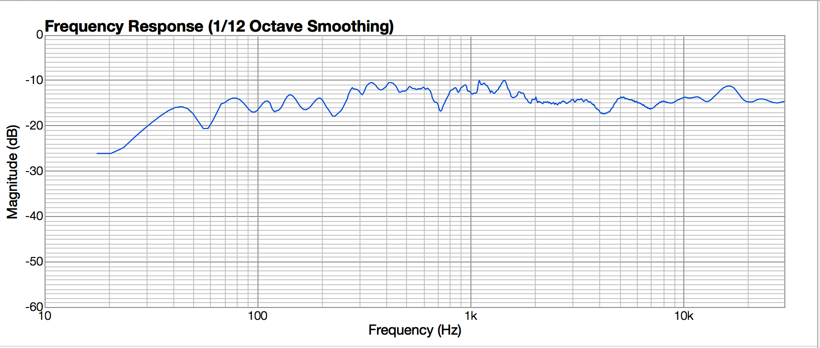

                So finally this afternoon I got all the pieces together and setup in the family room to do some measurements, and spend some time trying to tweak the felt/grille setup. I actually ended up cutting away quite a bit of the felt at this point, to the point where there is only a shallow V at the bottom. This seemed to do the best job and the least damage, and does work better than just the bare cabinet.
                This is the relatively un-smoothed response setup in the back side of the family room, measured out to 30 kHz (the first line after 10kHz is not 15 kHz):
                And to clearer highlight the "overall trend" at this measurement position (1 meter distance, 1 meter height- sort of close for a three way)
                Some general comments- in the relatively non ideal quick and dirty setup, LF response is nonetheless quite deep and articulate- and being sealed, extra gravy on the articulate part. With a bit more careful setup, there's no reason to not expect solid in room performance to 30 Hz.
                2nd, there seems to be an elevated midrange response plateau between 300 Hz and 1100 Hz. But, the weird thing is, it doesn't really sound like that- something about in room LF and mid balance seems to mitigate this. Yet, the engineer in me wants to fix it.
                Now, I did a fair amount of listening, but just through the test setup, that is, feeding the T.C. Electronik firewire audio interface used for testing, which drive an Ayre K5 Preamp and Aragon X3 power amp. Cardas interconnect and speaker cables were used, just Golden Presence (which actually normally emphasize the midrange and presence region a bit subjectively, to me).
                Cuts were mostly high res source, either ripped SACD or HD Tracks or similar. Just played through the Vox player, which is a very decent simple player, and which does on the fly optimizations for audio playback, but I wouldn't describe it as state of the art. But then, not much of anything on a Mac or PC is for music playback, though some things are pretty decent. It was doing on the fly sample rate conversion for music playback, as the T.C. unit was running at 96 kHz. This is not a recommended configuration, but didn't have time to change over. More concerned with overall balance, anyway.

                How does this stuff sound? (keeping in mind it's mono- one speaker)
                well, big, lush, very detailed deep and harmonically authentic bass, a clear clean top end that sounds just a touch recessed or polite, and a very lush detailed midrange.
                Particular standouts are syncopated drum/bass combinations which retain impact from both but don't muddle them together, like Gavotte in B Minor and Ballad of a well known gun.
                I listened to the Shelby Lynn cut listening for different things because of an article I read online (possibly Absolute Sound) where the review discussed why he used that track, particularly for the relative level and balance in reproduction on any system under test between the piano and bass and drums in the opening before she sings.
                I also listened to the standard Northern CA DIY test tracks, a mix of several highlighting piano, vocal, and other readily identifiable instruments.
                All in all, the results were quite pleasing considering the source and signal chain! Which means I need to hook them up and listen with the big gear, too...
                Frankly, these sound much more musical and balanced than the first set of Ardents when they were first fired up- and even after the last set of driver and balance tweaks. Those Wavecor woofers bring a lot to the party-- no doubt about it! Right now, I'd still describe the balance as a bit on the lush or zaftig side- something that works better with a lot of standard recordings then some more neutral measured results. This is interesting...
                I can think of several follow up actions though before "release to production"-
                • Set this one up in the big system setup and listen in mono in place of one of the Isiris- evaluate tonal balance
                • Reveiw the crossover network and assay a design revision to adjust the midrange level to something more nominally flat.
                • Complete the second cabinet with modifications to the crossover reflecting the simulated design changes
                • Measure that system, and listen to it also in the big source gear setup.
                • Assess the measured versus listening correlation, and at that point finalize the design
                The thing that is puzzling, is that it doesn't really sound like the midrange is elevated- in room from my listening position, bass and miss sound very balanced, and the highs a touch soft, which with this Firewire audio interface and the Aragon power amps, is not a bad combination. This bears further investigation- if these were just for me as casual listening speakers, I might not bother doing anything more- any issue they have seem to be on the euphonic side, so far. But for the sake of the team effort, this should be sorted out further.
                One other point worth mentioning is that having the cabinets higher with these thick bases is not necessarily a benefit- the ideal listening axis IS aimed up a bit, and now it's a couple of inches higher for ideal summation on axis. This is fine for the net power response in the room, but I sure wouldn't suggest listening to these lying down on a low couch- that would be less than optimum in the mid to tweeter crossover area. Sit or stand... for best results!

                  S'funny you should mention that because the first thing I thought when looking at the graph was - needs more baffle step compensation. Then again we know that the amount of BSC required depends on the room, the loudspeaker positioning and sometimes your position relative to any nearby boundaries. I would be hesitant to use a lower amount with this design as it is largely intended for free space listening, that any the design is inherently very low distortion. Usually its the lower distortion designs that need the most BSC because they do sound so very clean.
                  Usually the way I balance BSC is by dialling in the full amount and then gradually reducing it till the overblown bass doesn't bother me any more. With very clean sounding loudspeakers you can sometimes use none and it will sound pretty good anyway, then you start dialing in more and you're like, well this is good too, it was good before though..am I applying enough? Too much? Dang it. So I choose to go the other route, apply more than you need, usually the full 6dB, this typically sounds too much then reduce until it doesn't irritate any more then leave it at that.
                  As you've got the PC, and all those boxes of digital tricks, () it would probably be worth balancing these initially with a DSP, then once you're happy with the sound, measure the speakers with the DSP in the chain and replicate what you measure with the passive crossover. You could also do this with LspCADs crossover emulator.

                    5ht element said it nice and well! This kind of 1m response sounds very clean and pure, but (depending on room/placement) bass needs some boost at least with moderate listening levels. Sort of loudness contouring. I believe that 2dB down 300-1200 would be nice and make them sound more "matured". Low bass does not need anything else, perhaps some tone adjustment (if you have and dare to use that knob in your amp) at really low levels.

                      I hear you Matt - that's a good methodology, and what I generally do, too. Now, the odd thing here, is that for this measurement this weekend, they are way out in the open, nearest side wall is the glass wall going to the patio, which at that point had the door open for the doggies with a simple dual panel fly screen closed magnetically. They were about 3-4 feet from that, close to the open door, and not quite half way along the long glass wall- I'd deliberately put them in a spot where I expected minimal reinforcement from any adjacent boundaries- something close to outdoor measurements- which I should do next as a check.
                      Well, I'll proceed as planned above, and look at pulling in that midrange region by 2 dB measured, with the second one, and see how that sounds....
                      One of the things concluded in the development of the original Avalons is that full BSC didn't sound right, and it was pulled back to about 3-4 dB.
                      Let's see if I can make some progress on this during the week, in spite of my work schedule- next weekend we have to finish organizing and packing for the trip to the Seattle area for the GF's niece's wedding- we're driving up there, and doing some camping on the way back, which GF has been looking forward to all summer. Leaving on the 30th...

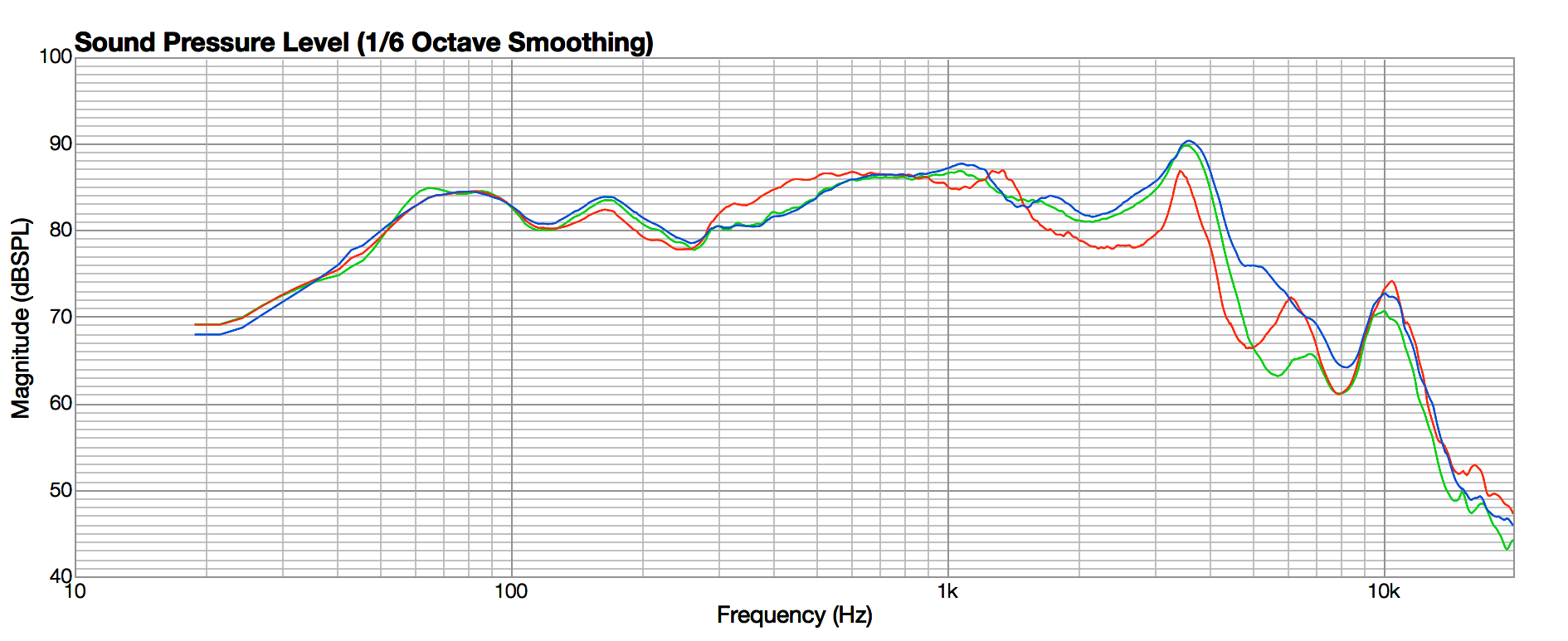

                        Another clue emerges
                        I went back to my first driver measurements- another clue emerges when I think about this a bit more...
                        The green and blue plots are at different heights on the woofer axis, and I believe more representative of what goes out into the room. The red plot is measured :"high" and close, and shows a more elevated output between 300 and 500. But, when one measures at the 1 meter test position for all driver outputs (as done yesterday), that curve effectively is working from the red curve.
                        How this possible "insight" affects things is the choices for modification of LF driver response and midrange level, and some changes in test setup, moving to a longer test distance.
                        I have also looked at the crossover with regards to the HF lobe behavior and phase, and have some fixes in LspCAD which should improve things on a lower listening and measurement axis. Fortunately, not difficult to implement things- like adding a 1uF cap in parallel in the first section of the tweeter circuit, and possibly swapping out one coil or cap in the midrange crossover. More details soon, I hope.

                          I am surprised at how much difference you're getting between 3 and 600Hz considering that the drivers are operating as pure pistons and are mounted close together.
                          As you said though the red curve gives you more output between 3 and 600Hz, but less just below it, with the other curve being the opposite. Different measuring positions are clearly going to affect how we visually perceive the balance of the loudspeaker to be, at least from the point of view of looking at frequency response graphs.
                          I guess this is one of those times where you're basically considering how much efficiency you want to throw away vs getting a more appealing presentation. It's never easy in that respect, throwing away efficiency just never seems right!
                          Have you considered trying to model the woofers as a 3.5 way instead of a standard 3 way just to see if it helps at all? I wonder if the difference in the curves happens at all to be interference from the two drivers? If you .5 way'd the bottom one and increased the roll off of its top end, it might change things for the better.

                            It's a function of radiating size and wavelength- and I agree that one could improve this by rolling off the lower woofer earlier, the crossover would certainly get large and costly. As it is, we're rolling off fairly hard starting about 400 on the woofers.
                            Setting up in a more typical position and addressing topics in the order I've laid out should get me to where things ought to be- I don't want to throw way the clean top end and power handling of those woofers, they can do a lot more at 400 Hz than the midrange can. Ideally we'd just measure on axis between the two woofers- this gives the best characteristics- and it can be done at a longer throw- and this is more representative to what I think I hear.
                            I'd hope to work on this on the coming weekend, as well as pack for the trip, but I've been told early this AM that they have some new work plans in mind and new things they want testing locally and redundant to what our own team does in Munich, and want all of us in the lab at least one day this weekend, but most likely both days. This is not making me a happy camper, to say the least!

                                I guess you could always raise the xover point a little if it helps with the midrange power handling and compression.
                                Essentially, I did in the initial design- to lessen requirements on the midrange driver, and to reduce the sheer size of crossover components.

                                  Valuable data there Jon...I appreciate your in-depth measurements and description. Just this weekend I was measuring dual woofers in a test box trying to get a feel for SPL levels, interaction between the two, BSC..etc.
                                  What do you estimate the 2.83V sensitivity of the Wavecor Ardent?

                                            They seem to come in pretty close to the factory spec, around 86.4 dB by my most accurate estimate. That's for a single driver, or for two wired in series- in the latter case, the extra driver coupled gives you 3 dB more output, but doubling the impedance gives you 3 dB less output, so it's a zero sum game.
                                            Driving one cabinet a moderate listening levels I was seeing voltage excursion on the scope beyond 20V peak. Stereo would have been louder, of course. Keeping the inductor insertion loss low is fairly important in a design like this. With 4 dB BSC, the net efficiency would be somewhere around 82 db- similar to a big magneplanar speaker. They like a hundred to two hundred watts per channel, too. The Avalon Indra is more sensitive, but the bottom end won't touch the Ardents for either quantity, extension, or definition, IMO. These are pretty killer for the size of boxes they are...

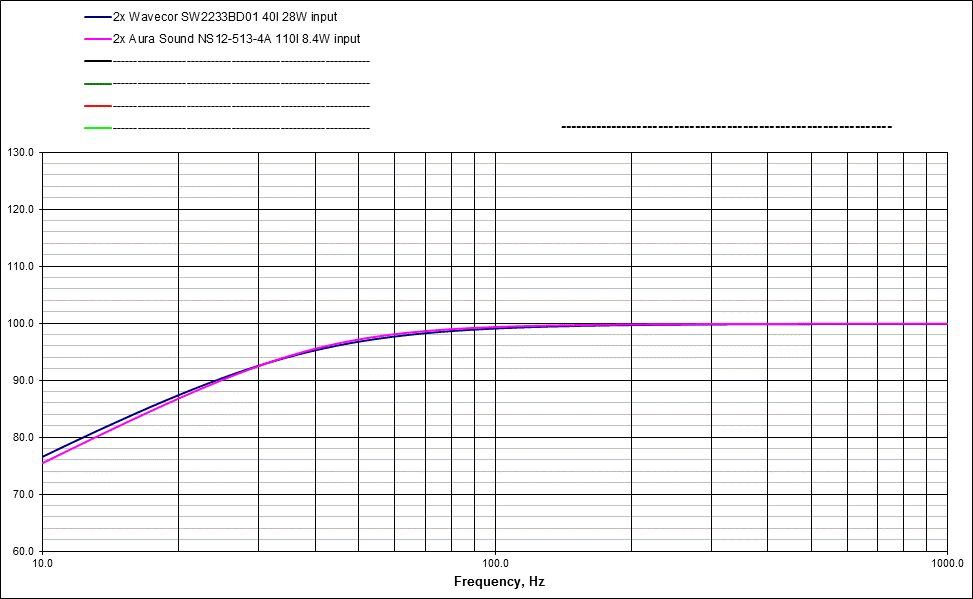

                                              That's around the number I was expecting. I was viewing these as kind of a "sleeper" speaker, probably will surprise people with how much extension for their size...tradeoff being efficiency. I will be interested if you detect any downside to the lower efficiency/higher mass cones.
                                              Here's your Isiris to Ardent comparison normalized to 100db...pretty nice that the 8 inchers extend the same (maybe a little more) as the 12s
Name:	wavecor aura SPL.gif
                                                #833
                                                I think the nice thing with the Ardents and with three ways in general, is even if you pad down the midrange and tweeter considerably all you're doing is throwing away power. Even with significant resistive padding they are still going to give you the dynamic range they are capable of.
                                                This is different to actually having a low efficiency mid and tweeter that would actually need to handle all that power themselves to reach the same SPL. If you've got enough quality power to hit the SPLs required from the system then it shouldn't make any difference (At least from a mid and tweeter stand point). It's a nice trade off in my opinion, especially if the size of the loudspeakers is a concern.
                                                The woofers, having large coils, thick metal cones and extensive motor assemblies should have good thermal mass and a relatively good ability to shift heat out of the boxes too. Those metal cones will surely help considering that the system is sealed.

                                                  What both of you have highlighted is the degree to which I've tried to make the Wavecor Ardent a smaller version of the Isiris while retaining the form factor of the original Ardent.... the similarity of the LF response profile is no accident, but the result of the driver selection and sealed alignment concept with two moderate Qts 4 ohm drivers in series in both cases. Doesn't require an arc welder to drive, as regards current delivery, unlike many systems with dual 8 ohm woofers and a midrange with a low crossover point. The real trick and enabling factor was the introduction of the Wavecor woofers, which like the Aurasound sort of straddle the boundary between subwoofer and conventional woofer, and both have extremely well behaved cones for the size of the driver, with primary break up mode at a high frequency for the driver type. Scott's plot certainly highlights the sensitivity difference- there's no getting around Hoffman's Iron law! :B Maybe for fun I'll try driving the Ardent's with a set of Palladiums, just to see how the handle a rig with high peak capability (600W clipping into 8 ohms...) - I wouldn't put heavily compressed program through at that power level, though.
                                                  It will be interesting to see is just how well the set of tradeoffs which Matt alludes to will work- the C79 is not as sensitive as the C173-90, but it does't need to be able to play as loud cleanly in the smaller system. And I still say I find the 6640 to be the nicest dome I've heard short of diamond tweeter. Very neutral... and dynamic. Man, I wish I could have the rest of this week off just to work on them!

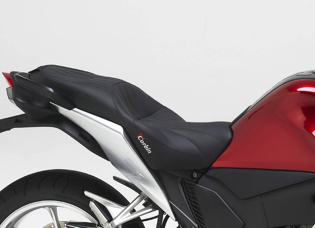

                                                      Last, in other news, yesterday we were informed we needed to work this weekend, including Sunday- particularly if we are to have any hope at all for one of my colleagues and I to take the time off starting the mid of next week (GF and I going to Seattle for wedding, colleagues wife going in for serious surgery which will have a significant recuperation time). So far this week, we've been getting side tracked to issues that aren't normally our assigned responsibility due to resource issues and crunch time before a major proto build. So, unfortunately, no updates are likely, as we have to pack this weekend, too! GF is not pleased.... neither am I. Well, two more months...

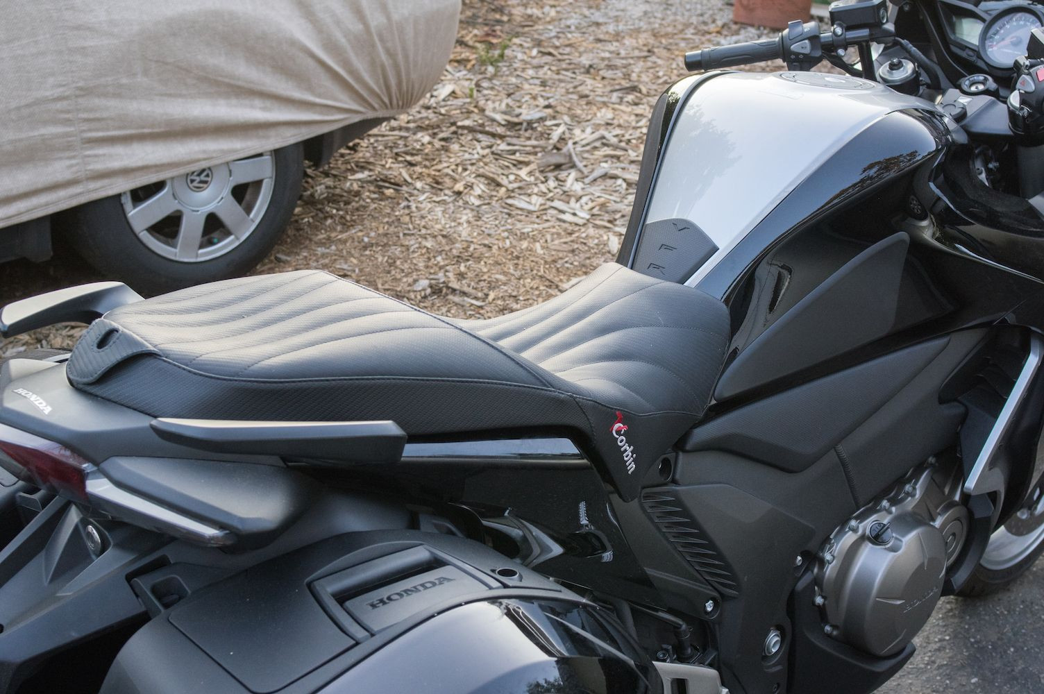

                                                      Only really good news this week is that the Corbin seat for the VFR shipped, and should arrive next Tuesday.

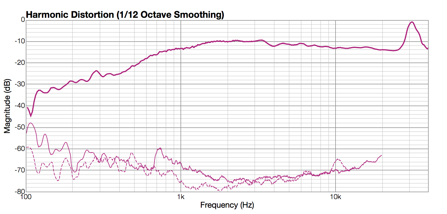

                                                        OK, just to present just facts, note, here is the 6640 SPL family of curves (on an original Ardent cabinet)
                                                        One could argue that there is a slow roll off in the response and a slight peaking at 35 kHz; as is typical for SS, the 3rd harmonic (overall output capability) is quite good, and the 2nd Harmonic (symmetry of the motor) leaves something to be desired in comparison.
                                                        Here's a distortion plot of the 6640, measured at 2.83VRMS
                                                        Now, here's what I measured on a Transducer Labs N26C. This one has the ceramic dome. I'm still waiting for their long promised Be dome version. This driver design has a LOT of potential...
                                                        The distortion performance is for the most part excellent, I might even go so far as to say unrivaled; though there is a blip in the HD3 response at 10kHz due to the 30 kHz cone breakup mode. Man, if they could get a clean low resonance Be dome on this, this would be killer, especially for two way systems. They have it on the updated web site...
                                                        They don't show as much data as I'd like
                                                        None of their distributors seem to have the Be tweeter. If I wasn't tied up in knots on so many other topics, I'd probably contact them direct about it. For now, it's still interesting, but not critical.

                                                            That foreign website has measured both Beryllium domes from Scan. The new version has a frequency response that looks like this.
                                                            But then their 6640 measurement also looks like this.
                                                            Both show quite significant ringing at a little above 30k. This does impact on the HD to a certain degree, but not anywhere near as bad as some of SEAS alu domes do.

                                                                On another topic, I would like to point out the scale of those graphs I previously posted as I had originally missed it, each line actually represents 1dB. This puts things into way better perspective, the Be dome breakup is only around 6dB in magnitude, which is pretty amazing all things considered and not at all like most metal domes. The other thing to pay attention to is how impressively flat the Be domes actually are, the wave guide effect of the newer dome notwithstanding.
                                                                I wouldn't mind betting that the Be dome from Transducer Labs would probably be an outstanding product.
                                                                  I did pickup on the scaling- it's a very detailed response plot, but the first impression can be unduly pessimistic!
                                                                  I certainly also think a Be tweeter from Transducer Labs could be fairly outstanding- the ceramic is quite good! In fact, I've been thinking about sending a PM to Evil Twin to update his Nascent design with the Transducer labs tweeter- could be a super low distortion combo then just begging to work with a nice sub... of course, I think he should ditch the offset front panel and B3 crossover, and go back to a classic NatalieP approach, though keeping the bamboo. Some guys are hard to convince of constructive change, especially if they didn't think of it first... :W

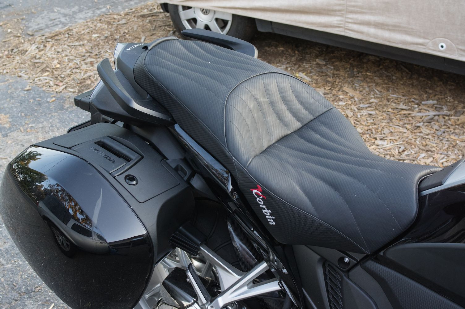

                                                                    Today is first day of vacation, which means a mad scramble to finish the packing I couldn't do on the weekend because of work, and get out of Dodge by 10 AM!
                                                                    However, to kick off vacation properly I had to take a short ride to Starbucks with the new seat first...
                                                                    We all have our own preferences. I have a preference for Corbin seats going on 20 years (since 1992, bought first one for a NT Hawk 650)- I just got my new one last night, only had a chance to ride it to coffee this morning, before we leave on our vacation camping trip for niece's wedding (GF always has busy agendas), but it delivers as expected, and also has a more built up and comfortable passenger section.
                                                                    As expected, it relieves the pressure hot spot on the two bone points at the bottom of my pelvis, and provides more front to back support, alleviating the tendency with the stock seat to slide forward and wind up flat against the tank. (they sell a lot of tank protectors because of that!). And as usual, somehow it feels like they used my butt as the mold guide, the fit is that good... even brand new- they do break in some, and feel better with passing time.
                                                                    The materials are first rate, including the custom seat pan- the stock set feels like a flimsy piece of plastic and vinyl made with cheap materials and design in comparison. Like comparing a cheap stamped frame white box woofer to the Wavecor SW223BD01.
