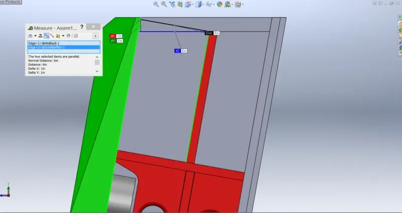

                    #1269
                    How deep is the mid chamber?
                    Cheers, Wayne
                      • 16205
                      #1270
                      Cheers, Wayne

                                #1275
                                Is this the dimension you're looking for? 6" via the model.
                                  #1276
                                  Thanks Ben, 6" it is from the front cabinet face. I'll add it as a note to the mid shelf pdf as a correction. I could have been sneaky and left it out as it is only going to fit right slid back from the front and making contact with the top on at 6" from the front of the cabinet. This after the 10 deg. edge cuts. Hehe.

                                    #1277
                                    Yes, that's the one! Good thing I didn't glue it yet.
                                    Thanks, Wayne

                                      #1278
                                      Thanks, Wayne
                                      You'll see when you assemble but the height is the critical dimension because of the angles it will only line up in one spot. A half inch wouldn't have hurt you
