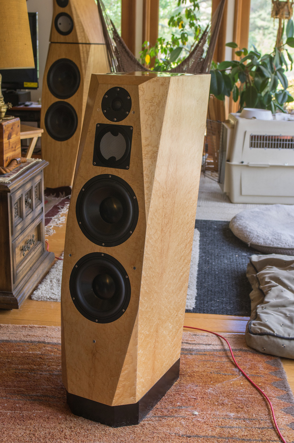

          Let's get back on topic. the next section probably isn't very needed for the hard core DIY guys, but is provided to show how I terminate the wiring leads and have been putting things together in my own OCD kind of way.

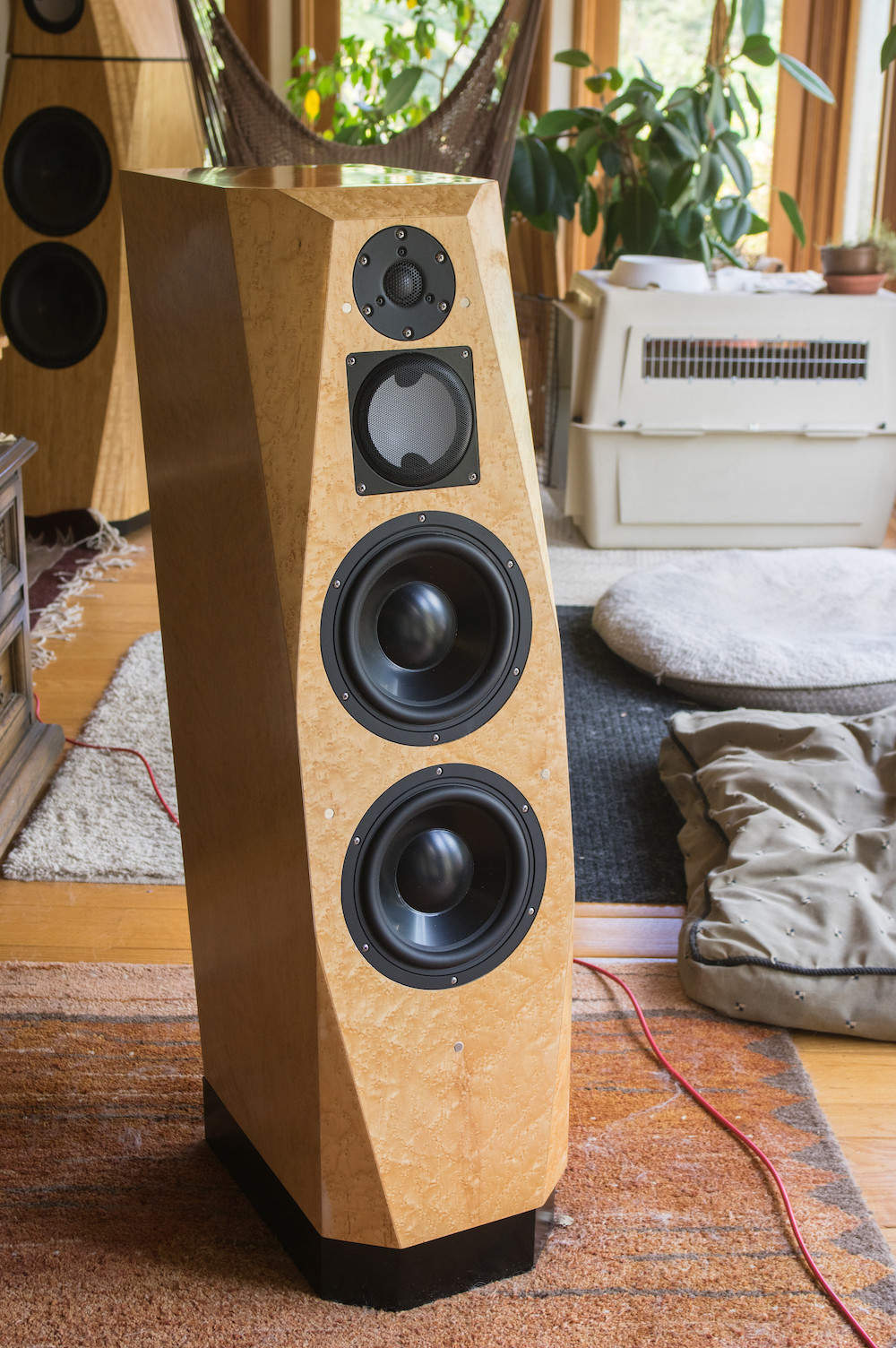

          Cardas SE11 stripped for the tweeter connections, and AWG bus wire used to create "pigtails".
          The finished cabinet is QUITE heavy, considering the size! I'm sure those Wavecor woofers have a big role in that. Last step is going to be wiring up and mounting the crossover base plate- stay tuned, later this weekend.
          Love the details! Looking forward to seeing how your base came together.

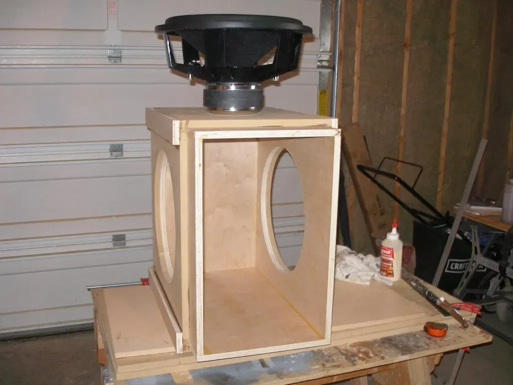

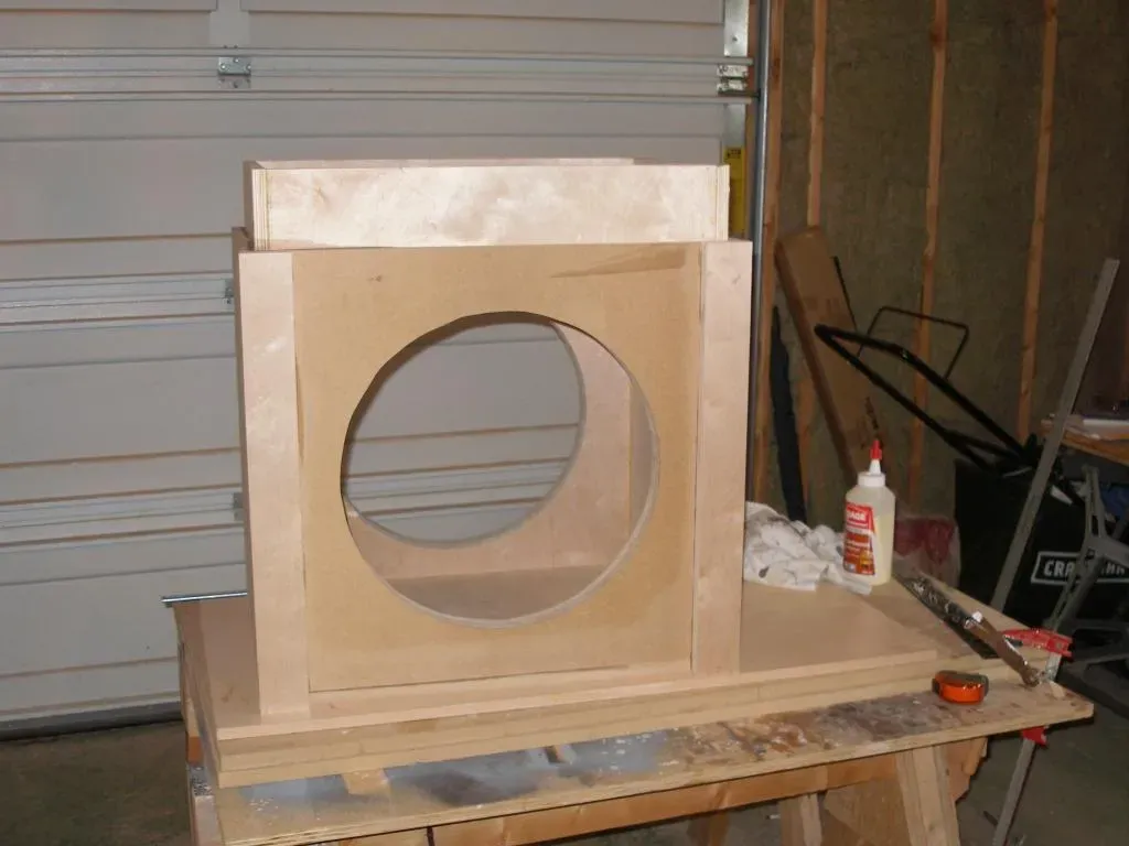

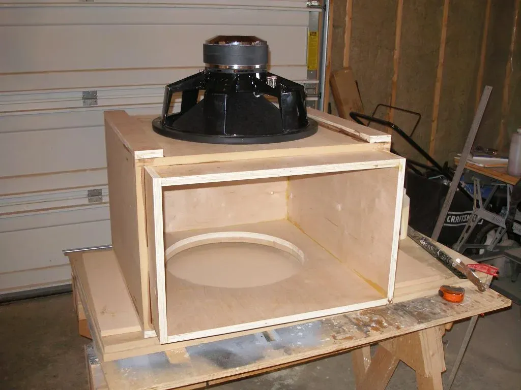

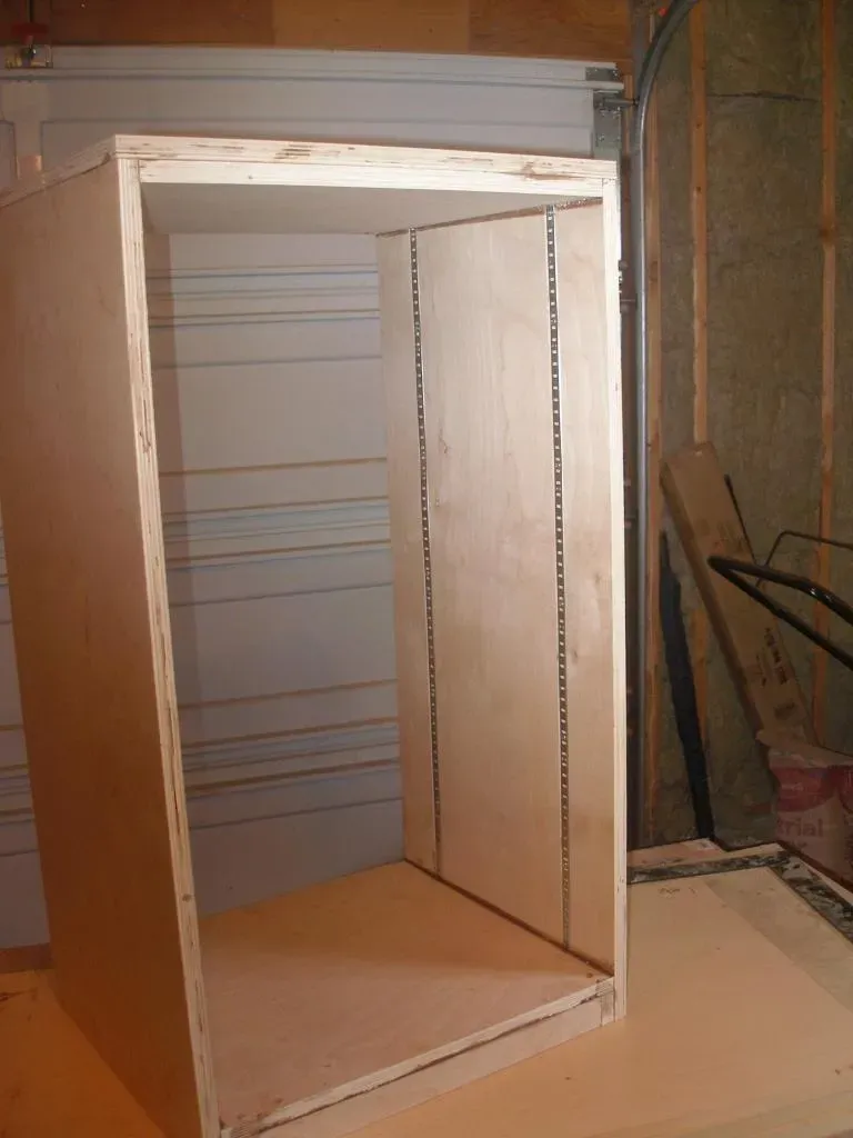

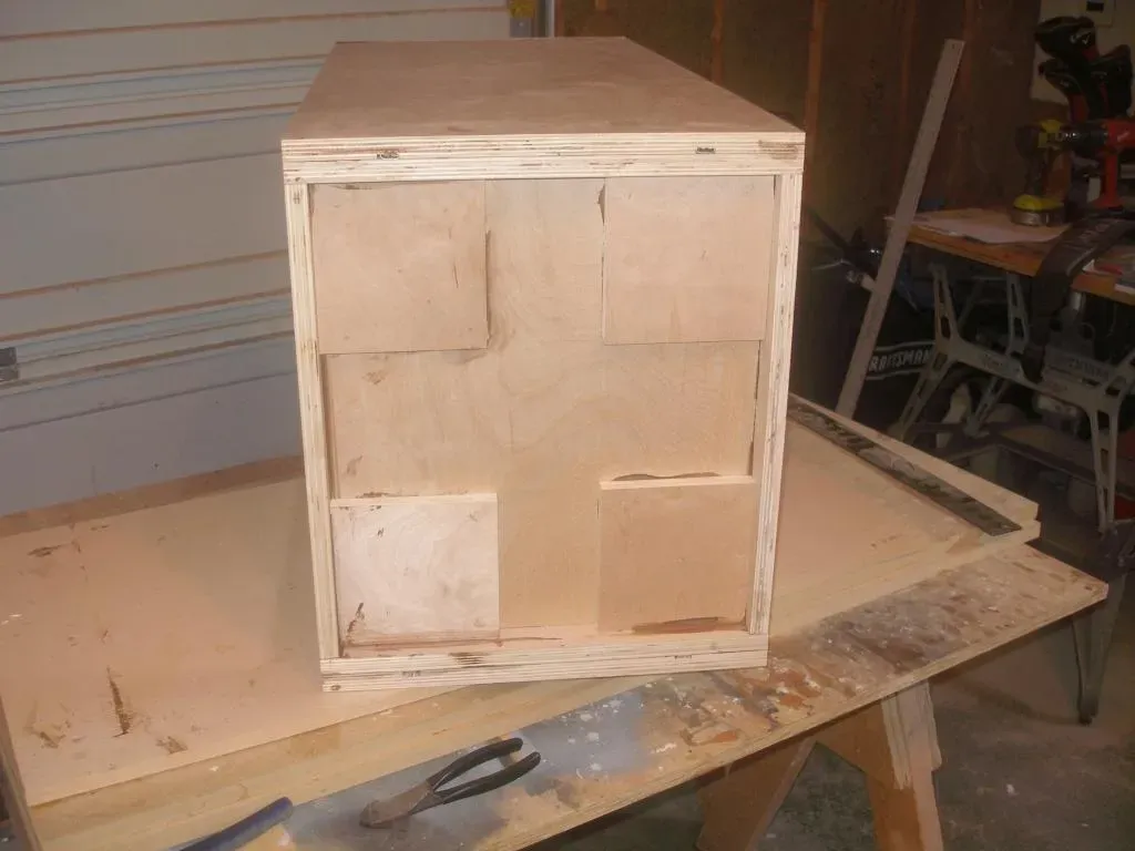

                    Hope all had a good 4Th. A little slow going on the IB manifold as I seem to have lost my wrenches for the table saw or sent them with the old router and case with Ben to Cal. I eventually end up using a c-clamp and 7/8" to change blades.
                    3/4" shop grade ply 13 layers, rapped in 3/4" MDF with some strapping.

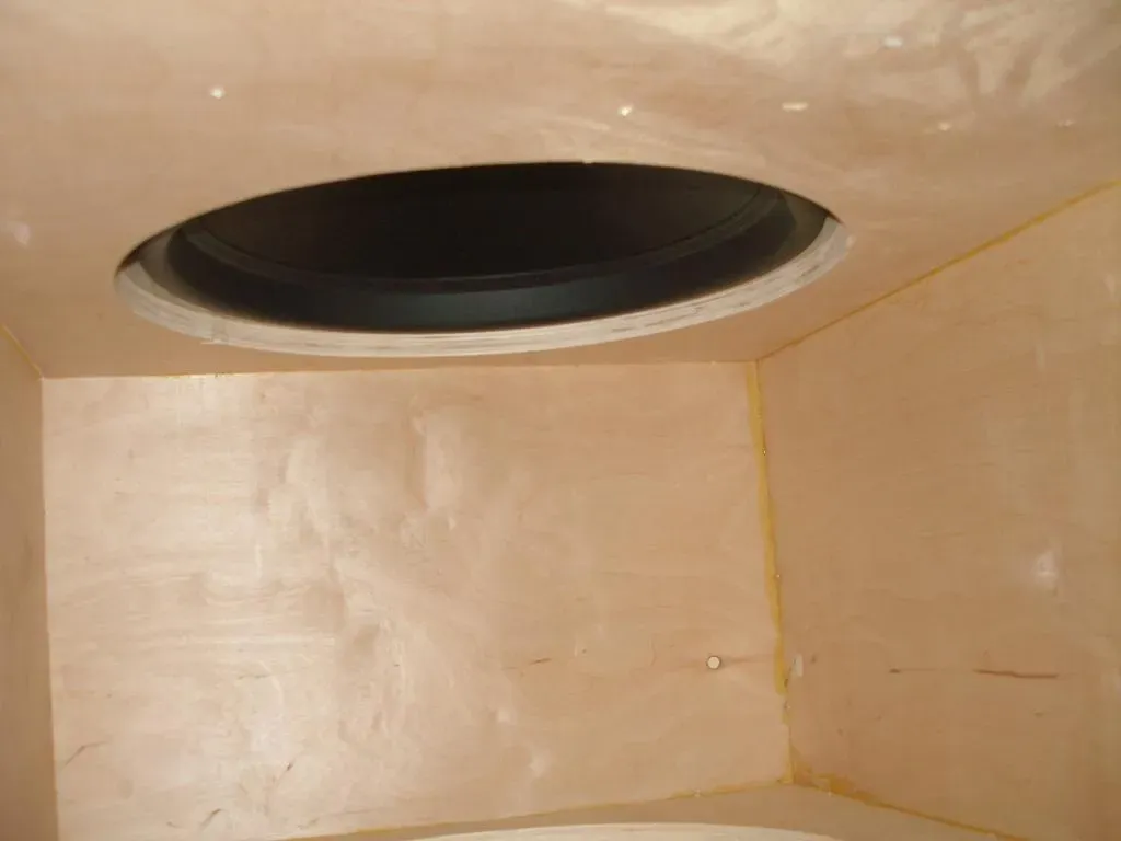

                    Drivers are Stereo integrity HT 18". Manifold will be orientated this way going through the framing to flush with the drywall.
                    Not sure if I'm mounting on the outside or sliding each one in and mounting on the inside.

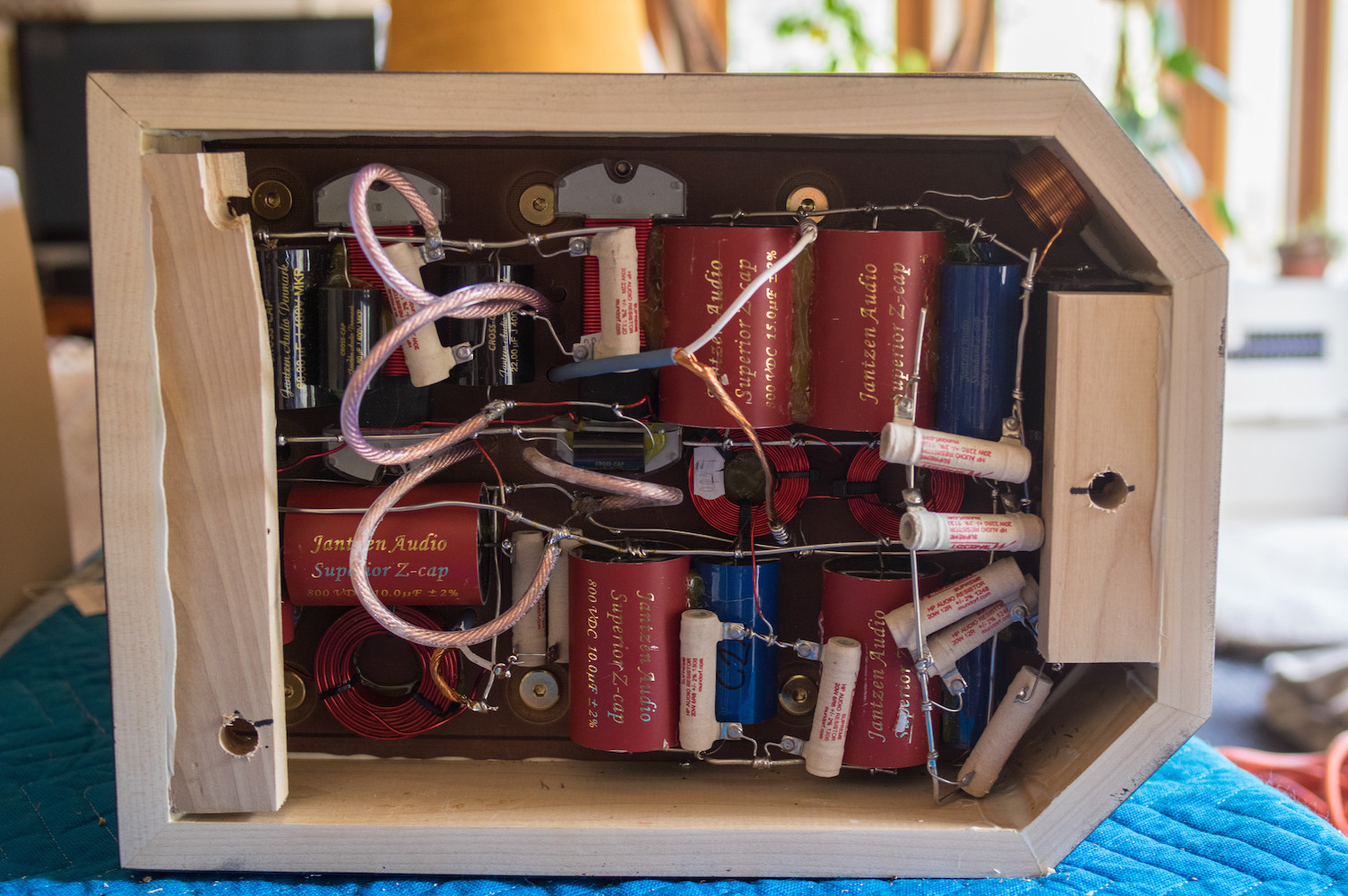

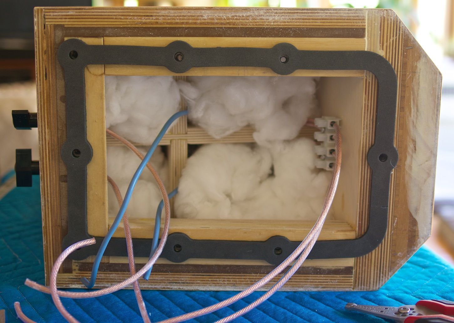

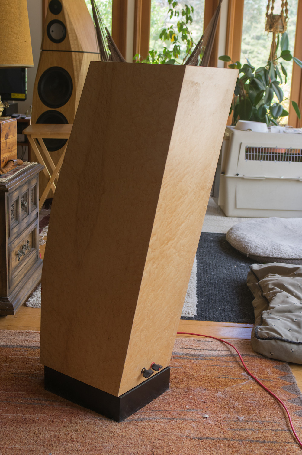

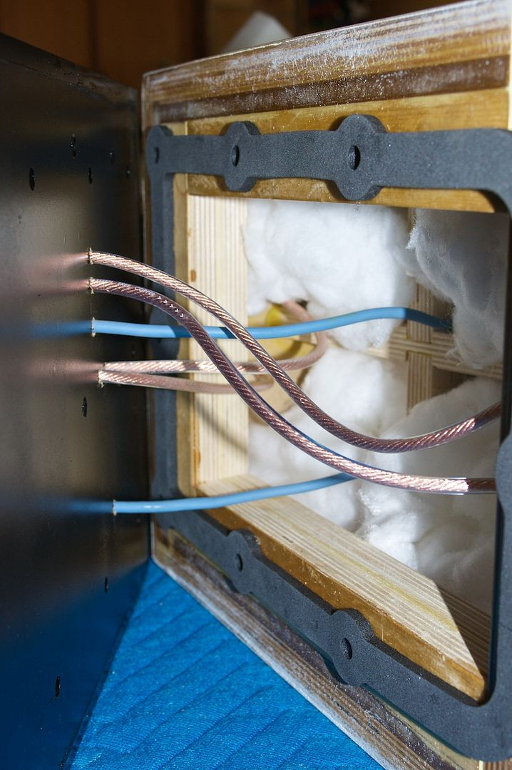

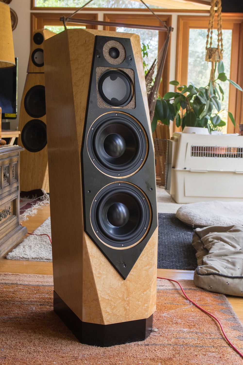

                          Here's how things have been going on the cabinet in process:

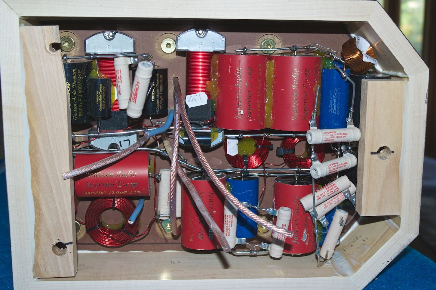

                          This view of the bottom shows the stuffed cabinet with all leads ready to insert in the baseplate, as soon as the holes are drilled. There is some method to my madness, as the cables will be going into locations next to where they must connect. Silicon seal was wiped on one side of the gasket then it was positioned on the bottom of the cabinet- this held it in place nicely.
                          After drilling the needed holes just large enough to pass the different size round cables, then they were routed through from the top side of the crossover-base assembly.
                          Then 1-1/2" long hex head furniture connector bolts were used to mount the base plate, using a 4 mm allen head T-wrench with access holes drilled through the front and back support plates (this part wasn't terribly well thought out in advance of construction- afraid I'm sort of making it up as I go along... )
                          What isn't obvious looking at this picture is that the overall ground bus is arranged as a U shaped loop, with the bottom of the U towards the left (laid on it's side), and the top side is going to the LF crossover, and the bottom going to the midrange and tweeter- input connection bus is basically done the same way, this will minimize voltage drop/interactions between the two sections, I think. Sort of like a quasi star ground setup.
                          Note that none of the resistors and even one of the coils are not glued down yet, pending evaluations and the final seal of approval!

                            Wow Jon, I'll give you credit when you want to make something fit your going to do it. :lol:
                            One thing you and Ben used all 8 base mounting points I thought that was over kill I only used 6, should have mentioned that It may have given a little more space. Why the block on front and back of the inside bases? I love the base driver termination point, I usually just come off the xover board and solder 3 wires together. Going to use that thanks! Should be fun trying to get ours in on top of our bases, may still do 2 boards though. Looks like a lot of fun "when can I try Dad, when?". Haha

                              This is a great build(s). I love seeing the collaborative effort really paying off. The three sets I've seen on here look fantastic :T I like all three choices of veneers. The proportions of the cabinet shape and drivers are spot on. Thanks for all the detailed info...it is very inspiring. I can't wait for the finale.

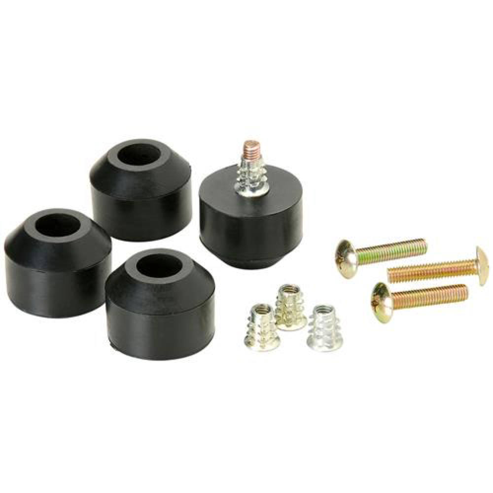

                                Those plates were put in pace for mounting these Dayton Audio feet, same type as used in their subwoofer cabinets, which are sold with threaded mounting inserts in sets of four:
                                This are a little flexible, but are a very hard rubber/plastic combination- doesn't abrade easily, quite study. They are whats on the bottom of the Isiris right now...
                                Just one option to explore - on a carpeted floor I'd probably use spikes, and I may switch to some of the Acoustic Revive isolation thingies with the crystal sand as energy absorbers, to decouple the bass from the floor a bit.

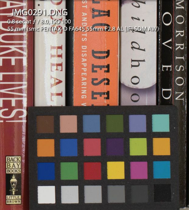

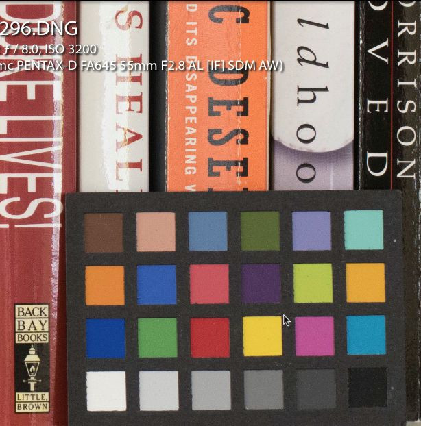

                                                          A high res crop via my Virtual Avenue account
                                                          OK, this is just to show you a 100% crop of a portion of the lower right of one of the images above; kind of like listening to 1 minute of a song in high res through a big DAC.... :W
                                                          Compare with the second image in the post on pictures above that I did...
                                                          Mind you, you'll likely have to resize your window to get a 100% view, and on a large display- this fully takes advantage of a Macbook Pro Retina display that is 2880X1880 in resolution.

                                                                      One of those weekends... warning- larger pictures (file size)
                                                                      Geez, you ever have one of those weekends?
                                                                      I spent MUCH more time on the Honda Element forum this weekend than HT Guide, but at least now I have a full DIY guide for how to tear down the driver door and have a second source version of the original OEM window regulator part on the way, at substantial savings. Hopefully I've turned what would be a $300-$400 bill at the dealer to a $60 part order.
                                                                      That what quite a diversion from my plans, and then, of course, I had a couple of unexpected "Honey must do's", a third to do after dinner this Sunday evening. Well, that's how it goes.
                                                                      However, I did finish up the initial wiring up of that cabinet and crossover... (slow work takes time)
                                                                      Click image for larger version  Name:	IMGP0597.jpg Views:	11 Size:	412.7 KB ID:	934462
                                                                      And it's actually sitting up and ready for measurements- (I'd hoped to get an impedance plot this evening, but Honey Do Blogs will win instead...)
                                                                      They're not waxed and buffed out, but still look pretty good. Have all the tools and supplies now to do that.
                                                                      Click image for larger version  Name:	IMGP0600.jpg Views:	11 Size:	411.0 KB ID:	934463
                                                                      Click image for larger version  Name:	IMGP0604.jpg Views:	10 Size:	454.4 KB ID:	934464
                                                                      Click image for larger version  Name:	IMGP0605.jpg Views:	11 Size:	463.8 KB ID:	934465
                                                                      Click image for larger version  Name:	IMGP0610.jpg Views:	11 Size:	466.9 KB ID:	934466
                                                                      These pics were hosted on my Virtual Avenue web site account; I'm getting sick of the compression and fuzziness that Photo-bucket puts on everything- it's the MP3 world of picture sites.
                                                                      Did I mention these things are heavy? Oh, they're heavy... feel like a solid block of cubic unobtanium. Slapping or beating on any of the enclosure walls feels like you're wacking granite - the harder you hit, the more you'll hurt your hand. NO resonance or sound from the walls, otherwise.
                                                                      Next weekend should have tech data...

                                                                          Ahh good old Honda window problems. I'm pretty sure I've had to do something window related on every Honda I've ever owned. Everything else works like a top but the windows.
                                                                          The speakers are looking sharp! Heavy is right, I find them almost immovable with the solid bases and drivers installed at this point. They will be downright dangerous if I put spikes.
                                                                            • 1677
                                                                            #802
                                                                            Those are coming along nicely indeed and certainly look like they mean business with the light reflecting off the fronts in those angled shots.

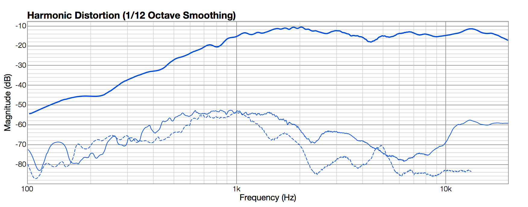

                                                                                      Seeing the Be tweeter reminded me of this website that I have perused a couple of times.
                                                                                      There are lots of measurements there for a large number of tweeters, mids and woofers. The one tweeter that jumped out at me was the Audax one.
                                                                                      Very low distortion indeed.
                                                                                      And then I found a retailers website that actually has some of their own measurements on it with their own distortion plots! This was quite refreshing I wish more would do this. (I wish they'd measure more!) But one driver that they happened to have measured was the Magnesium dome tweeter from the same range as the above Audax.
                                                                                      These seem to follow a different trend from the newer scan speak offerings in that they do not have particularly high HD2 levels. I remember you mentioning that you'd prefer if if scan changed the way they optimised their suspension and motor design to get the HD2 levels down a little and I tend to agree. So I saw these and thought of you.
                                                                                      Do you have a pair of those gold Audax drivers? I have some vague memory of having seen you post a picture of them before, not that you need more drivers to try and not that I do either, I've got several pairs of tweeters sitting on the shelf, but these did intrigue me and they don't cost ridiculous amounts either, plus I think you can buy replacement domes.
                                                                                      I used to, don't remember who I sold them to... I used to use a lot of Addax in the 70's and 80's.
                                                                                      I wish more drivers (especially Scanspeak) had HD2 to HD3 balance more like this:
                                                                                      JDT-1024
