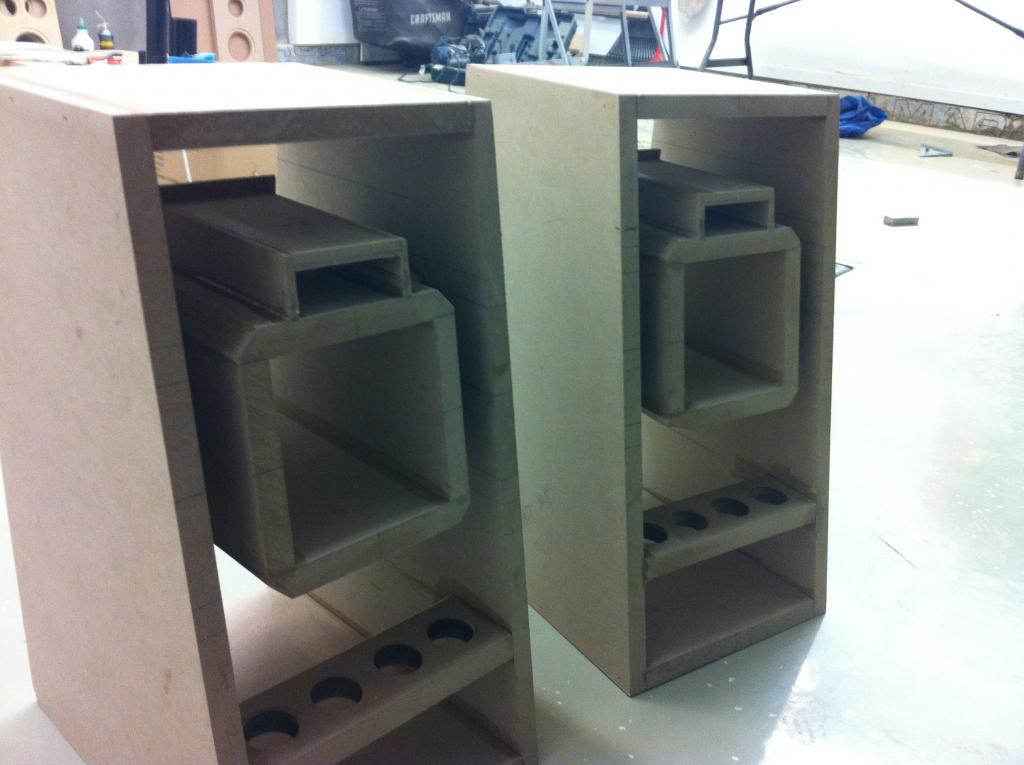

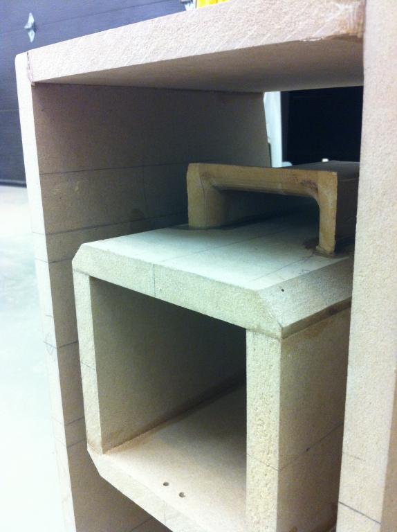

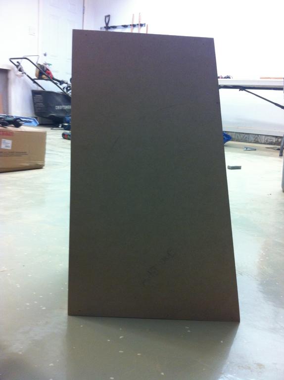

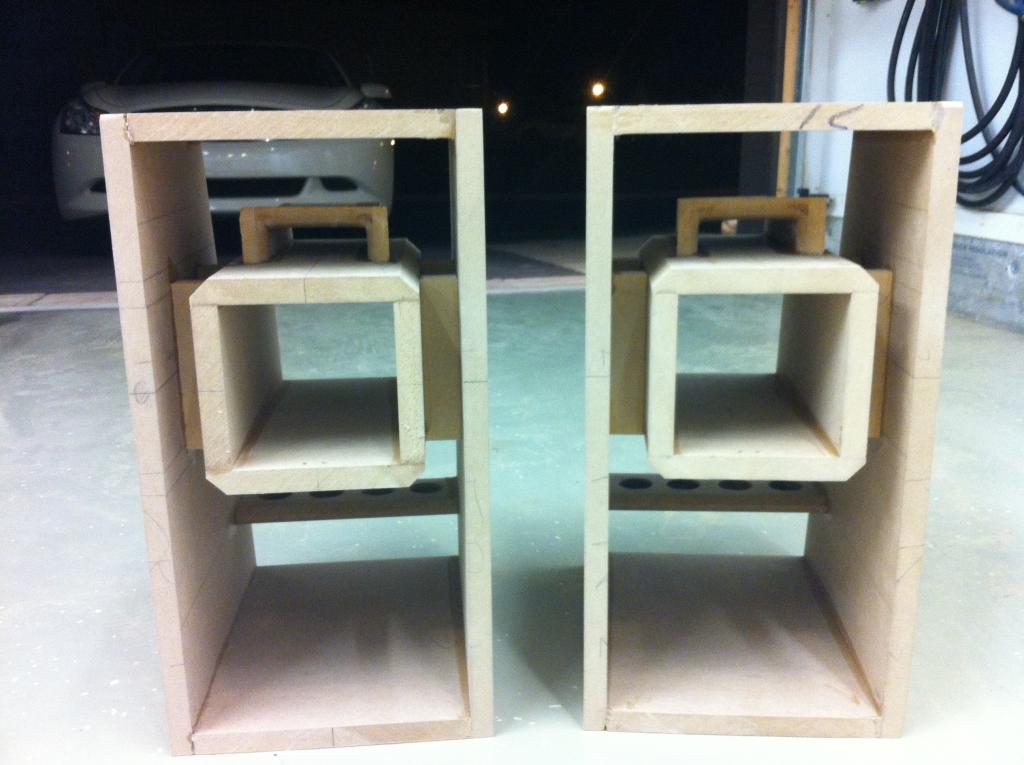

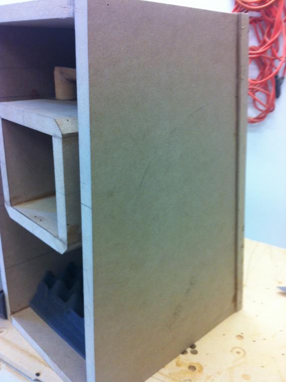

    Wanted to build the Monitors ,but did'nt want just a rectangular box, so I changed the shape slightly by slanting the back .
    Int Vol is identical ,..Width is the same ,..Spacing between drivers is the same,..Tunnel center is the same length,..the only difference is now the box is at 20" height.
    I took 1'' off top and 1" off bottom.
    Top is 11" deep ,..bottom is 15" deep.
    I replaced the round port with a slot port of the excact same Area 1"x 3.14" sq in, and shortened length by 1/2 " for end correction.
    Click image for larger versionName:	IMG_2110.jpgViews:	1Size:	46.6 KBID:	871166
    Click image for larger versionName:	IMG_2111.jpgViews:	1Size:	64.6 KBID:	871167
    Click image for larger versionName:	IMG_2112.jpgViews:	2Size:	29.9 KBID:	871168
    Click image for larger versionName:	IMG_2113.jpgViews:	1Size:	31.2 KBID:	871169

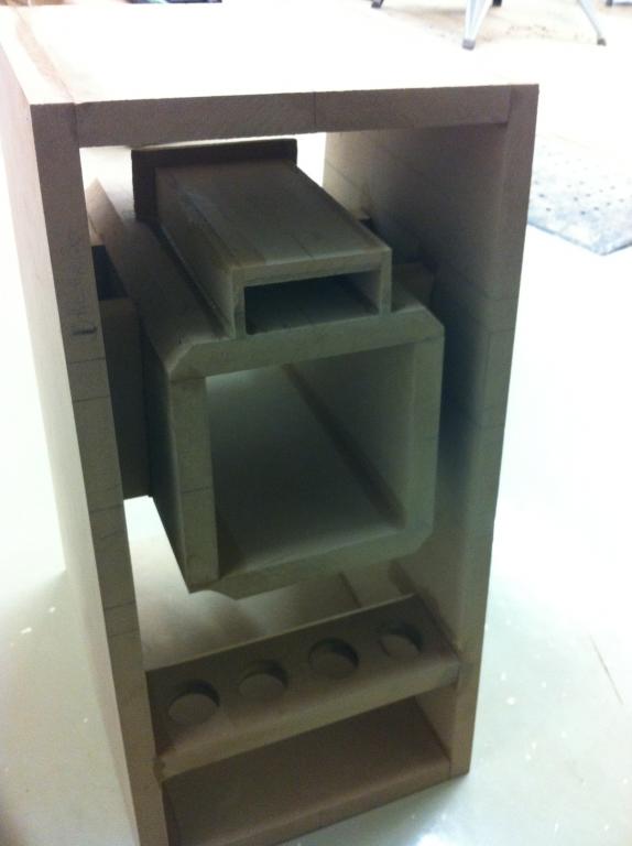

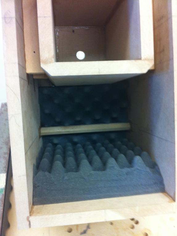

      Got the oversized back glued on, ready for a flush trim and started to insulate. I am wondering if the Eggcrate foam insulation Meniscus sent for bottom woofer section is to thick, it's 2.25" ?? ...I have 1" foam for tunnel.

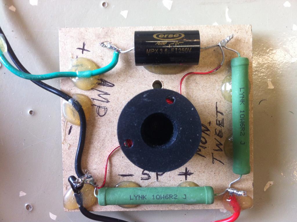

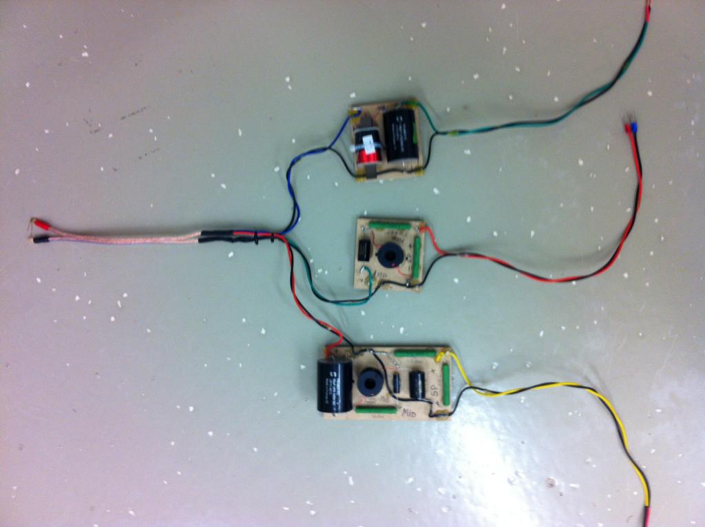

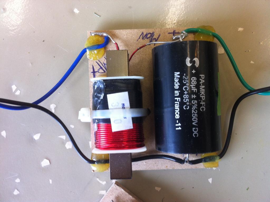

          Completed crossovers!

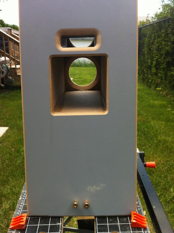

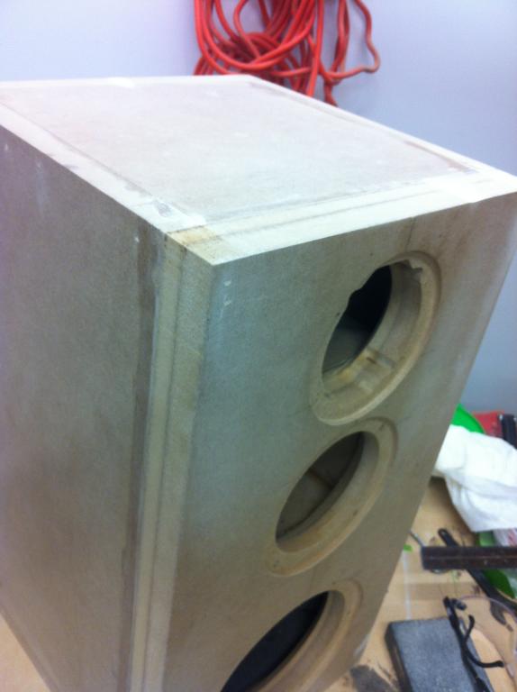

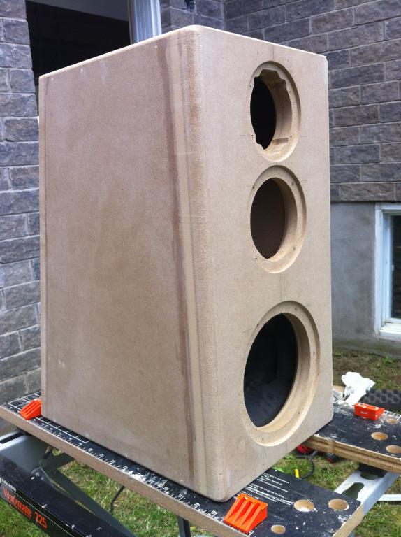

            Little update:
