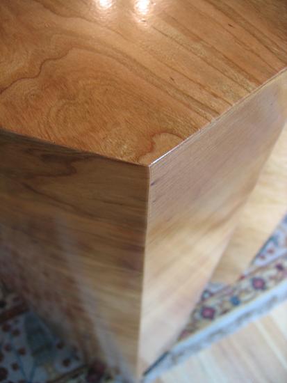

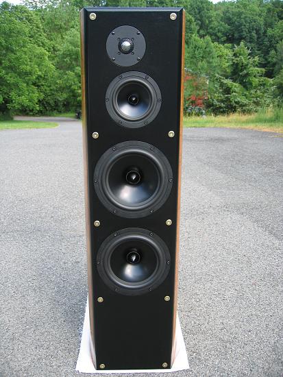

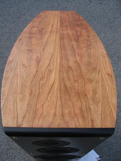

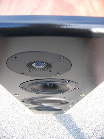

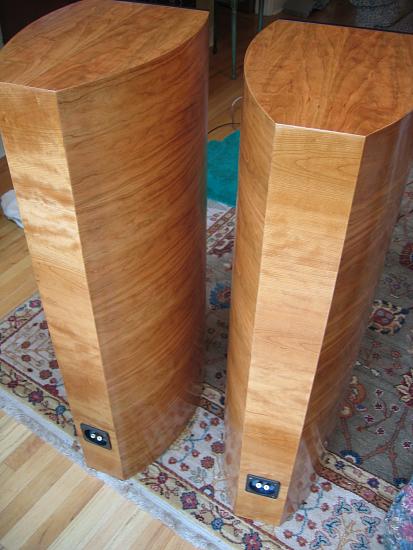

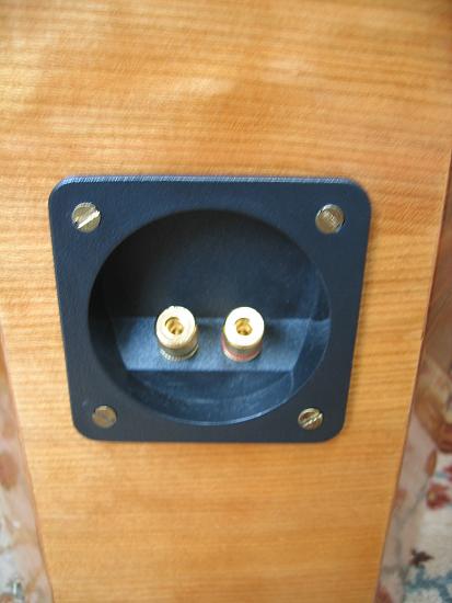

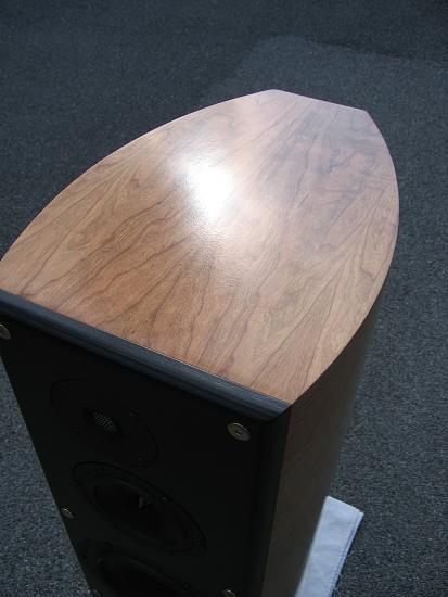

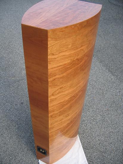

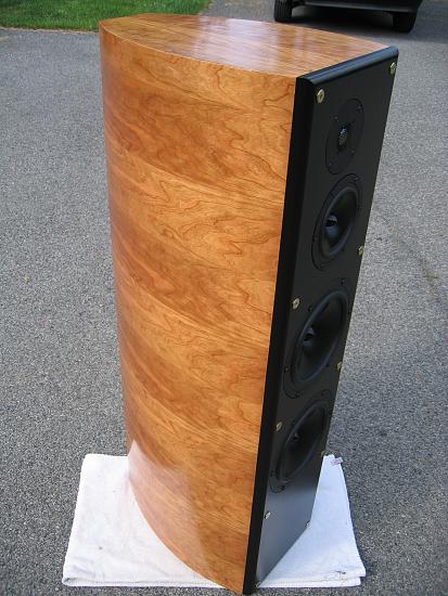

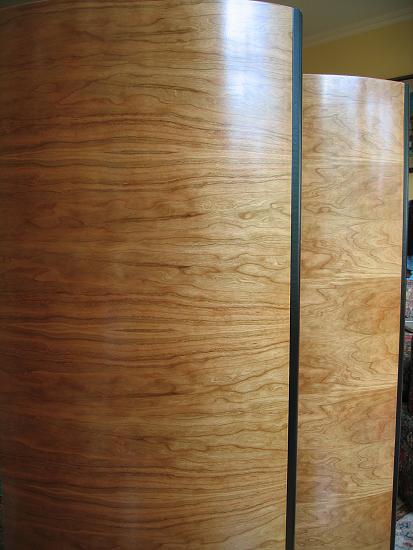

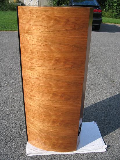

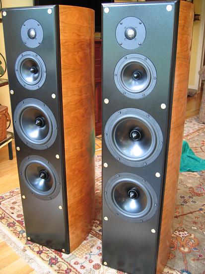

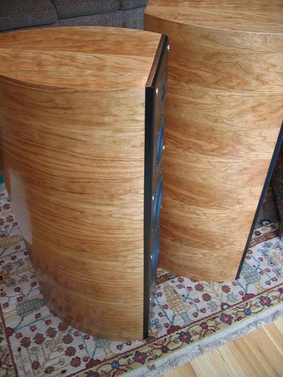

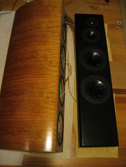

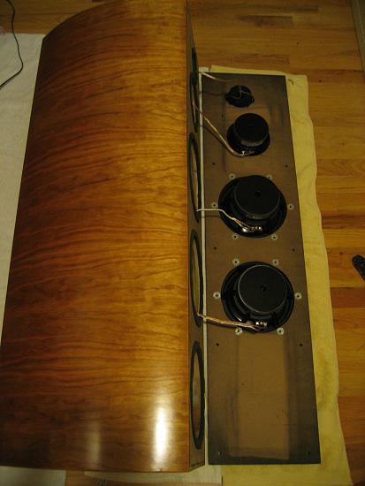

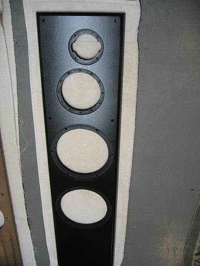

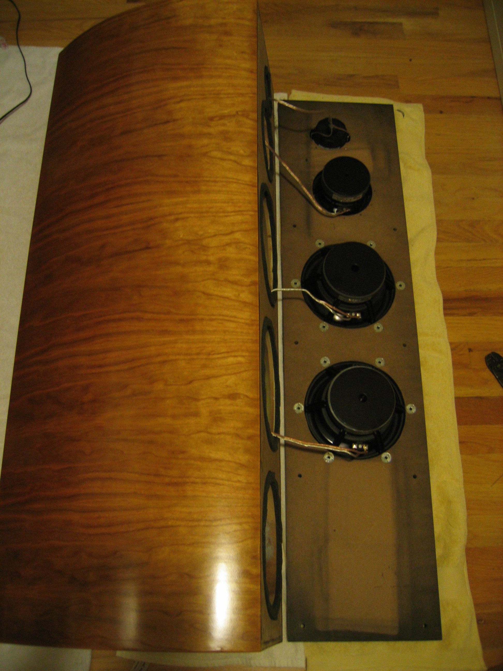

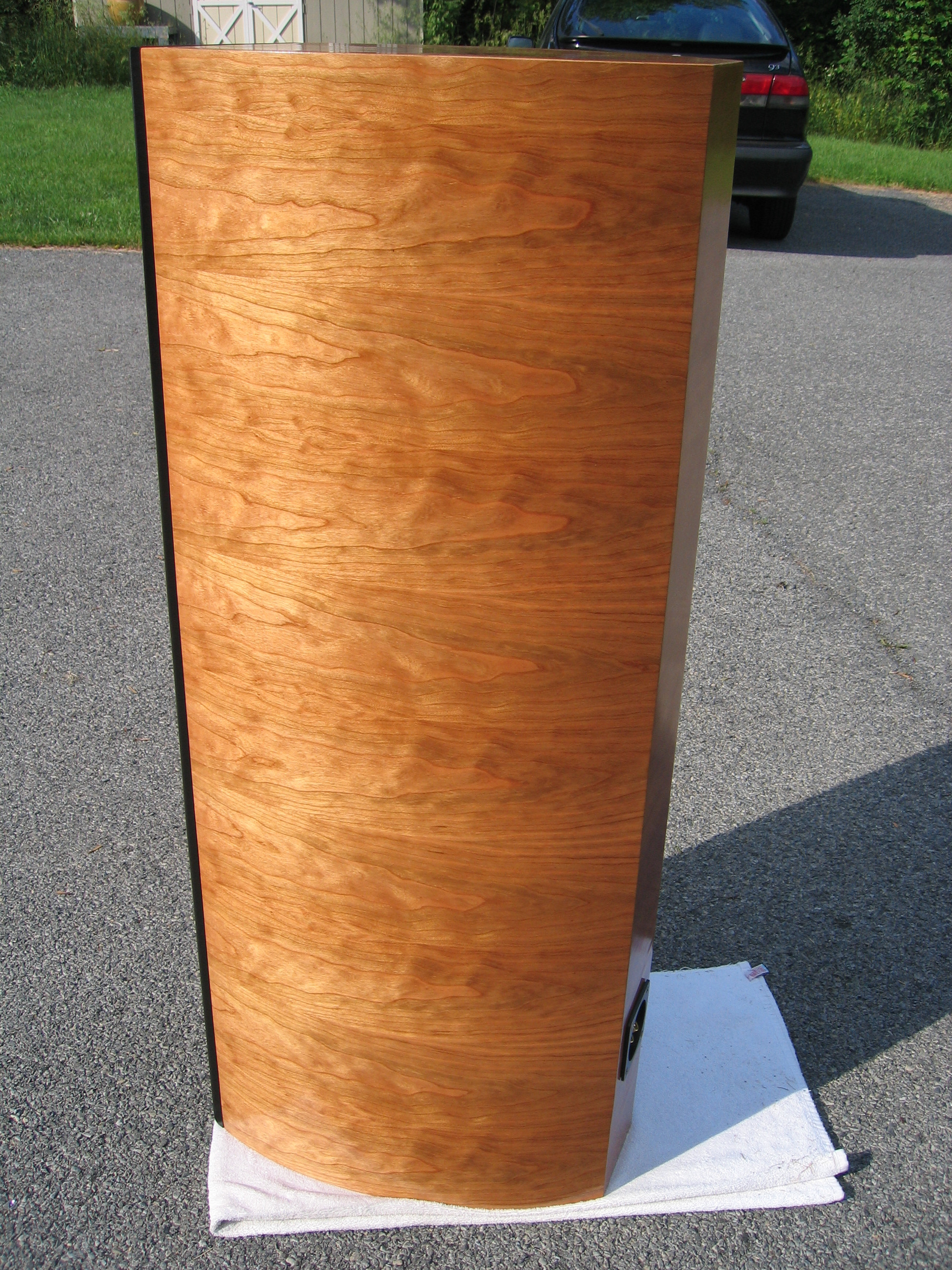

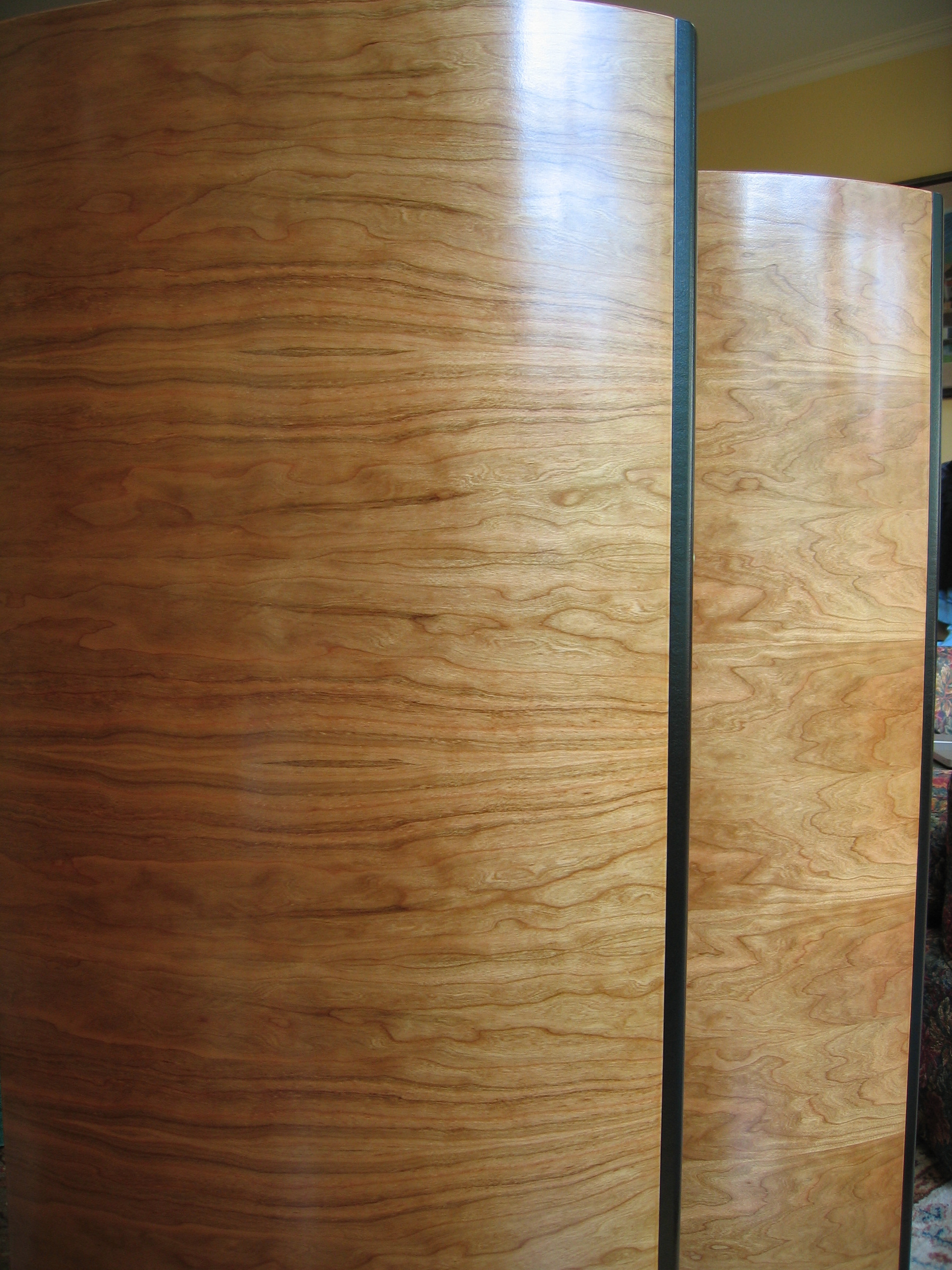

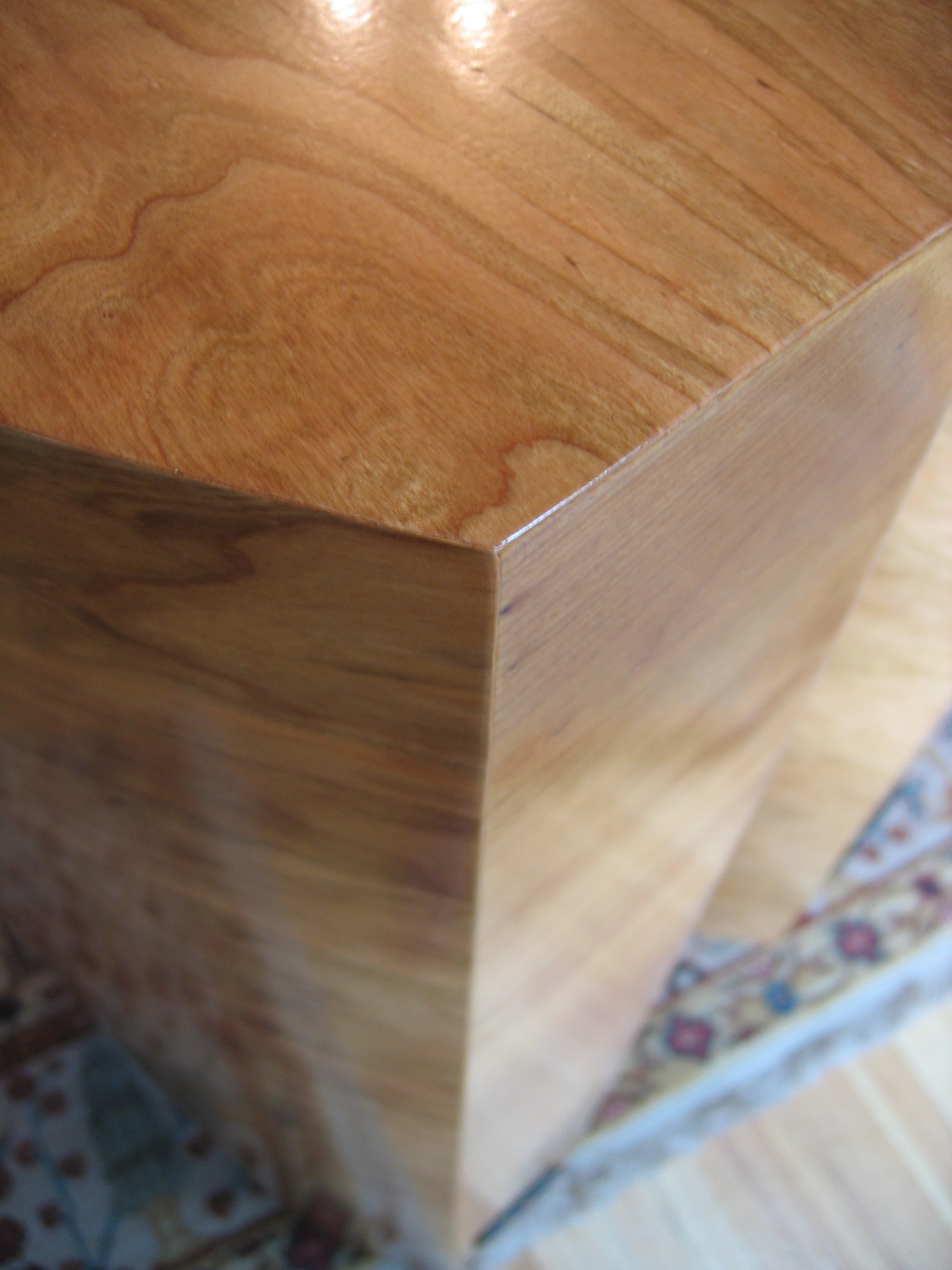

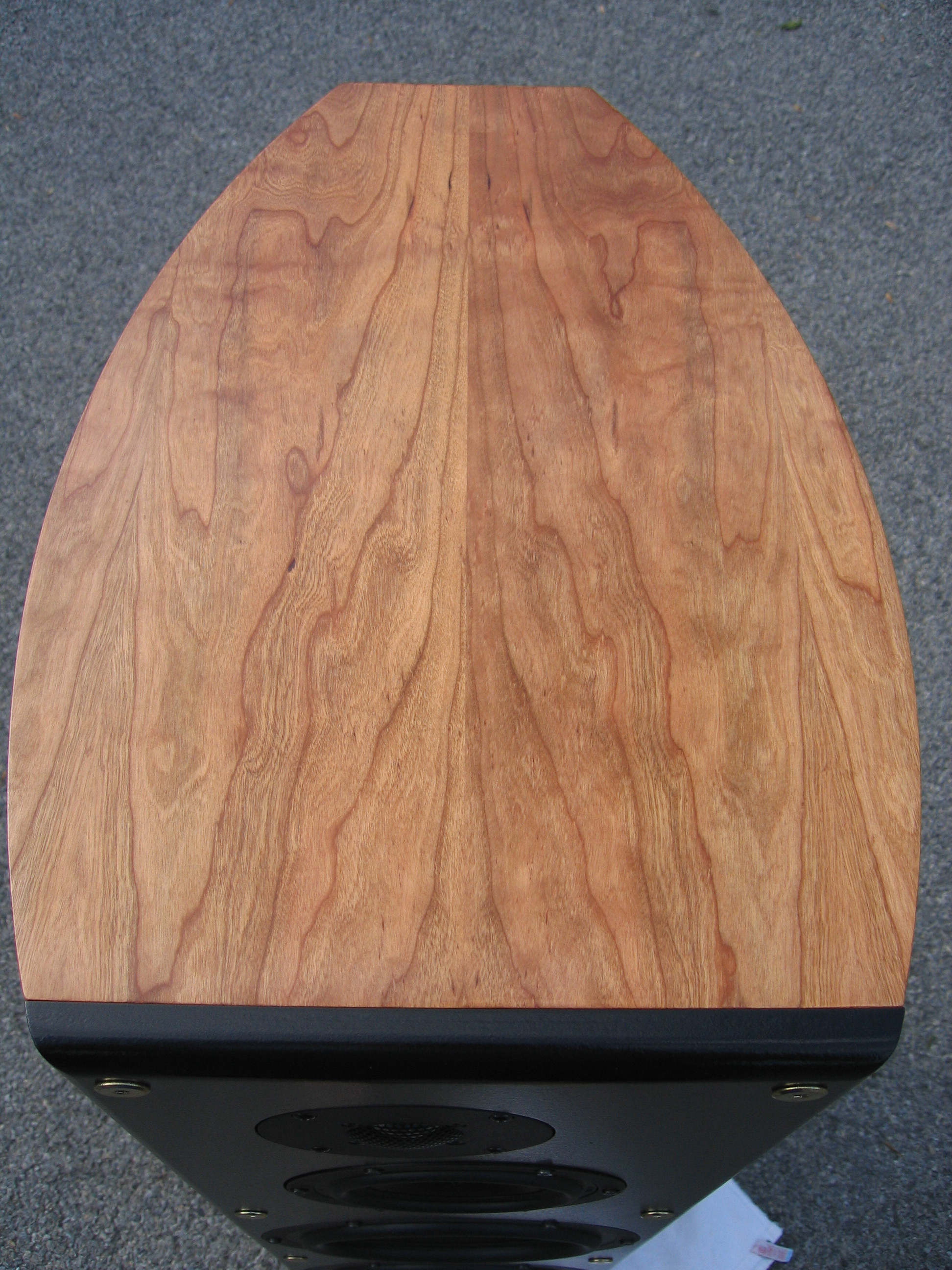

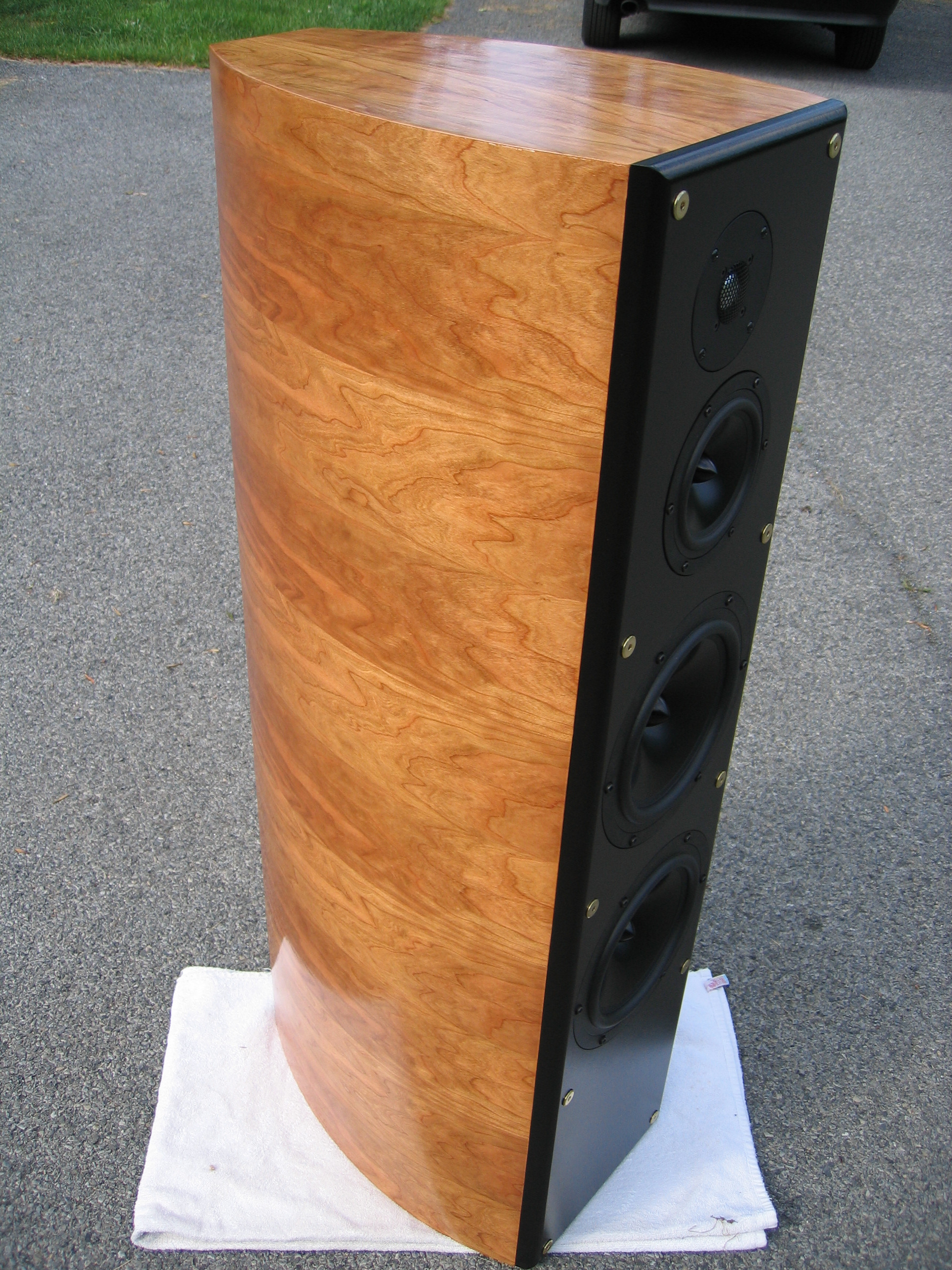

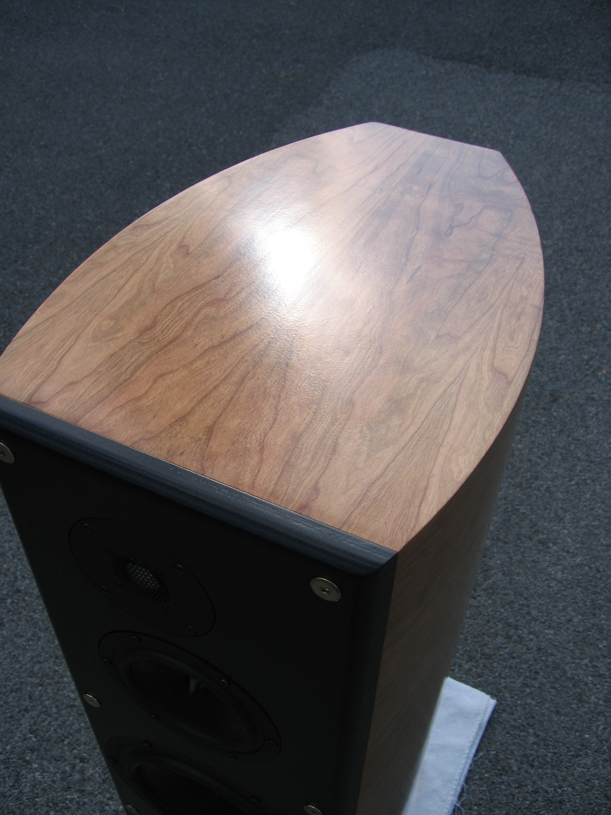

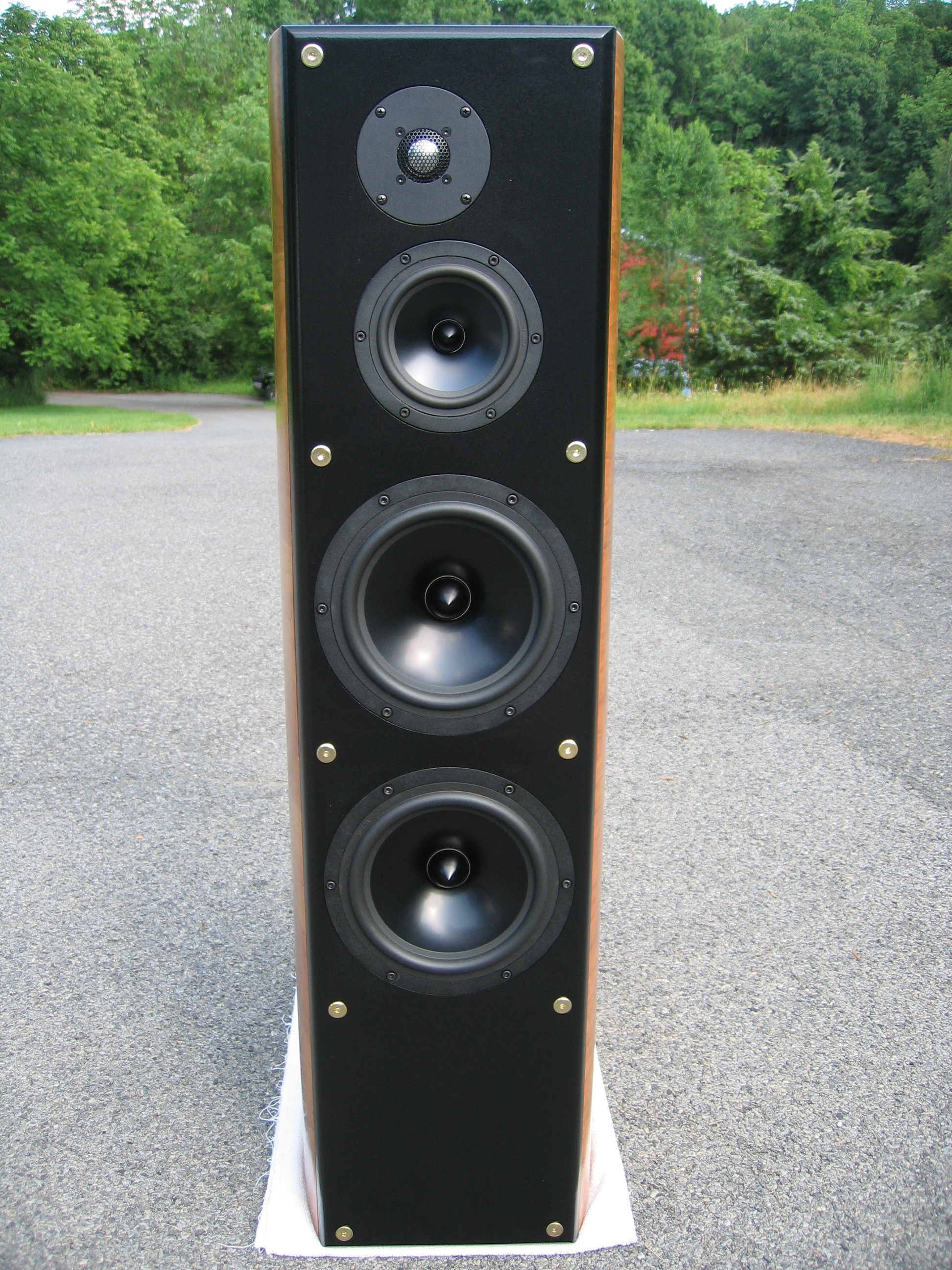

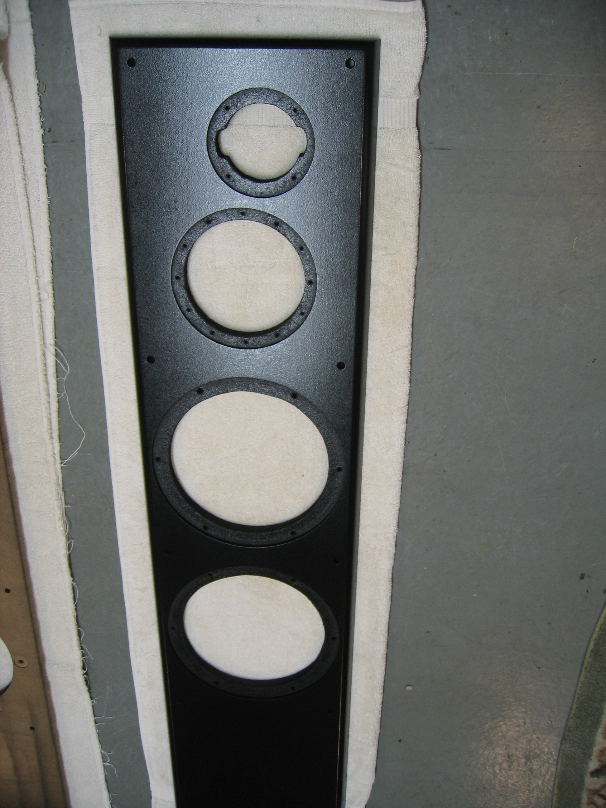

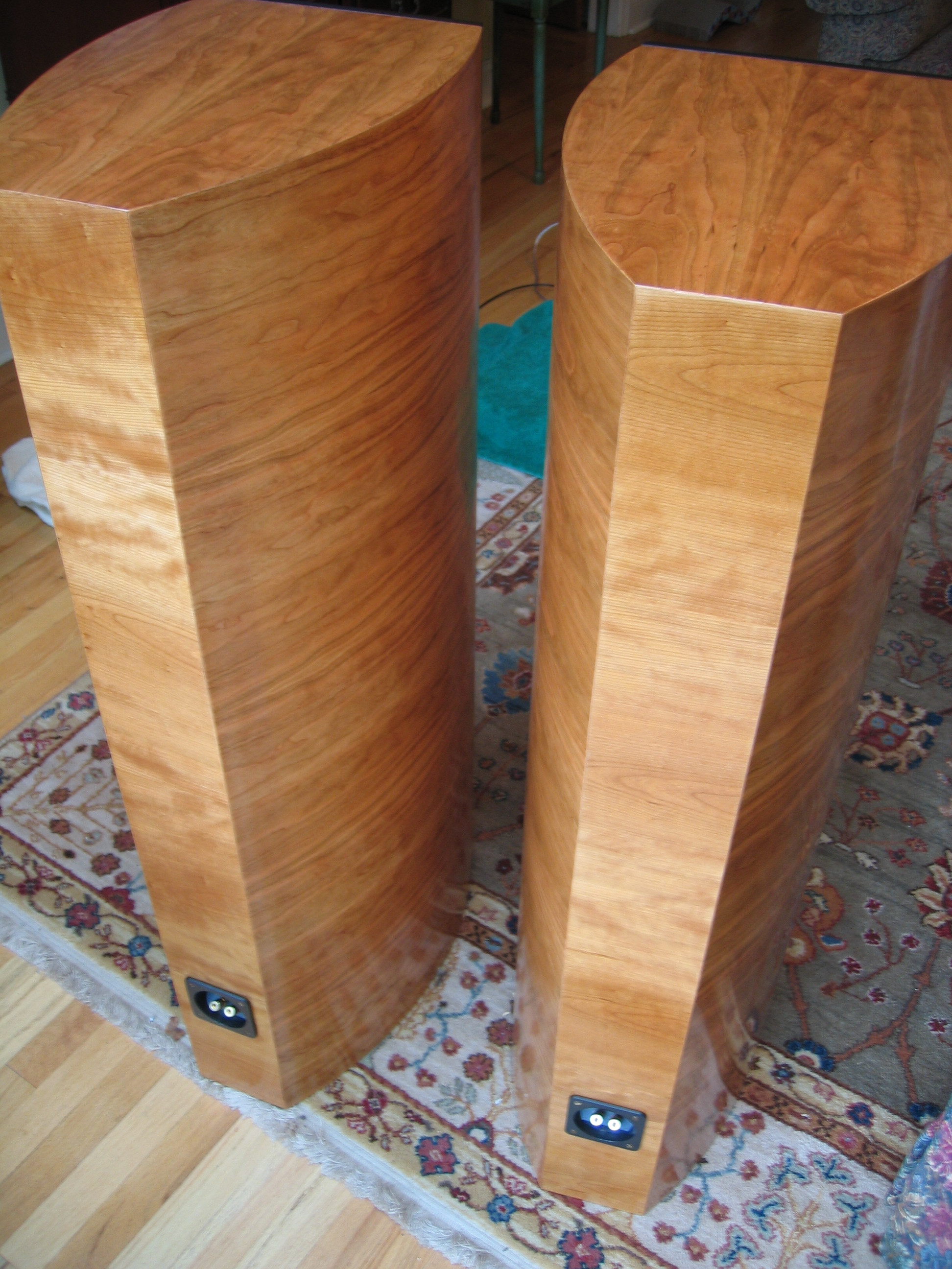

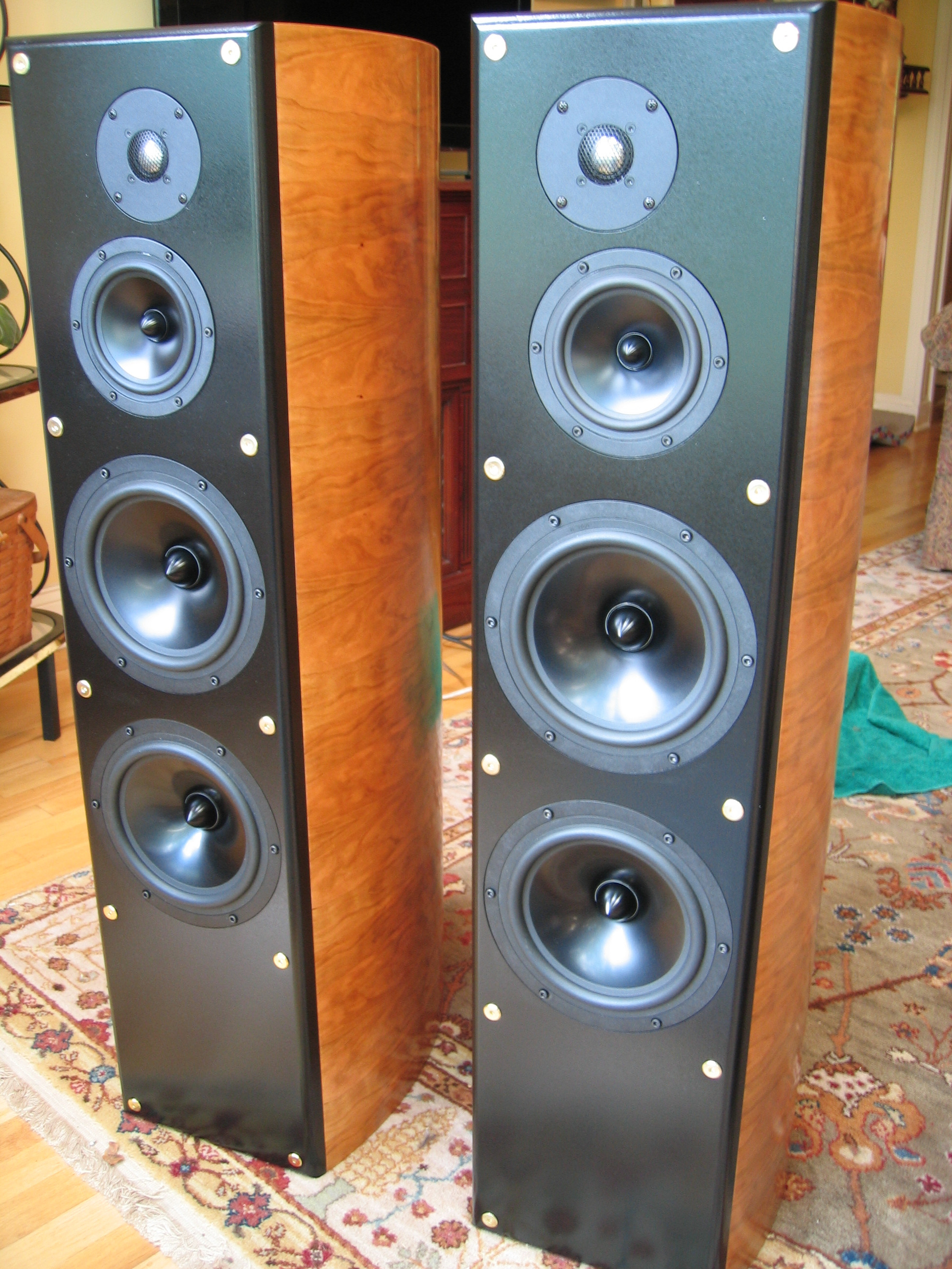

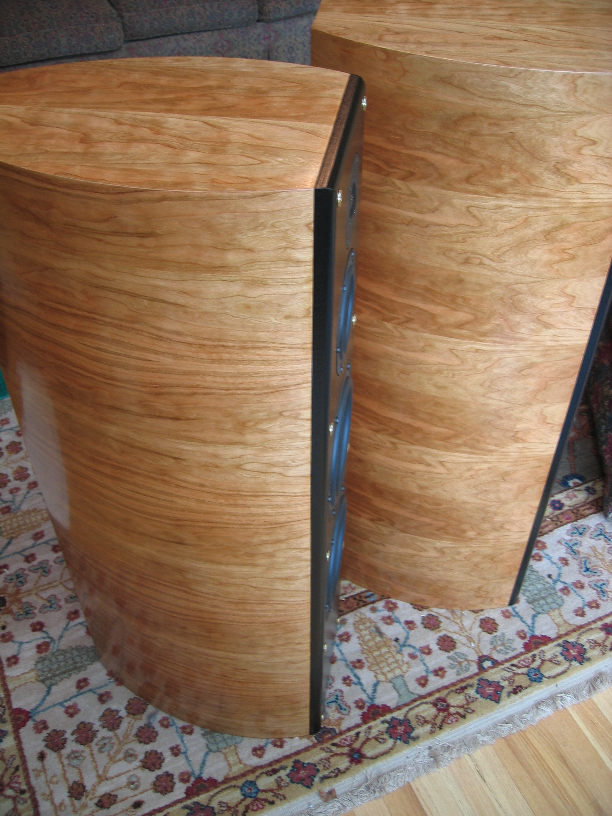

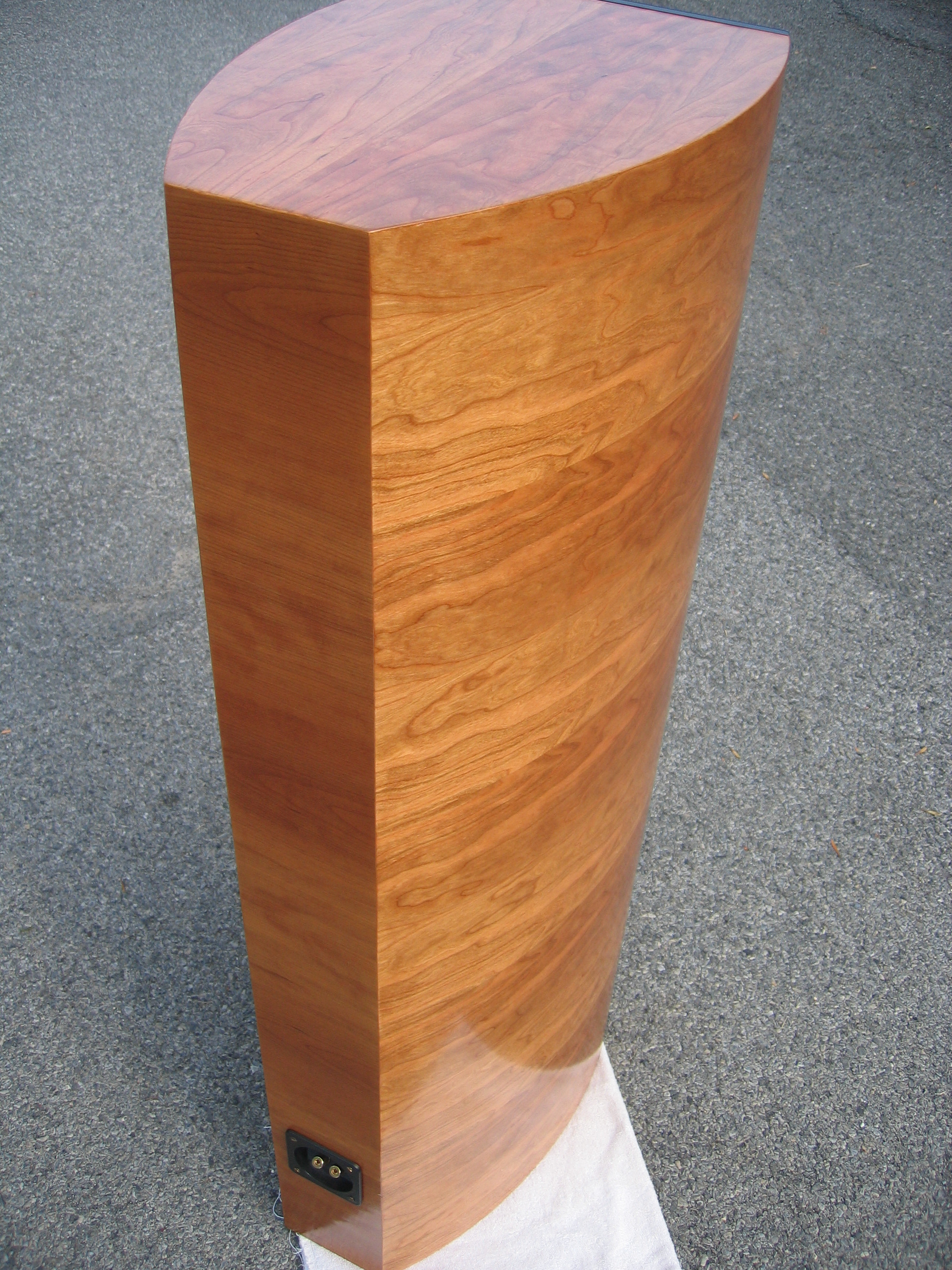

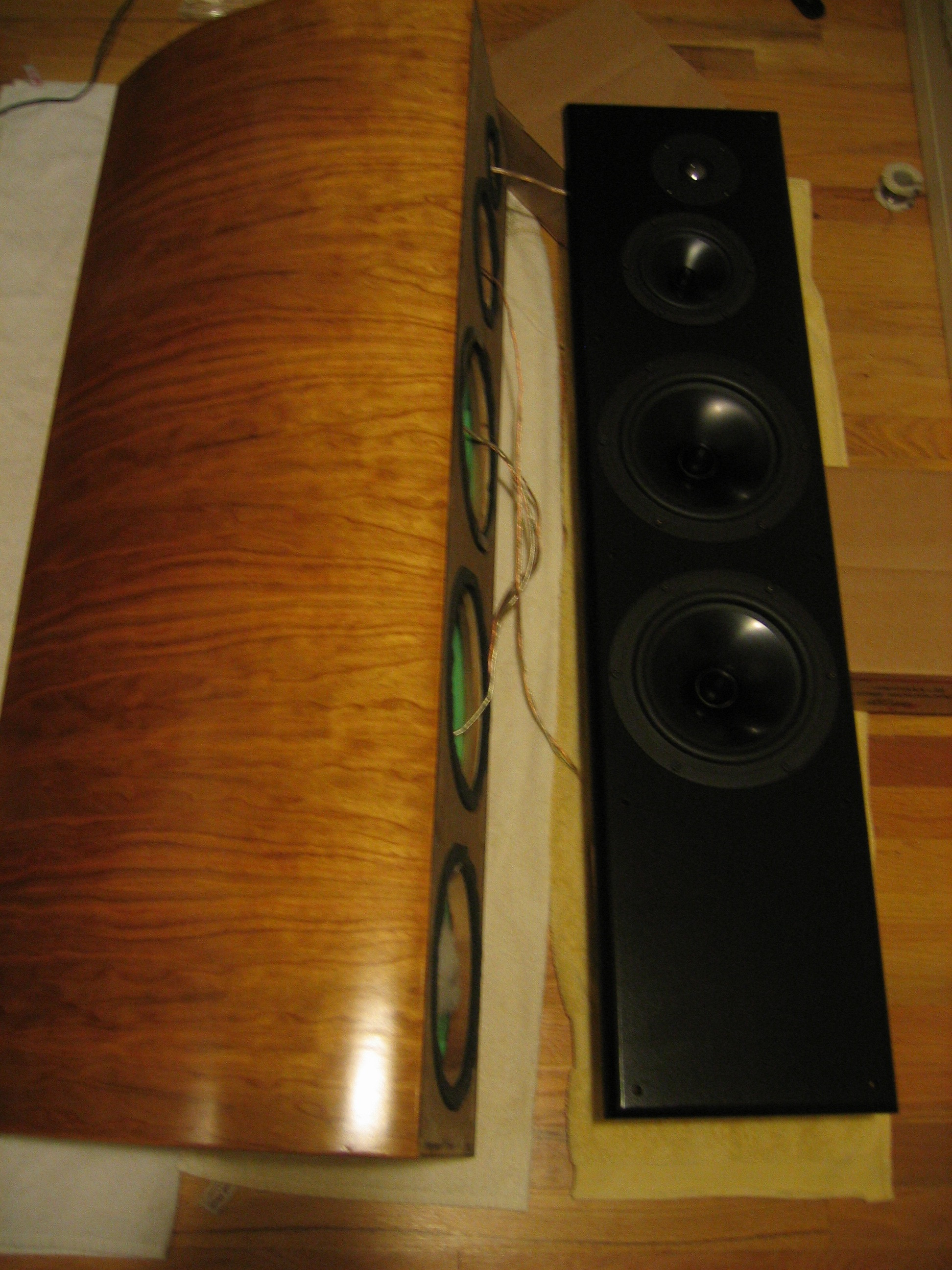

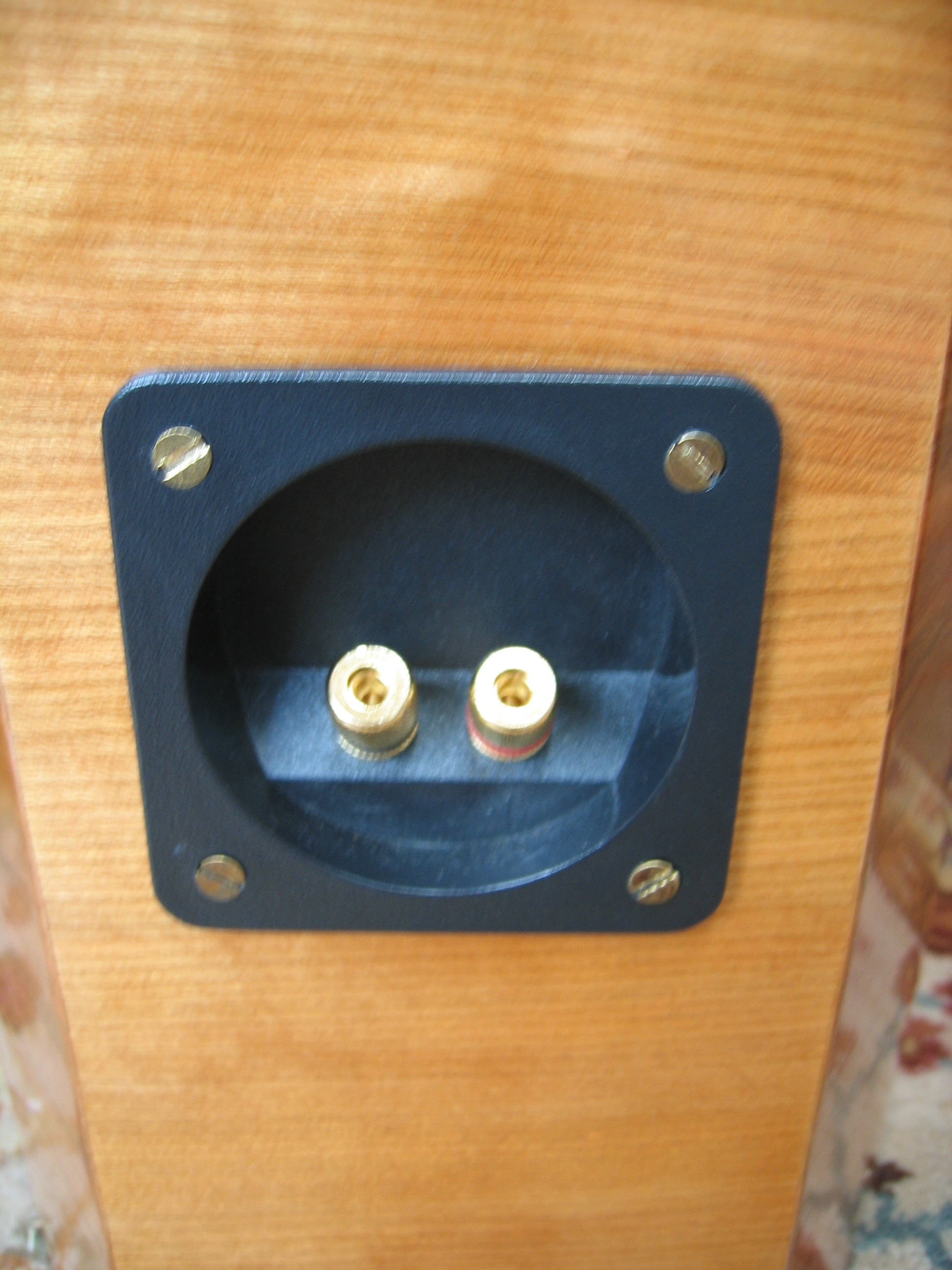

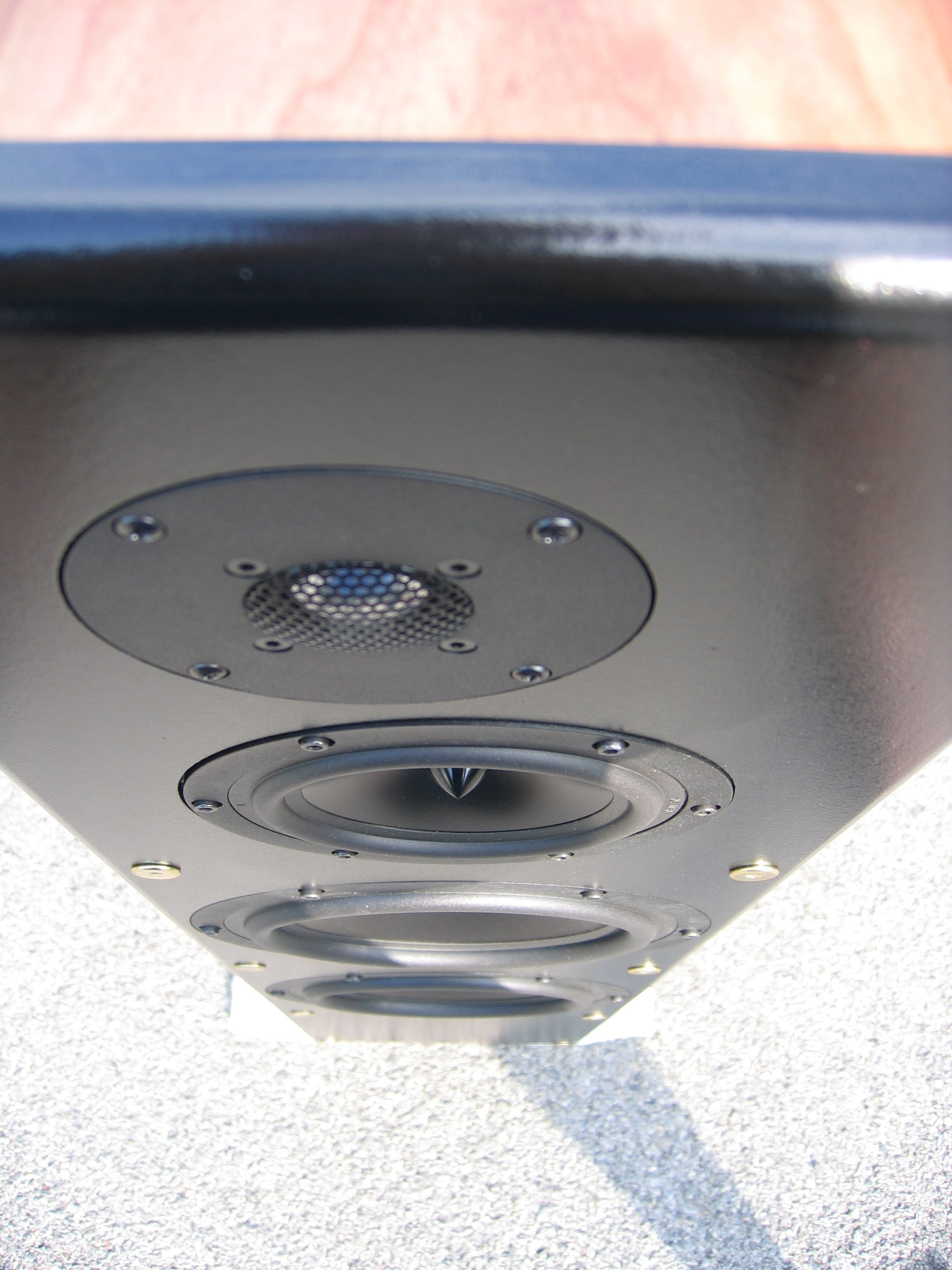

                              ​I finally finished these suckers. They're 90lbs each and came together really well. While they look good, they sound even better. Now I know how my music is supposed to sound. I will still build some feet and grills, but for now I just wanna listen to them!
                              Also, for the finish, I used some clear sanding sealer and 4 coats of Minwax semi-gloss polyurethane with sanding in between. No stain. I think they look glossier in the pics then in person. This might be because I applied the final 2 coats using a top-loading sprayer. I was glad I did this because the clear coat came out very even and with very little imperfections. I didn't wax them either.
                              They certainly have a presence, both visually and acoustically.

                                                                              I find more and more that I like the sanding sealer method for making the grain pop just the right amount, followed by a poly finish. I prefer the no stain methods as I want to appreciate the natural beauty of the veneer as much as possible.
                                                                              Do you know the specific species of Cherry for your veneer? Its much less red than I'm used to seeing. Where did you get your veneer?
                                                                              I hope you're getting lots of quality listening time in after all that effort
                                                                              • lcolbur1
                                                                                • Nov 2010
                                                                                • 134
                                                                                did you follow brian walters design and why have a smaller chamber for treble and mid then he got in his design??
                                                                                I got my design from here:
                                                                                I agree, I too wanted to preserve as much of the natural qualities of the wood.
                                                                                I got the cherry from oakwoodveneer.com. It was the the standard flat cut cherry sheet, a really great value for how nice they turned out.
