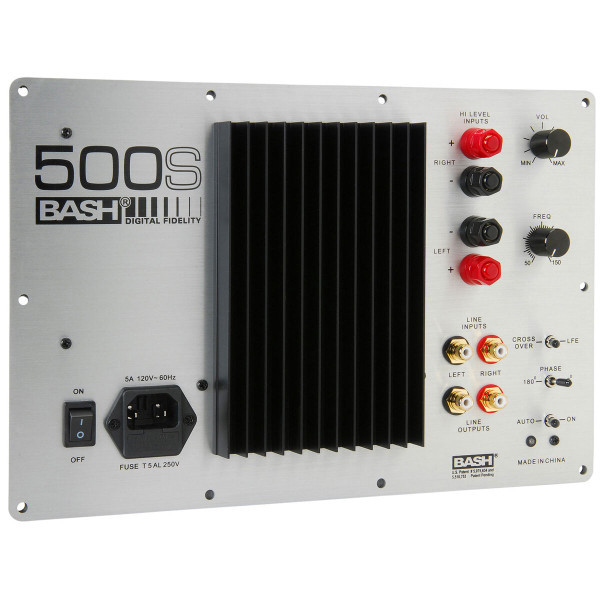

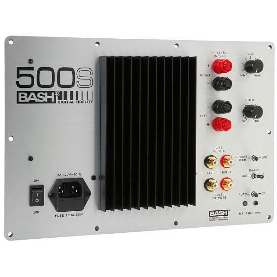

                        • 16209
                        #236
                        Since you built everything else yourself, why would you even consider a 'normal commercial sub-woofer'? Compared to the Statements, a DIY sub-woofer would be easy.
                        If I remember correctly, the Statements are tuned to ~40Hz, which means below that frequency the woofers will 'unload' and are in dangerous territory. LFE tracks on movies will typically go below 20Hz, which means there is material you will not hear without a sub-woofer. In your situation, I would build one sealed sub-woofer designed to go down to ~20Hz and run the LFE channel from your receiver to it. Parts Express has several choices in drivers and there are lots of cabinet designs you can copy.
                        They even have some decent kit subs if you don't want to figure out packaging, though myself, for a fast off the shelf solution, I'd be inclined to combine an RSS-390-HO with a BASH plate amp in their finished 3 cu fit enclosure, if you don't have time for wood working at this point.

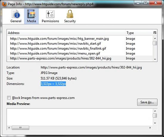

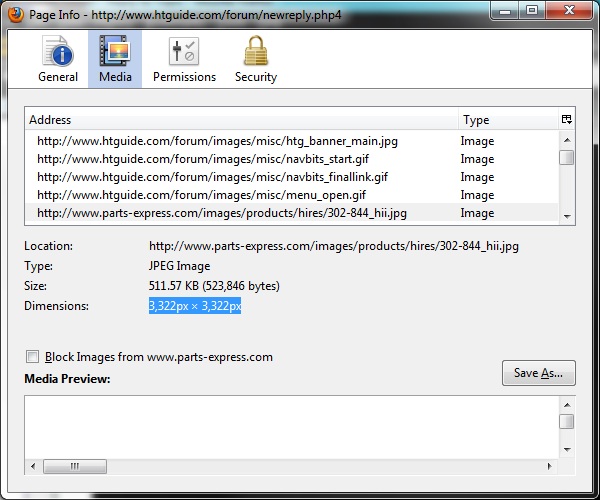

                            http://www.parts-express.com/images/products/hires/302-844_hii.jpg
                            Yo, Jon. You should know better than to post un-scaled pictures! :rofl:
                            Last edited by theSven; 30 April 2023, 14:07 Sunday. Reason: Update image location
