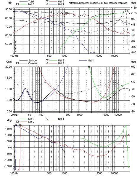

                                                                                  • AdelaaR
                                                                                    • Dec 2010
                                                                                    • 480
                                                                                    Oh ... so the statements are 6 ohms then? I Never heard of 6 ohm speakers before.
                                                                                    Apparently my amp can take 4 ohms or 8 ohms when only one pair is connected, so I assume that 6 ohms will be fine then.
                                                                                      Actually, the average would be around 6 ohms with a 4 ohm minimum. That is a very easy load to drive except for the "wimpiest" of amps/receivers. Honestly, I prefer to be in the 100+ watt range at (8 ohm rating) with more being better. It depends on the volume you'll drive them to and what kind of music/movies you frequent. Big bass = big power.
Name:	statementresponsesplots (Medium).JPG
                                                                                      Last edited by theSven; 30 April 2023, 14:20 Sunday. Reason: Update image location
