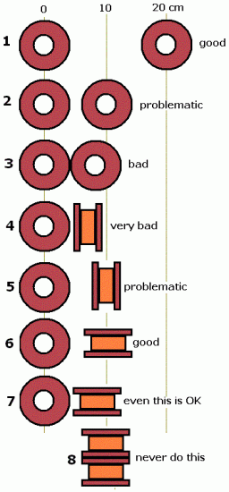

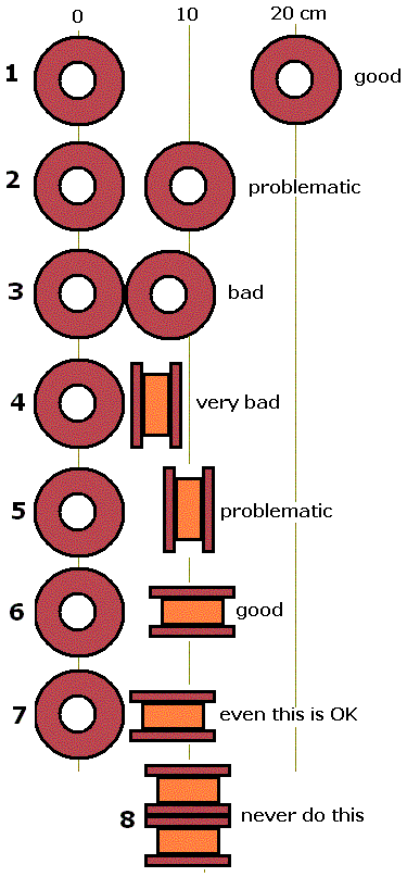

                                                                The crossover components and other things for the F4's arrived today.
                                                                I tried to assemble the crossover, but found it hard to fit 4 inductors on such a small space.
                                                                Here's a mock-up:
                                                                Image not available​
                                                                Does that look right?
                                                                Is there a better way to position the coils?
                                                                I want to keep it small so to fit on a little 12mm MDF board and be placed in the top of the cabinet.
                                                                Last edited by theSven; 02 August 2023, 15:47 Wednesday. Reason: Remove broken image link
                                                                  #167
                                                                  Here's a guideline to go by...

                                                                    Thanks for trying to help me there, Jim, but I had already found that exact same guideline floating around here somewhere.
                                                                    Thing is: in such a small space as the inside of an F4 ... with 4 inductors on one crossover ... it's near impossible to not be in the "problematic" zone.
                                                                    However ... I assume, since it makes sense, that the distance the inductors should be apart (when in the same planar field) is related to their inductance values, right?
                                                                    In that case the guideline comes a bit short at fully explaining the problem.
